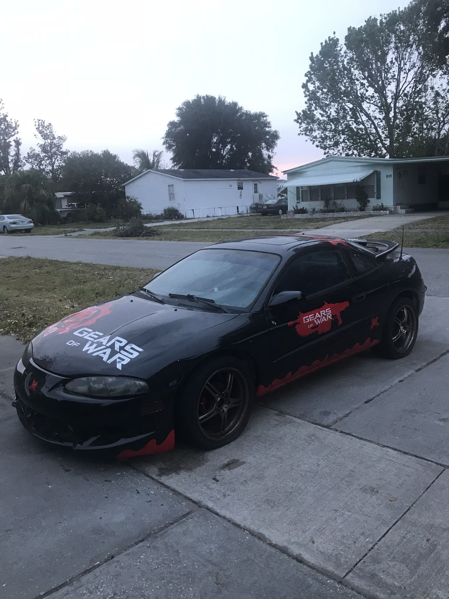

I bought this car for $700. This was my dream car from childhood.
Hi I’m a young Car Enthusiast and I want to mod this car to a fast sleeper car. I got this car about a year ago. I absolutely love it! I want to do many things to this little beast but I don’t know much about brands that are good and brands that are bad. You guys can give suggestions or better ideas feel free!

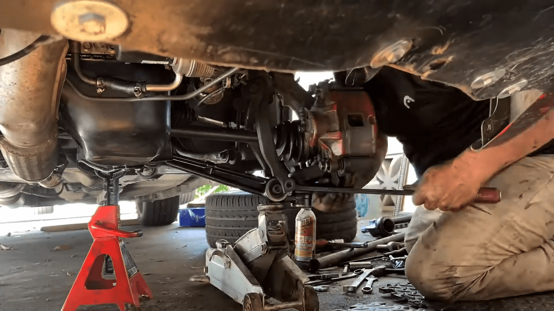

So I had an issue with my suspension and I changed both CV axles and replaced my whole suspension with a new OEM front suspension with the help of my dad. I posted a video about the whole process in the timelapse format on my youtube channel called The Fred Rider!
