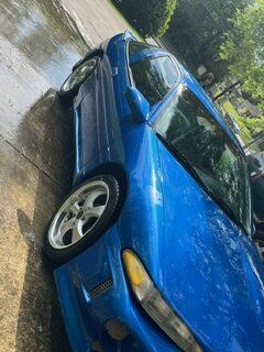

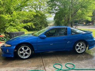

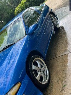

Happy to be here. I have a lot of work to do. Its is a 1991 Eagle Talon fwd 2.0. I wont to change it over to awd at some point
