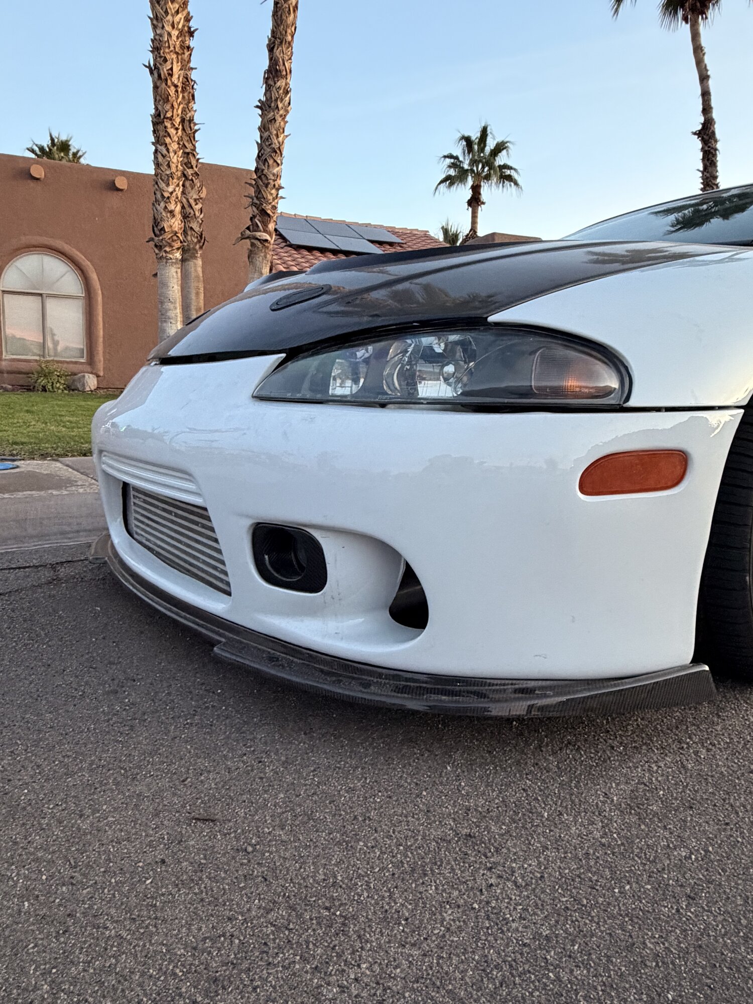

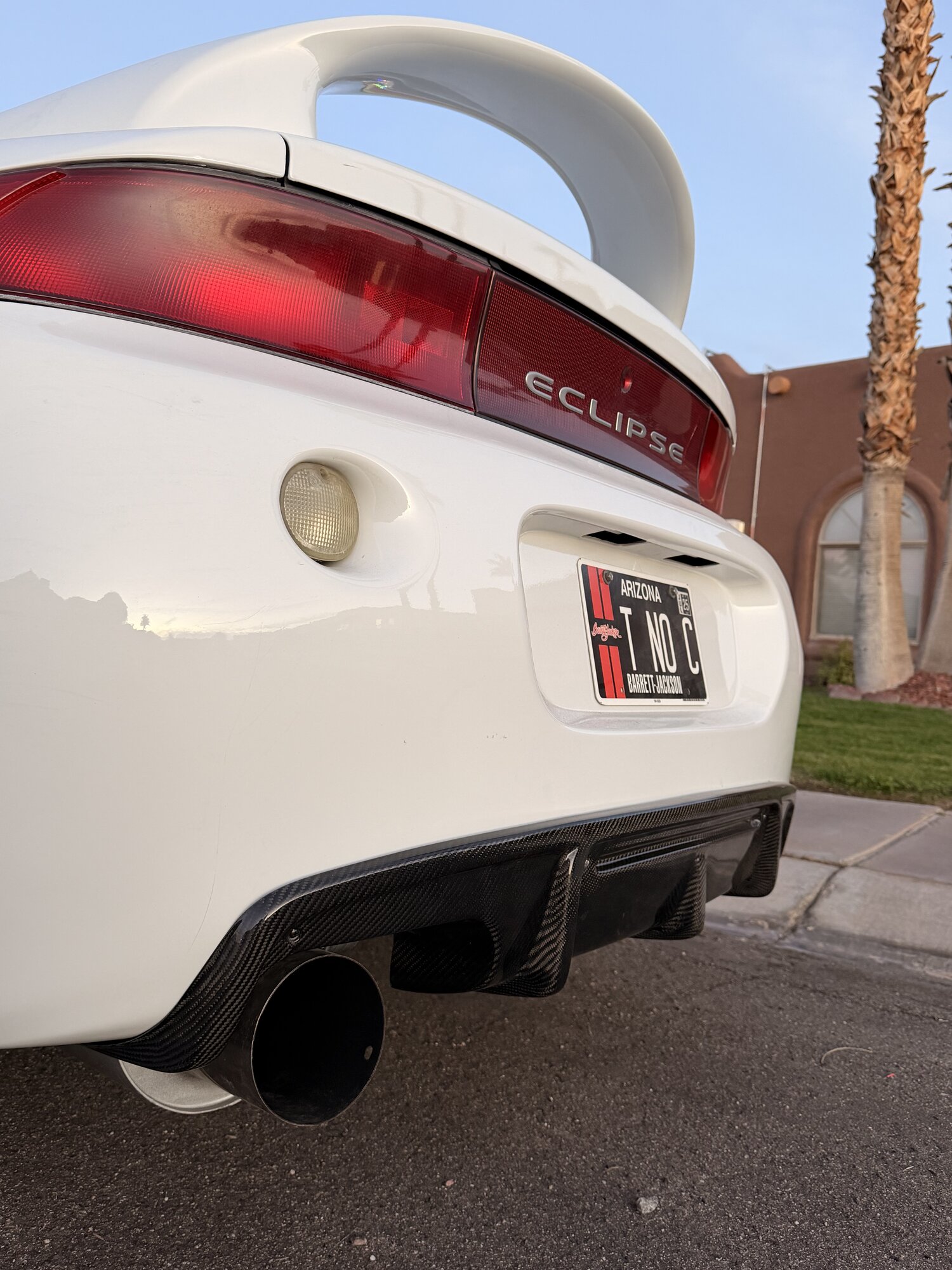

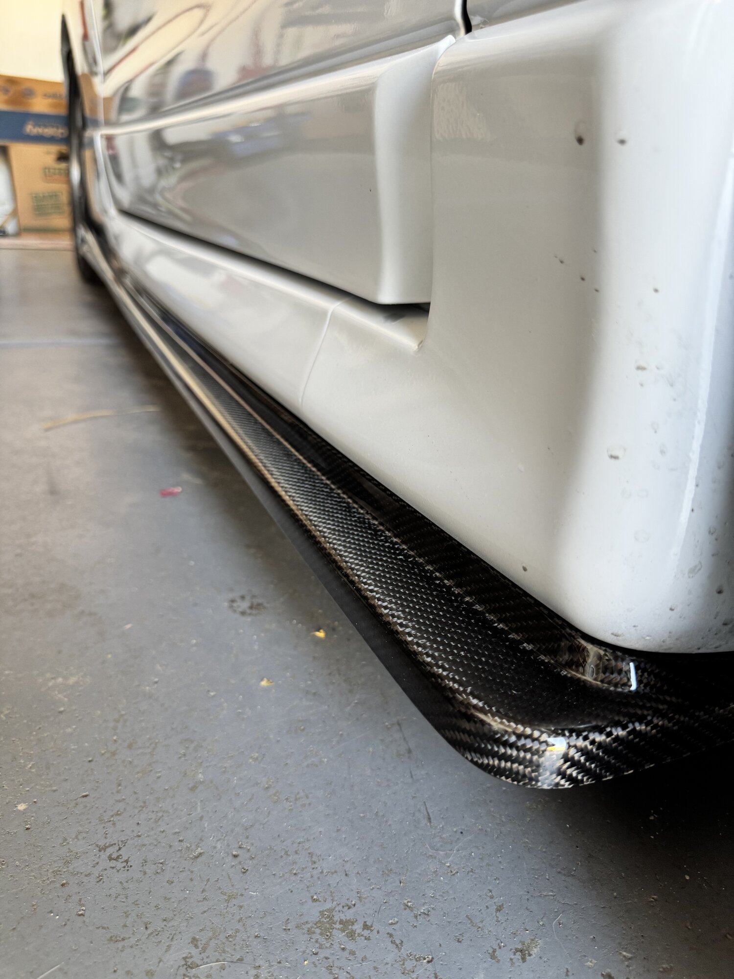

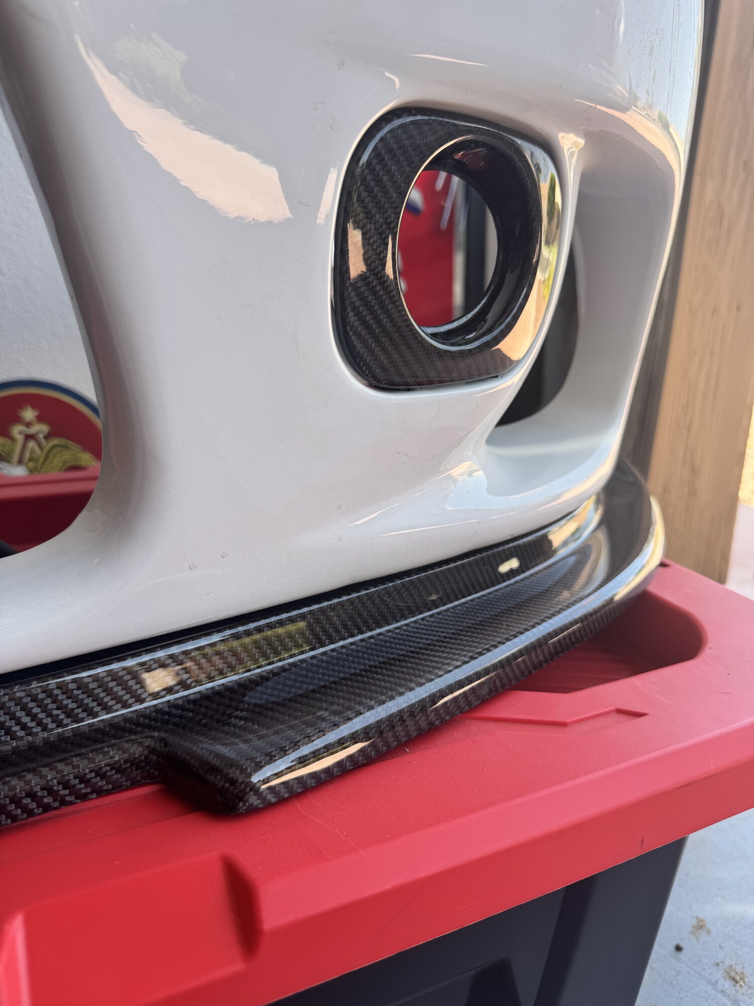

Update on what I’ve been up to. DSM Link V3 on speed density. Added AN fuel lines and filter. Full body repaint. Added a new carbonetics hood. Full carbon fiber front and side splitters and rear diffuser. Pillar boost gauge and Wideband gauge.

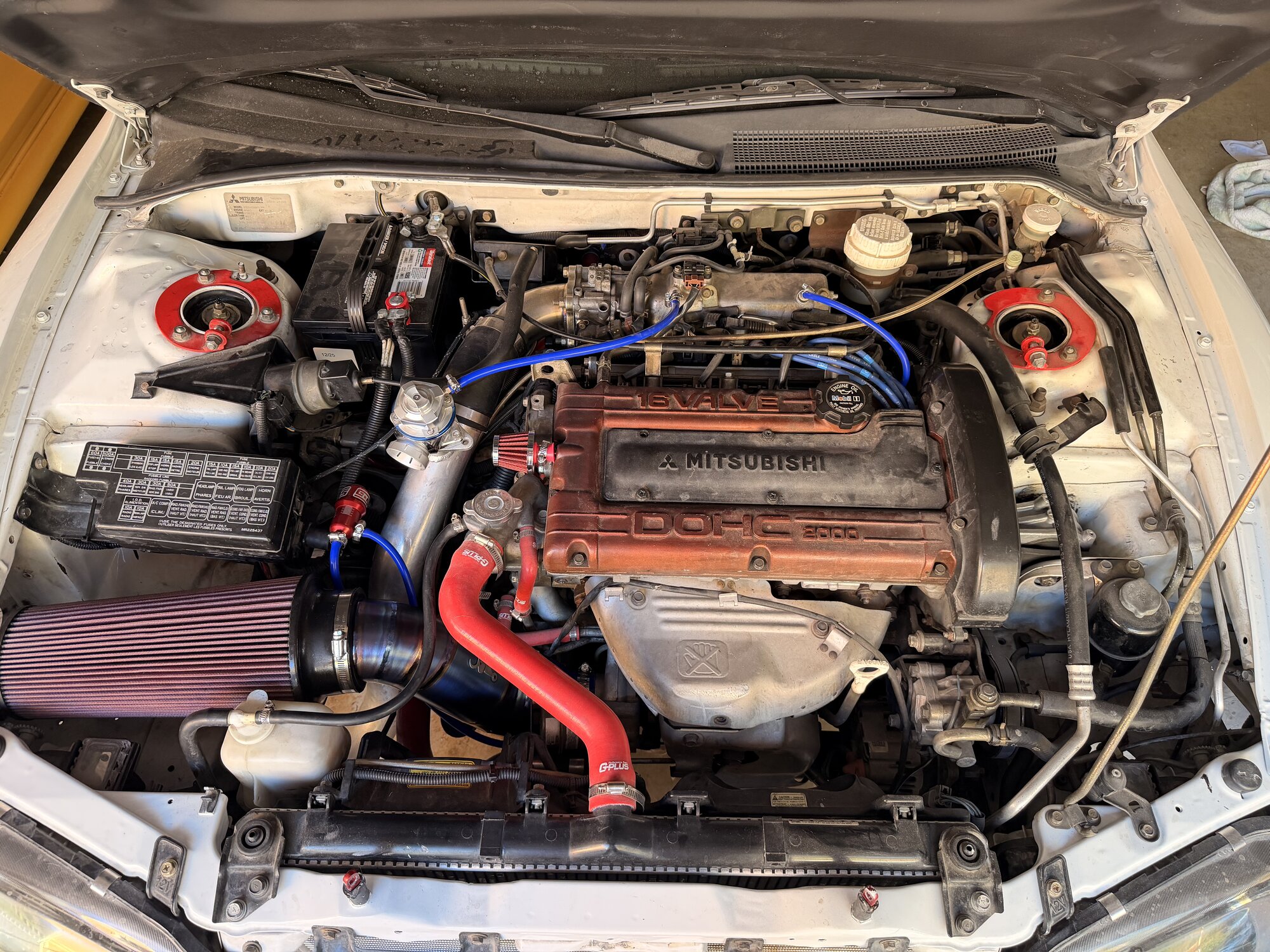

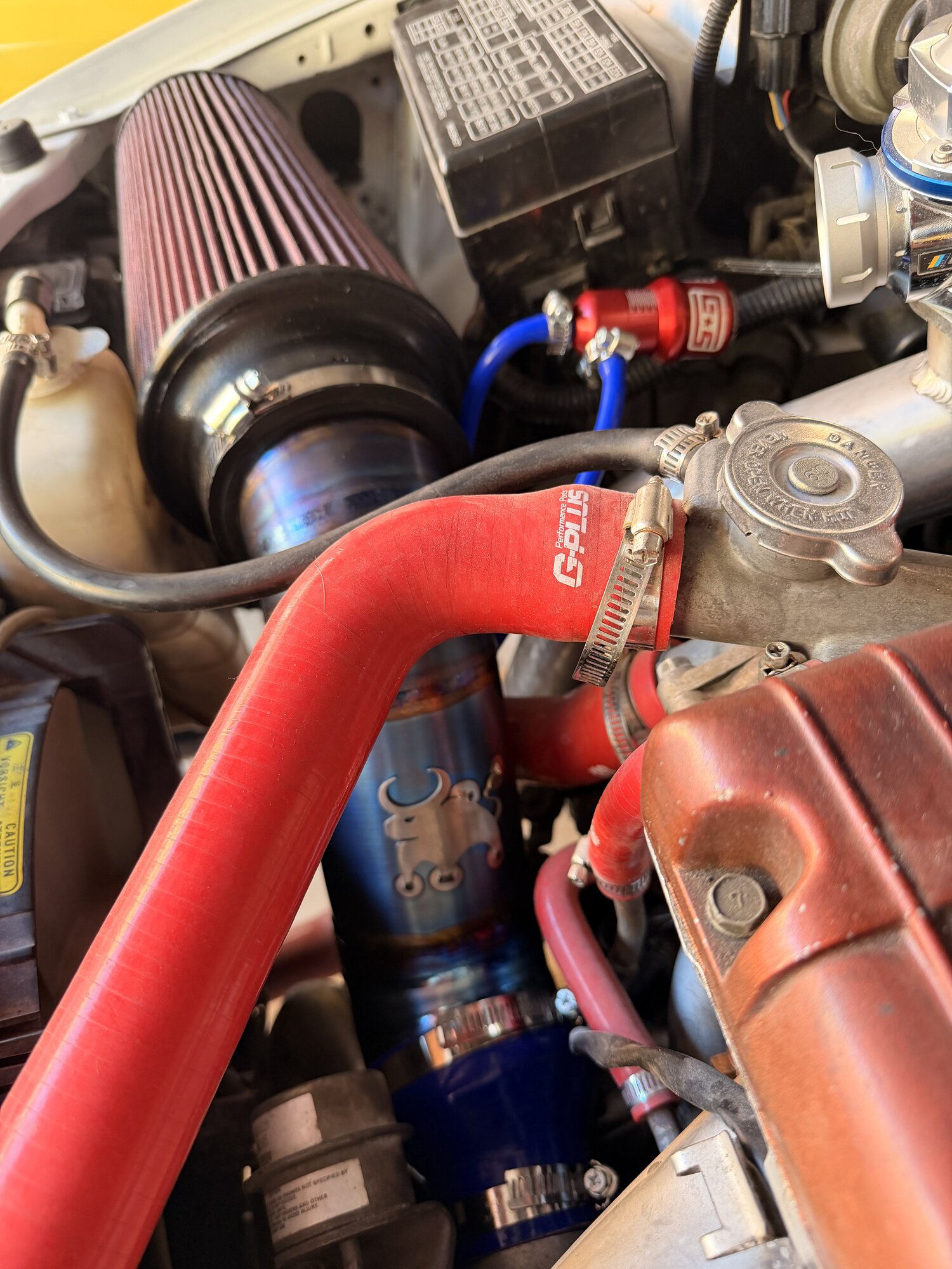

Today I installed the BS Fab Intake and a manual boost controller. EGR was already removed but today I also removed the charcoal canister and all those lines. Connected the FPR directly to the intake manifold. Also put in an AEM X wideband. It was a productive day. Now just to get the tune refined.

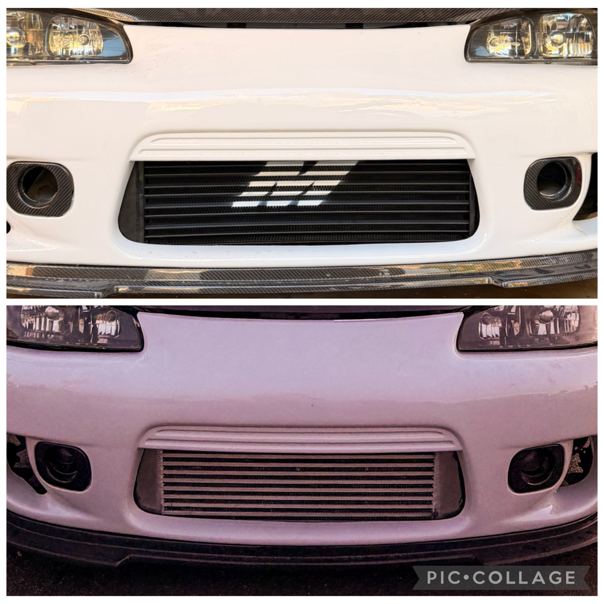

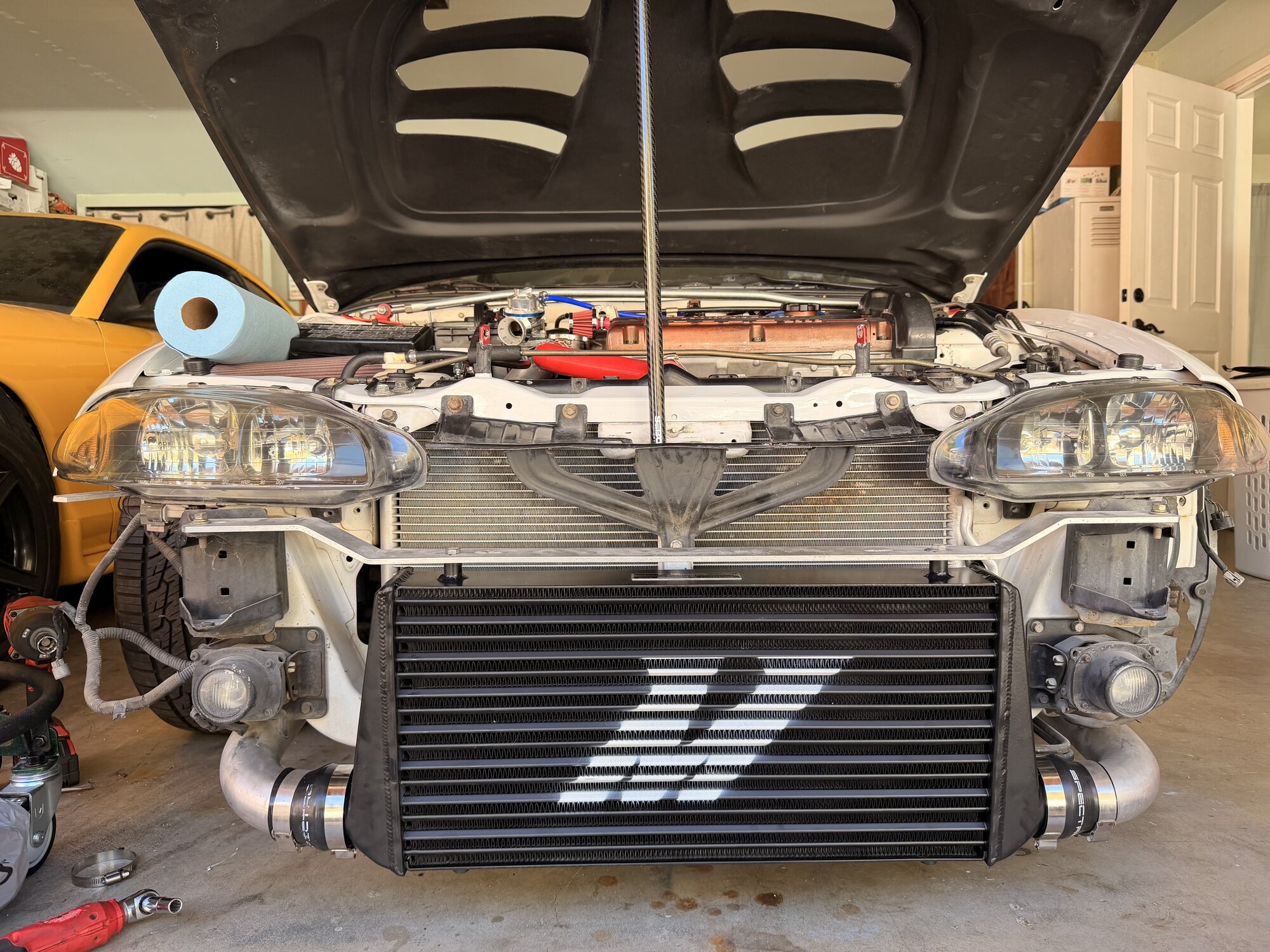

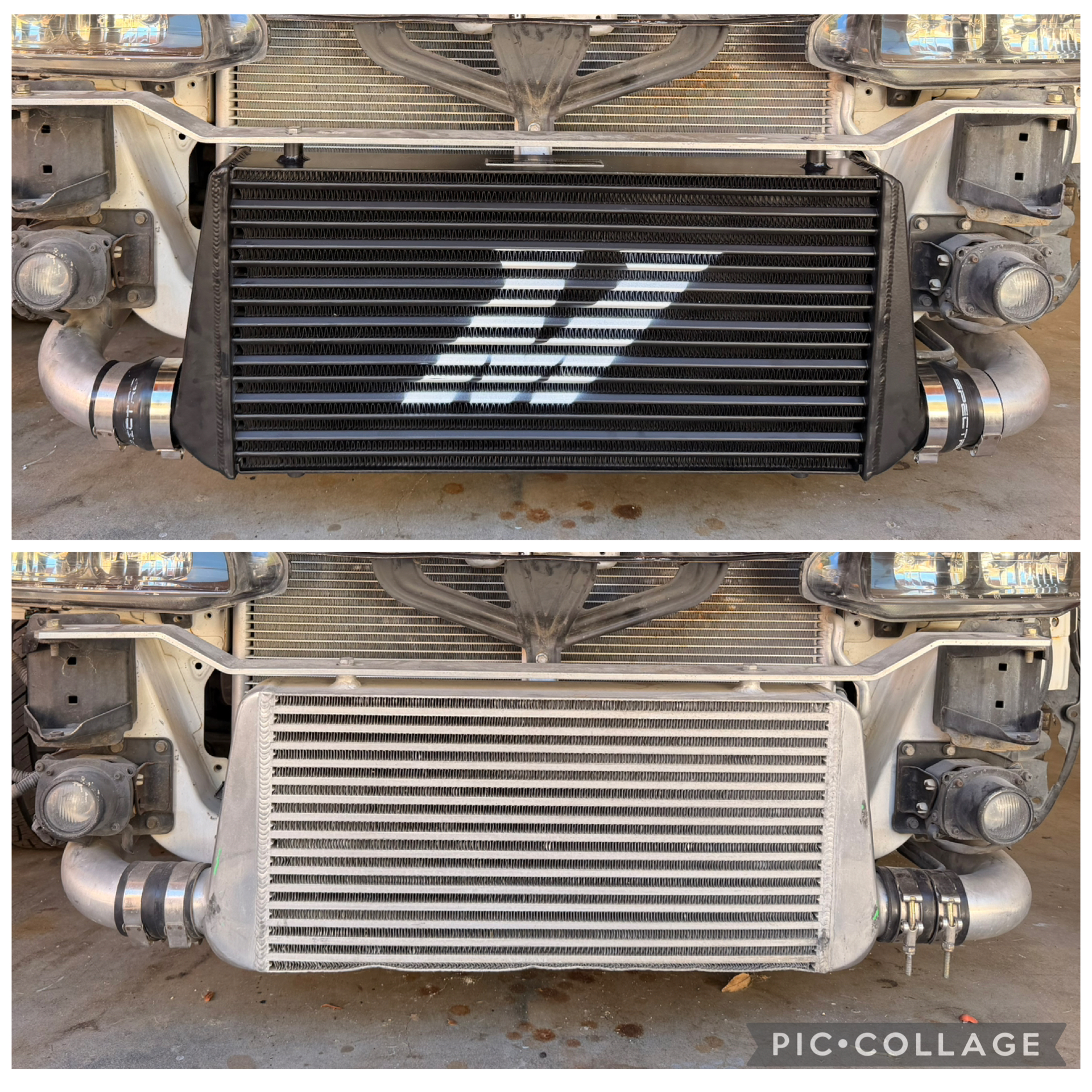

Today I changed my intercooler to the mishimoto M-line. Reviews are mixed but from what I read it seems to be the appropriate choice. What do you think?
that looks sick!! about to install a manual boost controller with a mechanical gauge myself you got any tips or pointers?
Well since I have done this I’ve had a vacuum cap come off a few times. So just make sure you secure them down with a zip tie or tiny hose clamp. Otherwise it’s pretty simple and straight forward to do. I followed a video I found on YouTube. I’ll see if I can find it again and share the link.
