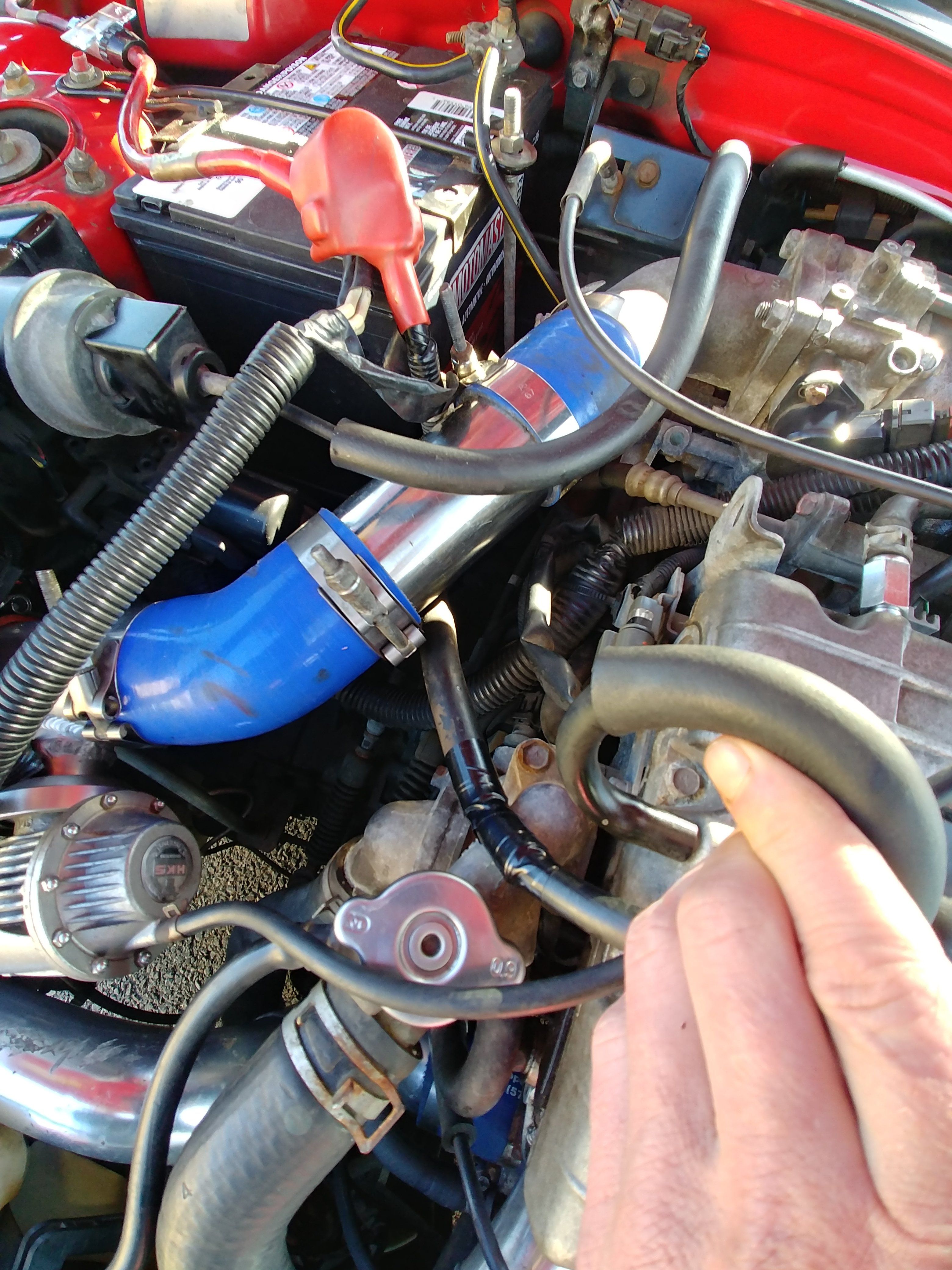

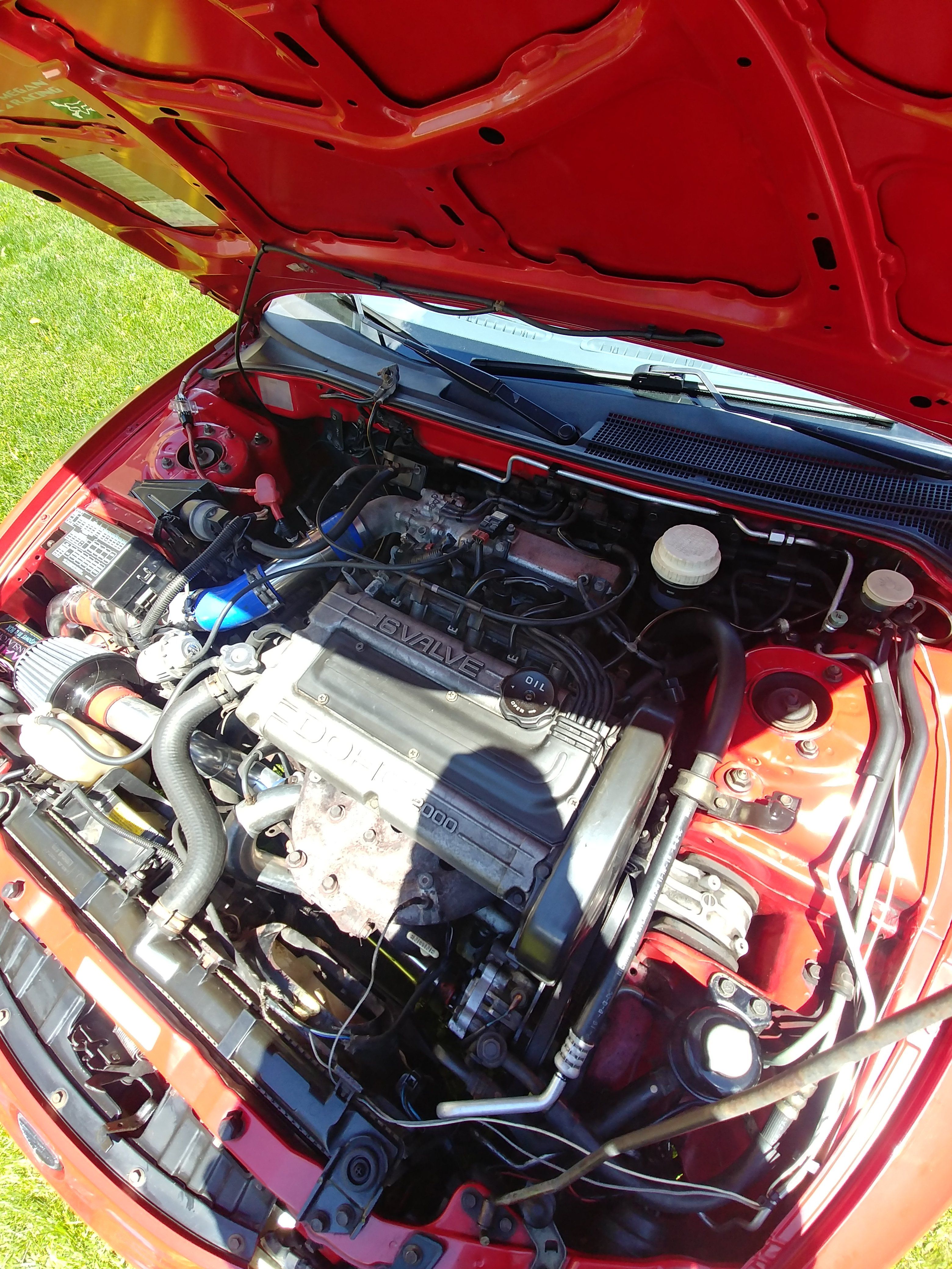

Do have the questiin of pcv dip stick that cant find answer or photo showing. Ive purchased catch filter for VC cover relief hose havent installed because i know nothing of turbo engines. But where does other end of hose post filter connect. In the pic from diy shows it just dropping off under some wire bundles. Any help regarding thus us apprecuated. I have added phote of engine bay maybe someone can provide assistance
And yes have replaced pcv. Dip stick, oil fill cap new hardware for valve cover on order here next week, along with plugs and wires. Like mentioned above cant seem to figure out where VC relief hose needs to be reconnected or if i even have place on intake for it to go. Right now its routed to hose leading towards wheel well.
did you look at this in the tech articles ?https://www.dsmtuners.com/threads/the-4g63t-pcv-system.366890/it shows diagrams of different catch can setups ...should be helpful ...says catch can should not be vented to atmosphere but connected to a vacuum source ....ur talon looks in great shape for an east coast car ..nice grab!! ...i have one that's gone to rust and a second i am rebuilding ...i Haven't seen a dsm here in newfoundland in a few years now and i think ur the closest on to me on this forum for sure

. I appreciate the love. Ending up figuring it out. Placed a small filter on for relief. Seems to be running smoother hasnt totally fixed problem but toned it down. Im sure with new gaskets, hardware, dip stick and oil cap it will be fine. I think a proper tune would also help but been advised to get good guages before doung so.
