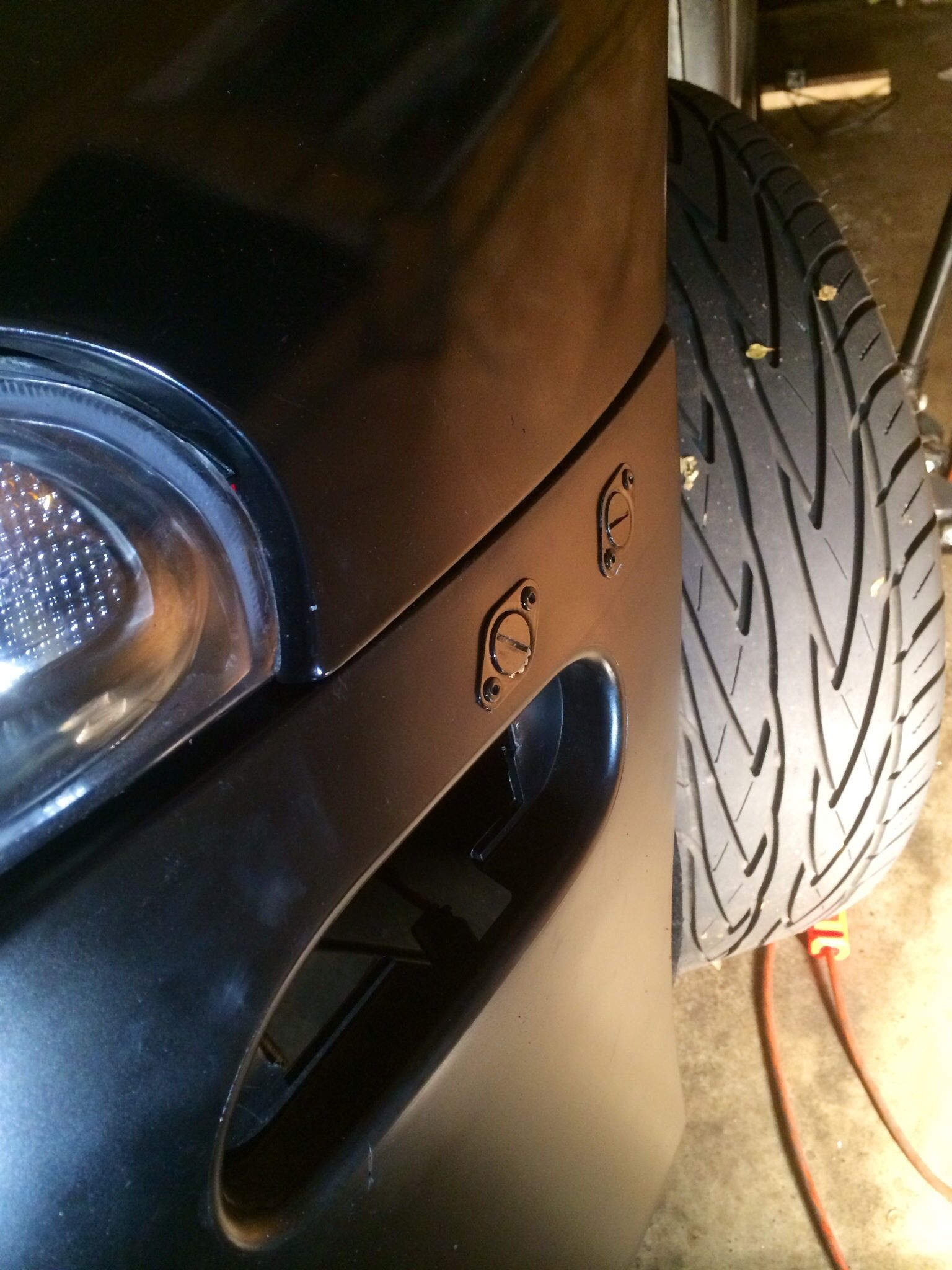

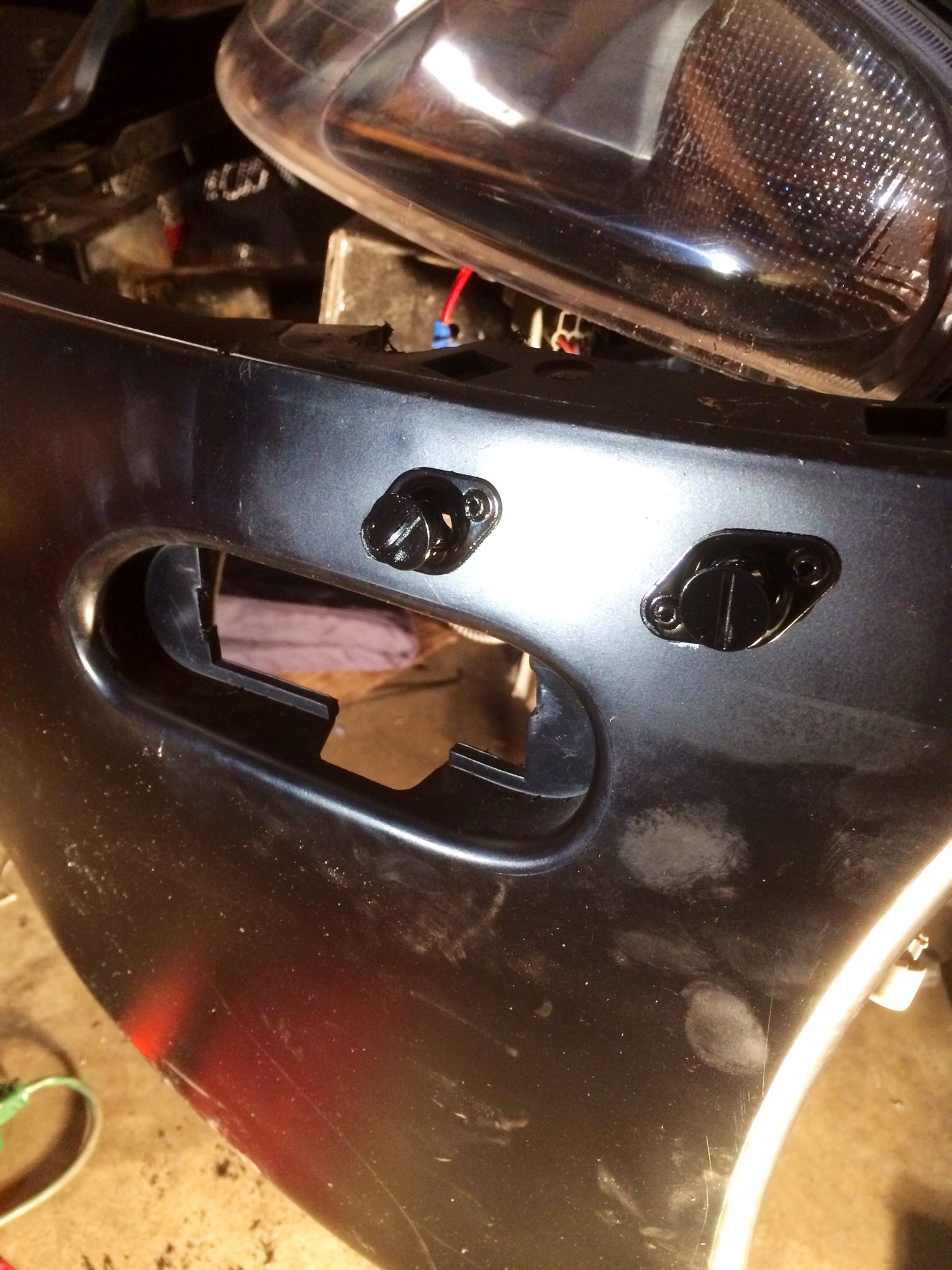

I got my Dzus fastener quick release bumper kit in! Thank you overkill performance for making such an easy solution!! It took me about 2 hrs to install the kit. I still have to mess with the alighnment a bit. Plus I have a non-OEM bumper and I think the tabs are a little thicker than the OEM ones so I just need to sand it down a little to be able to slide the bumper into place easier. Other than that the install was very smooth. I used overkills instructions along with jaxness's write up on here. With those 2 documents you have every pic you need.

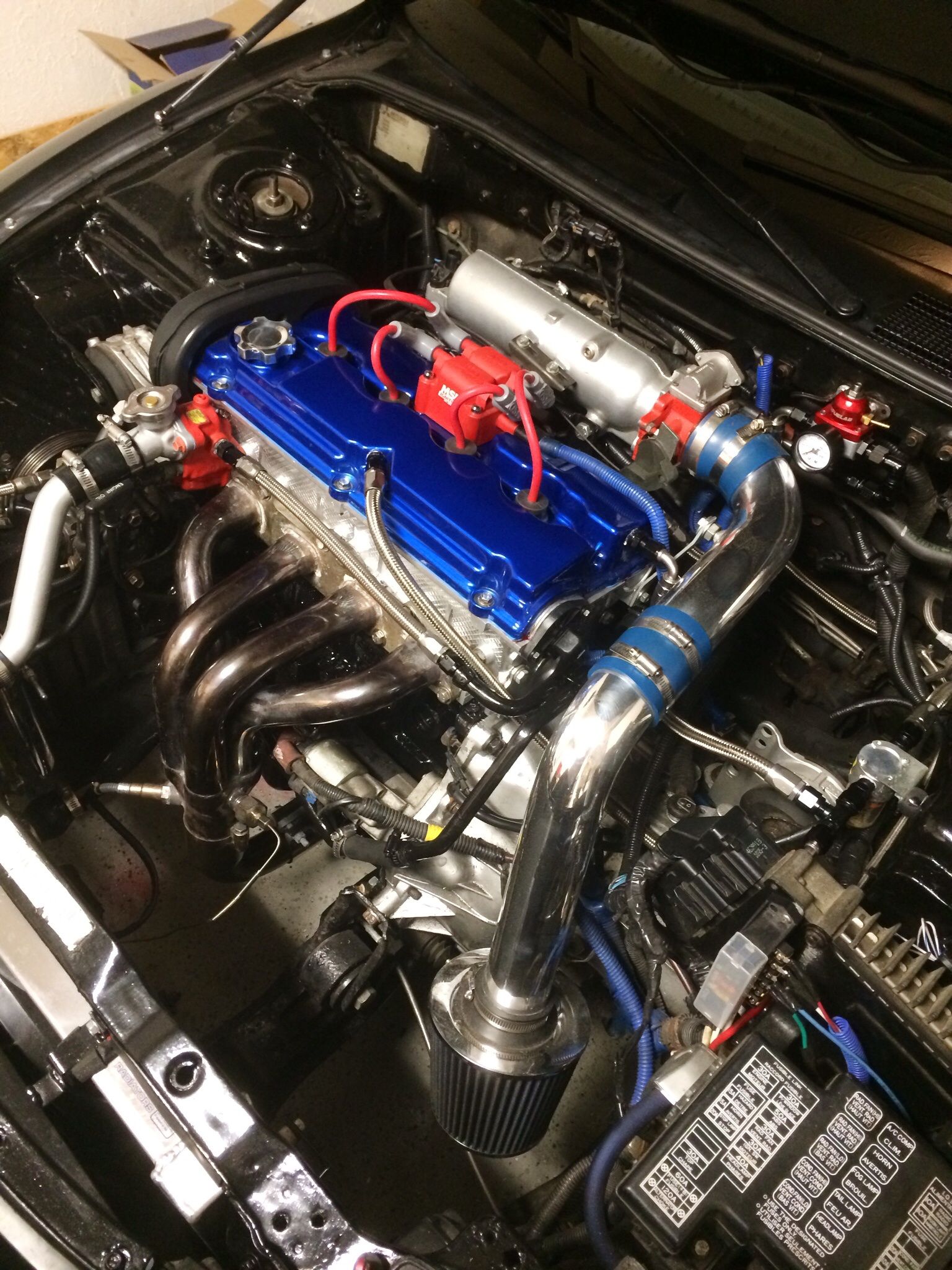

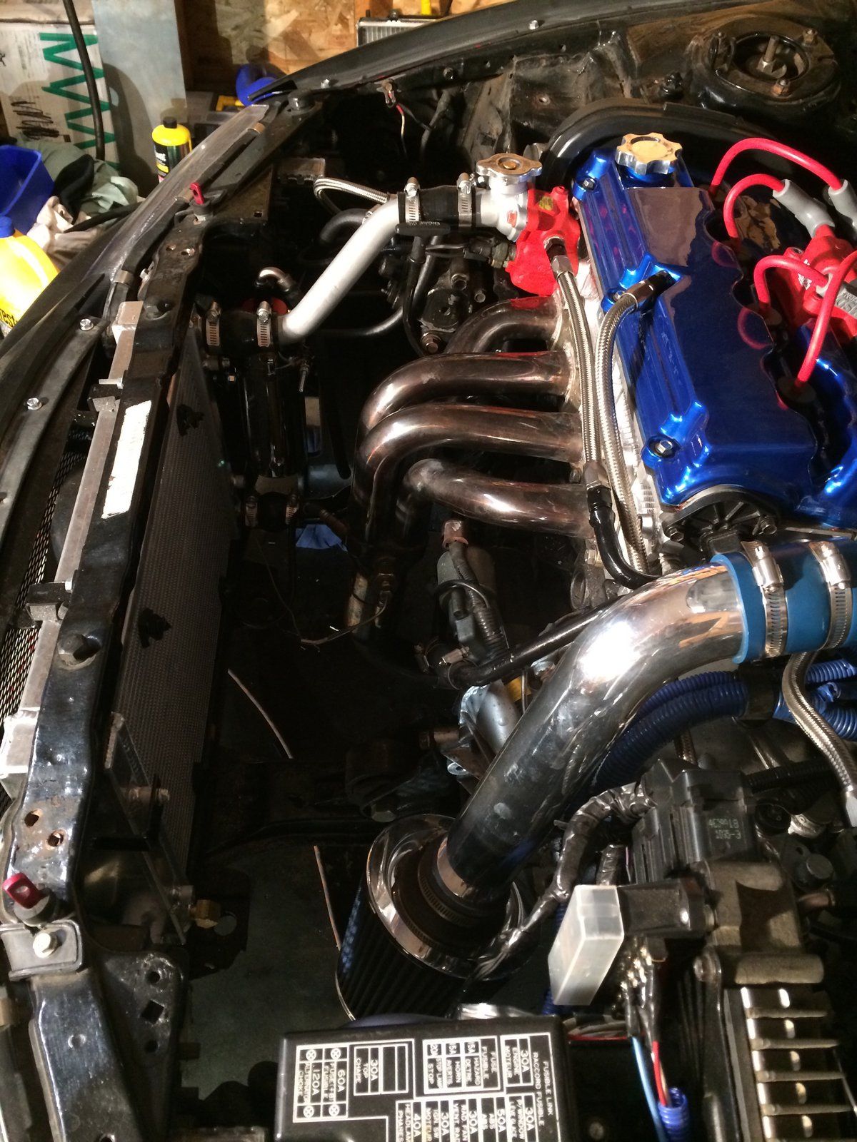

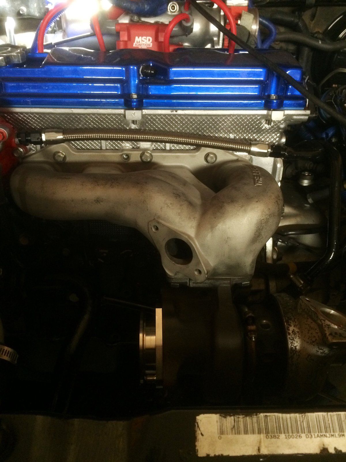

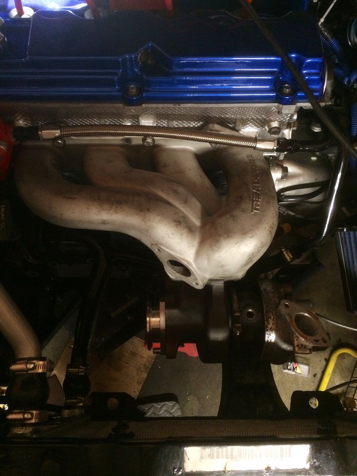

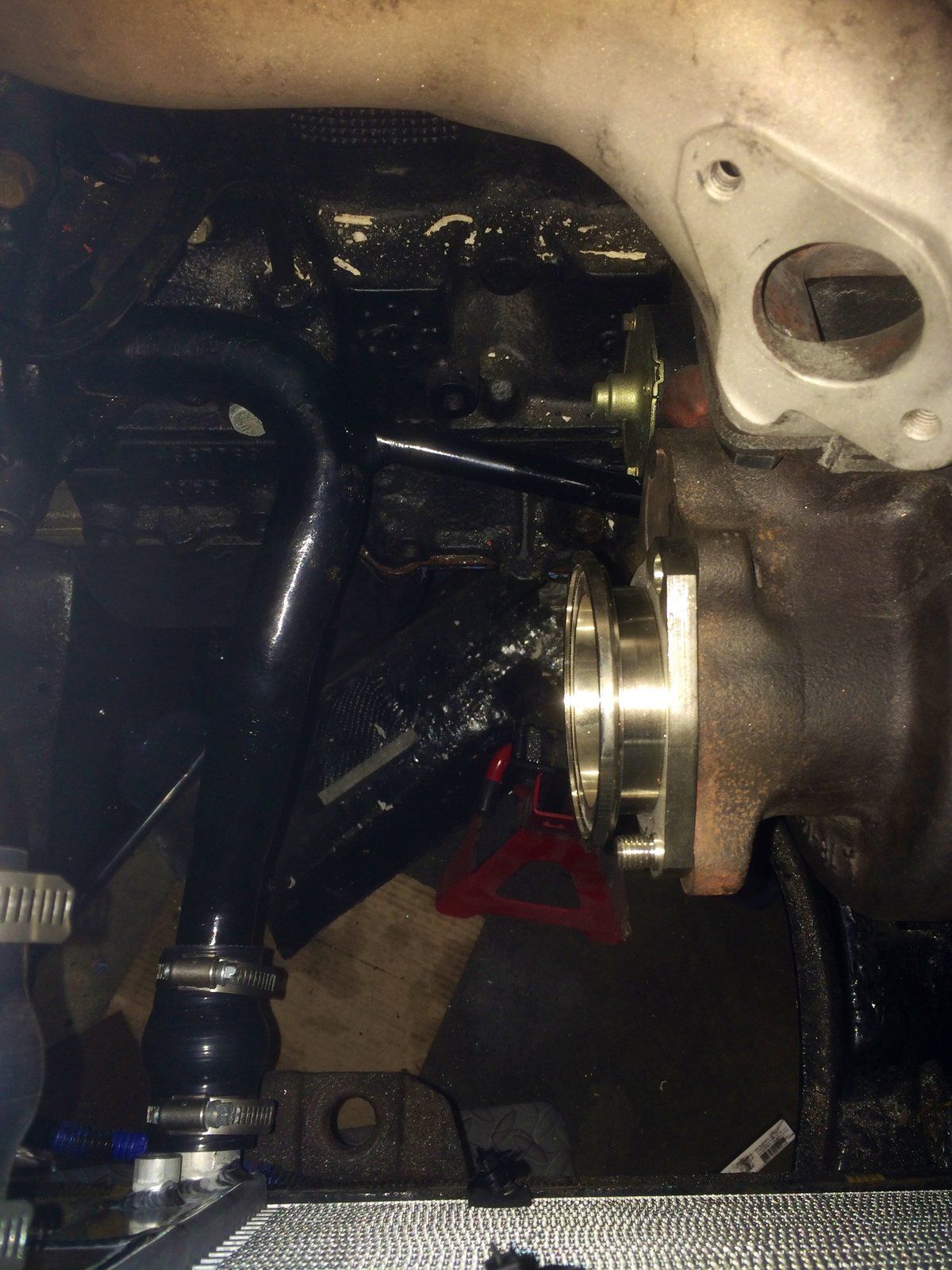

Now on to some more updates. I got a little itchy waiting to see how the Treadstone mani and turbo would look mocked up plus I wanted to see how I would have to run the DP with the new radiator hoses. I really can't wait until this is a permanent piece in the engine bay! For those wondering the turbo is an Evo3 16g with a T3 20g hot side. I will probably upgrade to a 20g before I actually turbo the car. Anyways on to the pics. Hope these help someone else looking at this manifold.

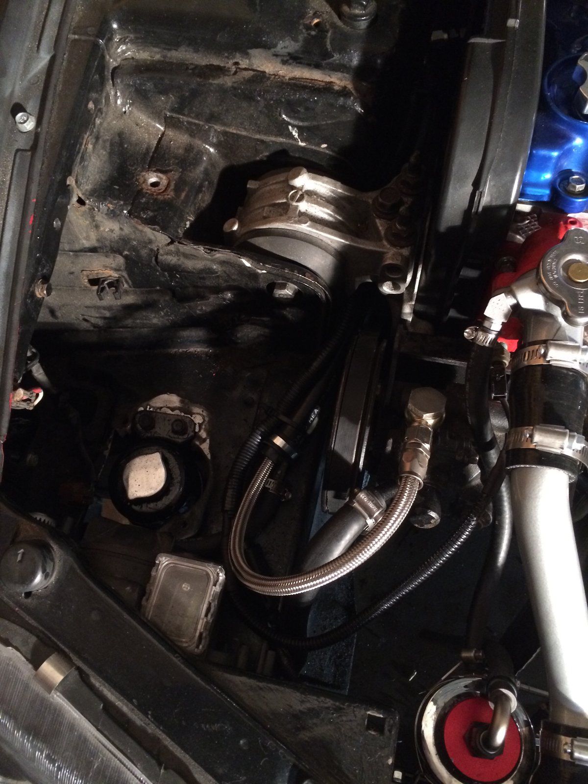

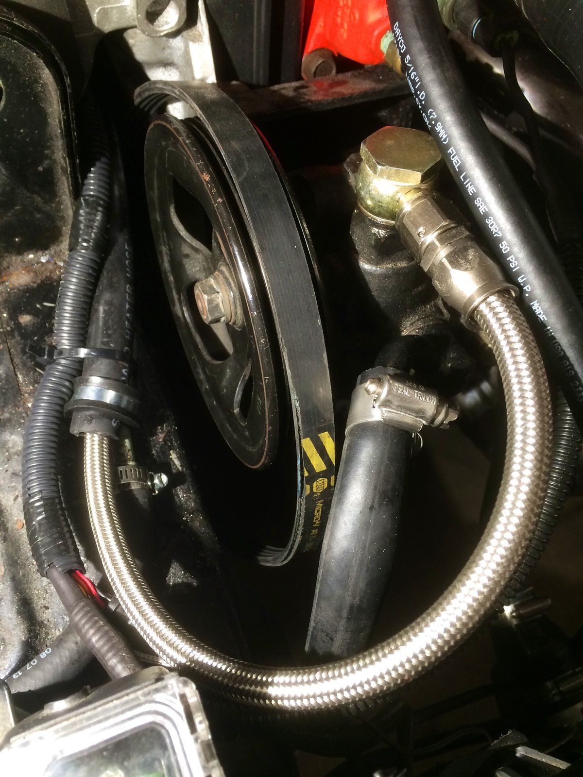

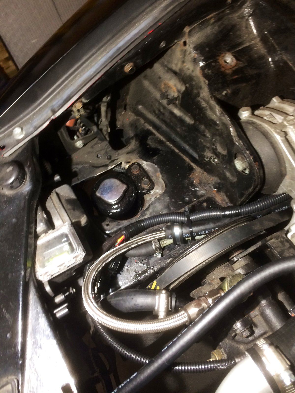

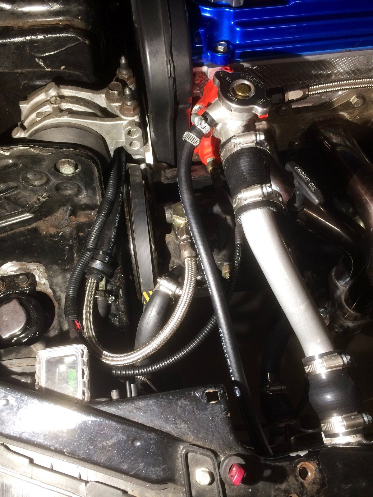

Now I also finished up the new power steering line and rerouted the wiring for the coolant sensors. I deleted the stock O2, AC, and power steering pressure connector. I extended the wires and ran them along the power steering line with the wideband O2 and EGT. I put a piece of 5/8'' coolant hose over the new pressure hose just to help keep everything from wearing through there. I think it came out great and really cleaned up that side of the engine bay. Next on the long list of the engine bay tuck is to weld up all the holes and shave the engine bay.

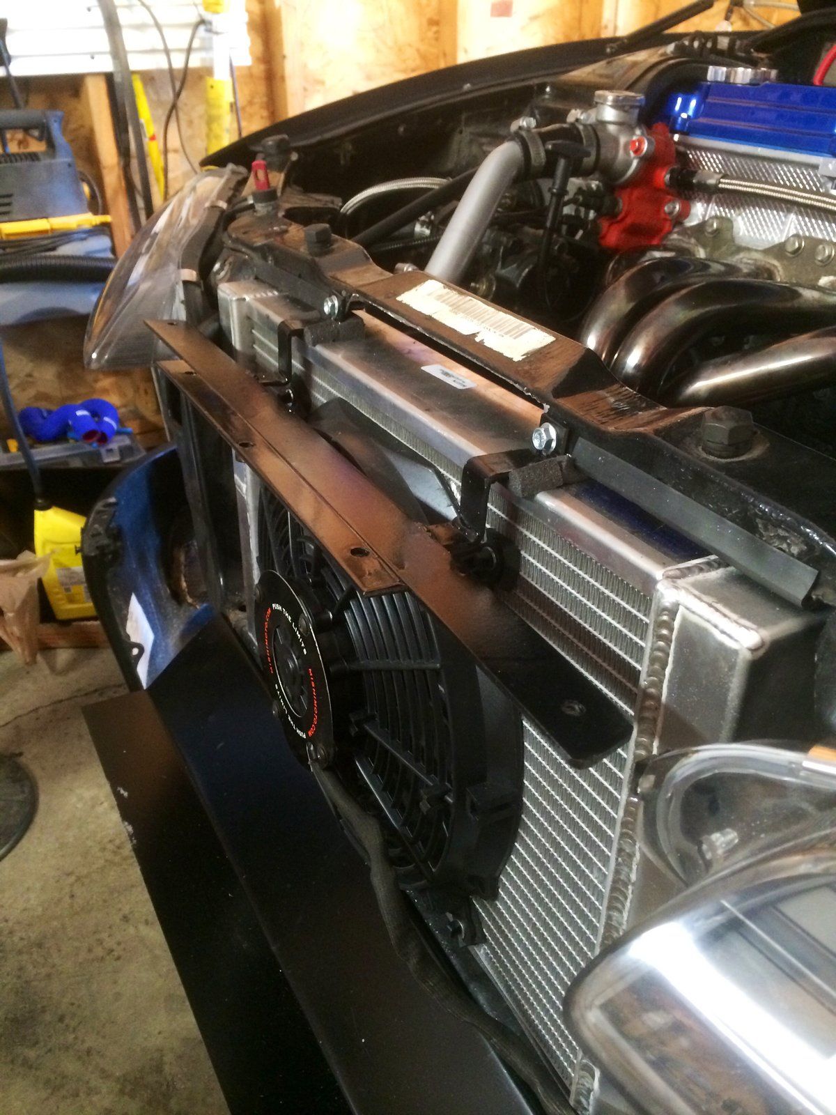

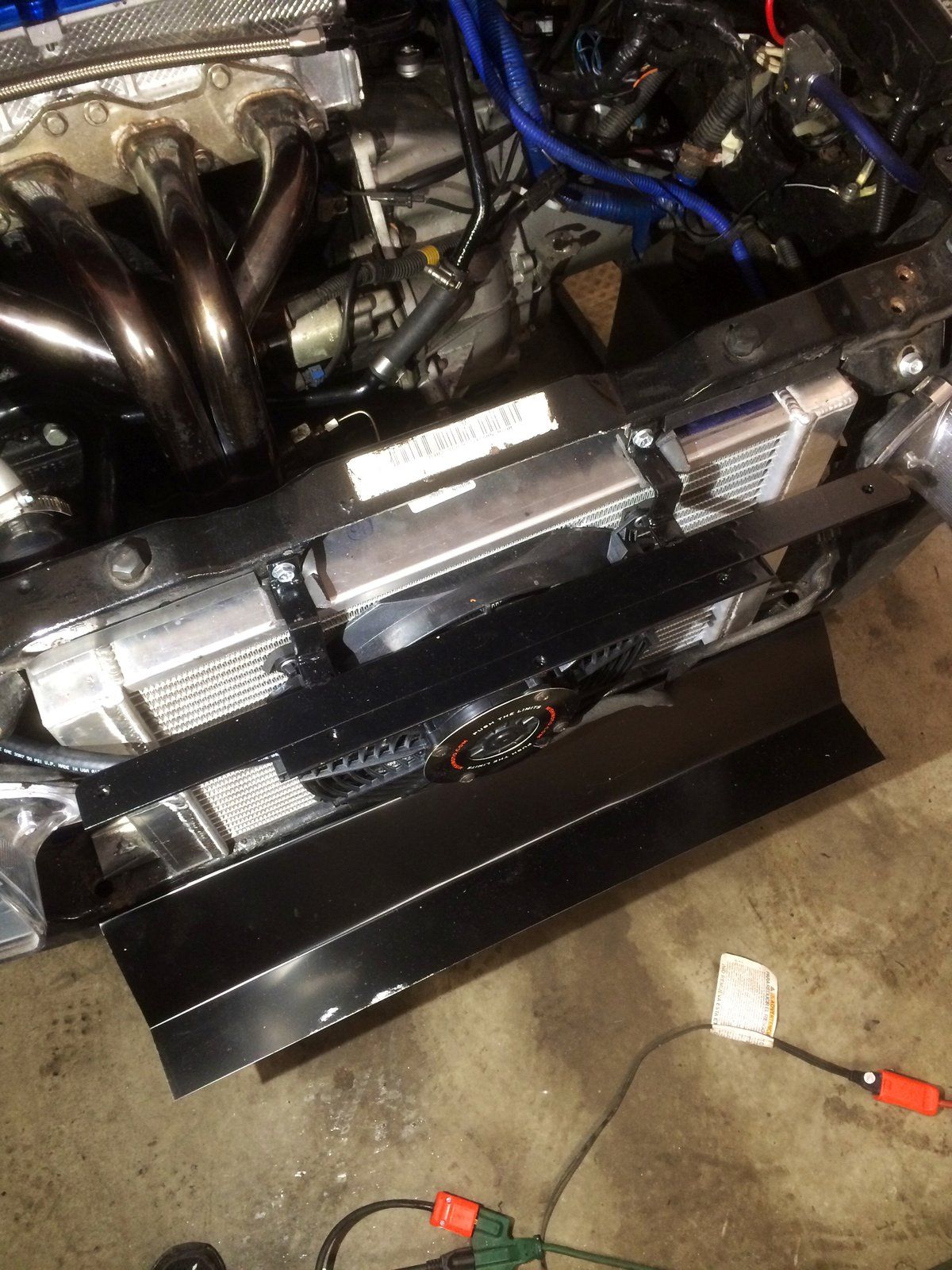

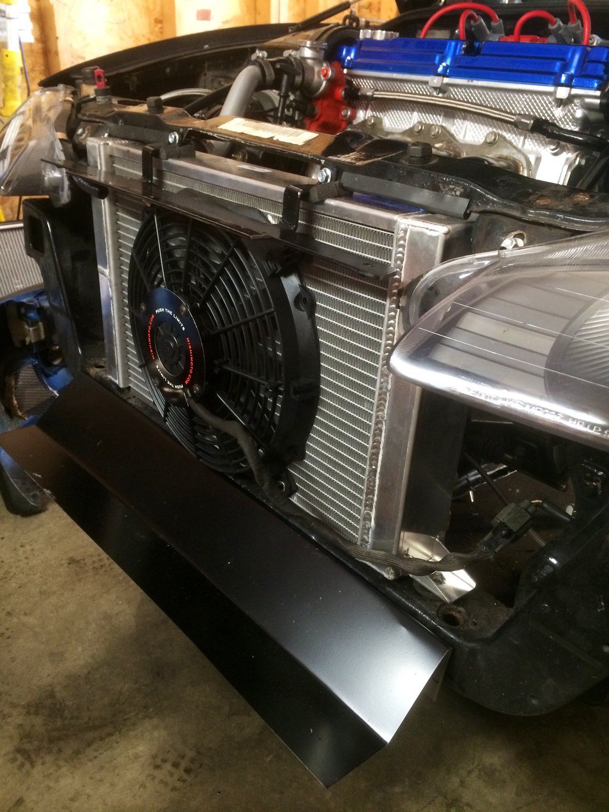

Now with the new radiator I had to make a new front bumper support. This is what I came up with. just nice and simple. I also bent up a new duct just to help guide the air into the radiator.

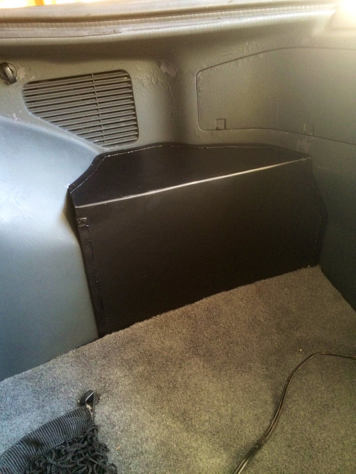

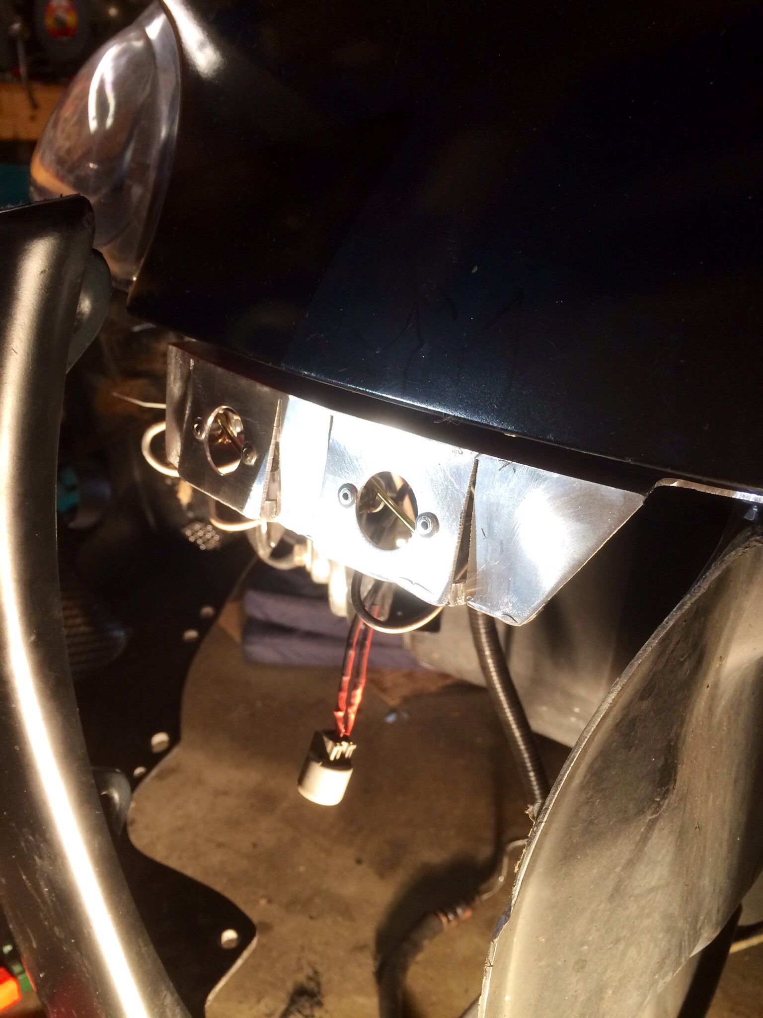

Lastly for this update I finally made a battery cover for the back. Right now its just plasti dipped black and is just resting there. I need to make up a few brackets to fasten it to but you get the basic idea.
Wow, that battery cover looks really clean. Nice job :applause:. That is exactly where I want to put my control panel for my tail lights. I may just have to steal that idea from you.:sneaky:
If you want the sheet metal for the template let me know and ill ship it down to you. I made the template out of 2 pieces because it was easier. I then traced it on one big piece.
I bet. I was just going to use some cardboard for the template and fiberglass right on top of it. Now that I think about it, I may have to do the driver side too in order for it to look symmetrical. LOL
It would probably not be that hard to match the other side since the drivers side will be more of a straight shot.

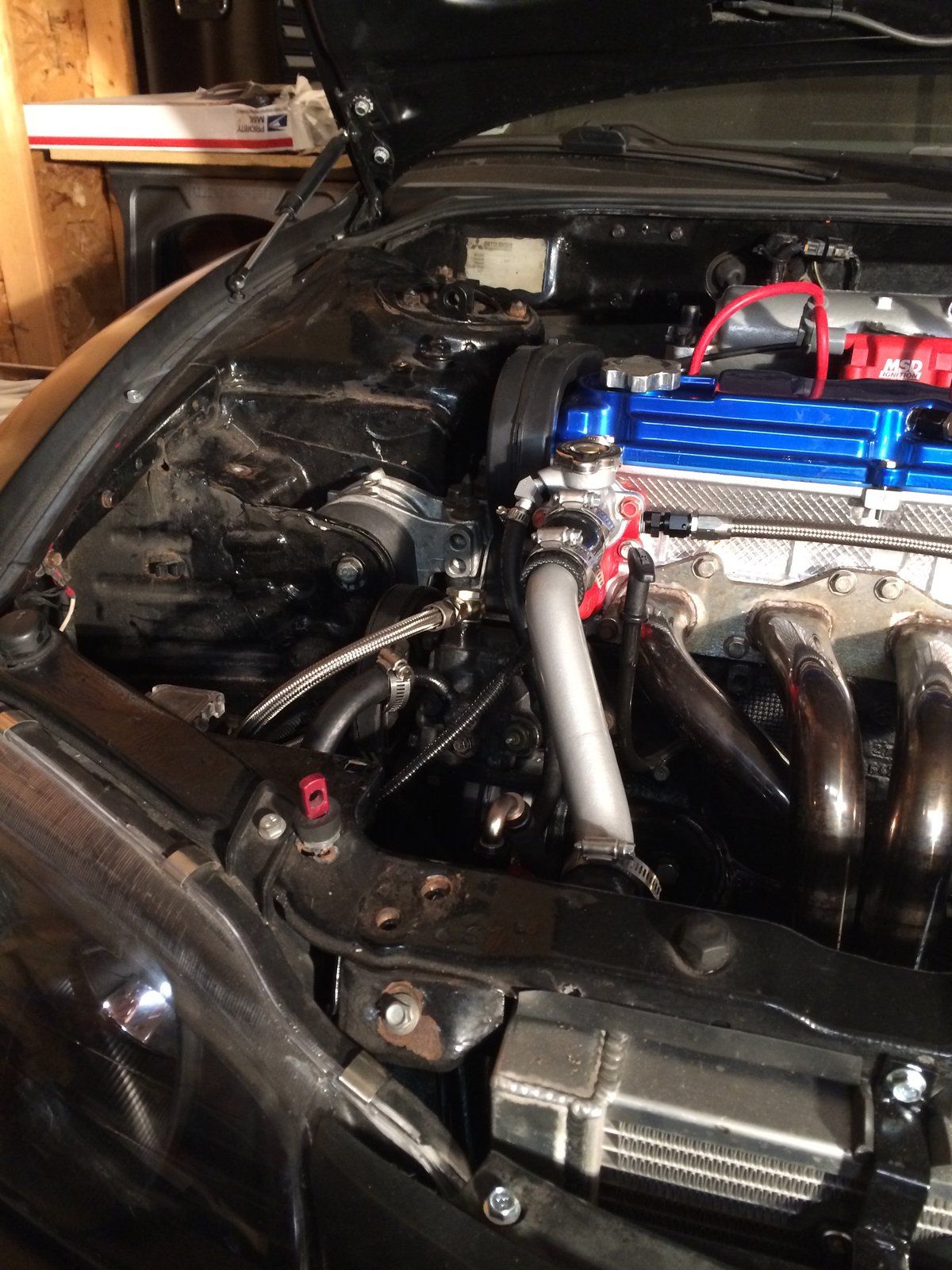

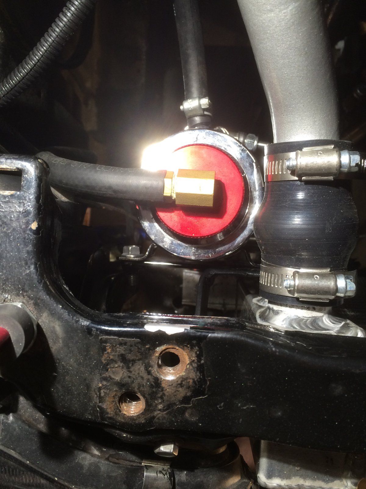

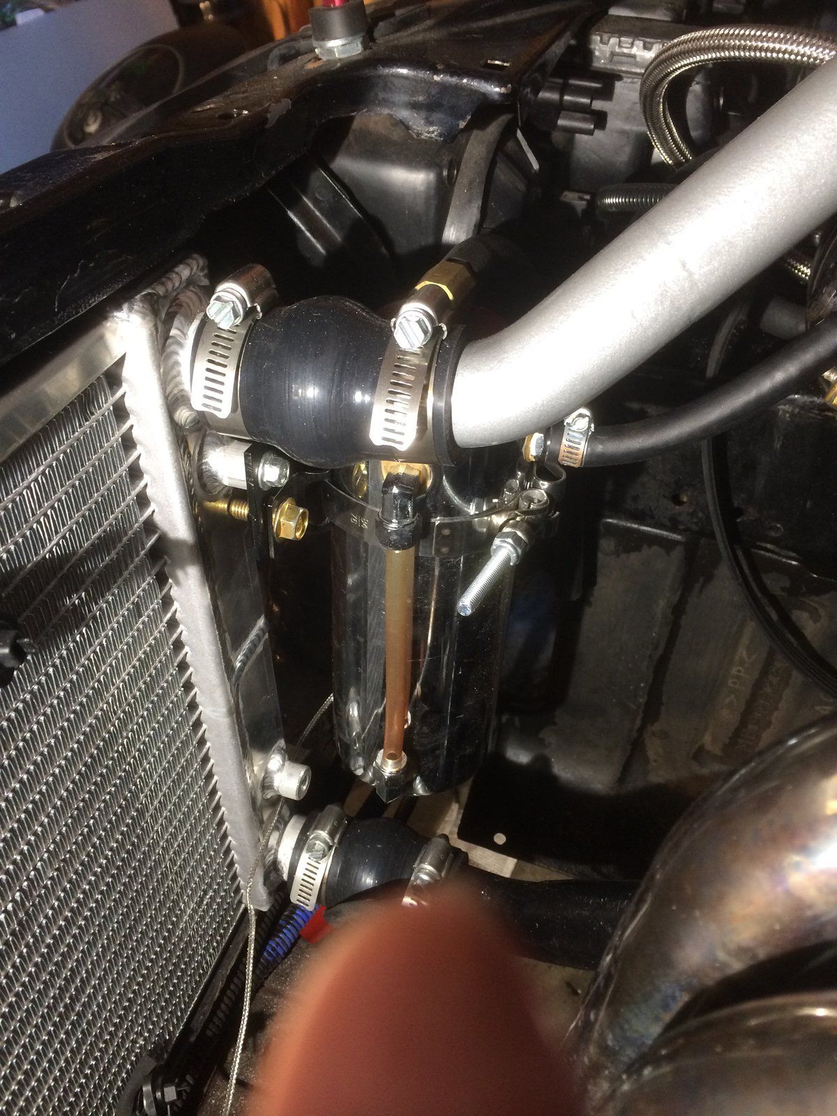

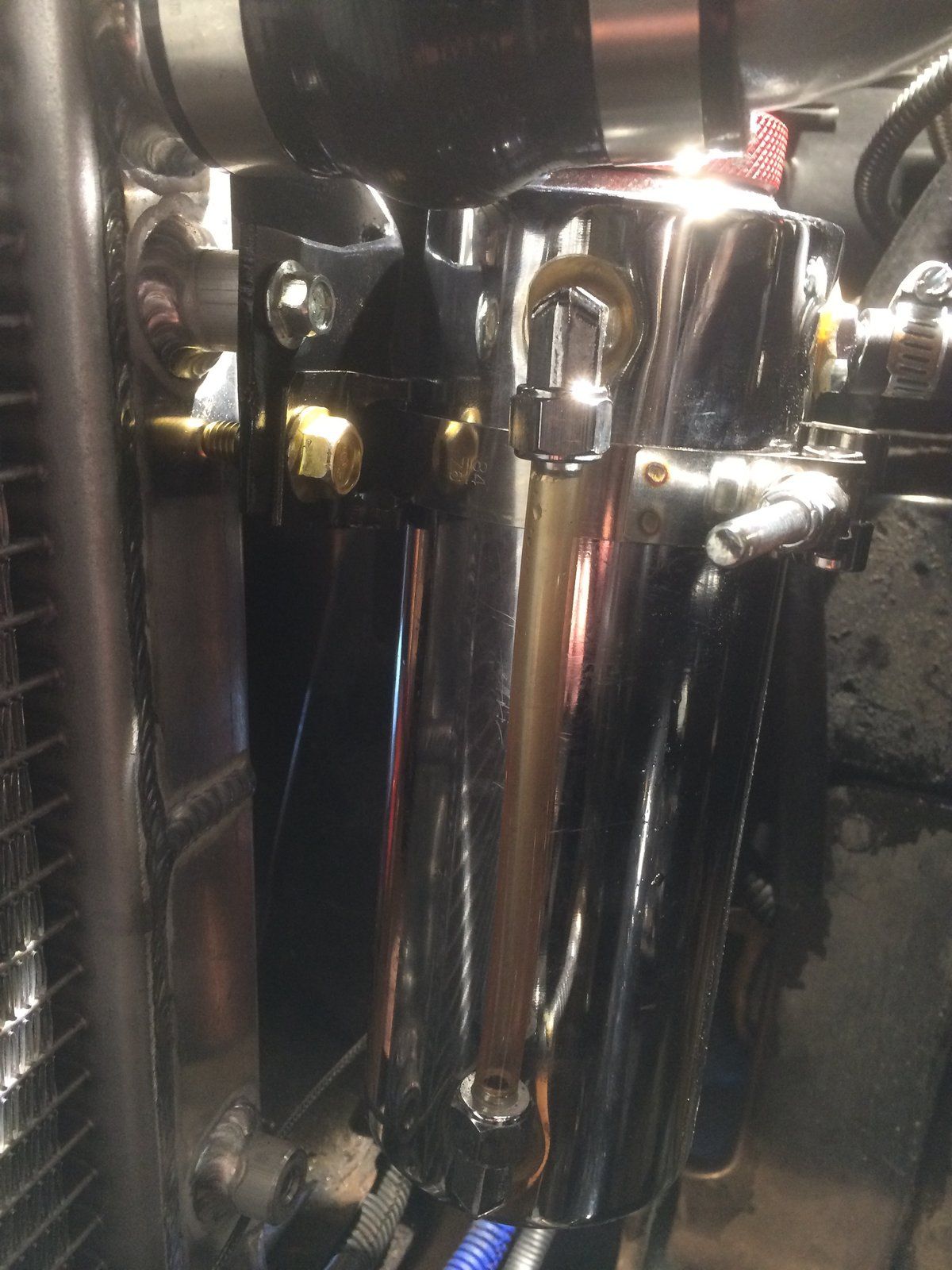

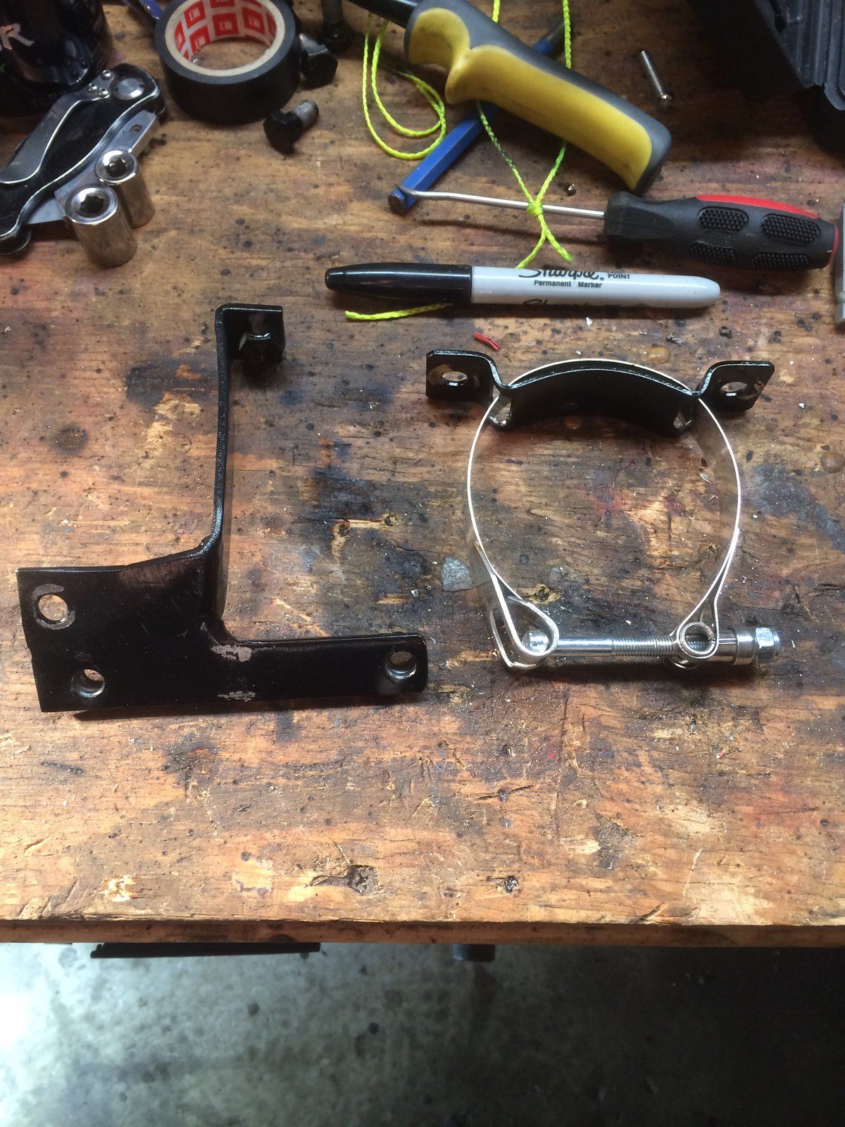

got my coolant overflow tank mounted. I will try and take better pics of the bracket tomorrow as I need to trim that one bolt or get a smaller one so it is not as close to the radiator.
Better pics of the coolant/ radiator bracket.
This bracket is made by Moroso. (P/N 63401)

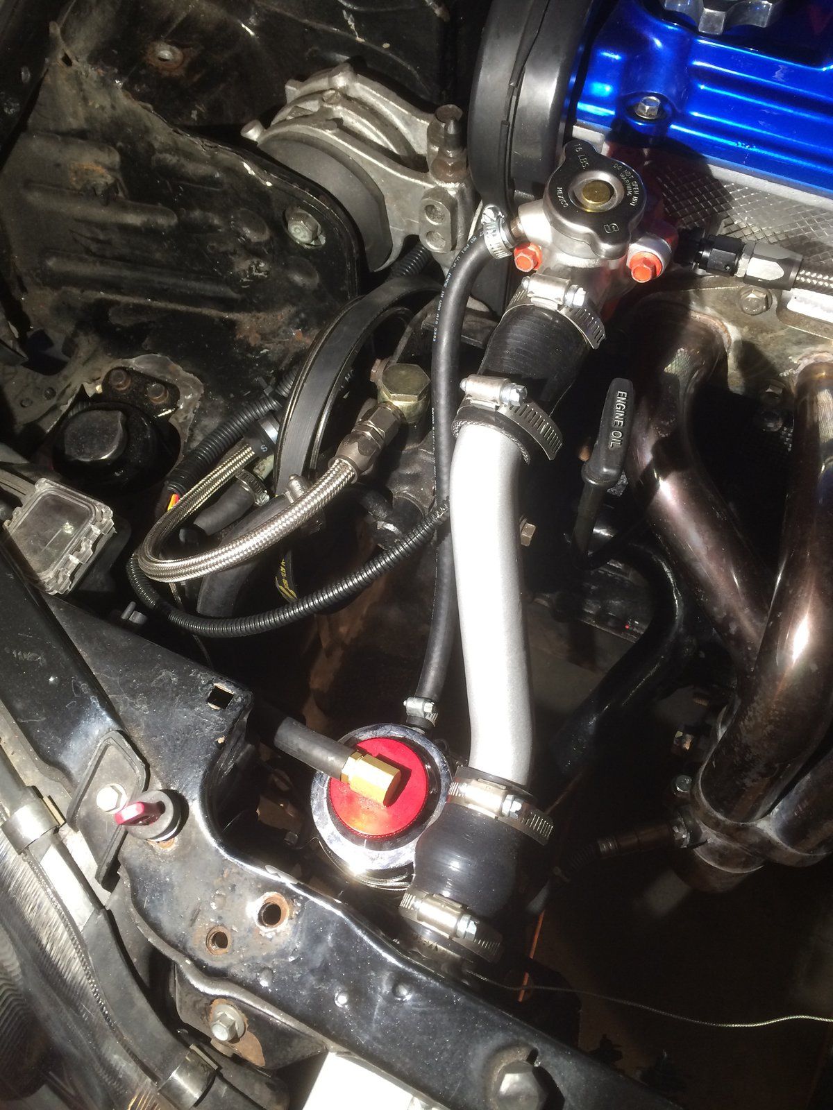

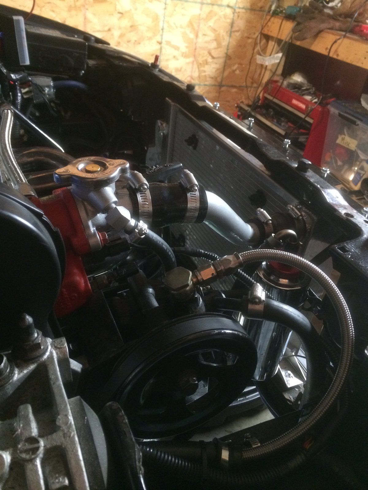

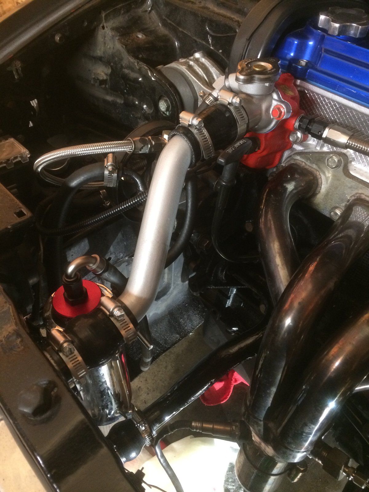

Just finished adding a bulk head fitting with a 150 degree push lock AN fitting to the top of the over flow tank. This makes it easier to open since it is so close to the rad hose. Also added a 45 fitting to the over flow outlet on the thermostat housing. Mainly to help steer the over flow hose away from the PS pump. it still touches it but doesn't lay on it like before. Now I just need to get it back together and fire her up and hope my DIY hoses don't have any leaks!

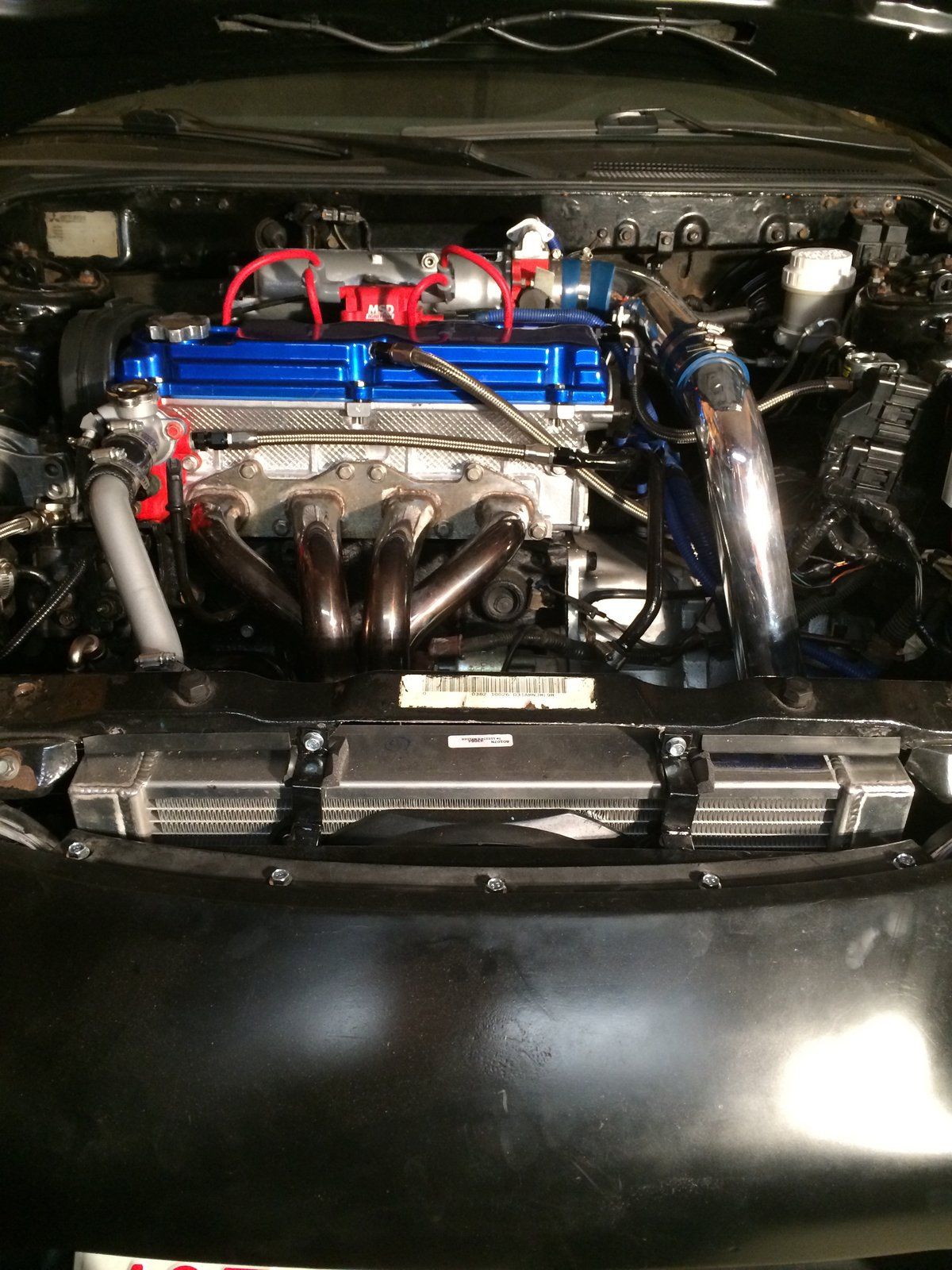

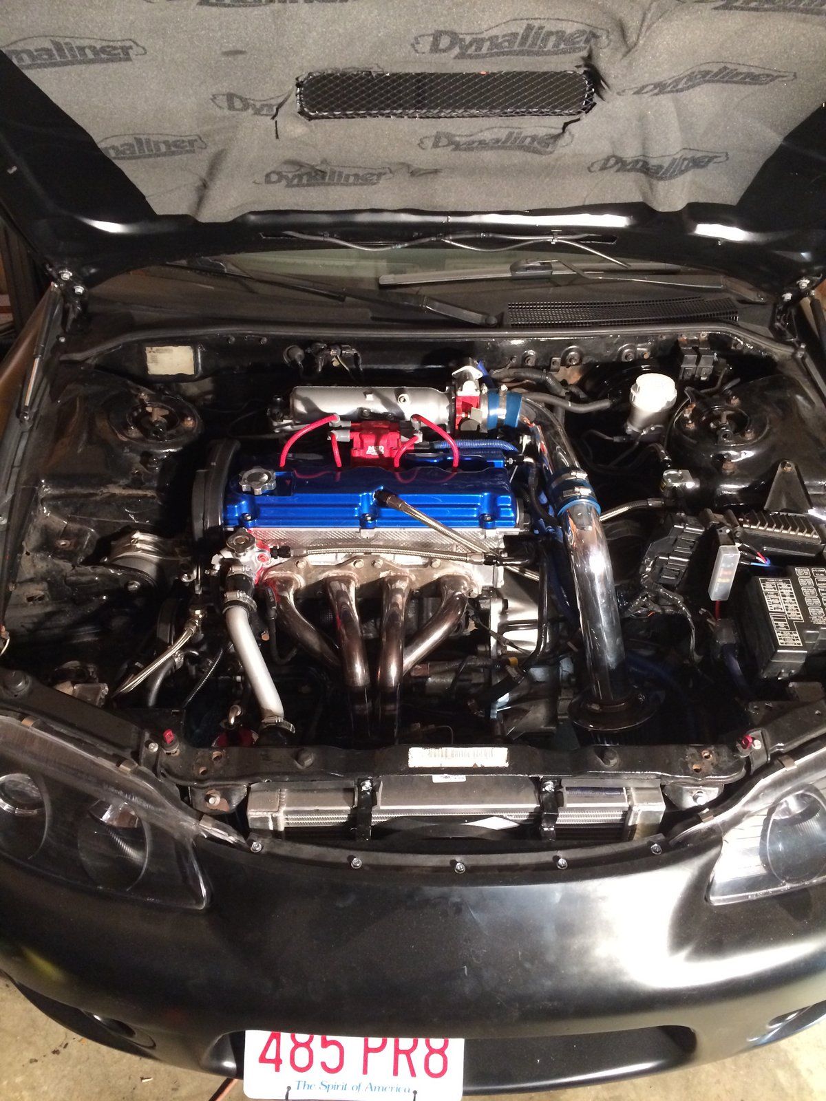

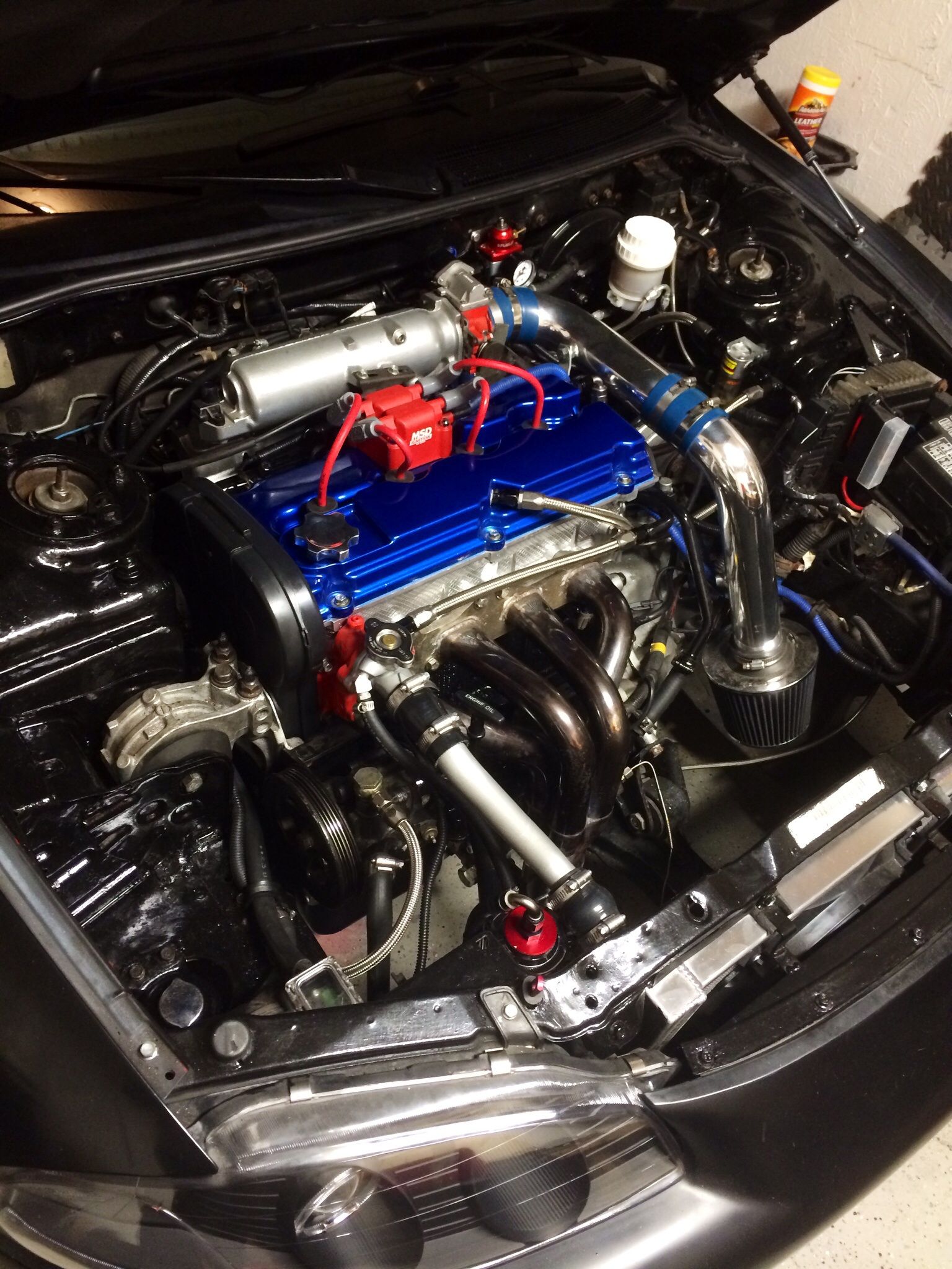

well I got the car all back together and coolant filled up... Zero leaks and it has been a couple days.
Here are a few shots of it back together with the bumper on and everything. Can't wait for the warm weather now!

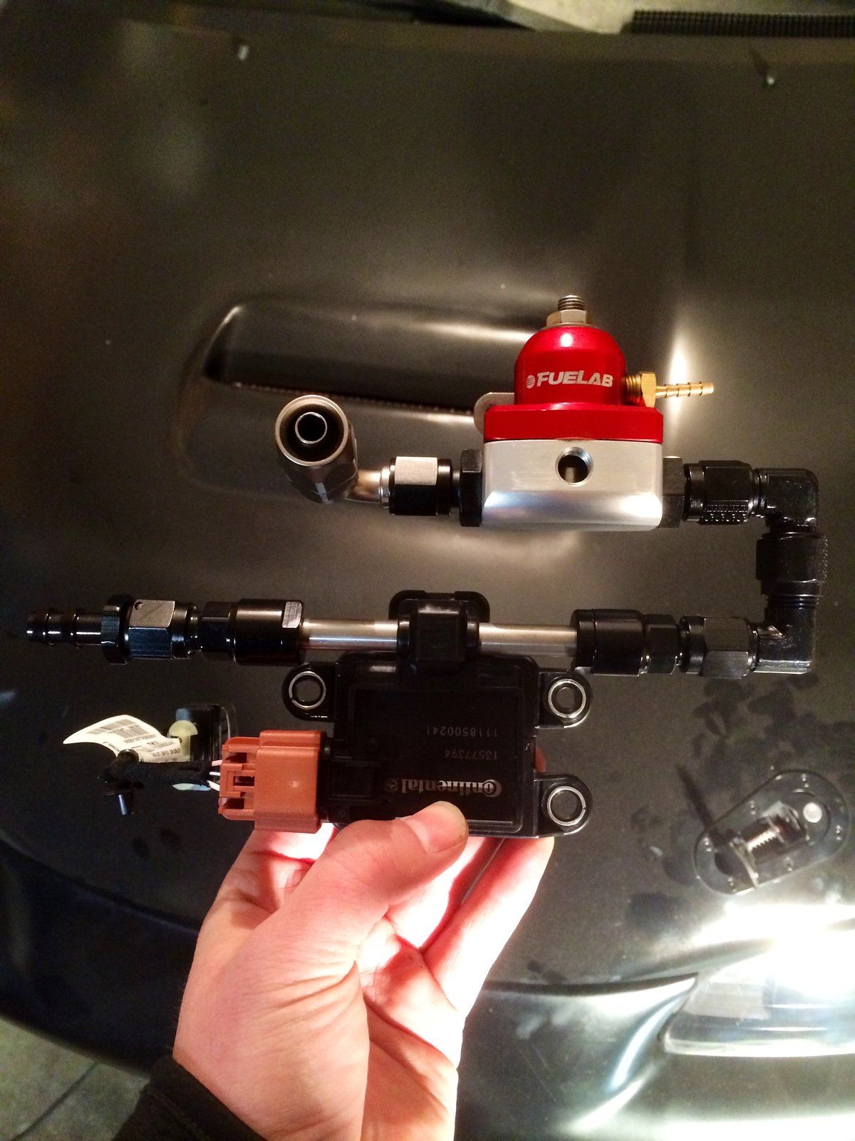

Well since I am moving out to Ohio I figured I would take advantage of the E85 and the MS3X's ability to use GM flex fuel sensors. I will be putting this in after we move. I already have a Wally 255, all the AN fittings and hose along with a fuel rail I modified and then the FPR pictured. I still need to get bigger injector for when I turbo the car but besides that my fuel system is pretty much ready to drop in.

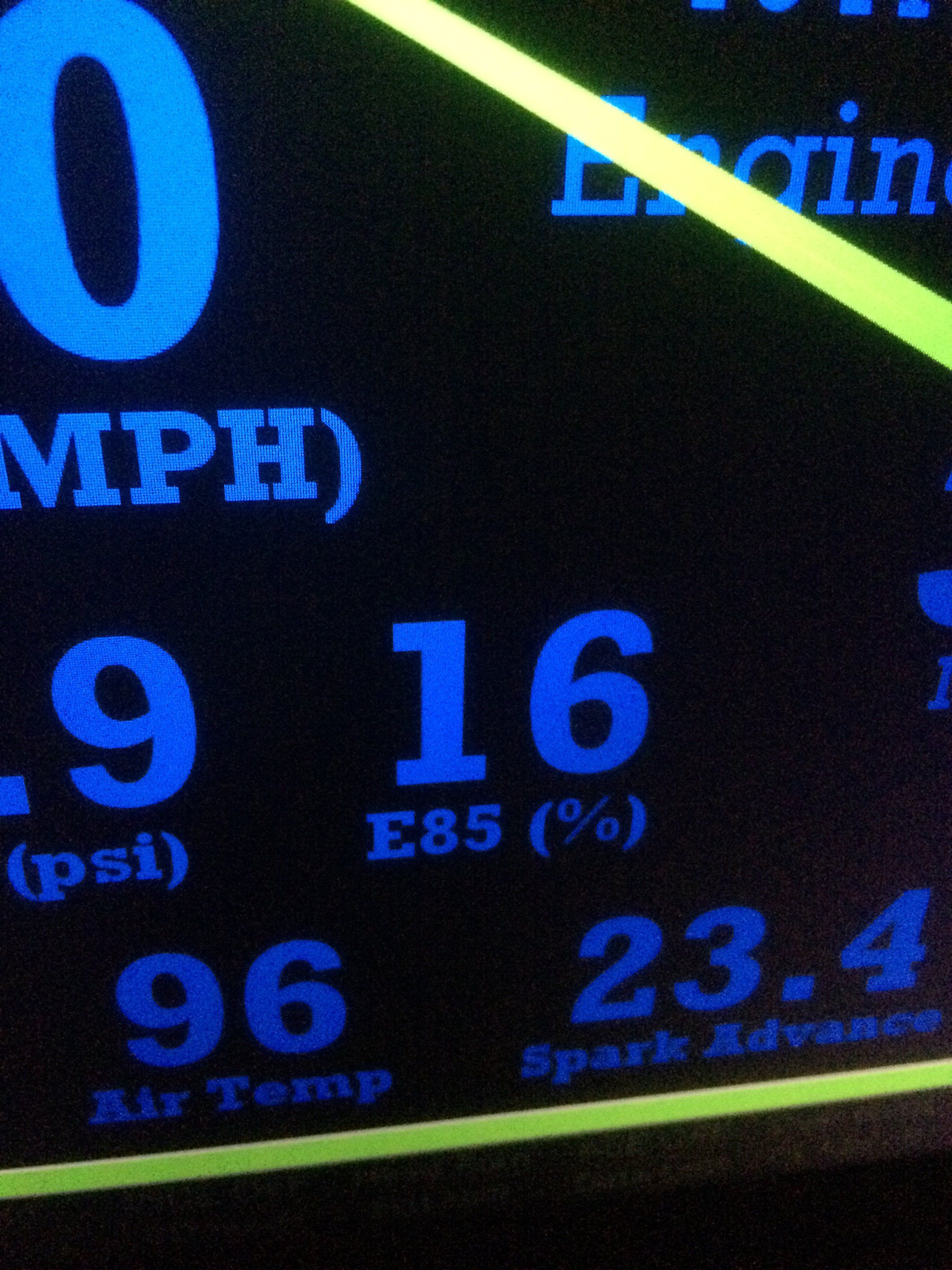

I have a few new pics though of the engine bay paint touched up along with my fuelab fpr. I have a GM ethanol sensor plumbed into the return line. Still need to wire it in and set up the MS but once that's done I will be able to run in flex fuel mode and let Ms make the changes based on ethanol %. I will post up once I get that done. Curious if it will be a noticeable gain on an NA car.
Finished hooking up the ethanol sensor and getting it set up in tunerstudio. Put in a gallon of e85 just to make sure MS would compensate appropriately. All my numbers were rock solid so on to filling the tank up the rest of the way!

Been running higher and higher % of ethanol and I gotta say there is a difference even on a NA car. The highest I have gotten it to is 45% (still running the tank down). Obviously I don't have dyno numbers so it's all butt dyno. The car idles better and is smoother through the RPM range. Definitely an e85 supporter now!

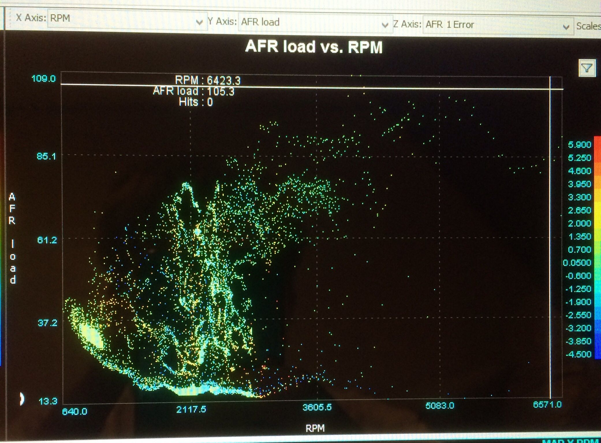

I have been playing around with tunerstudio and megalogviewer more. Megalogviewer is definetly a handy tool! Still learning the ins and outs and what to look for and what graphs are handy etc but here's a quick shot of my drive home from work today.
