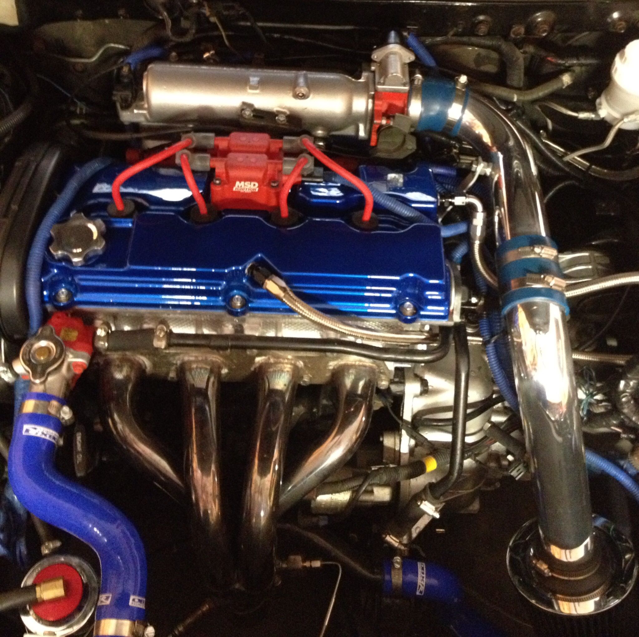

Sorry guys no pics of the valve cover installed. Work has been nuts. Ill try to get it on in the next couple weeks and ill update then. I also have everything for the cop conversion I just need to get it all on and play with the megasquirt settings.

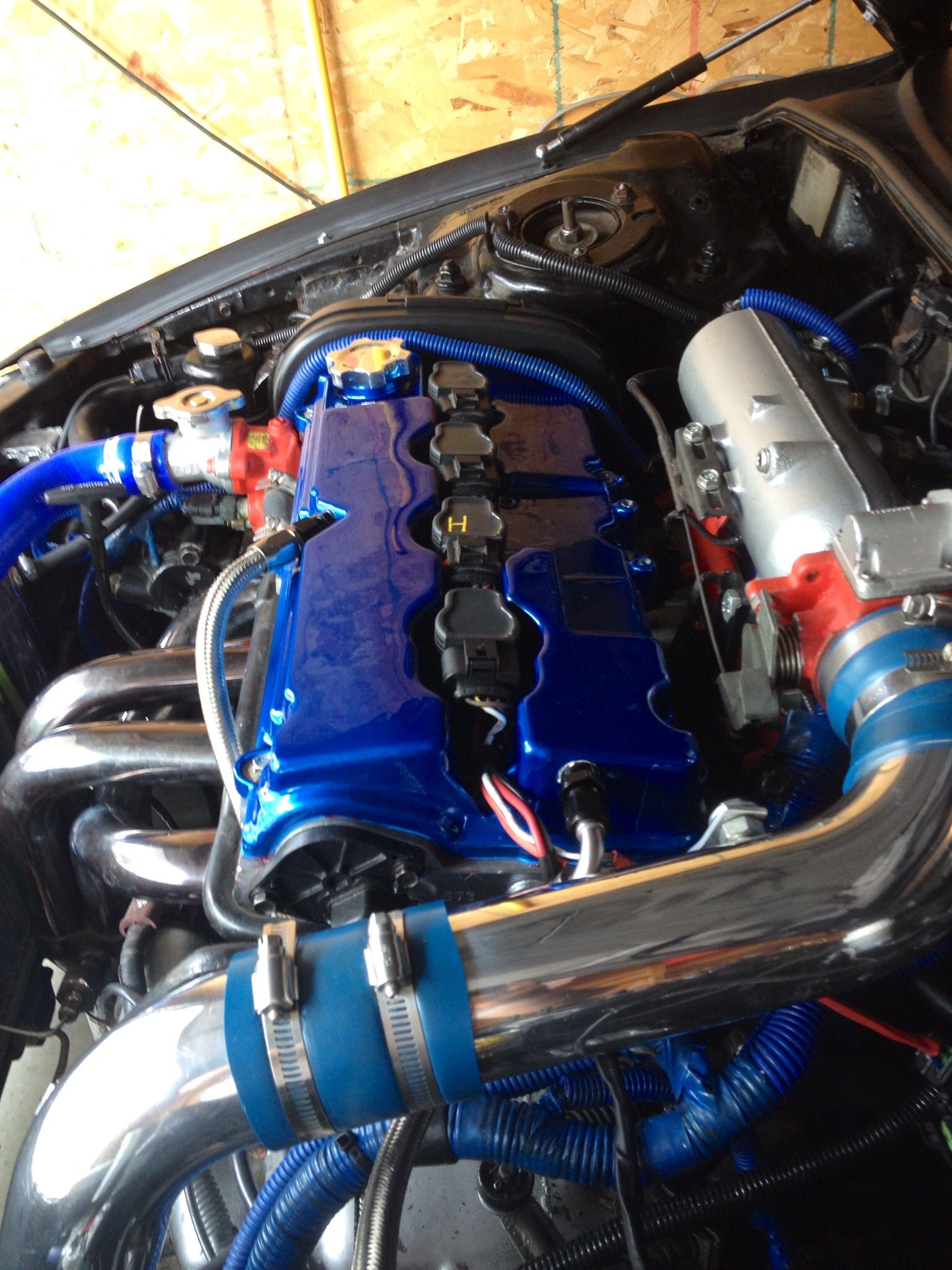

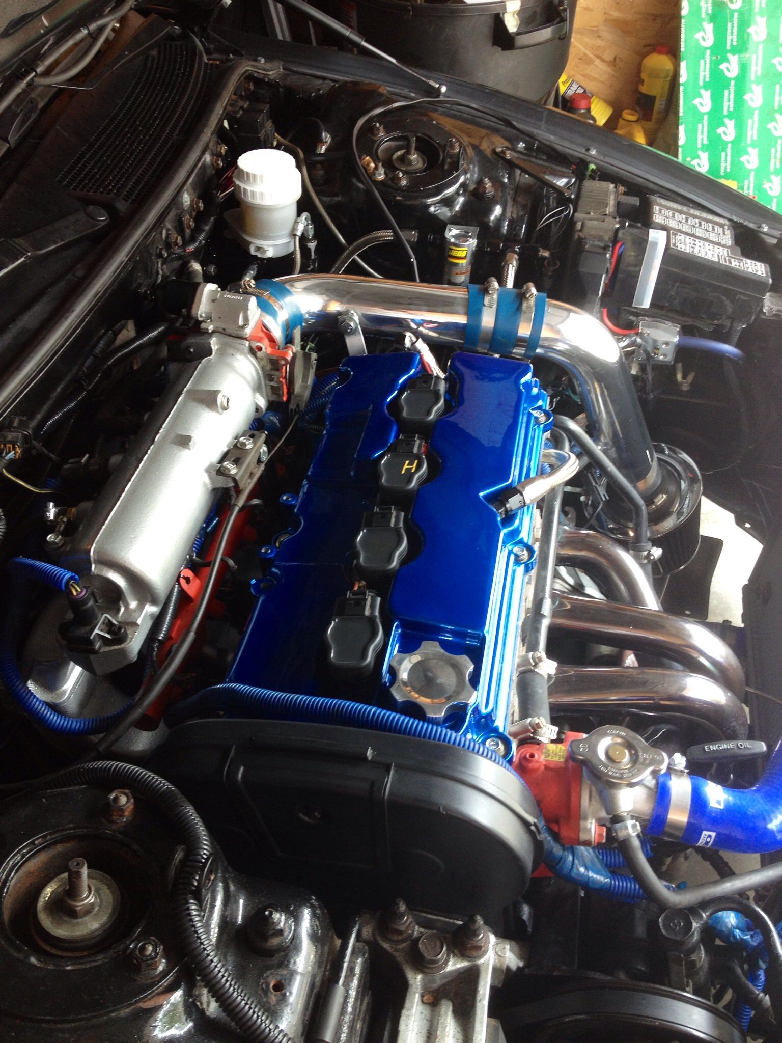

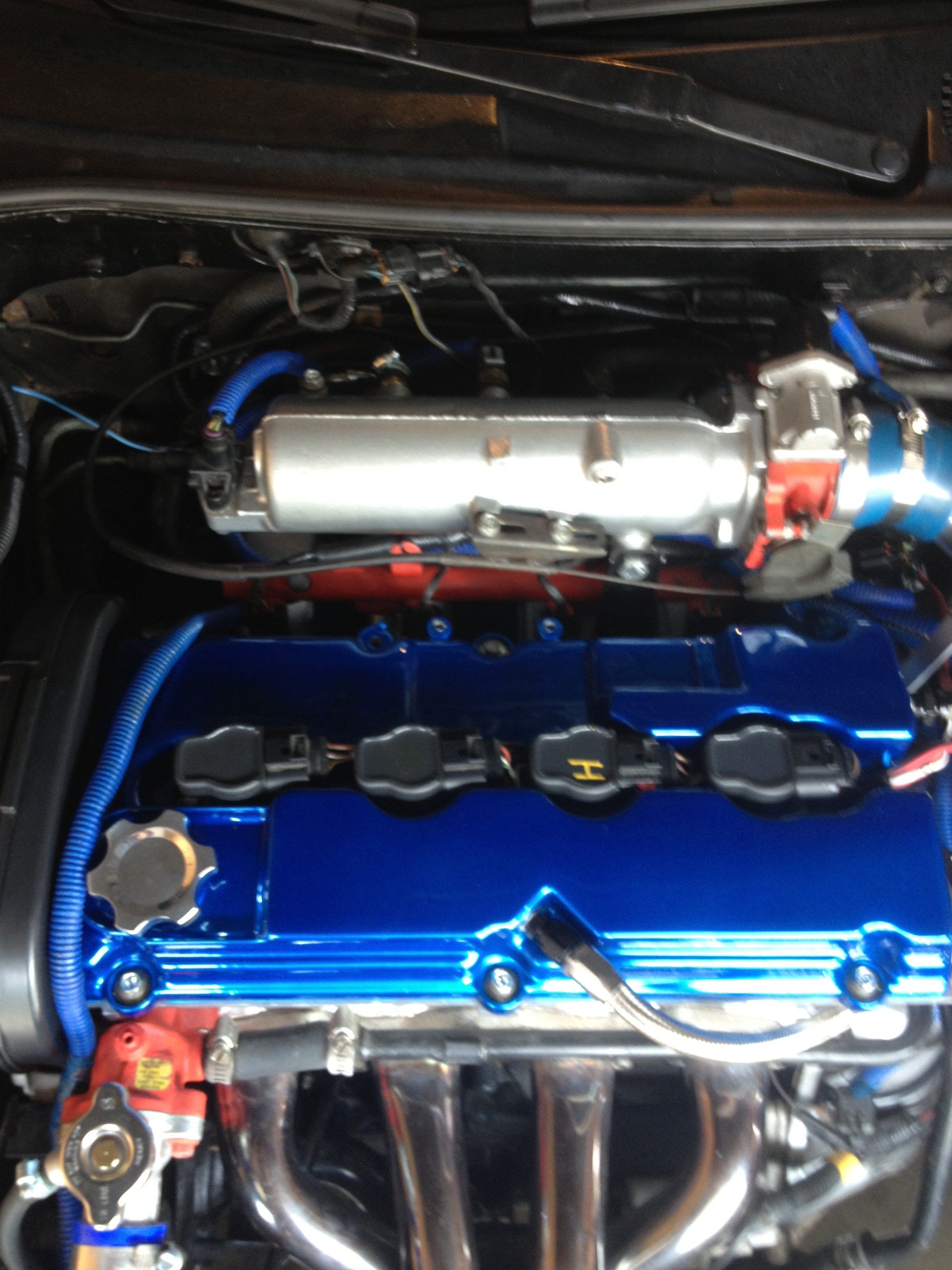

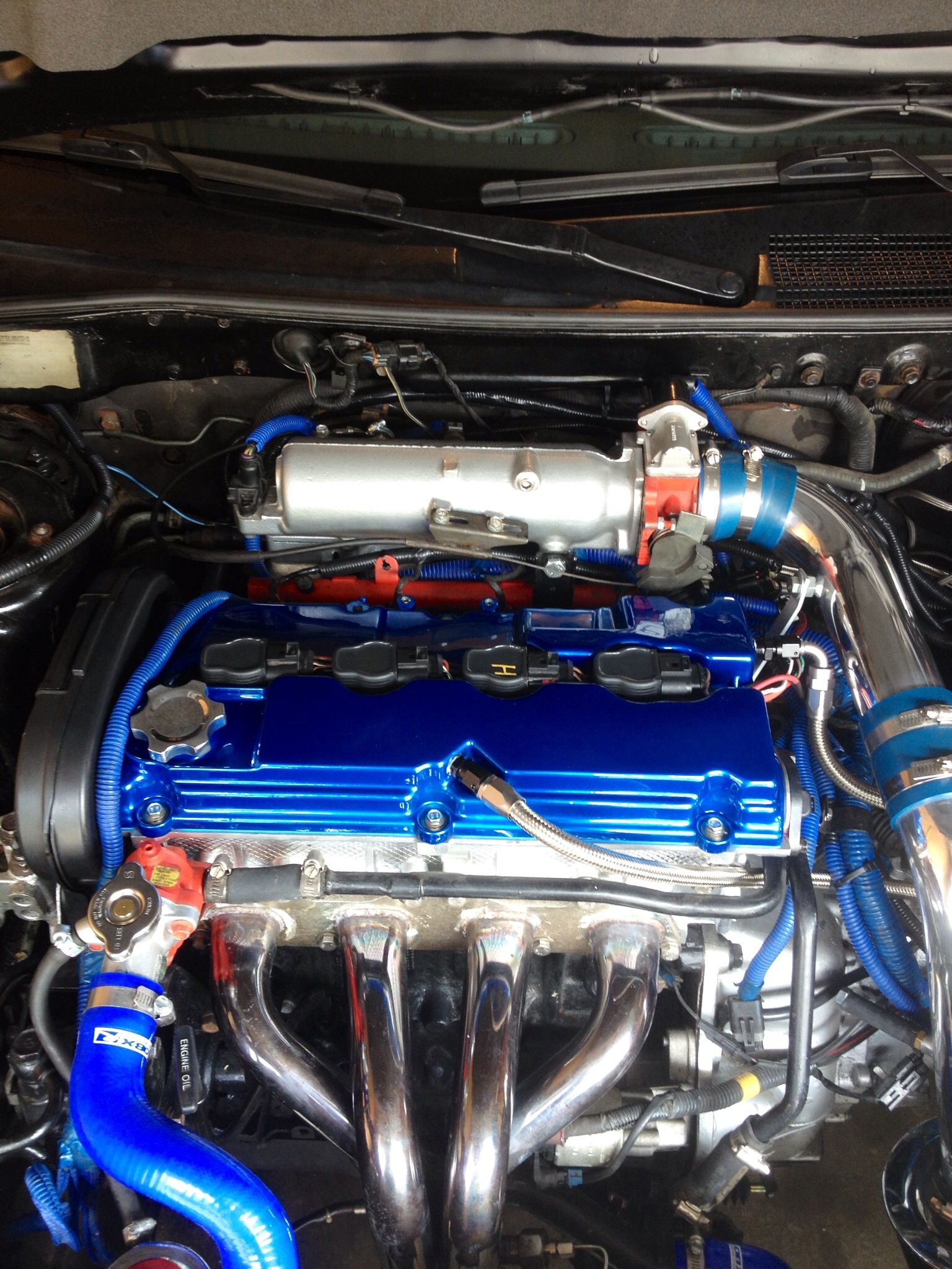

Finally got the valve cover installed. Still need to just finalize the wiring on the Audi coils.

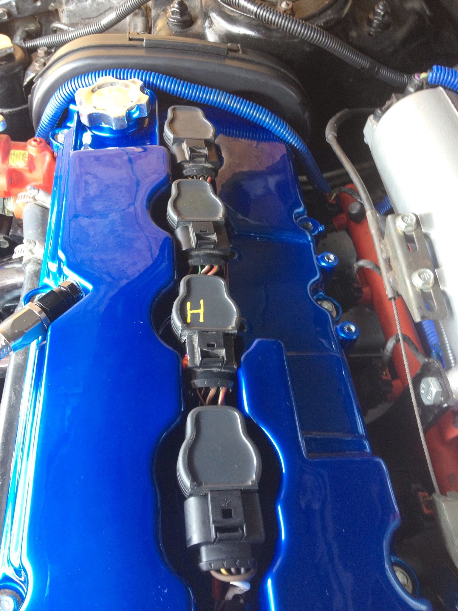

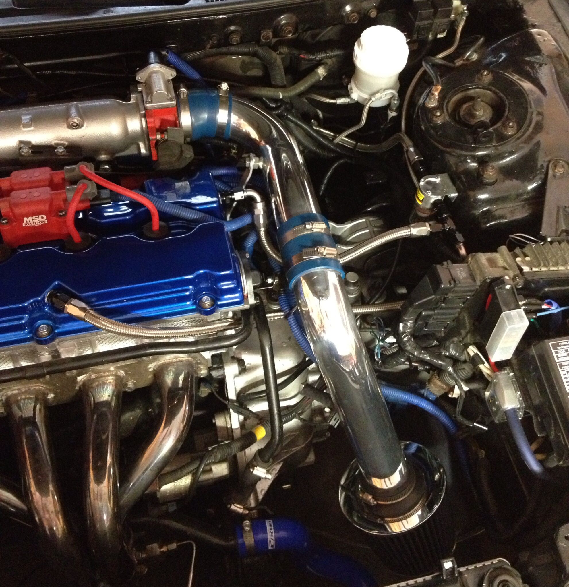

So I finally got around to laying out the wiring for the Audi COP set up. I need to finalize a few more things but I wanted to post up some pics so you all can see how sweet it looks!! The car is still running on the MSD coil pack right now.

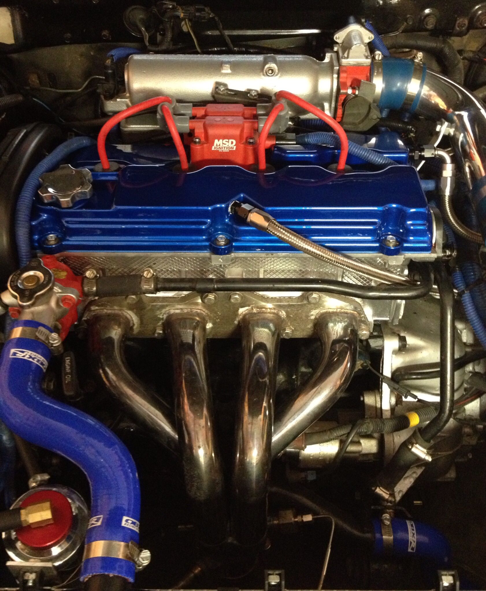

Also what do you have the vent lines for the valve cover going to. I don't see a pcv valve or the line that goes to the intake before the throttle body.
I wouldn't order that from CI motorsports. Either DIYautotune or symtech labs for ms stuff.
The AN lines go to a Jegs air/oil separator then the line into the intake goes where the egr used to go. The check valve is inline. I am having touble finding an AN pcv valve so I hid the ugly worm gear clamps and valve beind some wiring.

With your coil set up using MS3 are you using the quadspark ignition module. How do you have your coils wired? If you don't mind.
