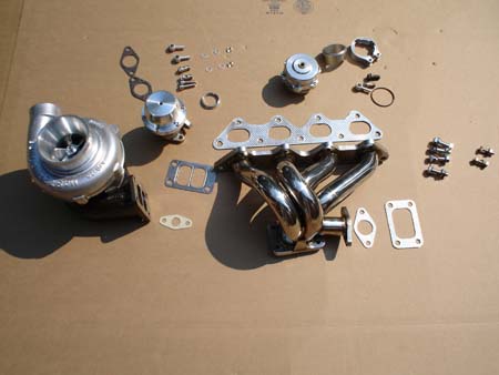

Even if the turbo is good, it seems like everything else is junk. I have seen many cracked manifolds, and if anything else has the quality of the manifold you will find yourself spending all of the money on just a turbo.

To be fare as soon as I see stuff from SSAutochrome the images of junk just come to mind. Their stuff really is garbage, thought that turbo isn't bad, the fact they rip off Tial WG and BOV and use those crappy ass OBX manifolds kills it for me.

stupid ass OBX turbo turbo manifold with thin tubing.
Alright correct me if im wrong here but, isnt that manifold a DNP manifold??? Compared to the one on ebay it looks the same to me and the last time i checked DNP makes a kickass header :talon:

Hahahah no thats not a DNP manifold. Not even close. Just because they are both polished do not confuse the two together. This is what the manifold looks like...
http://92civic.tripod.com
This is just the honda version but it's the exact same build from the exact same company ssautochrome with exactly the same parts, just for a honda instead of a talon. I know the guy who owns that car and made that site. I have seen that manifold myself in person and it acctually looks worse in person honestly...

Thats not the one pictured in the auction :talon:
SpoolnTsi said:
No they are not the same. I dont understand why it si so hard to believe that if a company is selling a fake Tial BOV and WG plus a cheap turbo that they would throw in a DNP header. That header is 500.00 buy it self so how would you get all that stuff for that price. If you look at the picture you can answer your own question.
Thats doesnt look like that the one in the autcion.
http://www.stockreco.com/DSC00066.JPG
They look very similar in the pics. Once thing I didnt notice different on the DNP is that the runners arent one piece but pieces welded together. While the ebay one is all one mandrel bent piece. And the dnp doesnt have the mount for the external waste gate.

Obviously you didnt scroll down thru the link that i have posted. Try scrolling down towards the bottom of the link this time and then repost.
http://www.dnperformance.com/eclipse.html
I know the one has the external wg flange but you can get both manifolds with or without the wg flange :talon:
I saw that one too and they are not the same. :mad:
That is not the same as this one. Get over it.
They dont even have the same exact shape. Either way why would a 750.00 dollar turbo kit come with a 500.00 dollar manifold? You have yet to answer that just just keep commenting about some lame ass manifold that looks similar to a high qaulity piece. If it was a DNP then they would advertise that so that people knew they are getting a quality part. This is thread is fu(king dumb. If you like this package so much then buy it and see how long it last.

Sorry I have had a VERY long day. I though you were saying they were the same not asking. I did however along with Jim say that they ARE NOT the same. The one in the auction is a POS and will not last long. The DNP is a very nice product and should last along time.
Oh for the love of GOD!!! NOOOOO IT IS NOT A DNP HEADER. It's a piece of shit OBX header JUST LIKE THE ONE IN THAT WEBSITE I posted. Yes the one in that site is for a Honda, but it's from the same company and the same design/construction. If you buy that kit the header will be of the EXACT SAME QUALITY. I think SSAutochrome makes the header themselves now but its a rip off of OBX's design and they are made in Taiwan. A company I deal with uses many of the same factories for their exhaust components and we have seen their headers being made. They are very cheap construction and total pieces of shit.

Thanx for clearing that up for me Jim and boostedinaz. That always bugged the hell outa me whether they were the same headers or not cuz they are so similar. I can see the differences in the quality now that you guys pointed it out. Not that you couldnt find a new item on ebay that actually isnt a piece of shit or anything but its rare to do so. Oh and i would never buy that kit off of there either :thumb: :talon:
yea those bov's are fake as well as the wastegates, the manifolds arent even made by obx, they are copies of that, and i hear the turbos are 270 degree bearing housing, they make shit and everyone hates on them.

But seriously, what if you got the exhaust manifold cryo-treated like someone suggested, would that help much?
and got the welds beefed up?
It has nothing to do with the welds, the welding is TIG and is pretty good. One thing they can do in Taiwan is weld really well. The problem is the tubing the manifold is made from is about 1/3 of the thickness that it needs to be. Adding weld to the manifold will not improve its strength or reiability. It's just too thin regardless of what you do.
