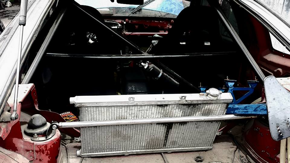

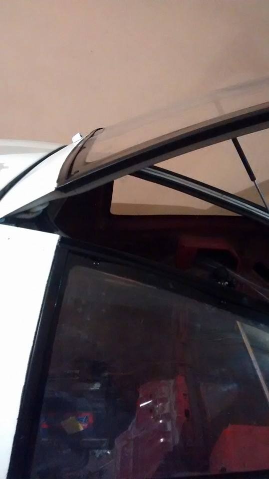

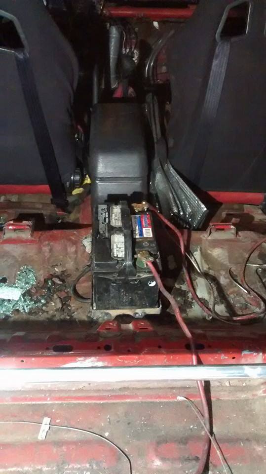

Testing the new proportioning valve, battery relocated to rear seats, lexan windows. Now the handling is less nervous :D.

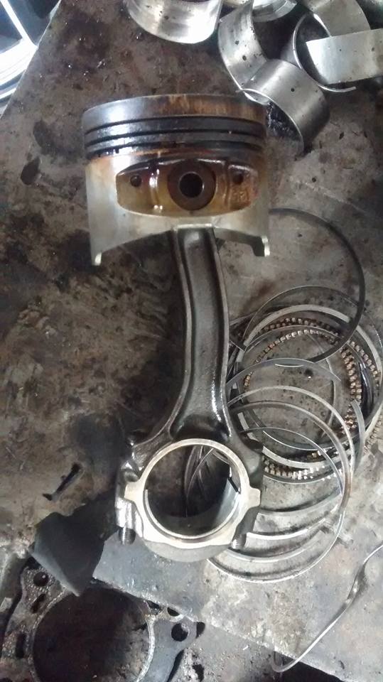

-Bad news is that the engine is dead.... hidrolock....

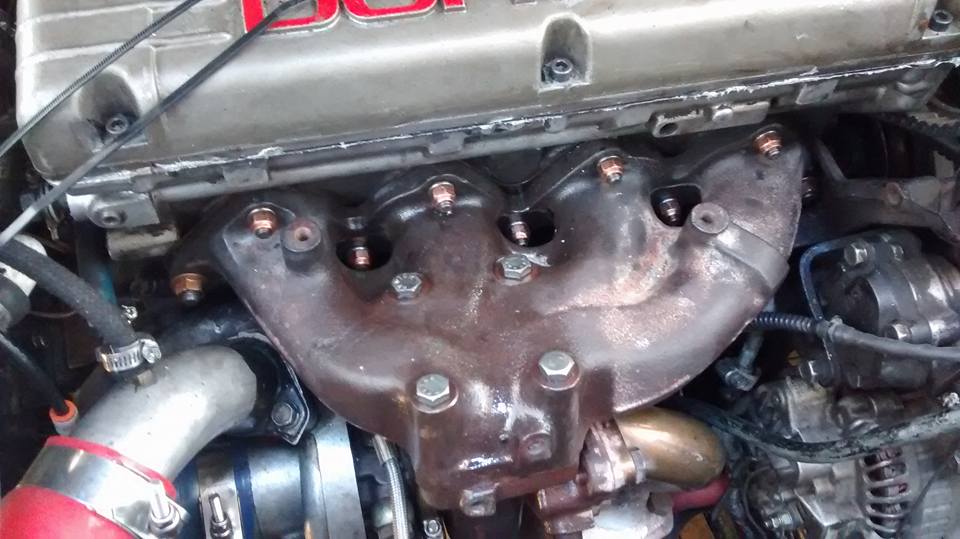

I went to work and i heard like exhaust leaks. And ended being striped threads, so a couple of beers (8 beers eeek), and a lot of patience, and she is running again.

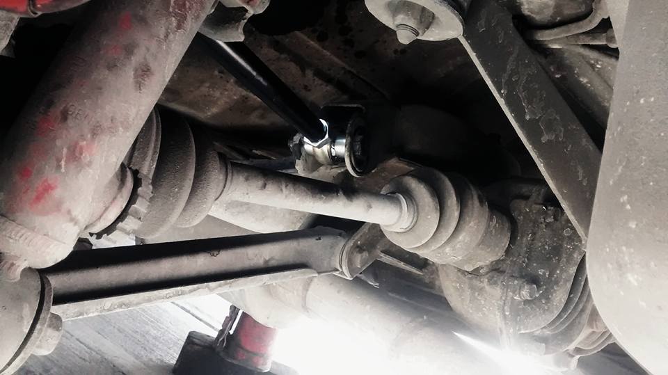

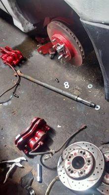

Some rear bars where installed to adjust that camber. As easy as the fronts.

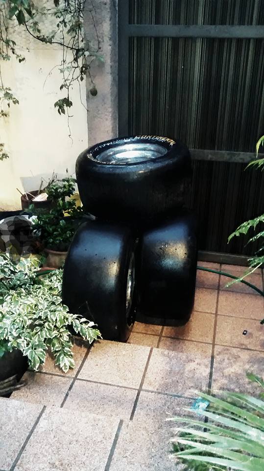

From years ago i was thinking about that used slicks they sell locally from the races hosted at the Nascar Oval. 205/60/13, 245/40/18, 26.5x6x15 (rare), 27x10x15, 27.5x10x15 are the common sizes.
18's are rare (because they are good for almost every car), 13's are small and narrow, 15's are the cheapest and most available slick they have. The issue, is that they are big and wide.
Its been discussed in the past that nascar tires are too much tire for our cars, but for the money i just can let pass this time. Its 96 bucks for a set of 4 slicks.
I hope there is enough rubber....

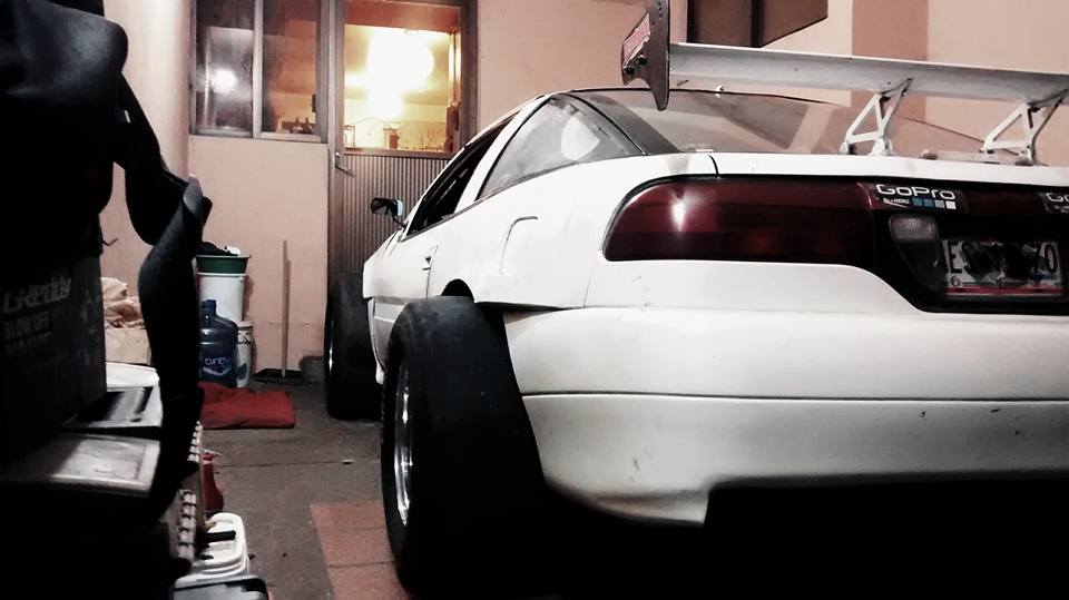

This slick thing is really happening. So..

So i coming to the conclusion. The slicks are getting flatspoted for rest all the weekend installed on the car.
This is new to me.... but seems is very common and everyone knows about it WTF!!

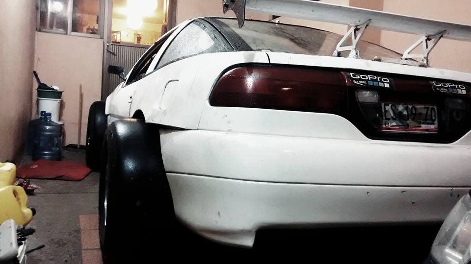

The suspension ha been dialed in, she is strong on curves but slow and boring on straights.

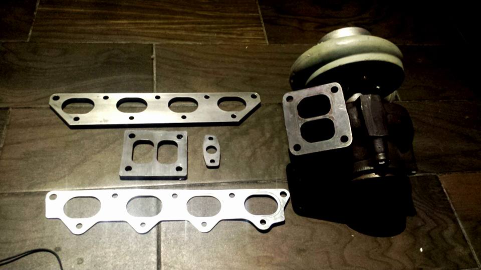

The little 16g turbo is not flowing anymore reliably so i'm planing to make a turbo change. I'm going slow on this because time is tight and i'm focusing more on aero and drivability. But i started with the simple things:
