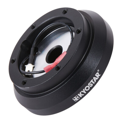

You simply unplug it and remove it after taking off the 4 screws holding it in place.
Then you get a hub adapter. Here’s the one I used:
yeah I did the same. there is a write up on here on how to get the horn to work. I also used the kyostar adapter but had to use a washer underneath tge mounting bolt to fully bolt the adapter on all the way. there was a tiny bit of wiggle that bugged me.
also without a quick release adapter or spacer the horn button will not fit over the center bolt
