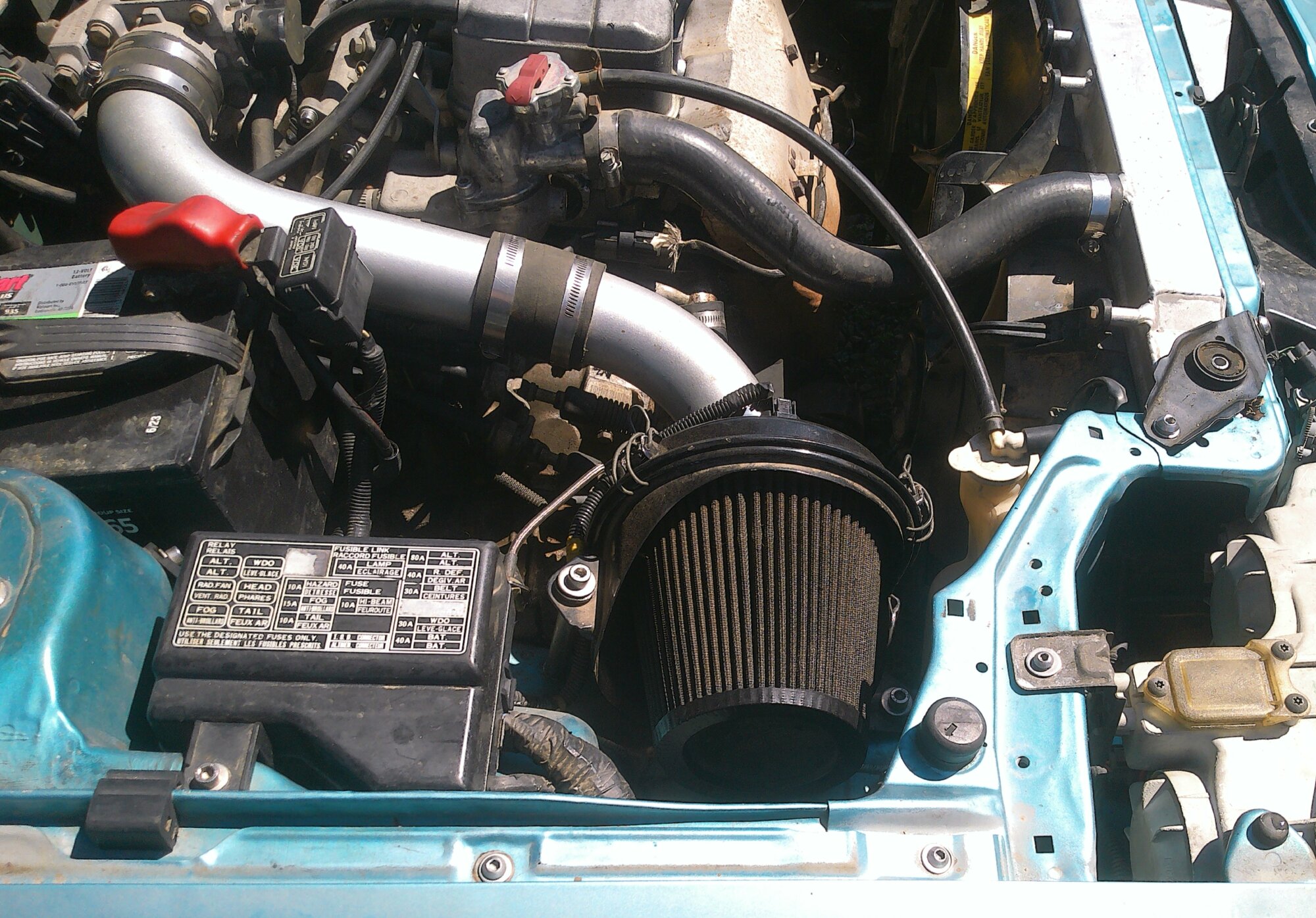

Had a spare turbo car aluminum radiator layin around so I pulled the dinky stocker and slapped that in along w/new radiator, heater and TB hoses.

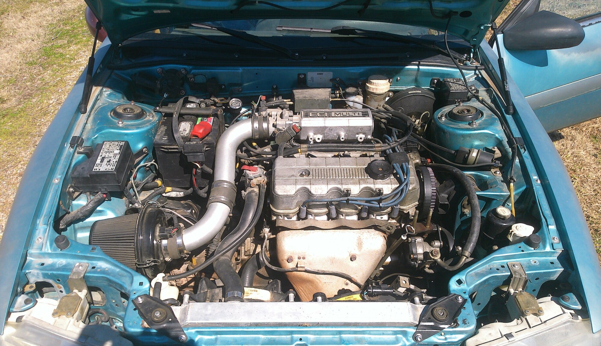

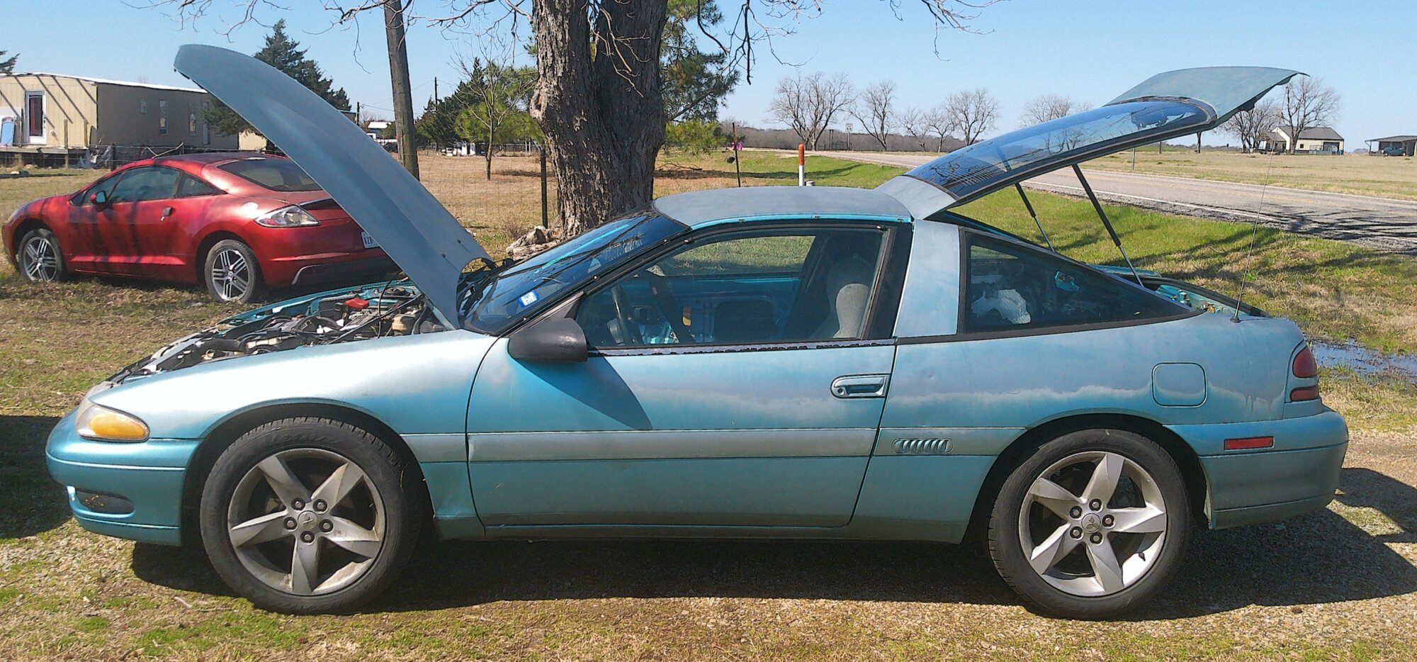

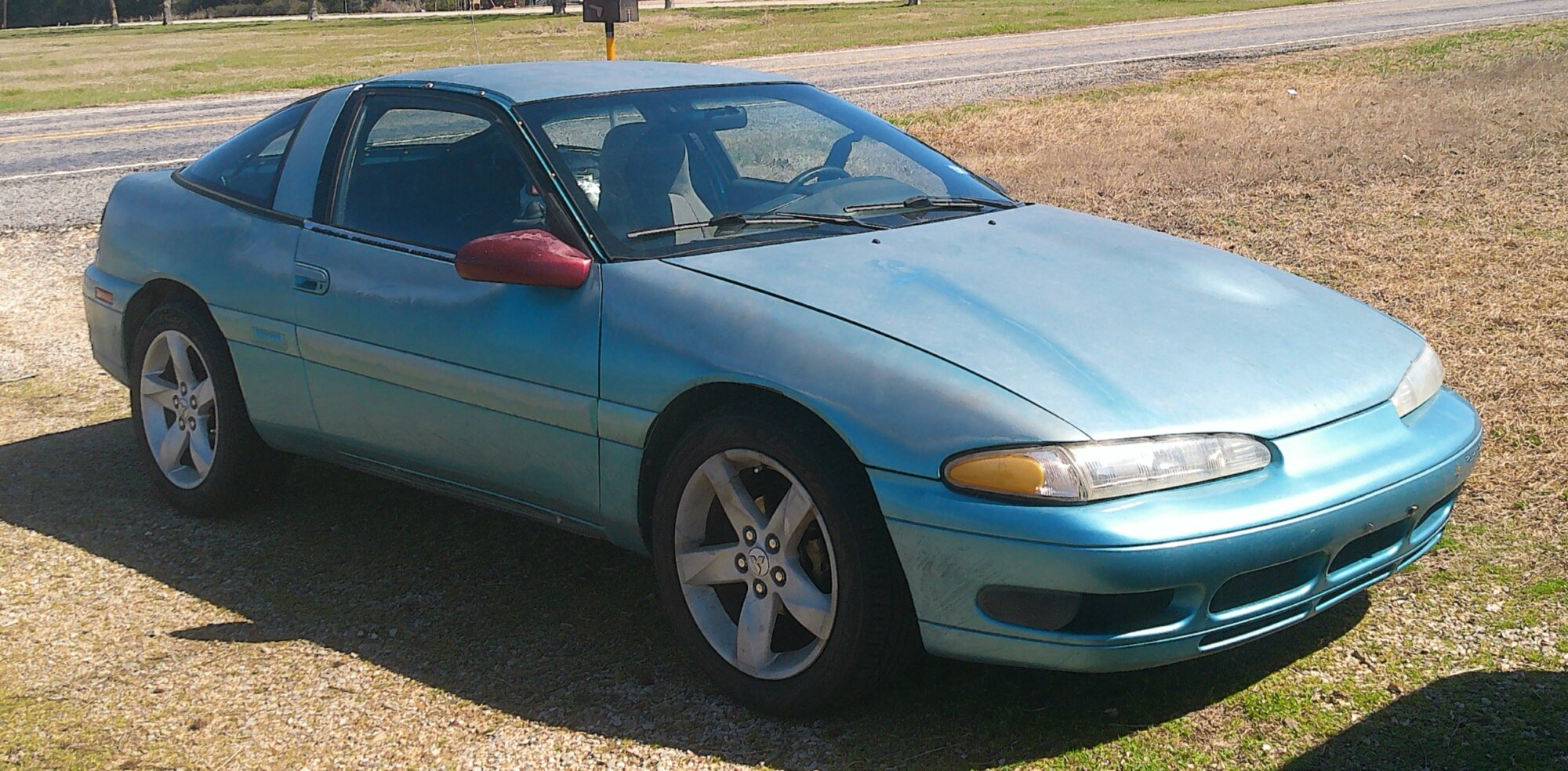

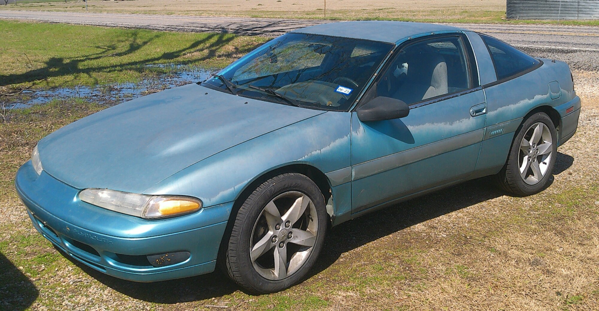

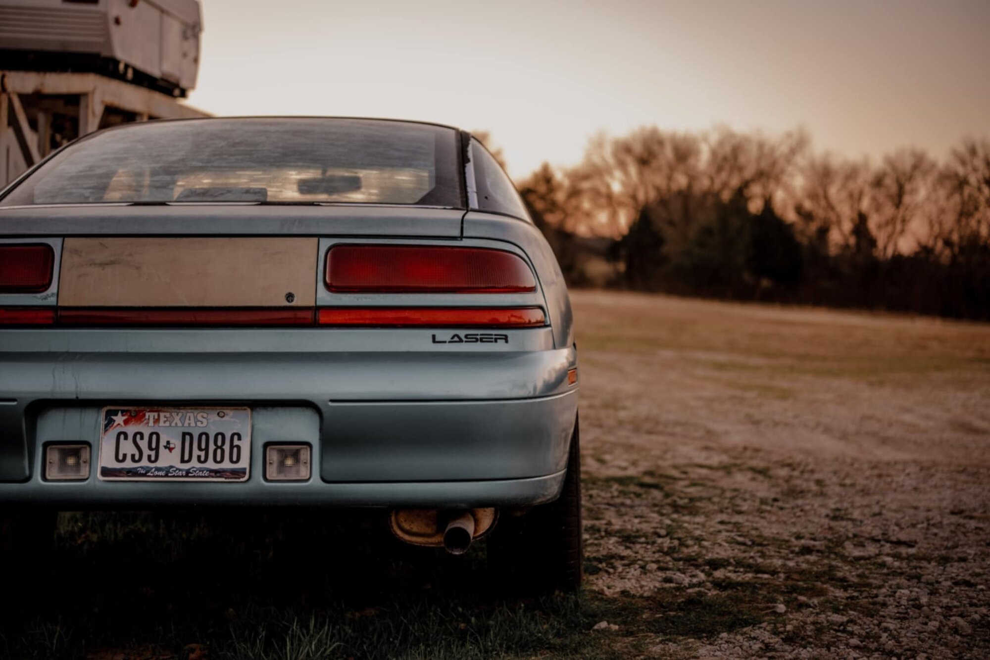

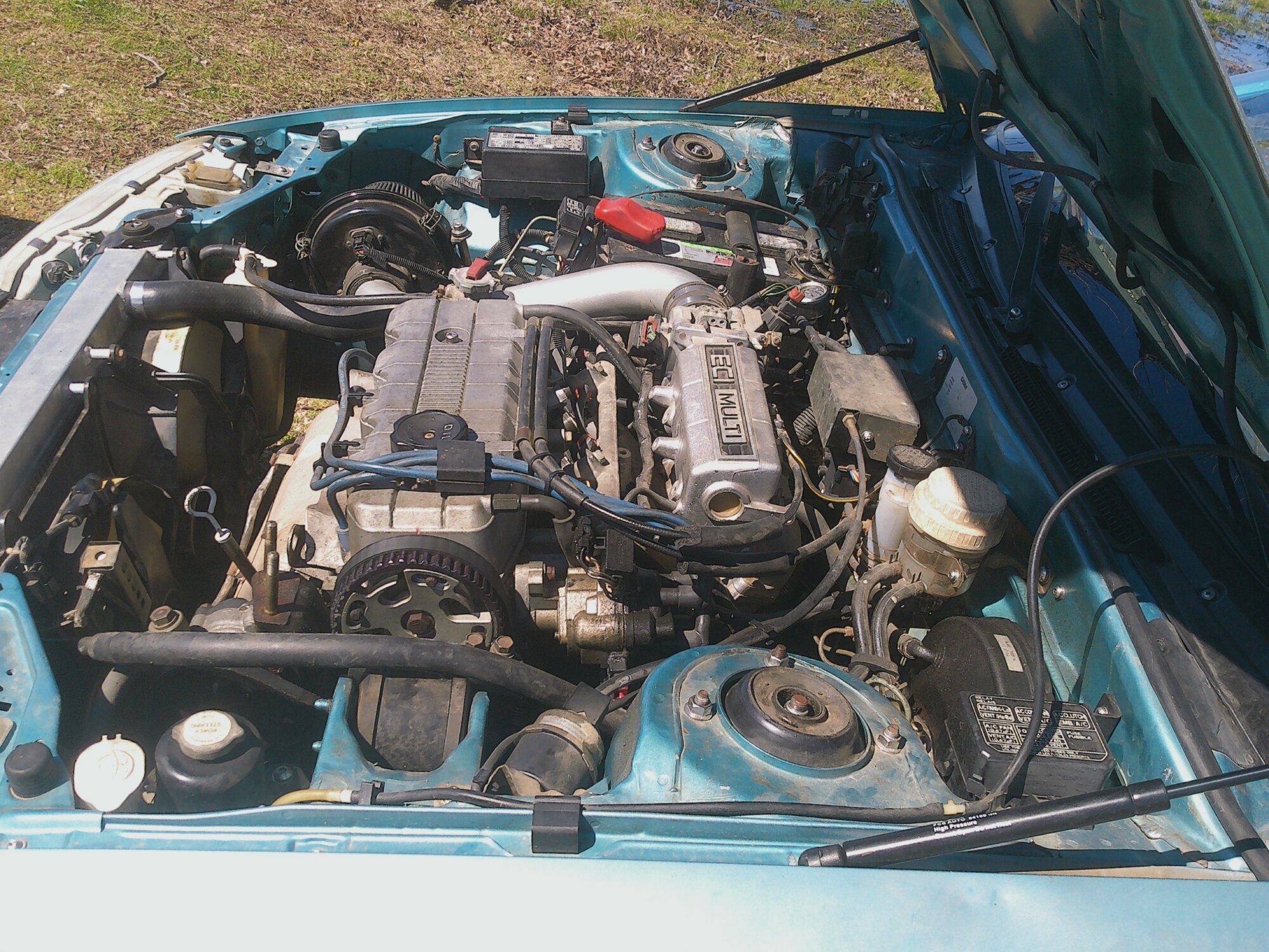

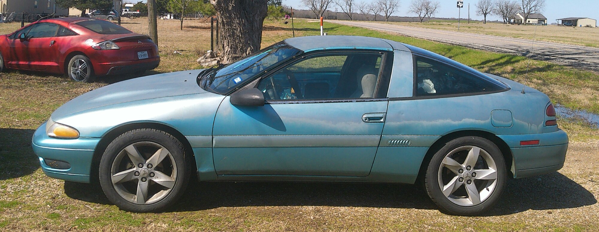

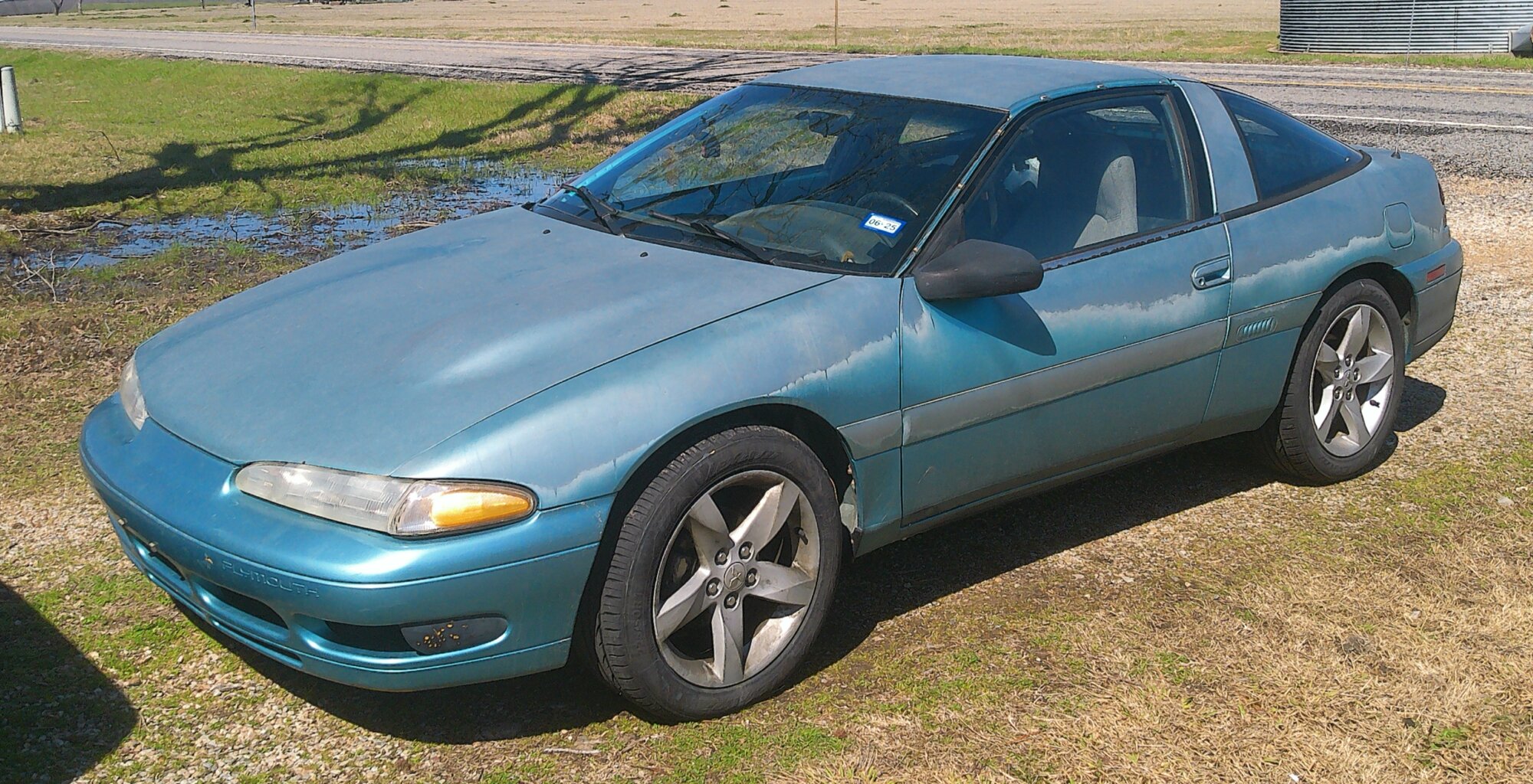

Nice and sunny today so I took some pics of my sun faded baby. As you can see in some of the pics I'm a big fan of allen bolts and have replaced most of the engine bay fasteners with stainless steel button heads, washers and nuts where possible. You'll also see I replaced the always in the way hood prop rod with struts which has come to be one of my favorite mods.
The body shows no signs of ever having been in an accident and is in great shape with only a few small door dings and a small dent in the lower drivers fender.
Had the windshield replaced which is why the A pillar and roof trim is missing since it was removed before the windshield was installed and it along with all the other external black trim will eventually removed and powdercoated.
Those with a discerning eye will note it looks like 1/2 the timing belt is gone but it just looks that way since I stuck a spare 4g63 pulley on it when I re-did the timing belt.
After having spent a cuppla years parked too close to a cedar tree the windshield cowl and wiper arms were rusted up so they got sand blasted and shot w/VHT primer and satin black polyurethane wheel paint. Some very durable paint for anything external.

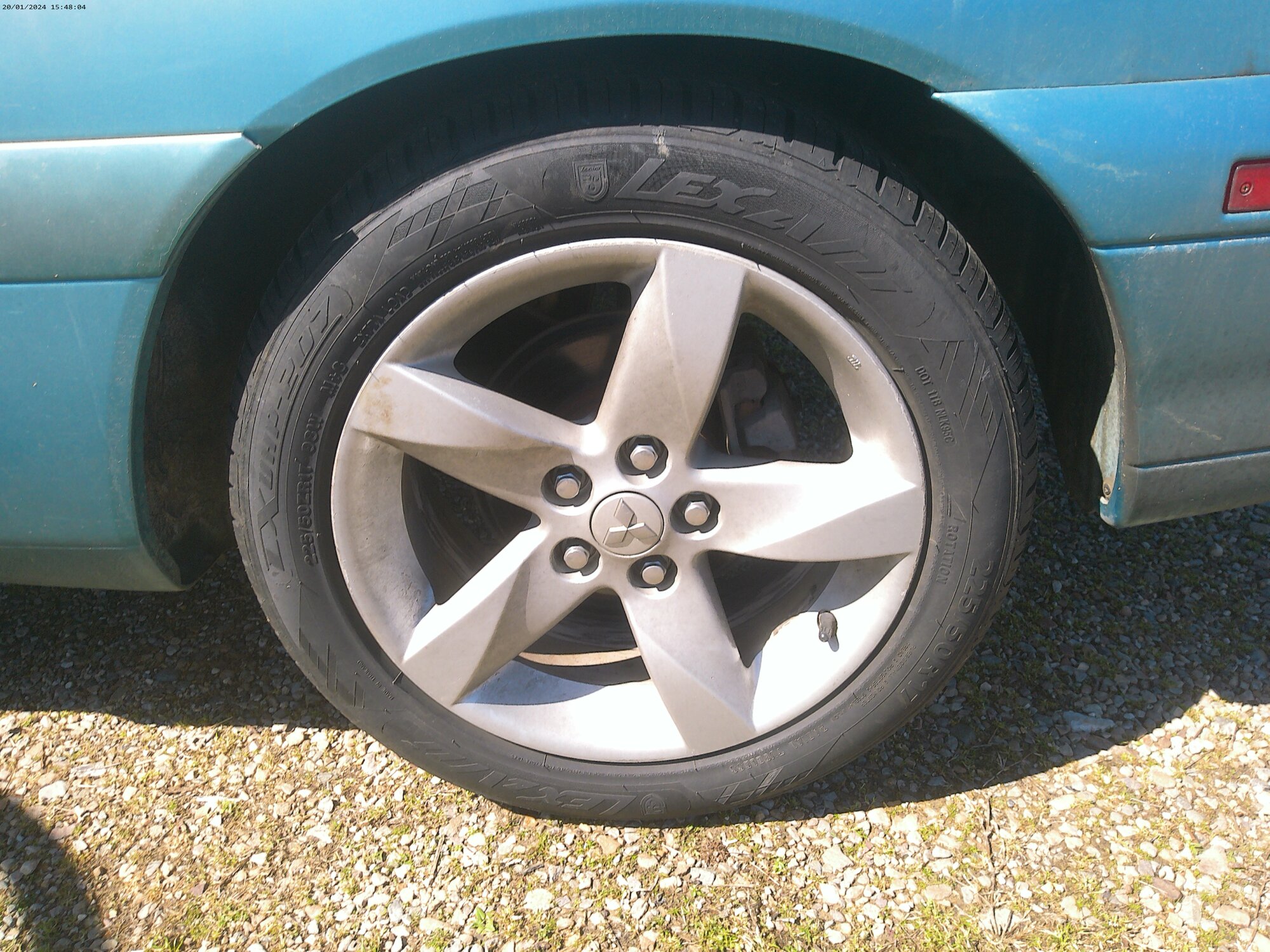

The wheels are stockers off my 07 Eclipse, which I replaced w/some old American Racing wheels I've had, well, forever. Went with some 225-50-17s and they fill the wheel wells just right. There's less than a fingers clearance between the back of the tire and the struts and if I wanted to go with anything wider it'd require fender flares, so they're just about right ;>)

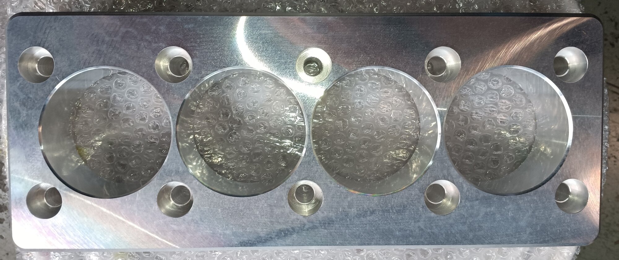

My plans for the car include a complete g4cs Hyundai 2.4 block w/10:1 Wisecos, 2G ported head w/some +2mm valves, a short ram intake manifold, lightened crank, 1G FWDt tranny and a long list of other goodies. Got waay too many trick parts just sittin in boxes that need a home.

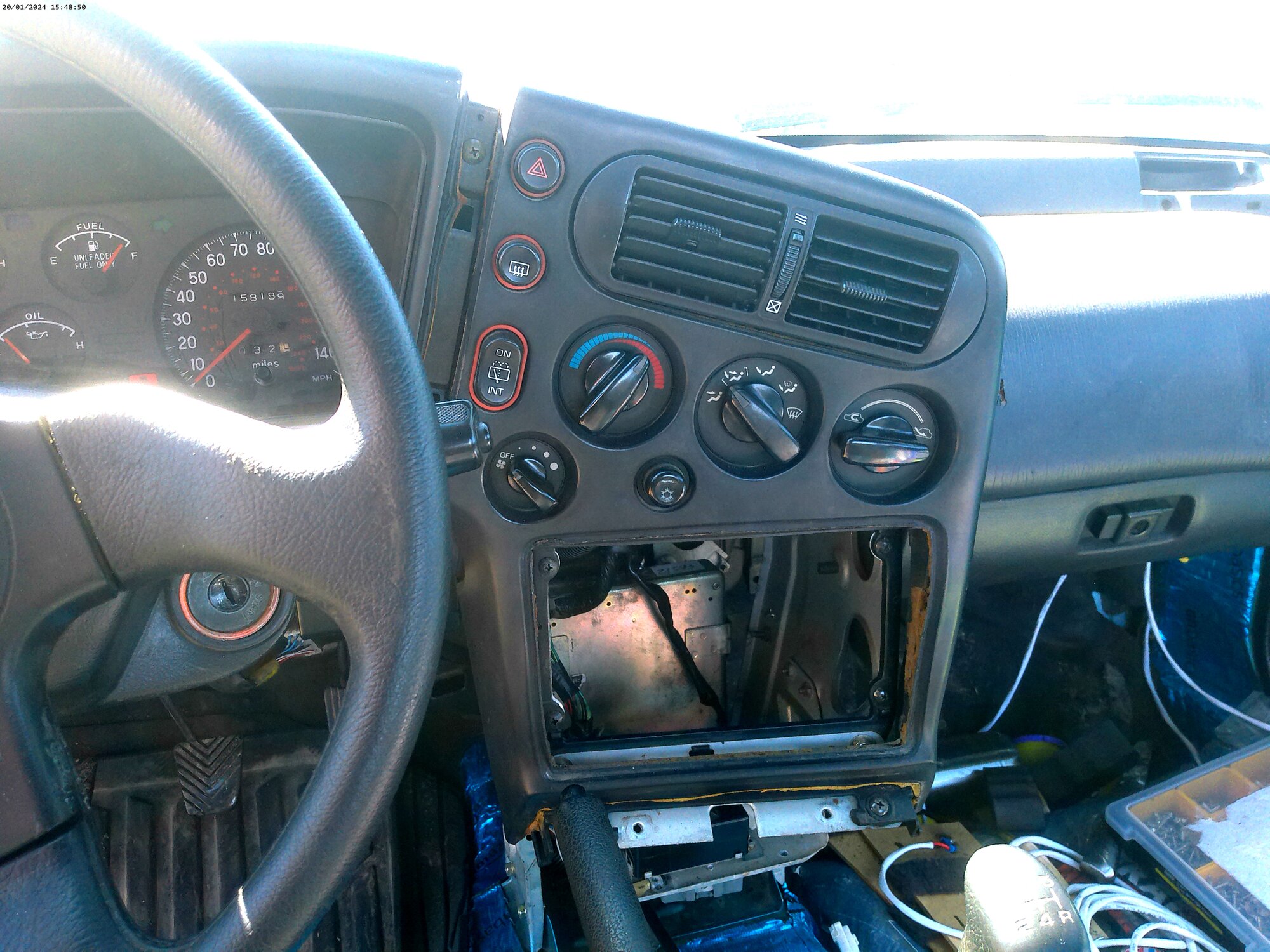

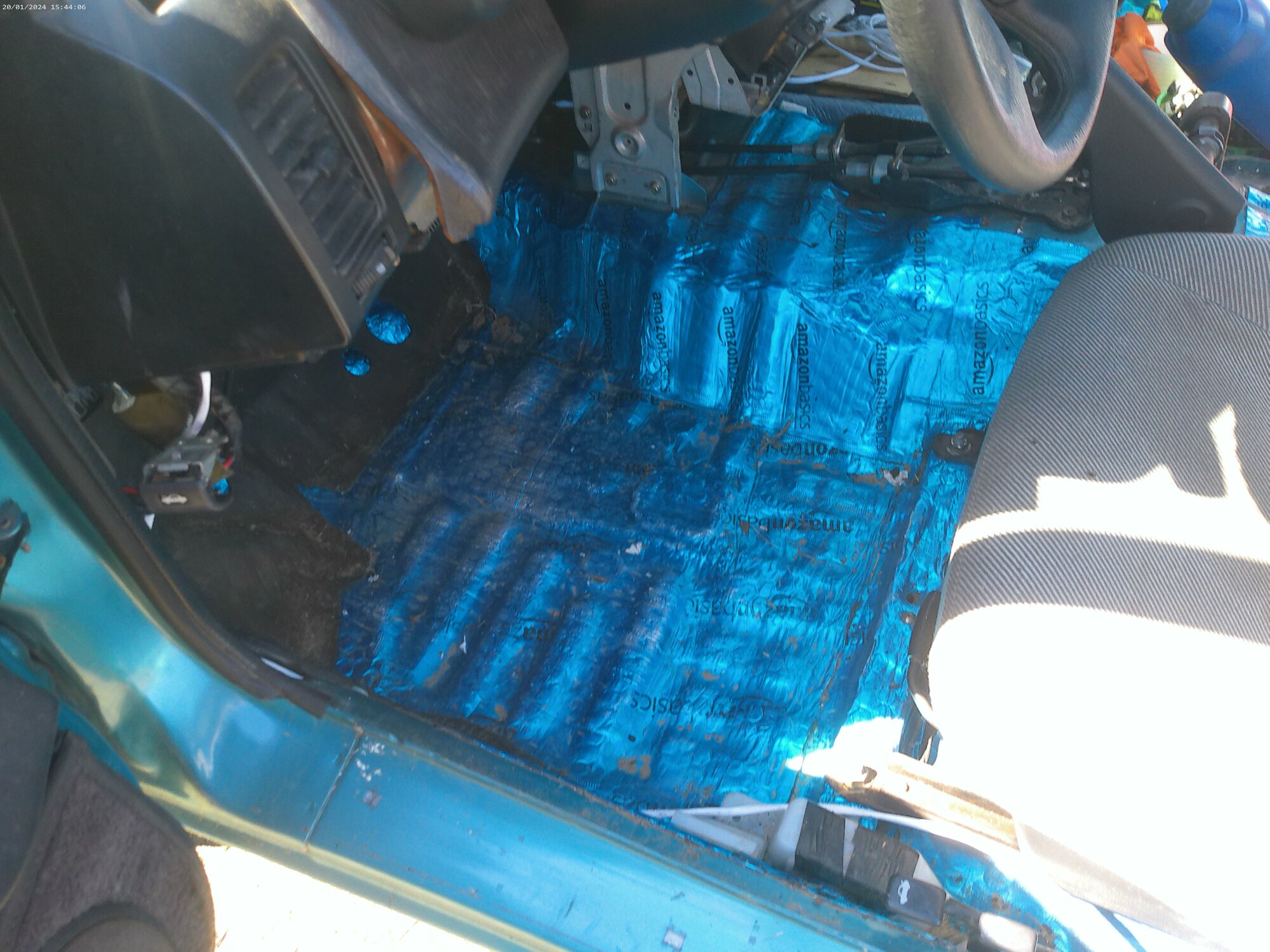

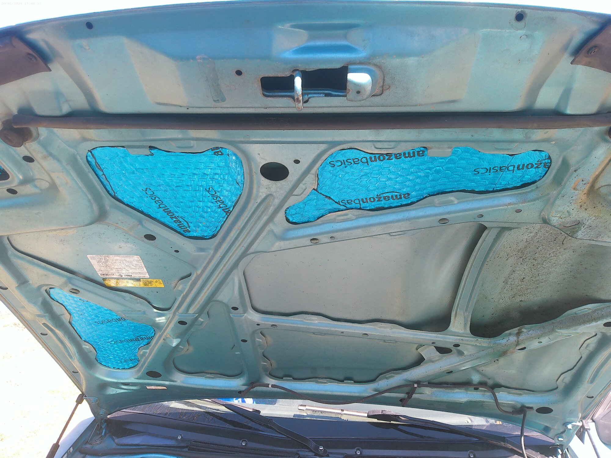

As a major part of this build a kick ass stereo system is definitely goin in. It's gettin a 10" Samsung tablet for the head unit, a USB hub/charger so I can add a cuppla TB HD for audio and video storage and have ample phone charging, etc. The head unit will output via a single cable along the drivers side back to a DSP which then will output to a pair of amps to run the 6.1 sound system w/all new speakers for the dash, doors and rear area, topped off w/a 10" sub tube in what was once the rear seat area. Not really wanting some bass box on wheels but a clean sound system that sounds good when cranked up a bit. The 6X9 JBLs, 6-1/2" Focals and 3" DS18 speakers along with the Skar 10" sub tube goin in should do fine for what I'm after.

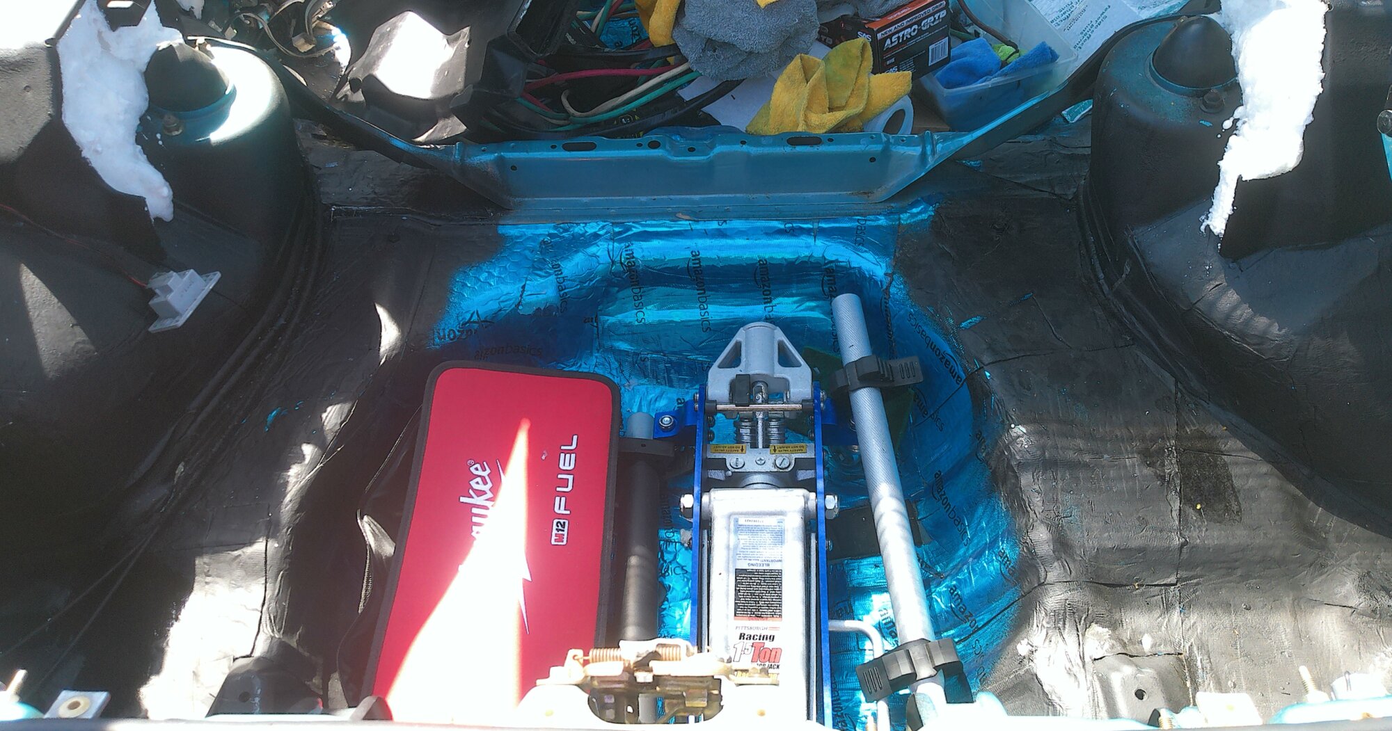

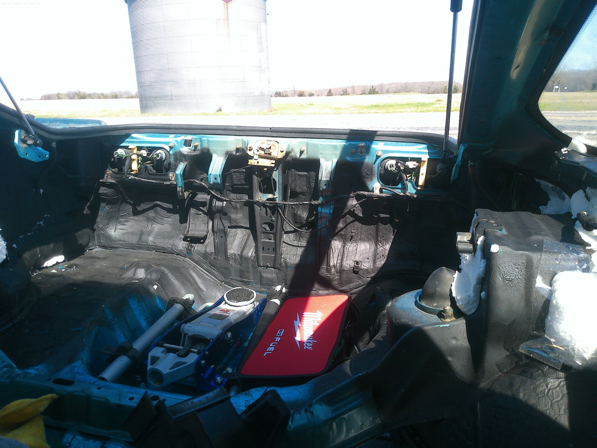

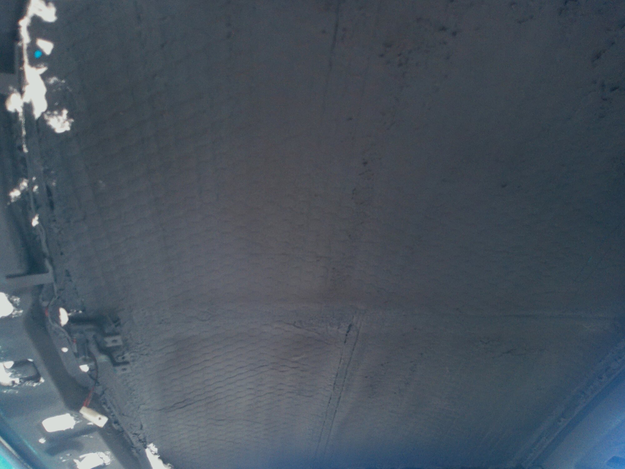

To that end I stripped out all the (badly sun faded) interior panels and added sound deadening panels front to back and side to side, even in the roof panel. All this sound deadening material also will all be sprayed with 3Ms rubberized undercoating to fill any gaps at the panel edges. Some of it's already done and you'll note the difference where the blue from the sound deadening panels can still be seen. I've also been shooting low expansion foam into all the body cavities to gain a little structural rigidity while simultaneously eliminating what were once resonant chambers in the body and eliminating a ton of road noise too. Even without carpeting in it the car is a lot quieter inside now.
Almost finished with the interior panels which have all been sanded and smoothed up a bit, then cleaned and repainted w/a satin black made by Rustoleum with a final coat of clear matte to knock down the sheen the satin black gave the parts. The last step for the panels was to apply foam sheeting to the back side of them to again help with any undesired interior resonance.
The spare tire hole is gettin a full size spare and as we all know that means it'll be sittin up a lot higher than the usual rear hatch floor. So, I'm raising the floor panel up high enough to accommodate the spare which then gives me enough room to also add in a 1-1/2 ton aluminum floor jack and it's 2 piece handles along with a very compact tool kit I've assembled for the car that just fits inside the bag I got w/a Milwaukee cordless ratchet, which can be seen in a cuppla the pics sittin in the spare tire well now. The jack, handles and tool kit will all be mounted in place on either side of the spare under the new rear hatch floor.
The new rear hatch floor will be hinged at the cross brace behind where the rear seat back once was and then hinged again on each side in the rear deck side areas to allow the outside corners of the rear hatch floor to fold towards the center so it can all be easily lifted for access to the spare tire, jack and tools.
Where the rear seat base once was will be replaced with another hinged panel which will be level with the rear hatch area floor and the battery, DSP, and amps will be mounted out of sight underneath that panel. This panel will have a master electrical disconnect switch like drag cars get installed in the vertical panel facing the back of the front seats so at the flip of a switch all power can be disconnected from the battery instead of havin to yank a battery cable when doin work on the car.
All the cars lighting has been replaced w/LEDs and that's another fave mod so far. The head lights are amazingly bright, the markers and tail lights look much more crisp and you can actually see behind you when you put it in reverse!

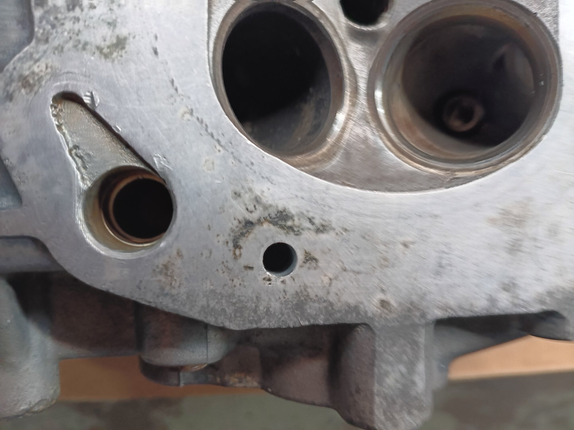

Yeah, the g4cs is basically a 2.4 version of a 1g/6 bolt block. Always heard it was a Mitsu design that they never built and allowed Hyundai to produce. I believe Hyundai only used this block in 90 and 91 Sonatas. Picked up this block and crank back around 2002 and have been hoardin it ever since. Got even luckier with this block since it came w/a forged steel crank which I had a machinist lighten by about 8lbs, which really changes the way it revs. I'll hafta get some pics of it later and put 'em up here but it very nearly resembles a flat plane crank.
It's such a close copy of the 1G block that it even has the bosses on the back side of the block for mounting the AWD carrier bearing, which means it allows running the equal length drive shaft set up. Been haulin around a cuppla drivers side 1G AWD jack shafts for many years and will be using one plus the drivers side AWD CV joint I just received from Rock Auto on a close out. This set up helps eliminate the wheel hop that often is common w/FWD cars.
Sadly these blocks are just about all gone now. Last one I saw for sale was goin for $700. However, if you manage to find one the only pieces you'd want from it are the block, crank and the beefy individual main caps, everything else is just scrap metal.

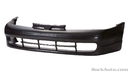

While I've always liked the simple styling of the Laser, one element of it's styling just never enthused me ... the front bumper cover. Having 2 rows of different sized openings in the front just always struck me as odd and kinda cheesy.
While I could have performed major surgery to the bumper and opened up those dual openings to a single opening it seemed like that would probablee not turn out well so I began to look at other alternatives.
Found some aftermarket kits that looked more aggressive but they all were made with the lower edge of the bumper cover dropped down further than the Lasers front end. I expect that styling was intended to match Eclipse and Talons which have lower body cladding that extends lower than what the Lasers does.
So, I started lookin at replacing the cover w/a stock one from other models. The 90 and 91s bumper covers are different due to the pop ups they came with, so they were out. So this left me with only 92, 93 and 94 bumper covers to choose from.
Diggin around on different sites, lookin at what was available and what styles I liked I came upon a reproduction bumper cover from Rock Auto for the 92 Eclipse that was exactly what I was after, well almost anyway.
As always the price was fantastic, just $52.79 and with shipping came out to just over $200, less than I could find any used 92 Eclipse covers for so I pulled the trigger on it late last Sundee night. To my surprise today, just 2 days later, it was sitting in front of the house when I got home today!
Unlike most aftermarket bumper covers that come folded up in a box and they tell ya to let 'em sit out in the sun to regain their shape this one shipped in a huge box, wrapped in bubble wrap, then bagged in plastic with the remaining space in the box filled w/air pillows so it arrived completely unscathed and pristine.
I was lookin at a stock one my buddy had on a 92 Eclipse over the weekend and since he had it off the car we got to do a really good comparison against the stock one on the Laser. The body lines matched perfectly but one thing I noted was that the Eclipse cover had a recessed area in the center for a Mitsu Tri-Star emblem. I knew that would need to be covered somehow. Again, this new bumper cover has that area completely flat, so no modifications necessary.
The cover is made of really nice, thick black plastic, has all the necessary mounting tabs and even ones along the bottom edge for the sheetmetal reinforcement strip.
It comes with the same support bars across the center as the stock Eclipse cover has and these will be removed leaving one large grill opening that I'll be making an expanded metal piece to then fill the opening with which will give me pretty much exactly the look I wanted for the front end.
I've attached Rock Autos catalog pic so you can kinda visualize what I'm talkin about.
In case anyone needs a replacement bumper cover for their 92 Eclipse I'd highly recommend taking a look at this one as not only is it a steal of a deal but a really well made piece to boot.

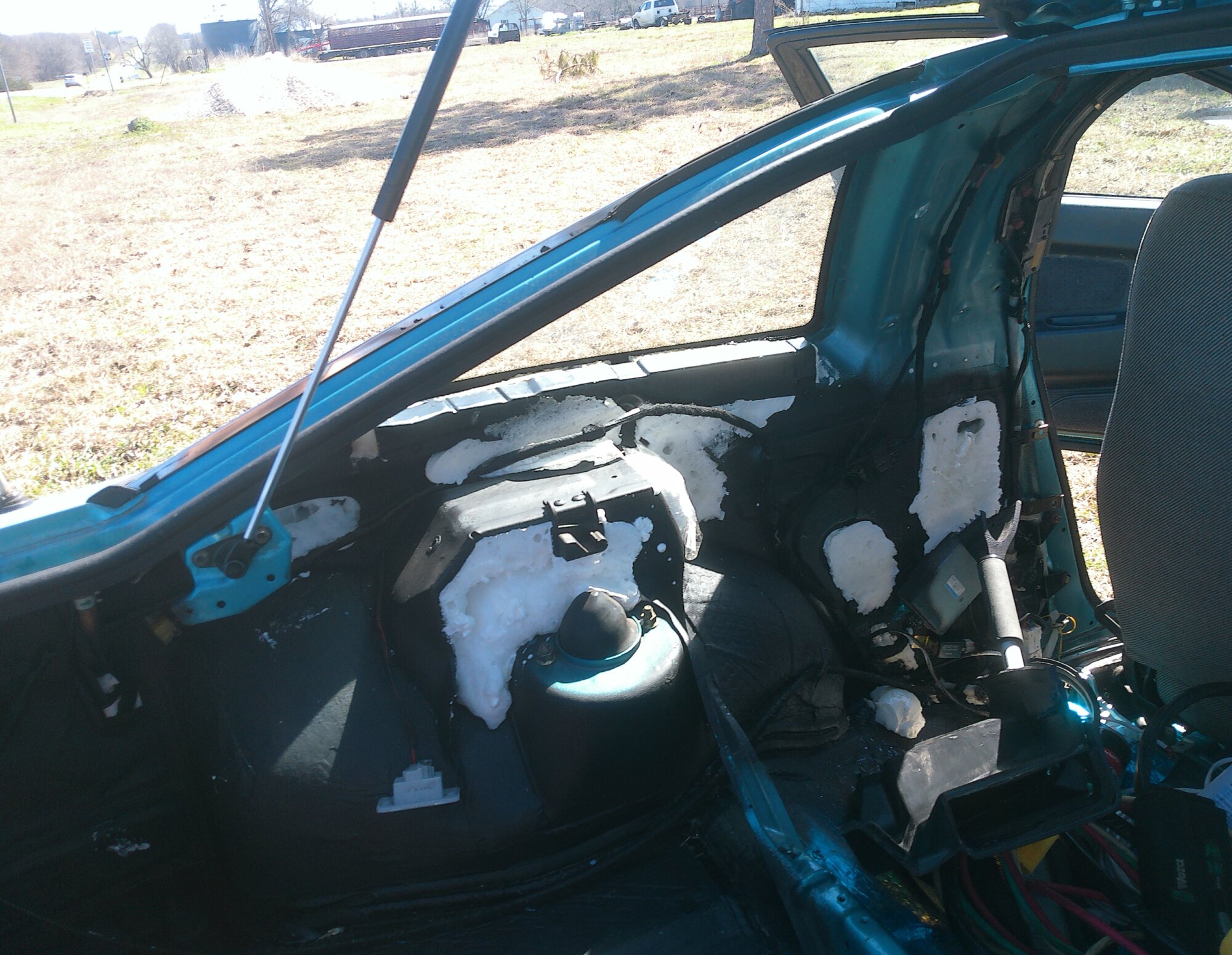

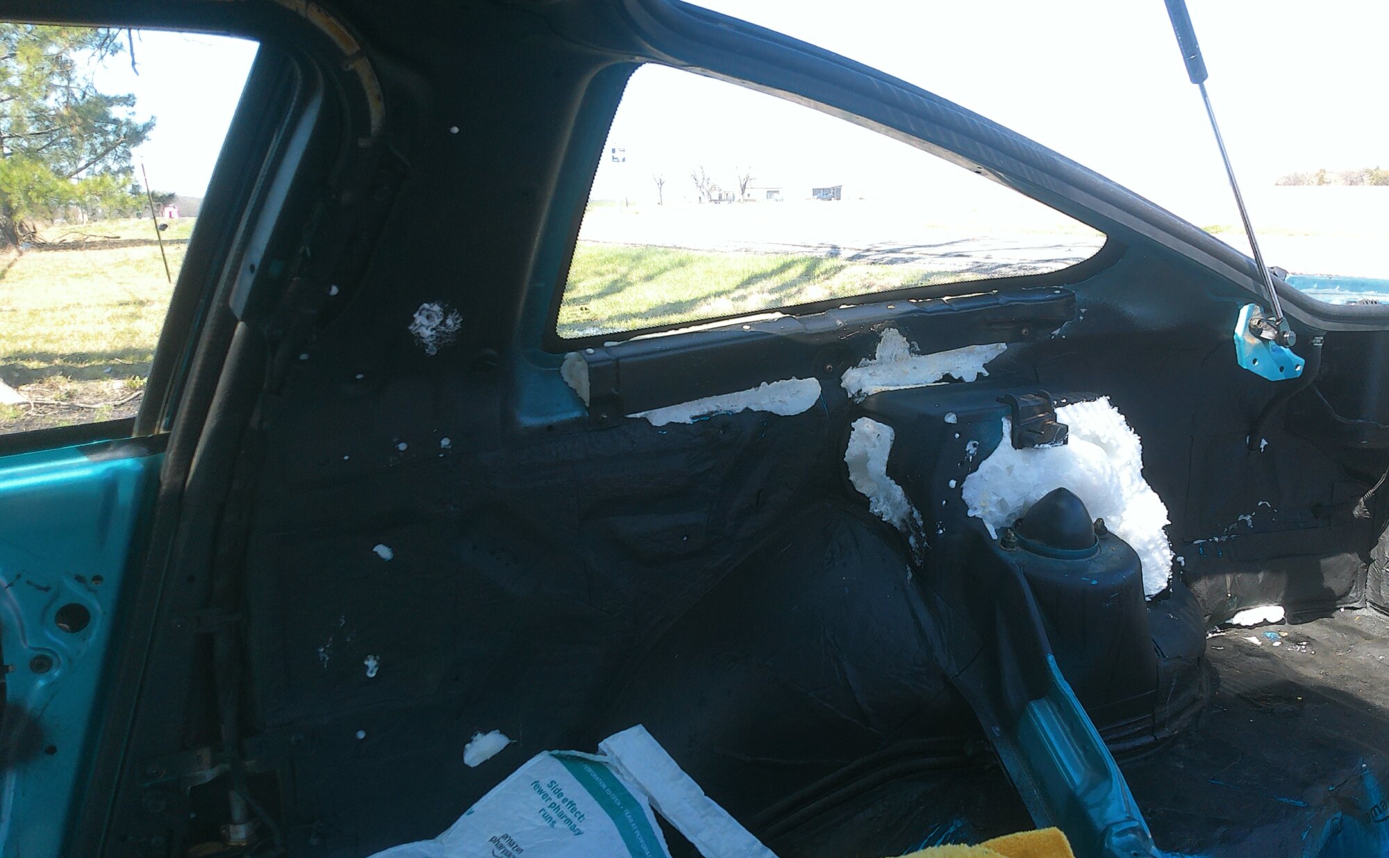

After hours of installing sound deadening material, shooting foam into every place possible in the A,B & C pillars, across the B pillar cross brace, into the body openings in the sides of the rear seat area, the sides of the rear body panels, the side of the foot well areas, inside the running boards, all the way around the roof support bracing and filling the rear hatch cross brace areas, then applying foam sheeting to the backs of all the interior panels along with fresh foam strips along all the panel interface points it's all making noticeable cumulative results in how the car sounds inside while also quieting tons of squeaks and rattles the car had.
Once the rest of the interior panels go in I feel sure it will get even quieter still.

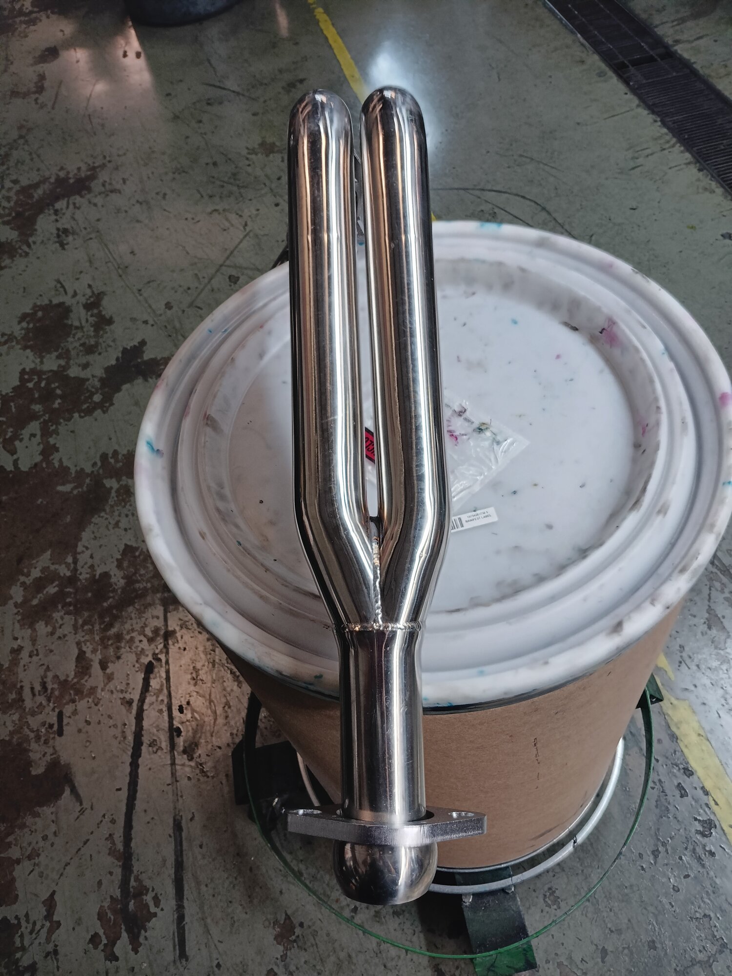

Noticed an exhaust leak that was gettin worse and expected the gasket at the cat eliminator flange was leaking again, which had already blown once so far, but that waddn the problem.
Got to my buddys shop with what now sounded like open headers, jacked it up and this time the 2 into 1 Y pipe coming off the head pipe had completely broken. Someone in the cars past had probablee drug the flex section on a speed bump or something and had just replaced it with a straight piece of pipe so every time the engine rocks it's stressing the exhaust pipe, which eventually just broke.
Luckily it was weldable and my buddy had a spare flex section off a Ford Focus along w/a short piece of exhaust pipe that we used to make a proper repair.

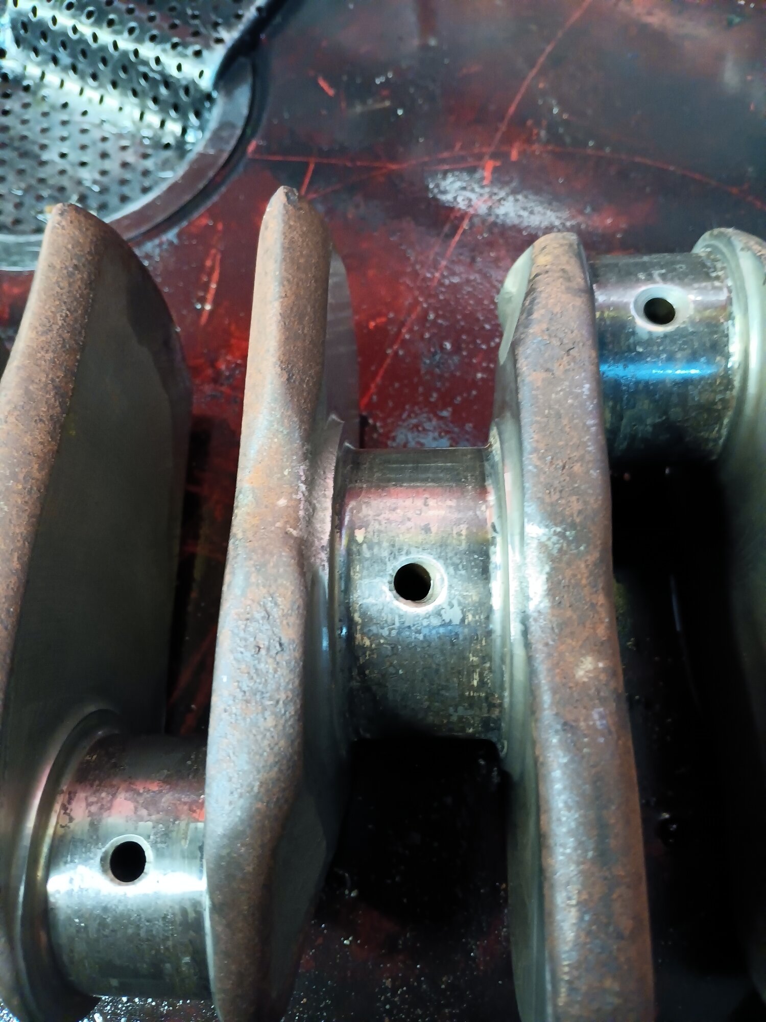

Last week the 4g37 in the Laser finally died. Having been down for the last few months needing a new distributor after one of the connectors snapped off while changing out the timing belt tensioner pulley I finally got it back up and going again. And ... it made it about 58-1/2 miles of my 60 mile round trip commute.
On my way in about 1/2 way I noticed it was runnin poorly all of a sudden so I pulled over, popped the hood and found the engine covered in oil while also pouring blue smoke outta the exhaust. It was still holding good oil pressure and temps were ok so I decided to limp it on to the shop. The power was way down and it didn wanna rev so I kept it to about 60 mph for the rest of my all highway commute. It was also puttin out tons of blue smoke. I am guessin one of the worn rings finally just let go but a full tear down will be necessary to confirm that.
Had a long 12hr day at the shop where we were having fits w/scheduling and mechanical issues w/one of our machines and I really waddn lookin forward to the trip home but decided there really waddn anything to lose at this point so I cranked her up and headed for home.
Made it about 6 miles when the oil pressure began to drop like a rock. Slipped into a rest area and added about 2qts of oil but had to let it cool for about 30 mins before it'd crank back up.

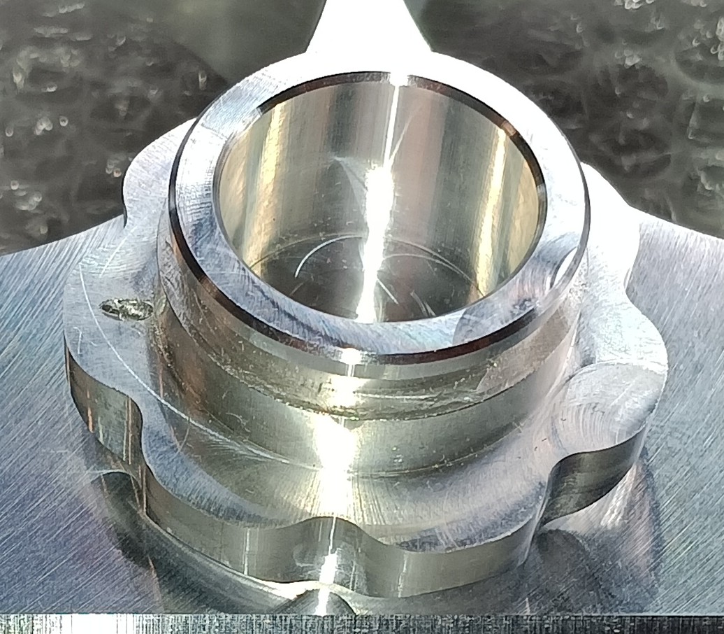

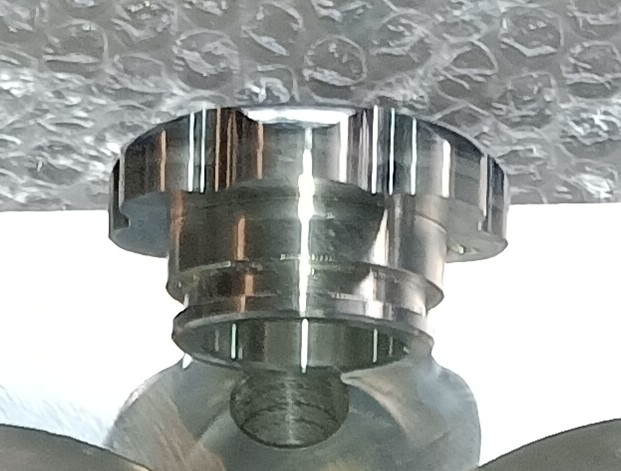

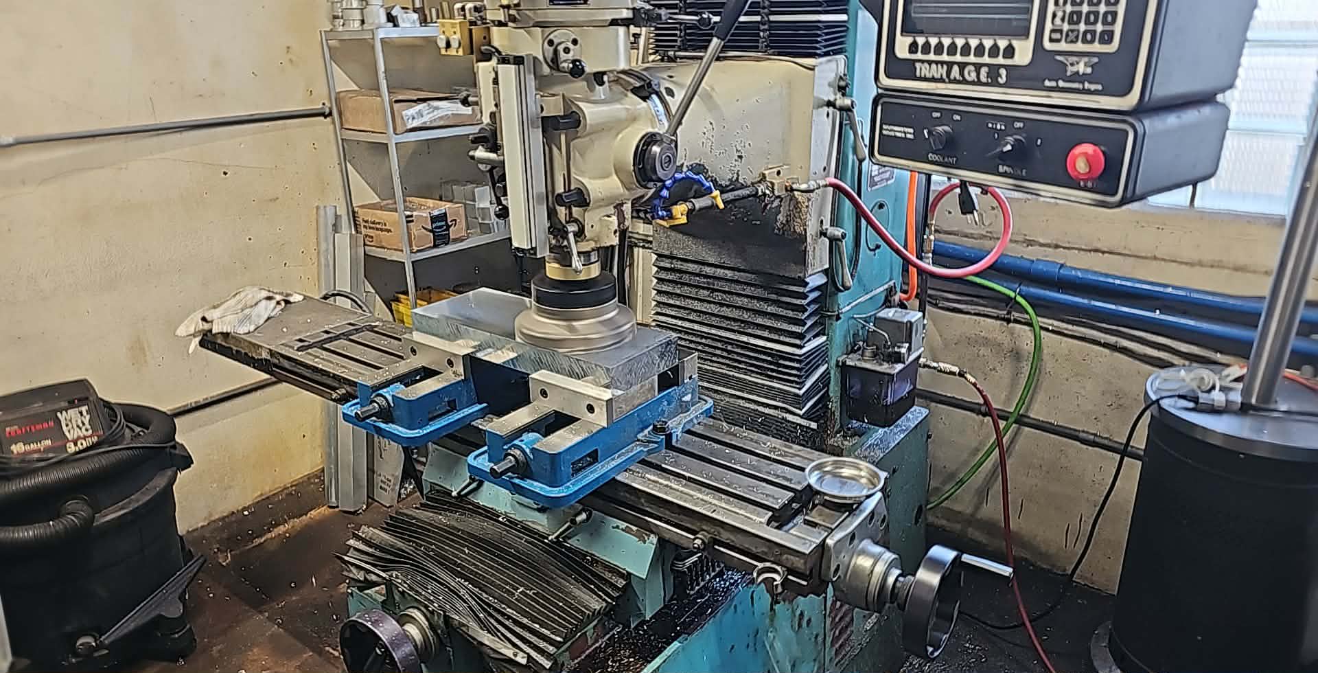

For this build I decided to go all out and do everything possible to get the block machine work spot on and needed a very special piece to help in doing so. Contacted Fatboy Fab (on FB) and had them make me a deck plate to send along w/all the parts to the machine shop.
The 1st pic I received was of the initial fly cutting operation and the second pic is of the finished plate as received today.

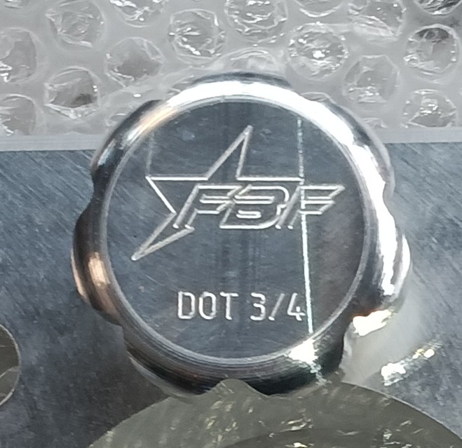

I'm also including a cuppla pics of the sweet CNC'd Clutch Master Cylinder cap I received w/the deck plate.
These guys are awesome to work with, hold to their deadlines and do some masterful machining. I couldn't be happier w/their parts and highly recommend doing business w/'em when you can.

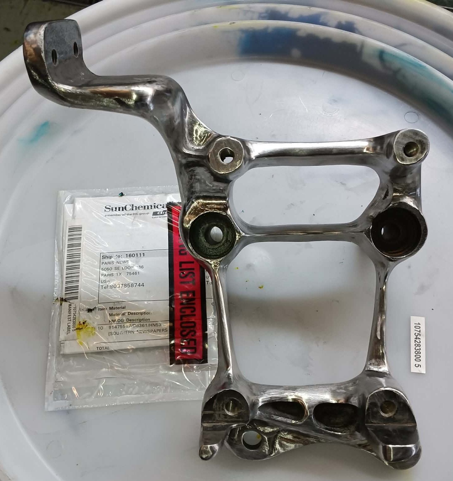

Lots more custom touches like the time waster custom AC bracket, and will be doing some interesting things w/ Cerakote for this build. So much still to be done but I at least have the bulk of the parts and this one will be built w/all SS allen head (SHCS) fasteners, washers and nuts. And, I have a totally new idea for building a primary catch can into the block itself.

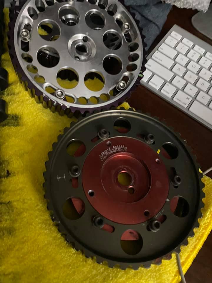

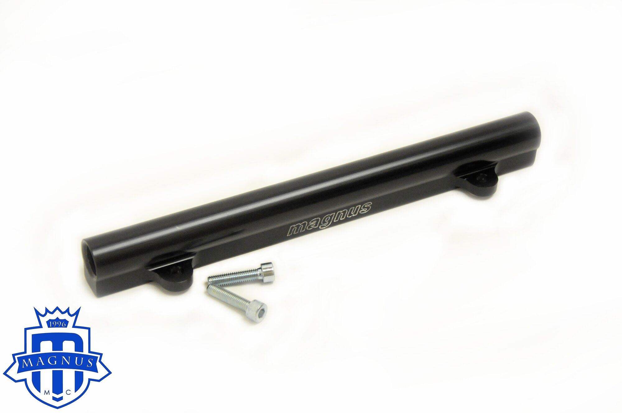

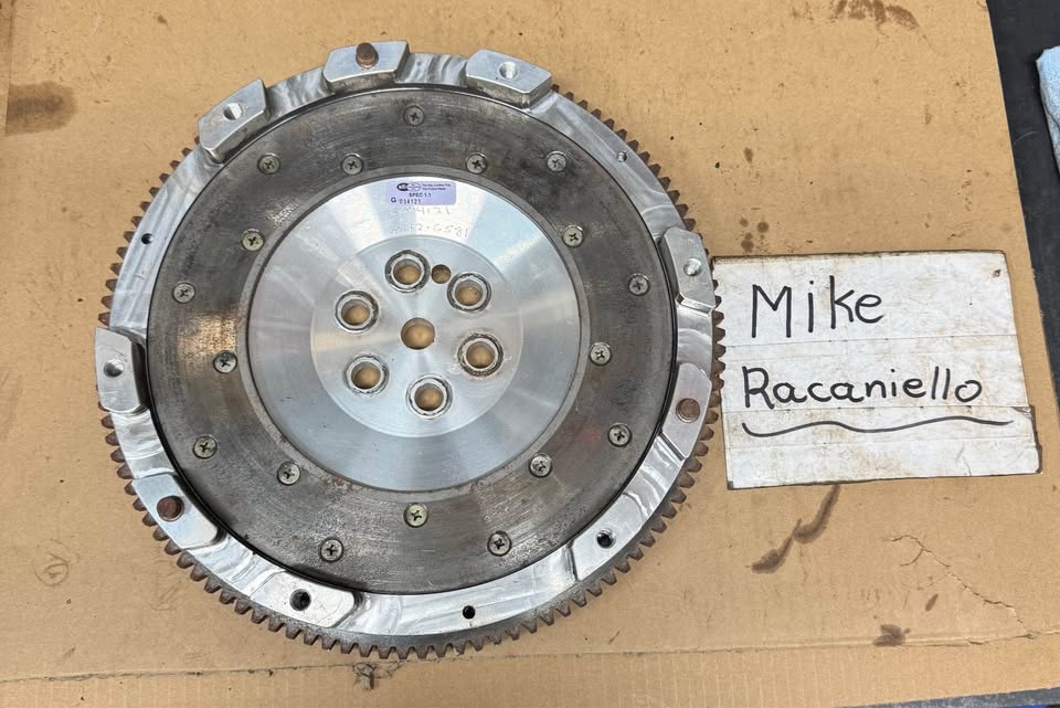

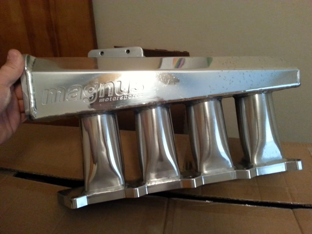

Here's a few pics of a few of the parts to be used.

Stainless Steel Clamp on Dual Exhaust Tip Tailpipe Duo Layer 2.5%22X(2.6%22X2) X8.85%22 OAL - ...jpg

Took the Eagle rod set and deburred and radiused all the edges to eliminate any possible stress risers then buffed 'em w/cartridge rolls and scotch brite. Still need to buff 'em w/a brush wheel on a bench grinder and sand blast 'em before Cerakotin 'em.

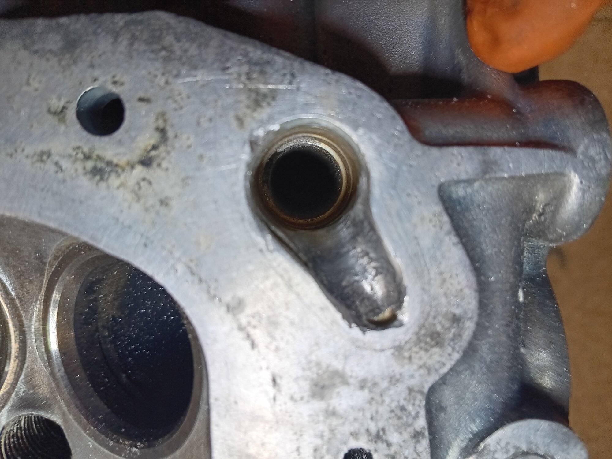

Spent more than a few hours cleanin the 2G head, removing the valve guides so I can port it, removed all the casting flash inside and out, opened up and smoothed the oil drain back passageways and water passageways and made some improvements in the valley areas to help the oil return more easily to the pan.
Once I get the head ported and the chambers buffed and slightly reshaped I'll post some more pics. Also need to give the Wisecos a little love to eliminate any detonation hot spots before recoating them and the chambers and valve faces.
