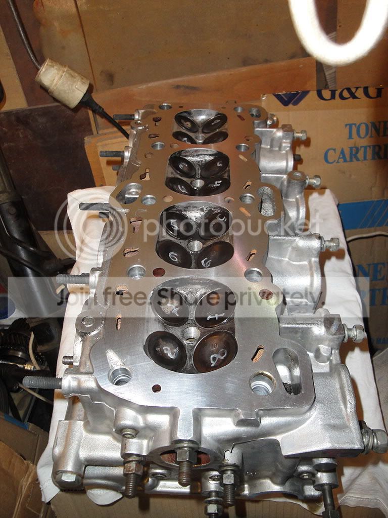

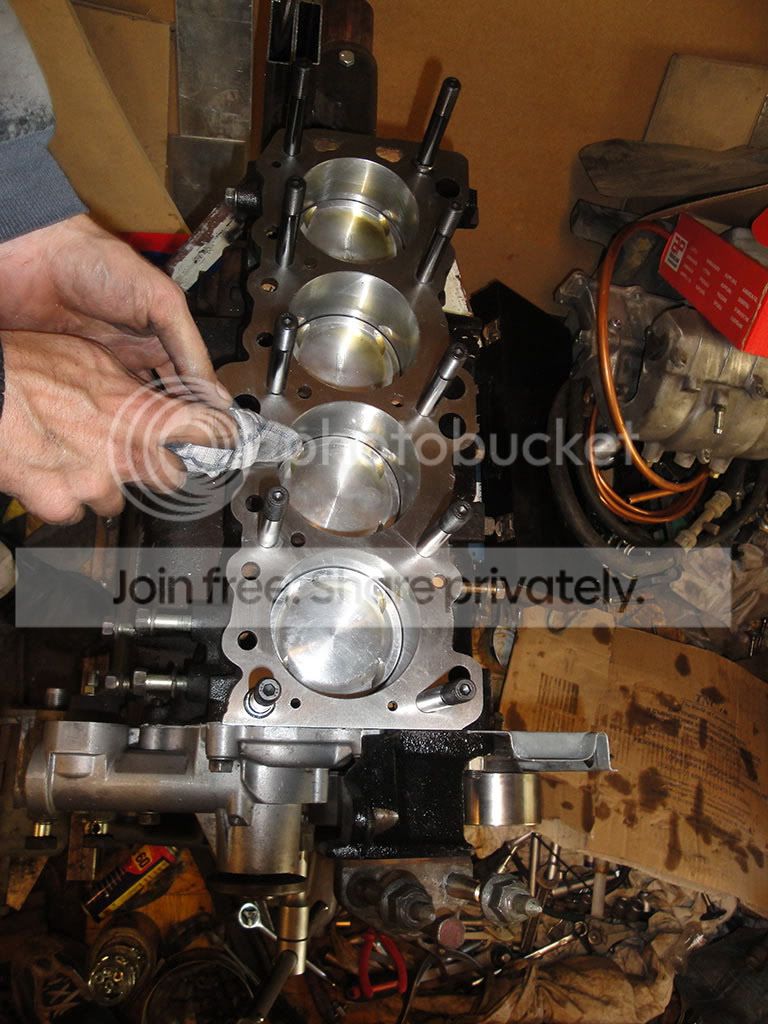

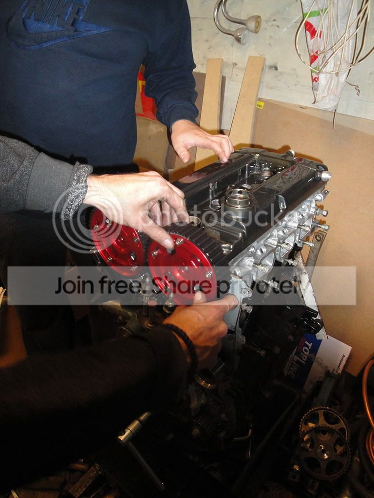

So, the engine is almost complete. The thing that need to be put are the VC and timing belt. I have an OEM timing belt. The VC is on the pics just to se how it will look complete. Than I will have to rotate the whole thing to see if valves are touching the pistons.
ARP head studs
the shiny head

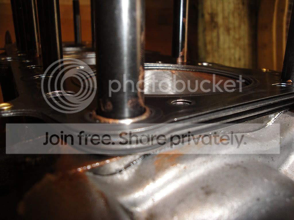

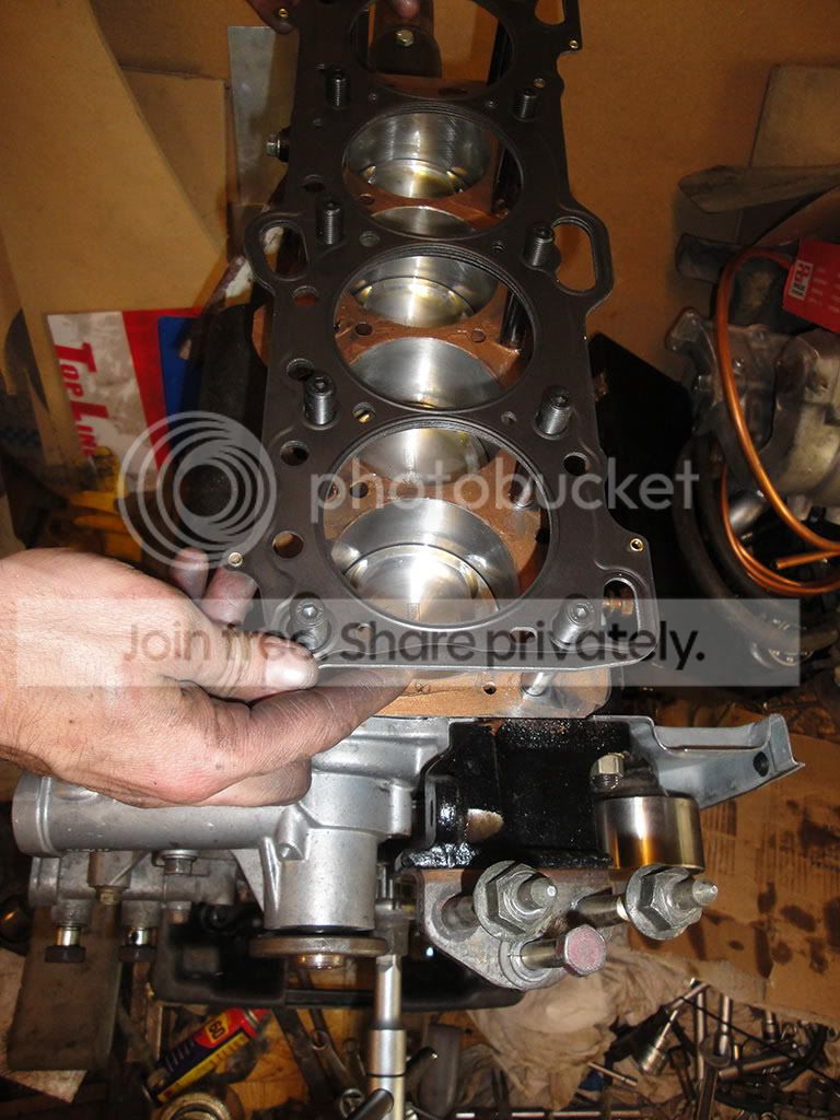

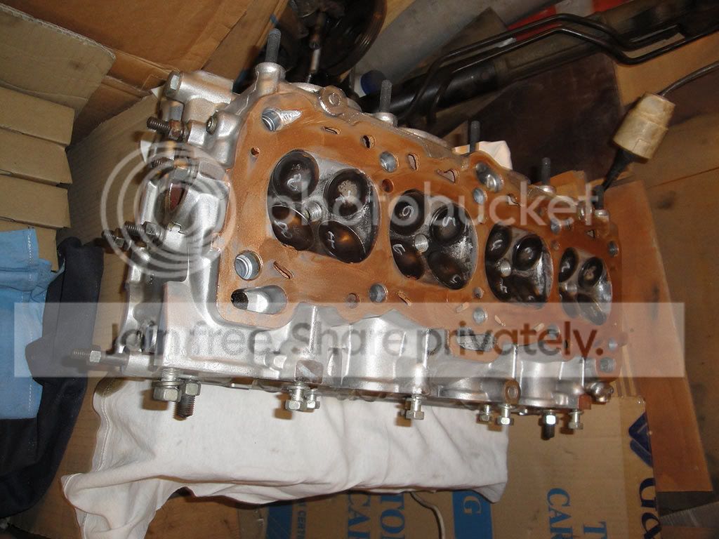

i put some copper grease. Then I saw that a dry install is recommended by cometic, but I left it as it was already covered. I hope I have not made a mistake.
.20 over 5 layer MLS Cometic

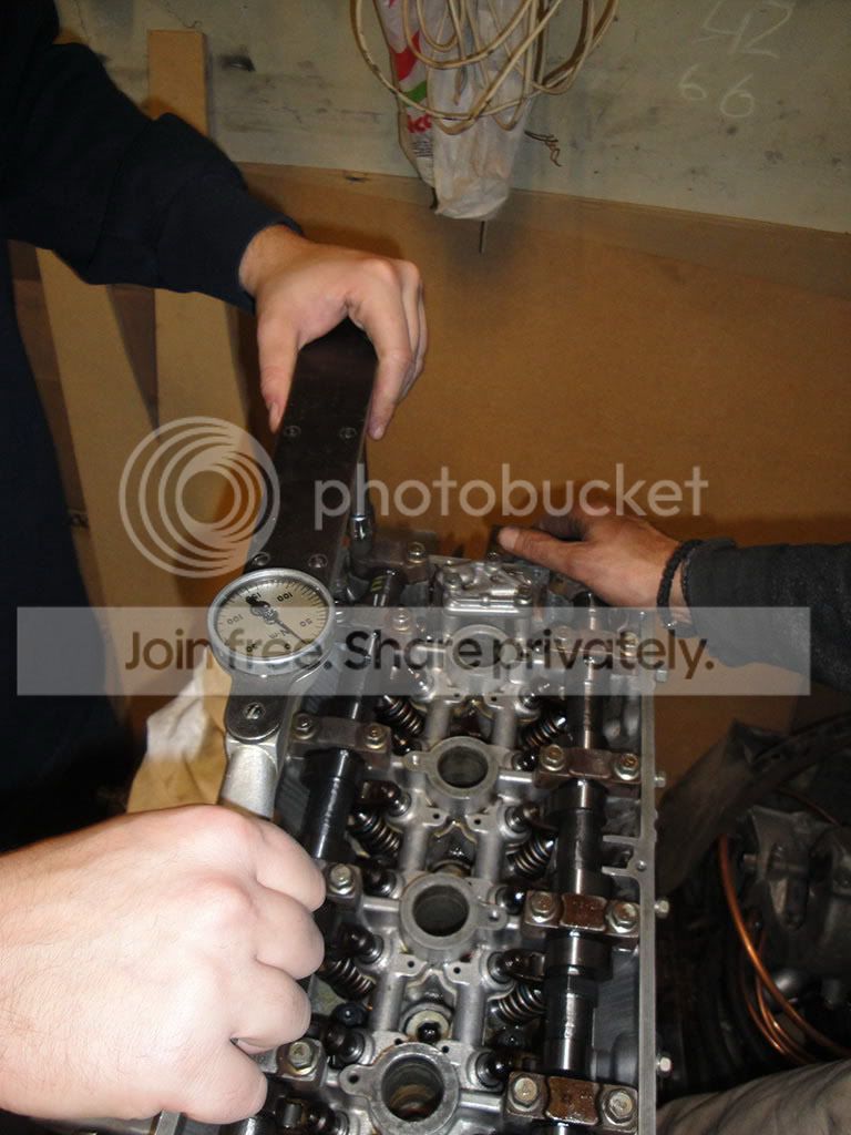

Cams torqued as per specs. I am using Delta K272 - copies of Kelford 272
Fidanza adjustables and the powder coated VC. I wish I had the money for those clear timing covers :(
