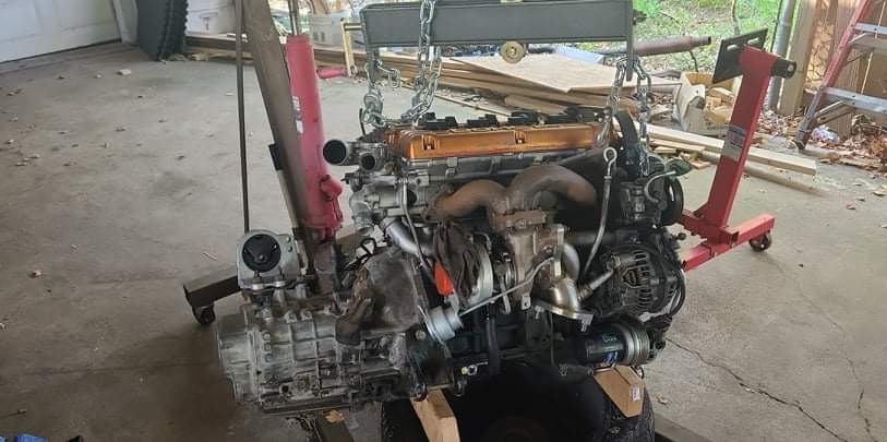

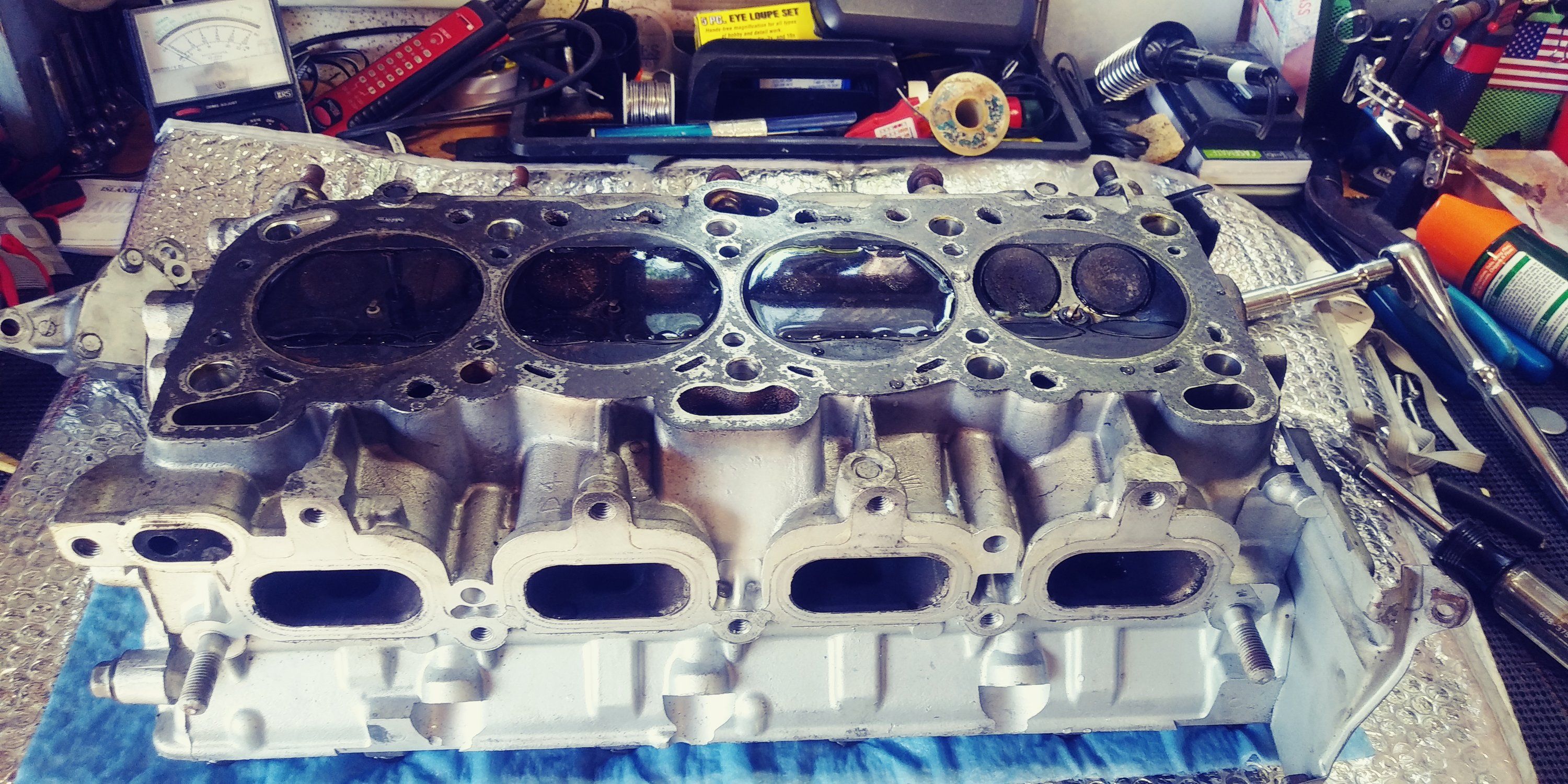

So, I'm going forward with the plan to swap the SOHC head for a DOHC head. I picked up a head from a buddy of mine. I was aware that the engine jumped time, so a rebuild was planned for. I finally got around to fiddling with the head.
I pulled the cams, rockers and lifters. I am currently leak testing the head. Check this shit out.
It's been sitting maybe 20 minutes.. I think I found the issue. ROFLROFL

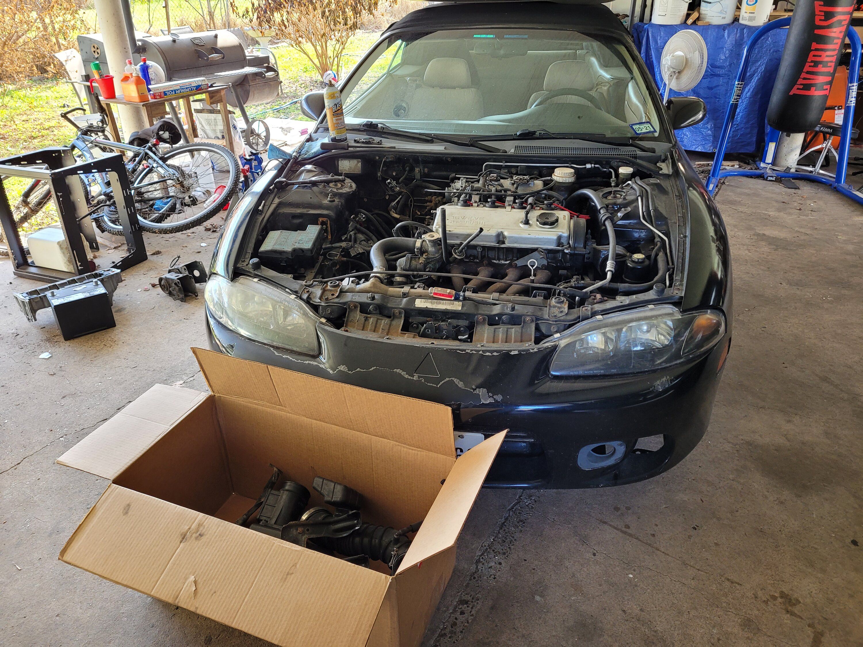

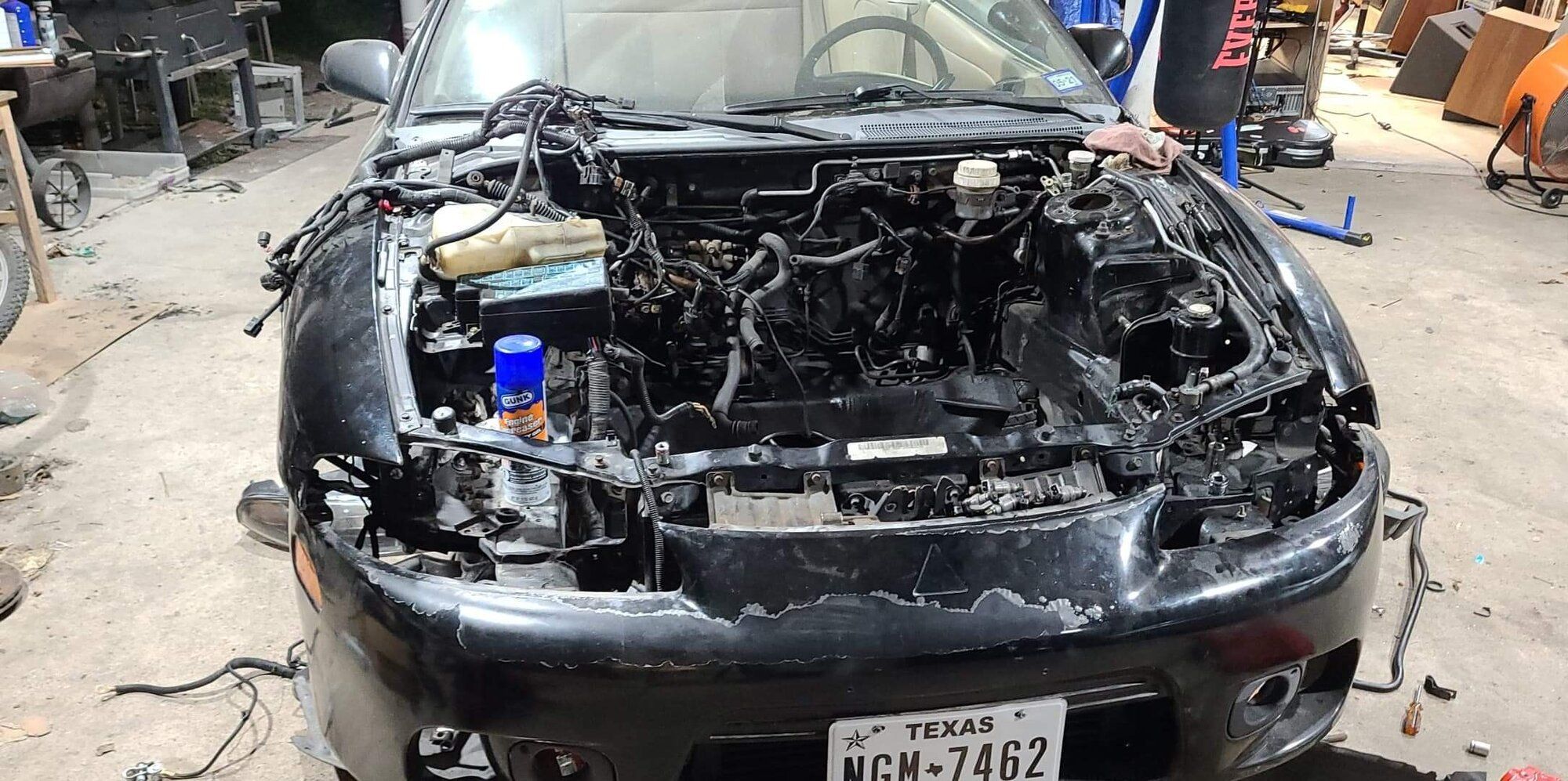

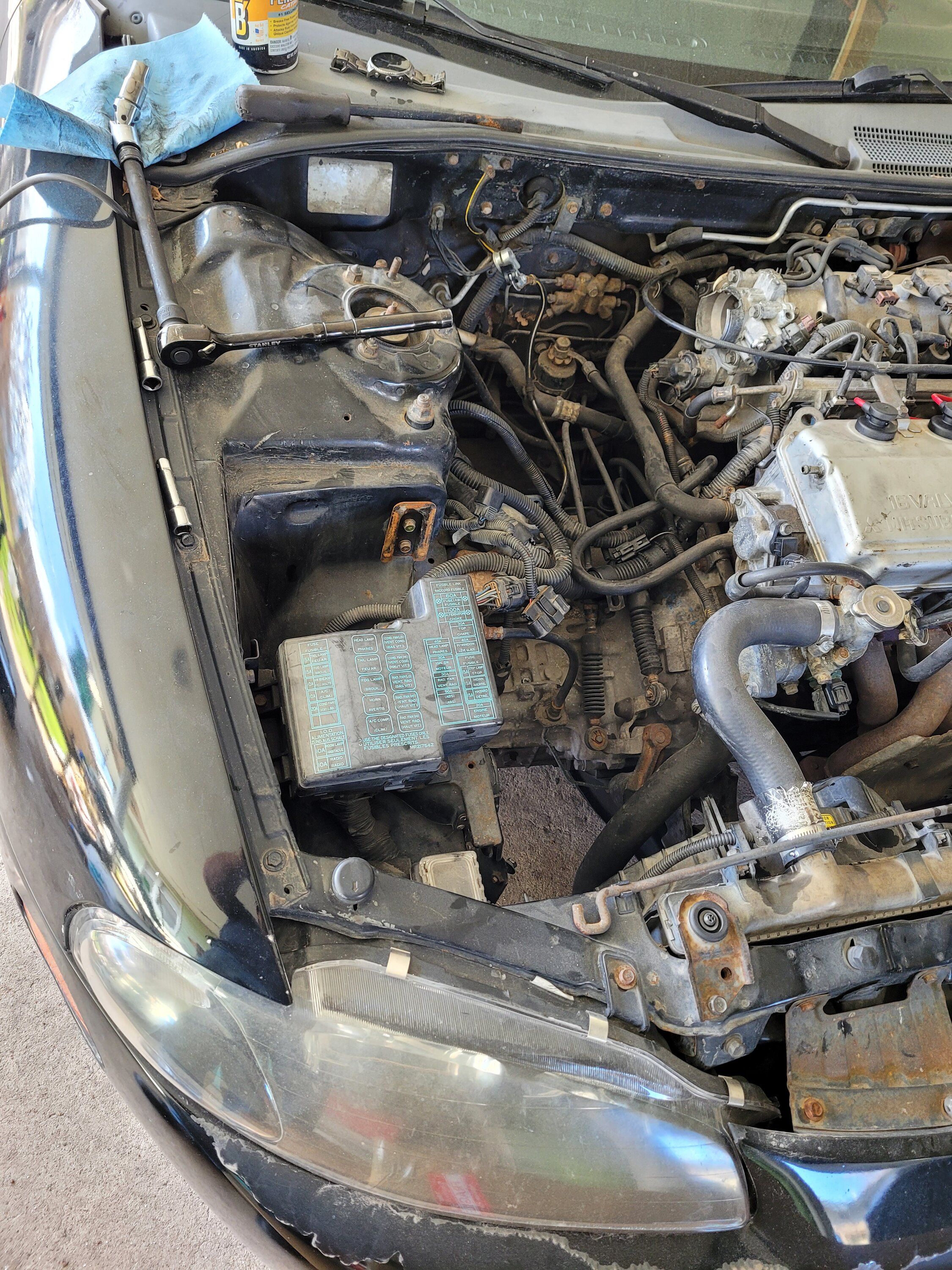

Update:

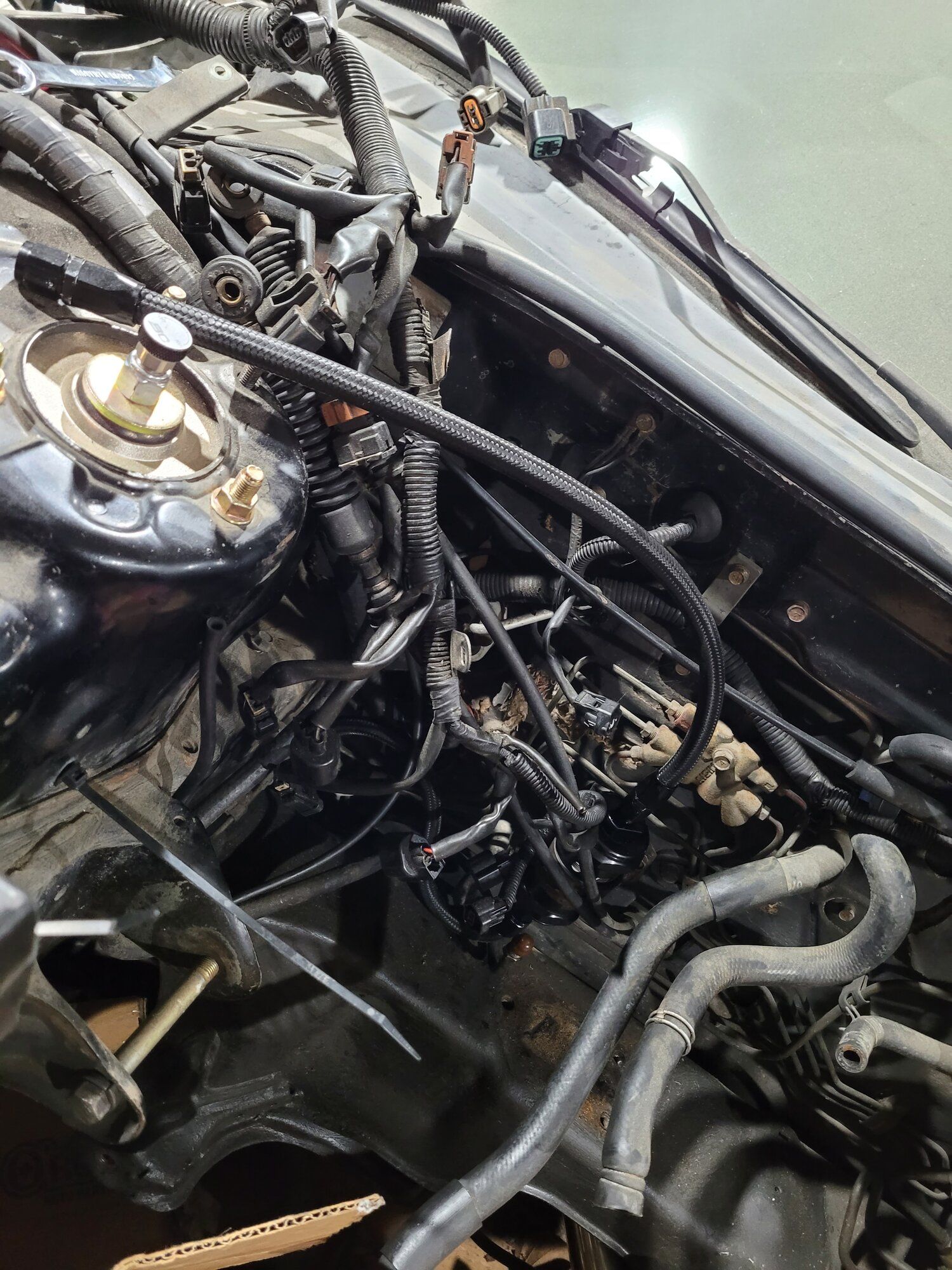

So far, I've got the engine and trans out, I've swapped the front end harness and fusebox for one out of a gst, same with the engine harness. I've got the entire interior out of the car, for grins mostly, but also because I'm swapping the under dash harness out for a harness with the power mirror option, since the original did not have that option in it.

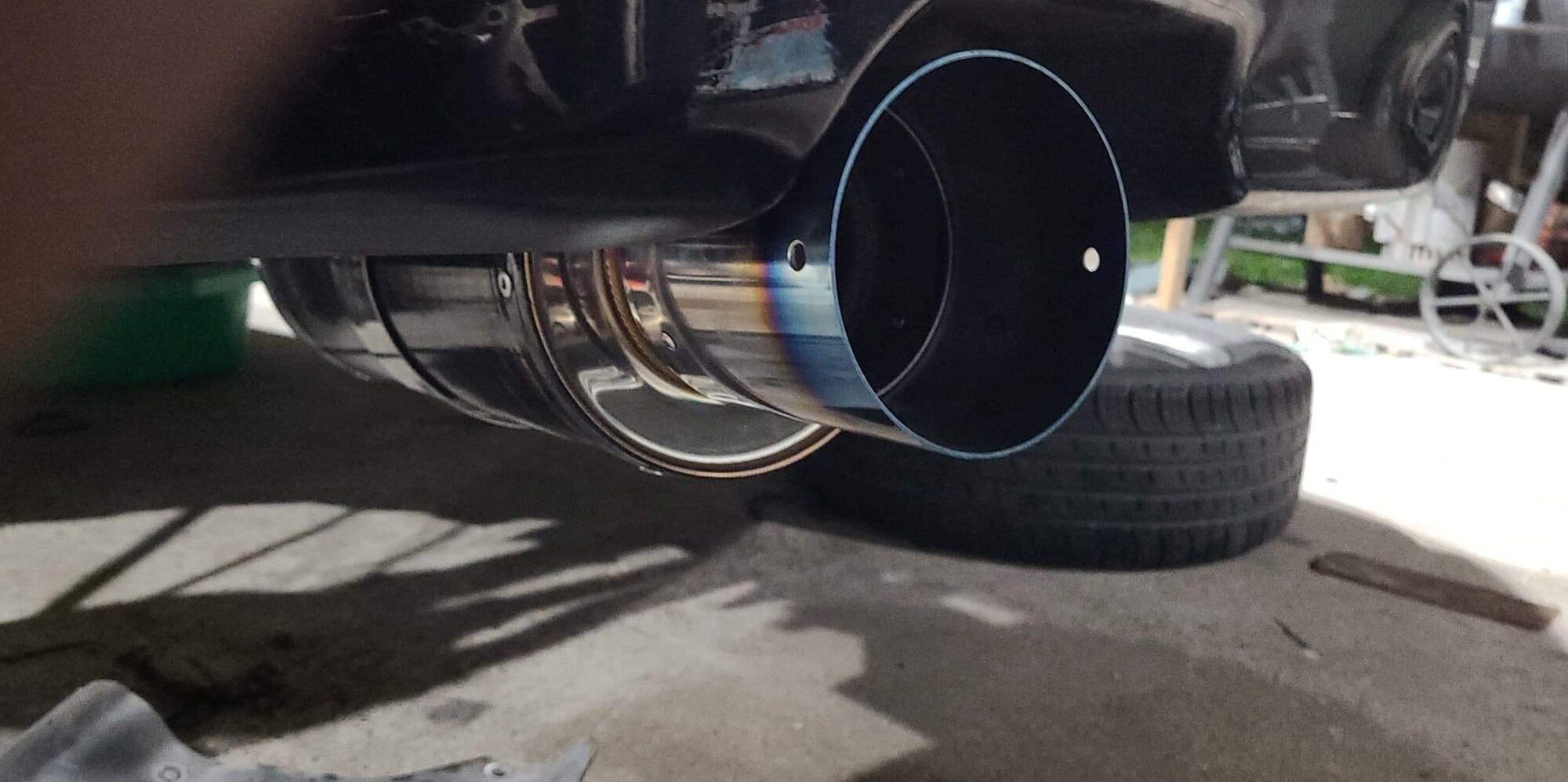

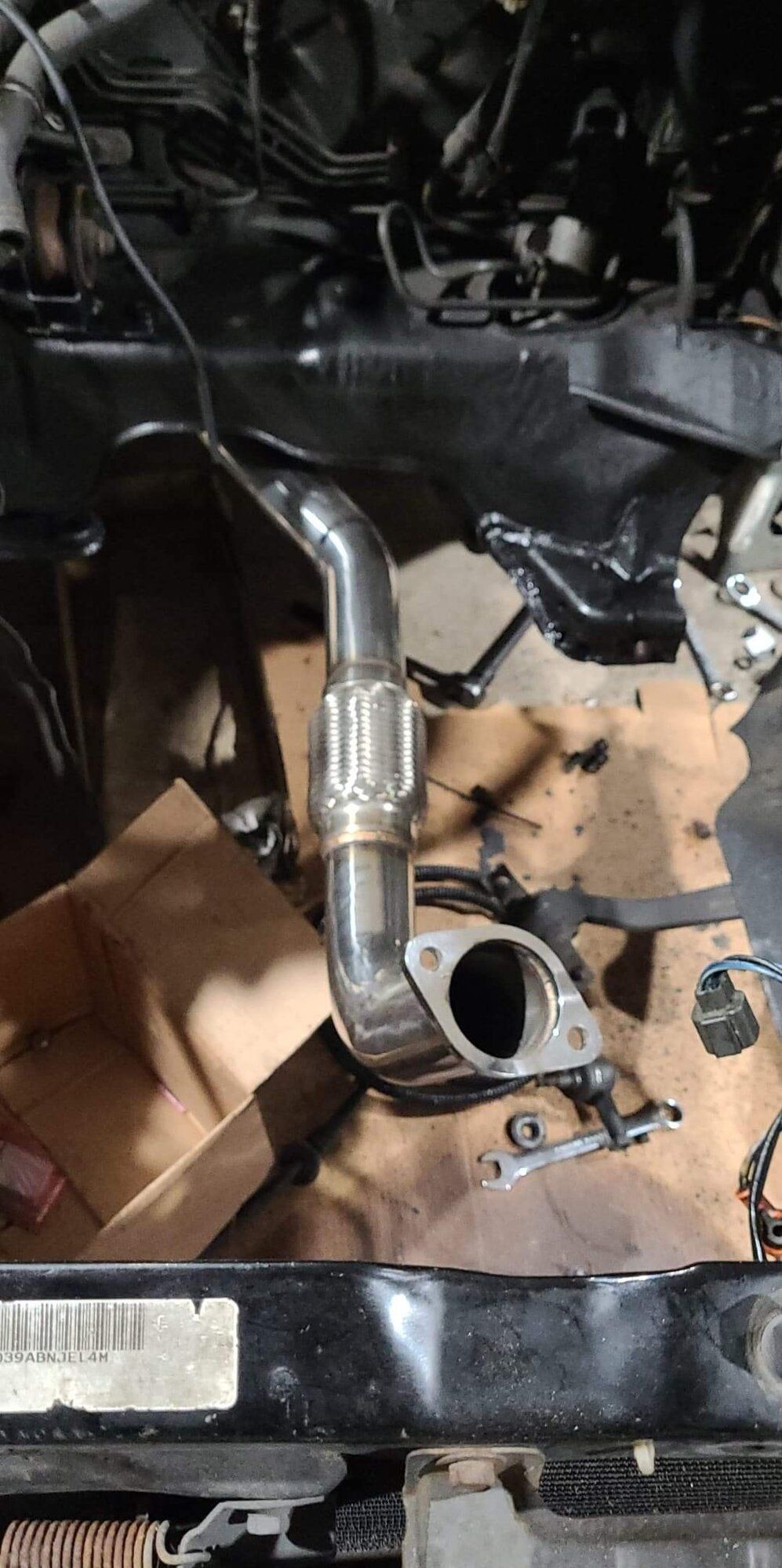

I've also got my Megan Racing downpipe mounted, along with a HKS Carbon Ti Catback exhaust, since the Megan Racing one I ordered had been canceled and refunded.
Also, since I'm going to daily this car, I will be cutting into the downpipe and installing a cat. I'm not overly worried about super high performance at the moment... yet 😁

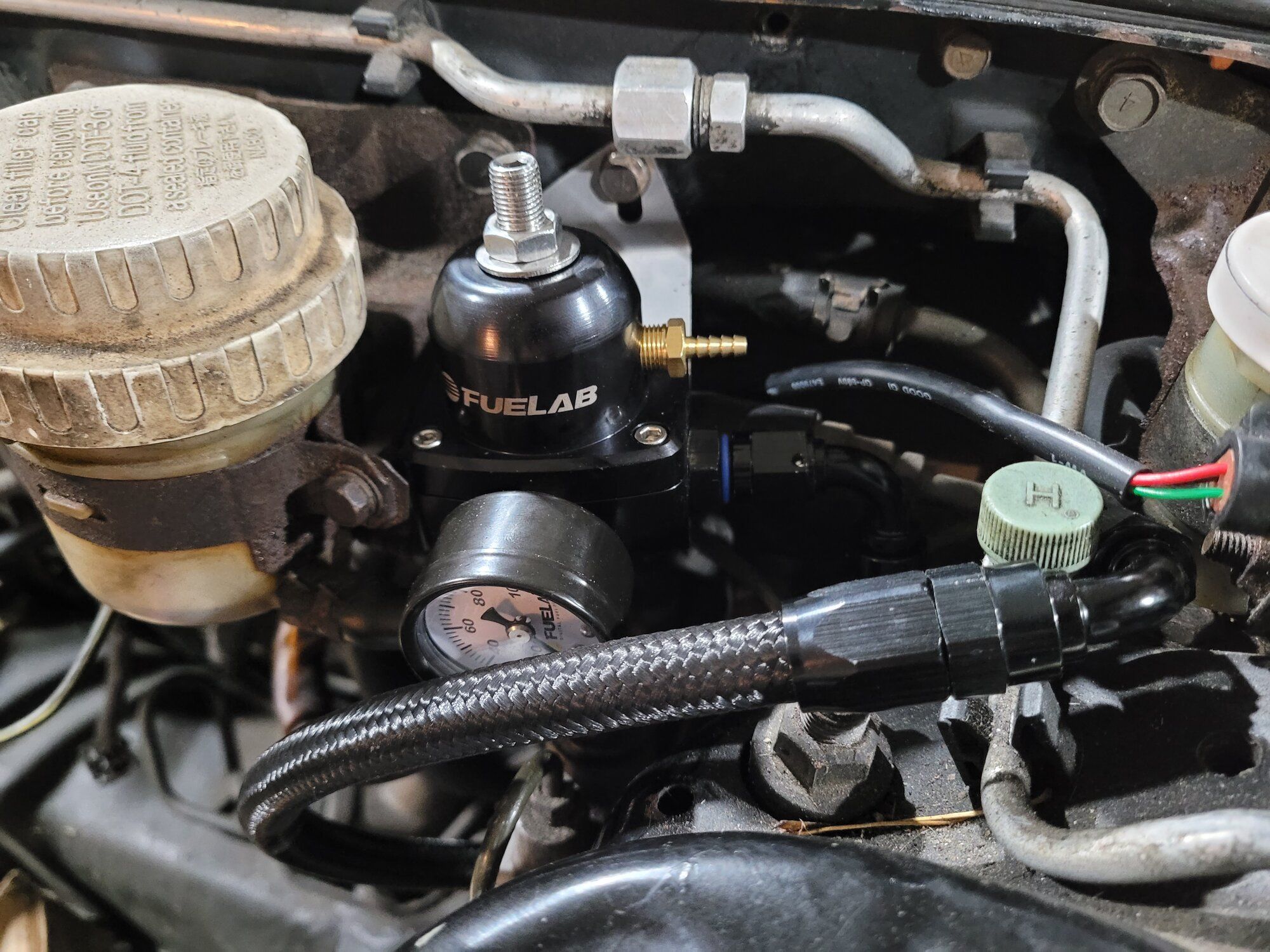

I've installed my 255 lph pump. Unfortunately, ran into an issue with the stock pump hanger, making it impossible to install the pump. I've swapped it out temporarily as the hanger I bought doesn't have a evap sensor port. (Overly excited oops on my part... one click buy be like that sometimes...)

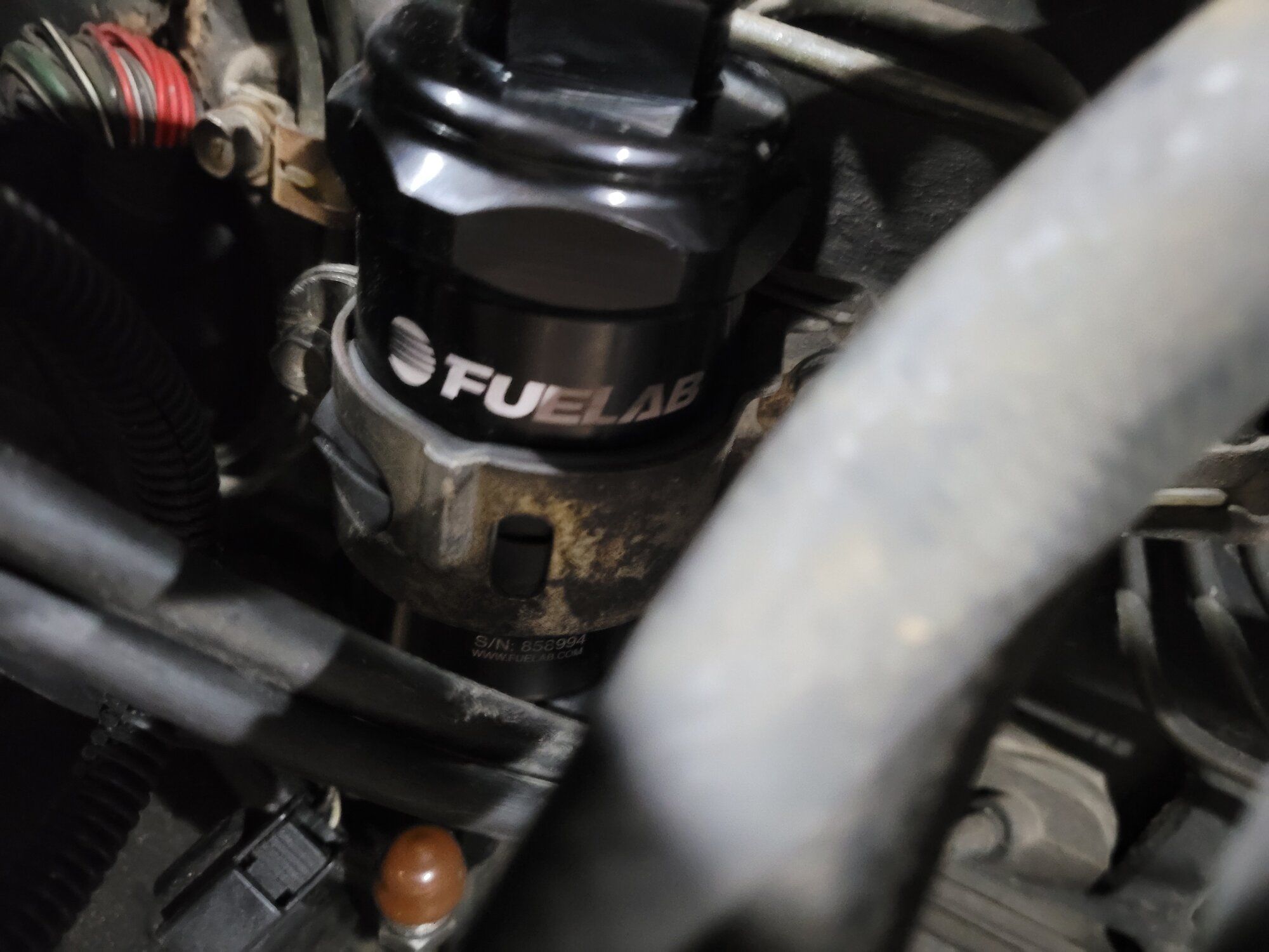

I've also installed the Fuel labs tank to rail kit, with that fancy fuel lab Fuel filter,(it was on sale, couldn't resist. 😅 ) which I managed to fit into the stock location. and a fuel labs AFPR.
I also have the wiring for my boost gauge, oil pressure Gauge, and wideband O2 gauge run, I just haven't tapped them into power yet.
