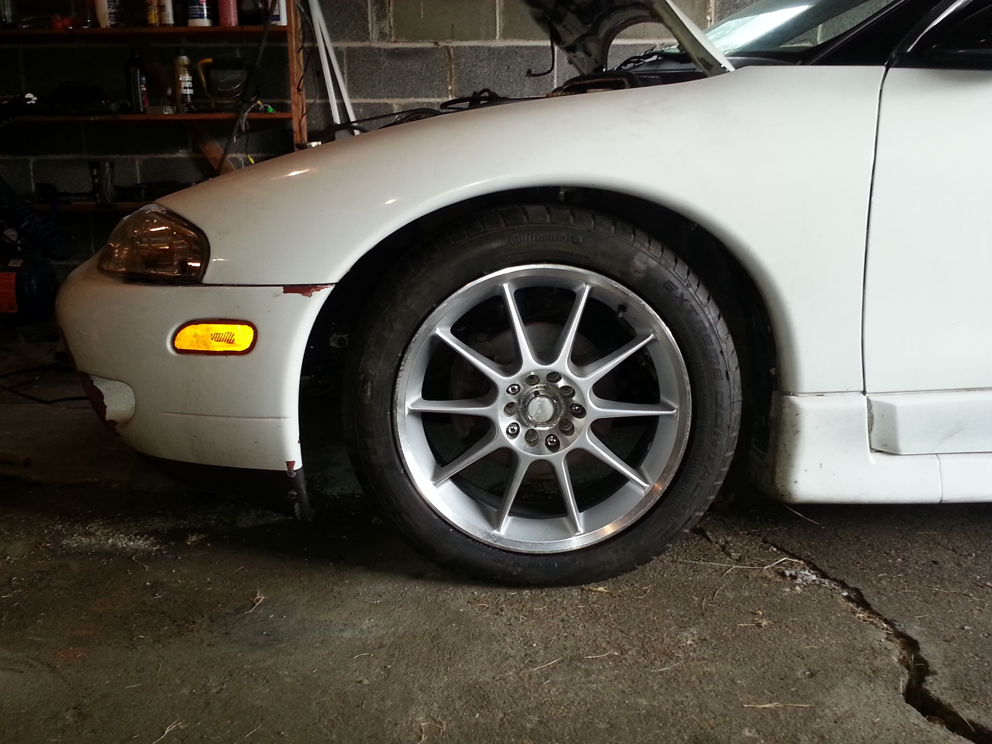

Got my new wheels and tires installed. Primax 618s with Continental Extremecontact DWs. Size is 215/50/17.
