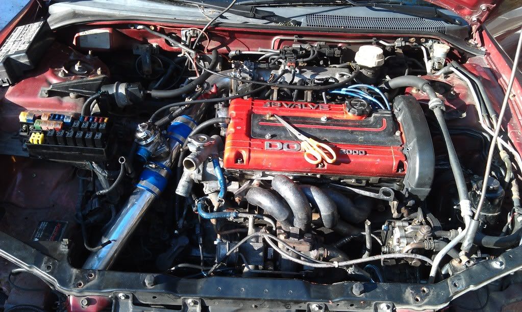

Now on to the new build, I bought this off of a kid from my high school for 500$, He thought the transmission was gone and I said for 500$ it would be worth the parts at least. Has 113,000 miles had some bad boost leaks and exhaust leaks when I first got it.
This is what it had done when I first bought it.

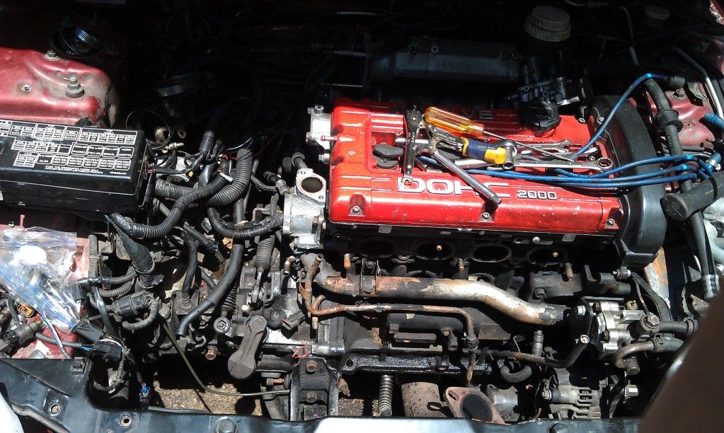

Here is the state of her when I first got it.
After looking it over we realized that it was just the sifter bracket that was missing two bolts hence why it was stuck in fourth gear! It also only had RWD but that was just because the front CV bracket was not bolted on.. This might have caused some rear end damage but I haven't gotten it to a lift yet.

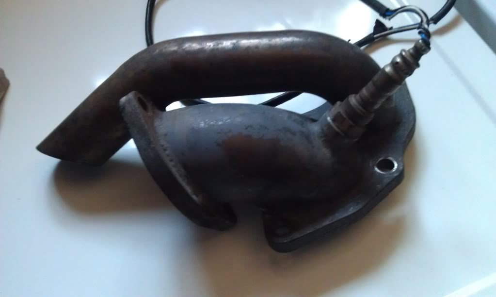

The next thing was getting the exhaust leaks and boost leaks all fixed. It had some fitment issues with the FMIC the way the owners before had done it so I put on a spare on I had and it fit much better with the bumper and support. Next was replacing the head to exhaust manifold gasket where there was a huge leak making the car run like S**t. We found out that one of the head studs was broken once this was fixed it ran a bit better once it gets some new gas it will be back to normal. I'm going to first move up to a 16g and then to the hx-35. I got an amazing deal on a open dump so I decided to throw that on the ole t-25 for now.
It obviously didn't make a huge difference in power but the sound of the exhaust is a great tone and cant wait to get it on a bigger turbo.

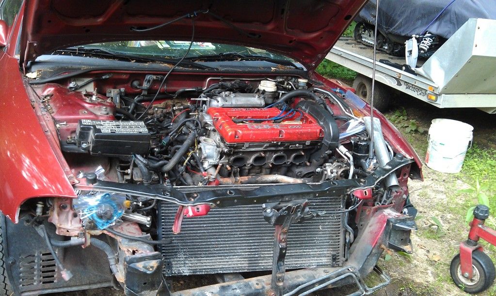

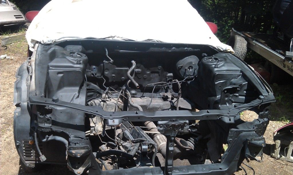

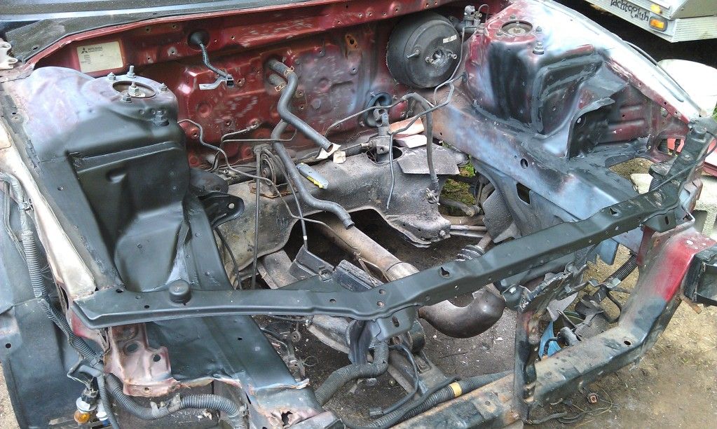

Here is some of the progress with everything taken out nothing much I didn't think I was going to be making a blog so I didnt take many pictures.

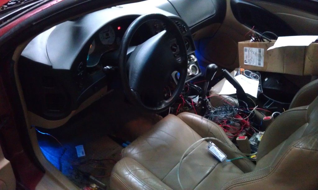

My next project was to get a push button start system going with two flip switches and a push button to start it.
This is what I have so far and they both work flawlessly, but the push button is not working yet. I need a relay so I can get enough power to it to turn the car over.

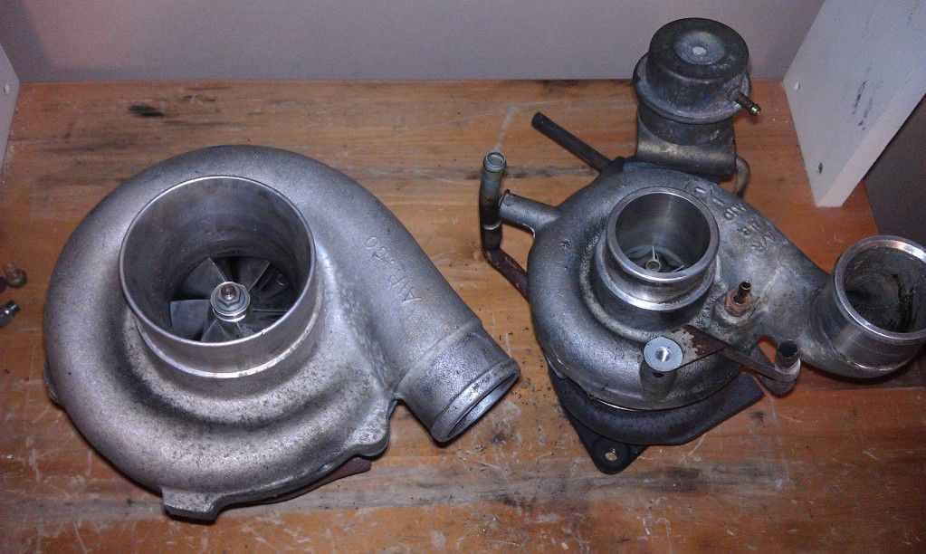

Here's the PTE compared to the t-25!

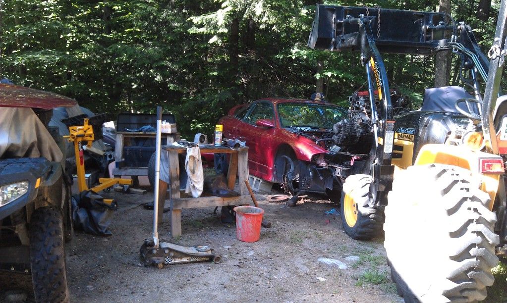

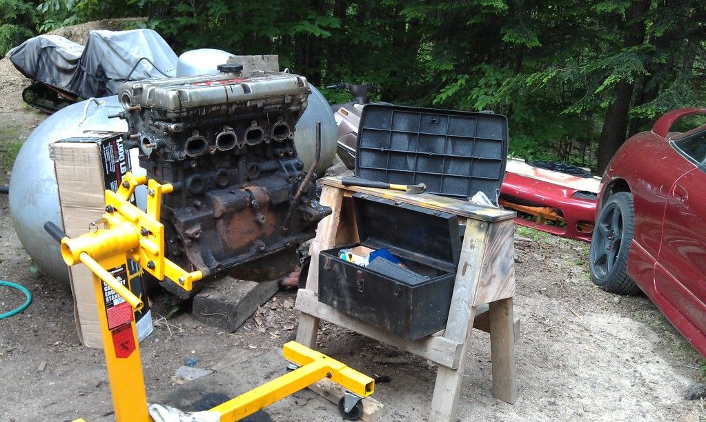

Starting to get the 7bolt pulled out
Closer!
The 7bolt should be pulled next week when I get some more time to detach the shafts.

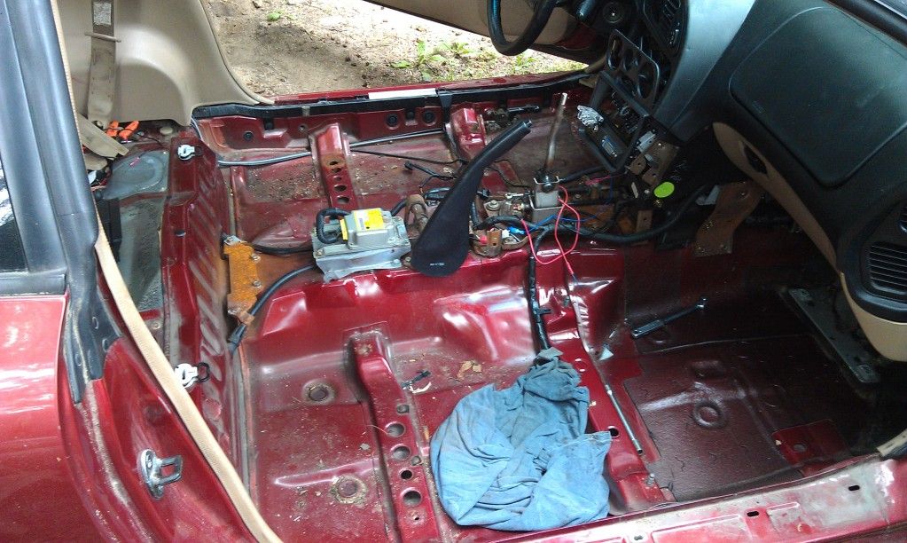

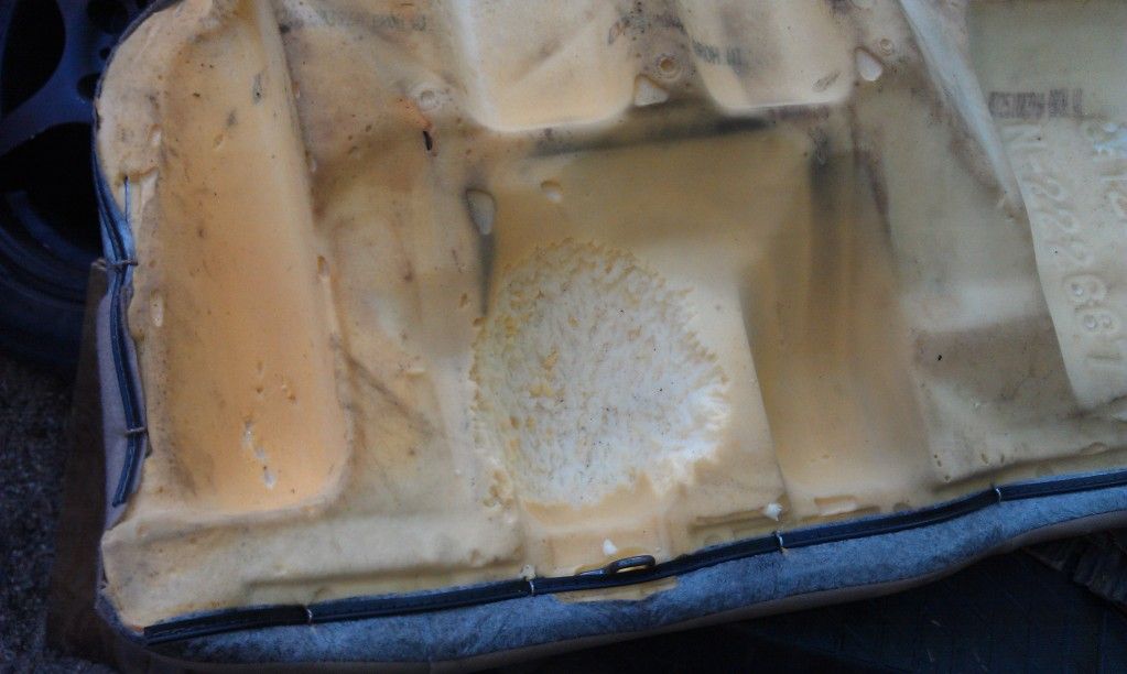

Doing some weight reduction taking out all the sound material and any unneeded brackets and luxuries

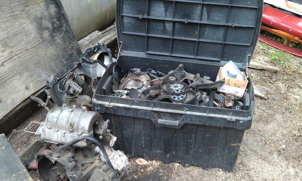

Here is the 6bolt that I will be rebuilding
All the parts from the 6bolt!

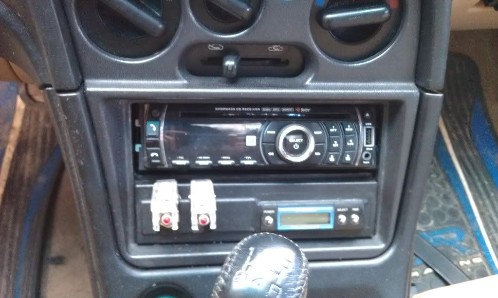

I like the custom single DIN mount for the turbo timer, howd you make that!? Regard your DSM looks great!
Thank you! its actually something my buddy made with the turbo timer part. it is just supported with a small metal plate in the back and the front was just black epoxy. Im not sure where the single din thing came from though.

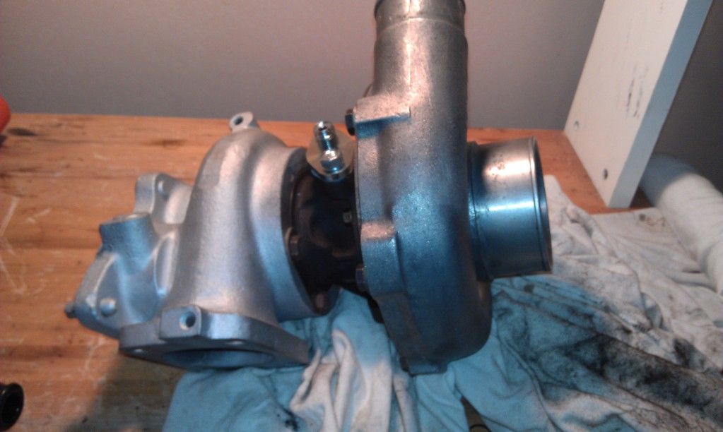

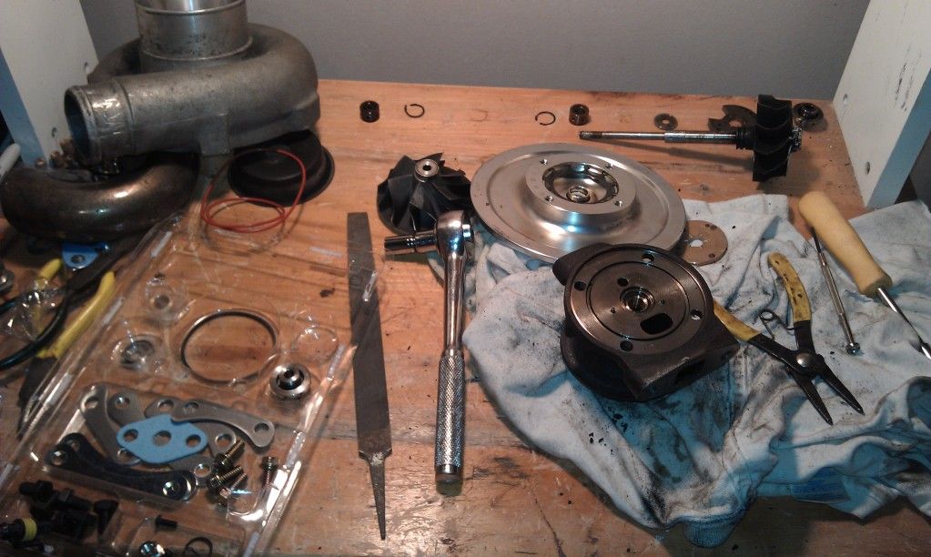

I also rebuilt my PTE 3431E and it came out really nice!

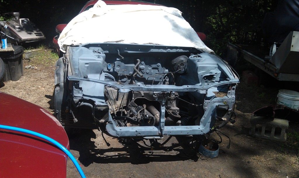

Motor is out
Prep
Primed
First coat

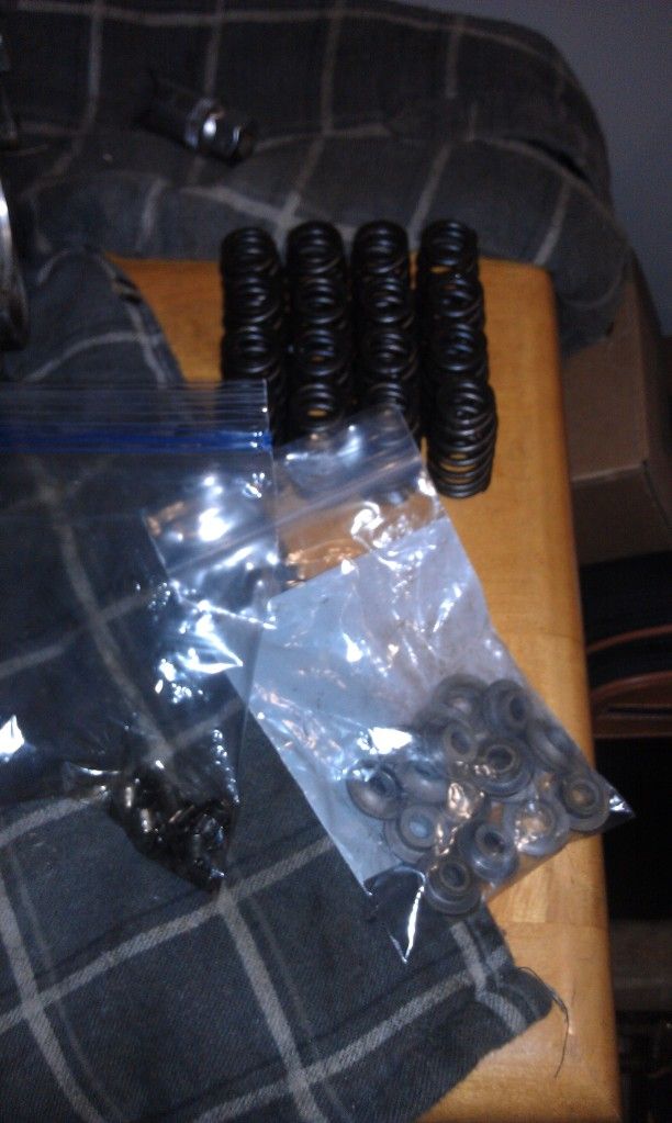

I got the old S&R out waiting to put the evo 8 beehives in tomorrow and have the cams to follow on Wednesday

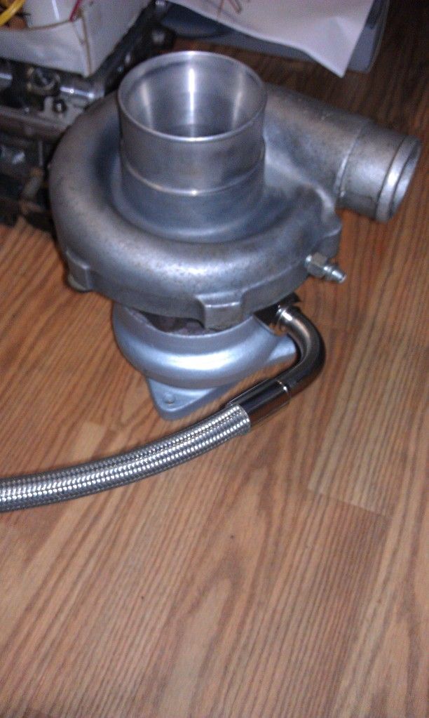

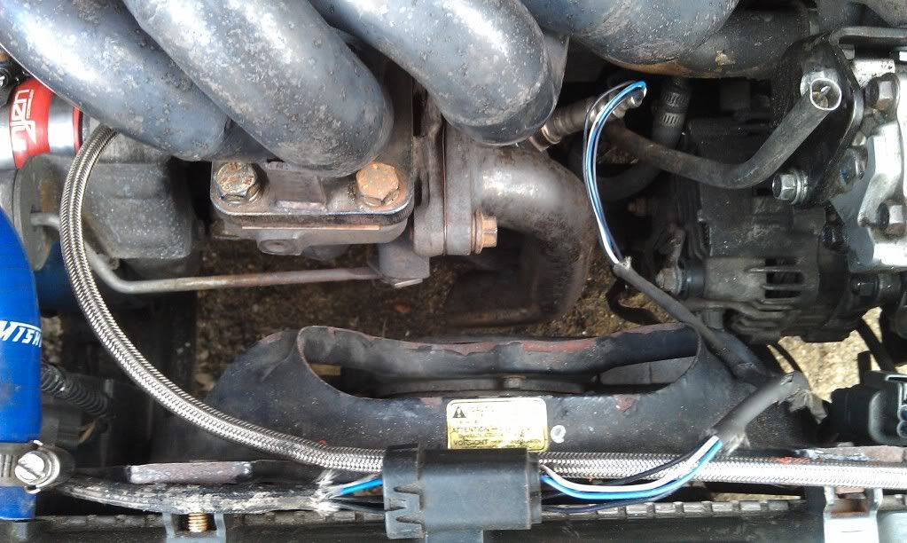

I also finished my turbo I got the oil feed and my new -10An drain line in
Thats all today will have some more tomorrow when the evo S&R go in!

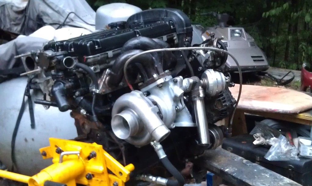

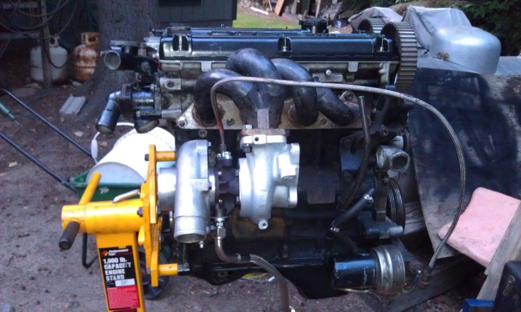

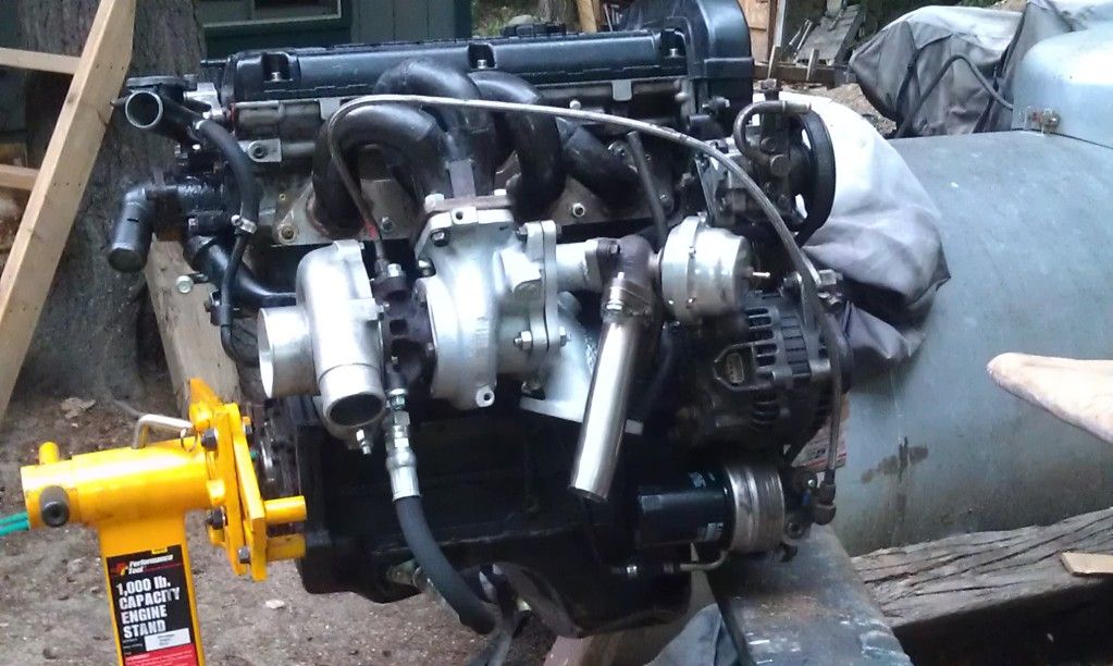

I got the S&R in and the 275 Cams in along with most of the motor built back up!
here are 2 mock of pictures, need to get some new exhaust studs and find my intake manifold bolts and time it and she will be ready to drop back in.

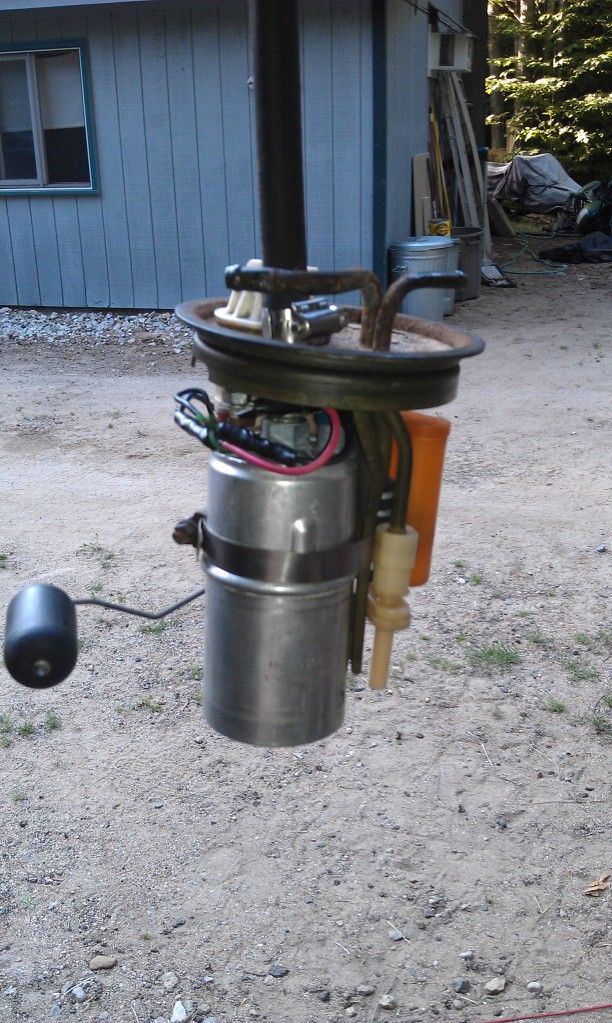

Just a quick update with my fuel pump the bosch 040. It didnt fit in the tank so I had to custom fit it.
Here's what I came up with...
I had to drill out the normal line that comes to the FP, this is where I pushed the top 2" of the Bosch out and just hose clamped it to the side. Looks kinda sketchy but I think it will work out!

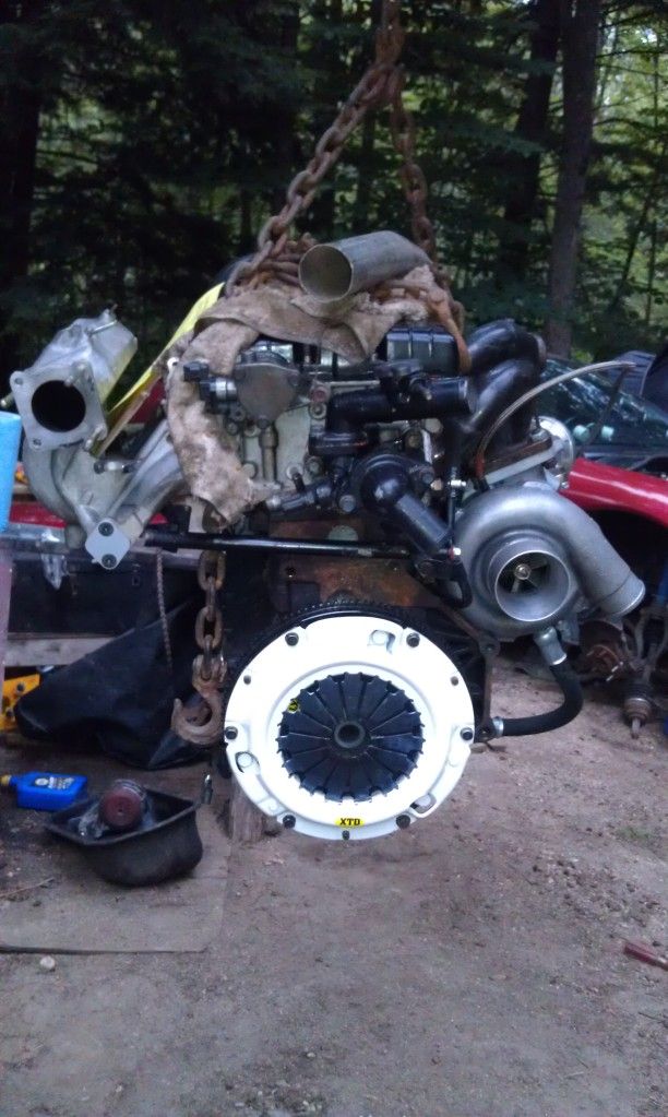

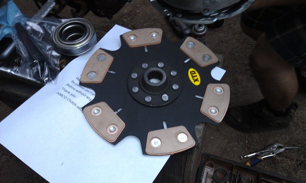

Here is the stage 4 xtd clutch brand new with a act streelight flywheel
all bolted up

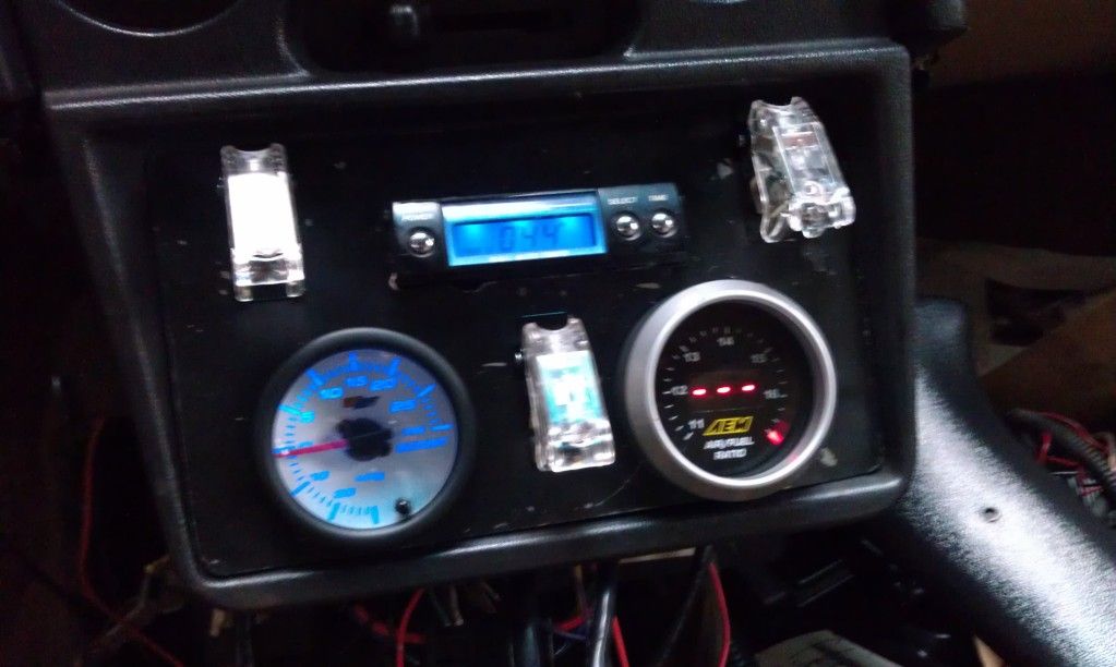

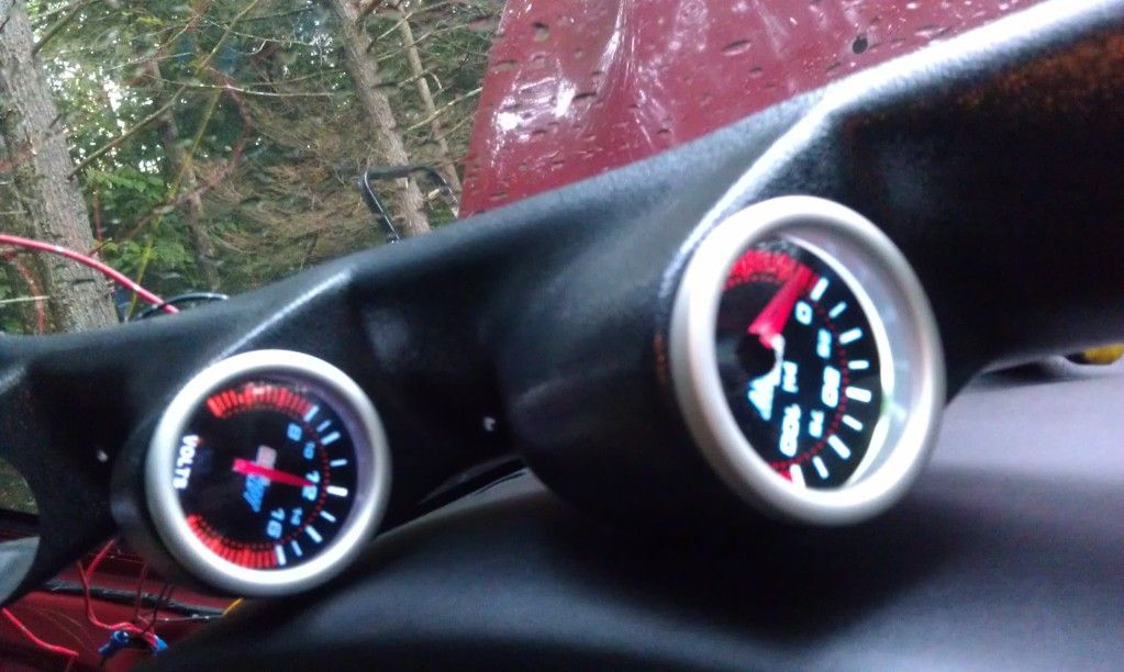

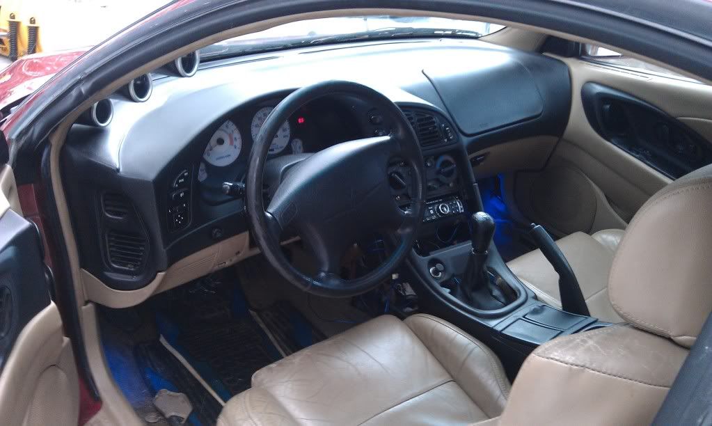

Interior is a mess! trying to get all the gauges wired up
The custom center gauge cluster that me and a buddy made. The switches are going to be for ignition and the center will be for my dual stage boost controller.

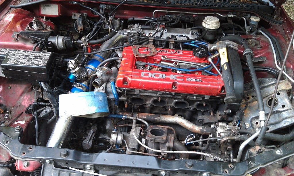

And here is the engine bay...
It was all back together and SHE RAN! The 275 cams sounded really aggressive and everything ran nicely! Then I went to do a BLT... I had leaks from every where and have been tracking them down for almost a week! I have it down to the throttle body area but I cant seem to find where it is coming from even with everything there being rebuilt with new gaskets. That's the only thing holding me back from driving it now and I hope to have it finished very soon so I can take it to the track before I leave for school!
