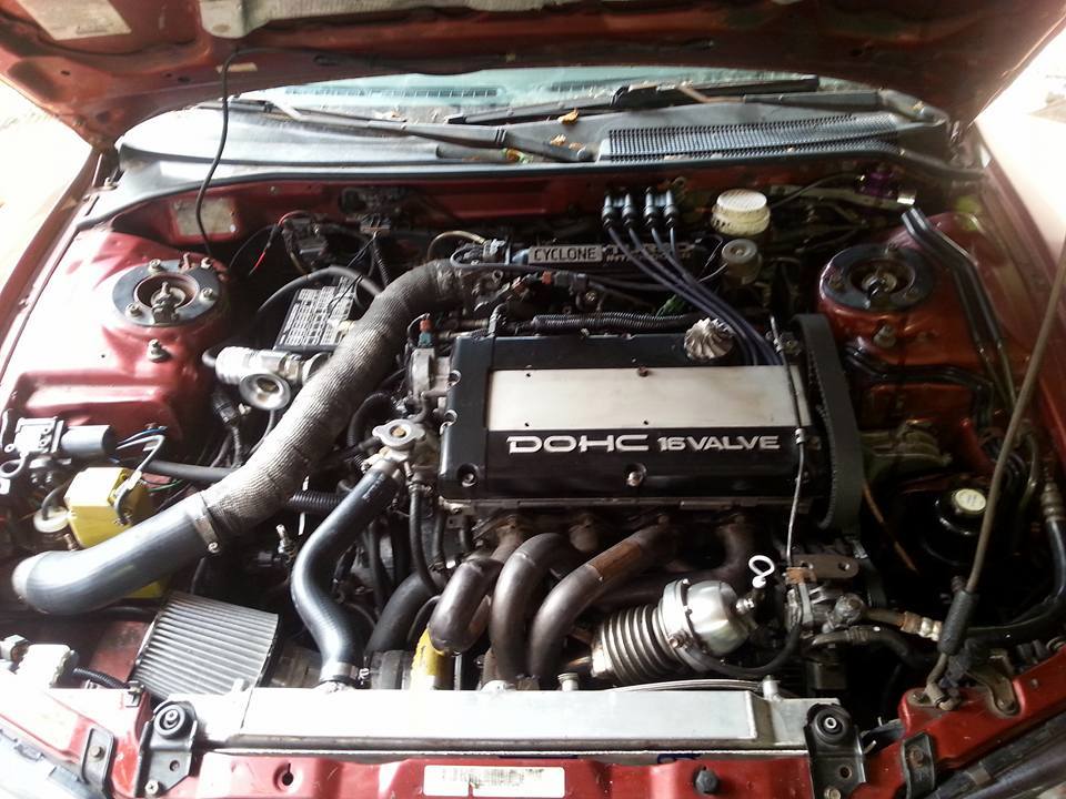

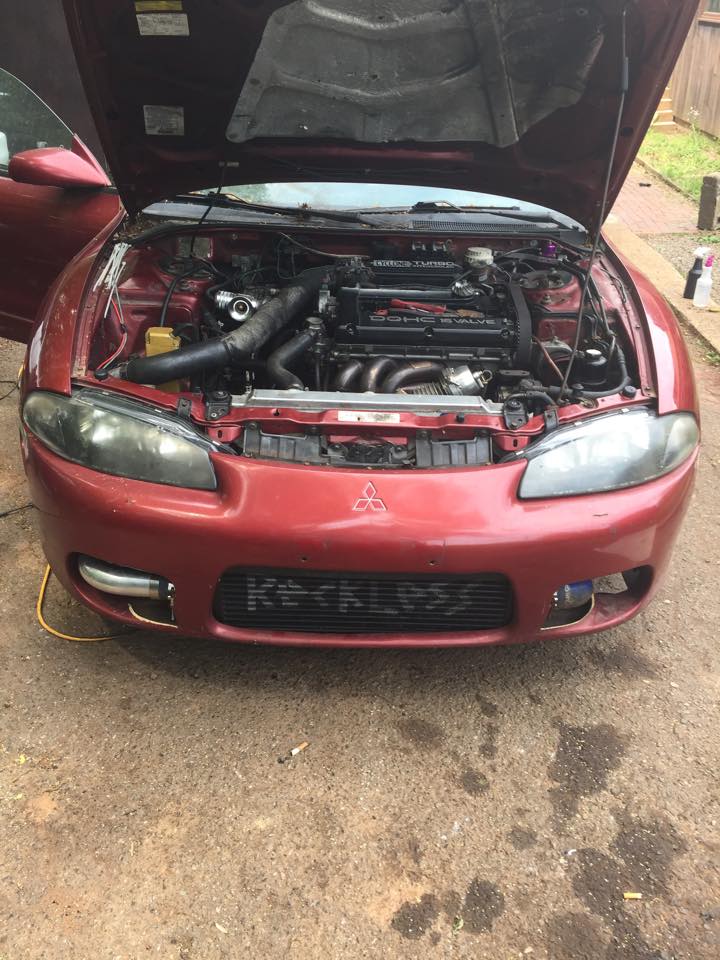

1997 "Reckless" Eclipse GSX Awd
Trans- Auto- stock- with stock trans cooler
Motor- Stock 7 bolt 4g63t bottom end and stock 1g 7bolt head
Suspension- Stock
Mods-
F.I.C 650CC injectors
Walbro 255 with Adj FPR
Cyclone intake with butterflies using 14b waste gate activated under boost with 1g throttle body 2g TPS
Holset H1C
F.M.I.C short ran.
Fluidyne Radiator
Plx dm6 wideband
4 bar omni gm map and gm iat from Extremepsi.
1G BLACK TOP CAS
98 Gst black box ecu
FULL 3" with High flow cat-to stock Srt4 dual tips
Rear o2 anti-fouler

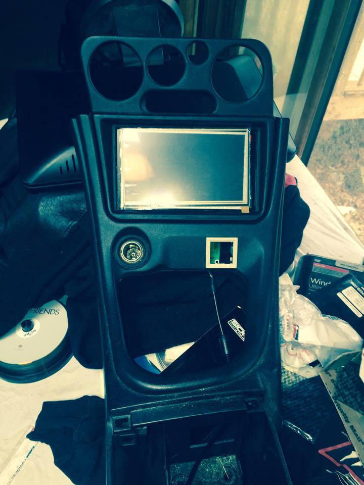

Interior Mod-
Digital Boost gauge and PLX dm6 touch screen Afr gauge in Vent above heater controls
7-inch touch screen monitor running VGA with Hp mini laptop located in glove box.
Rewired Pioneer 4 channel amp in stock amp location wired to laptop.
This works as radio- with internet capabilities for GPS-Pandora-Internet feeds- etc.
As well this allows for EVOSCAN and Ecuflash to be installed and used from within vehicle.
