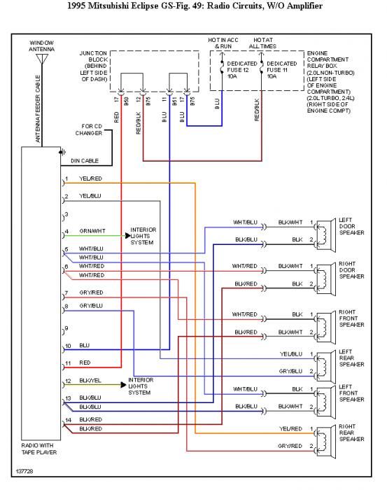

Hello everyone, I have been trying to install a Pioneer head unit by splicing in the wires. I have searched high and low and found a few diagrams and posts of the radio wiring for the 96 coupe and none of them seem to be the same as what I have. Does anybody know what these exact wires power? The only wires that I have in the radio harness are as follows:
Blue
Yellow/Red
Black/Red
White/Red
Blue/Yellow
Gray/Blue
Green/White
Black/Yellow
Gray/Red
White/Blue
There is 2 more which are not striped. It's a solid white wire with gray lines across, and a solid red wire with gray lines across. Like I said, these are the only wires that are there. I'm not as good with the electrical as I am with the mechanics and just need someone to give me an idea of what some of these wires are. Thank you!
