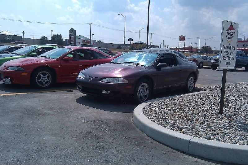

first meet

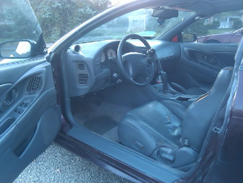

Fruity interior. I dont know what would posess someone to paint a grey interior red and black.

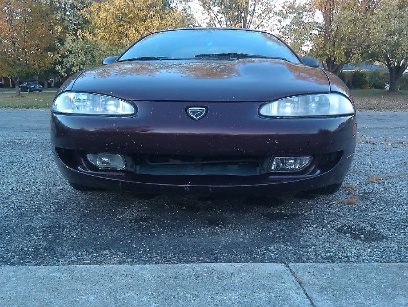

Broken foglight. You know how hard it was to find just one foglight to replace it?

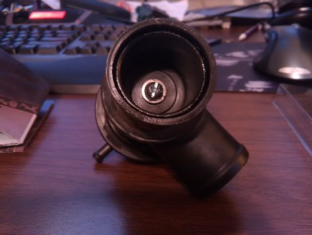

plastic BOV mod! I found a thread here somewhere and decided to attempt it, it helped but the valve still leaked.

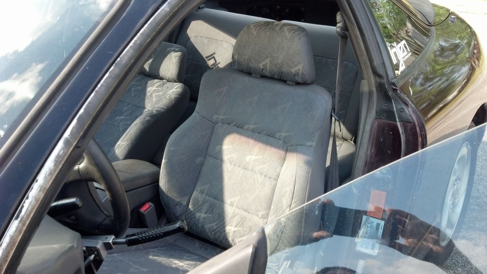

Here's one of some new seats i got in the Junkyard for 50 bucks. After this and a thorough scrubdown, it made the car look MUUUCH nicer inside. Huge difference.

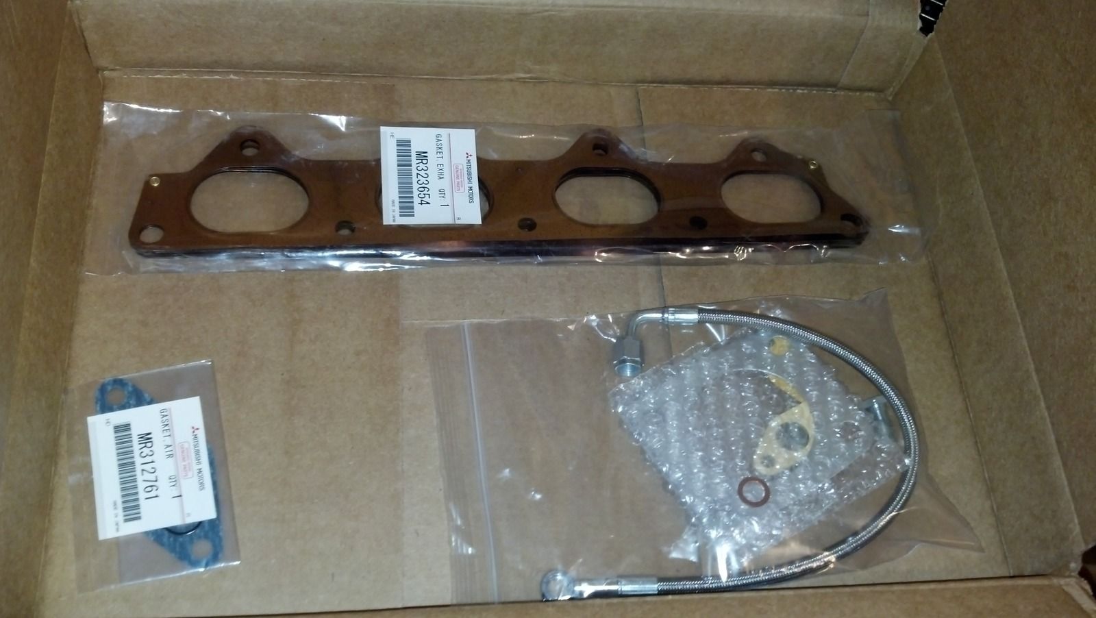

Goodies ordered to put the 16g on

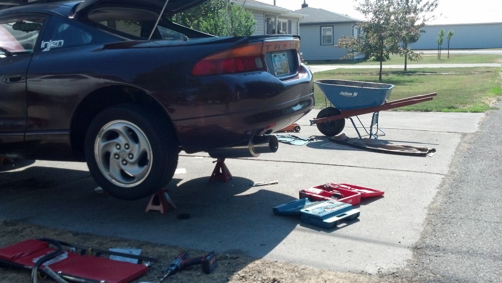

Working on the new Exhaust and IC. I also put new upper window moldings on, almost pristine ones at the junkyard for 15 bucks!

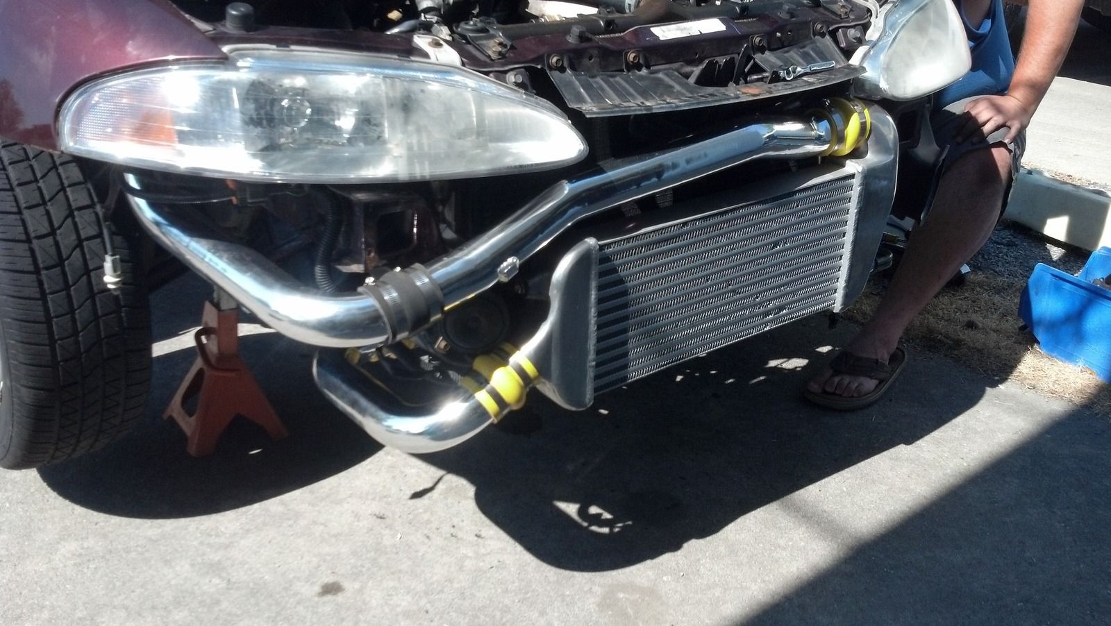

Intercooler finally on. It sucked because the guy i bought it from bent the brackets all up for some reason, and we had no vise.

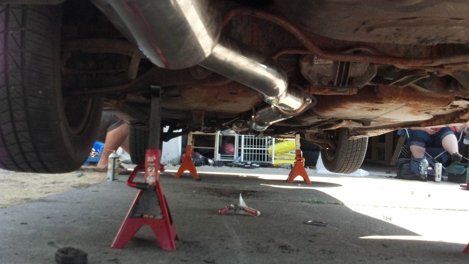

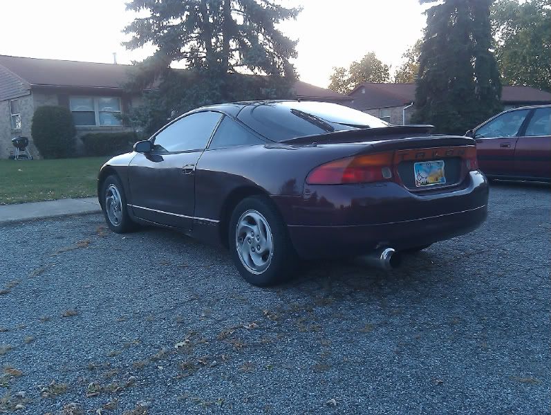

Shot of new exhaust. It fit pretty well, except that I forgot all the bolts and gaskets at home and had to go to NAPA to get more, it was a long drive home.
