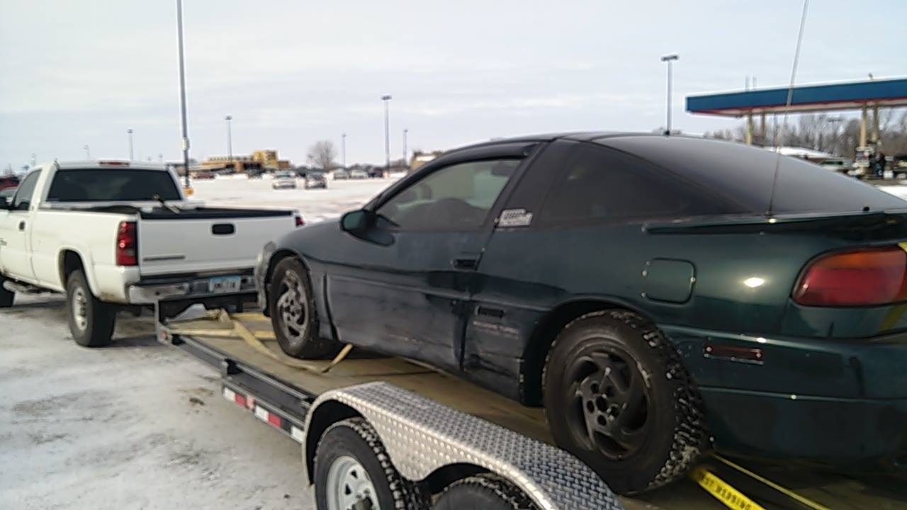

So I picked this up. 1994 Eagle Talon TSi AWD 5spd. I overpaid a bit honestly for it, paying $3500 considering it had a fairly decent bucket list of problems including terrible idle surge, needed a tune, fuel tank & sending unit issues, a ton of hack job fixes, terrible rear battery setup, lots of shit wiring from both age and poor decisions from a previous owner, boost leaks, and a improperly installed MLS headgasket (was not prepped properly) that was leaking. (Lots of these issues I did not recognize when I looked at it, it was -45 degrees when I picked it up and I couldn't stand to crawl all around it.. my fault). My main reason for buying it is that it was clean and my favorite 1gb color. Also that it had a rebuilt motor and trans (supposedly, unconfirmed but as clean as both were I believe it). The guy I bought it from did tell me about some of the issues - the main ones I did not know about were the headgasket, bad wiring, and the fuel tank studs all being trashed. Overall he was a decent guy, can't fault him I suppose cause I'm not sure how deep he ever got into this car since from what i know it was just a bit of a 2nd car to him.
Hauled it home, wasn't sure if it'd make it back on its own with all its issues. Picked it up New Years day. Was from Minneapolis (6 hours from me). Original goal was to just fix it up, do some appropriate mods and run 12's on the 16g and keep it reliable. Ended up doing better than I expected in the end.

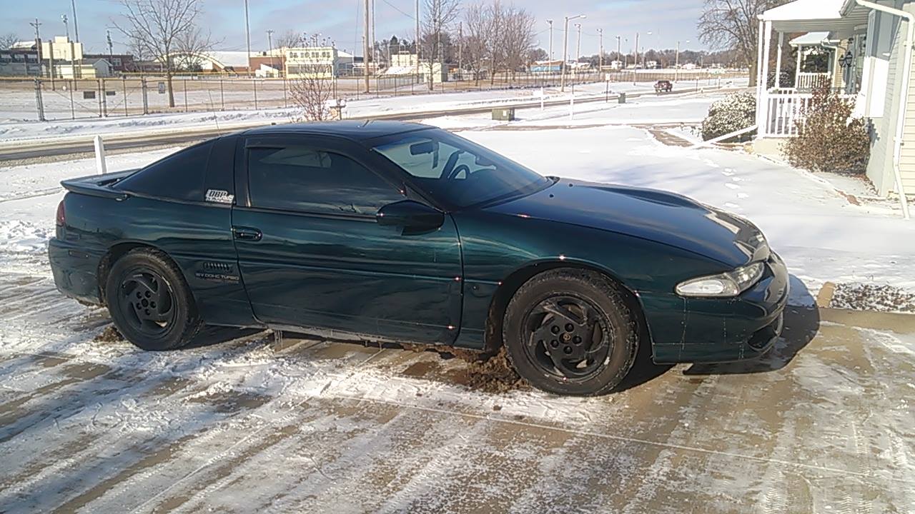

After getting it home, immediately started doing maintenance and trying to sort out issues. Mainly fixing boost leaks, tried to brush up on my ecmlink skills from years ago and got the car tuned to the point it was decent to drive. Tried to find the idle surge issue but just could not figure it out. New sensors, boost leaks fixed, throttle body rebuilt, and still she surged.
got it cleaned up decent though

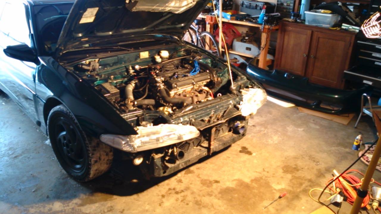

Made it back home May 9th. My goal was to finally tear into the car to do the headgasket, fresh timing, fix more wiring, and some other maintenance to have it ready for the track May 23rd. I wasn't going to work on it til the next weekend, but luckily Sunday night on May 11th I got bit by a boredom bug and went out to the garage at midnight. An hour later she sat like this.
Doubt the car was ever run on e85 before, and running on it cleaned out the fuel system and gunked up my injectors. Fuel filter is a strainer made for fuels like e85 so it was easy to clean and throw back in.
Injectors were terrible, a buddy has a flowbench and cleans them for a side business and did mine for a good price which included all new seals. Said he didn't know how my car even ran or drove decent with the shape they were in. Perfect shape now.
Only spent about an hour on it that night. Then the next few days I was pretty swamped and didn't get to touch it. Finally after about 3 days I had time to work on it and finished pulling the head.
New OEM headgasket on, ARPs torqued down
Getting it more buttoned back together with the new timing hardware and timing belt, and also picked up a Mishimoto radiator with mishimotor slim fans for $50 from a buddy to replace my beat up jbweld trashy stock radiator.

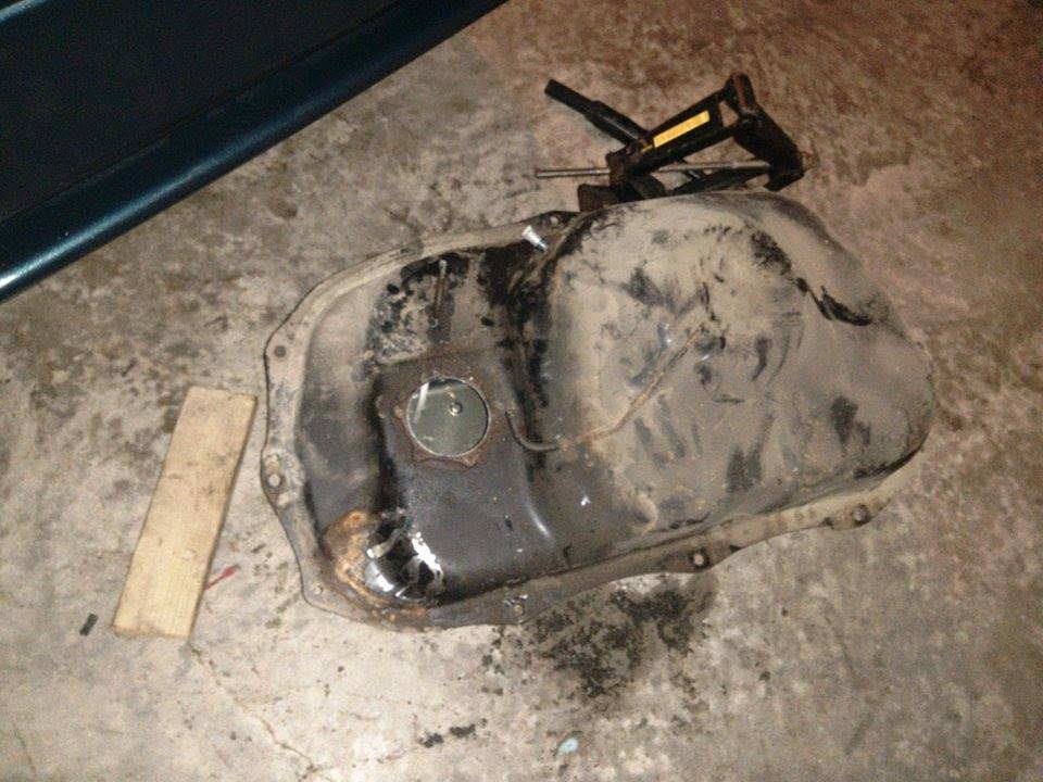

Then with the car getting close to empty, I went ahead and pulled the tank out since it has needed re-studded since I bought the car. Will be nice to finally be able to fill it to full without it shooting out from the sending unit and then leaking when i take corners for the first 50 miles or so on a fresh tank. Also tackled the tank with some degreaser and simple green to clean it up from 20 years of grime. Pic is before cleaning it at all.
