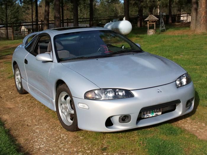

1995 Eclipse GSX 5spd 133k. Ran rough and wouldnt idle without holding the gas down. Mainly stock at purchase other than front strut bar and unidentified aftermarket bov
Day 1 - Got it home on a flatbed. $850 car w/ terrible paint (painted 3 times). $125 tow.

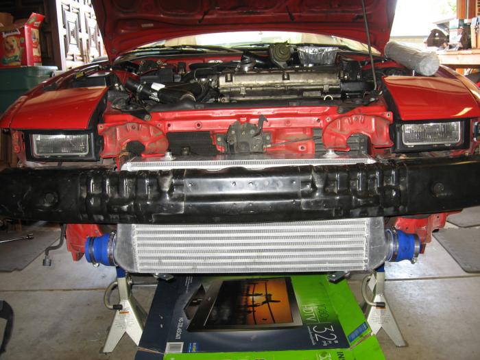

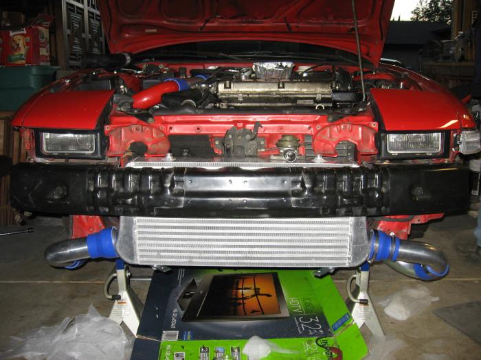

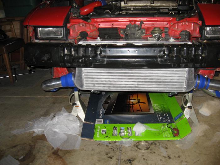

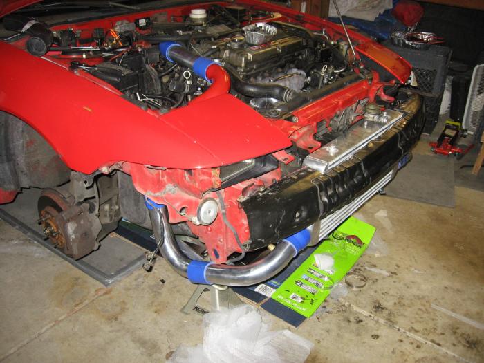

Day 8 - Removed front bumper/headlights and SMIC and SMIC piping.

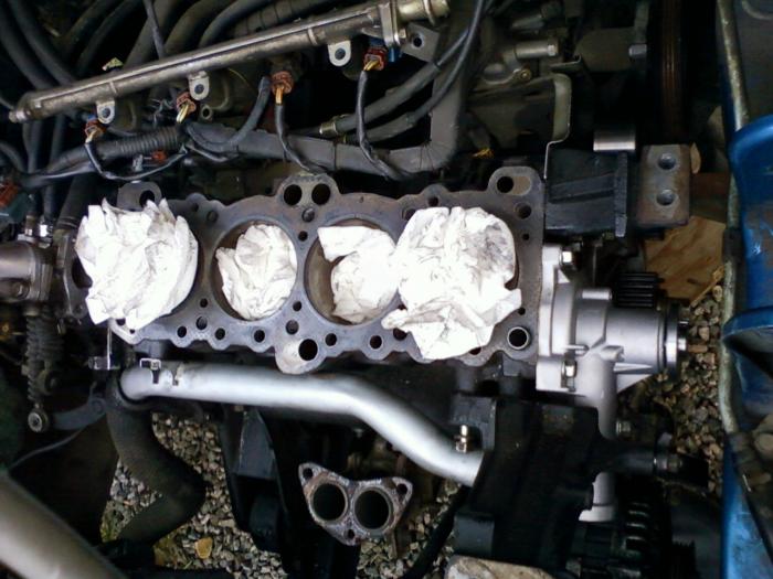

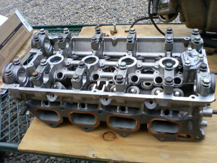

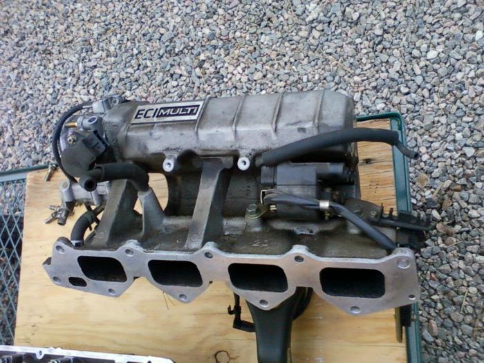

Day 9 - Removed turbo, exhaust manifold, radiator, drained oil. Took quick pics with my phone
Day 11 - Drained trans and transfer case. Removed transfer case and all but one bolt of the intake manifold.
Day 12 - Trans is out
Day 13 - Engine is out

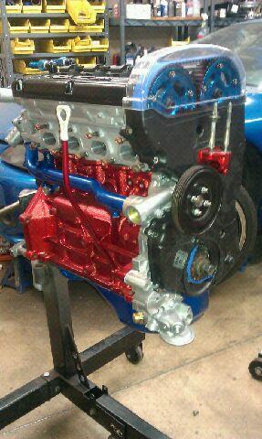

Day 10 - Bought a complete rebuilt 6 bolt w/ appx 98k w/ 14b turbo, 6 bolt fly and oem clutch for $350
