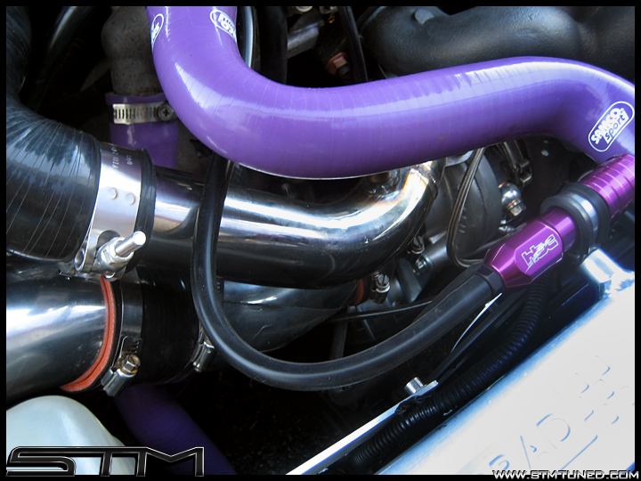

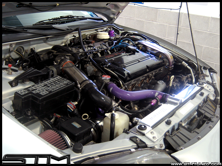

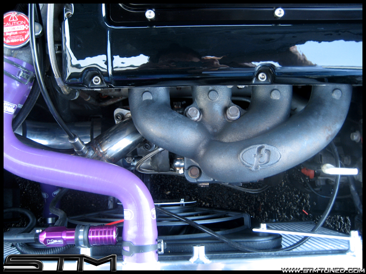

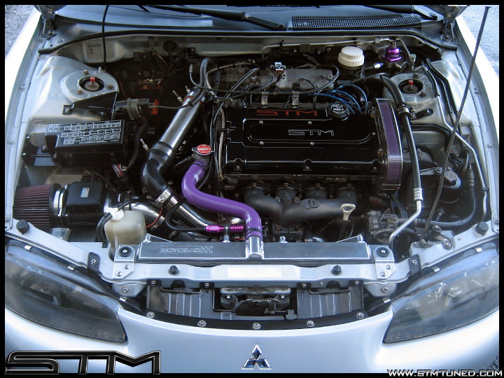

So, yes, the car is tuned on E85. It is running our STM Tank to Rail, and FPR Return Kits with the ProClassic Hose. I've got a little over 1000 miles on this set up. It's got the FP Race manifold and an Evo III 16G.
As you can see, there is no intercooler, no side mount- Nothing!
Emery at STM set it up with an AEM Water Injection Kit and we started off spraying meth, but then switched to water.
We added a Koyo radiator and FAL fan to help keep it cooler.

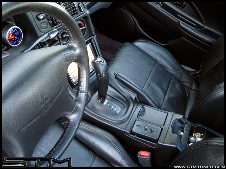

And the Road Surge Auto Shift Kit is absolutely necessary! Without it, full throttle, the car will just pap off the rev limiter- it doesn't shift fast enough without it. but WITH it... it's INSTANT! It's a little rough, but it's not hurting anything. I love it!
Emery has it tuned on DSM Link V2 and I see about 26-23 psi as it falls down. The turbo is just a little guy, so I don't expect too much more.

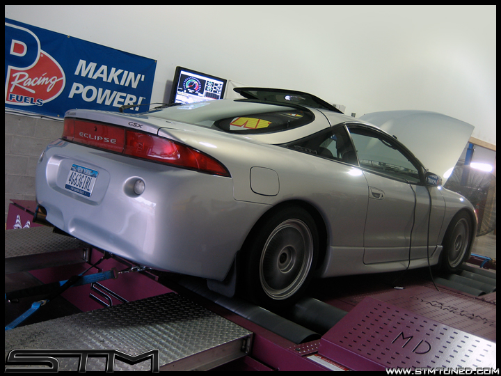

After all was said and done, we saw 100 more awhp over the previous set up (which was basically only a cat-back and Hallman) and the car runs and drives BEAUTIFULLY!
I couldn't be happier and it's only $20 to fill the tank. I've been watching the coolant temps and intake temps and they are all normal, the intake temps are about ambient. He made a carbonfiber shield/air duct right above the STM Transmission Oil Cooler to split the air so the air filter does not get all the hot air off the cooler and help direct it to the engine compartment.

Oh, and here's a video of the car on our dyno.

The car saw 250 tq and 250 hp. It's a little faster on the highway than a lightly modded STi and he just ran a 13.0, so if I saw a 12.9 I'd be happy.
The car could be faster, we could push it more tuning-wise, take out the subwoofer, spare tire, leather all that crap, but honestly, I just don't care to.
250 on a mustang dyno through an auto/stock motor/130k+ car that I drive every single day is more than enough for a fun, reliable, daily driver.
And I'm happy. It's good to know I have the fuel/tuning software ready to go, so if I needed to go "faster" all she needs is a 50 trim.

Can you provide more detail as to how the water injection set works? I mean I know HOW it works, what I'm trying to ask is how do you know the amount of water to spray? I'm very interested in your setup. Nice car too...
That is a beautiful creation!! Grats!
On a side note, wouldn't even a stock 2G SMIC setup benefit? I don't see the harm of your IC-less setup (with the water injection and all), but it seems like there's room for it and would surely help cool that charged air more. Whats the thought process on that?
