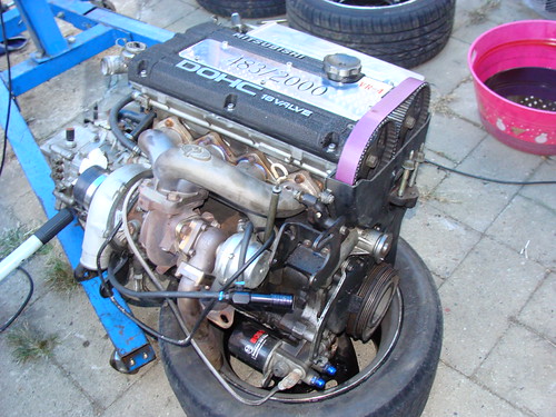

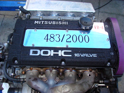

Finally Update!! The motor for the galant is finally together and ready to drop in.
as soon as its back from paint ill be back off JSB been there for the last year.
Specs
2.0 Weisco Pistons
1g rods
BS Removed
Ported head 1mm oversized valves
HKS 272's
Turbo
PTE5031 Dual BB
Tial 41 MM Wastegate
FP Race mani Coated
Intake
Dejon Intake
JMF Race Intake Manifold
Fuel
950 cc Injectors
wally 255
Areomotive Fuel pressure regulator
cooling
Spall fans
ETS FMIC all black
Tial Q Bov
I'm sure there is more im missing.
On to the Pics
With a ball bearing turbo, you might want to run your feed feed line off the cylinder head. There may be too much pressure for the oil seals to hold. Looks good though:thumb:
Looks good man. Can't wait to come back down, have some fun, and watch your car run!
