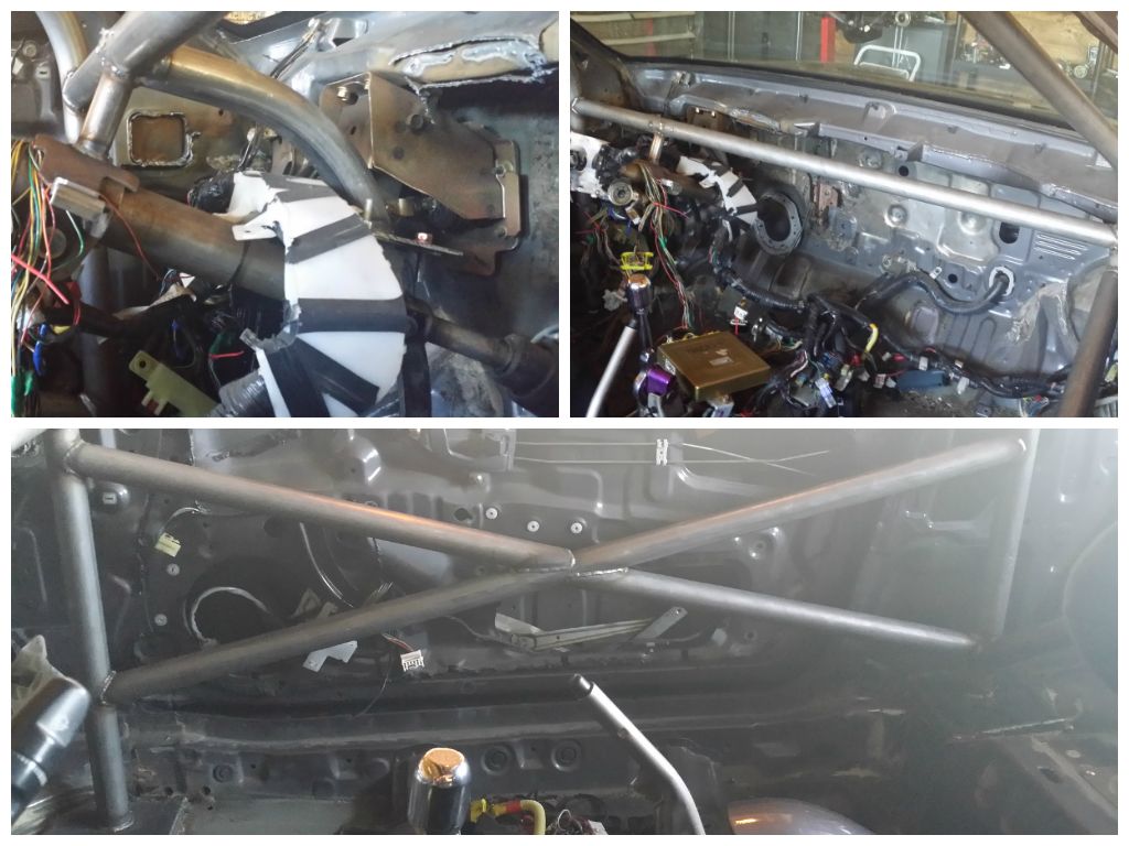

You only have a 6 point roll cage, you need to go to the front shock towers or get a brace like the one a member makes in the forum, sorry I dont know how to link but if you search you will find it.
Do you have an under dash bar if not, you should, also you could mount your steering shaft to it and save a lot of weight.
Do also under door bars from your front hoop to main hoop or floor bar at B pillar.

In the RLTA rules it says the roll cage may not protrude the firewall with the exception for the unlimited class. So I am unable to reach the front shock towers. I have seen the brace that is made by a member of the forum, but he only makes them in batches occasionally. At some point I will be sure to stiffen the front of the chassis one way or another.
I do have an under dash bar and altered the mount for the steering shaft because I had to move it to the left. With the center hump that covers the drive shaft and resonator I could only mount the seat so far to the right so I had to make the steering shaft move to the left.
I was thinking about doing the under door bars at some point. Thank you for the suggestion though.

On the under dash bar and steering shaft, what I mean is get rid of the steering shaft bracket and cover and only use the shaft itself mounted to an adjustable bracket or a heim joint or a pillow block to the under dash bar, dont know if your rules will allow.
Of course no provision for anything else but you will save about 12 pounds.

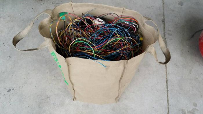

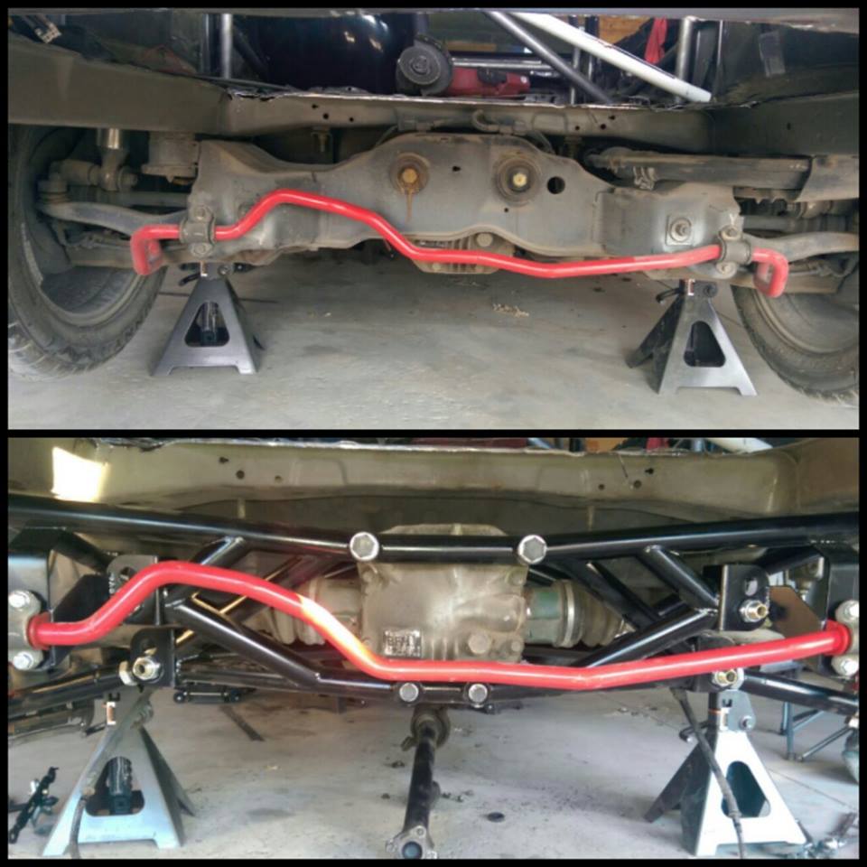

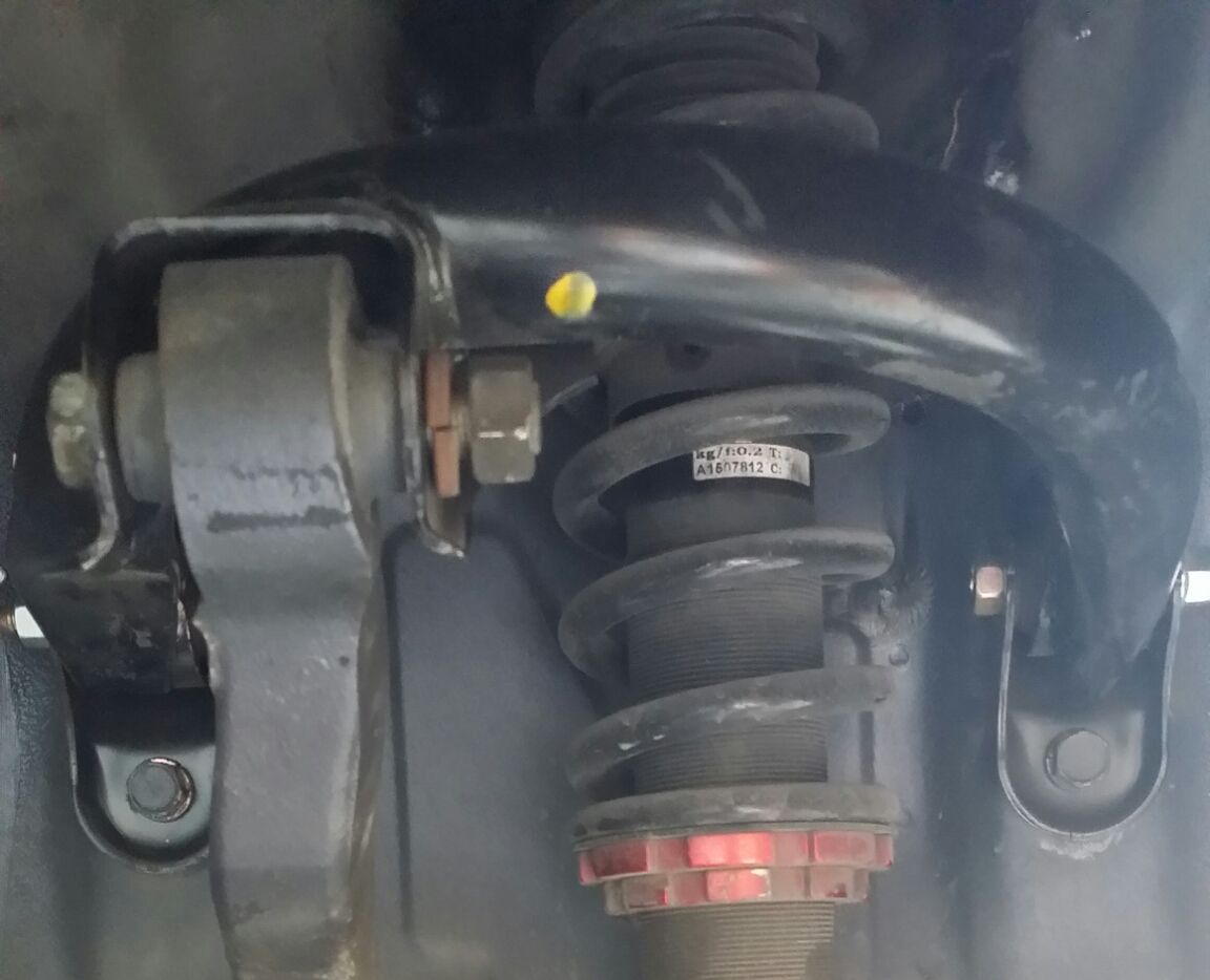

I apologize for the lack of updates lately. My spare time has been consumed by family and other cars. During the time I have been MIA I have mainly been working on rewire, removing 10lbs. This Memorial Day weekend, while I had family visiting, we dropped the original subframe to replace it with the tubular model designed by Paul Volk. Also, removed the fuel tank and replaced the upper control arms with 3g style. A bracket for the new fuel cell still needs to be made before being installed.
