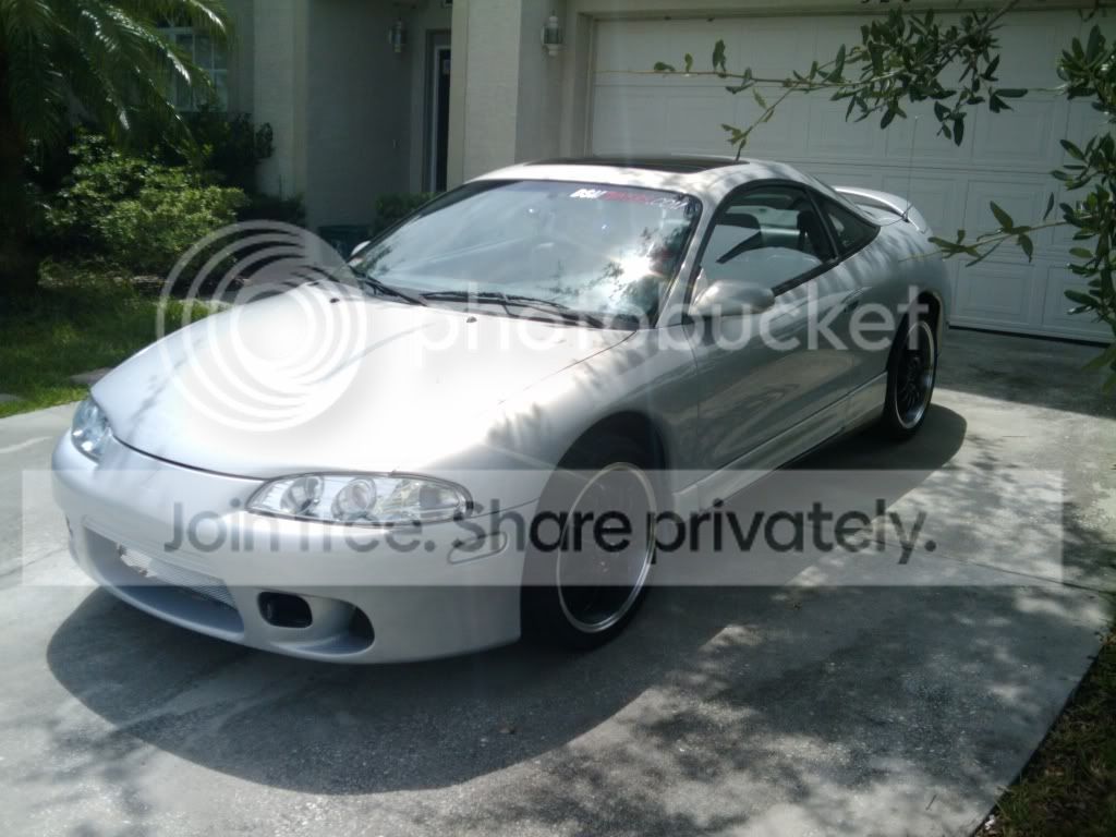

This blog will be about my ongoing DD project. I have a 95 GSX that I bought 4 years ago. 2 blocks later instead of doing a patch fix to get it back up and running I decided to finally do a full build up on it. This was my first car, but since buying it it's had crazy wiring issues, and defective odds and ends.
Anyways, somehow I drove it all the way down from Boston to Florida (where I went to school) after a long @$$ wait to get a new clutch in the car (I put in a 16g after a blown t25 which wore the stock clutch down)

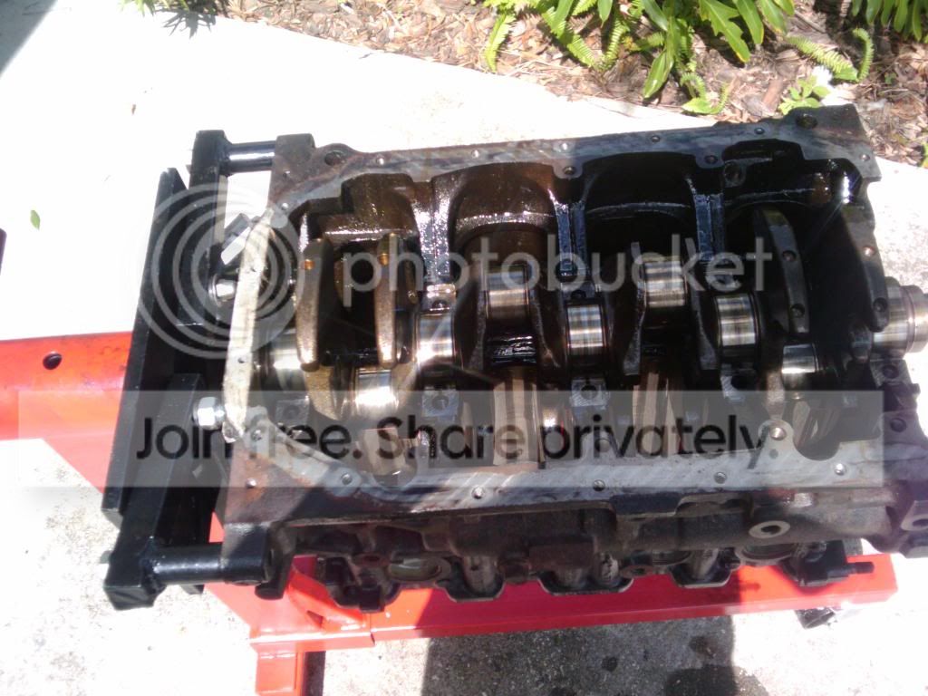

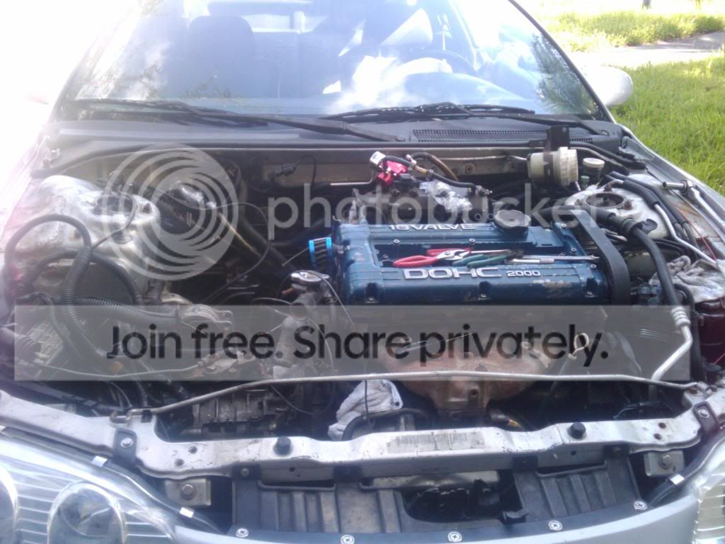

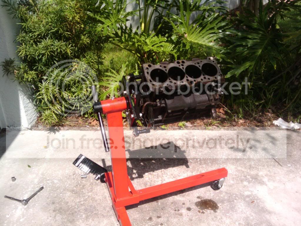

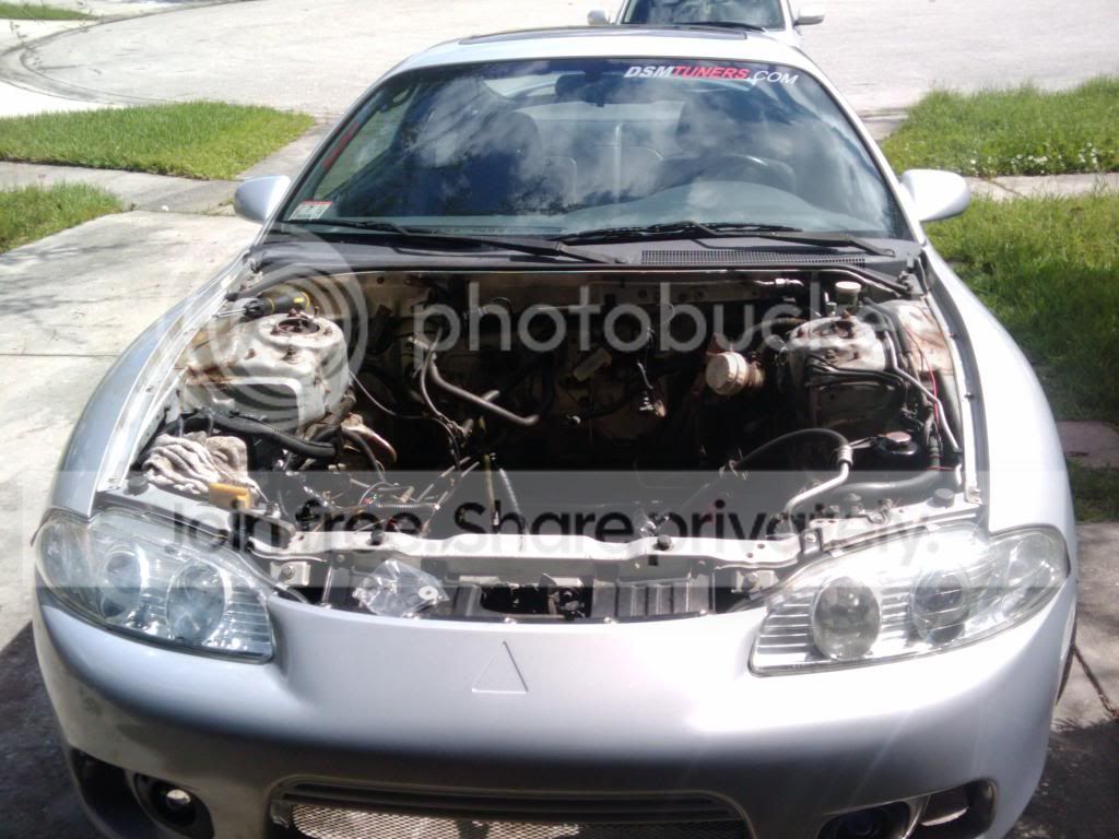

Once I got down here, I continued to have crazy issues, wiring gremlins up and down the car, car wouldn't start, after a saturns alternator it finally got up and running again but then, overheating showed its ugly head to my DSM! :notgood:. So after a new thermostat, coolant flush etc.. the car finally started pushing coolant YAY blown HG :barf:. So now a blown HG has turned into a full rebuild! Instead of replacing the HG with the head off the car, I decided to pull the long block and just about everything else!
before pulling the block
block out of the car with a mess of the hacked wiring harness

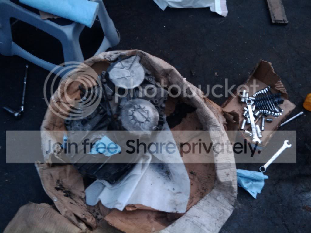

Here's the block getting torn down

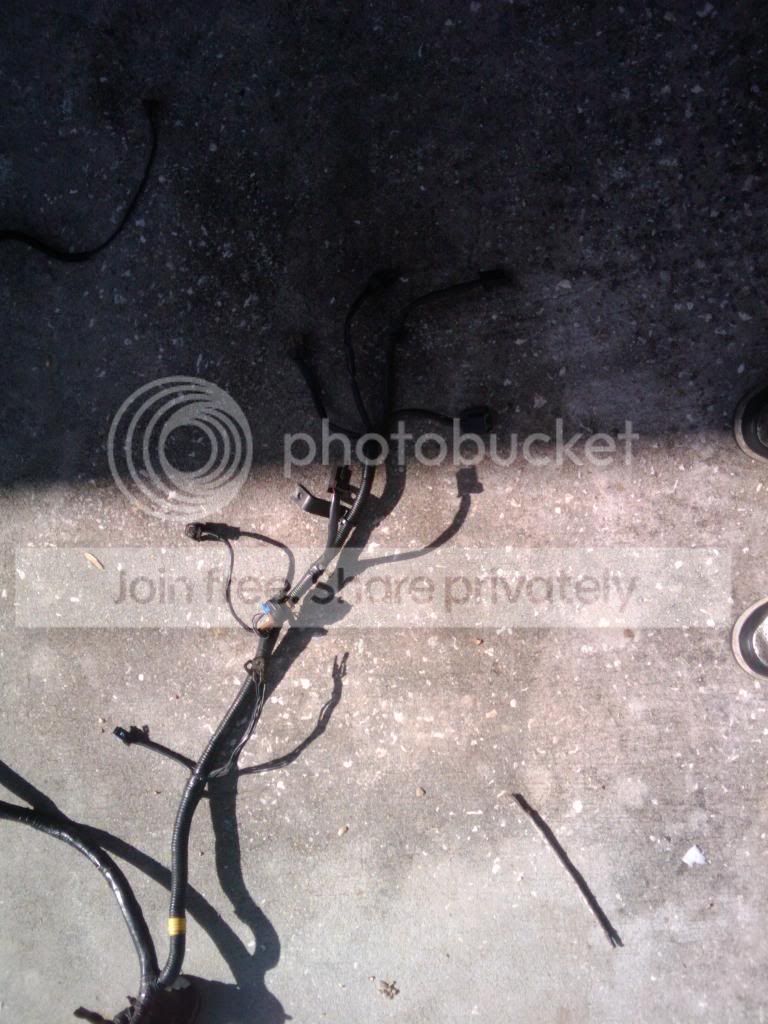

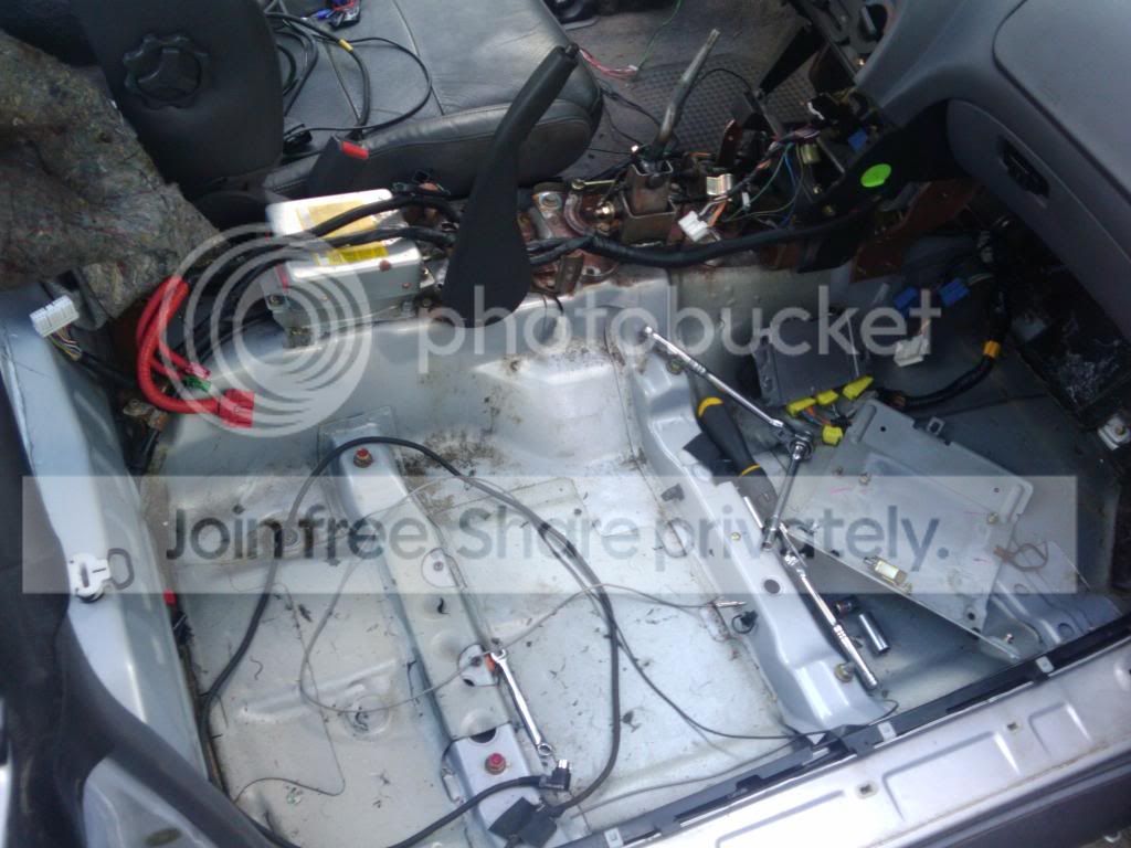

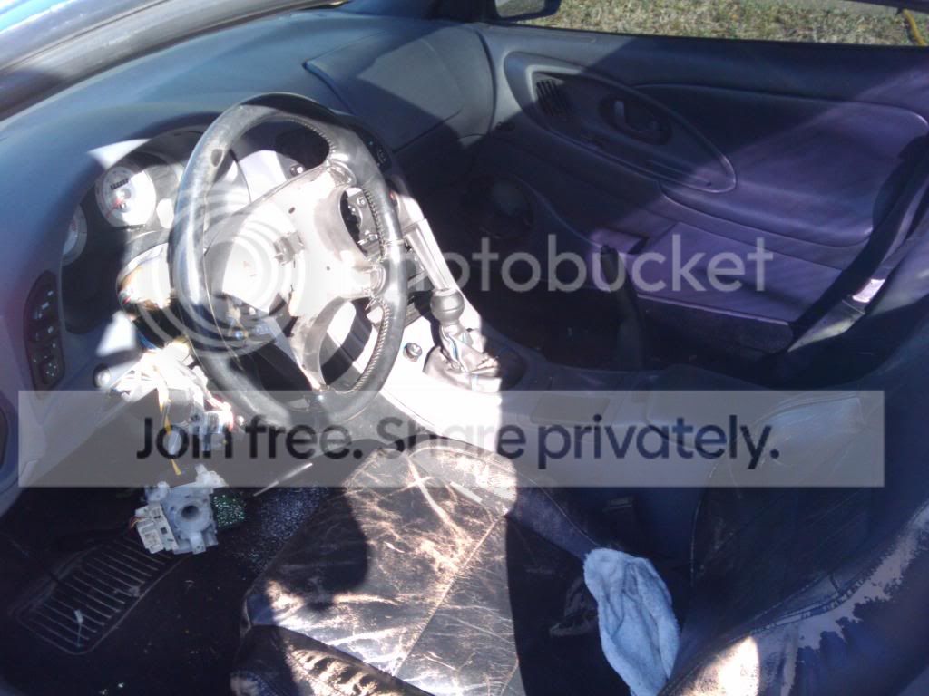

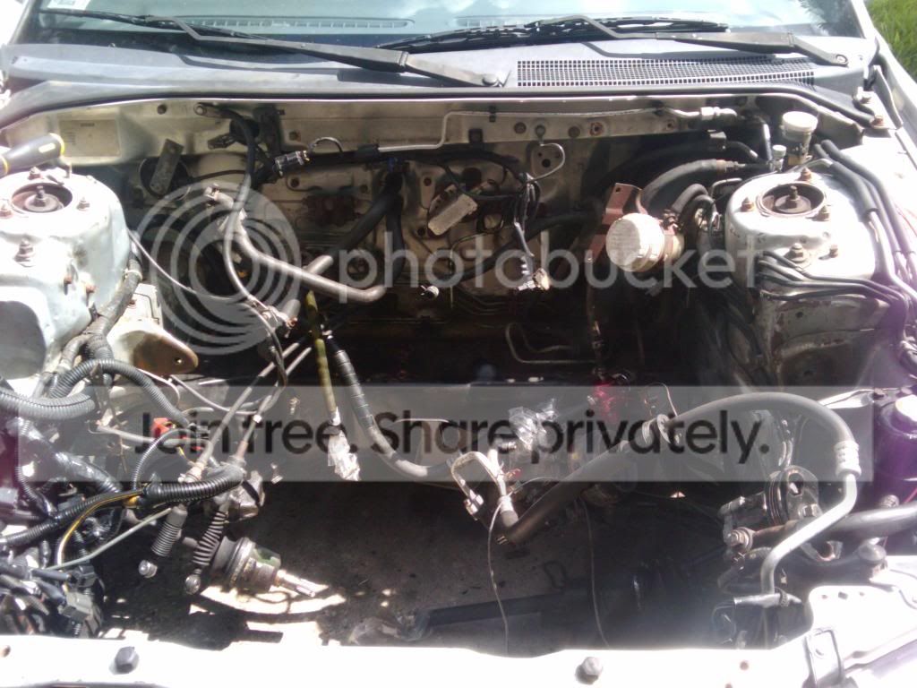

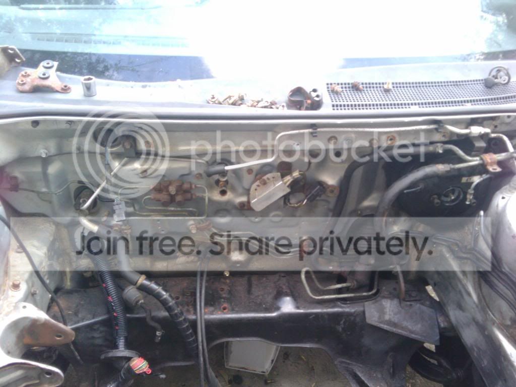

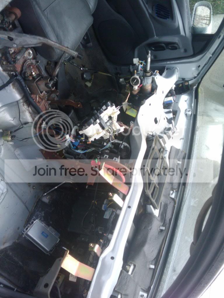

Started working on the interior - the plan is to rewire the car and remove any unnecessary wires to neaten up the bay.
Here's the harness out!
Dashboard out!
A LOT cleaner now!

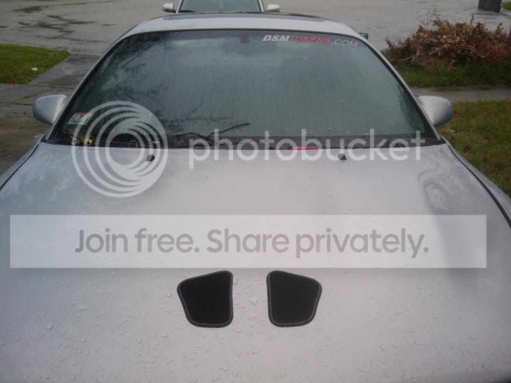

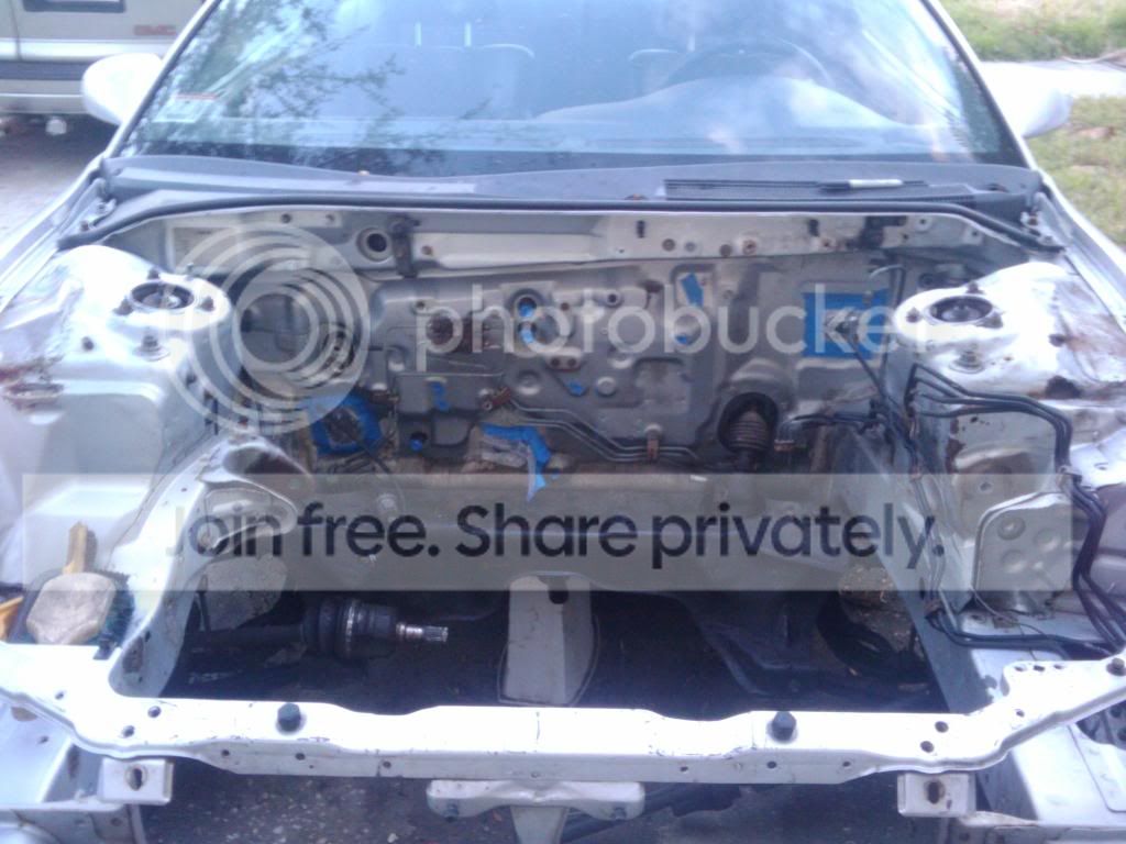

Did the greyforest hood mod while the hood was off!
Now to add even more confusion, once I tore down the car, I quickly realized that it was a boston car....RUST EVERYWHERE
I'll post pictures up later

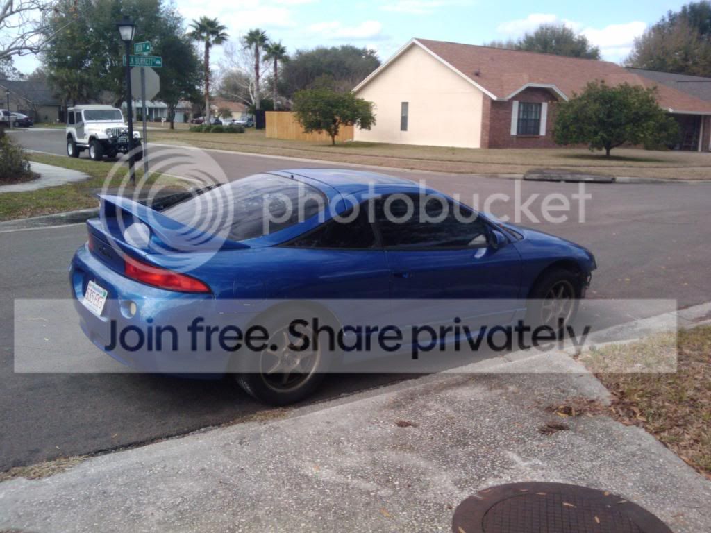

Anyways, I planned to cut out the rusted sheet metal and weld in new panels but but then I decided against it. The frame rails were way far gone and the rust was incurable. So, I bought a new shell!
It definitely needs some work (and definitely new paint) but absolutely NO rust!
Got the car for $700 and sold off some of it's parts for a total of $620 so I got it for practically free and still haven't even sold the wheels and tires! ONLY DOWNSIDE - The car's a GST but we can fix that!

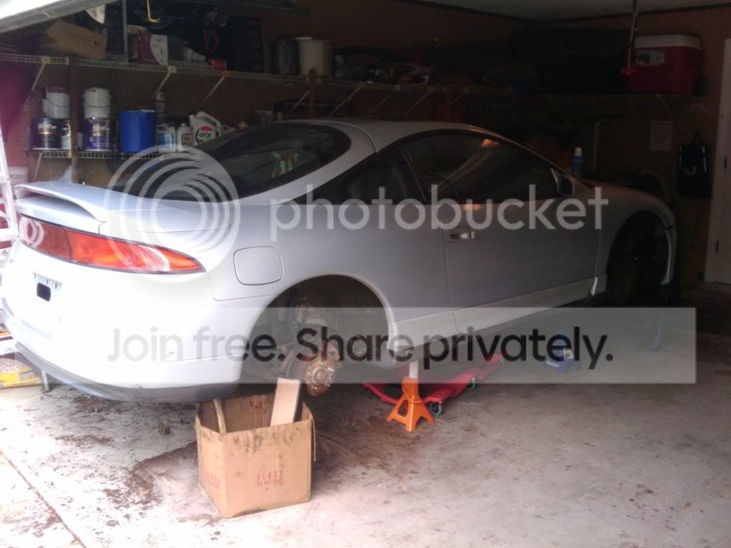

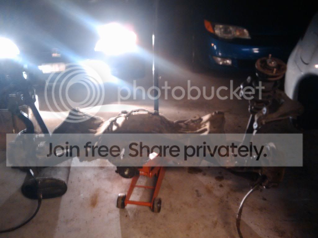

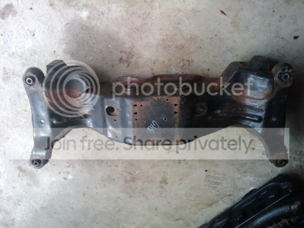

Here's my 95 up on stands getting the rear subframe/ crossmember (whatever you prefer) taken out.
It's out!
The subframe is a little rusty, but I just got it sandblasted as well as a lower control arm and rear sway bar - sway bar is painted I'm waiting to weld some new metal up to the subframe before it goes in the GST
