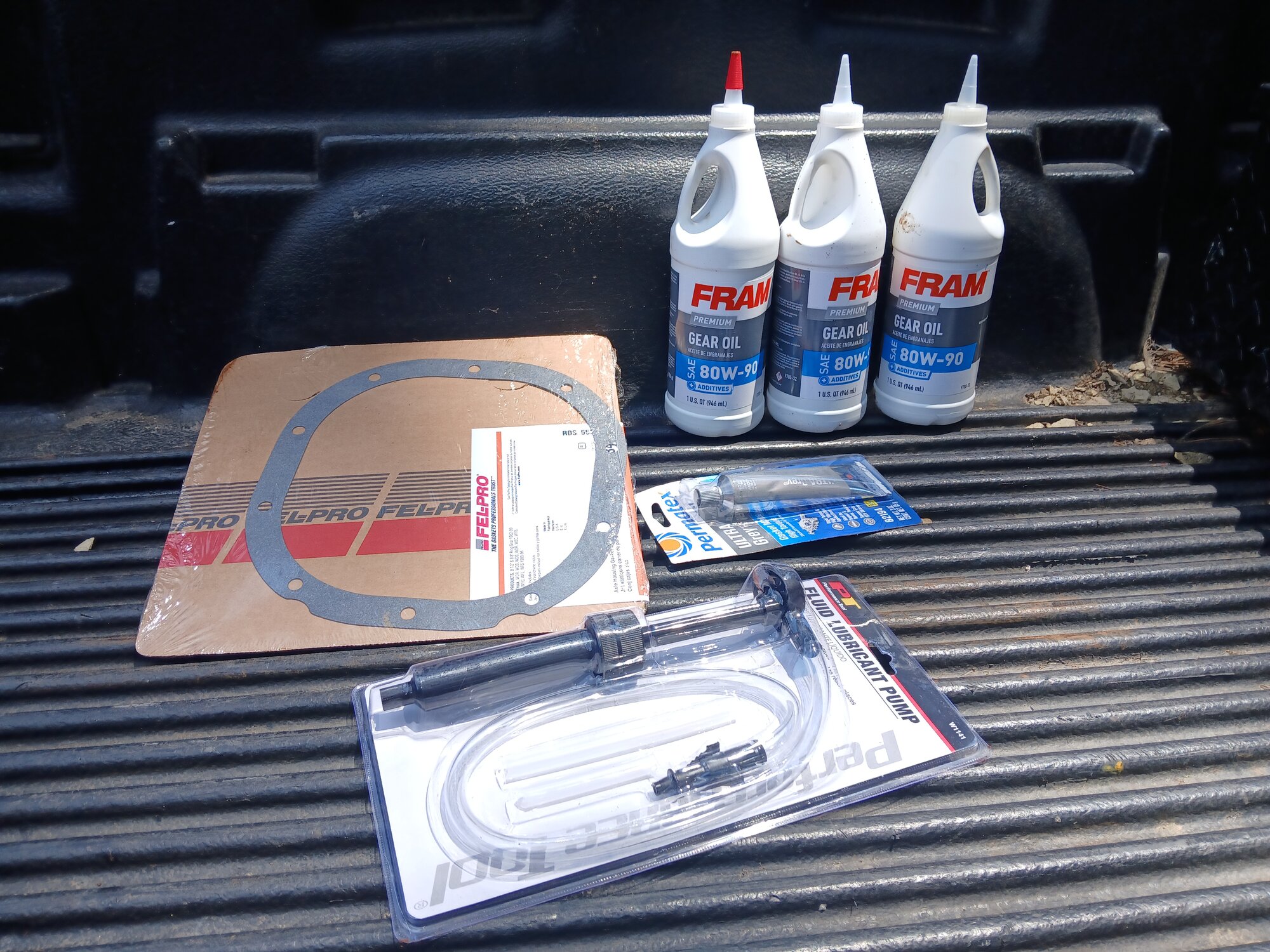

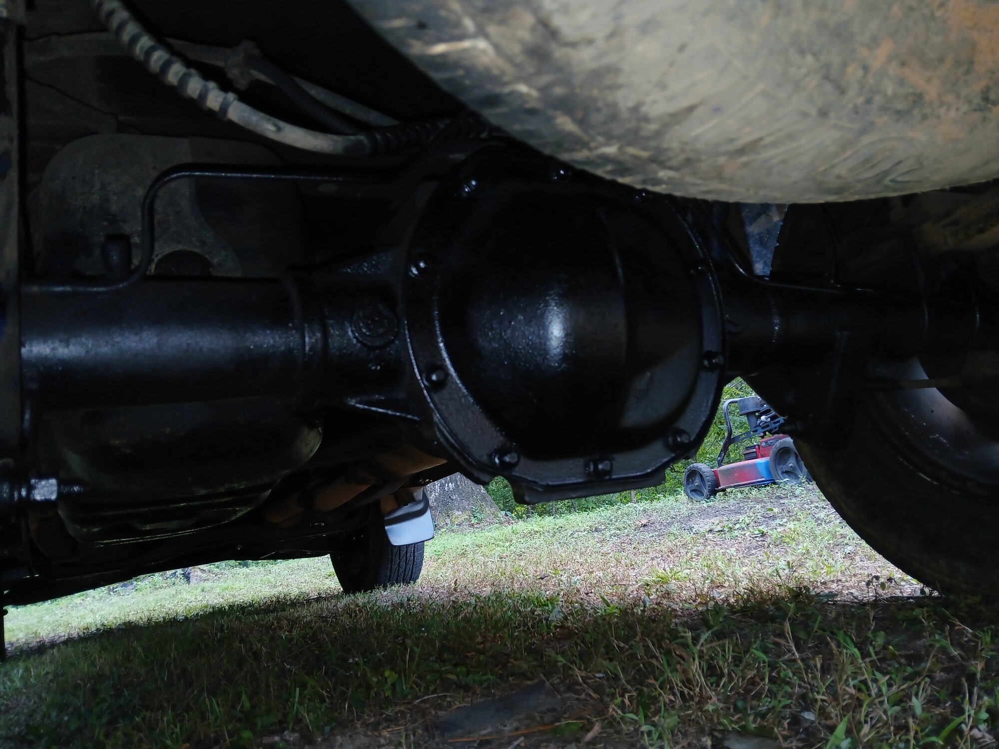

Went ahead and replaced the differential gasket. Of course fresh fluid and I decided to spray some paint after the job was done. One less leak to worry about.

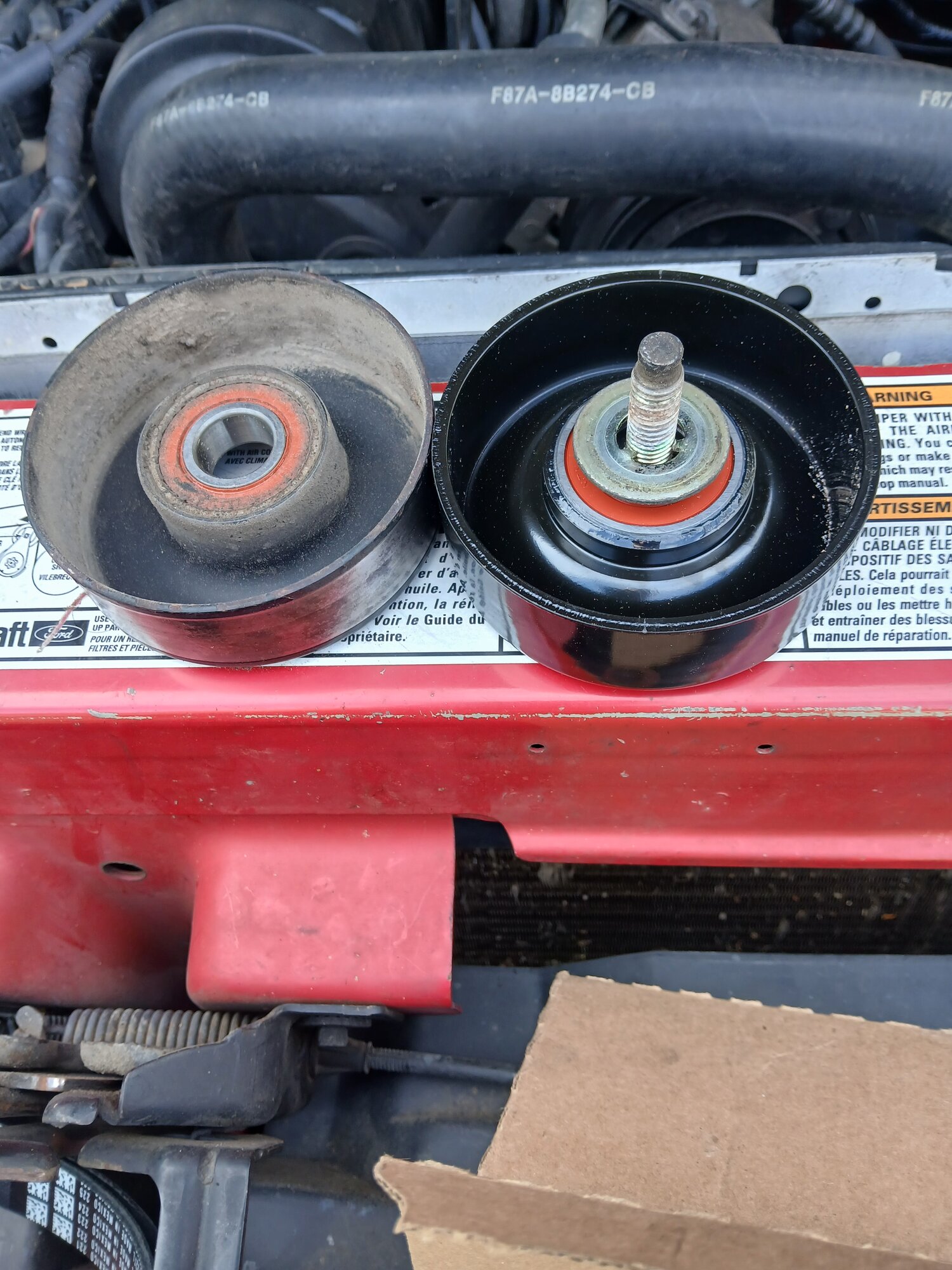

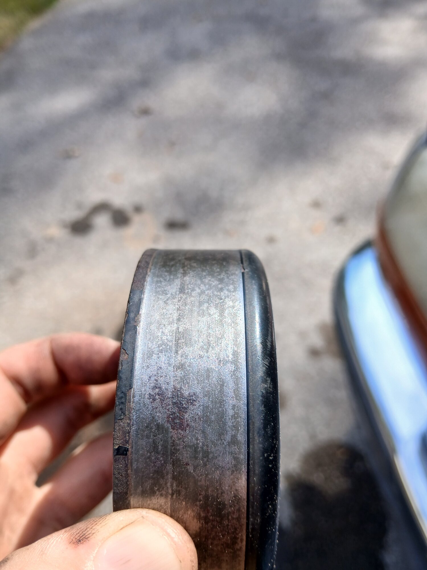

Got 4 new tires since the others were 9 years old. Also replaced the serpentine belt and idler pulley. Those bearings were loudly asking for a replacement. I was amazed to see an original Ford pulley with 210k on the odometer.
Seeing the metal worn down on that pulley shows that it served it's purpose for a long time.

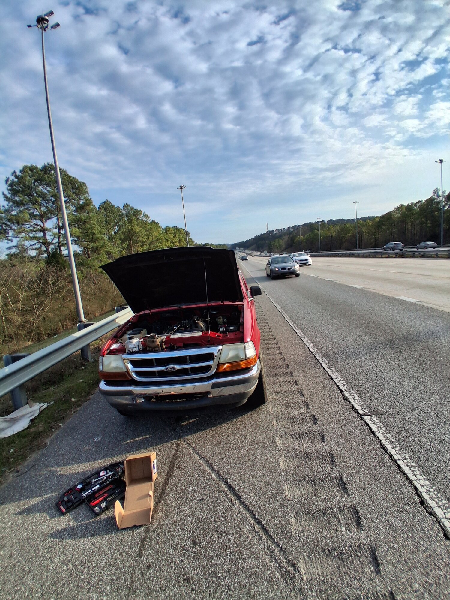

211,900 miles. Alternator gave up on the interstate. Luckily a nearby Napa had an alternator in stock, so I didn't have to pay $300 for a tow I was a good ways from home. I can say, wrenching on the shoulder isn't something that I've missed. It's very loud/distracting and nobody slows down while you're entering/exiting the vehicle. I was going to have it towed home for those reasons, but when I was told $300 I then went for a walk and pulled out the tool kit. I forgot to get the tow insurance for this one apparently. I'll be adding it on now.
