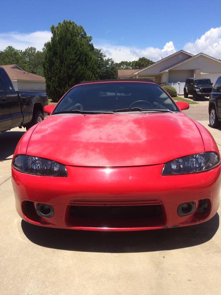

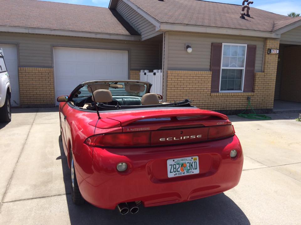

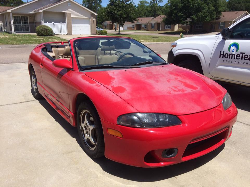

1997 Eclipse GS-T Spyder
Rough paint and seats, also broken top bracket, but just recently bough it and have plans of restoring it.
