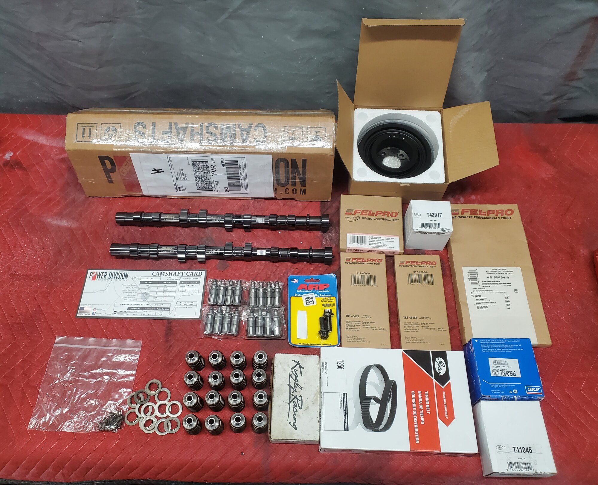

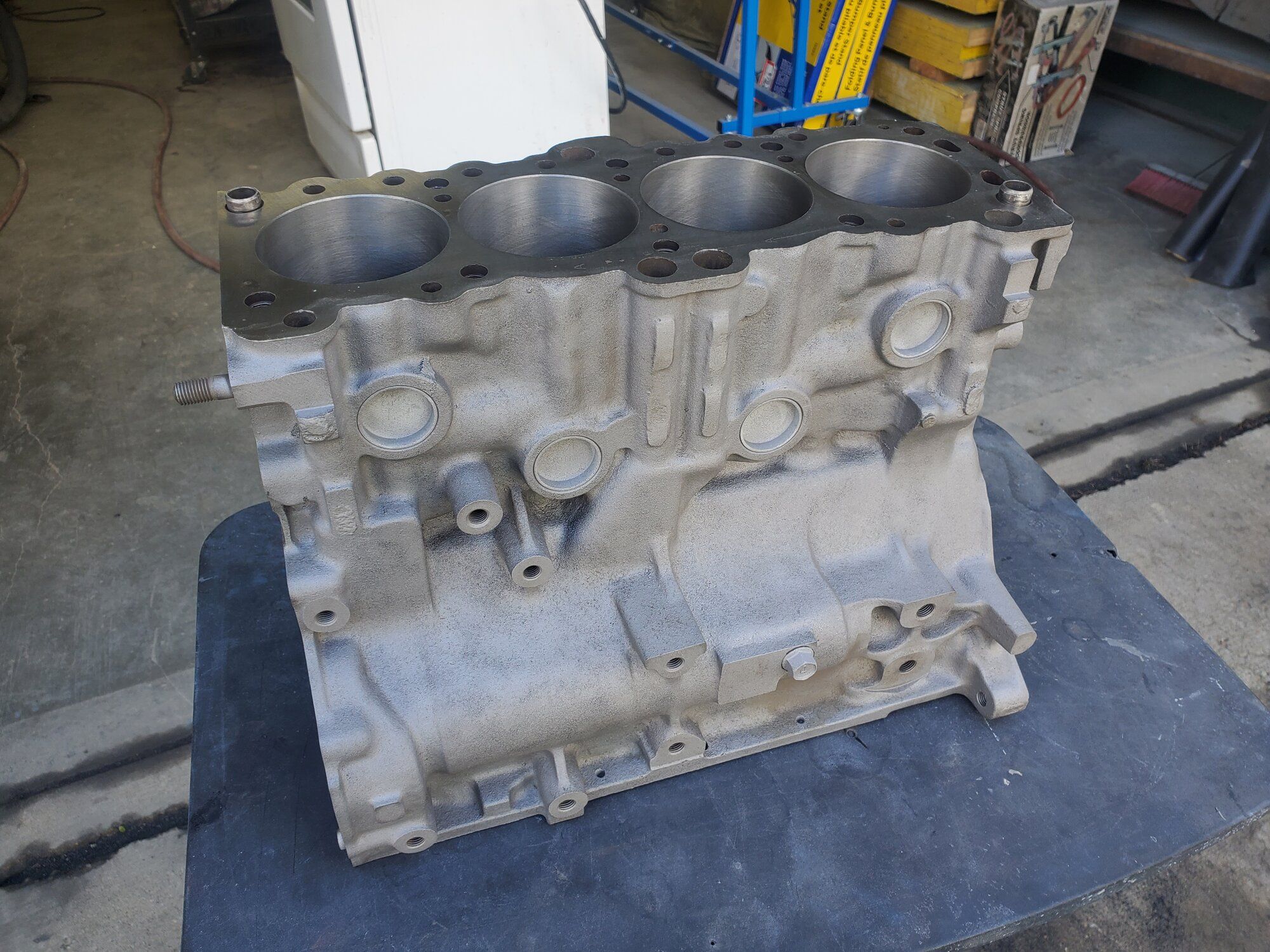

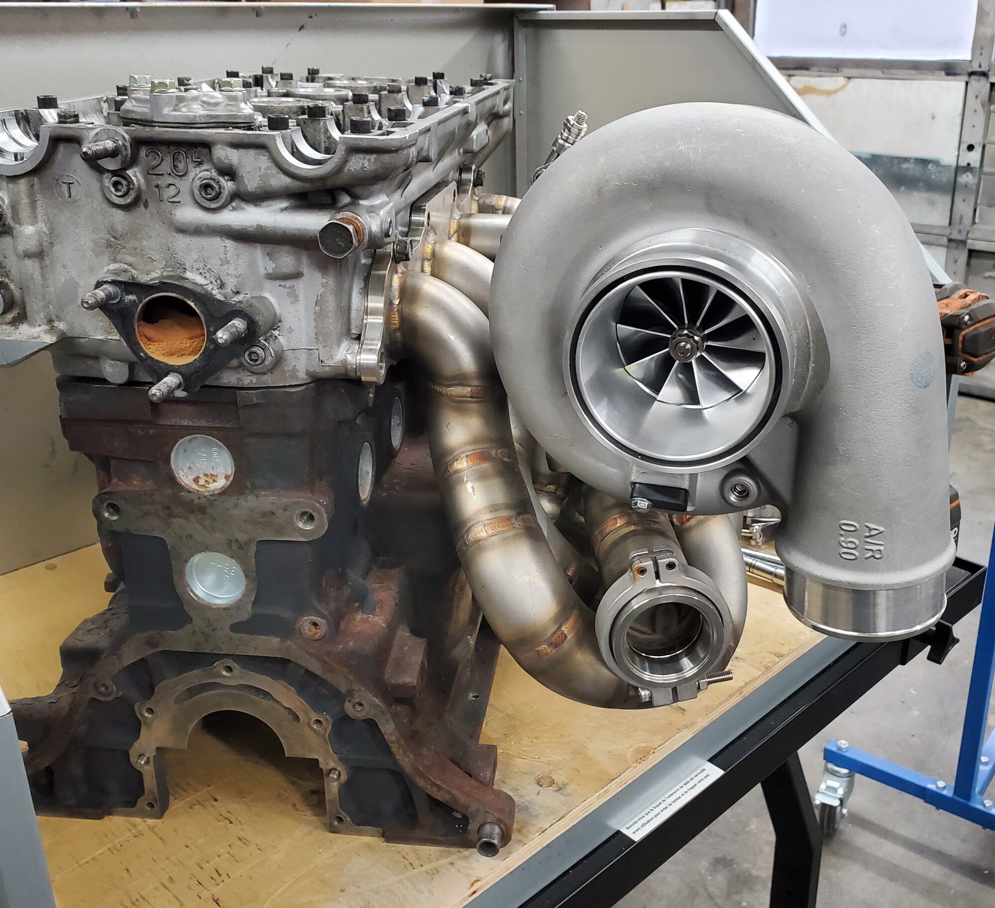

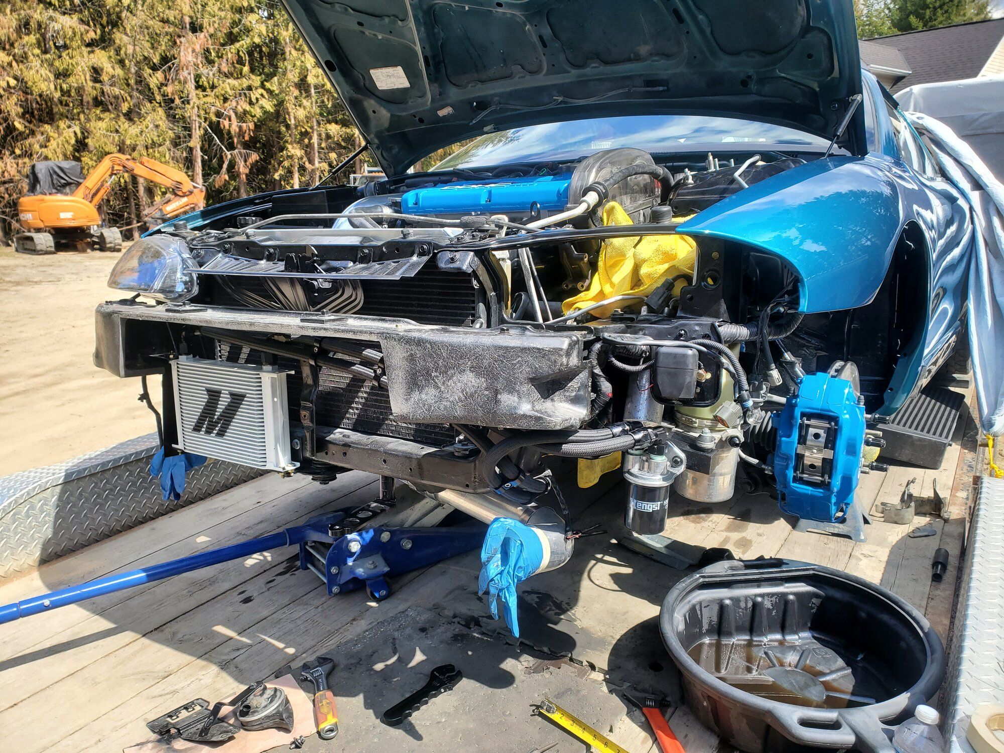

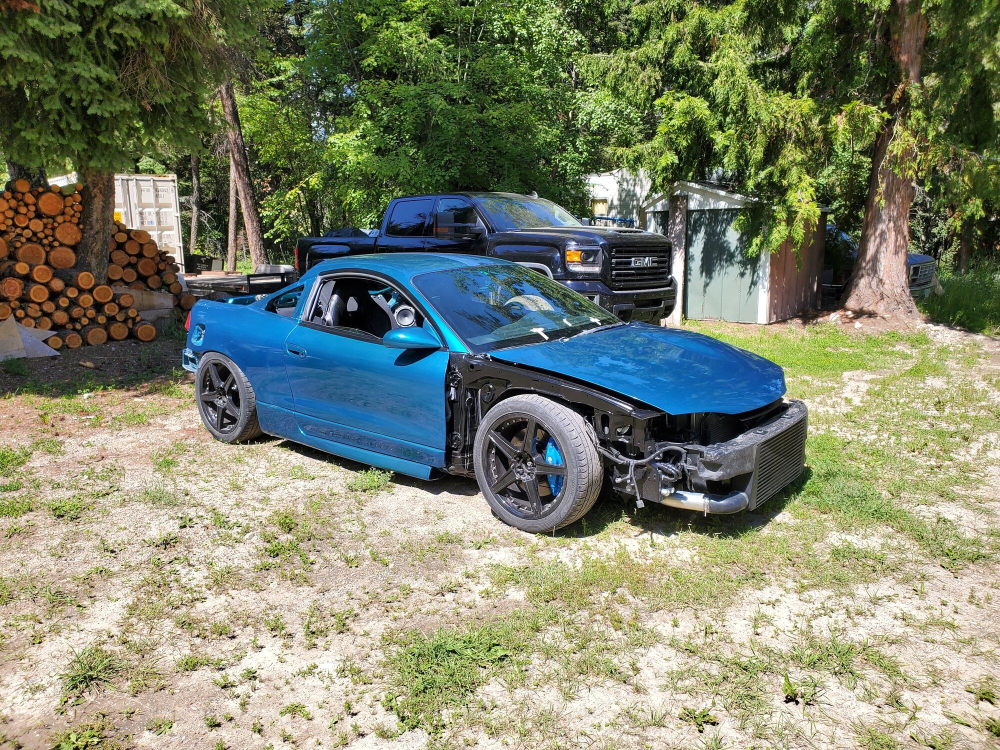

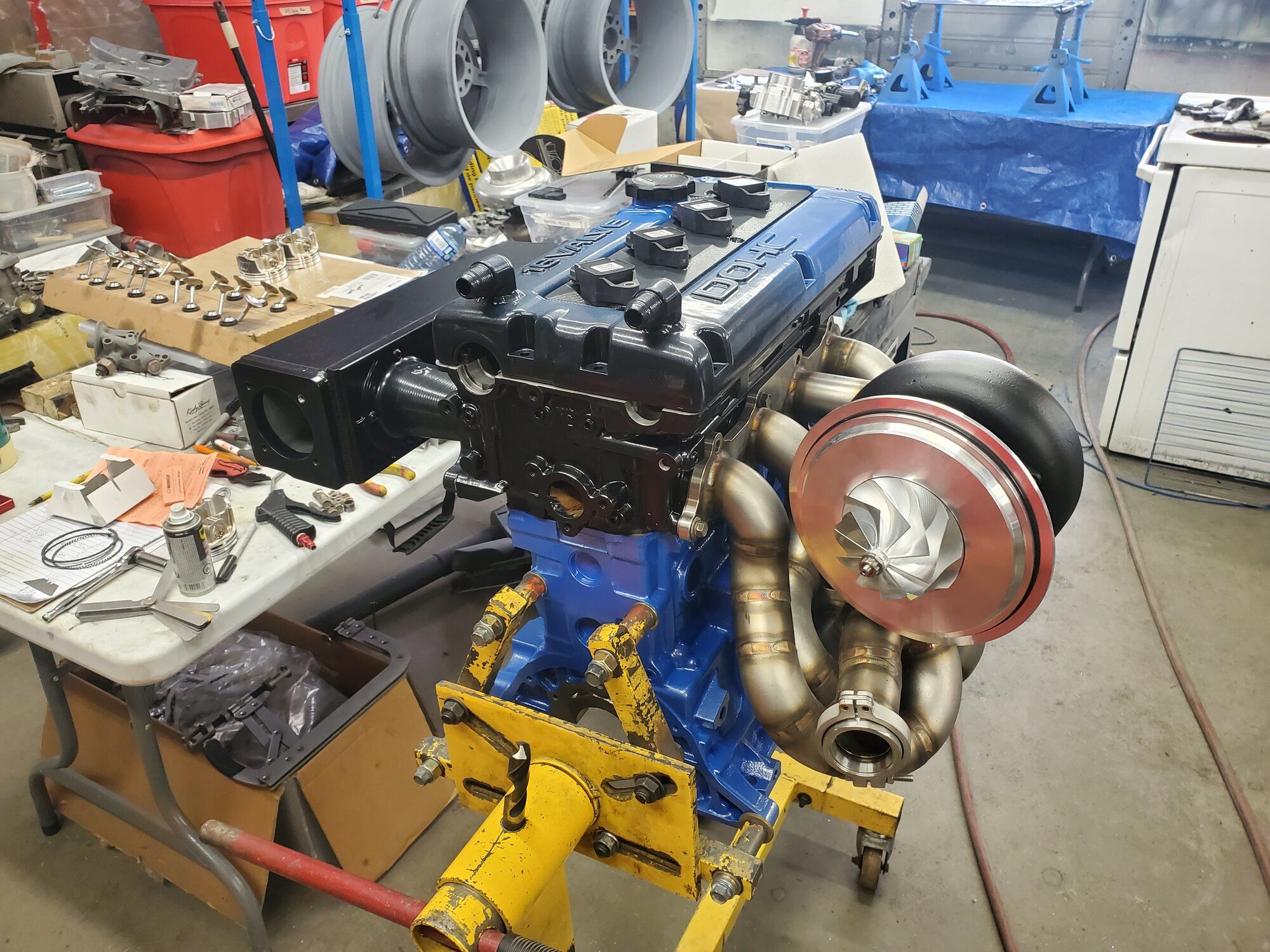

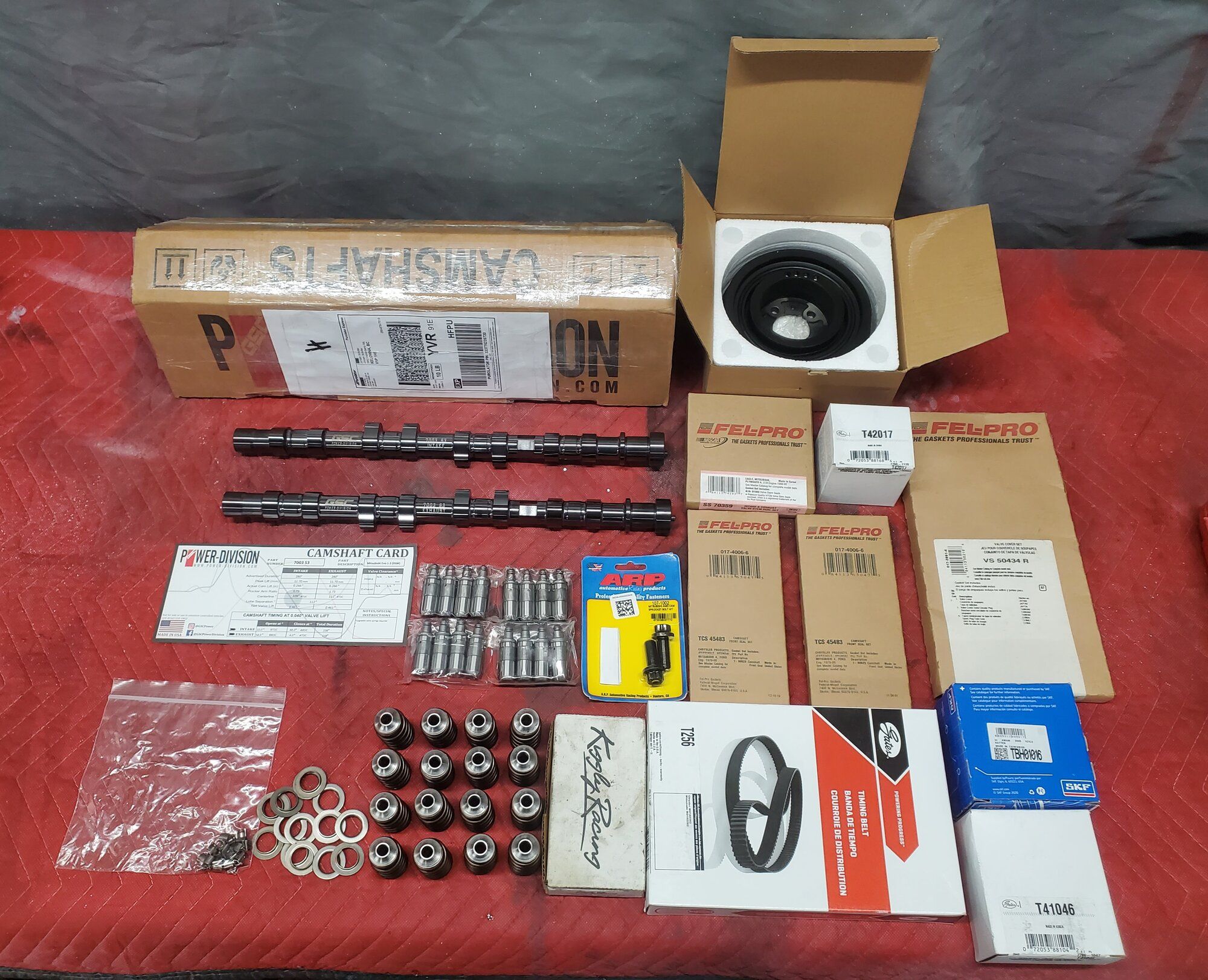

Yeah, been collecting more parts. I've tried to keep the car profile updated, but been slacking on the build thread.

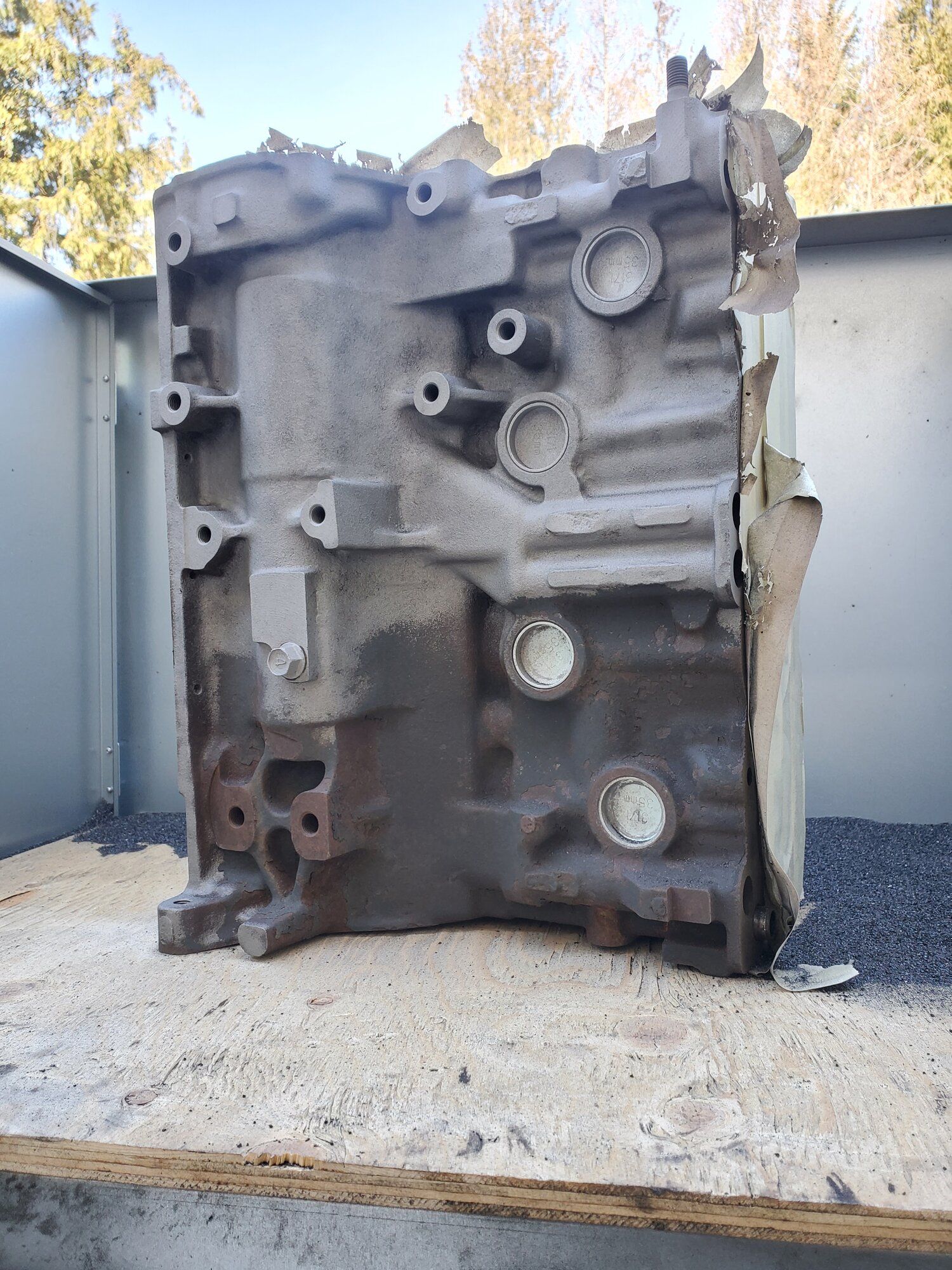

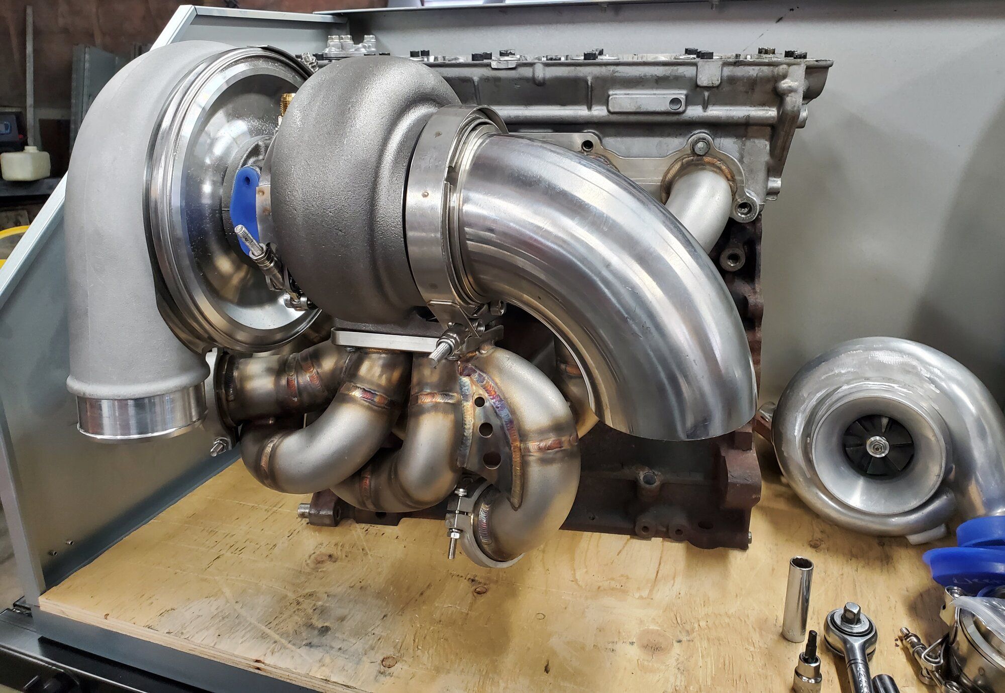

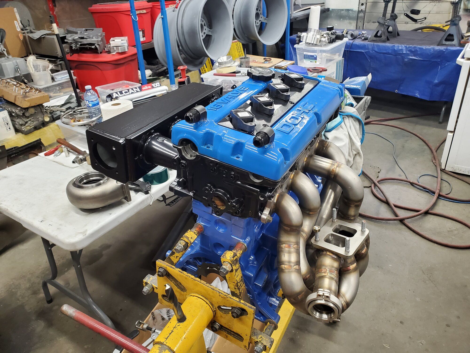

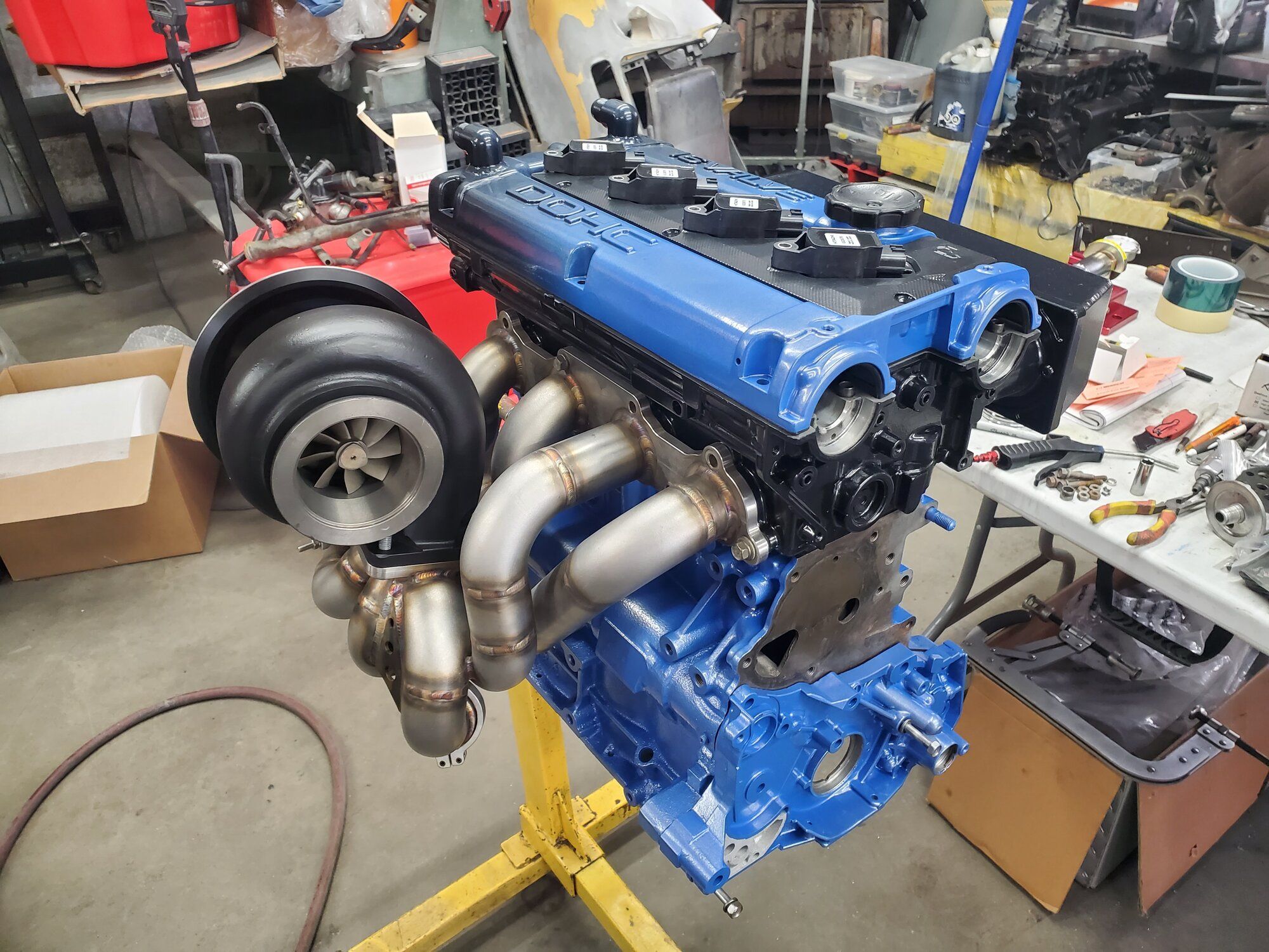

Just picked up a g42-1200 for the car, and am in the process of tossing my 2.4 together to run in it, as I've been waiting on my 2.0 Crank from eagle that's backordered..
2.4 motor has
Wiseco HD pistons
Eagle H beams
Eagle Crankshaft
Acl bearings
Arp mains
Kiggly Brace
O ringed Block
L19 head Studs
Ported head
Manley +1mm valves
Kiggly Hp springs

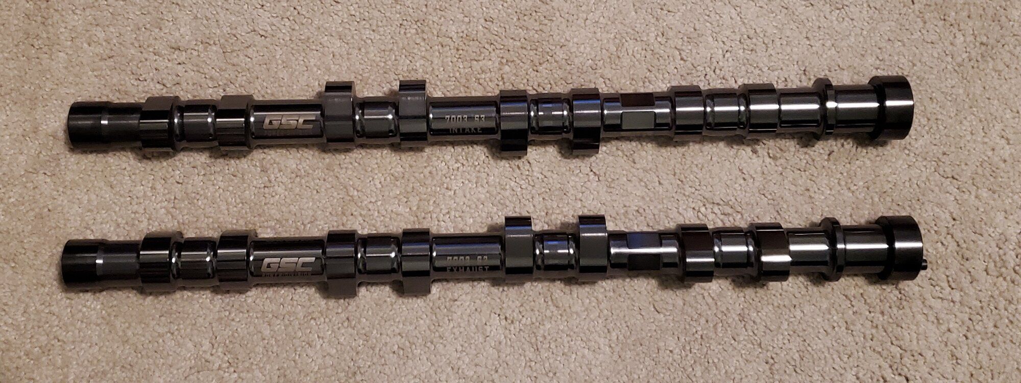

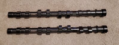

Gsc s3 cams
Aem cam gears
The 2.0 is the same part list but with manley I beams

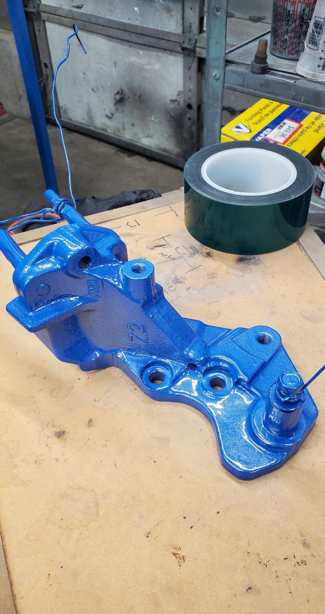

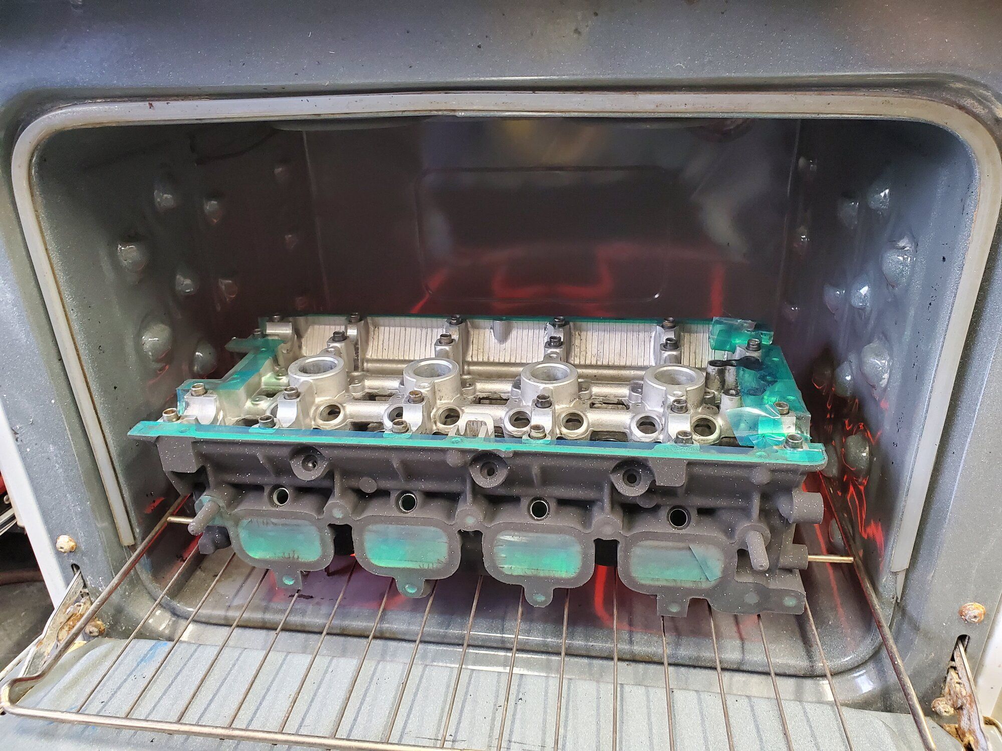

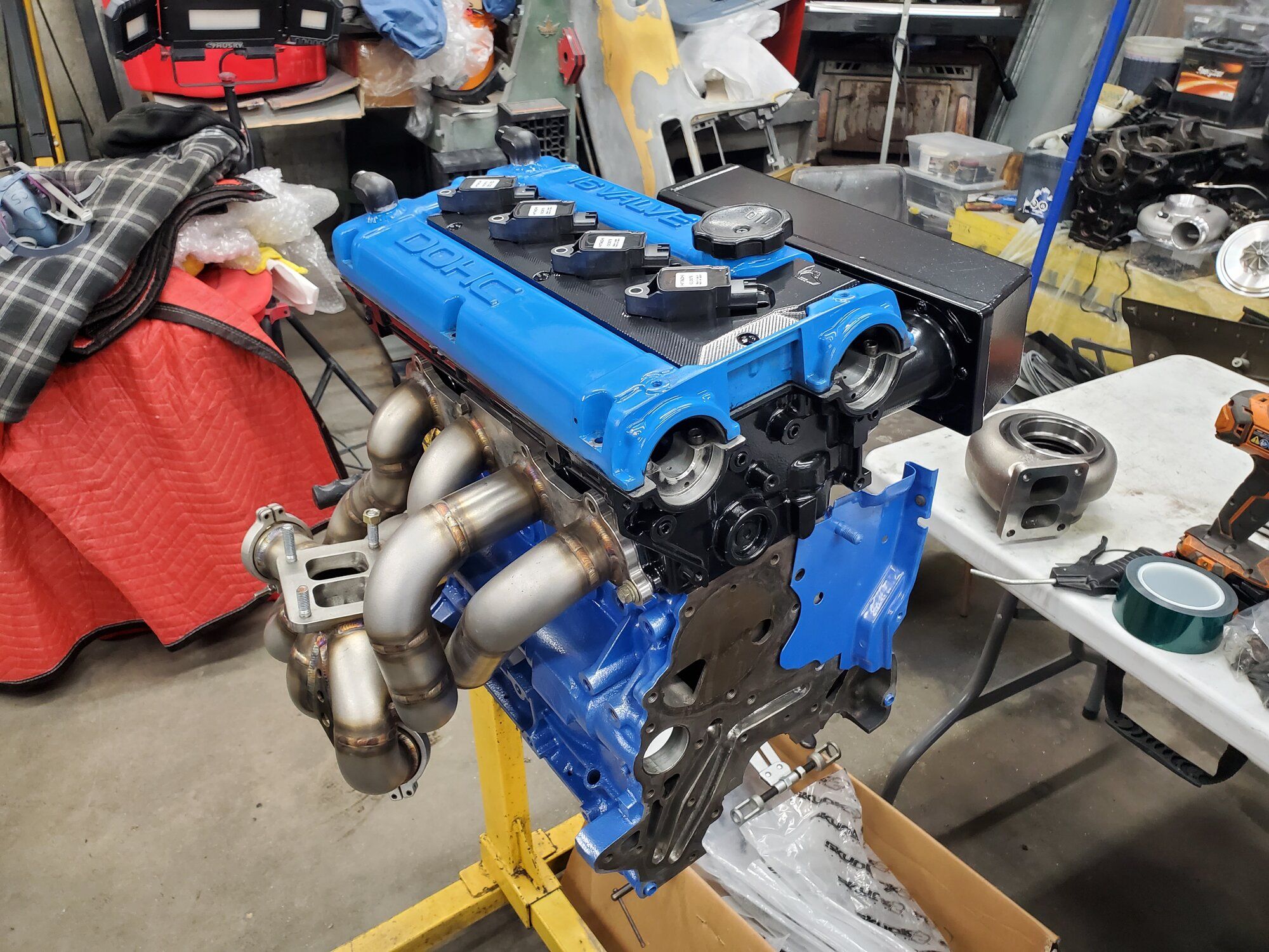

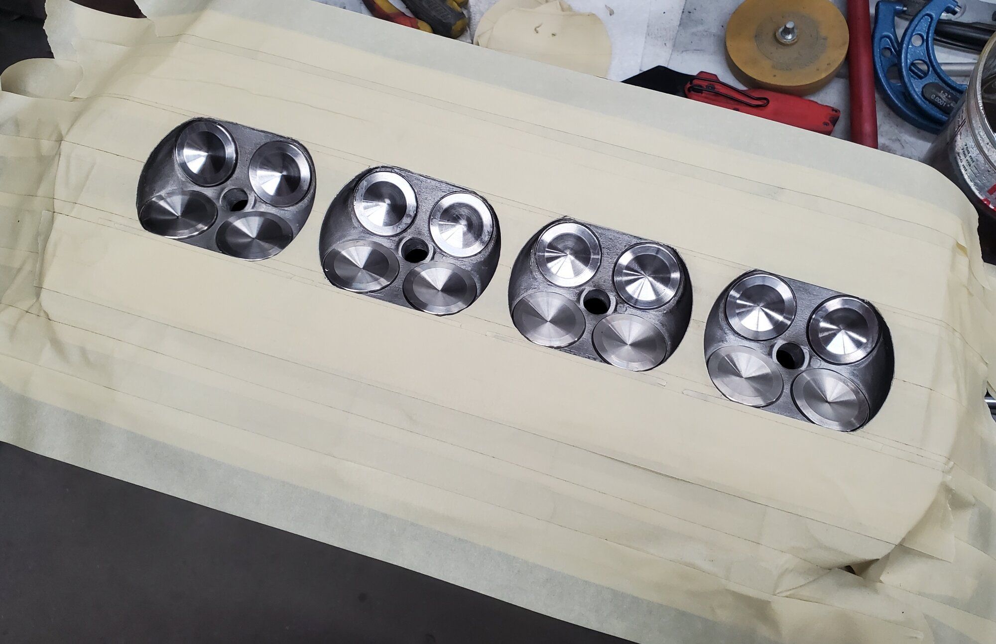

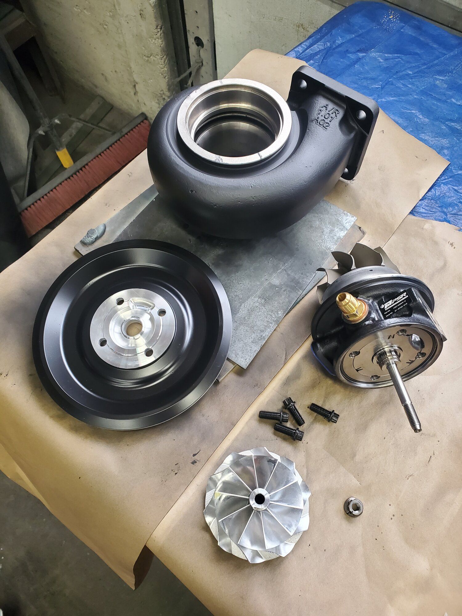

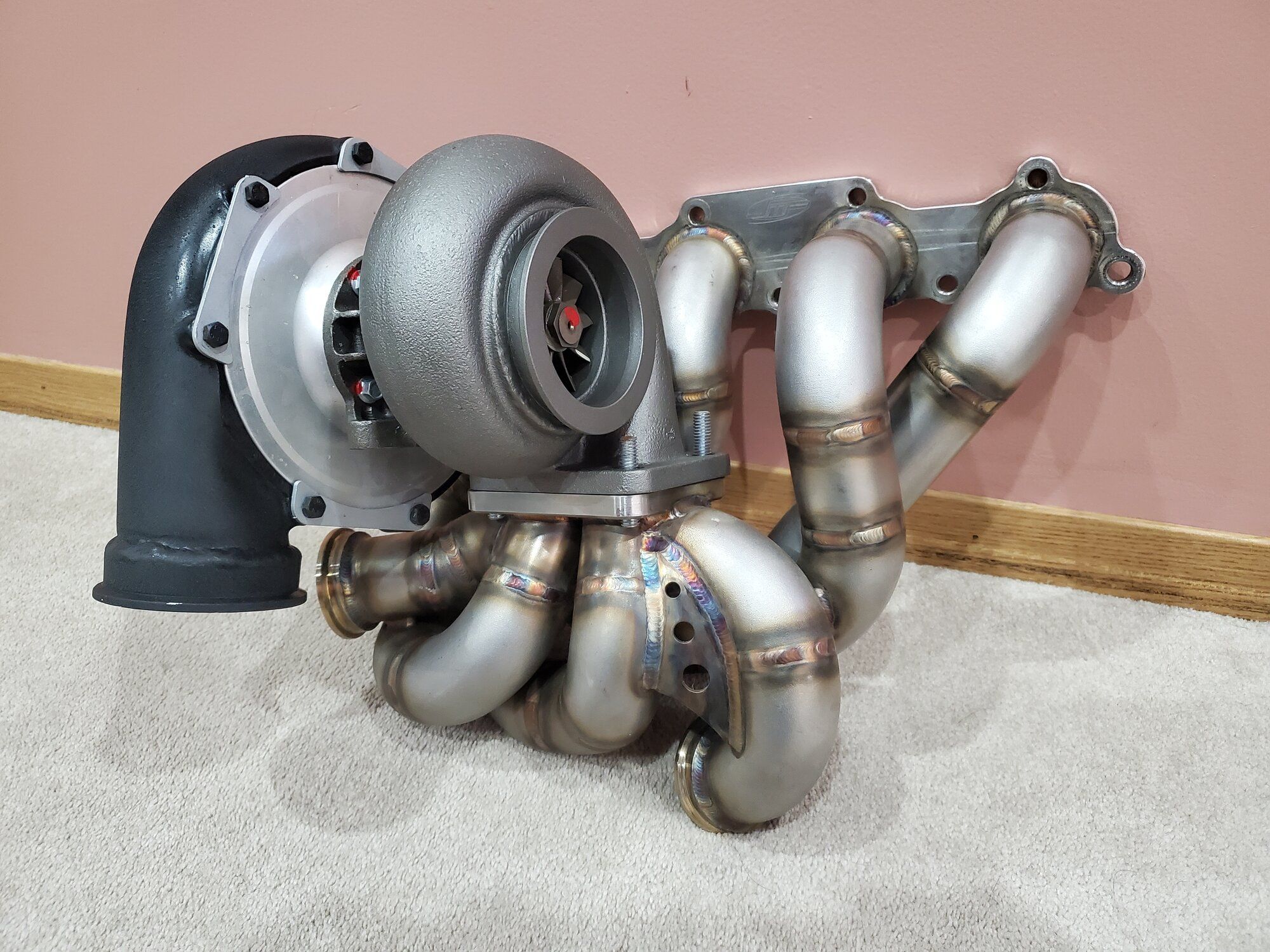

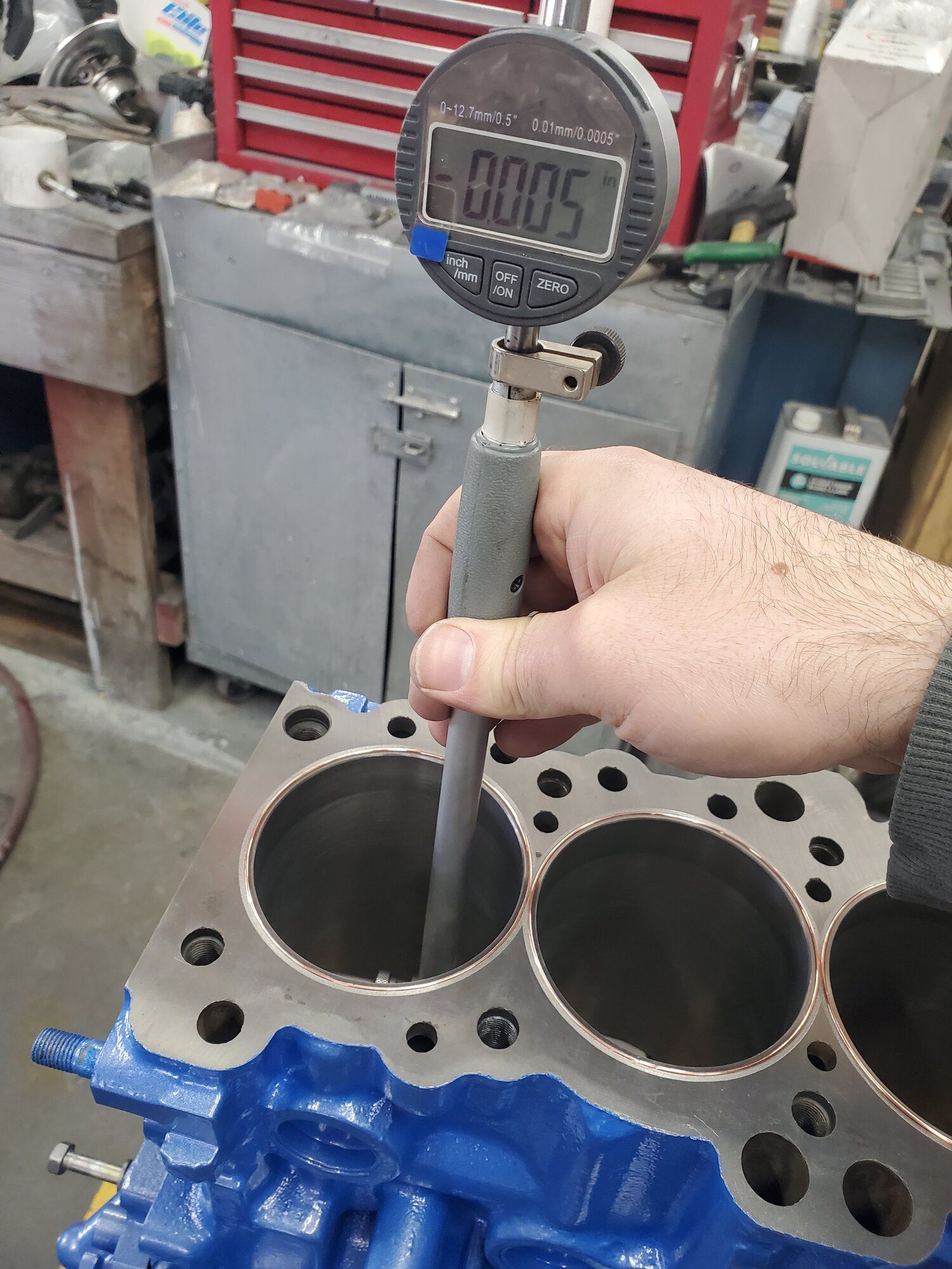

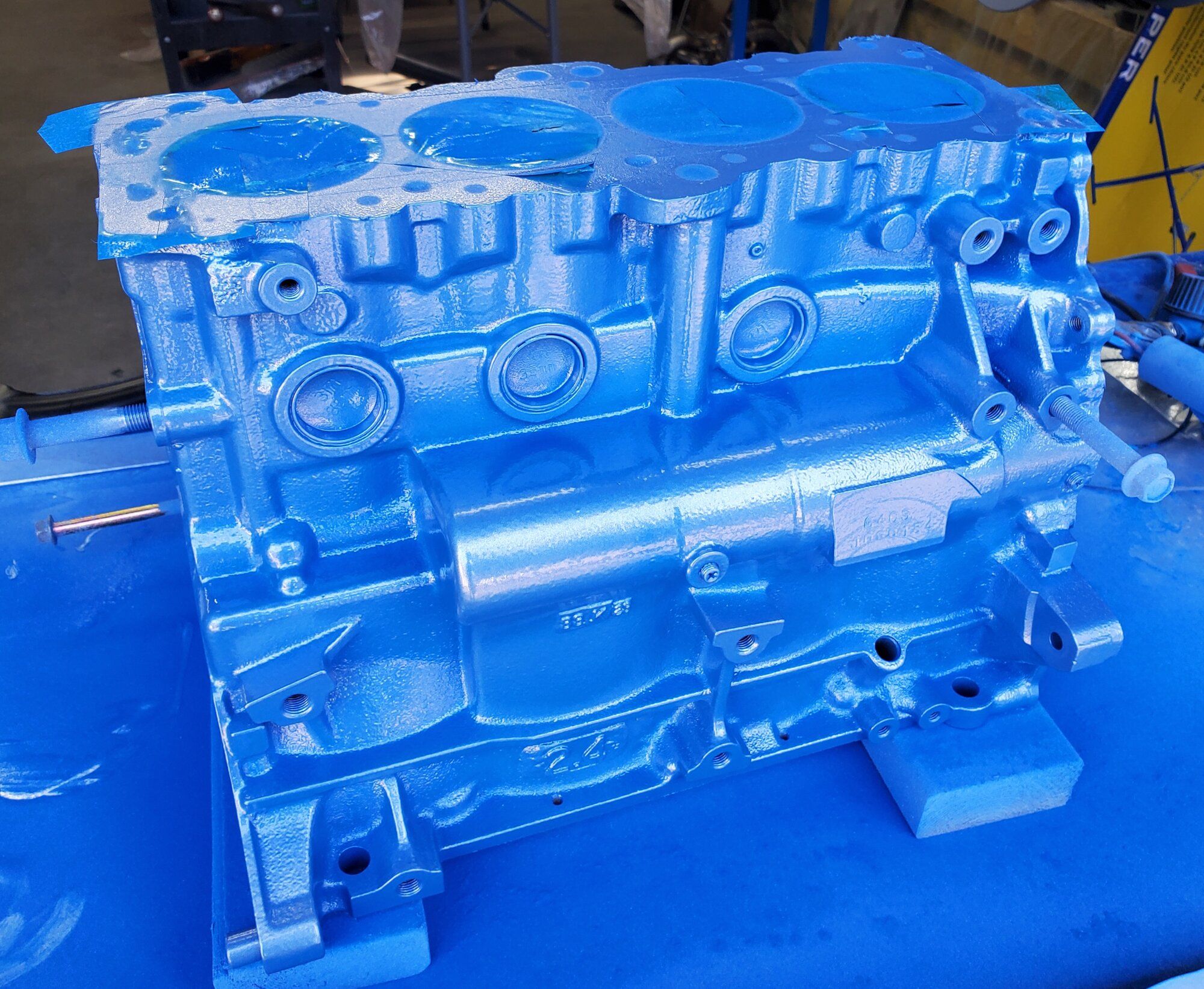

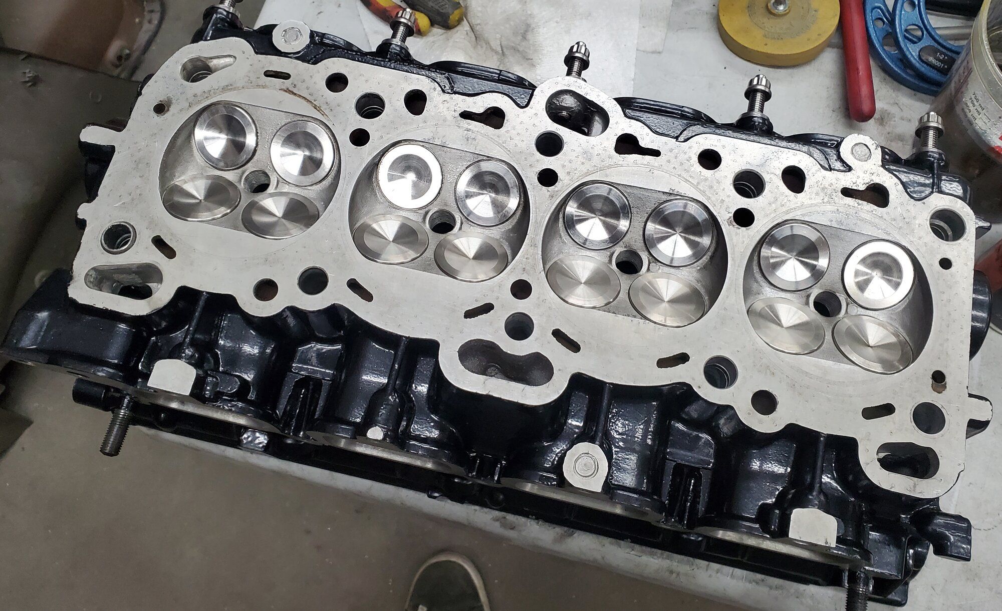

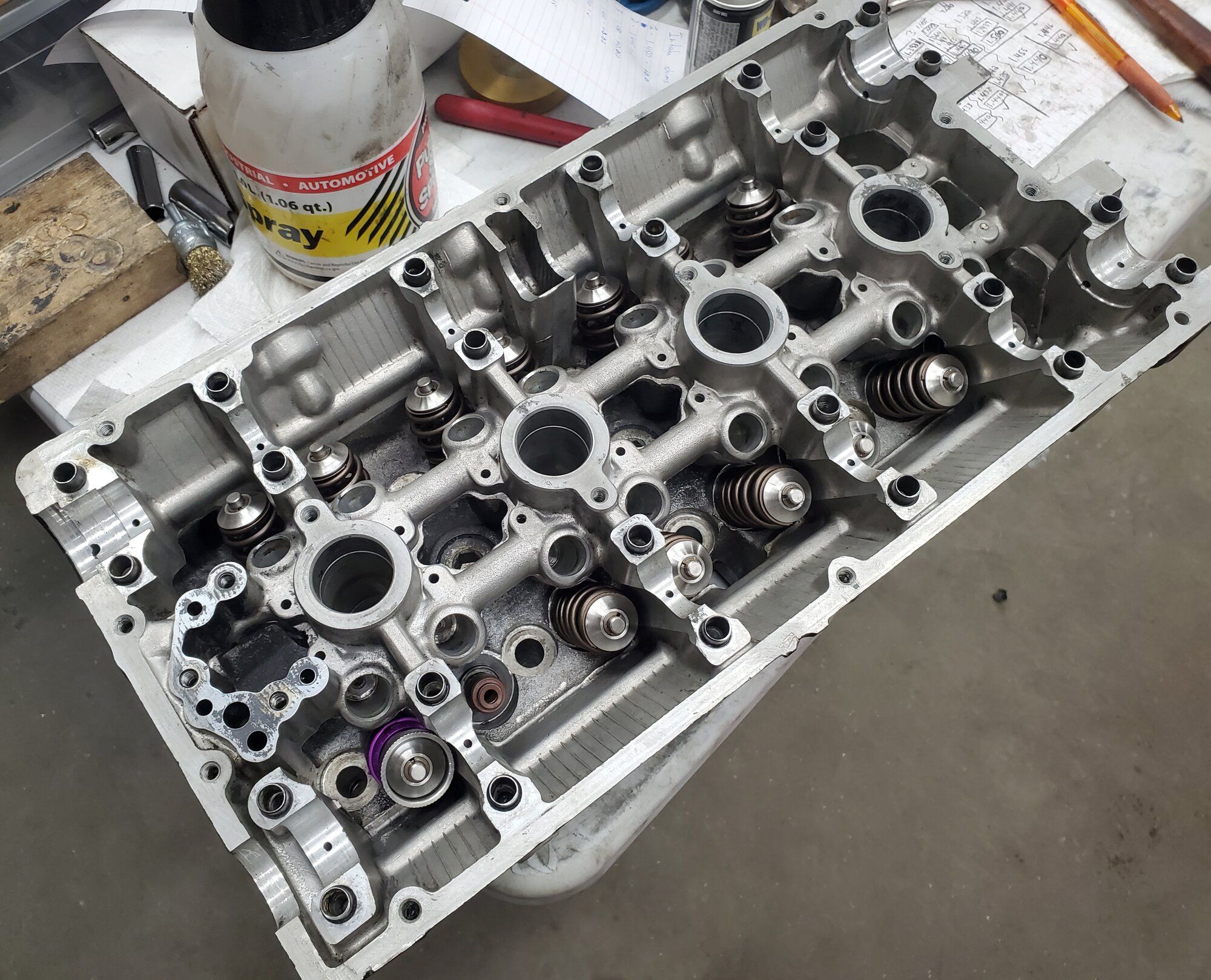

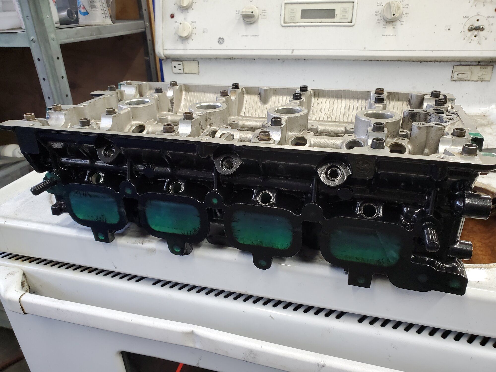

Ive finally got the head all tossed together and the bearing clearances, ring gap all sorted. Thermo coated the pistons, head and ceramic coated the turbo
Now its just time to slam the pistons/rods in.

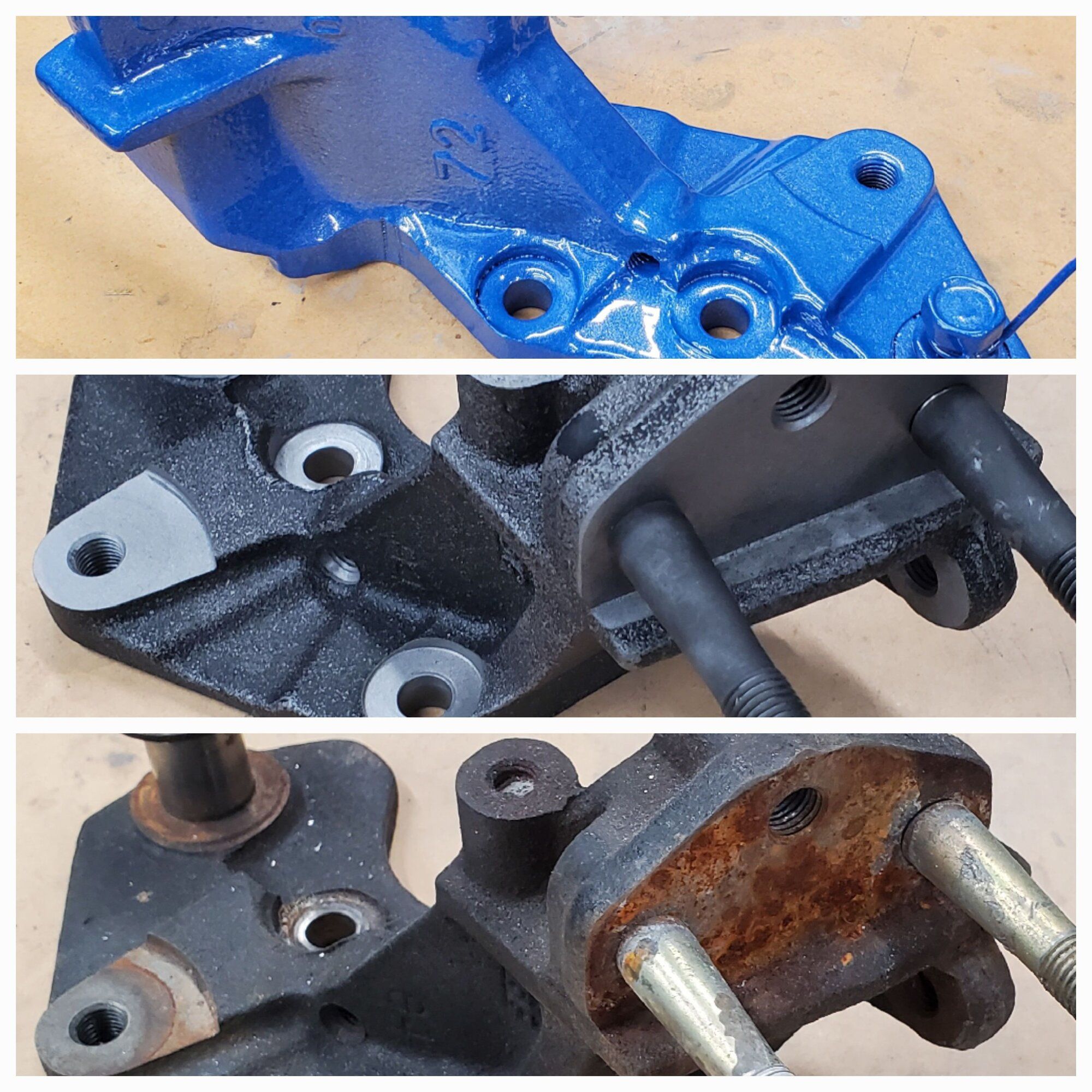

Next hurdle is figuring out electroplating, I got some stuff from caswell but had mixed results so perseverance will be key to getting this project finished
