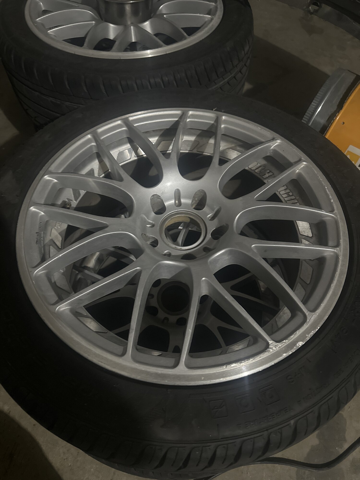

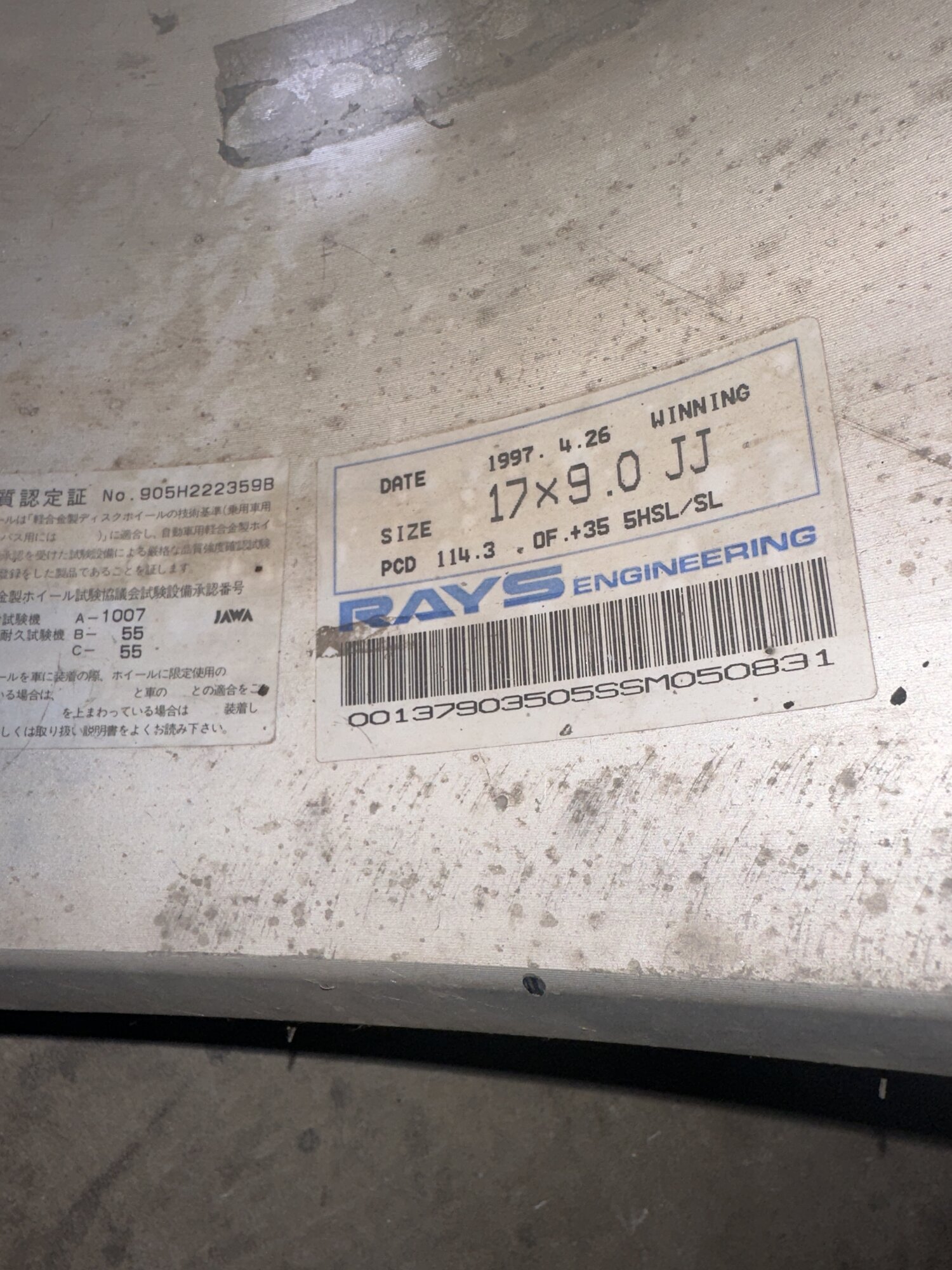

•Removed wheels to inspect brakes, I plan on rebuilding the brakes and do some powder coating on the wheels, brakes, control arms etc. I like the wheels, they’re Rays Wheels from 1997.
