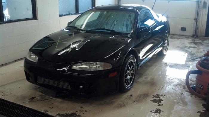

OK first off i know my username name throws it off. The gst was my first dsm. I'm now onto the 95 talon tsi as it says in the title. Dont have a whole lot of information on the car since he didnt know much about it. Took a while to get it. exactly what I wanted. I traded my 95 jimmy for this (that's how I do it little harder to buy and sell in this economy) I work at a body/service shop so i have somewhere to work on it when its cold as sh** out. Okay so lets get to it.

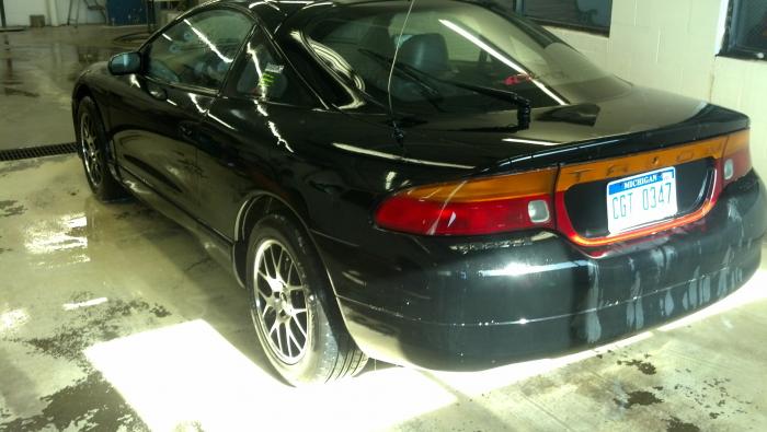

The picture of it wet was the first day i got it. Everything looked clean strut towers were good, no oil leaks, clutch felt strong said it only had 25k on it. No gears grinded started up perfect every time. Zero rust on the body, little here and there bolts, drive shaft, nothing too bad. So it begins

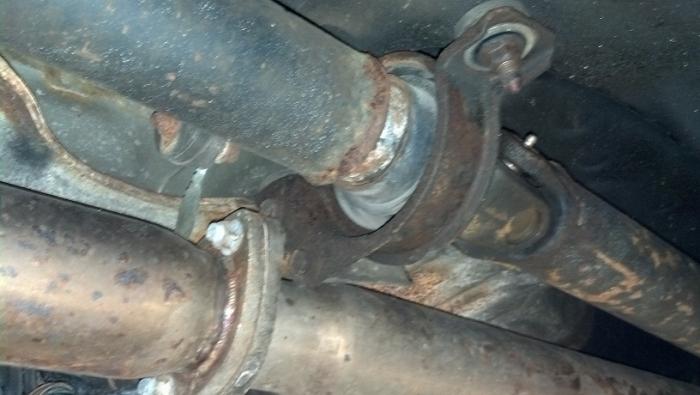

Next day- (new clutch time) While dropping the trans we realize my drive shaft middle bolts that hold up the middle carrier bearing was loose. Then realized the 2 bolts were bent forward like he ran over something, the rear motor mount was missing a bolt and a new control arm he had replaced was missing a bolt (good thing i never take the highway) 3 of the 4 control arms are bad and the oil feed return line was kinked. Found out the 255 wally was in fact a stock fuel pump. And the mbc lines had cuts in them (not sure why) So big boost leak there. Also the couplings were not tight all the way (another boost leak) ended up putting a stock clutch in for now.

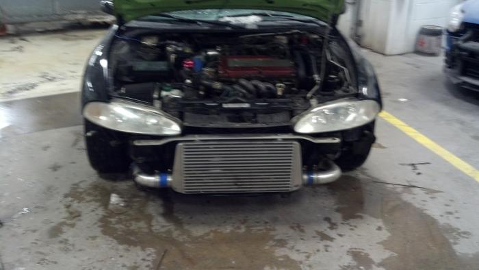

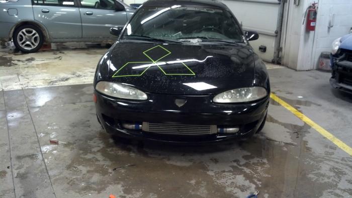

Same day- Clutch that had "25k on it'' was the stock clutch also and had an air hose fitting on the end of the small shaft to make the clutch pedal more stiff and feel like a brand new clutch. f'd me pretty good. Well the clutch was finally done and i decided I didn't want the 2gb eclipse bumper anymore. Taking it off was pretty simple considering it was 4 bolts and 5 zip ties LOL, I decided to get and paint a 2ga talon and put it on. Okay enough rambling and onto the plans of course after i fix the small stuff.
This is my daily driver so trying to keep full interior

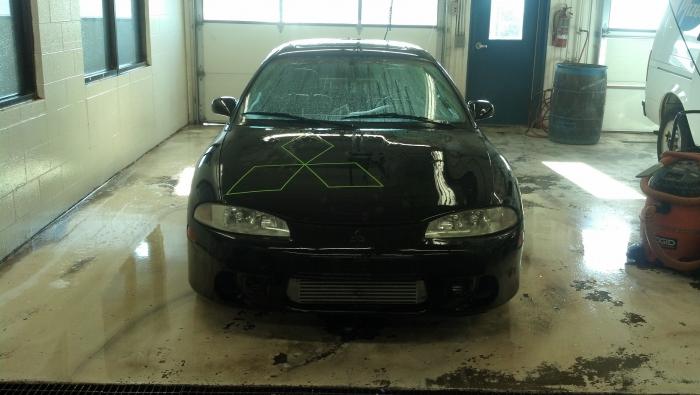

Gonna paint the hood and get rid of the mitsu symbol since its a talon, since i have to get a new windsheild ### its cracked im gonna get EAGLE on the top of it. Full black interior (its already half way there)
