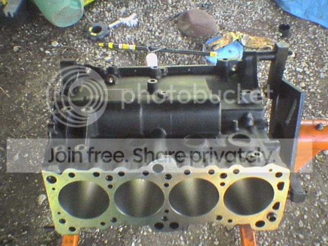

Block After Machine Shop and Paint .030 over with Balance shaft bearings flipped

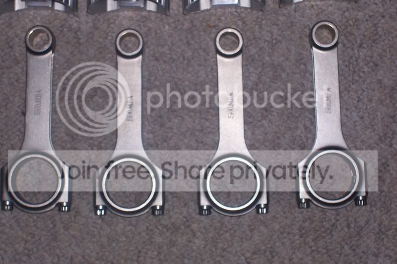

Eagle H Beams

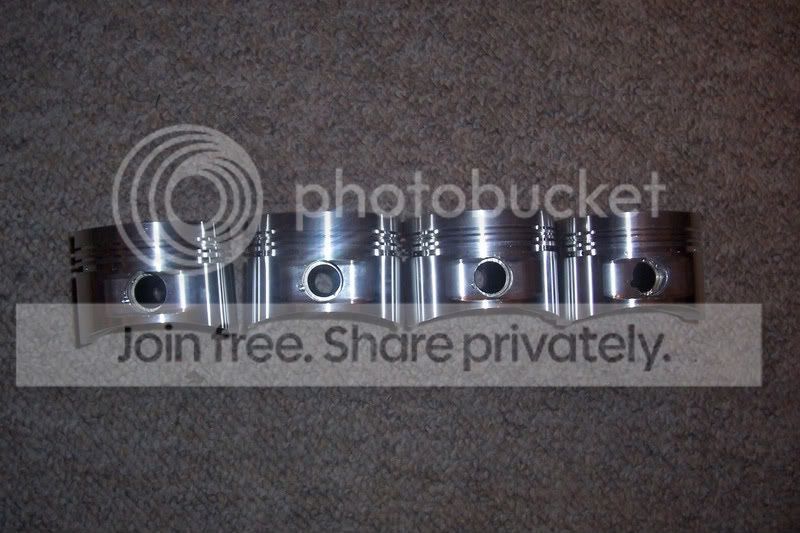

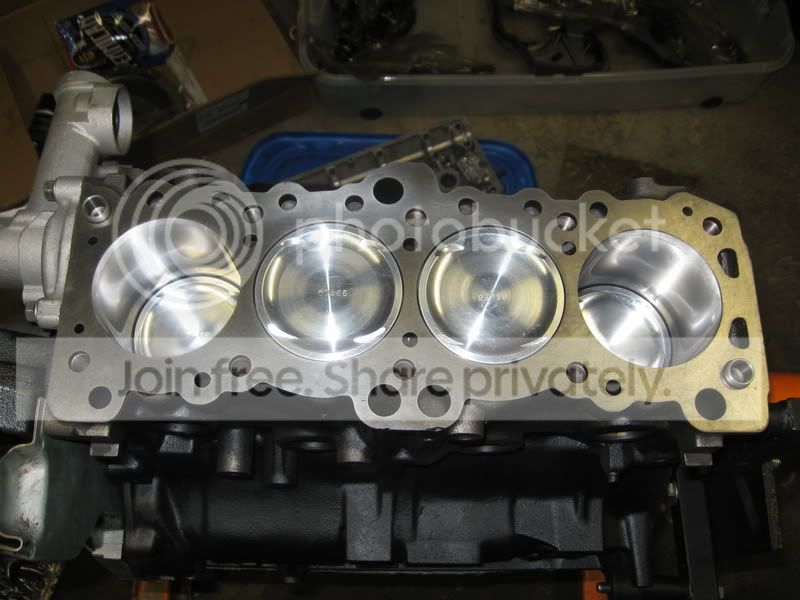

Ross Pistons .030 Over

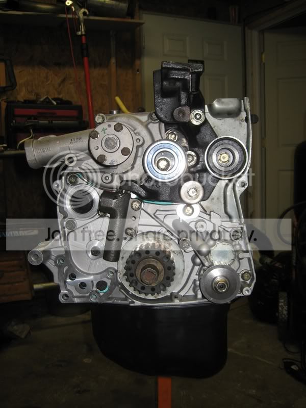

Short Block Assembled

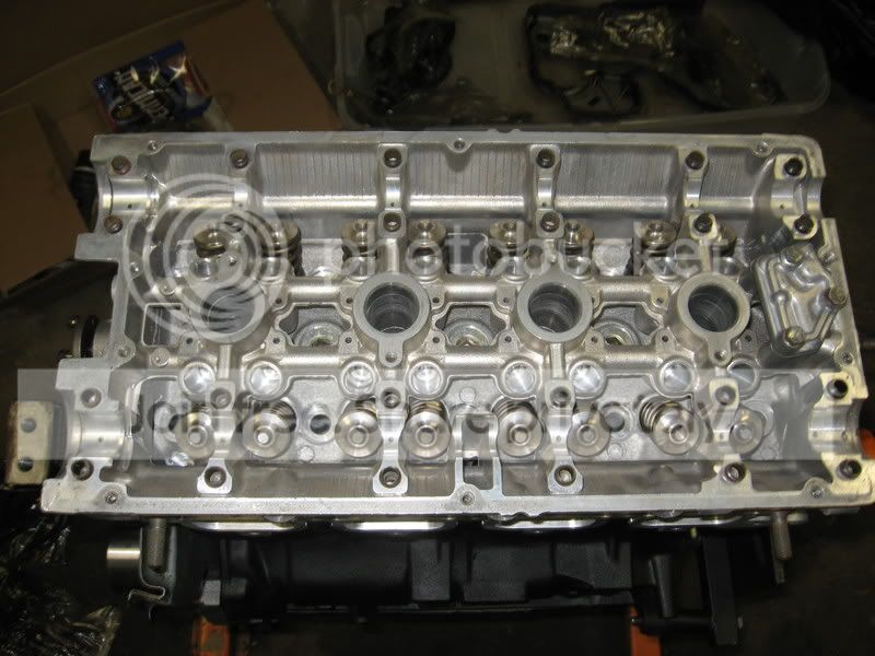

Head After Machine Shop with Manley 4g63 Springs, Titanium Retainers and valve lock kit, Stainless Industries Stainless Steel Valves (Standard Size), SBI Bronze Valve Guides, Ported and Spring Hights set.

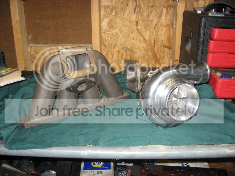

Revhard T4 Manifold and Master Power T70 (Compressor - Inducer - 69.1 Exducer - 91.0)(Turbine - Exducer - 64.5 Inducer - 74.0)

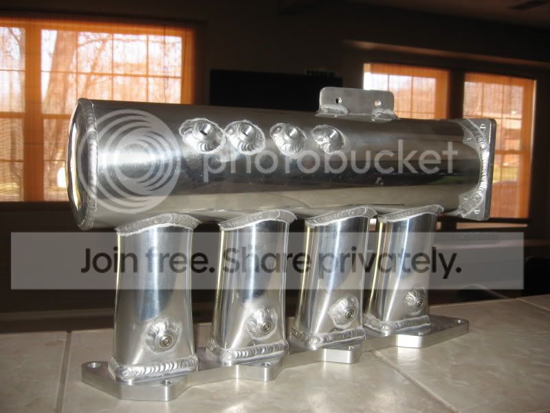

SBR Intake Manifold W/ 75mm Throttle body flange

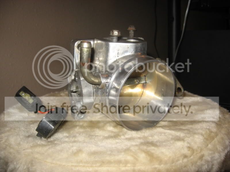

75mm Mustang Throttle Body

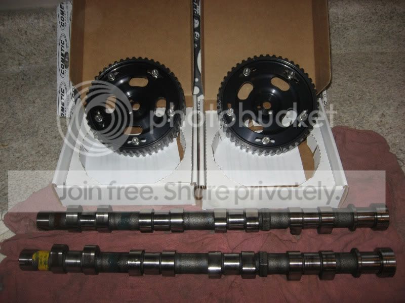

BC 280's and the Fidanza adjustable cam gears, MLS Head Gasket

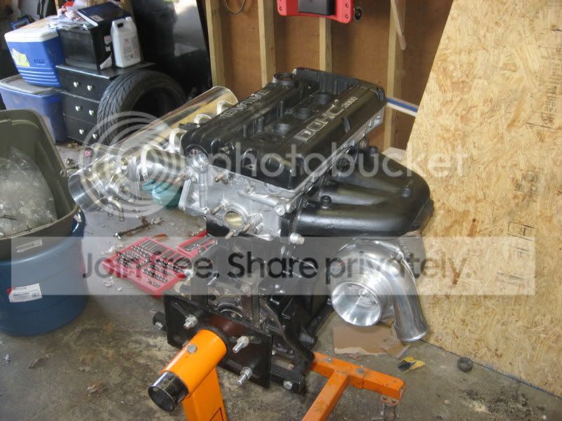

Stuff Laying together still need to Degree Cams
