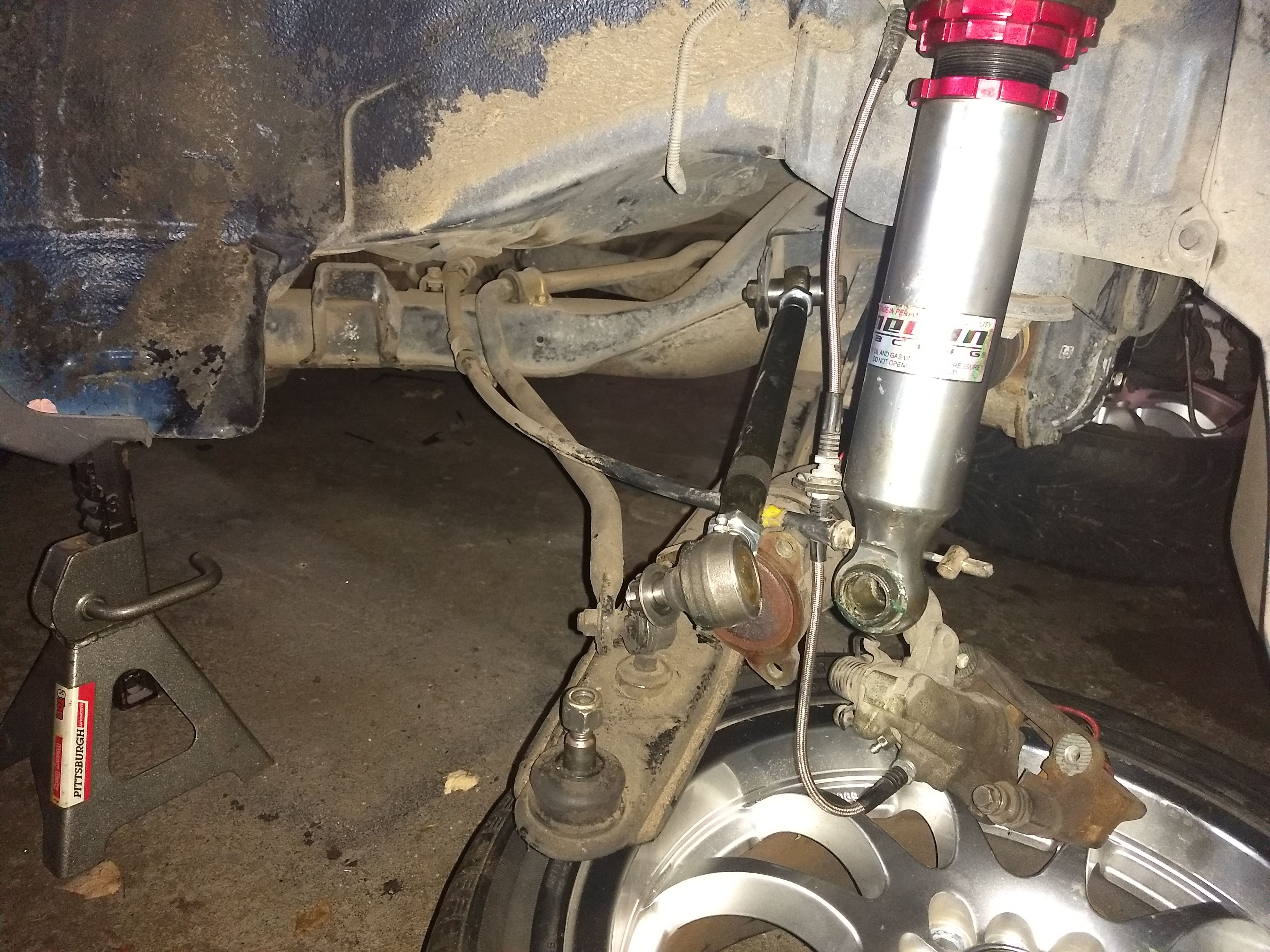

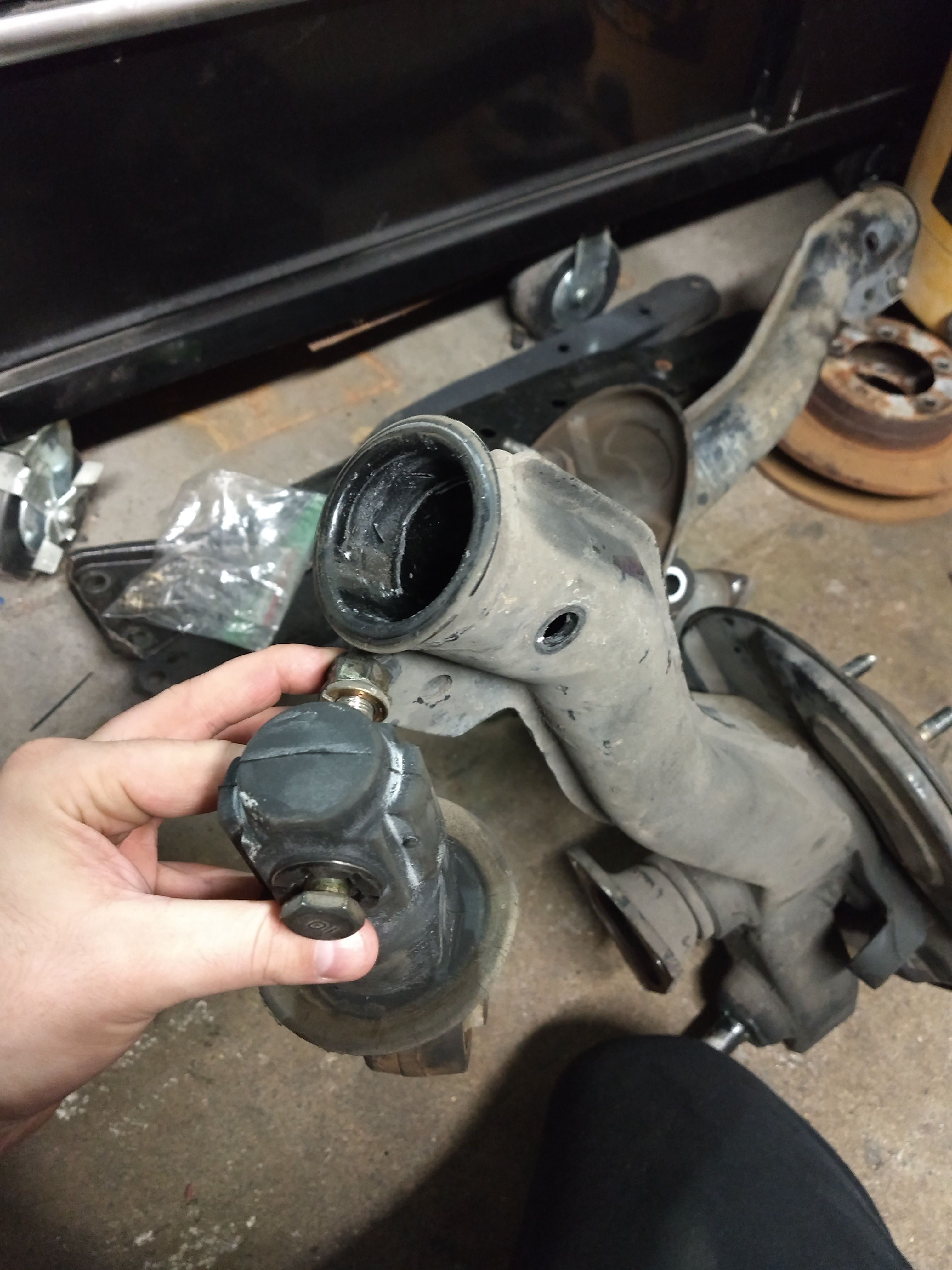

Got the rear upper adjustable control arms installed, rear toe arms removed so that way I can Tig weld the volk toe eliminator kit. Also bought new front Megan racing coilovers lower lock collars. Couldn't get the ones on the shock unseized so going to cut them off and install the new ones. Also in the process of making a tubular front cross member. Will post pics when more progress is done.

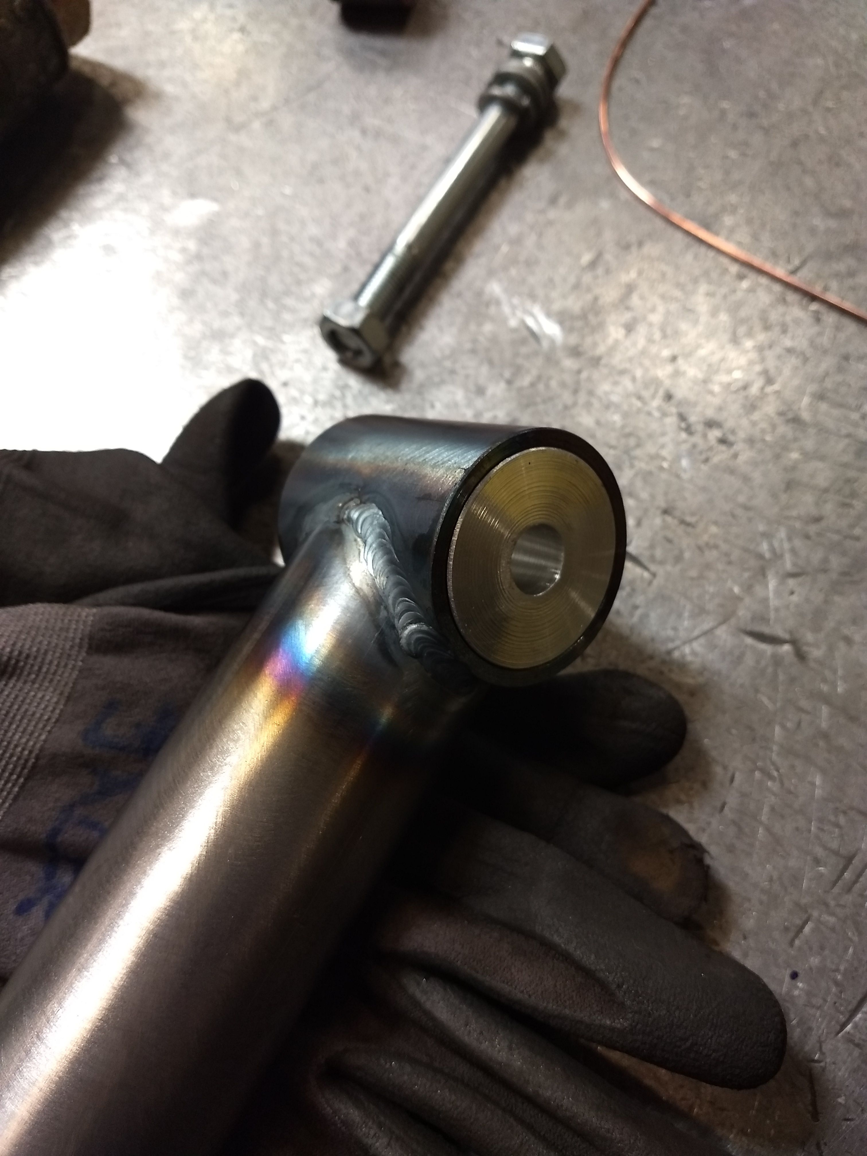

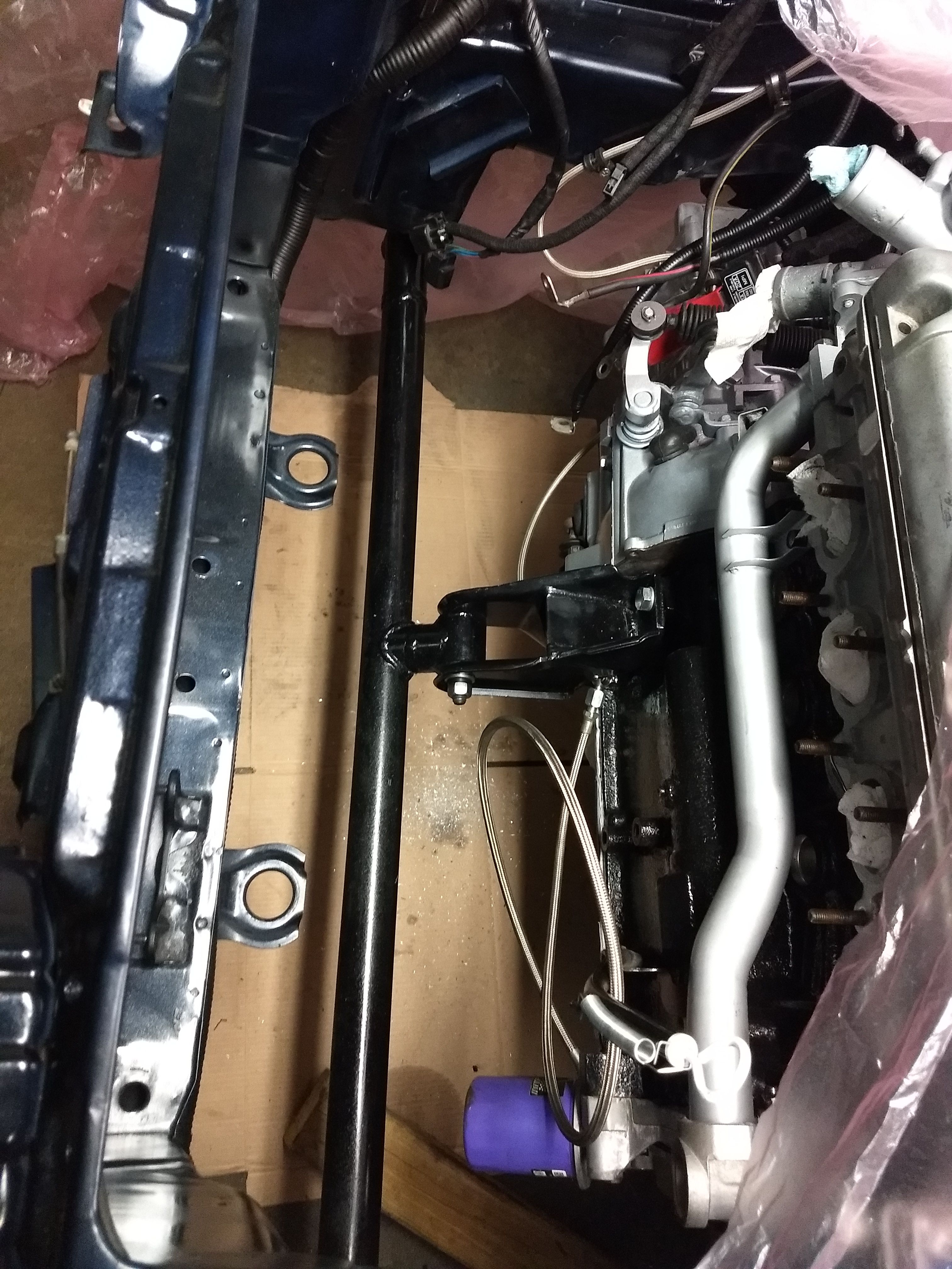

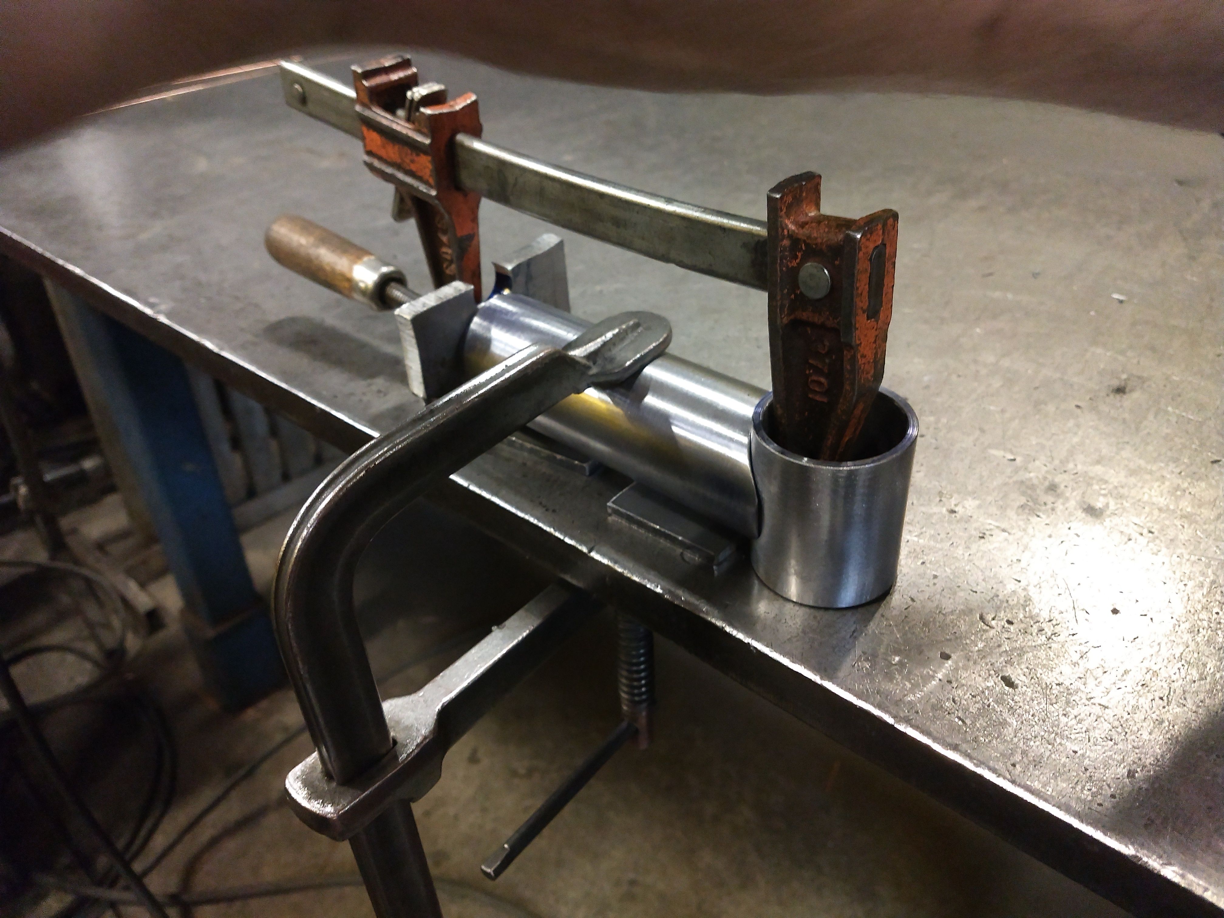

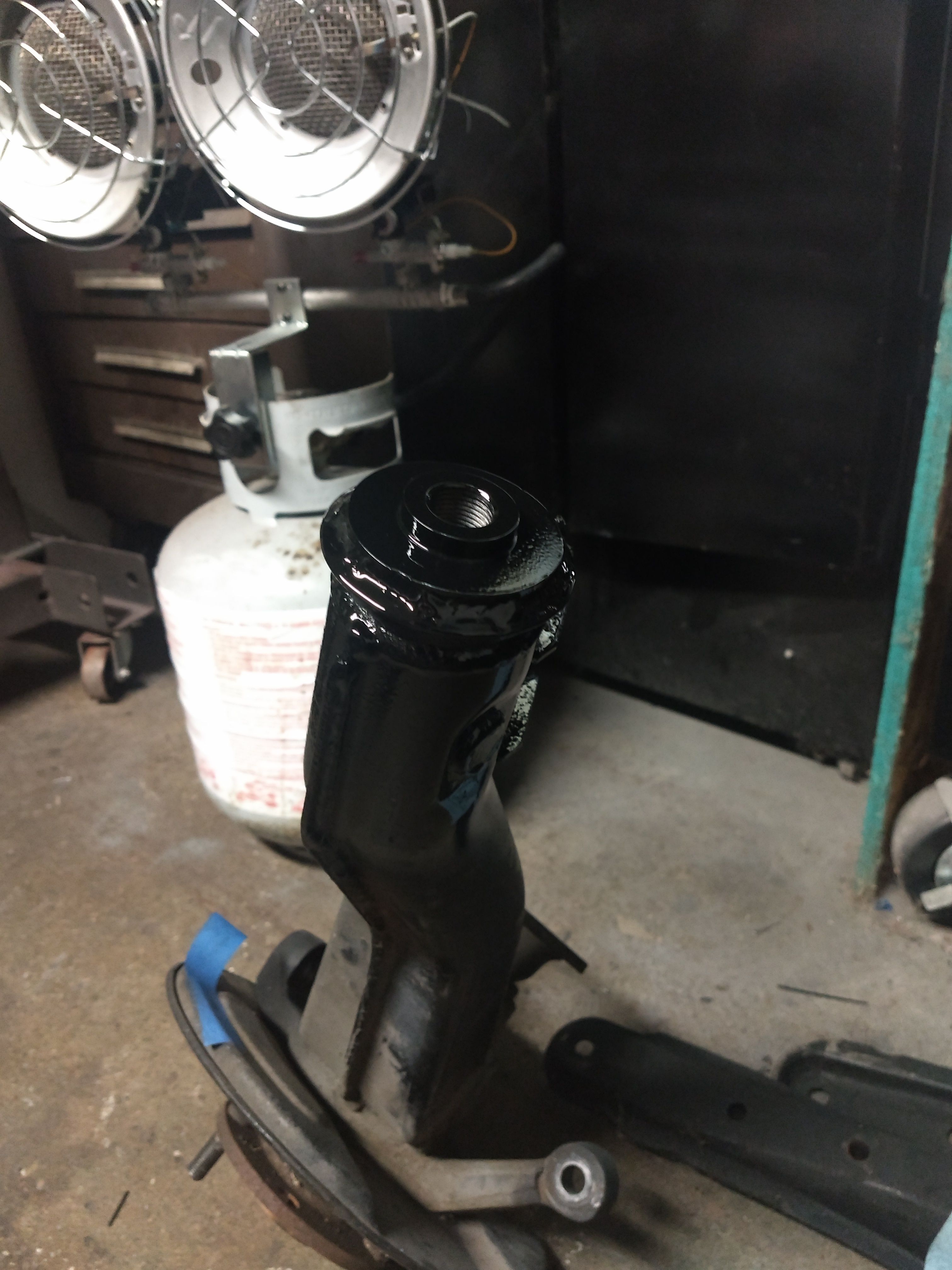

Got quite a few things done today. Took a drive to my dads fab shop to work on making a tubular front cross member and to weld in my toe eliminator kit.

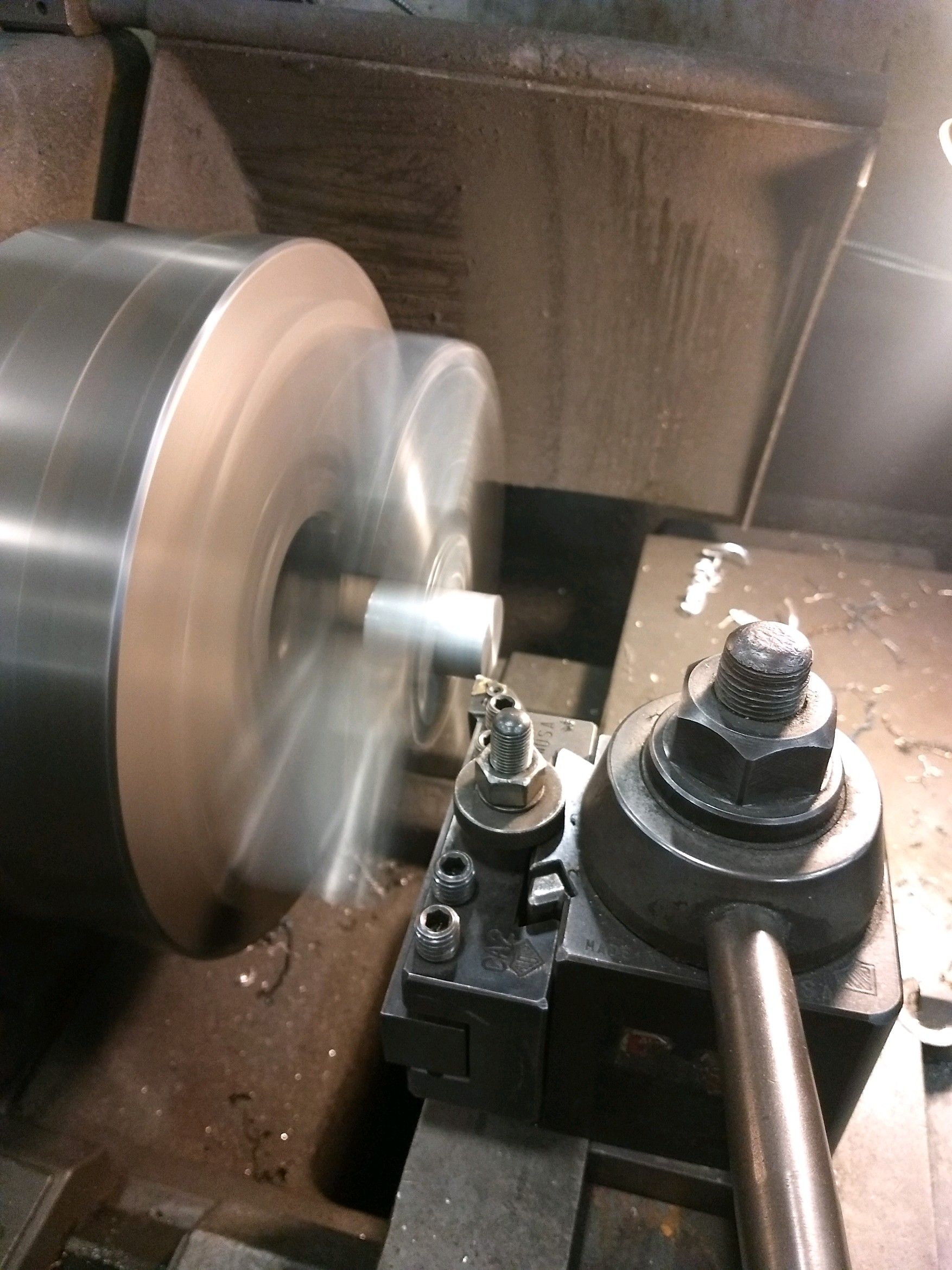

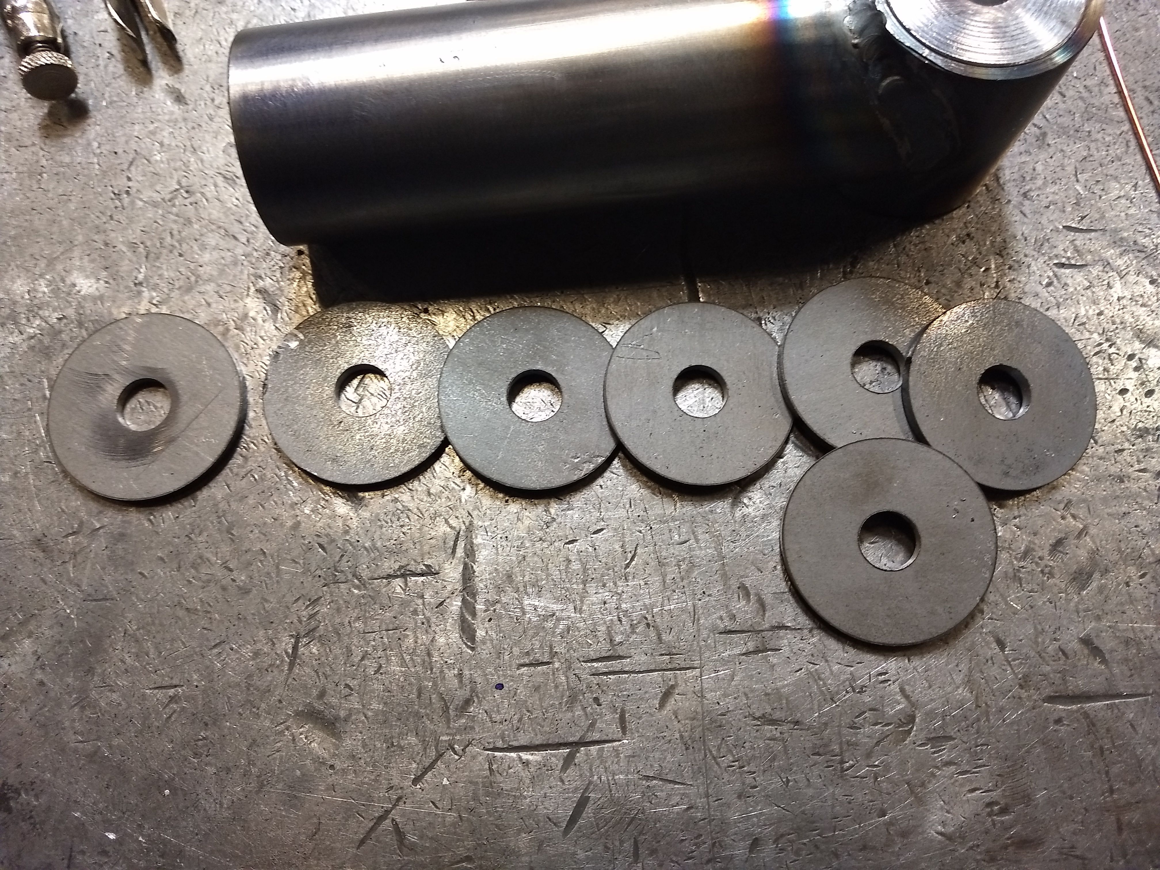

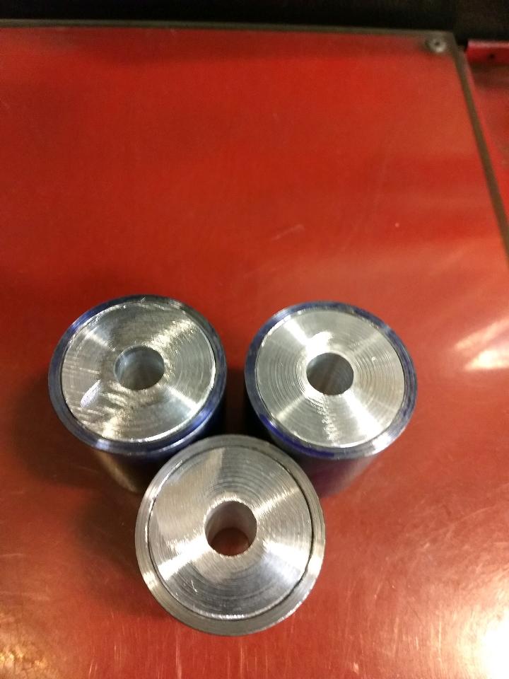

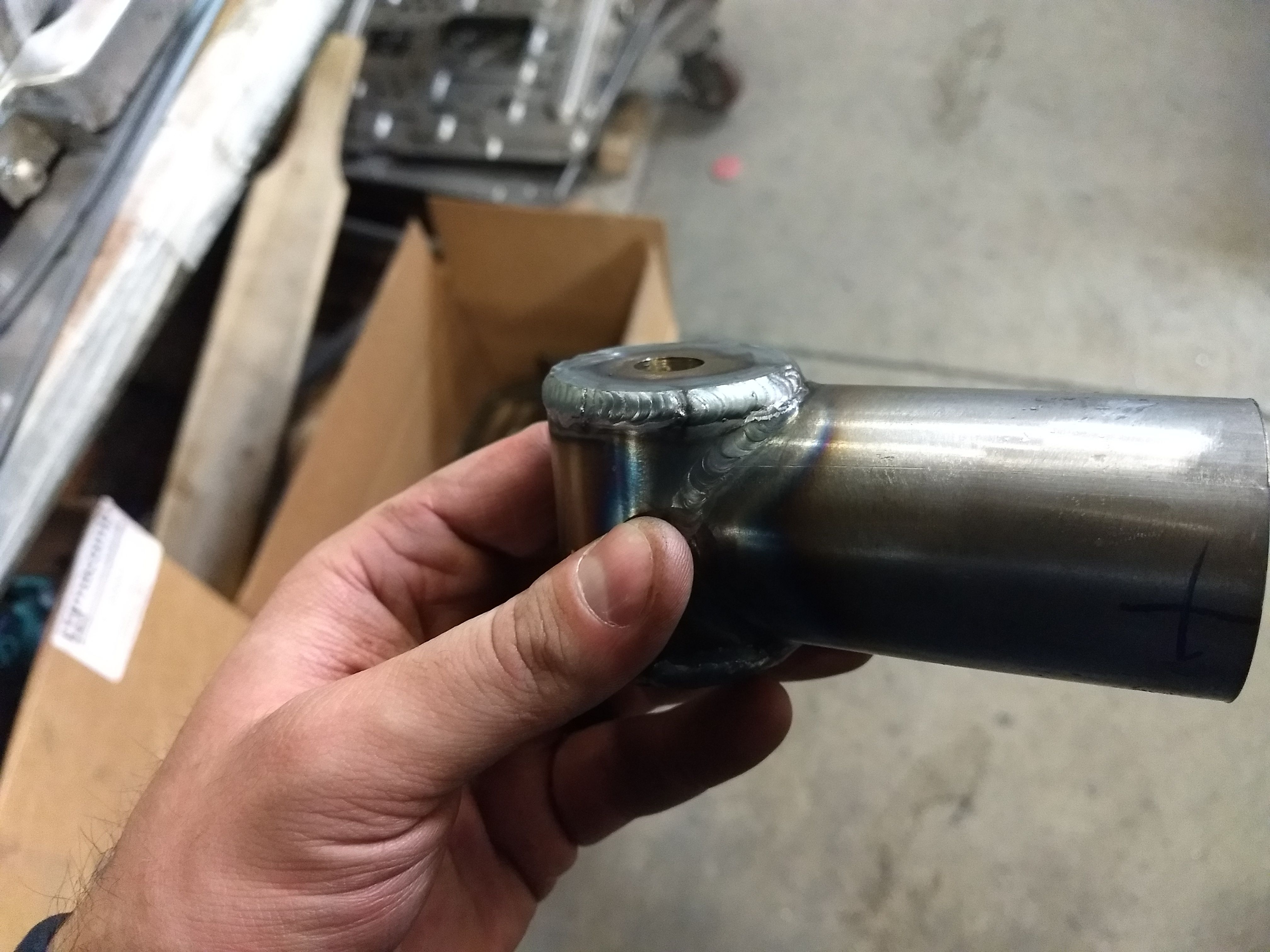

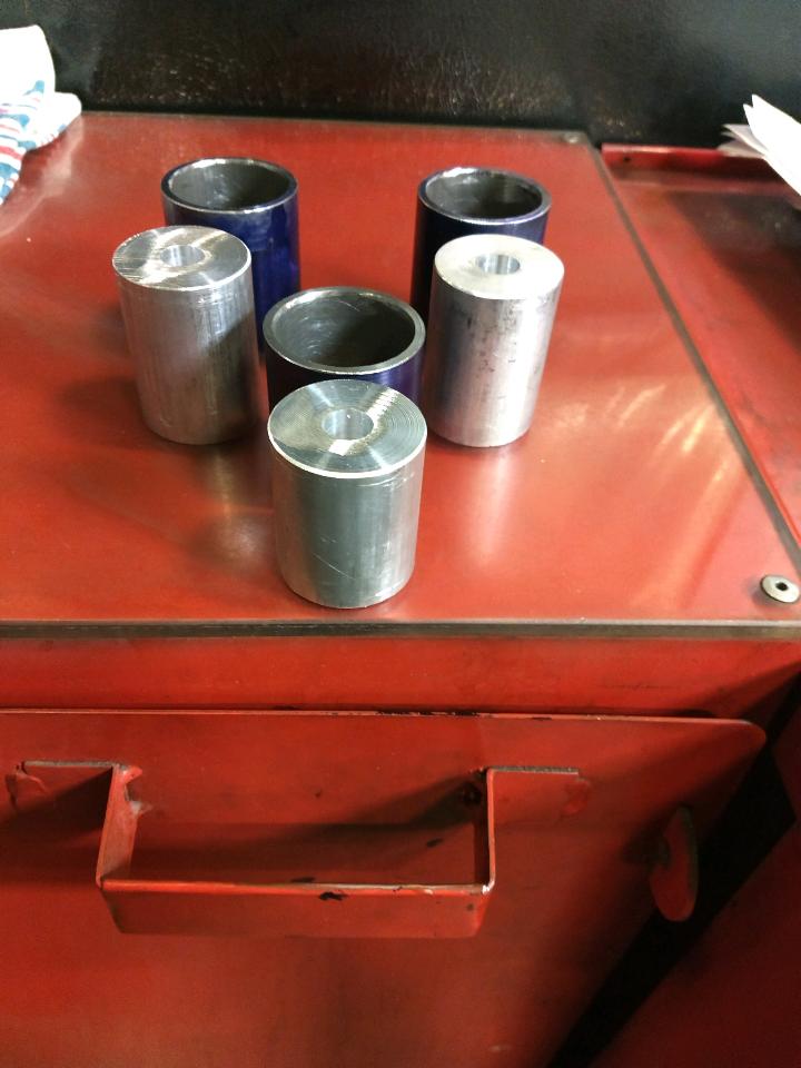

Mounts that tie into the vehicle as well as the front roll stop. Made some aluminum inserts to act as sleeves and fully welded it up.
Some welding for the crossm also the toe eliminator.
More to come, have to mock it up on the car as well as figure out the angle on the rollstop then will be back to fully weld

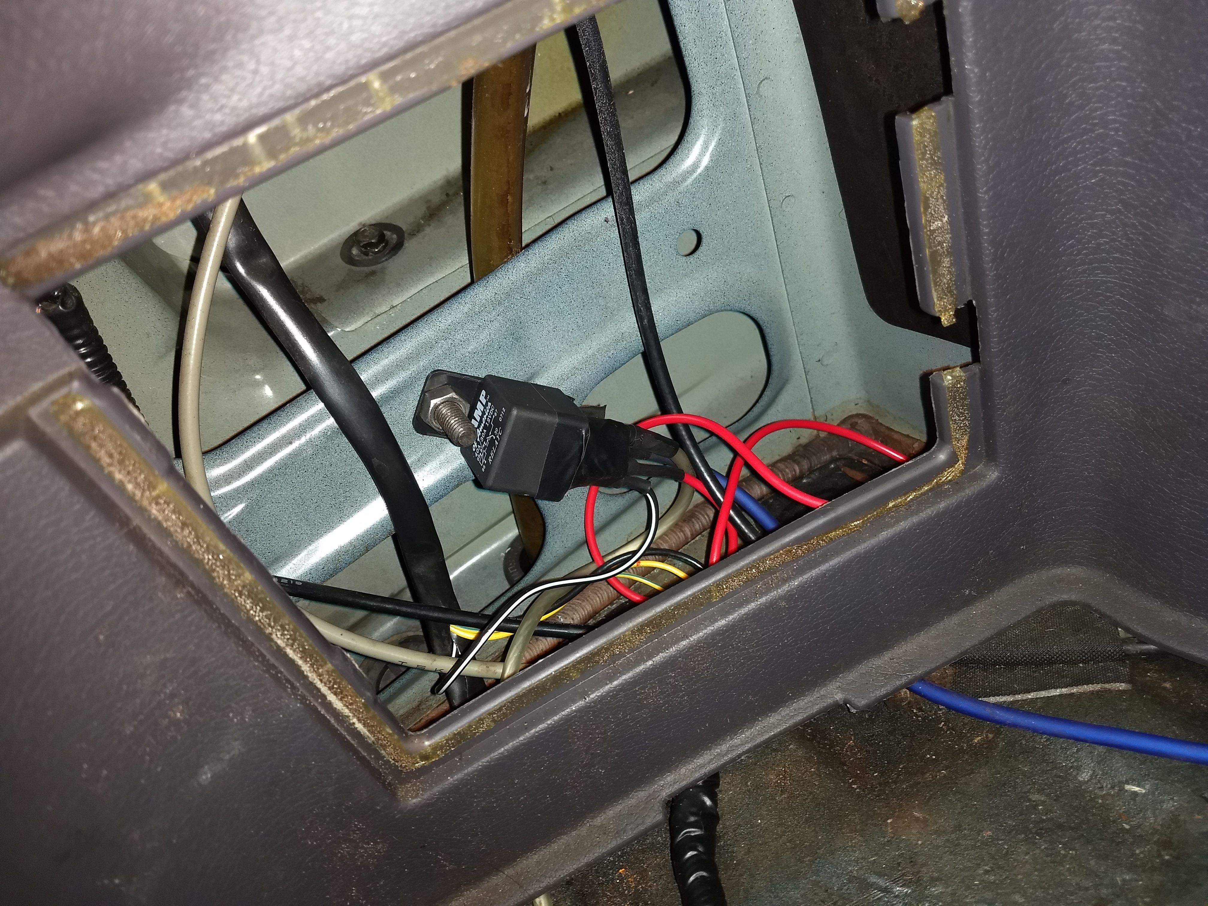

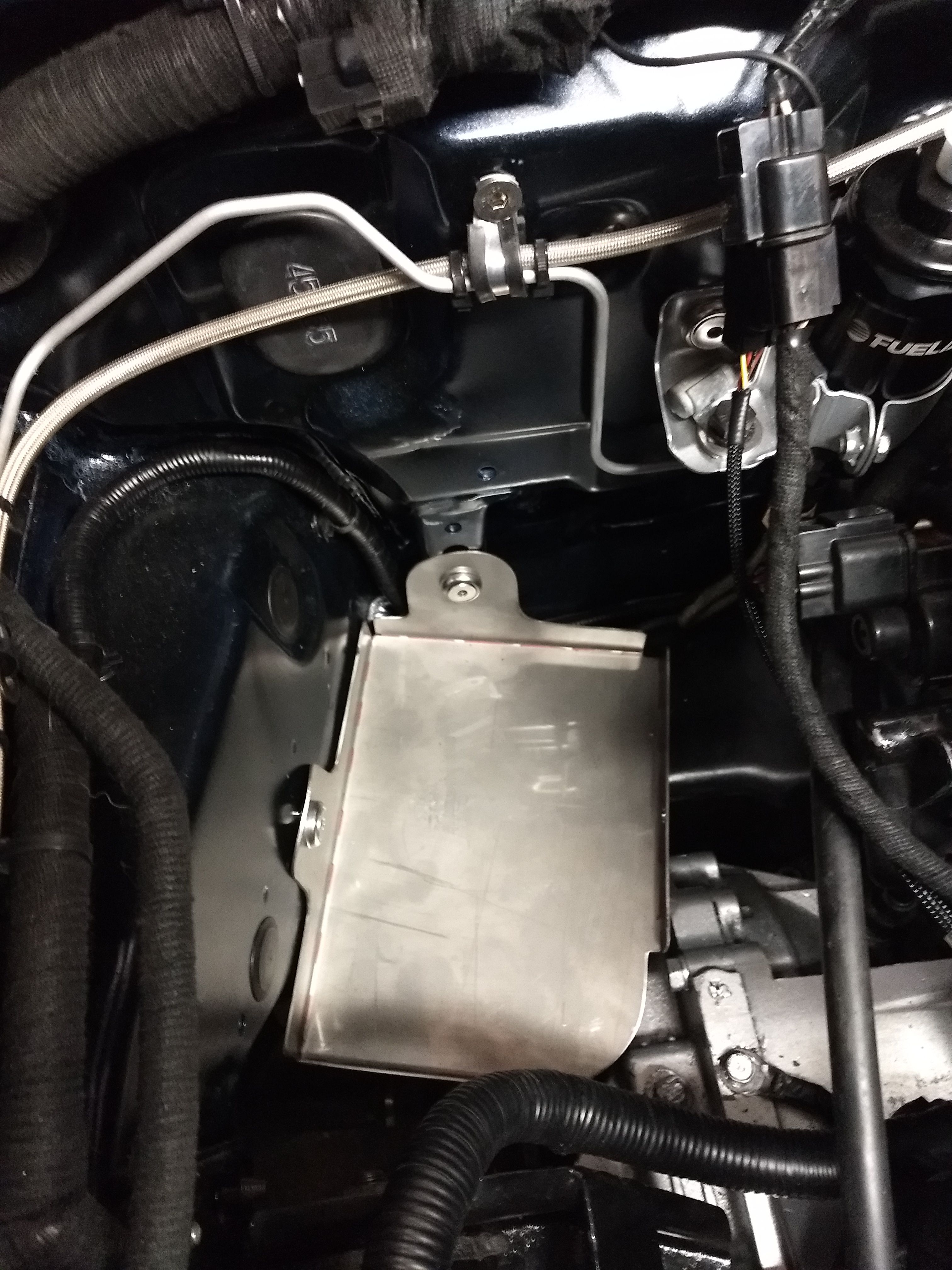

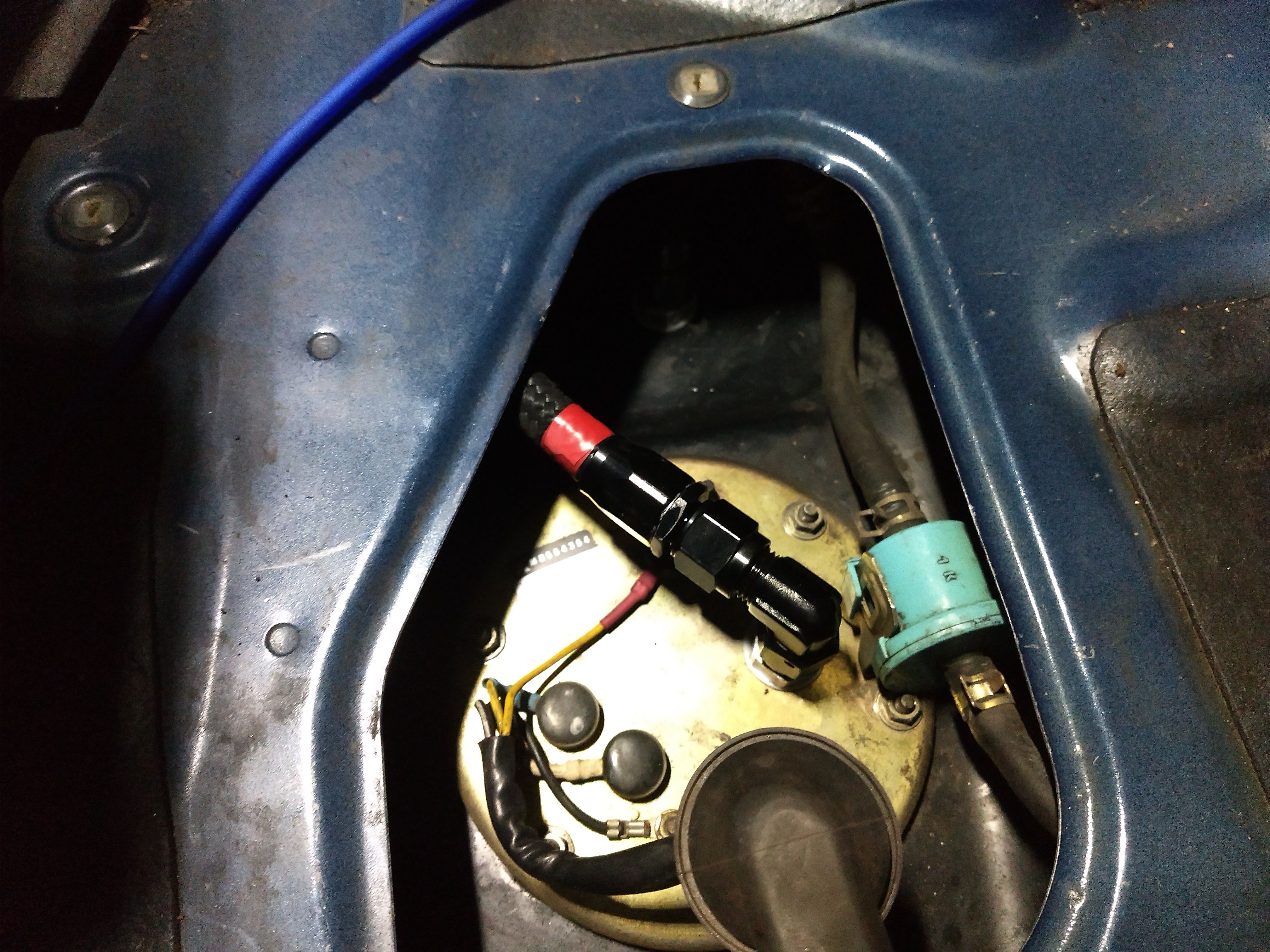

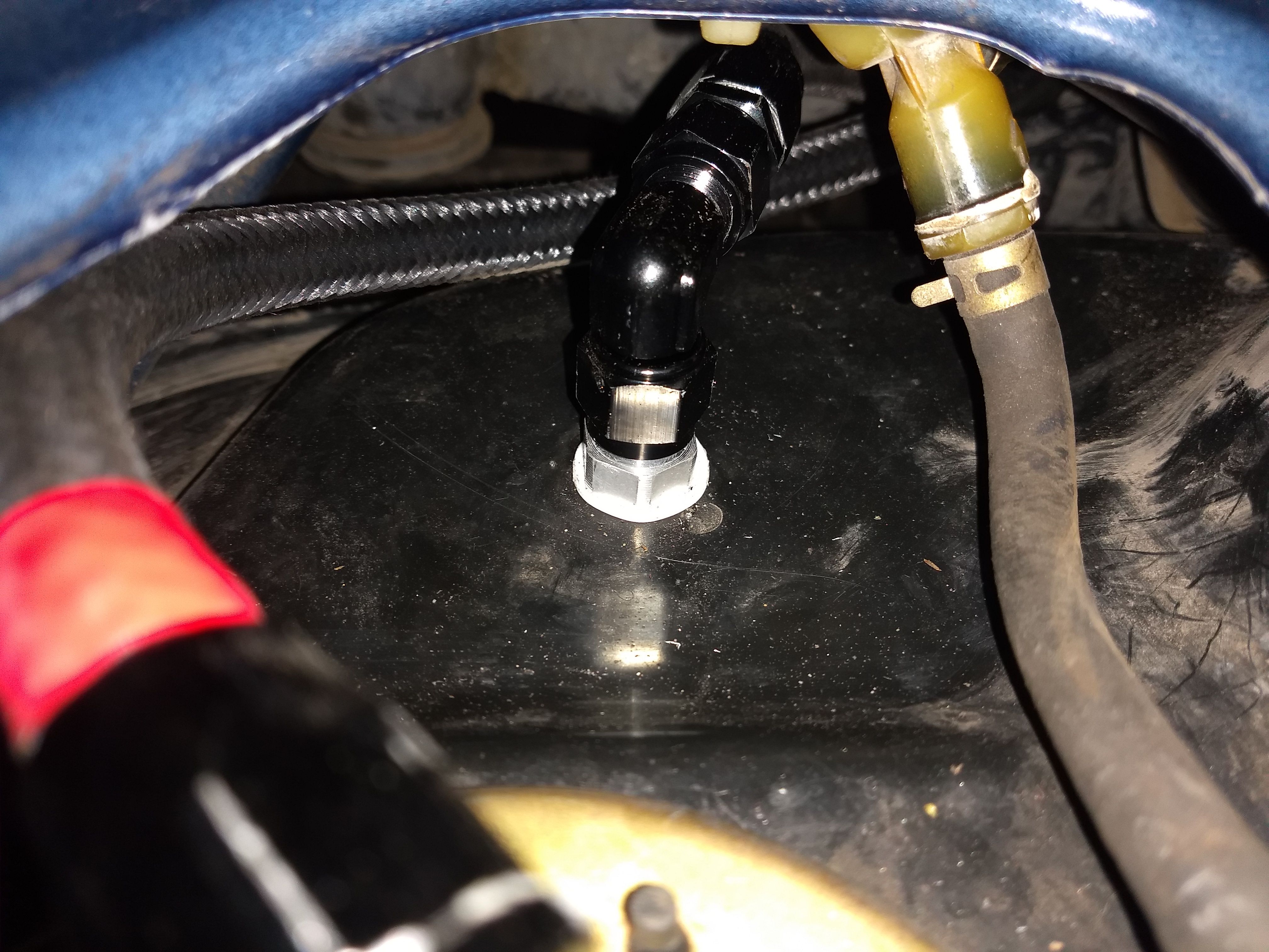

Ended up redoing the factory fuel lines and ran black stainless braided feed and return to the fuel sending unit and gas tank. Also my dad came in clutch as usual and made a badass battery tray out of some stainless. Makes it sit really low so I have clearance for the intercooler piping.

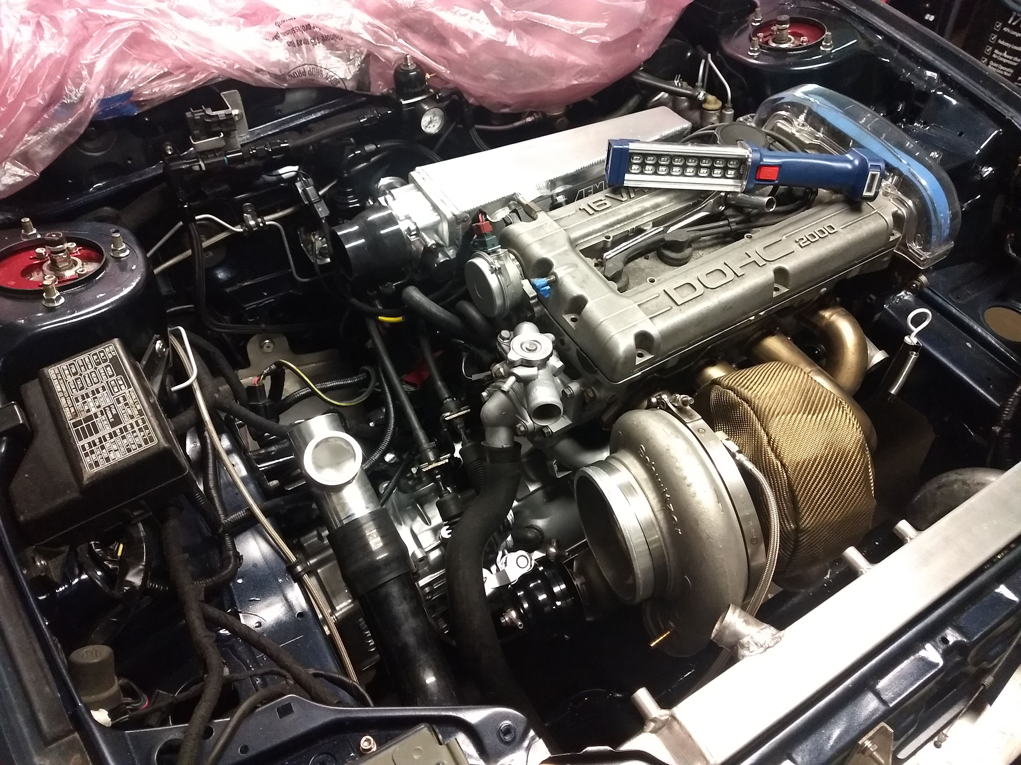

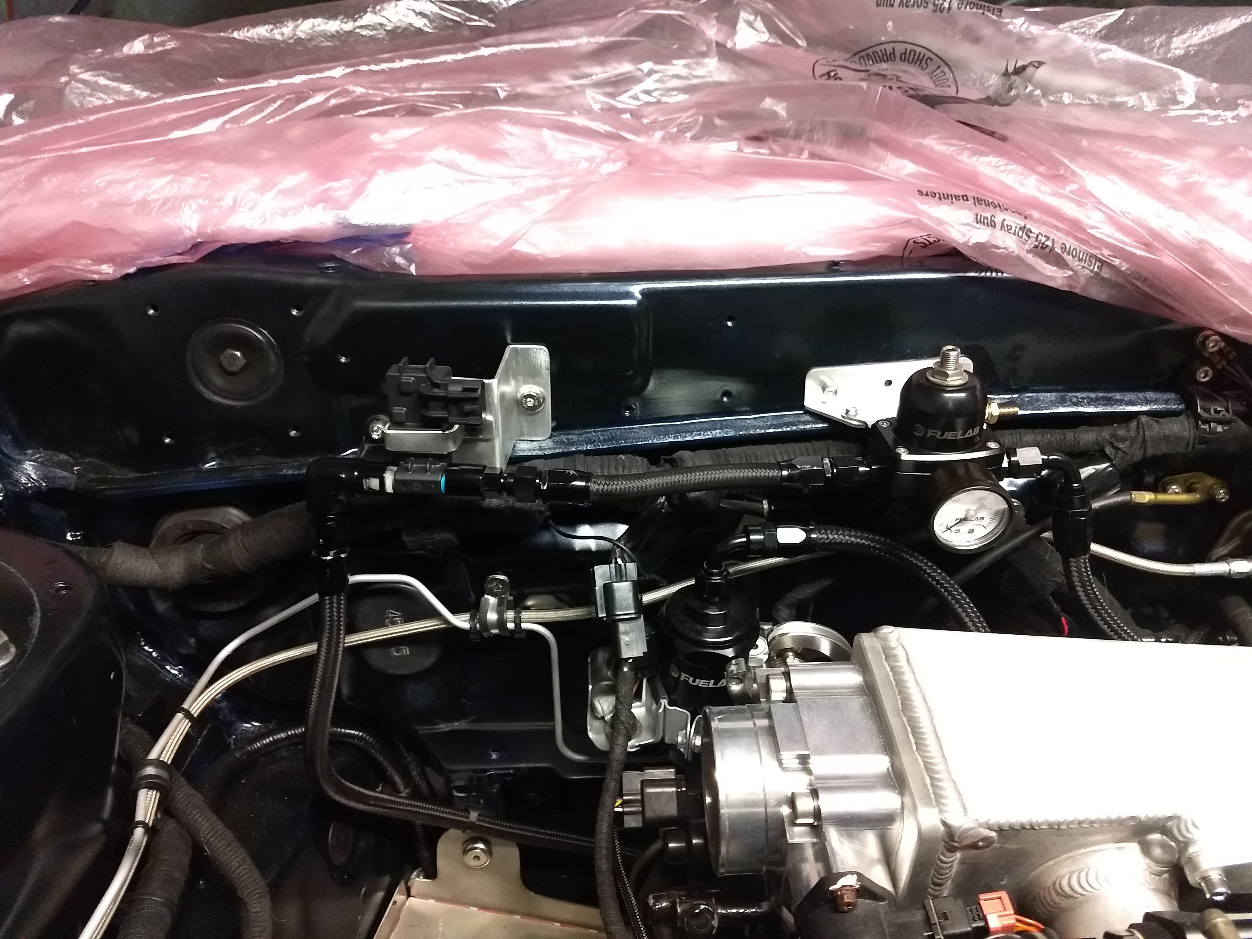

Gm flex fuel sensor, and fuel lab fpr installed along with all the lines and fittings. All that is needed now is to wire up the sensor. Got the turbo mounted as well as all the lines ran. Working on wastegate dumps as well as exhaust routing. Pics of turbo, manifold, and wastegate setup to come.

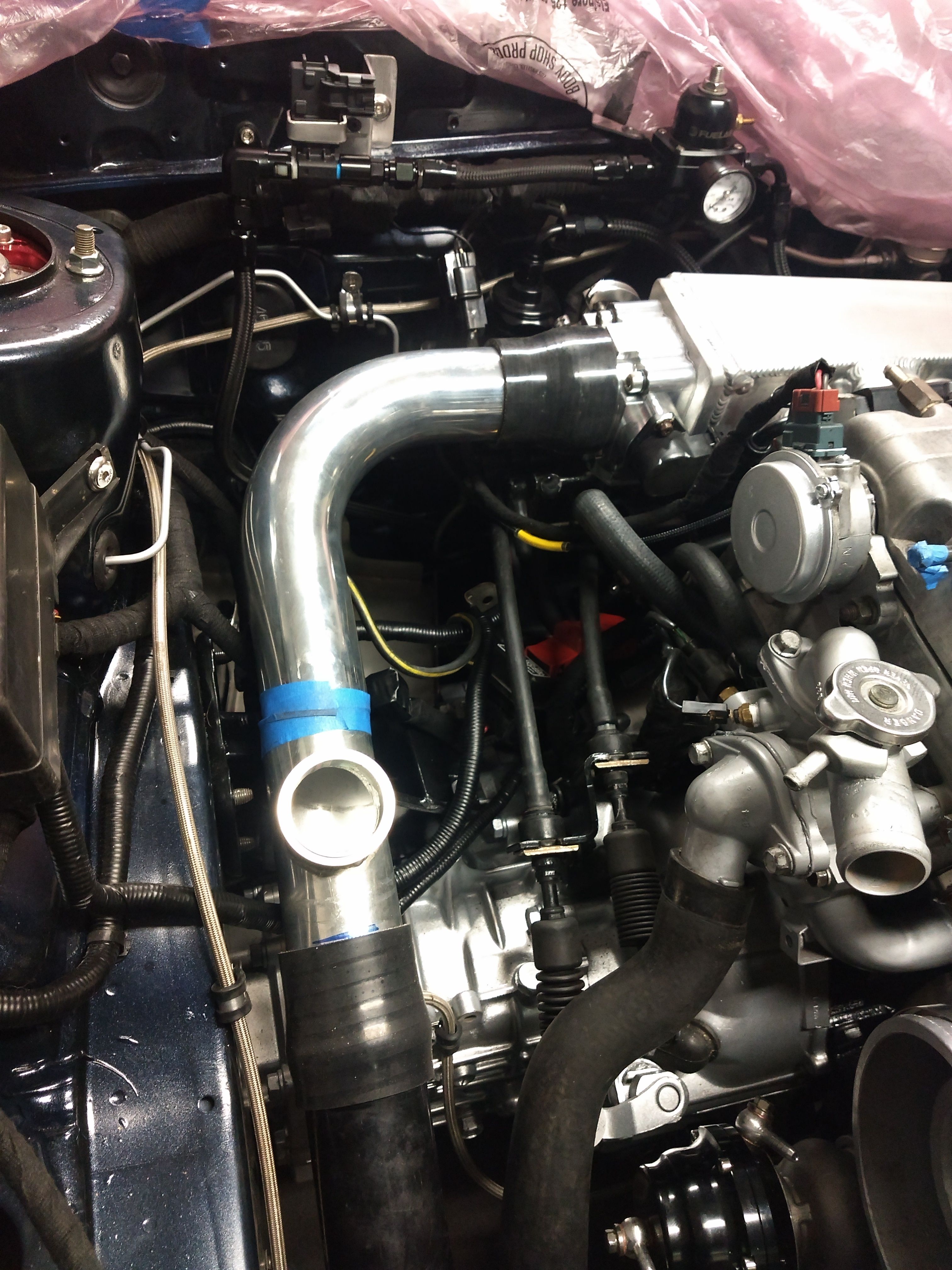

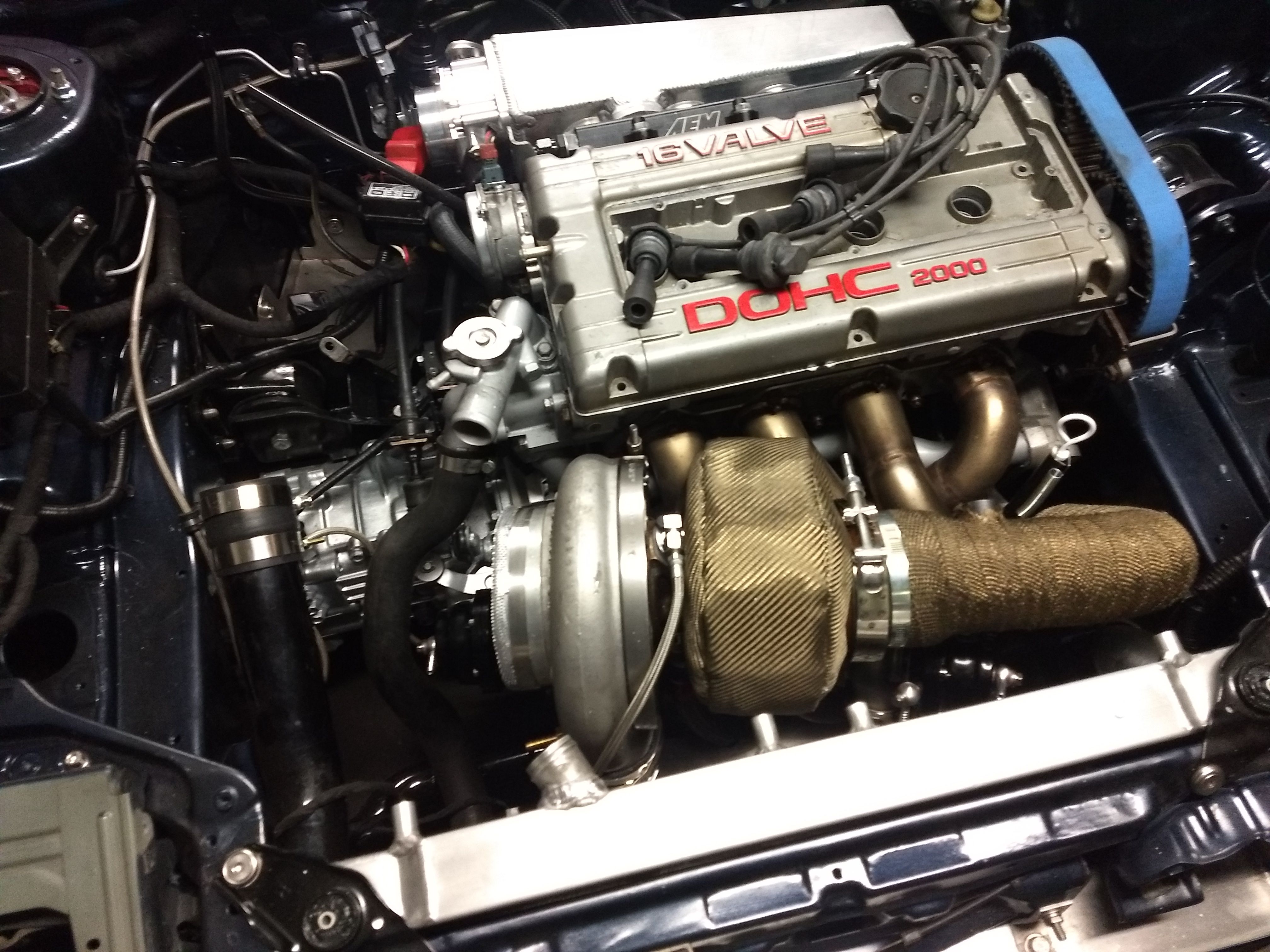

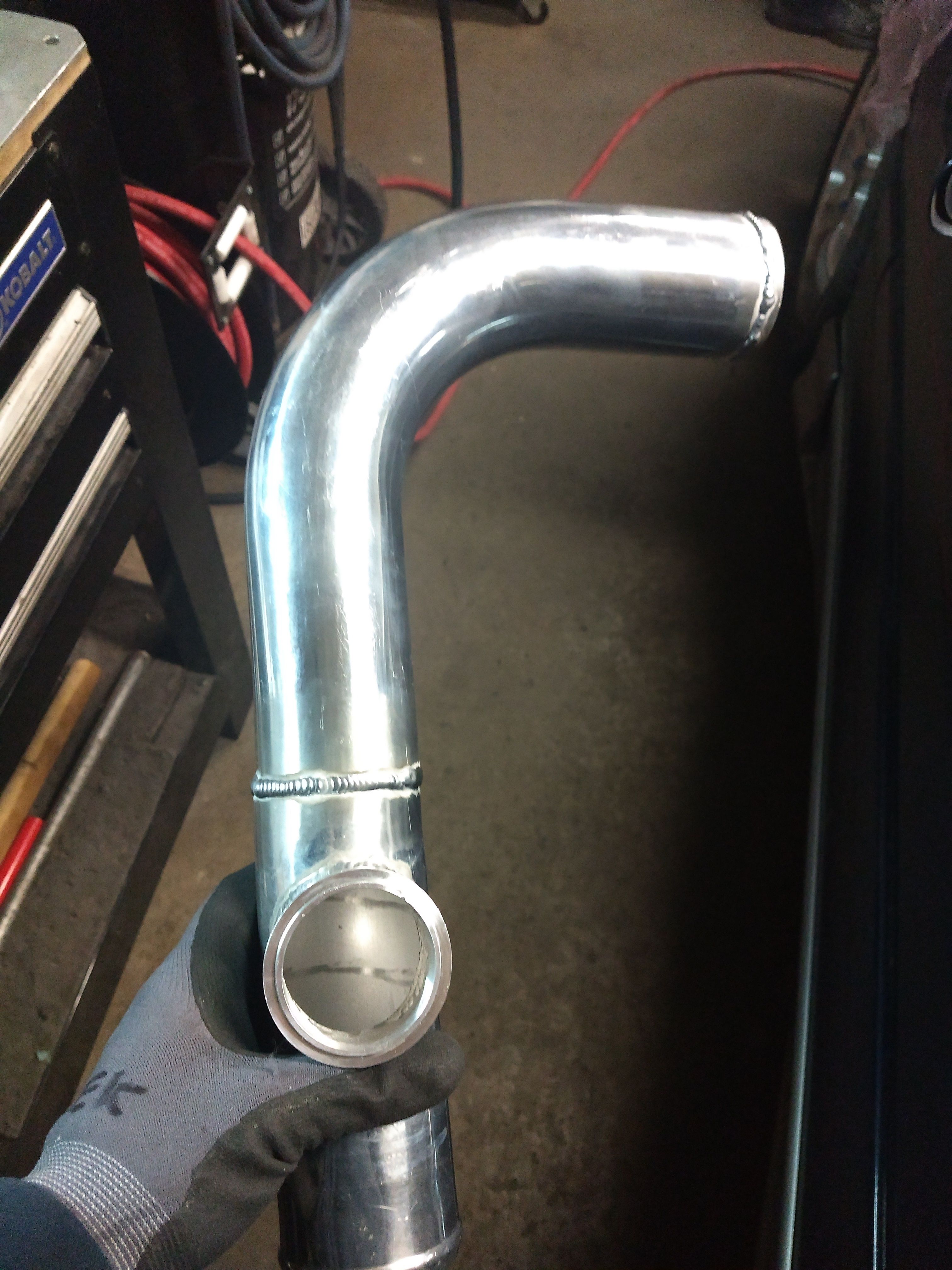

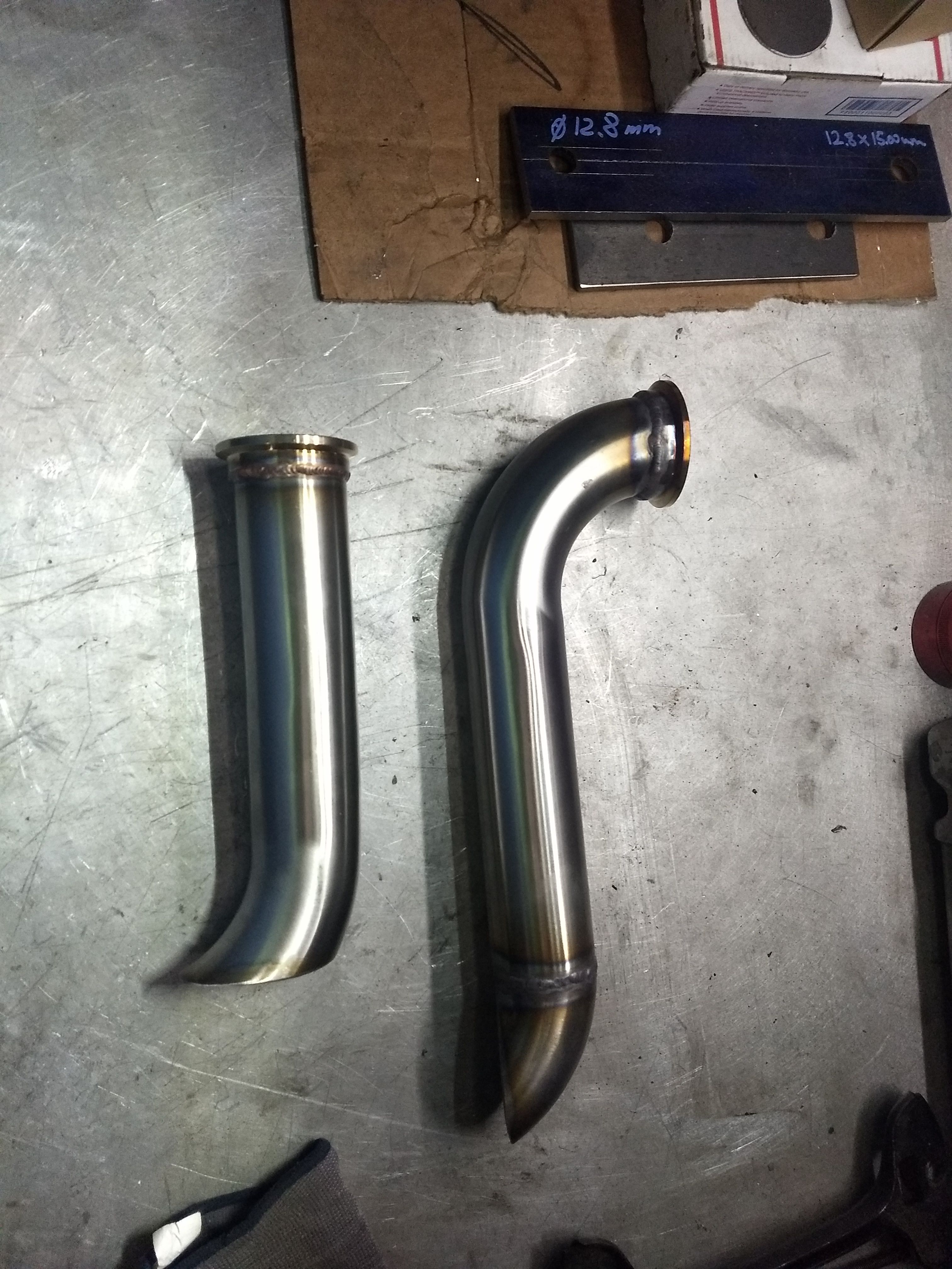

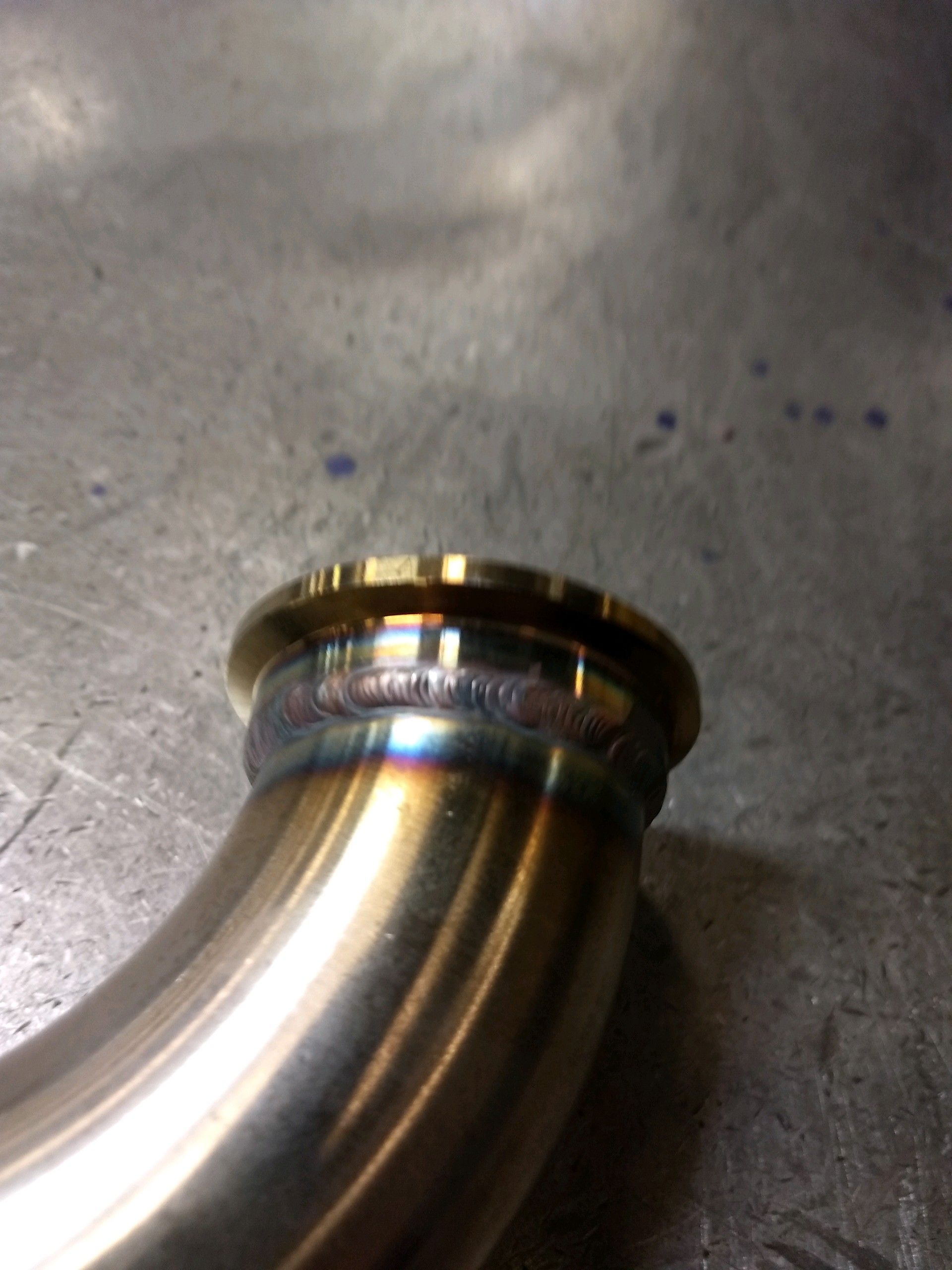

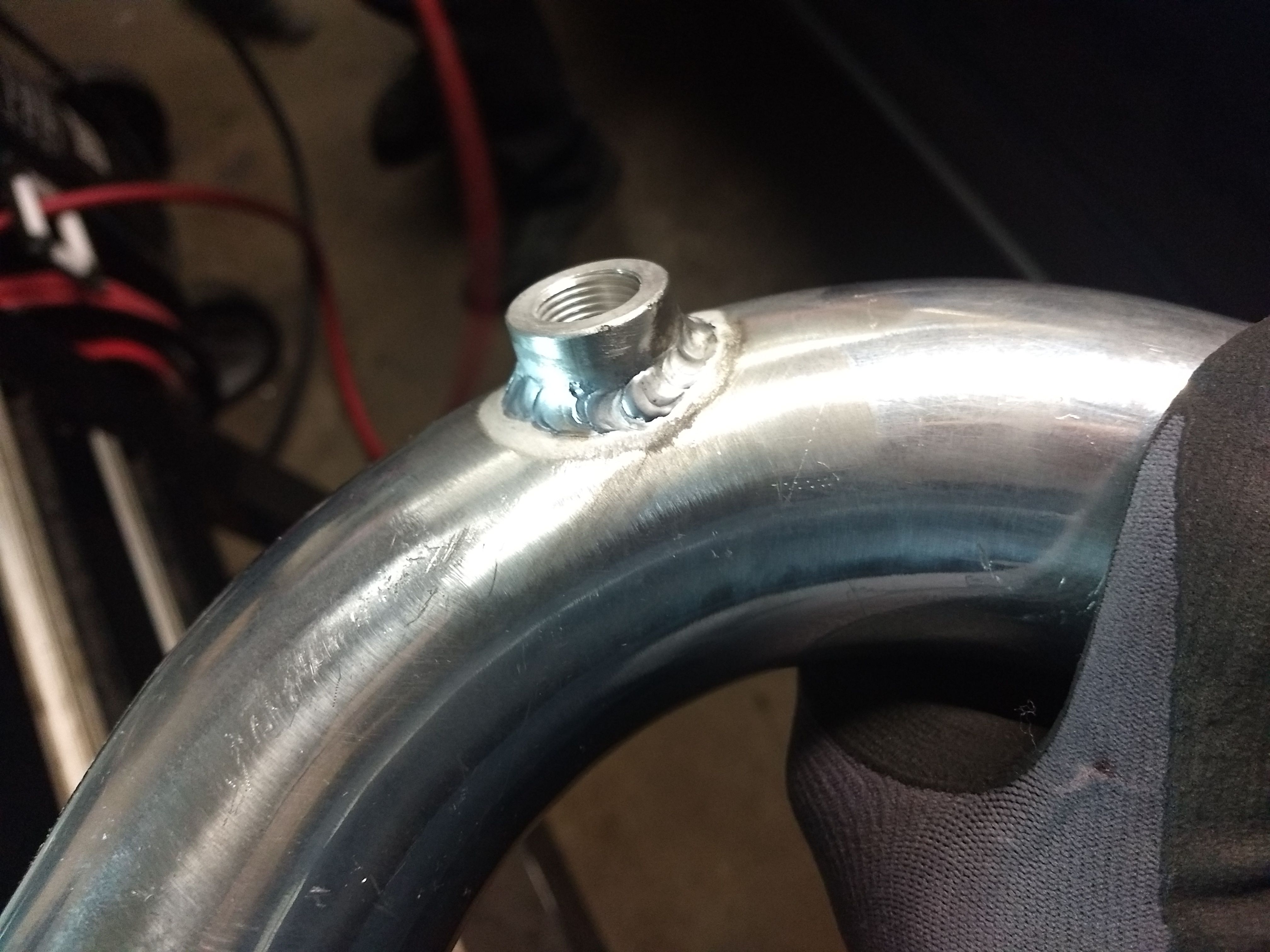

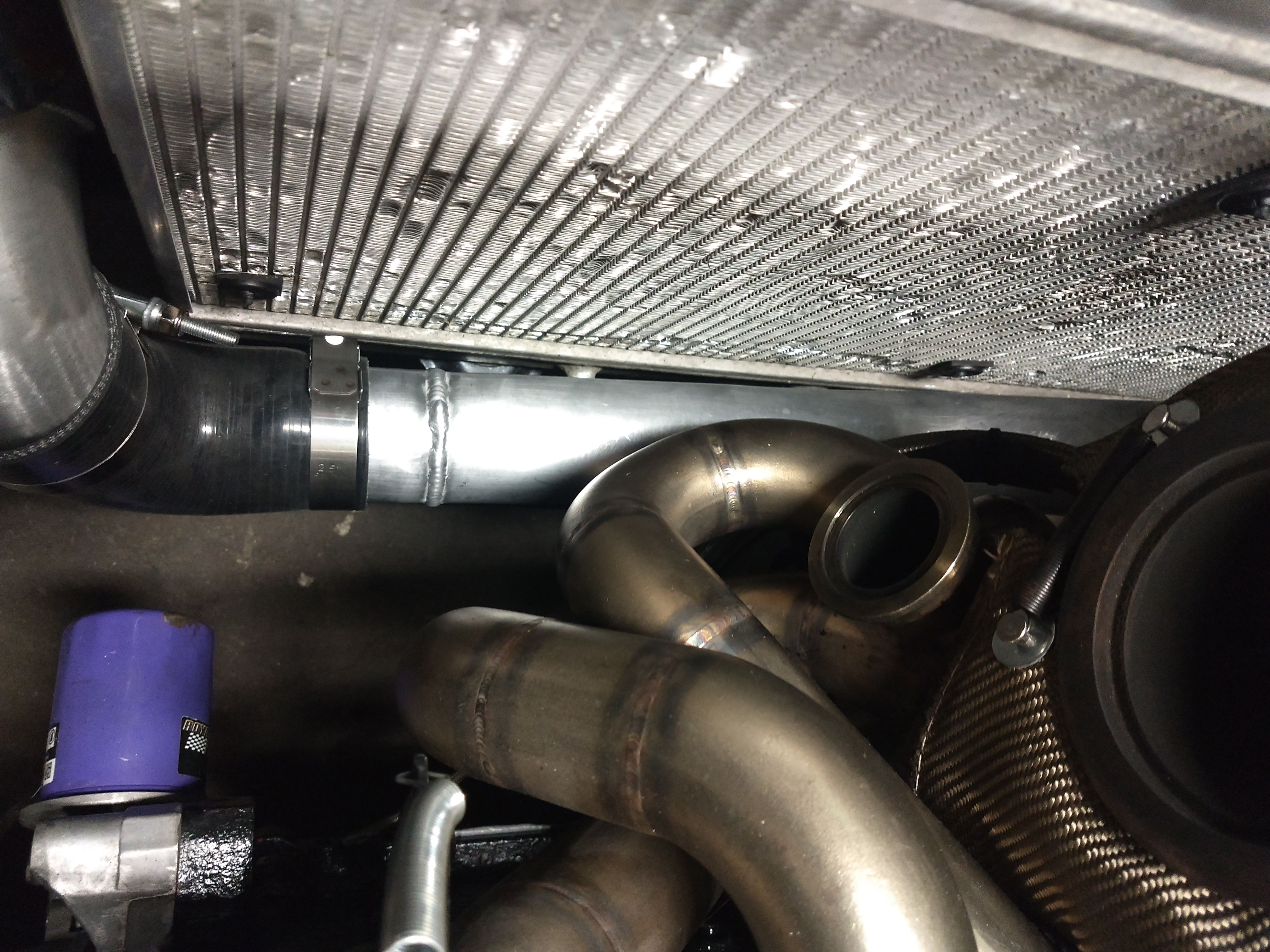

Exhaust manifold mounted, turbo mounted and oil lines ran, wastegates mounted, intercooler piping made to fit and iat sensor bung location established. Just need to weld the intercooler piping up this weekend and should be able to start making the exhaust.

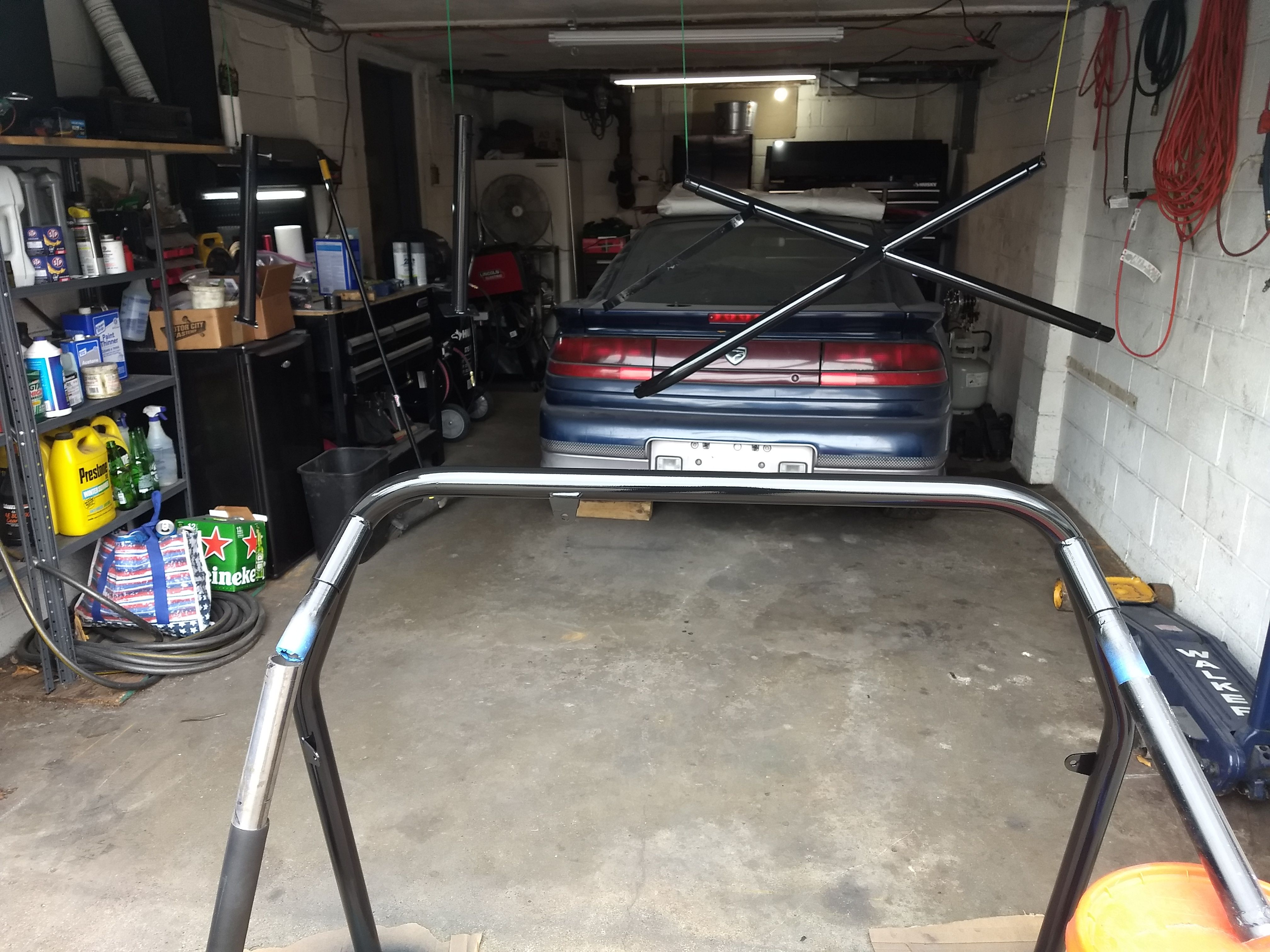

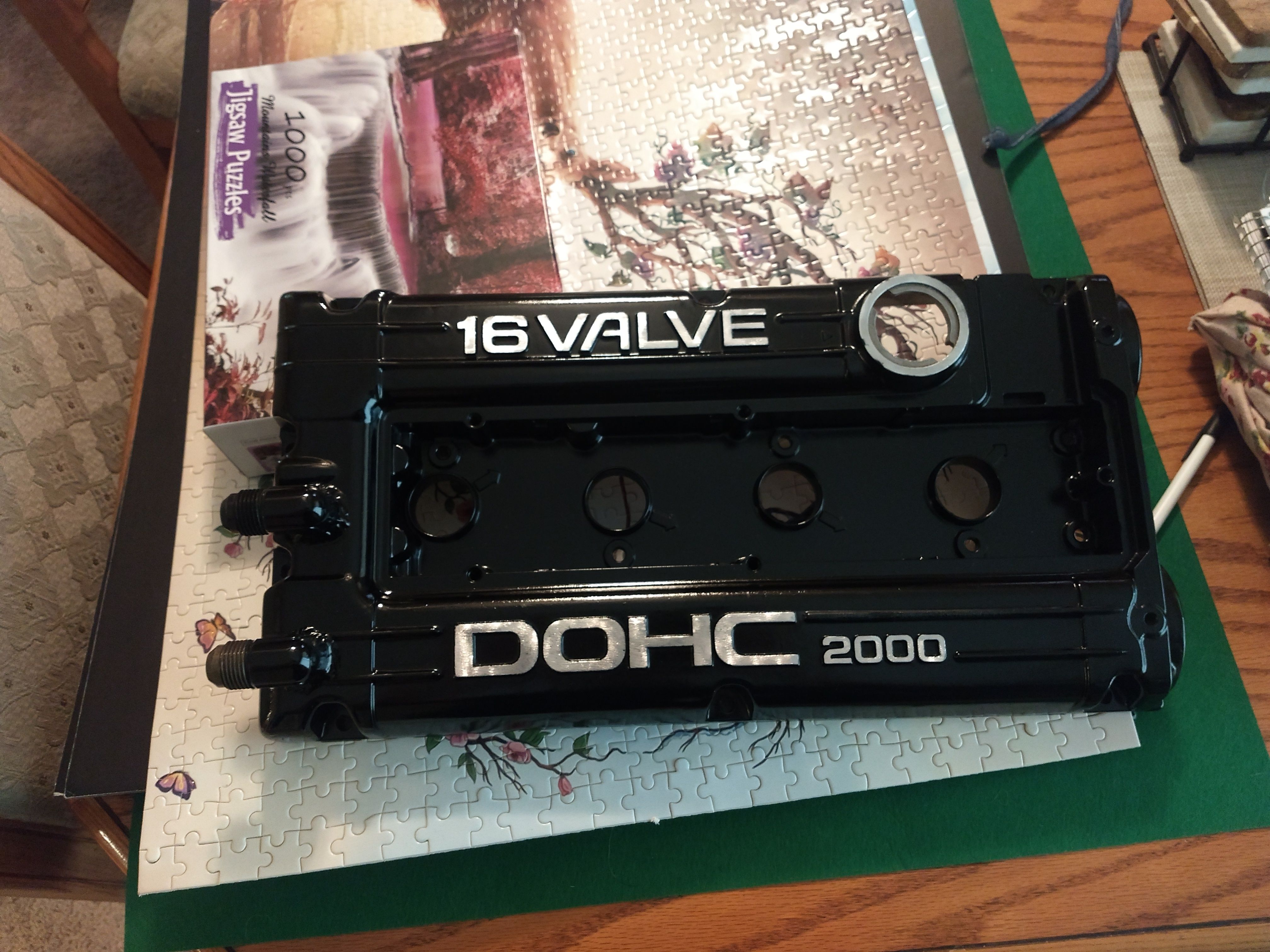

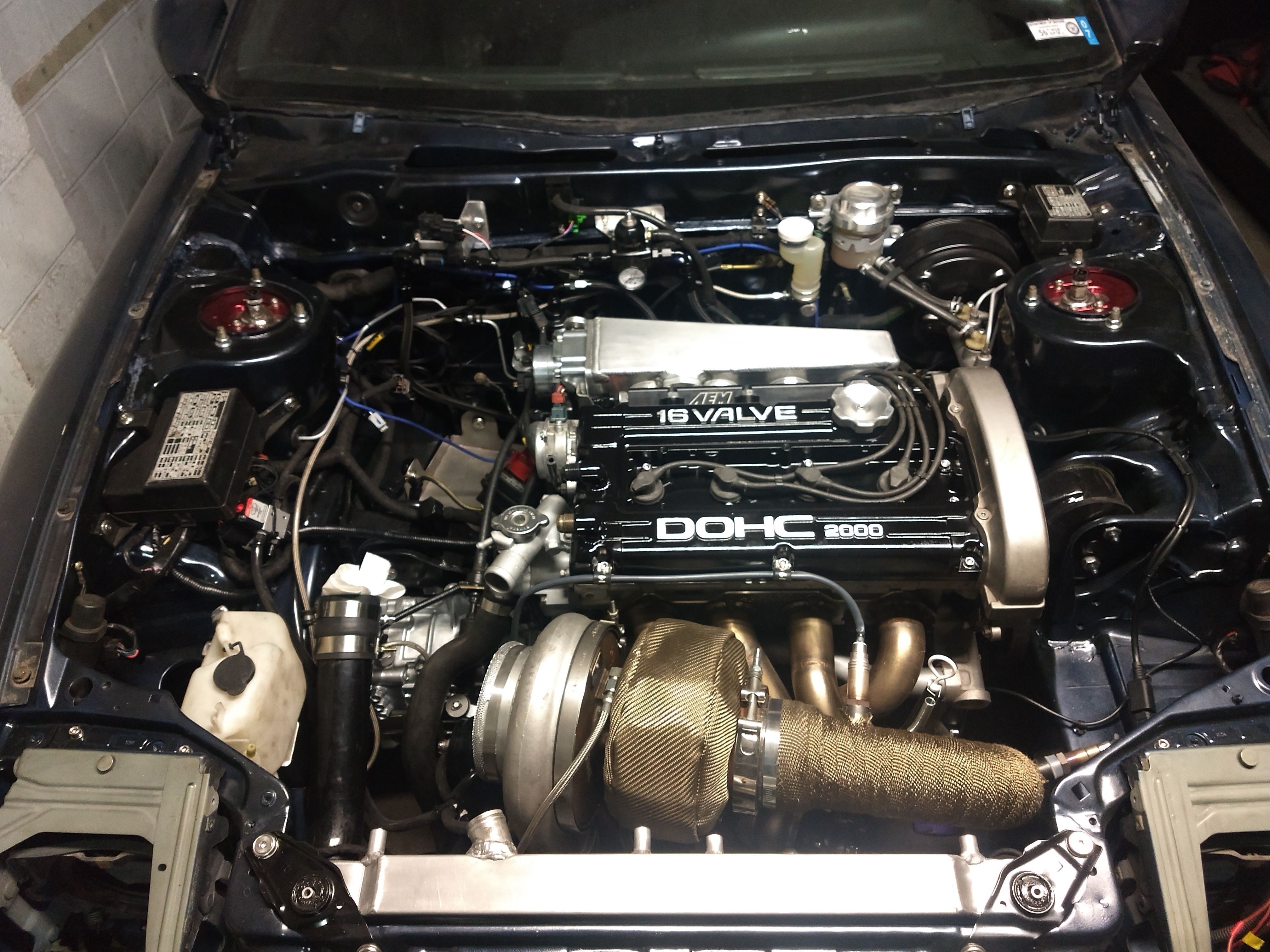

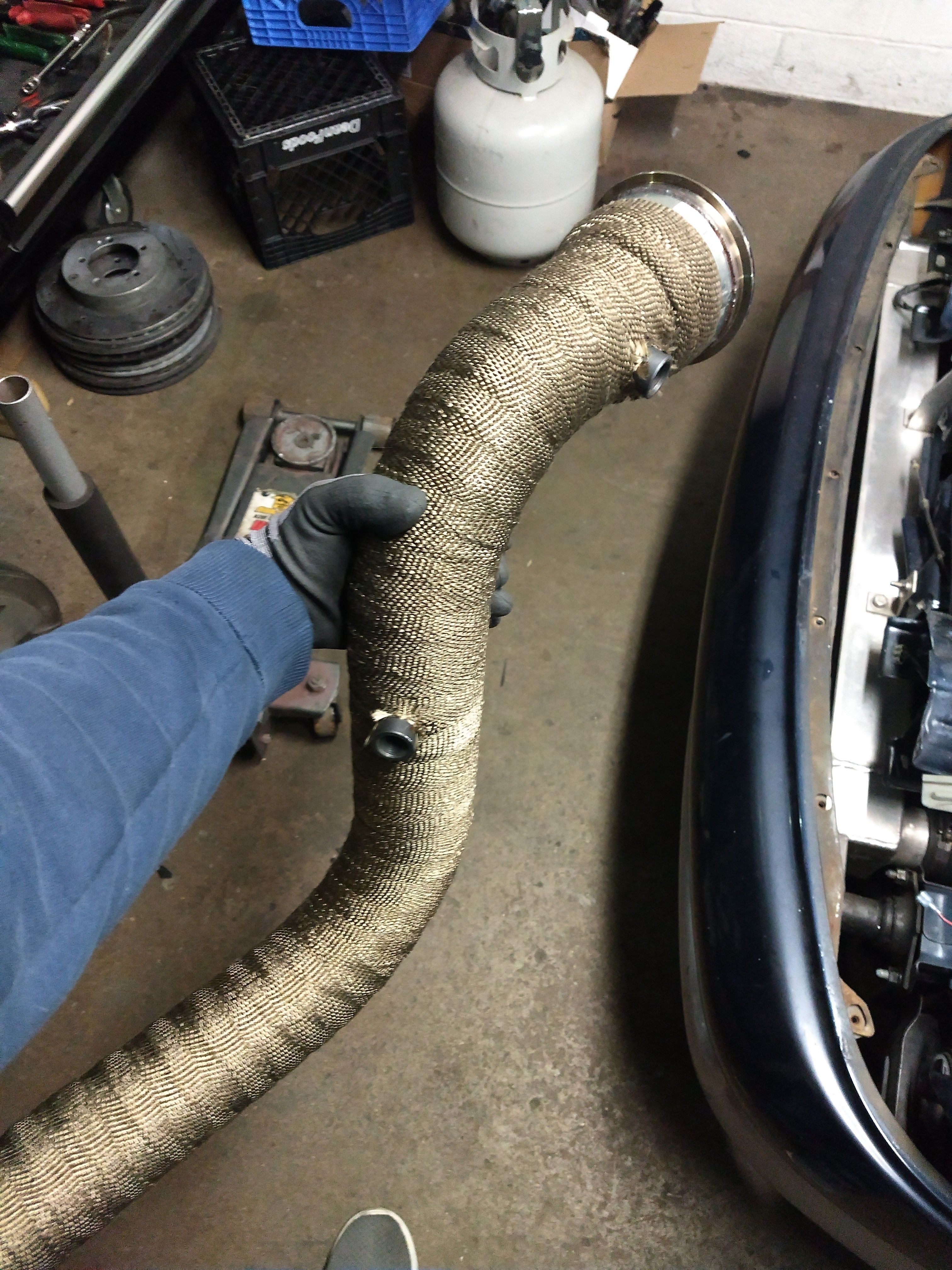

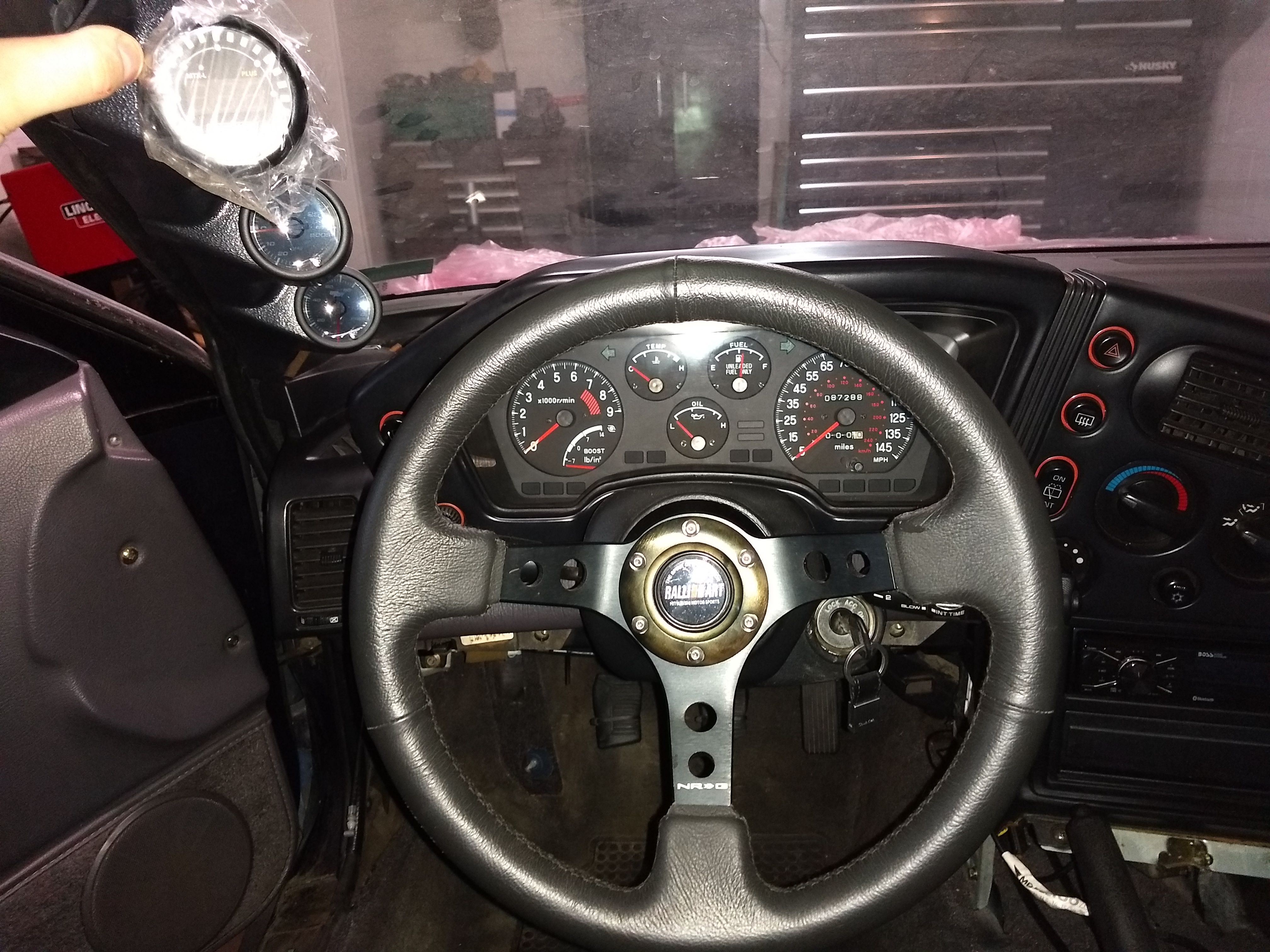

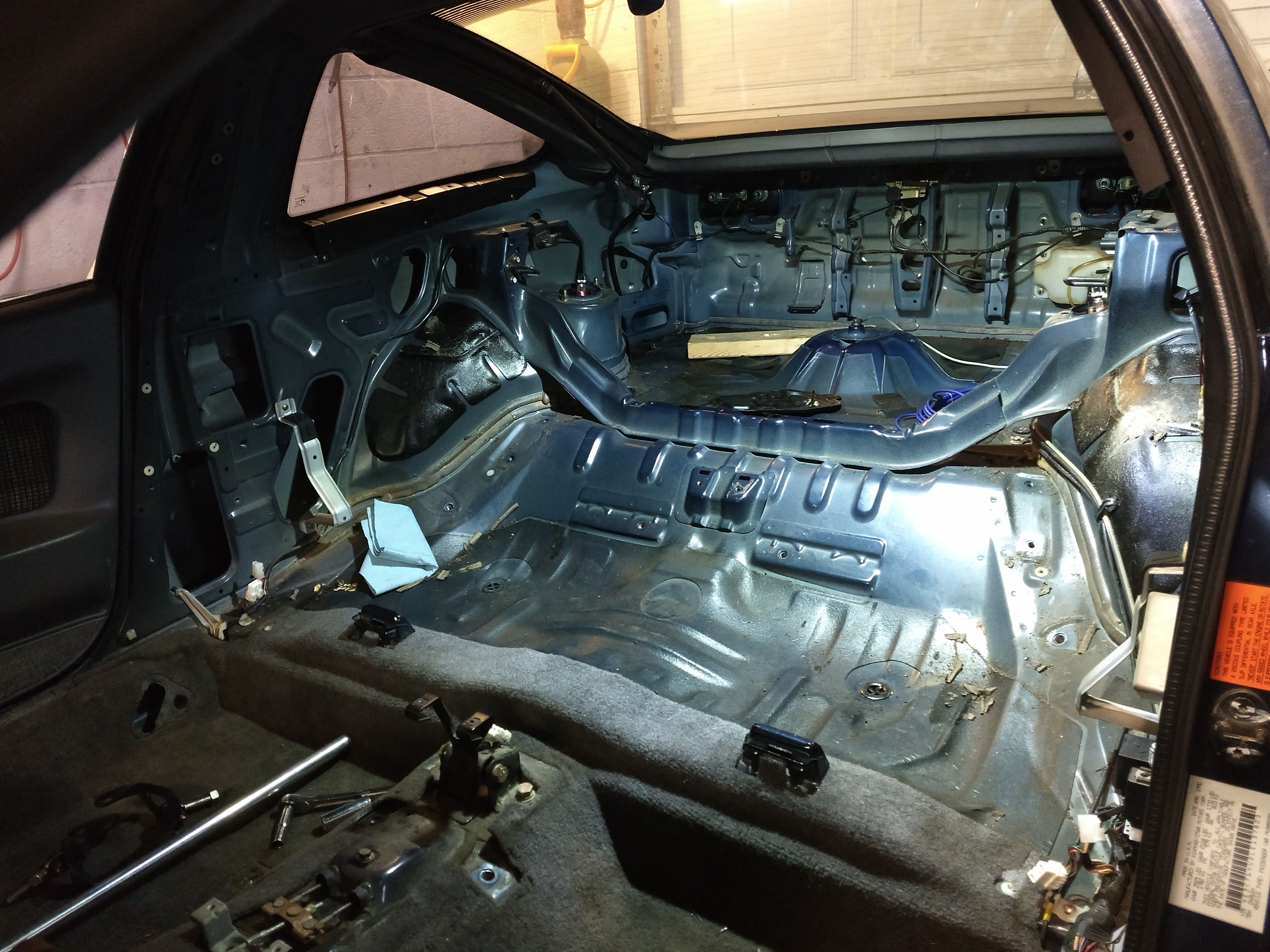

Both wastegates fully installed with new springs as well as leak checked. Exhaust finally done and heat wrapped. Working on welding an fitting on a spare valve cover as well as making brackets for my coolant overflow, catchcan, as well as ebc. Got all my gauges wired up, afr/boost/oil pressure as well as ECU installed. Lastly started ripping out all the interior trim panels.
Valve cover painted, autopower roll cage painted, going to try and get the kirkeys installed tomorrow while utilizing the stock 1g adjustable rails. More progress to come.
