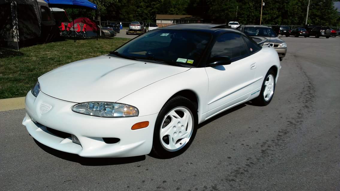

The car needs some opinions now. Those of you who don't daily drive your cars I would like some input. There is nearly zero chance this car will ever see the track so I'm not setting it up for that. It's a street car through and through. Even so I like to have quality parts and seek to improve things continually. My mod profile speaks for itself but now I am considering other items.
Coilovers? Are they that much better than the koni yellow and eibach prokit I have? Ride quality also?
Tires. As this is no longer a daily driver I'm considering something very soft. Like dot legal competition soft. Any comments? The car behaved so well on Michelin pilot super sports not sure I could benefit if the car isn't a track car. I may even keep two sets and put the oem wheels on for shows etc.
Serious mods. Up until now I've not cut on the car anywhere. I know my front mount will require it so I'm going to bite the bullet unless somebody can comment otherwise. It's an ets street core so it should just be a little bumper trimming and that's it.
Of course plans can always change but for now this will remain a 16g street car.
What do you non track guys do with your non daily drivers? Cruise and smile? Or beat up on lambos when the opportunity presents?
