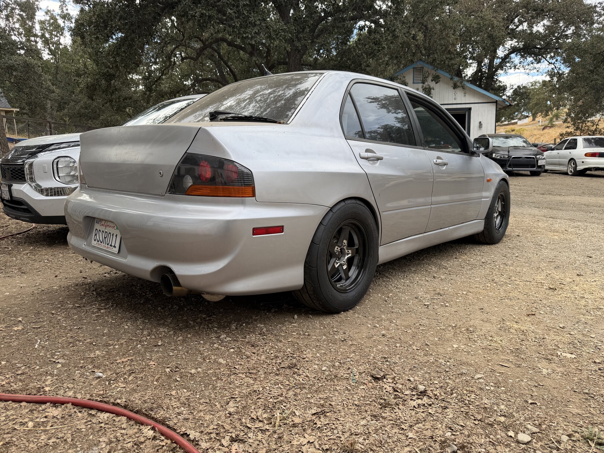

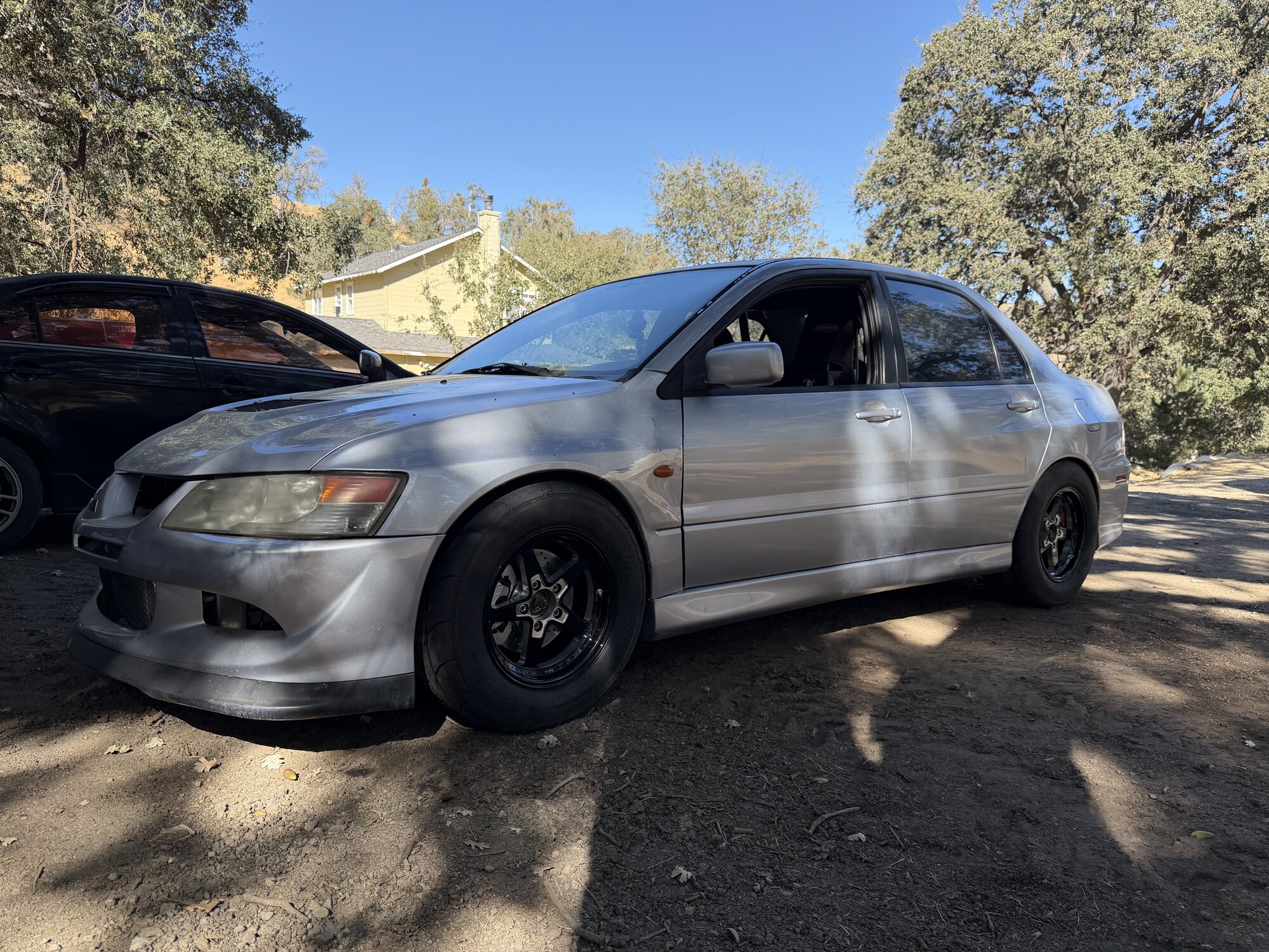

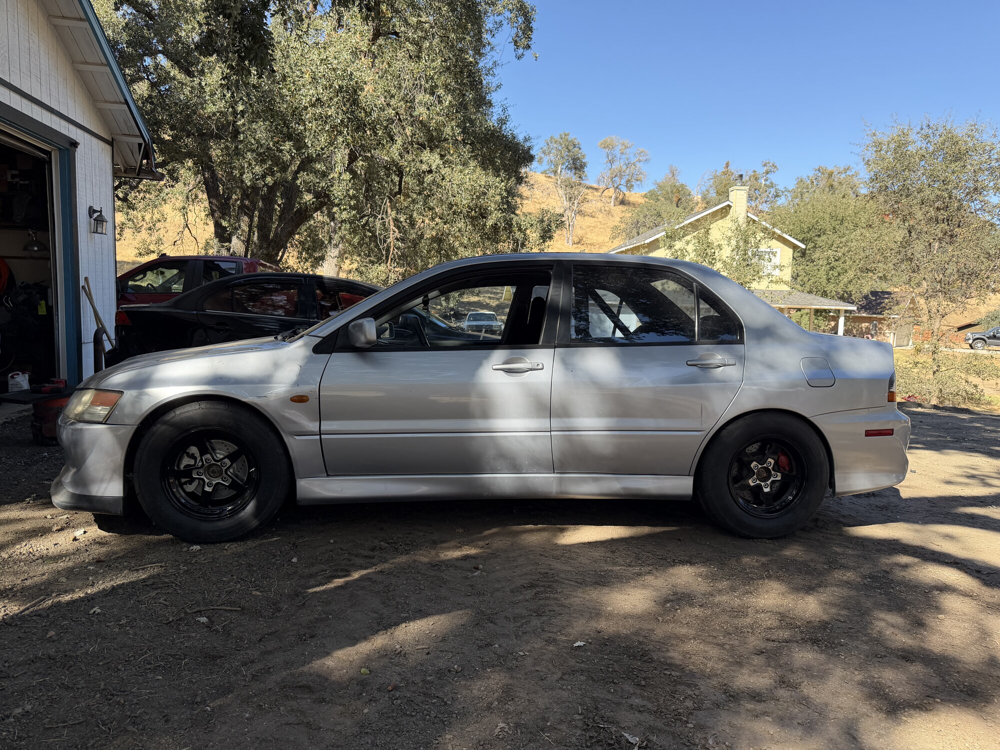

2005 Mitsubishi Lancer Evolution 8 Vehicle Profile & Build Thread
After selling my first evo, and regretting it, I decided to build another one almost identically to the first.. for some unfinished business and goals I still wanted to accomplish
2005 Mitsubishi Lancer Evo 8
Ownership Status
Currently Own
Vehicle
Drivetrain
AWD
Transmission Type
Manual
Build Type
  1. Street
  2. Drag Race
Mods-Bolt-on
Forced

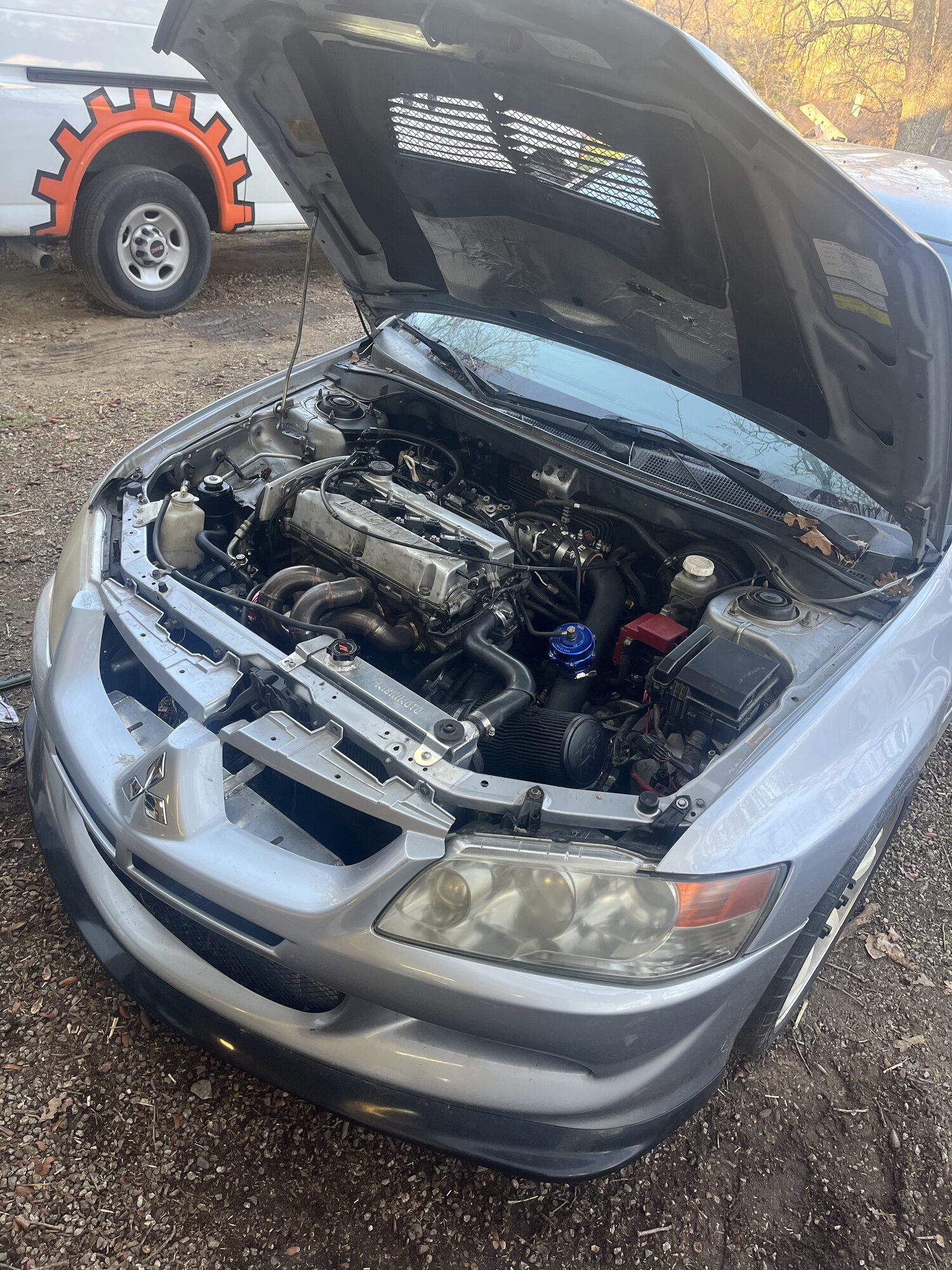

Mods-Engine
OTL Garage 2.4L 4g64
Manley H-Tuff plus 150mm rods
Manley 9.5:1 CR pistons 86mm bore
G4JS cylinder head
GSC R2 Cams
GSC valve train
Mods-EMS & Logging
OEM ecu Tephra V7
Mods-Drivetrain
DB Trans Ultimate Ratio Transmission
Mods-Handling
STM D2 Coilovers
05 Galant Front Calipers & Rotors
JEGS SSR Star Wheels 15x8
Mickey Thompsons ET street 235/60r15
Background
After regretting selling my previous evo, I built this one to resemble the old build. Finish the goals we never got to accomplish… going for my first 10 second pass
Forced Performance 3582
Gonzo evo T3 hotparts
FIC 1650cc injectors
Buschur double pumper Twin 255
Speed density

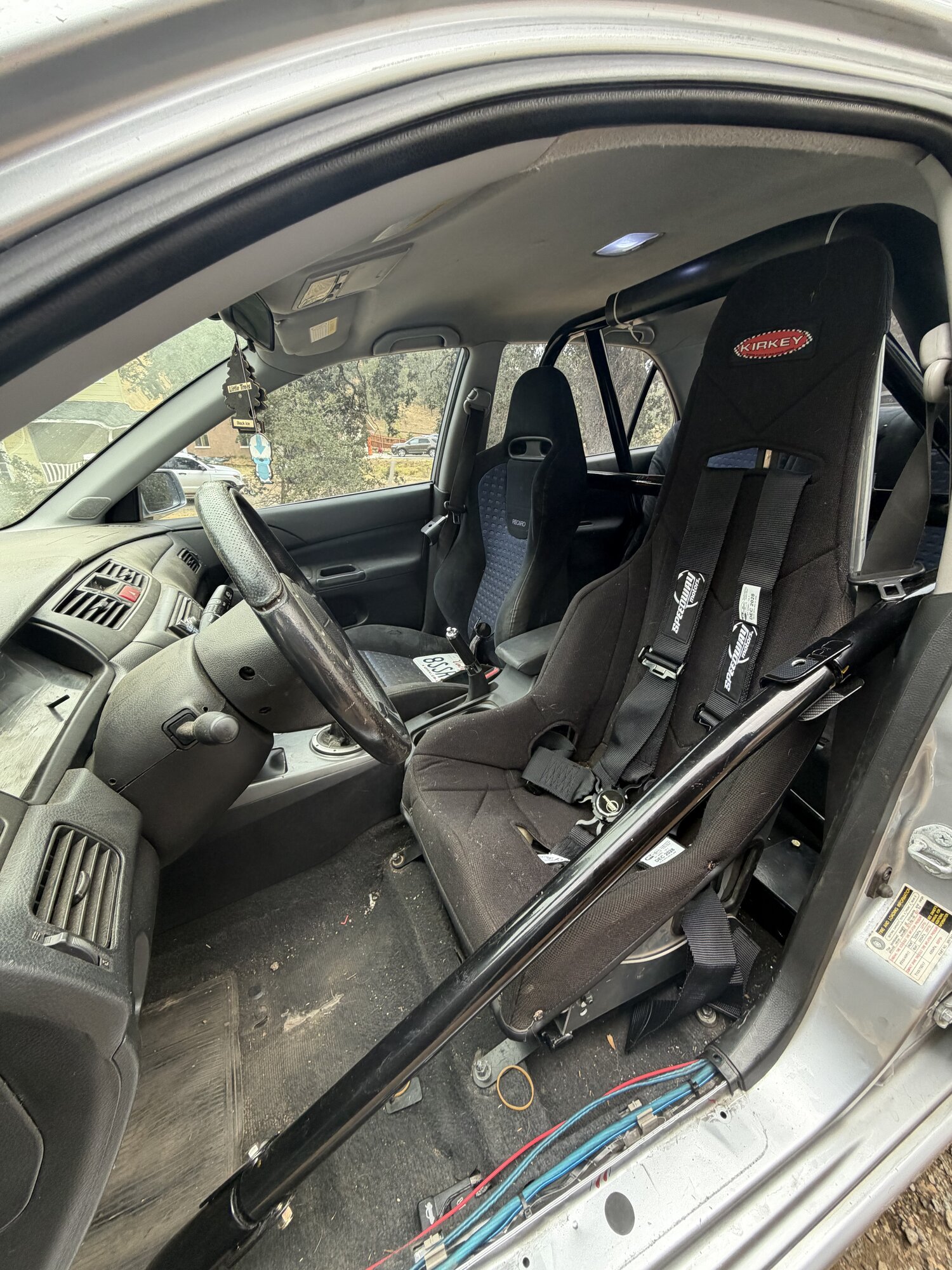

6 Point Roll bar
Comments
