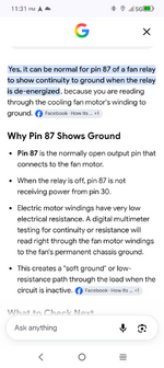

    Here. Maybe this will help you understand better. Sometimes machines have better phrasing You must be registered to see element.

    It's the pin 86 not being continues with the dual press switch and pin 85 not having a ground is what's preventing the a/c controls to turn on the condenser fan. And that also explains why the condenser fan only goes ON when ECT is higher and...

    When the vehicle reaches operating temperature and commands the cooling fan to go ON, it is normal for the condenser fan to turn ON as well.Going back to all 4 wires having continuity with pin 87. This could be a normal phenomenon for pin 87 to...
