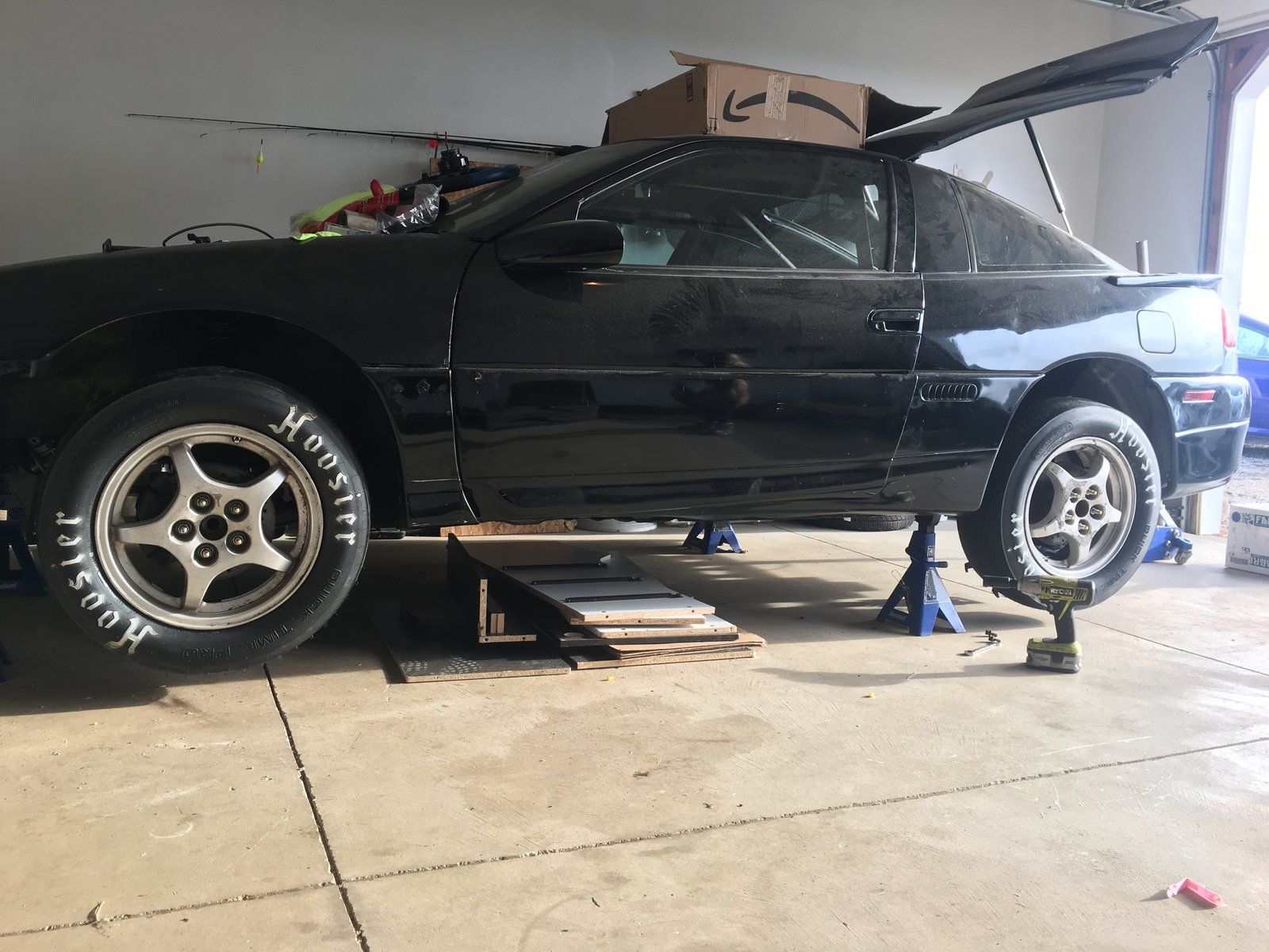

Came across Casey Barretts old talon for sale last year and ended up buying it in Michigan. I've seen a few threads on here from previous owners but I will try and keep this one civil. Had a ton of parts laying around that I couldn't sell so I'll see where they get me.
TRE trans, old 37R, DNP manifold, fuel system from Buschurs 1G build a few years ago, 1450's, V3 link, ETS 4" race kit, 16" Hoosiers on 2g 5 spokes, and a bunch of misc stuff.
Unfortunately it has been difficult to get it up to nhra spec for the shootout. Bought a new kirky pro, RCI harness, and window new. Do not buy the jegs kirky knock off as they are not SFI certified. The body is pretty rough and the cage has lots of surface rust. I bought some spray gel from AZ to try on the rust and it has worked well so far. I was worried with that much rust the cage would have been mild steel but I found a few places lettered mil t 6736b so I guess it 4130 chromoly.

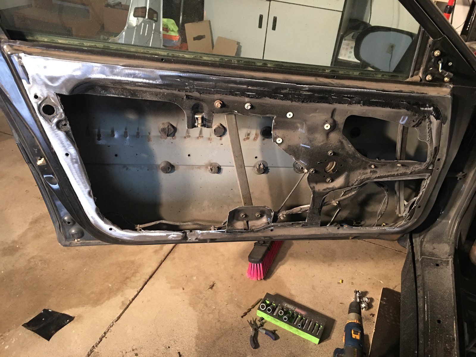

Can anyone recommend a good panel adhesive? The door caps are pulling off and the clip retainers are broken. The driver fender cap has a block of wood behind it and secured with wood screws.

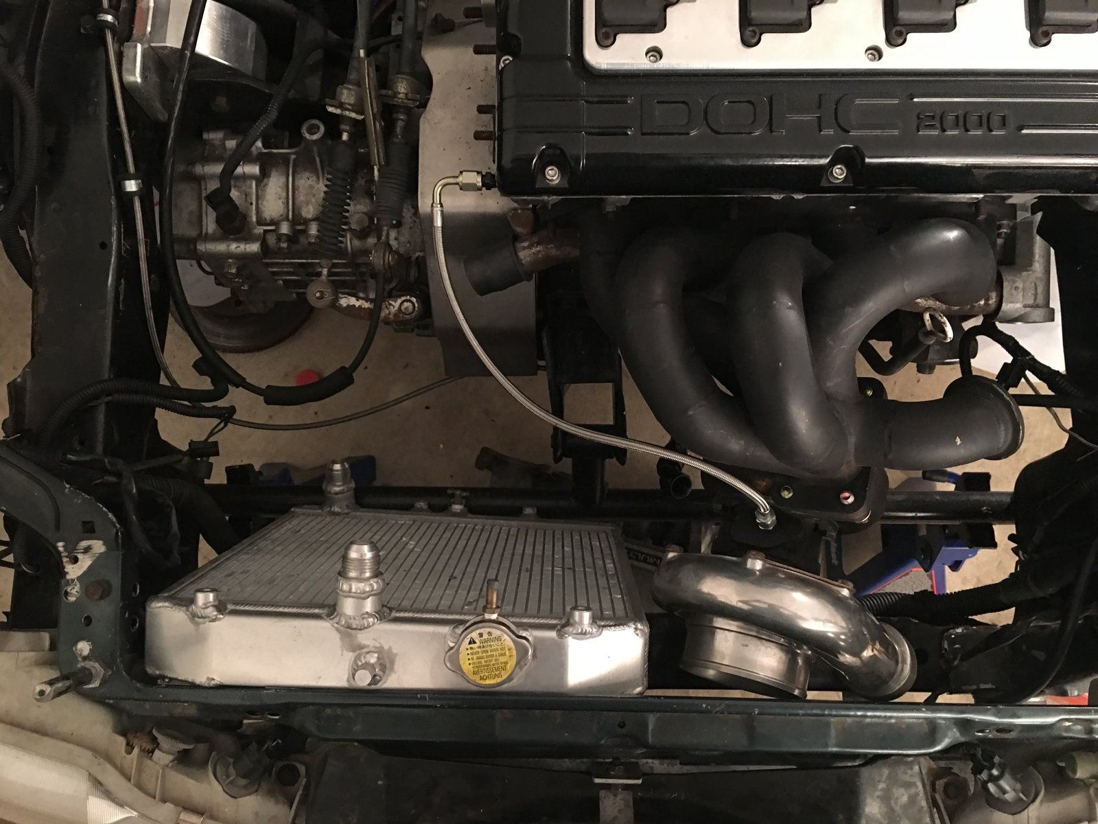

Took some of my old evo parts off the shelf and test fit to see how they may work. Did a bunch of cutting as well. Barely fit the turbo blanket on with as close as the turbine housing was to the block. No chance at getting an engine diaper in there too. Put my JDL FF manifold on and much more room. My fluidyne half radiator fits pretty well and should cool better than the scirocco style I had. Removing my trunk mounted battery in favor of a JMF pc925 setup. Also picked up a thermostat housing delete. Found some shifter and cable bushings in one of my storage boxes.

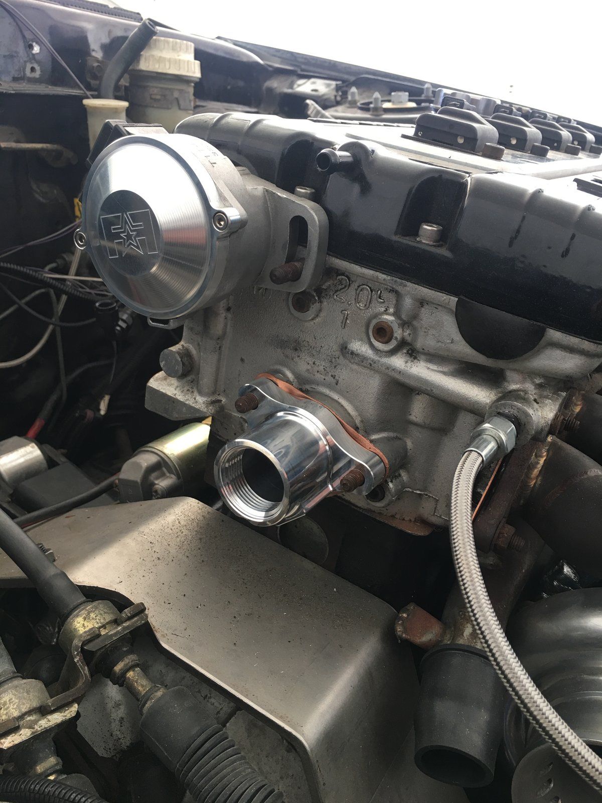

What's the purpose behind the thermostat delete? Would you mind throwing me a part number for the half fluidyne you're using? What are your goals for the car?
I've had the radiator for 8 years not sure if DB sells them anymore. It was on my evo and using the delete I needed a fill cap somewhere else in the system. The delete was "blemished" and I couldn't pass on the price.
