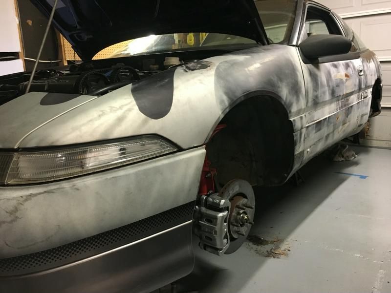

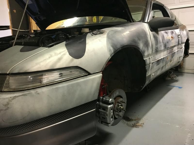

The "Beast" is my '91 Eagle Talon I've had since 2002. Setting her up with a focus on the strip while leaving her street legal enough to drive to work on occasion.

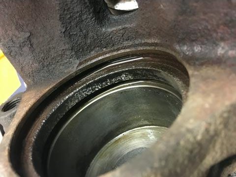

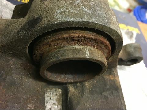

During my first drive my brakes decided to pay me back for my negligence to attend to them. My drive from work consisted of driving about 2.5 miles, parking for 10 minutes to cool down, and driving the remaining 2.5 miles, never going over 35 mph. By the time I made it home the front left wheel was smoking and extremely hot to the touch. I left the car in the garage for a couple weeks until I had some time to work on it and in the meantime ordered brake rebuild kits for the front and rears from Rockauto.

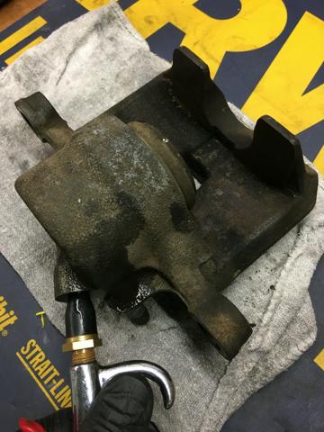

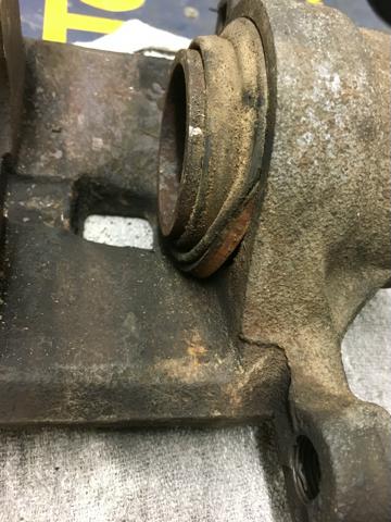

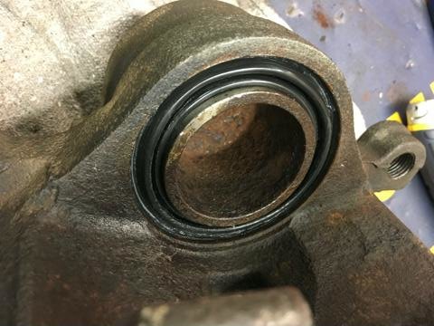

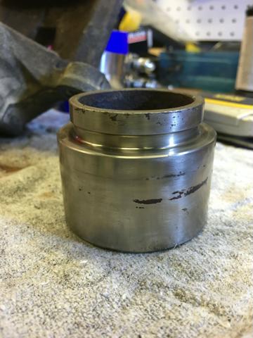

I did these one at a time, starting with the main culprit and working my way around the car, back to the rear left caliper. I started by removing the retaining clip and dust boot, then I used an air blower with 90 psi to pop the pistons out of the fronts. My car came with the small, 1P fronts so disassembly / reassembly was pretty straight forward. Using a block of wood to keep the piston from crashing into the caliper when it popped out kept me from damaging it. Although, accidentally putting a finger between the piston and the block of wood is not something I recommend....ask me why.

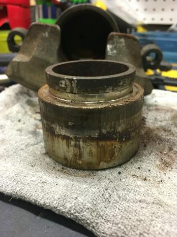

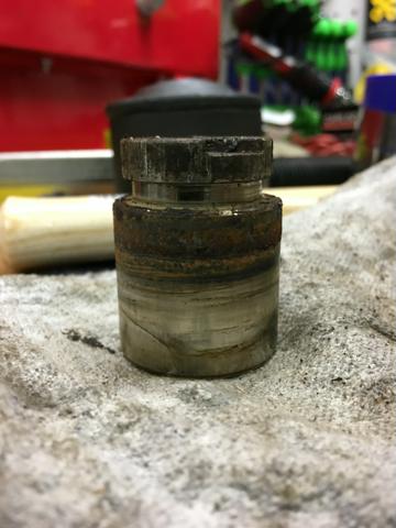

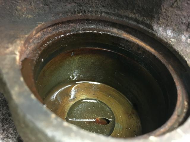

Once I got the piston out (and stopped the bleeding) I took off what rust I could using mineral spirits. As expected the front left was a bear to pop out and had a ton of rust build up on it. I got it pretty clean and reassembled then tested it with a C-clamp and the air blower for good, smooth movement. During reassembly I lubed up the seal with plenty of brake fluid to make slipping the piston back in easier, of course I used a C-clamp to aid in this.

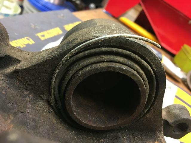

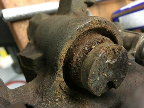

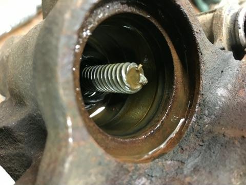

The rears were a little more complicated due to the E-brake but came apart easily enough and went back together without any spare parts... The left rear was a little stuck, also as expected, so I did have to use some Groove-lock pliers to get a grip on it and twist it out. I used a rag between the teeth and the piston to minimize damage enough to clean it up afterwards.
