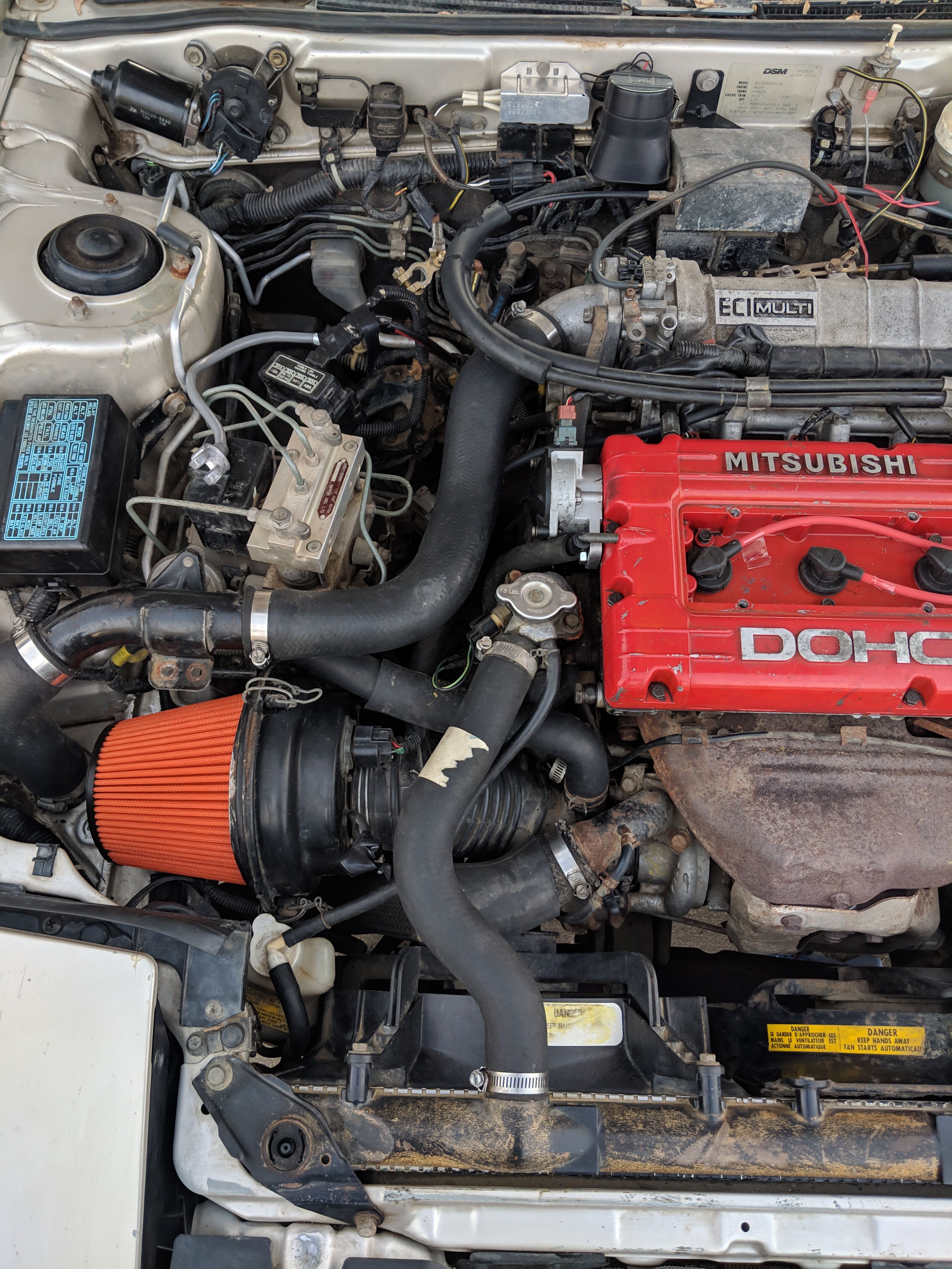

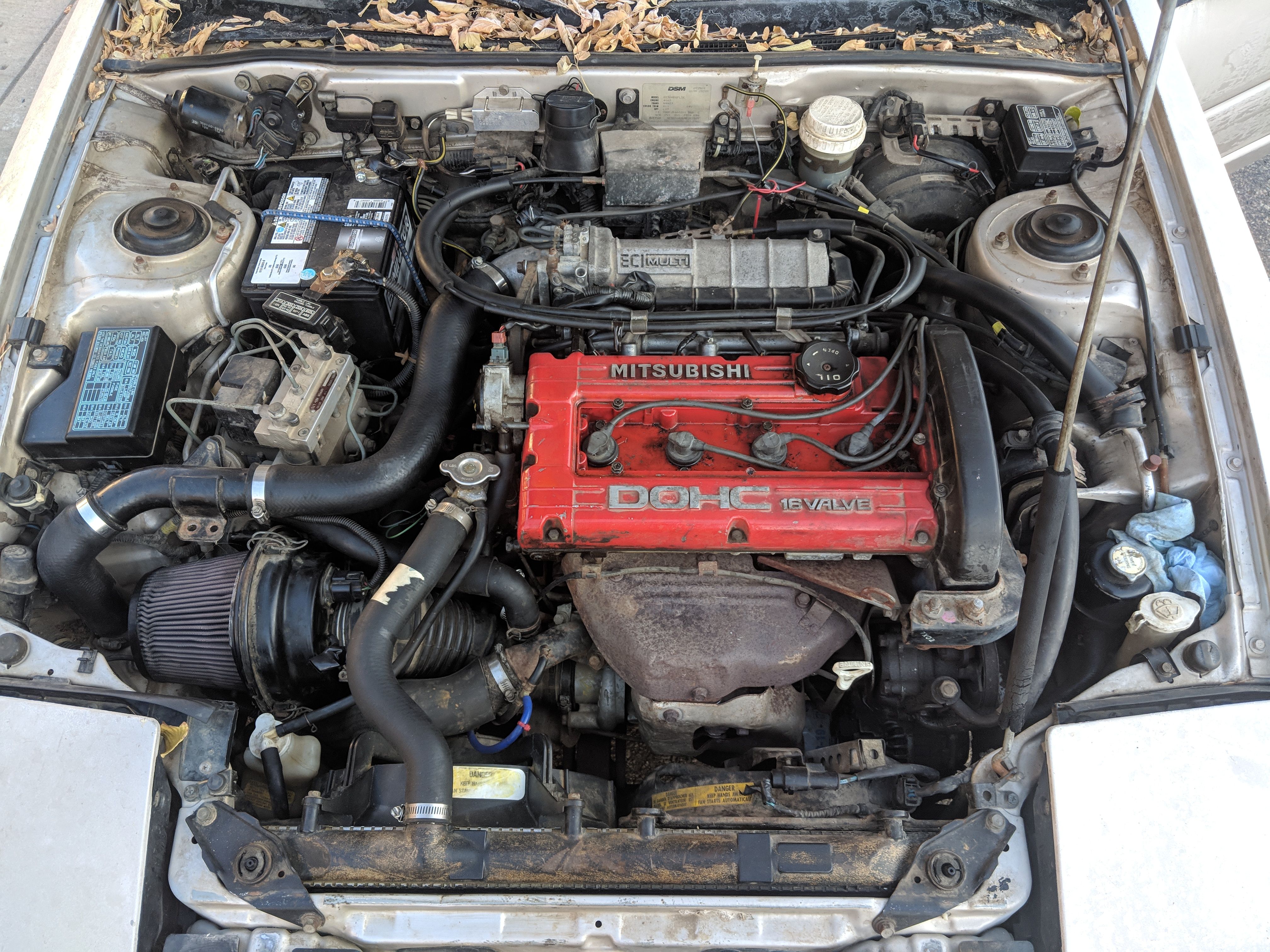

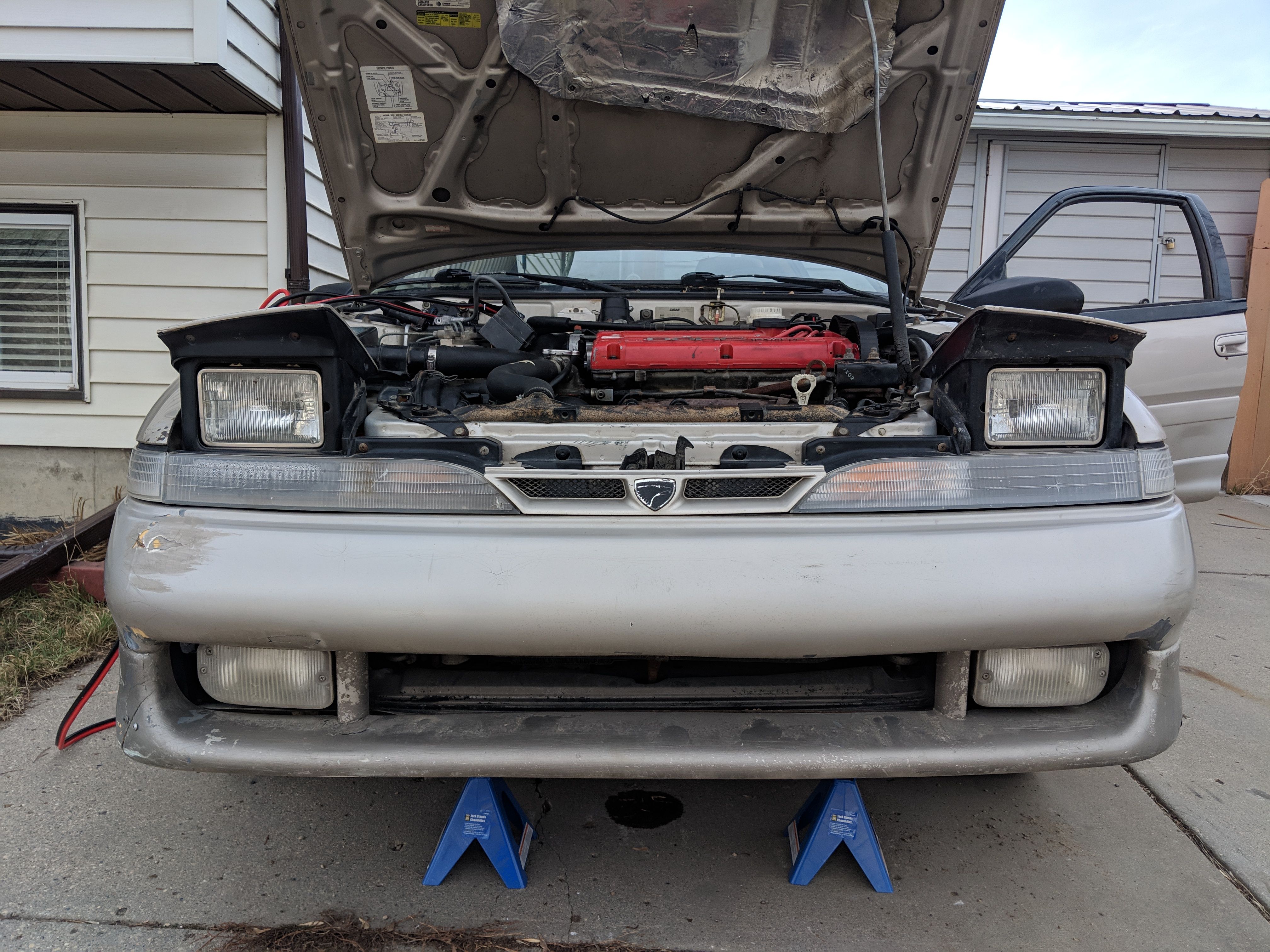

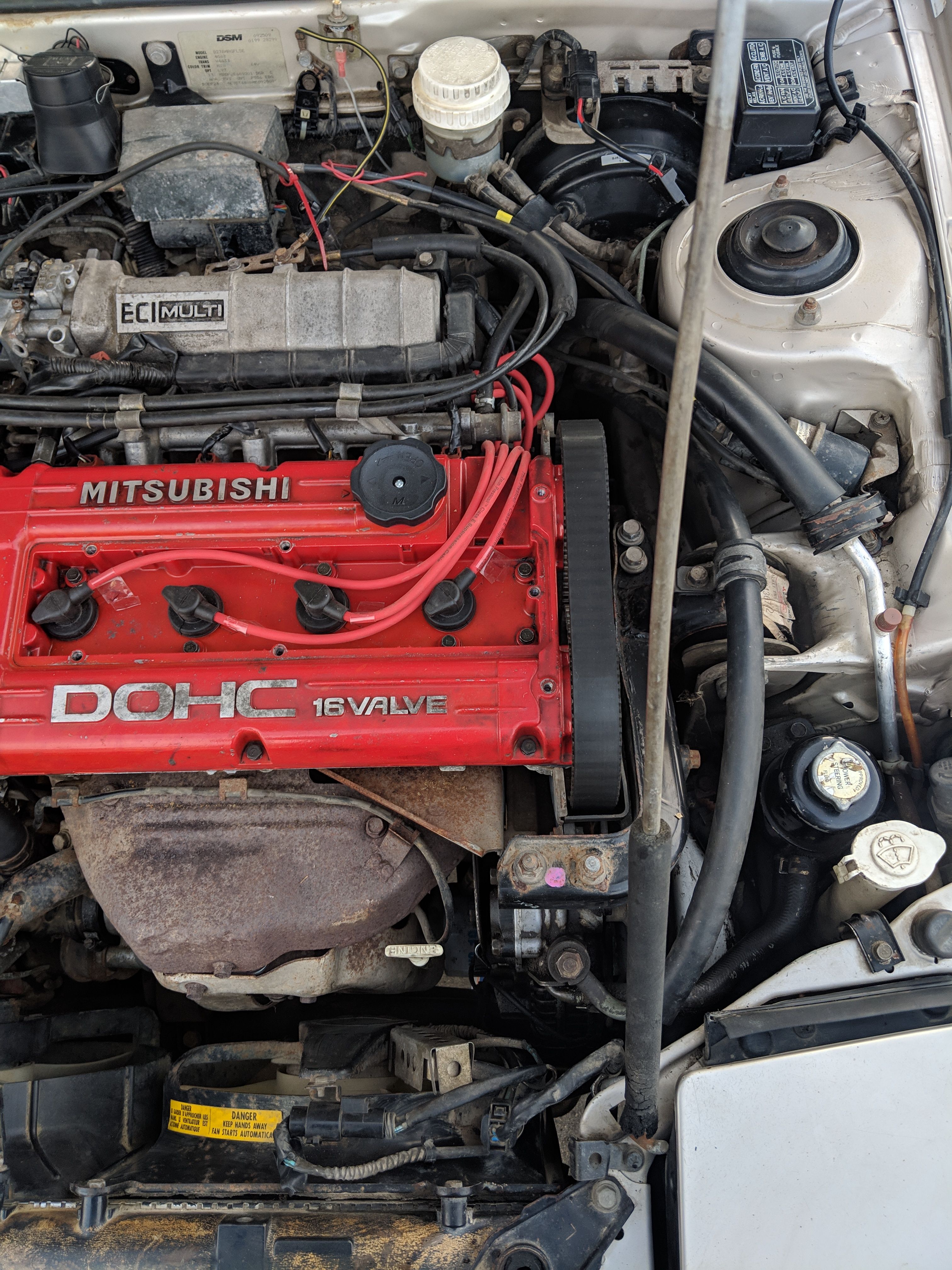

I got around to tidying up the engine bay. Just gave it a general dusting but the blacks pop out a hell of a lot more. Still a long ways to go before it's 100% LOL
Here is a before picture from October 2018. Changed the plug wires and air filter since then. I have also removed some vacuum lines that were plugged with bolts in favor of proper vacuum caps.

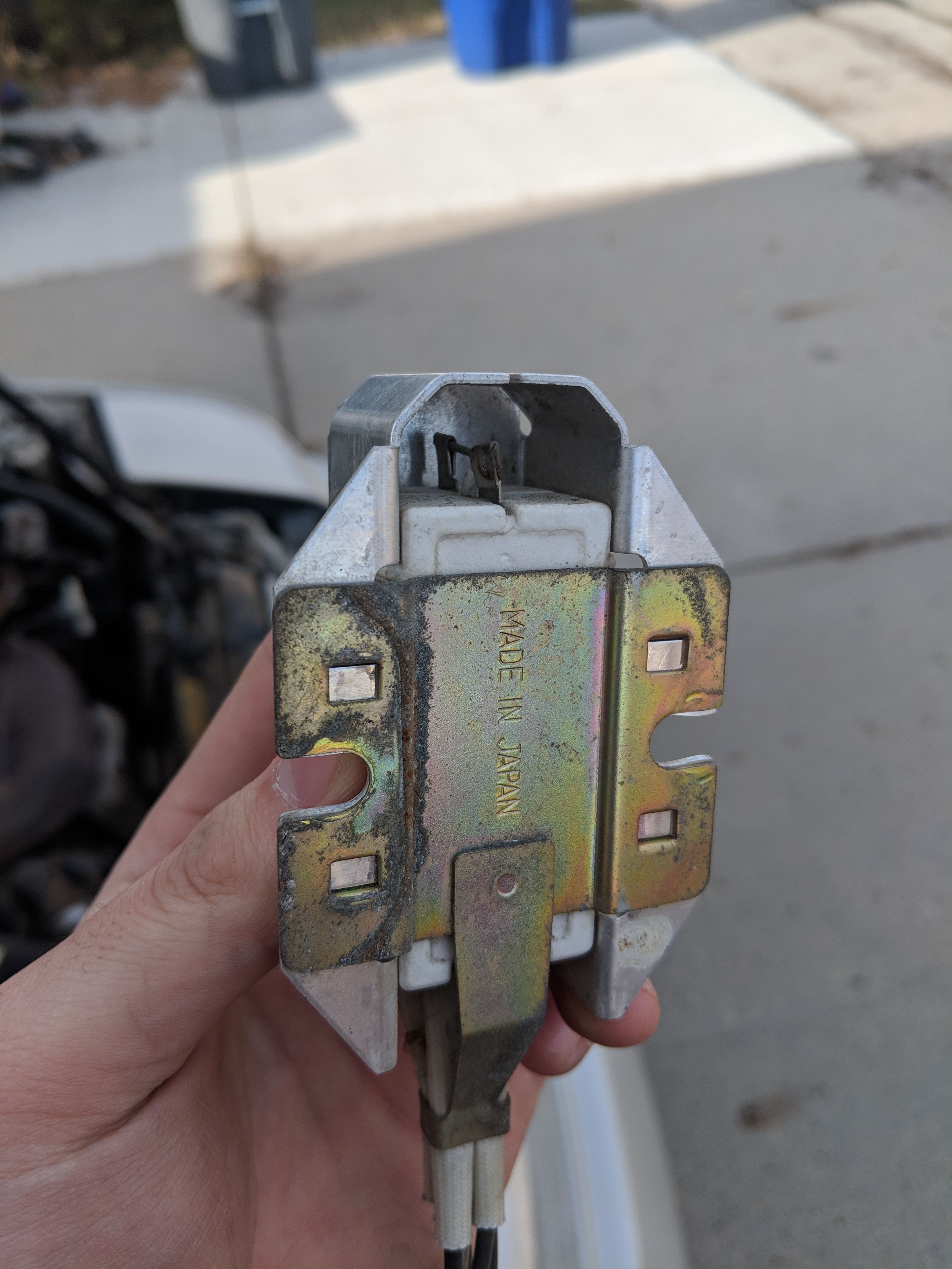

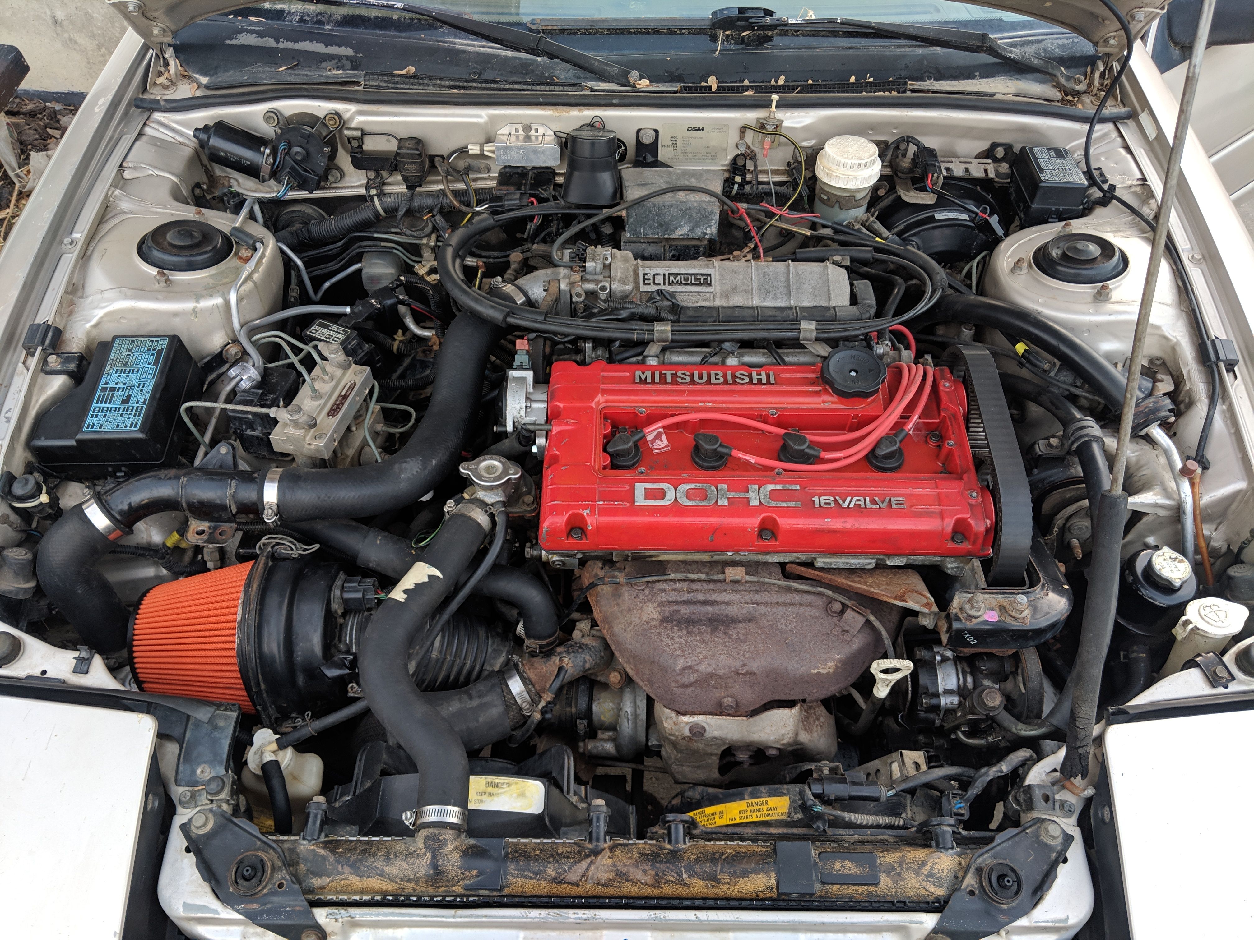

The injector resistance pack is what got me to dust the engine bay LOL. I thought it was dirty so I cleaned it, and then the area next to it looked dirty in comparison and it started a chain reaction.
The resistances checked out at a solid 6 ohms for each pin. Reason for checking this part is that I'm trying to diagnose a no start issue.
Wasn't really sure what to take a picture of so I just grabbed the backside :idontknow:

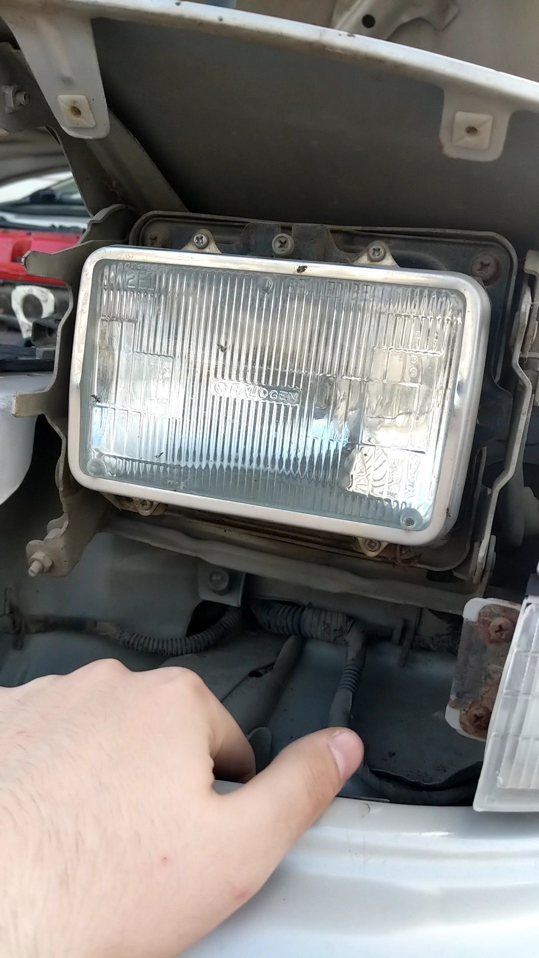

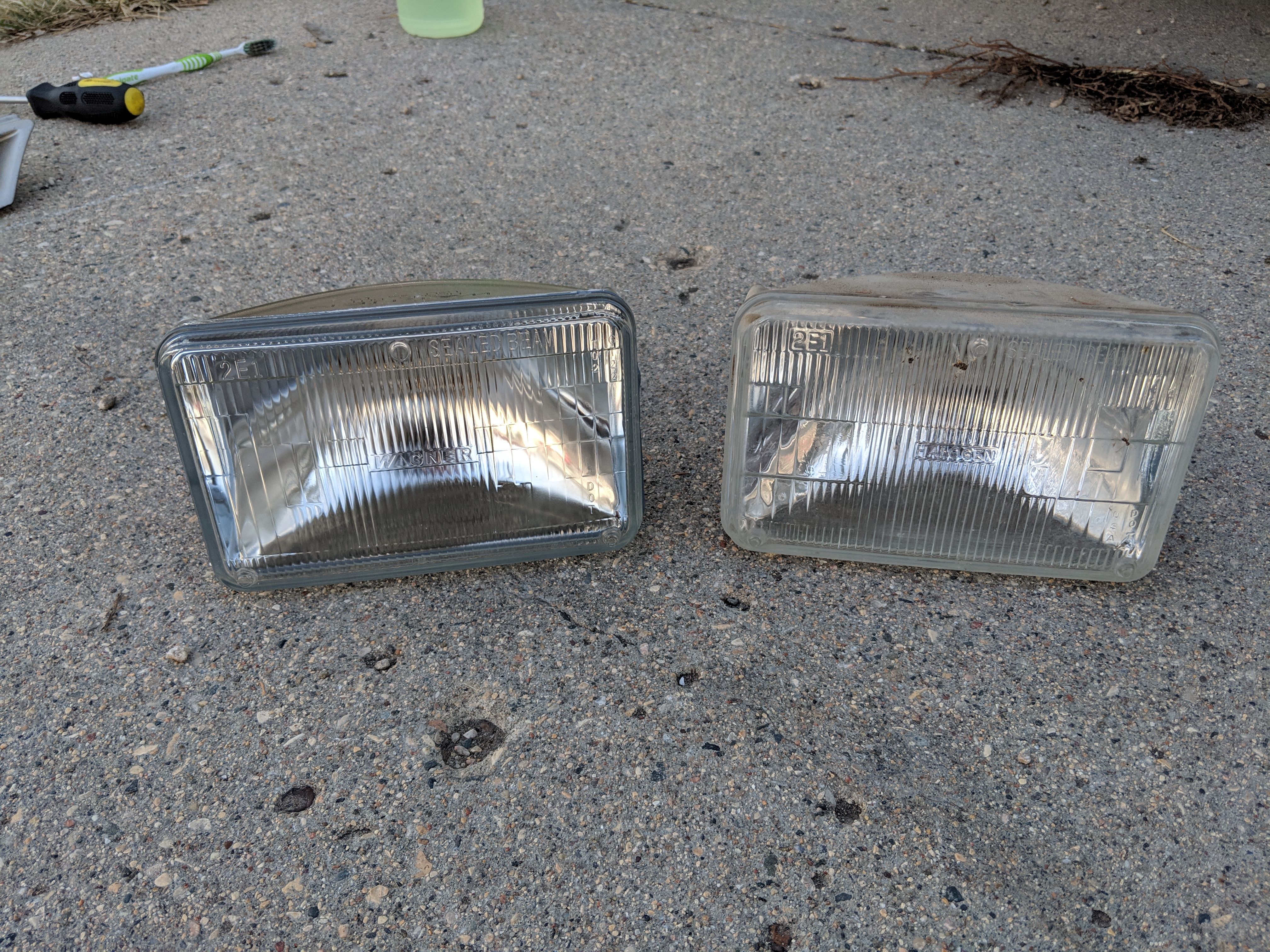

I wanted to put my new lamps in. I cleaned the plastic trim and the surrounding area.
This is with the old ones in.
New lamp on the right, old one on the left.

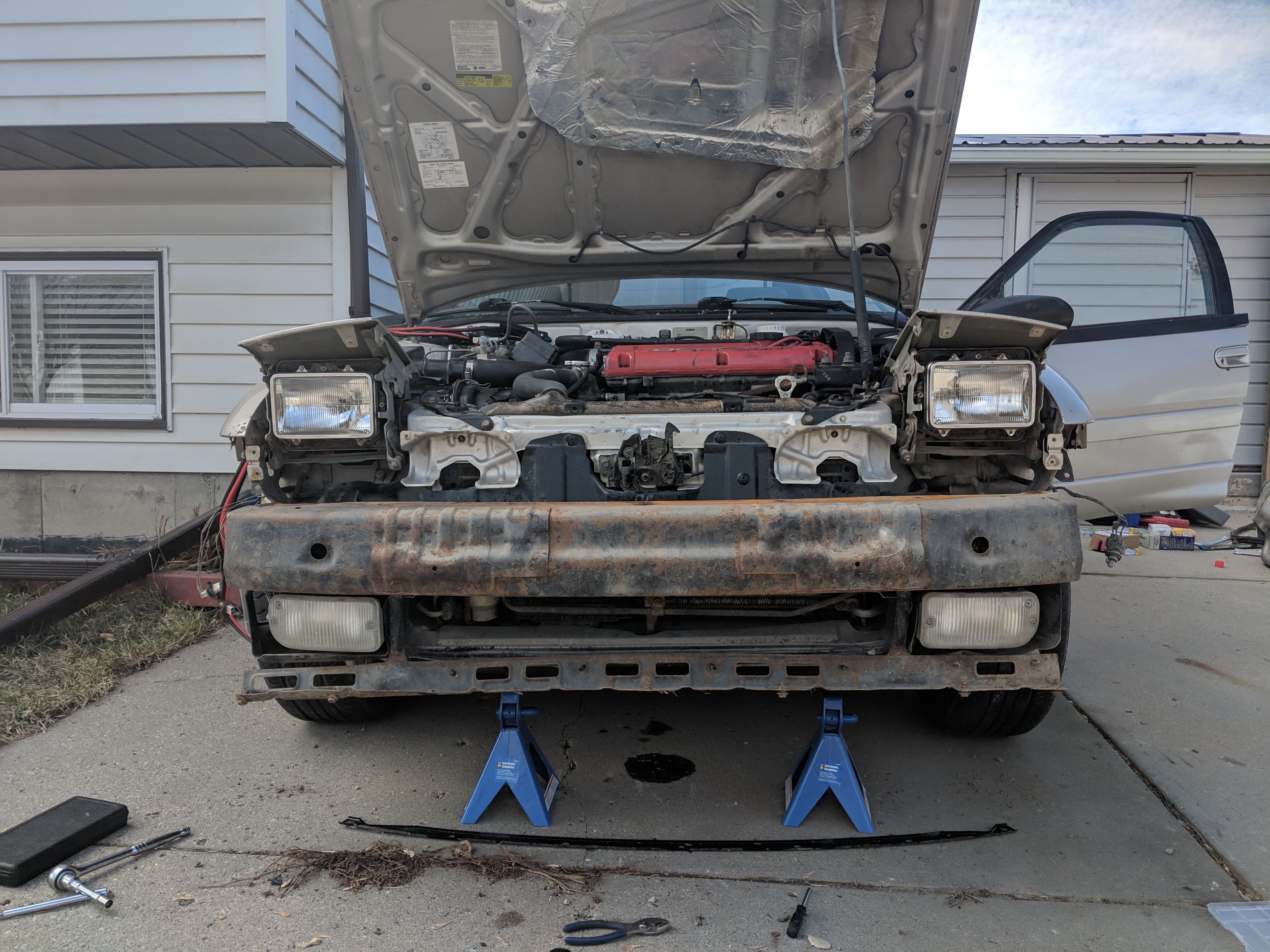

I took off the front bumper cover and broke several seized bolts, as you do :cry:
I was going to replace my fog light bulbs but the screws holding the housing on were stripped to all hell. I didn't want to deal with that so I opted to leave the old bulbs in :idontknow:

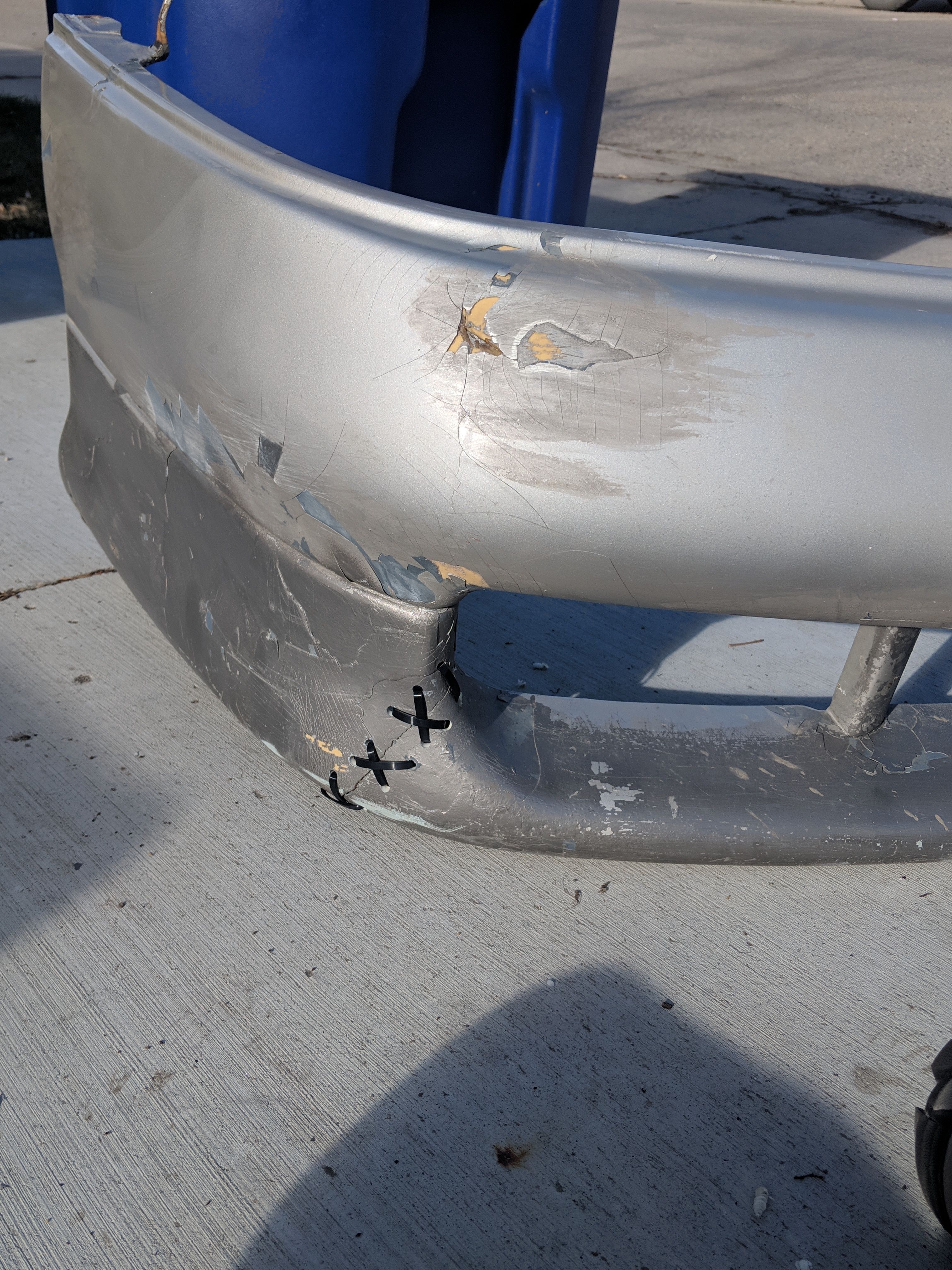

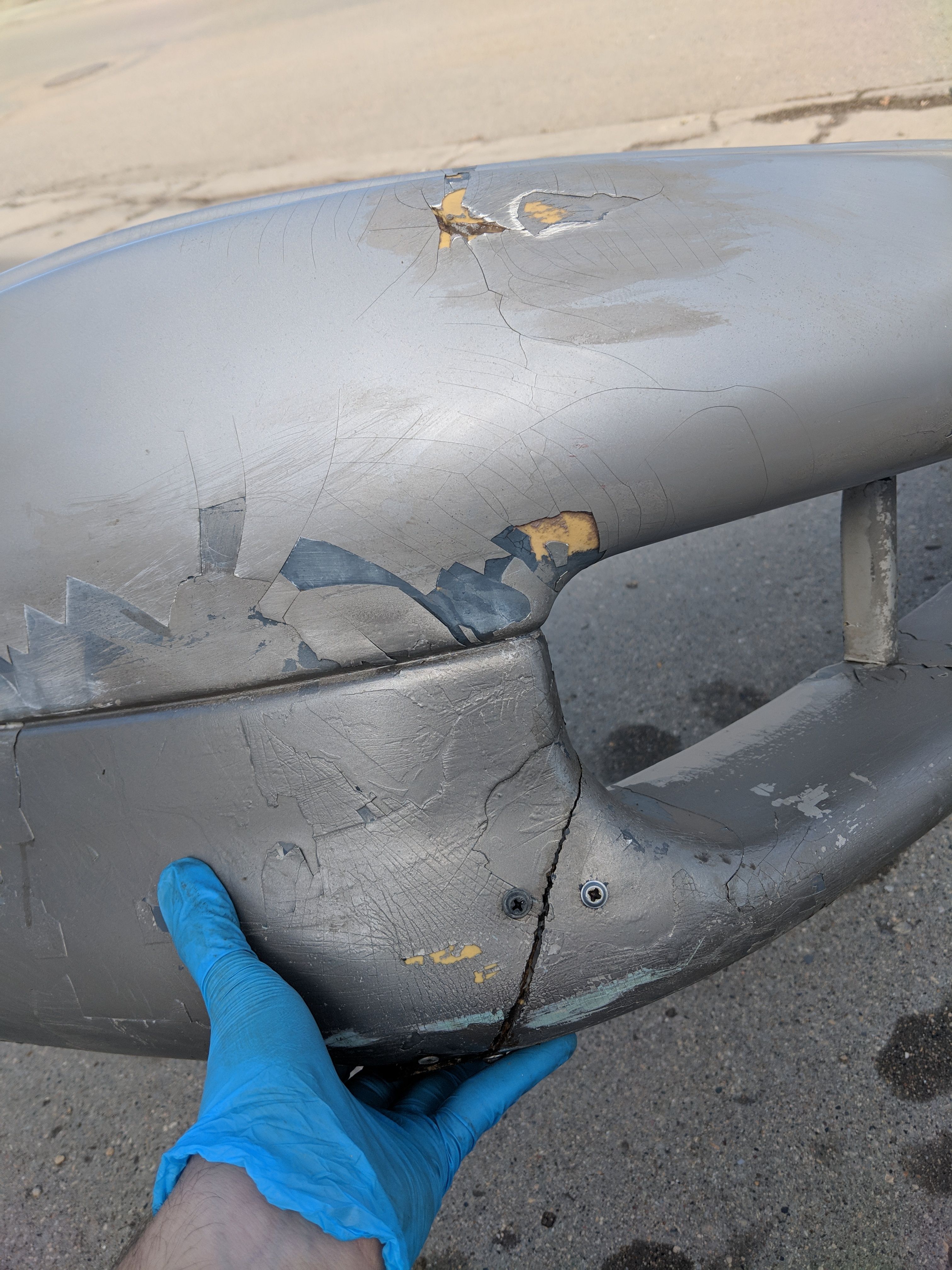

The front bumper cover is looking pretty rough.

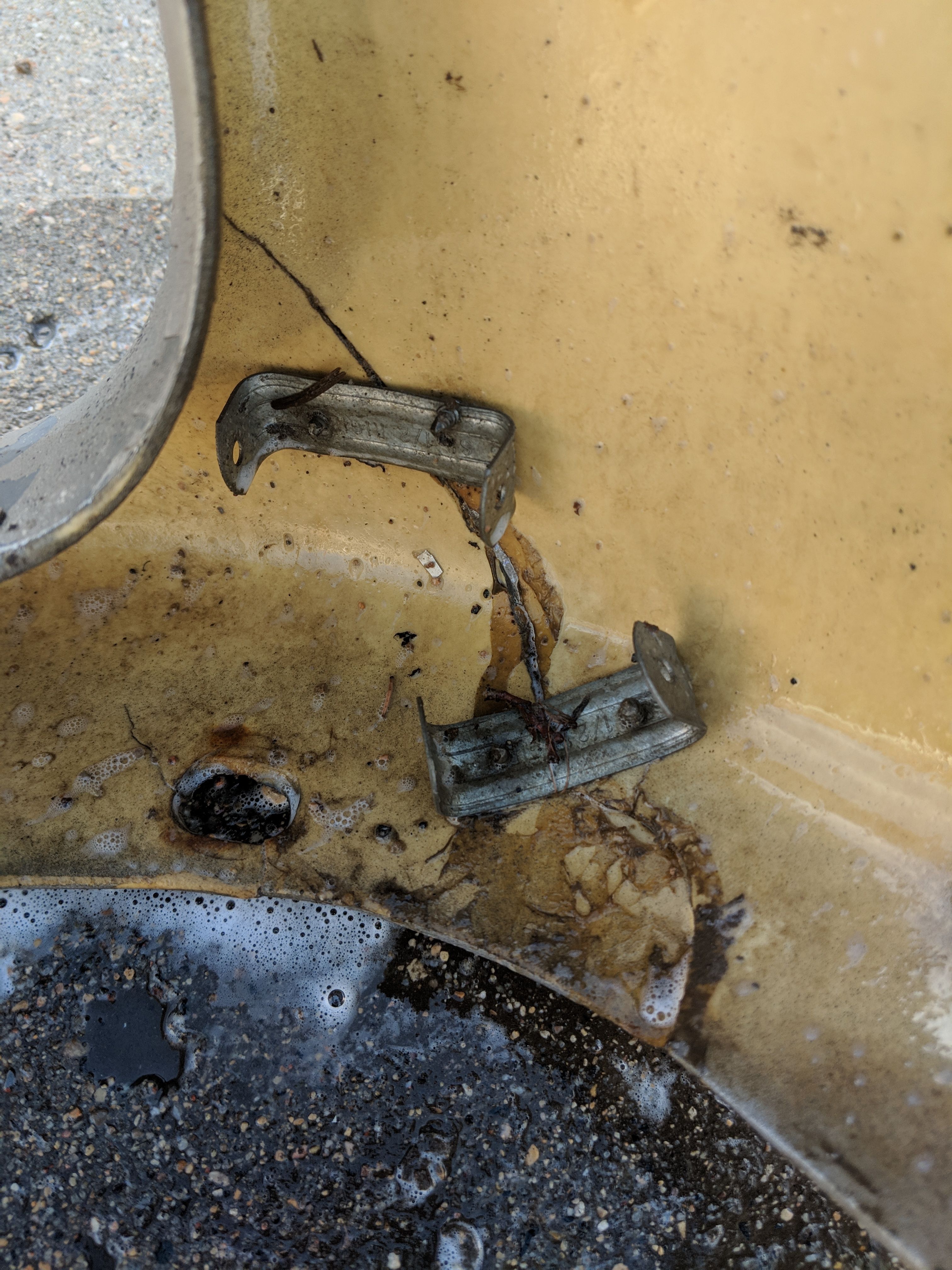

I cleaned the rust from where the metal brace sits and also the mud on the backside of the bumper cover.

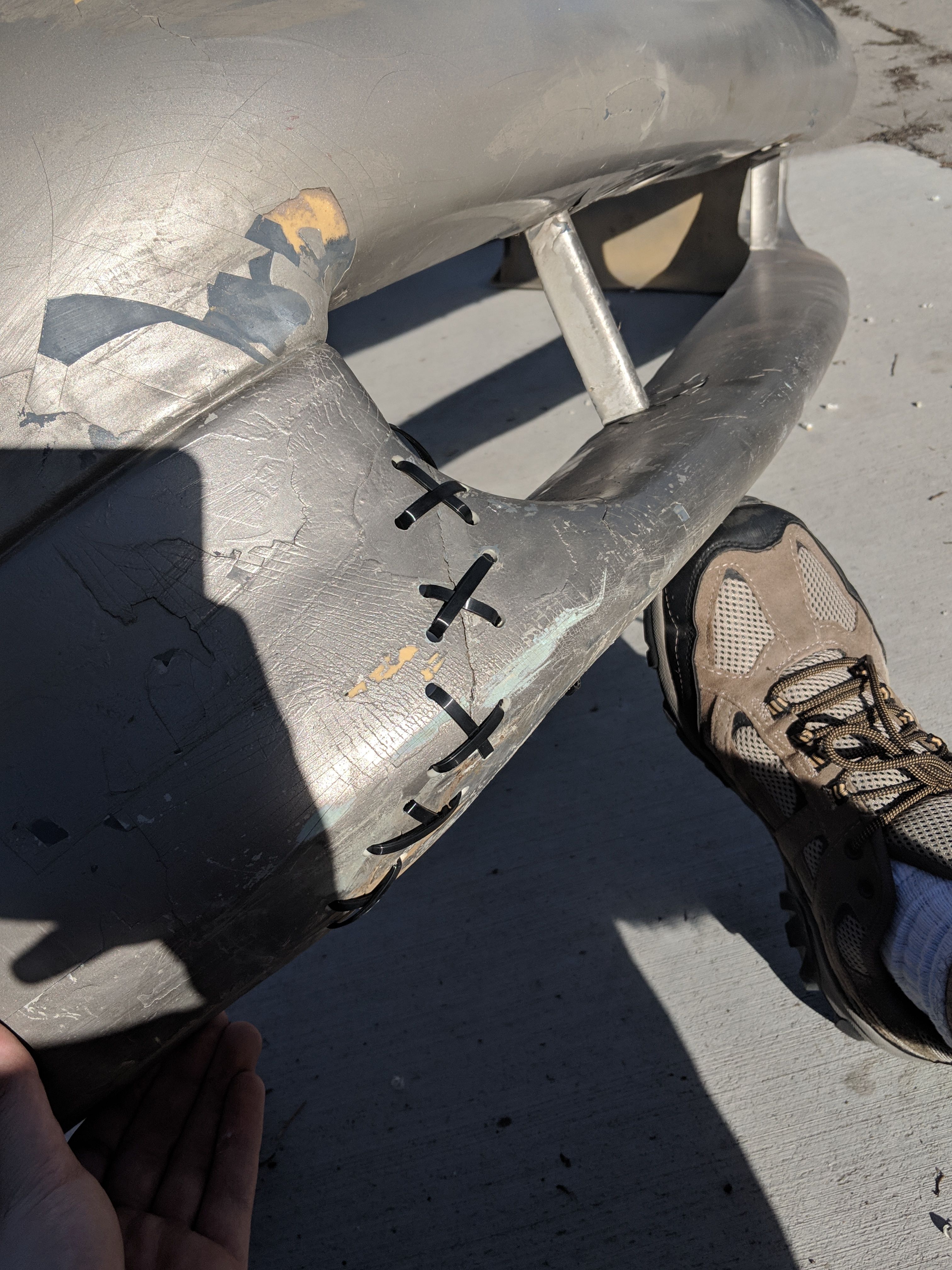

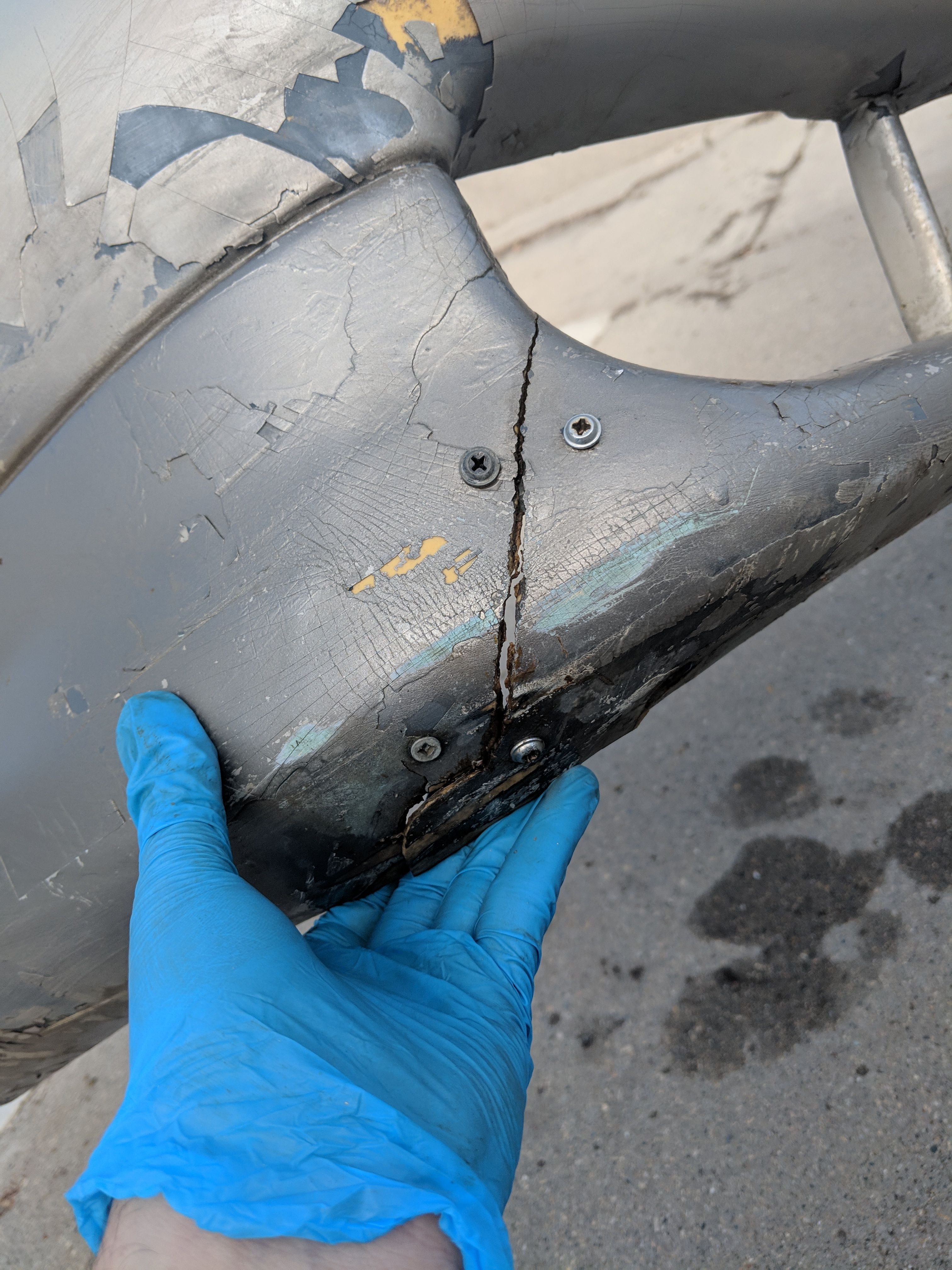

I removed this metal bracket and the screws because I thought it looked ugly on the front side and didn't feel that it did a very good job of holding the crack together.
I drilled a hole at the end of the crack to prevent further splitting and stitched it up with some zip ties. I think this looks a little more tasteful.

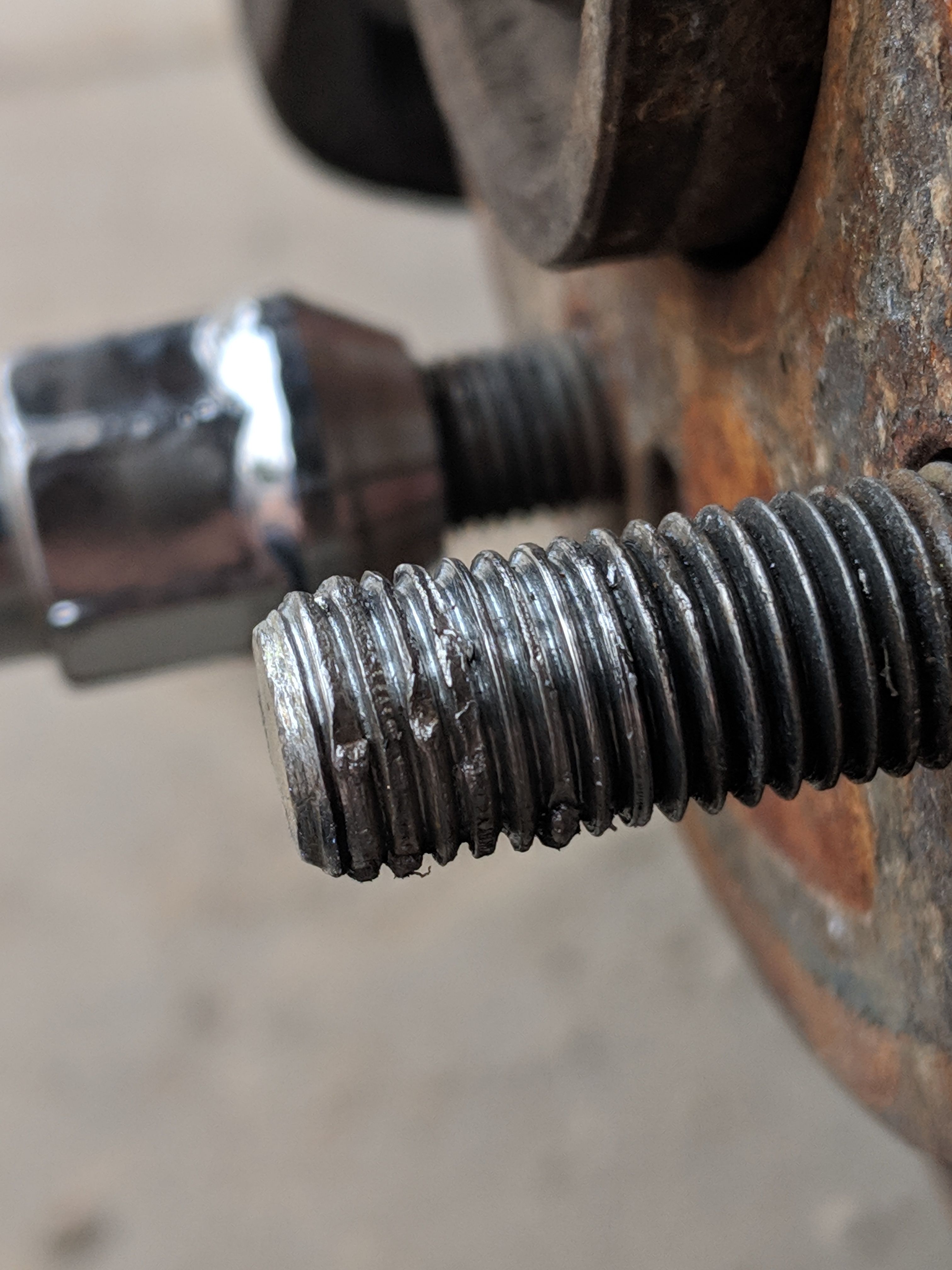

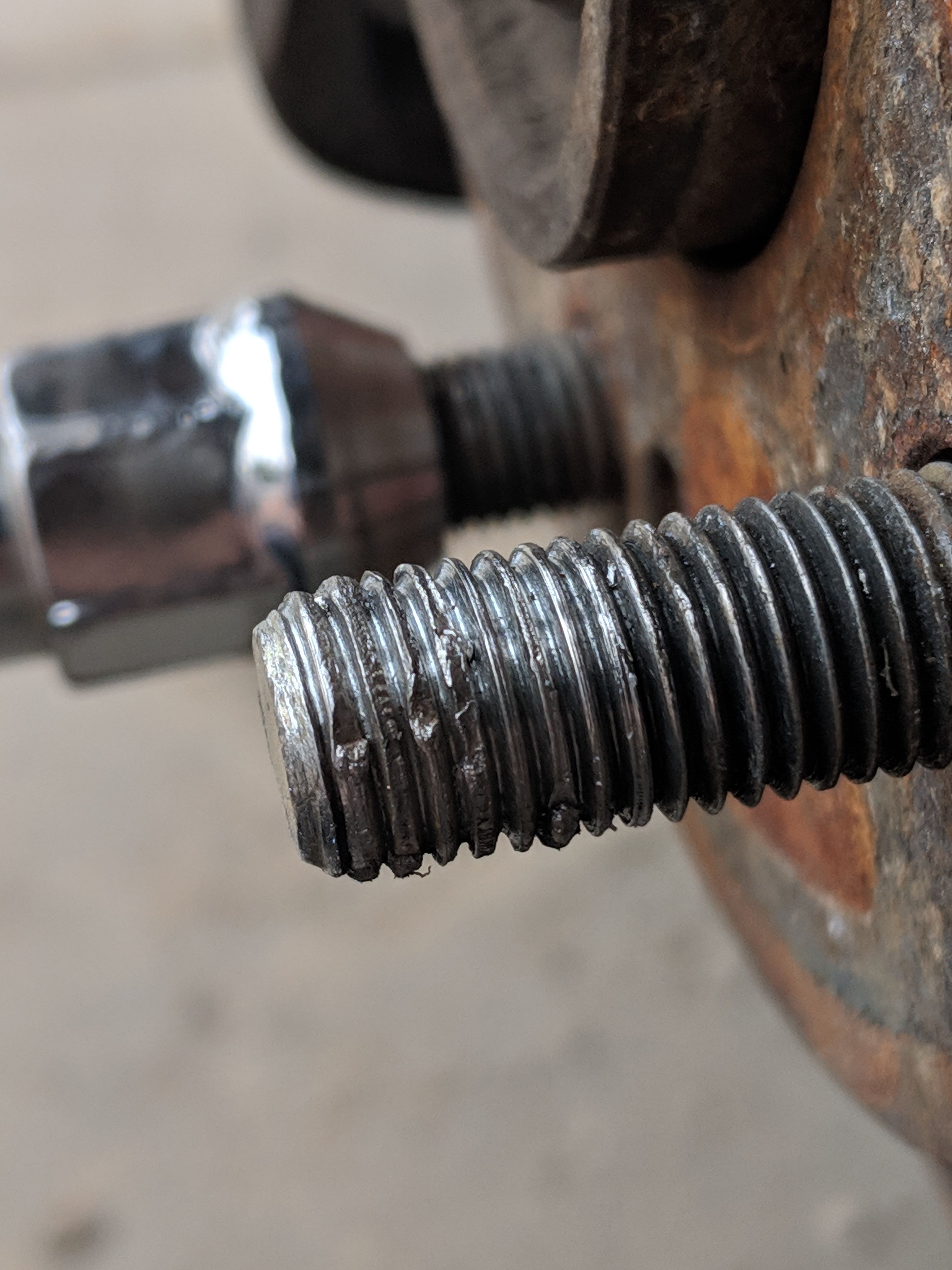

I was wondering why one of my lug nuts wouldn't go back on and found out why.
A couple of new wheel studs and lugs are on my shopping list.
I was wondering why one of my lug nuts wouldn't go back on and found out why. View attachment 565927 A couple of new wheel studs and lugs are on my shopping list.

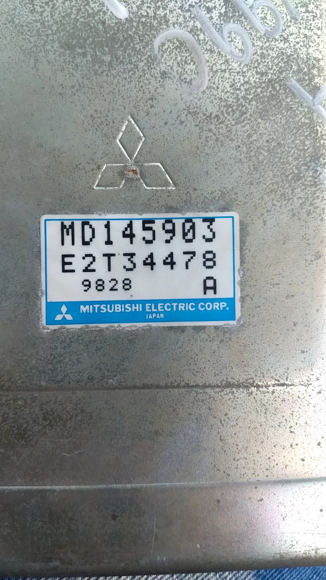

After some researching, I found out that using a '90 ECU in my car requires a pin layout change? So I'm not entirely sure which ECUs would be compatible and I'd be able to use.

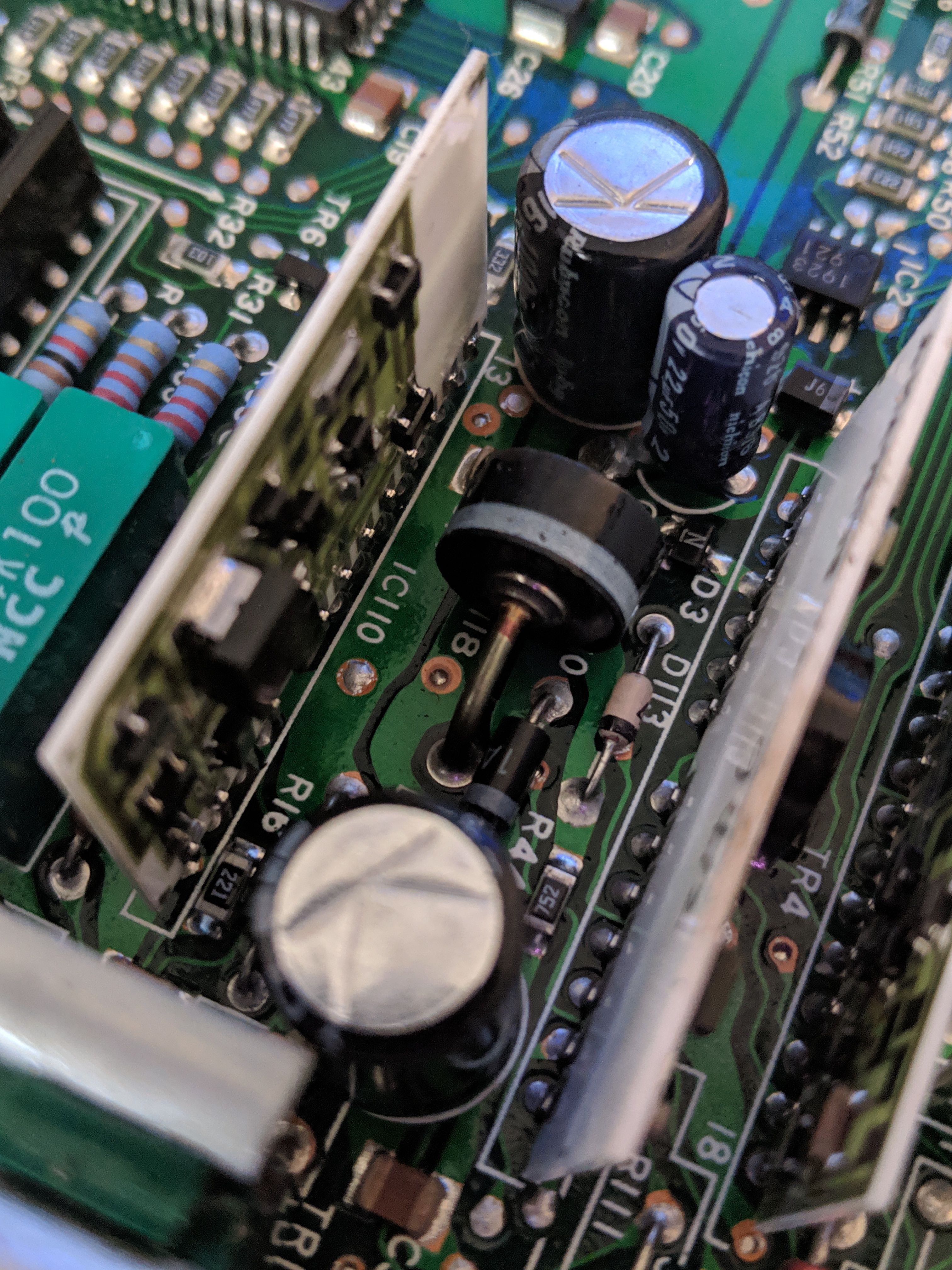

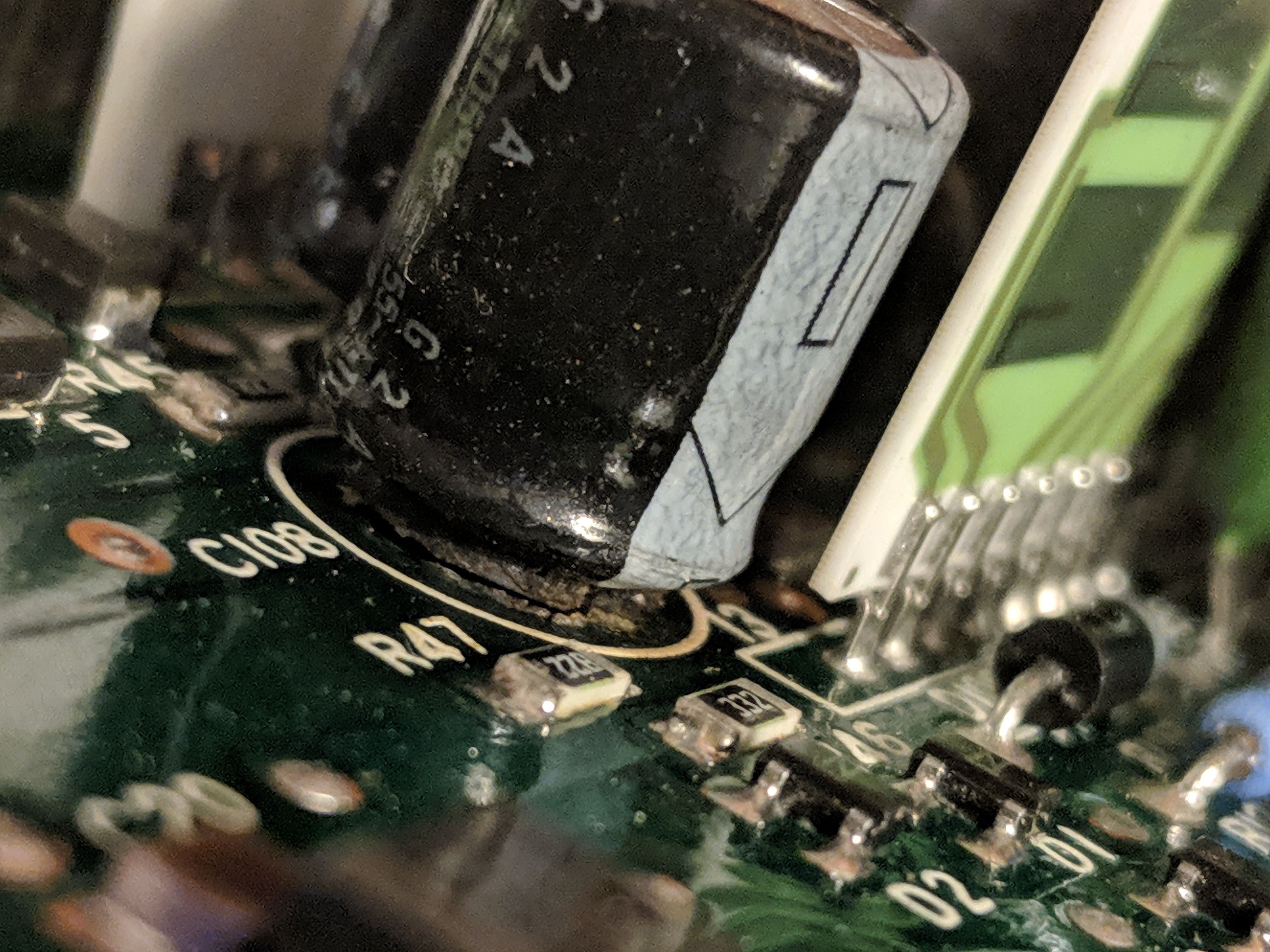

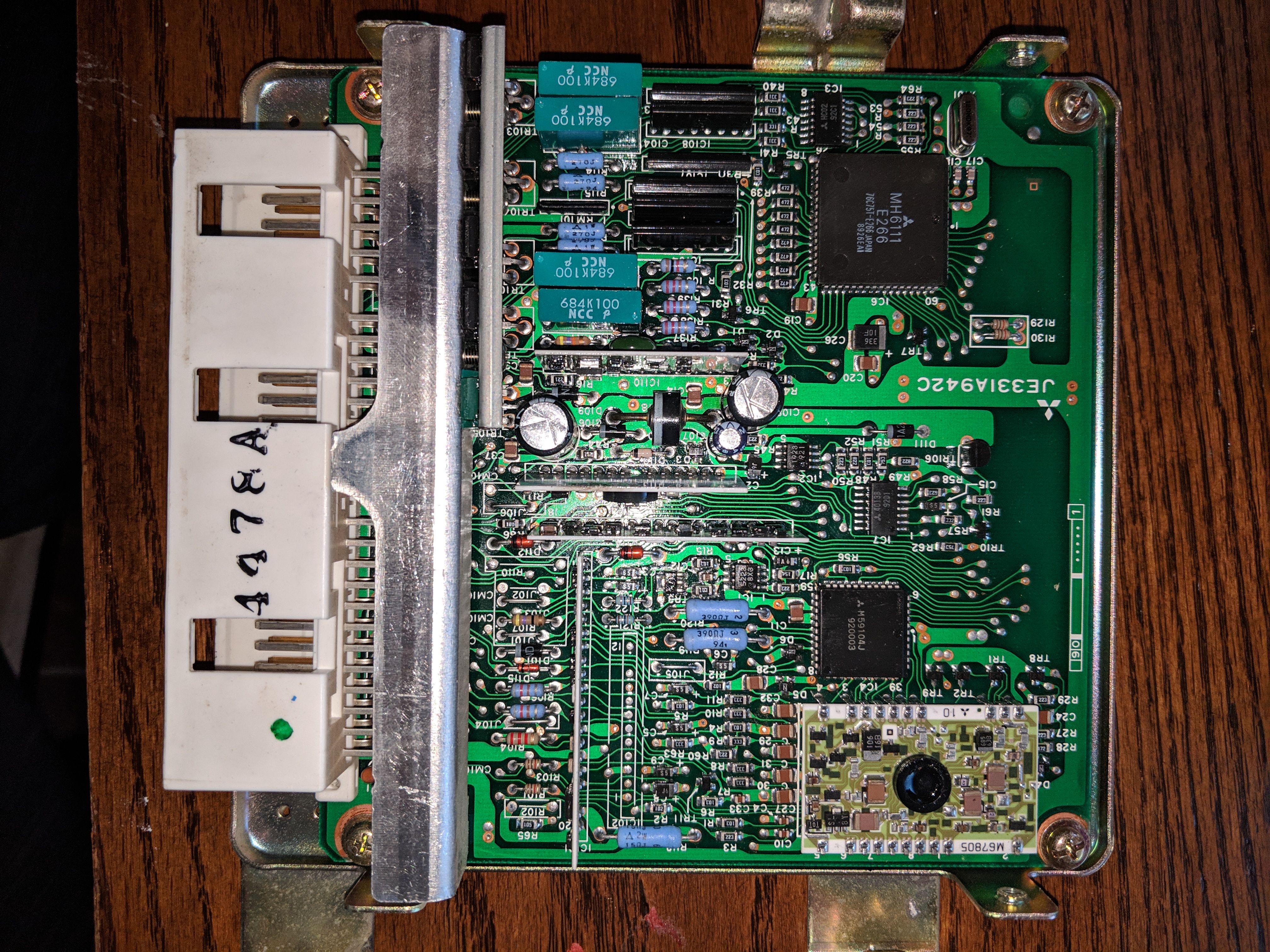

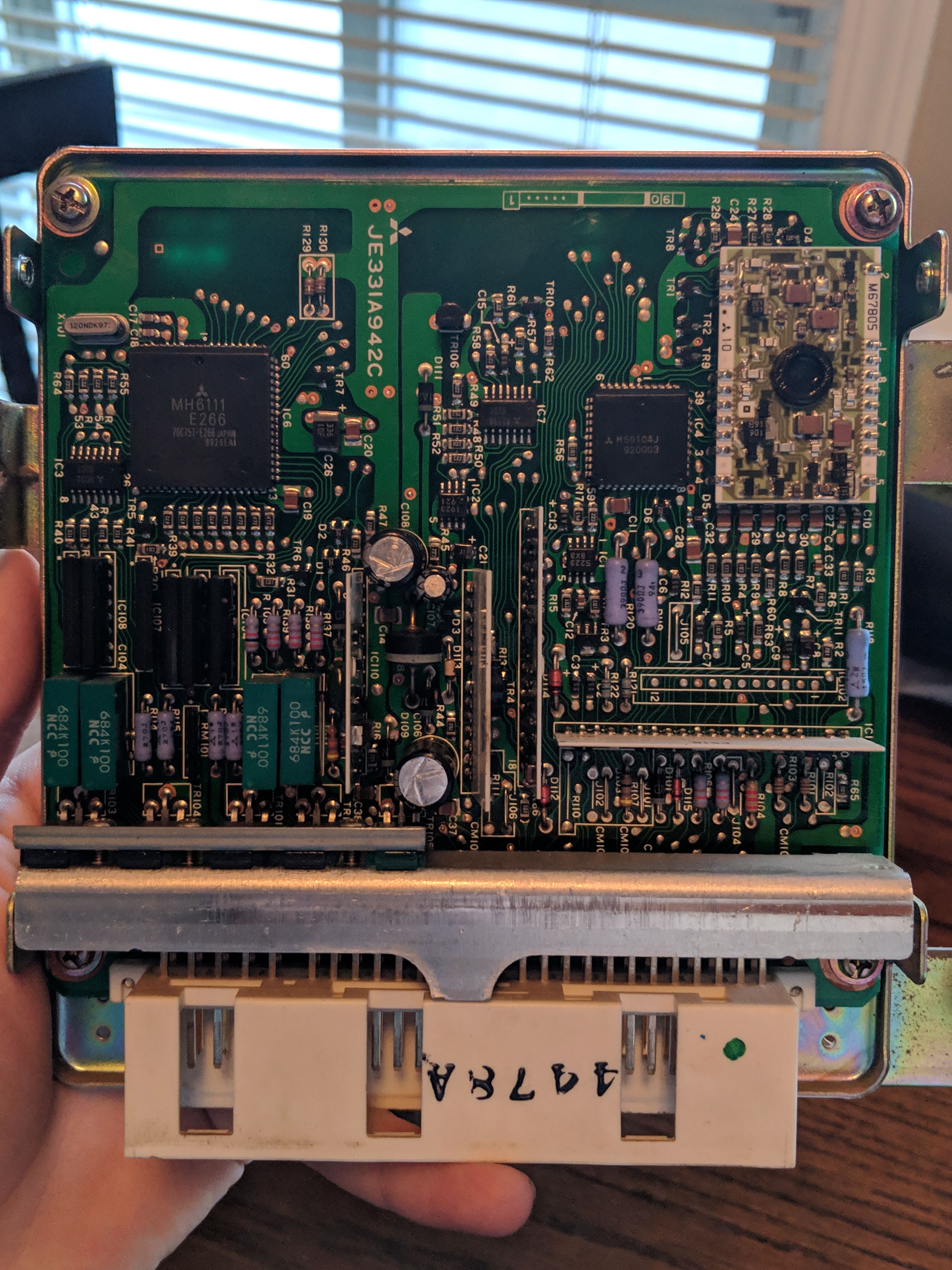

I pulled my ECU out and popped that bad boy open. I also determined that it is a non-eprom unit.
It doesn't have a rotten fish/egg smell, the capacitors aren't leaking and there doesn't appear to be any broken solder joints. I didn't grab a picture of the backside but everything looks fine at a glance. I gave it to a mechanically inclined friend to inspect and he says that everything checks out.
I'm thinking that my ECU is the cause of my no start issue, as I read that a faulty unit will not give you either fuel, spark, or even both. Any help or insight would be greatly appreciated.

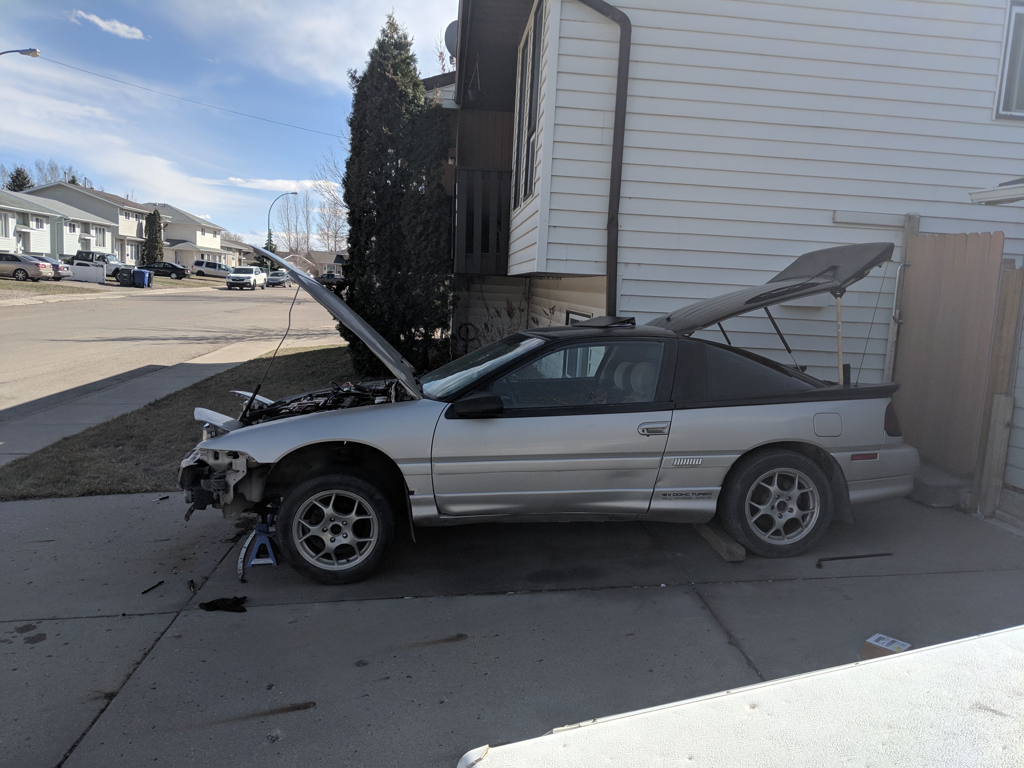

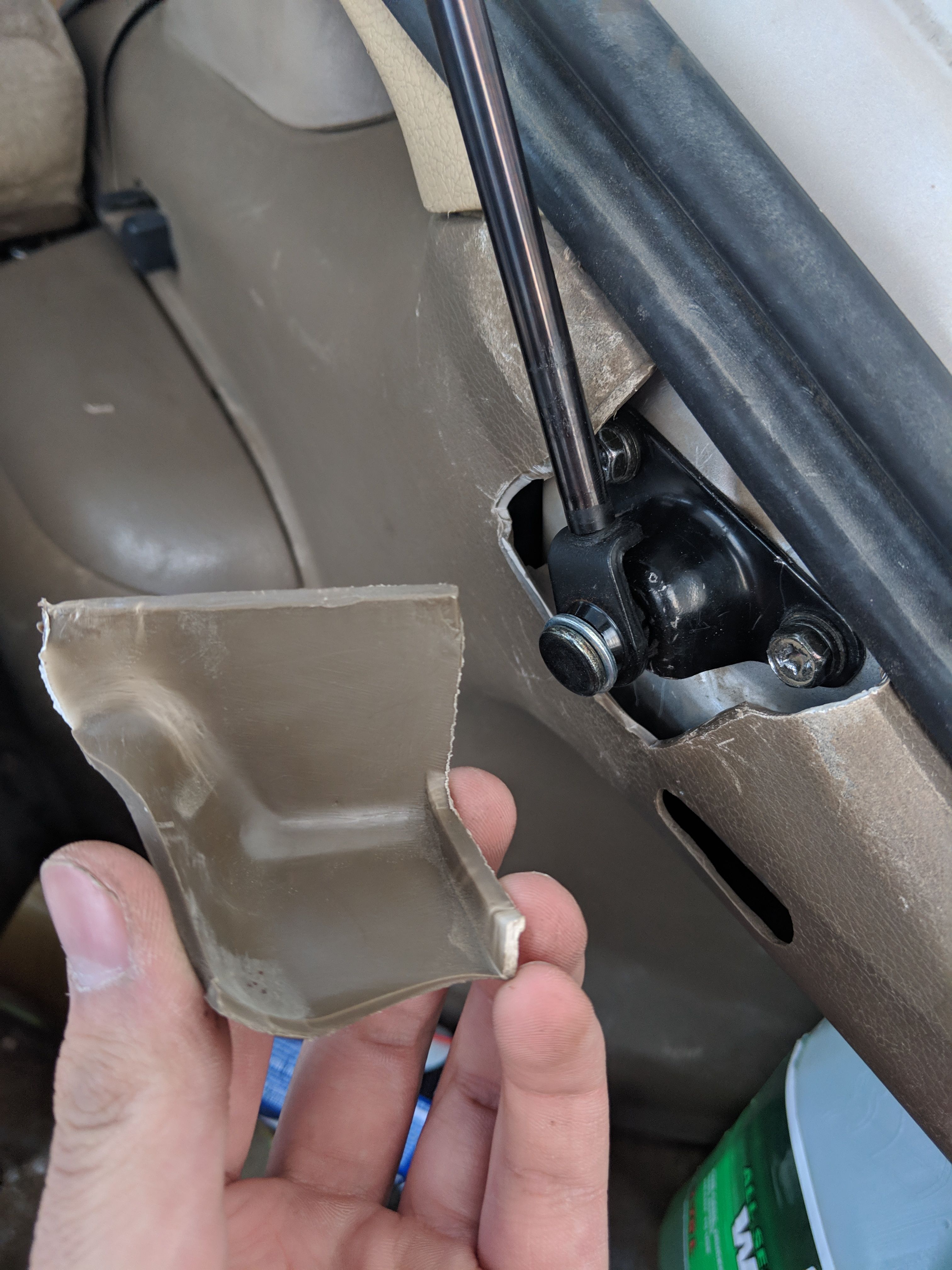

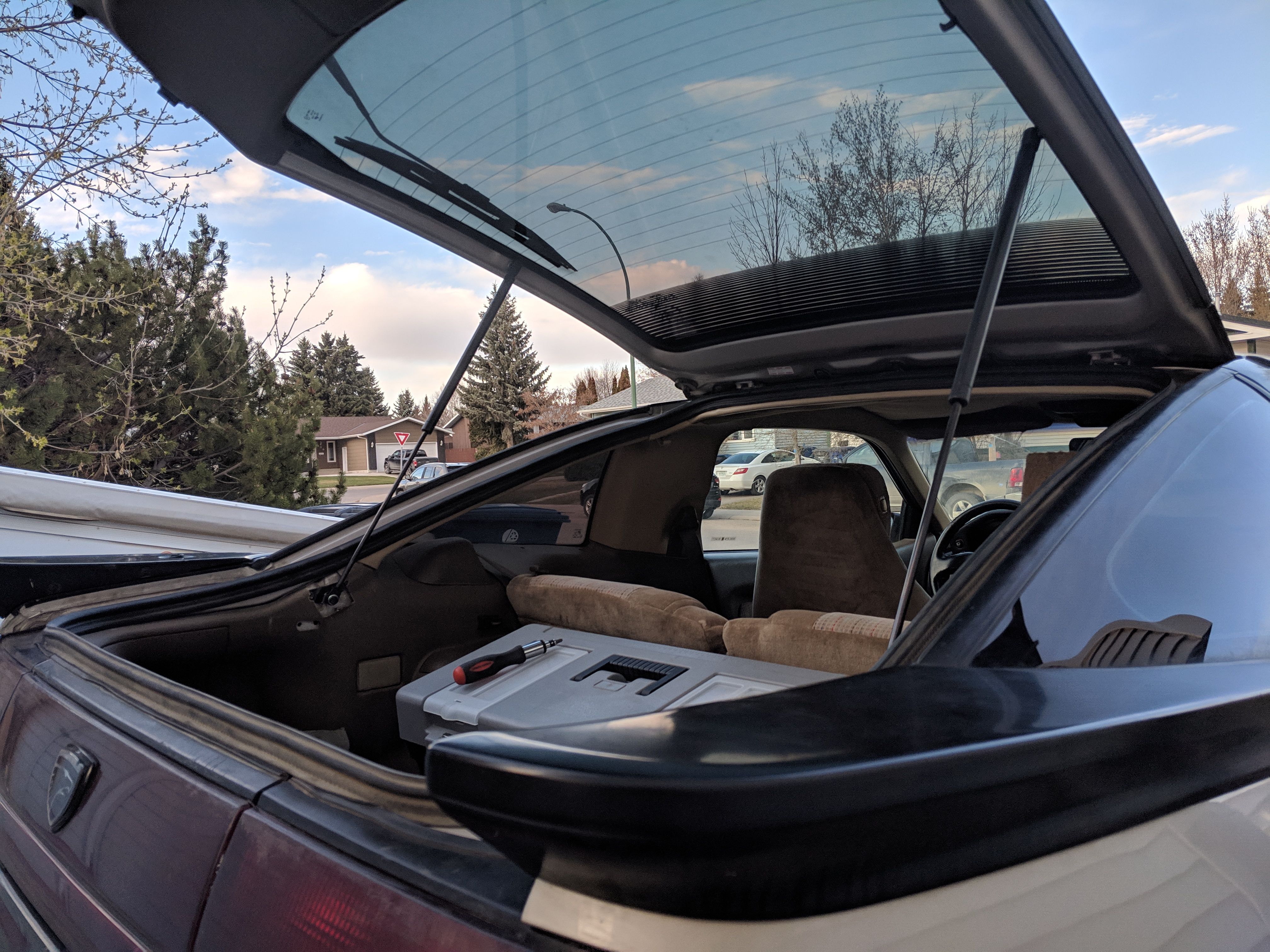

New hatch supports and some new weather trim went in today. Way more convenient than propping it up with my snow brush :thumb:
I broke the plastic trim while prying it back when installing the supports though.
I used a utility knife to make it look a smudge better. I hated how it was asymmetrical so I cut the plastic on the other side in a much neater fashion. Later down the line I'll come back and find a more elegant solution.

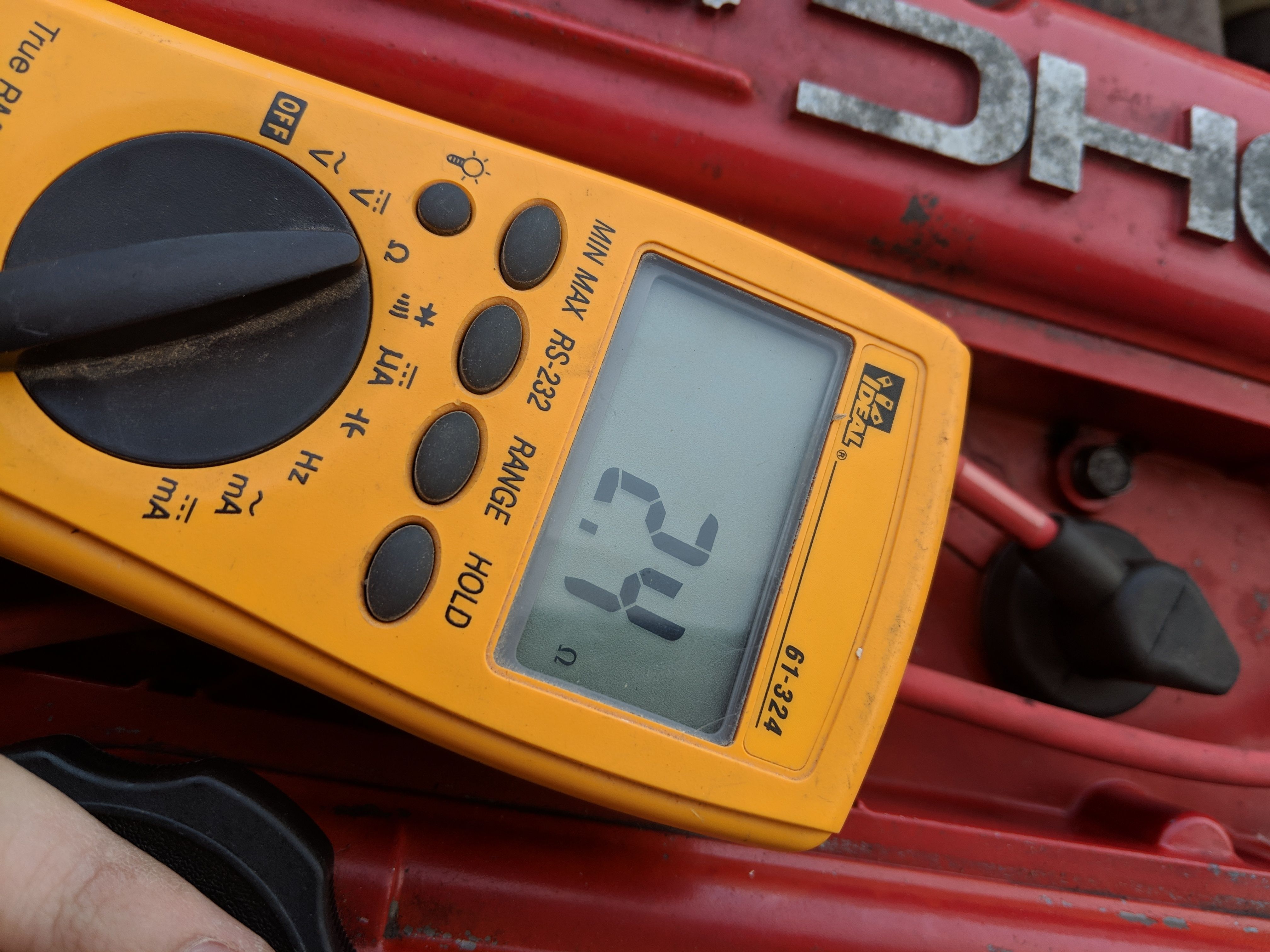

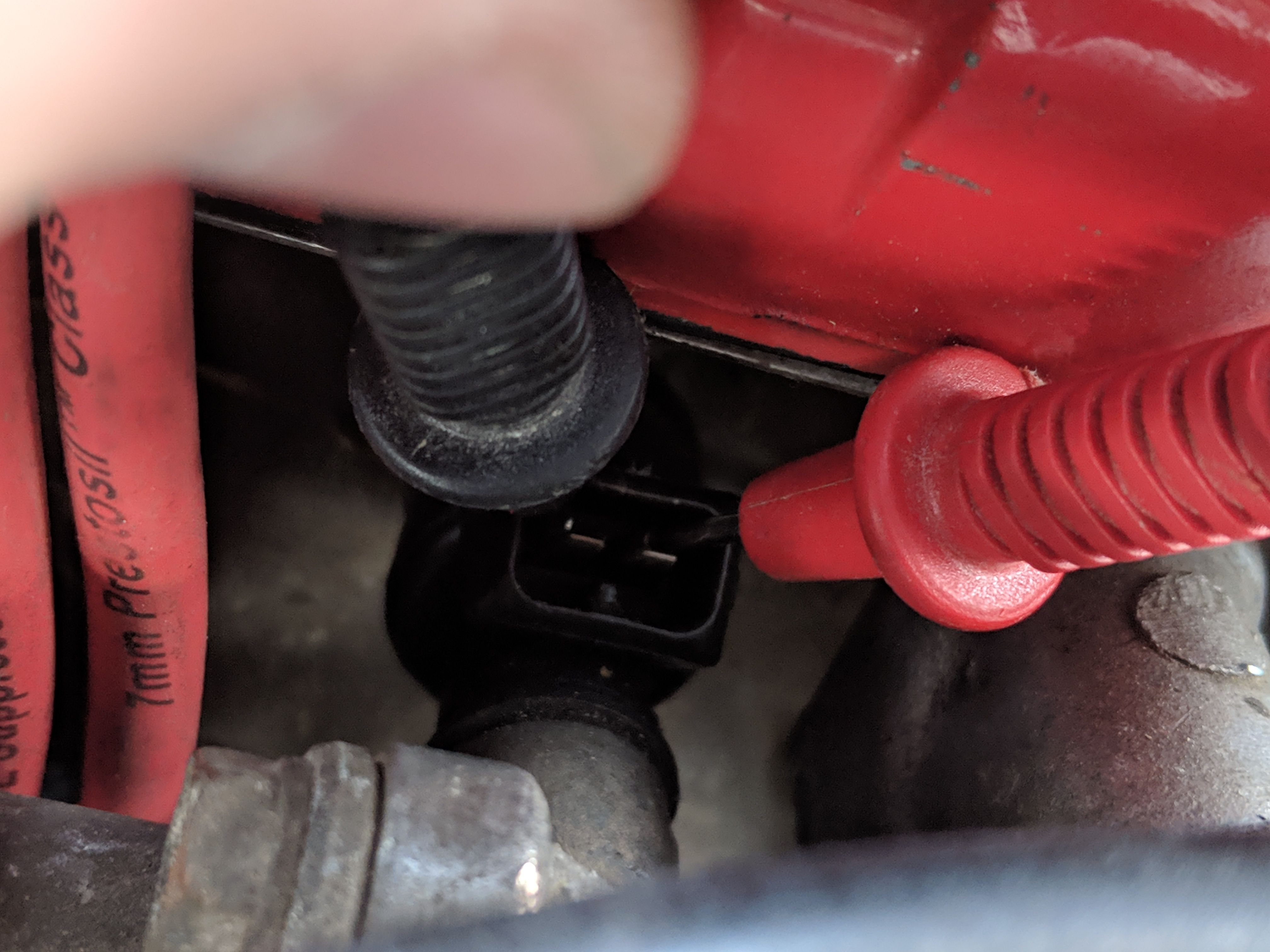

I checked the resistance on my injectors just to be on the safe side.
All 4 checked out at a steady 2.4ohms each. I still need to check if they're getting power from the harness but overall I think the fuel system works as expected. I'm still thinking the ECU is the bad part here :f-u:

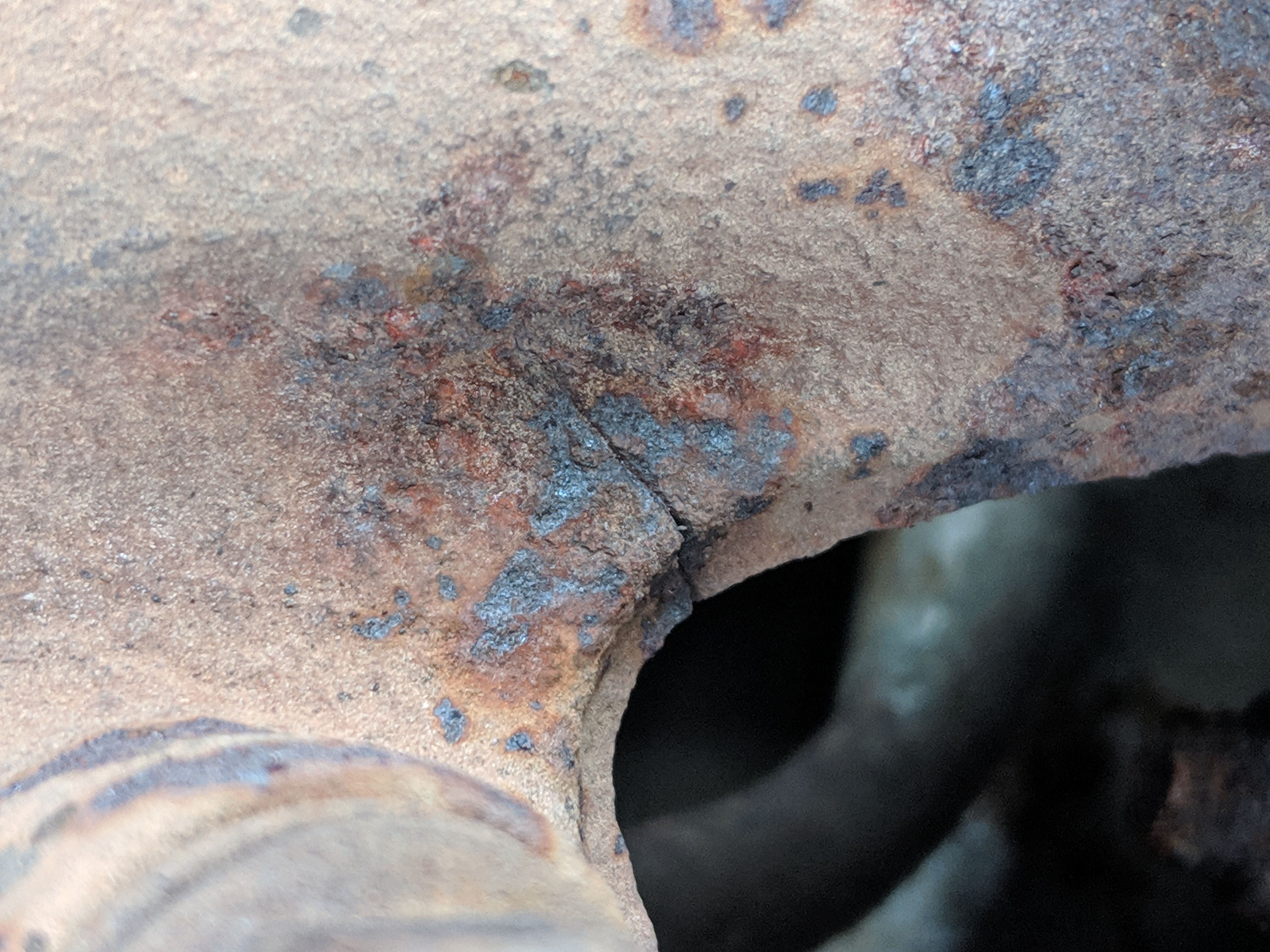

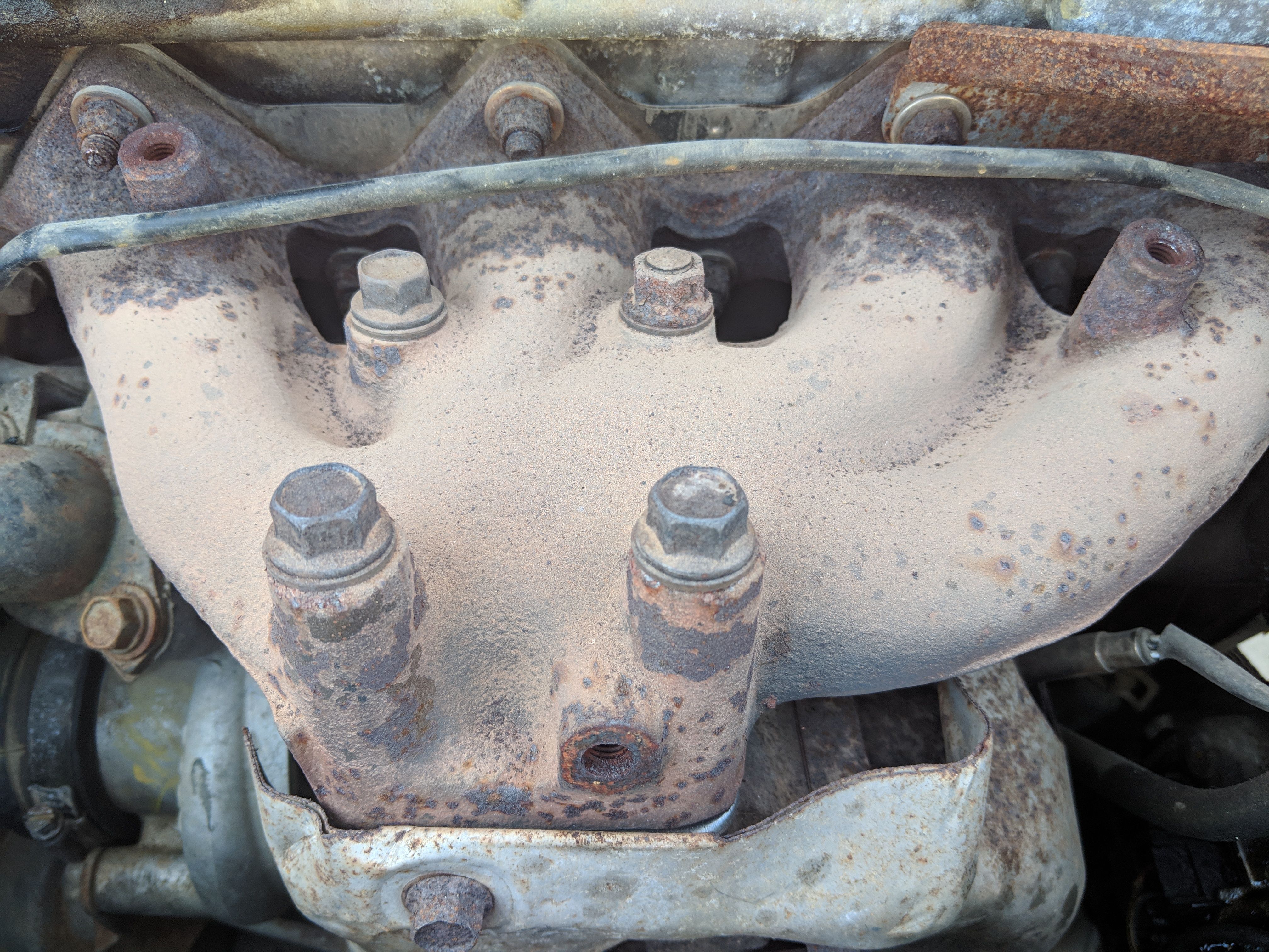

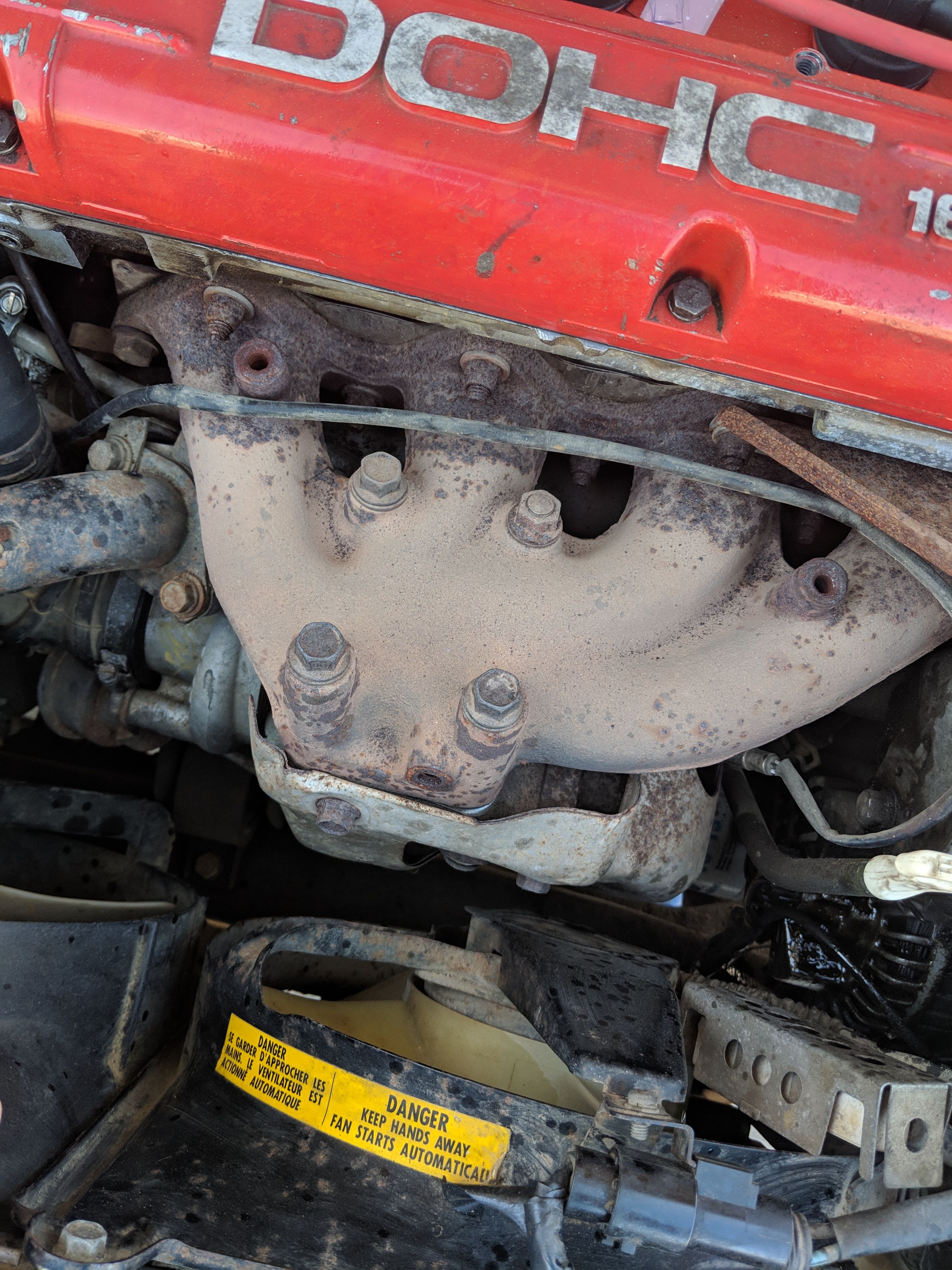

Today I removed the heatshield so I could get a better look at the exhaust header.
I cleaned up some of the rust and caked dirt with a wire brush. I took off the heatshield with high hopes that it'd be crack free but I had gotten my hopes up for nothing :toobad:
There is a crack on cylinder 4's piping.

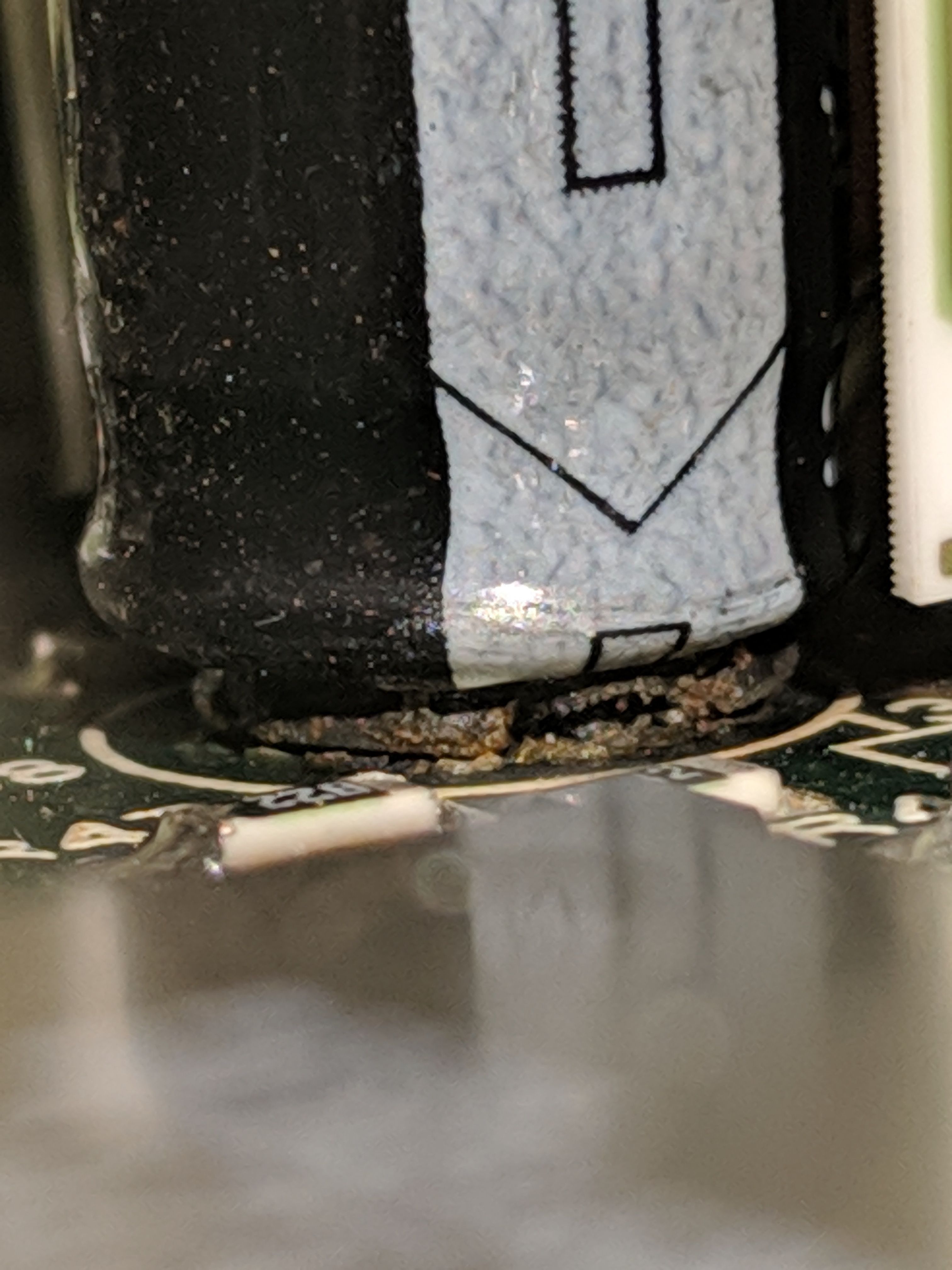

I also pulled my ECU again as I'm expecting to buy a new one soon. I looked over the internals once again and found a slight rotten smell from the capacitors when I put my nose right up to it. Yuck. Not sure how I didn't notice this the last time I opened it up.
Took a closer look at everything on the ECU and one of the capacitors does not look good. I'm getting a buddy to solder some brand spankin' new ones on and clean the area a little bit. Fingers crossed that this is the issue with it, but if worst comes to worst I'll just buy another unit.
New ECU caps went on and I put it back in the car.
Tried starting it up a week ago, it would crank and very subtly hesitate to actually start. Today I bought some starter fluid and shot some into the cylinders. The engine started for the first time in almost a year! :hellyeah:

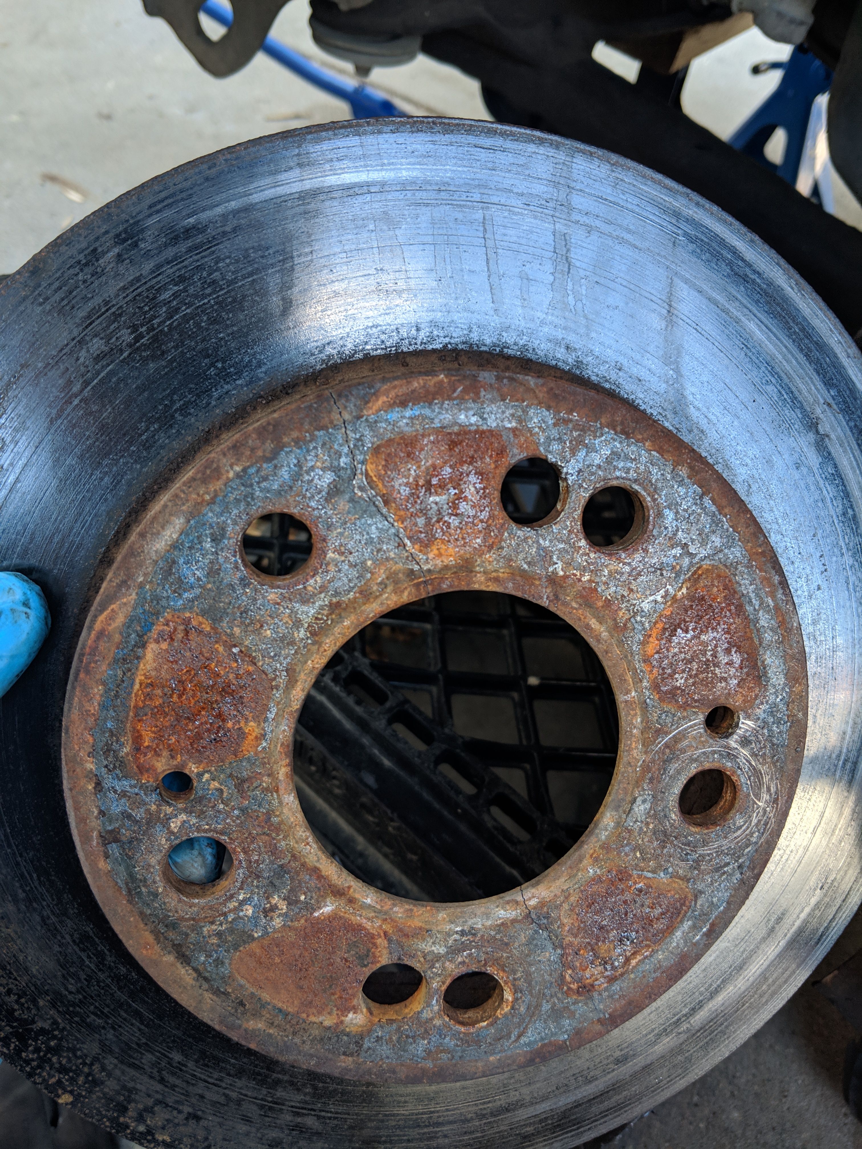

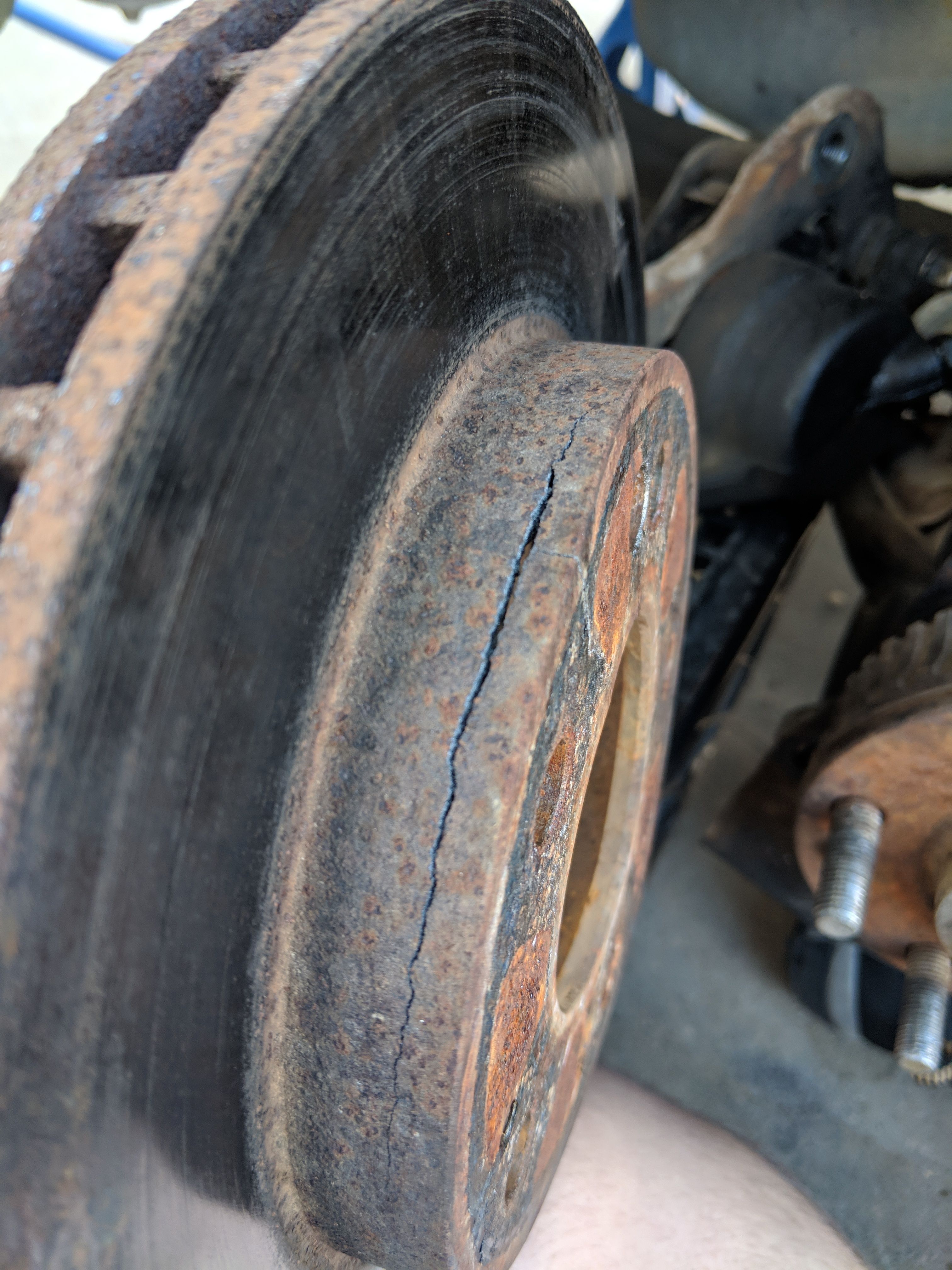

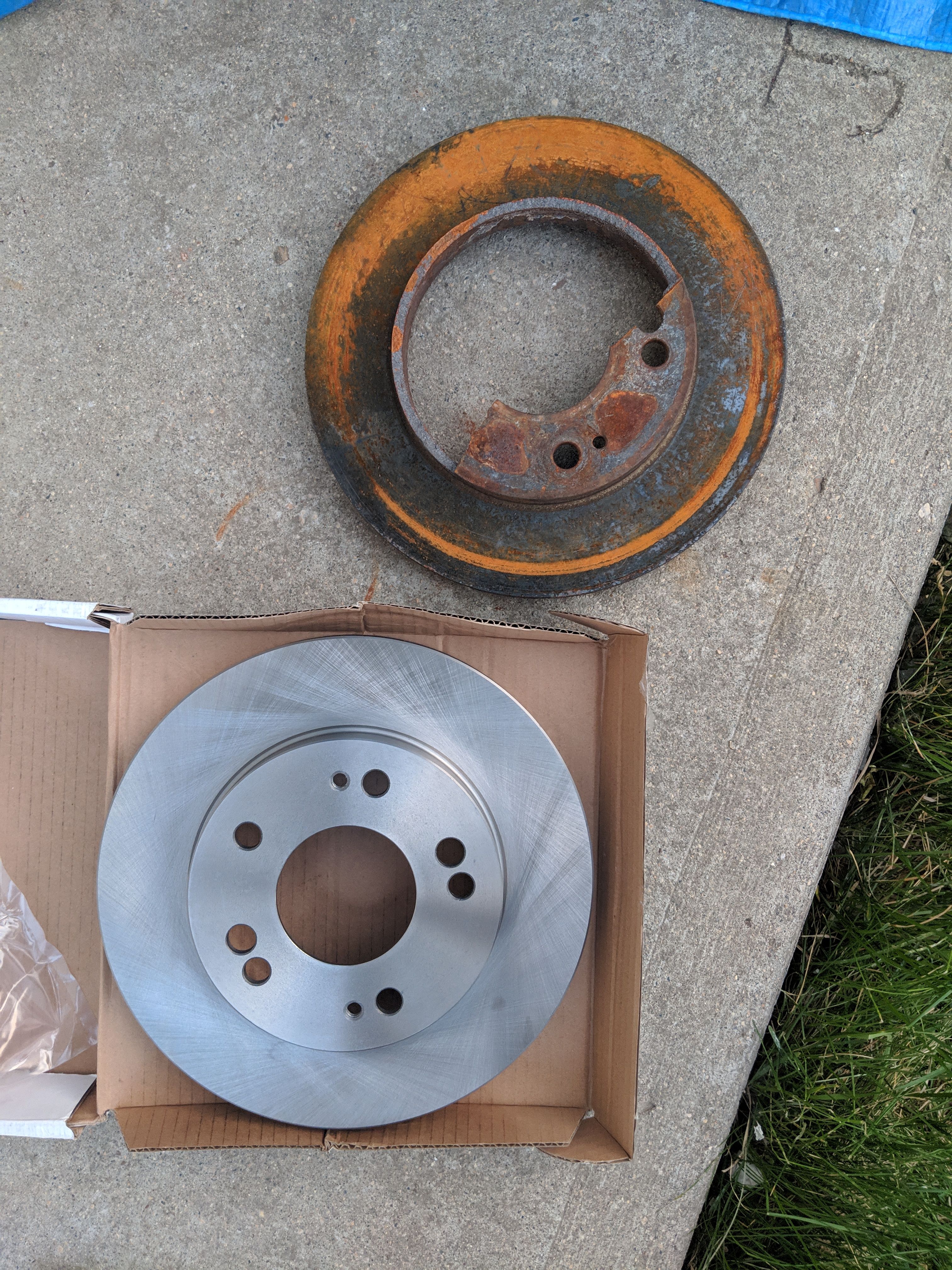

On May 20th, 2019, I inflated my rear passenger tire and took the car for a drive around the block. The steering wheel was rapidly shaking back and forth (read: death rattle :f-u:) and the brake pedal was giving physical feedback. I pulled into my driveway and the car stalled going up the slight incline. Jacked it up and took the tire off, and found bad news.
These front rotors are goners.
There were several other issues:
• CV boots were obliterated, explaining the grease all over the brake parts.

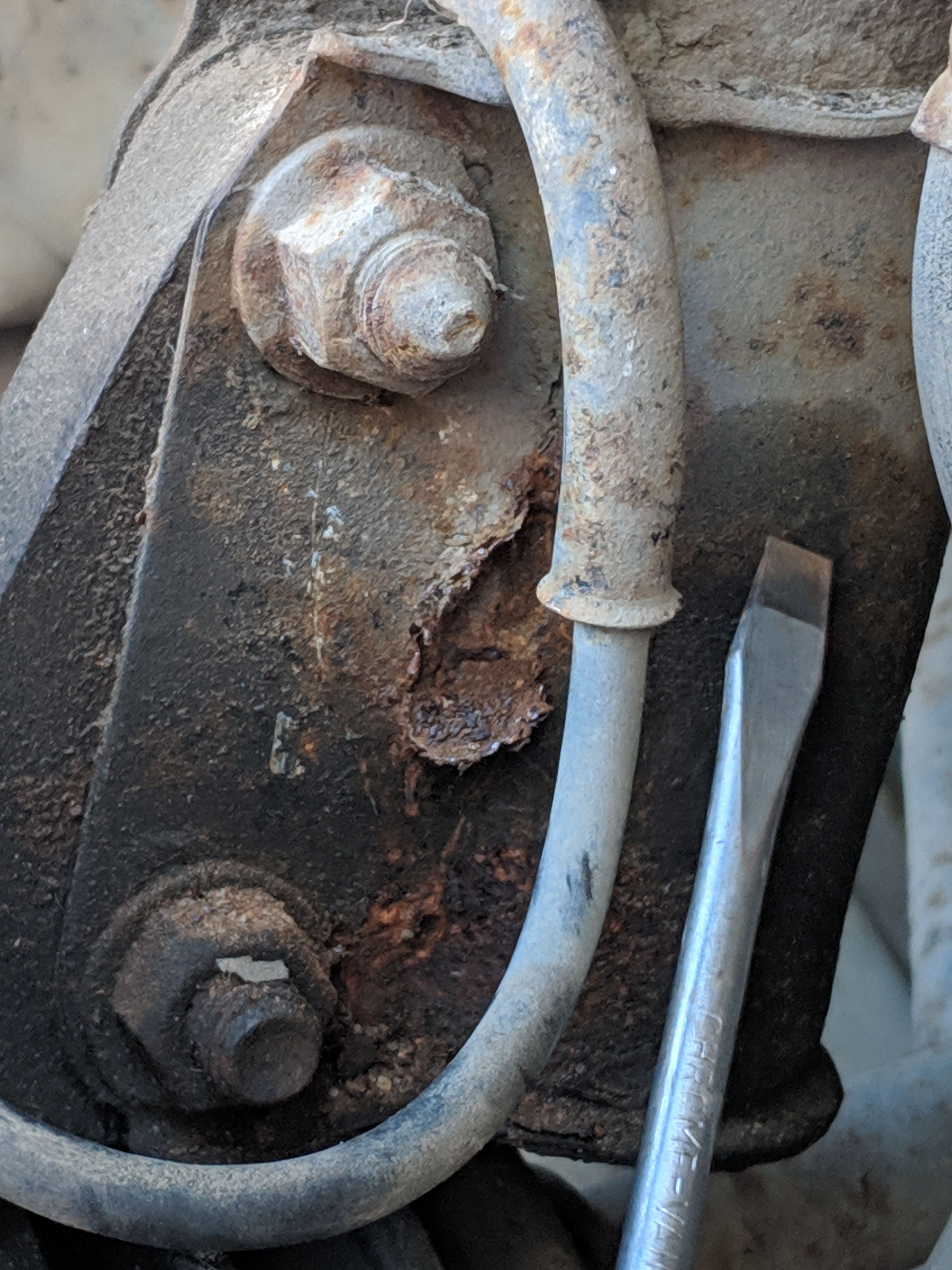

• Strut towers beginning to rust through, there is a 1" hole on the driver side tower.
• Rear passenger wheel well is rusting through on the corner.
• ~20 year old bondo repair on the rear passenger quarter panel. For what it's worth the repair was well done but it's beginning to crack.
• Pretty significant amount of side-to-side play with the wheels when the front end is in the air.
I don't have very much money at the moment to dump into this car and I legitimately considered selling it out of anger. I went to bed and the next day decided that I will order a new set of front rotors and brake pads and see where that takes me.
I ordered Centric rotors and pads from Rockauto for CAD$100 shipped.

The shell and undercarriage are surprisingly rust free. There is some small rust spots on several body panels but nothing too major. The wheel well in question seems to have been coated with a rubber undercoating a millennium ago and I suspect that's why the rust spot exists.

1g exhaust manifolds are junk. Look into replacing it with a 2g manifold.
Thanks for the info, I'll look into rebuilding the pump. It seems like it's the hoses that were leaking but it definitely wouldn't hurt to rebuild it. The alternator is pretty gunked up, I think after I get the car driving I'll get it tested at a shop.
