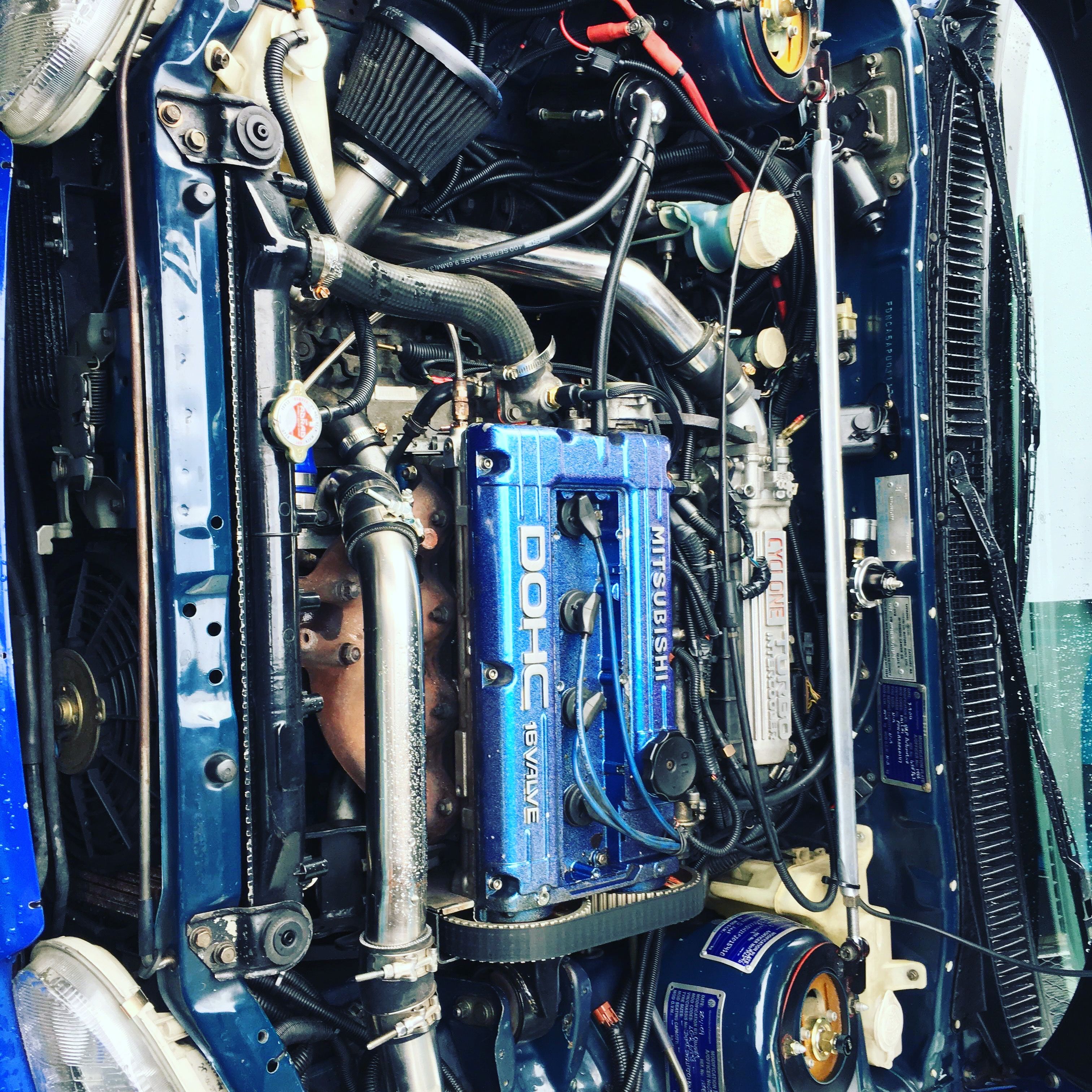

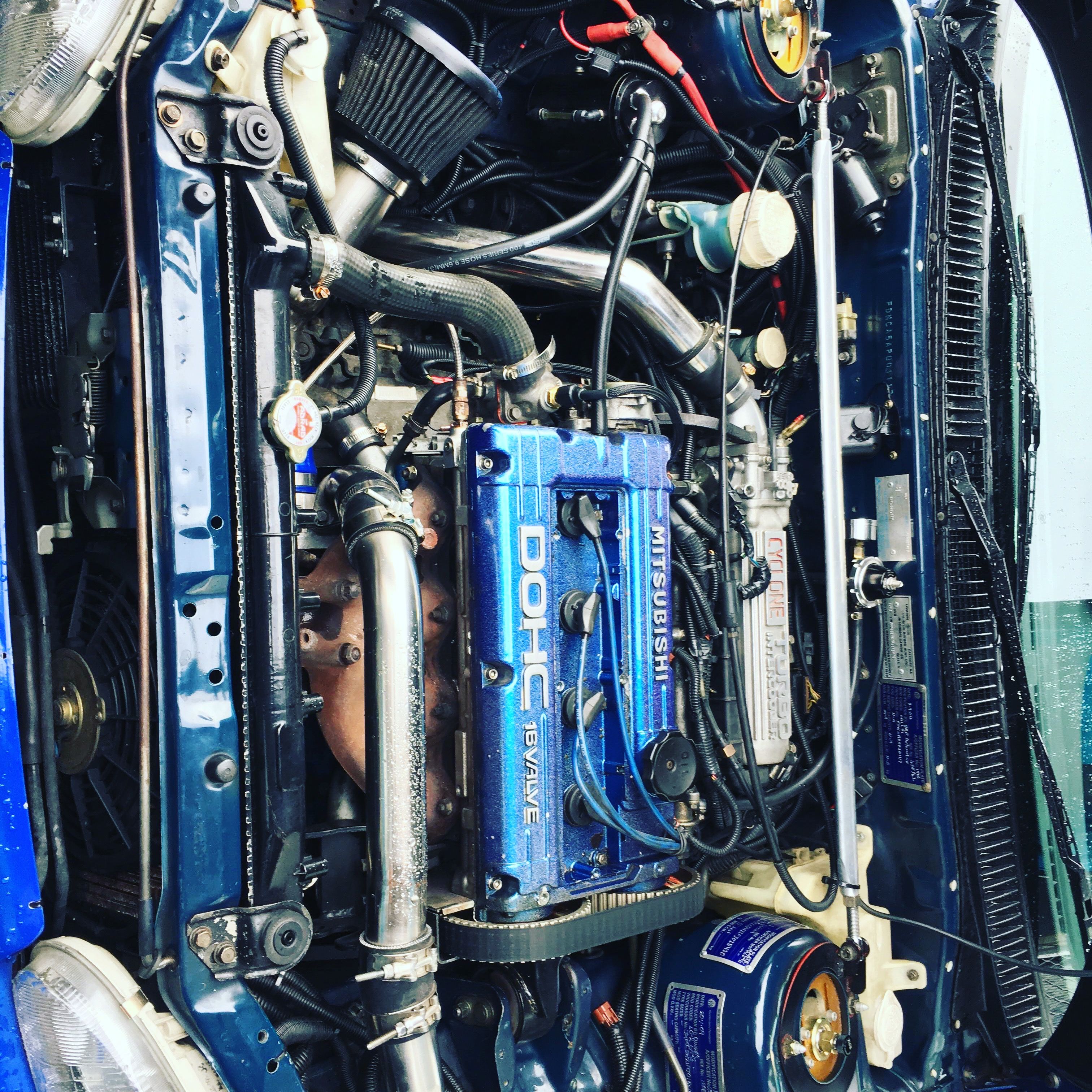

Built 4g63t, eagle rods, weisco pistons, 3 layer metal head gasket, arp studs, 272 kelford cams
Update, so i got bored of the 16g and went overboard, and decided to strap on a 3584 and send it, 2200cc injectors, raceworks surge tank with 460 and 525 inside and a walbro 255, 45mm turbosmart gate, half radiator with spal puller, chinabay stainless mainfold, 3.5 dump, gtx3584, 2.5inch cooler piping, carbonetics triple plate clutch( fried the 5 puck on 2nd pull) thats it in the video went on 27psi so waiting to go back out for a tune with new clutch
