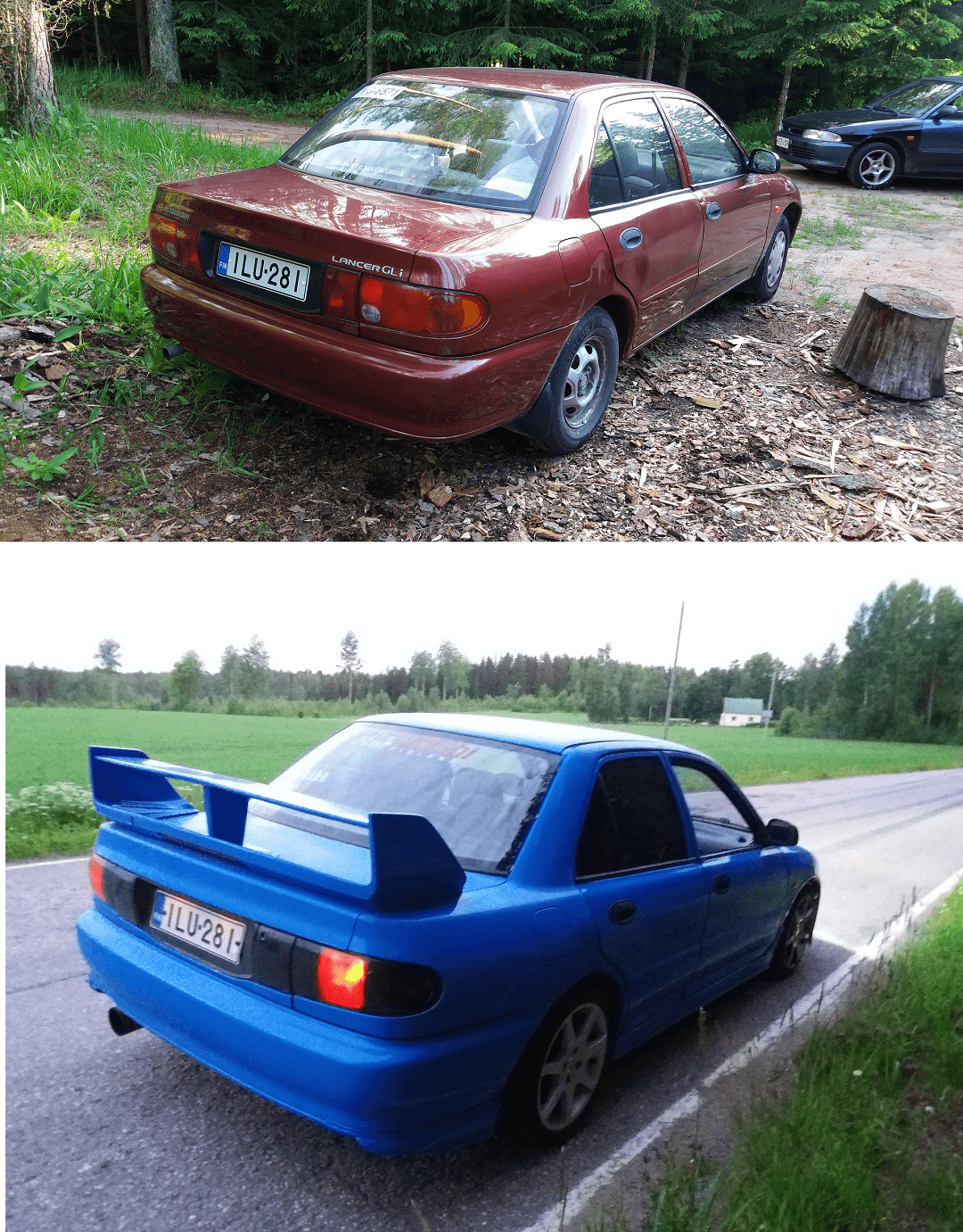

hello sirs I am Patrick Medestomas, i am currently building this 1996 Lancer, hoping to learn a lot feom you guys, cheers!
