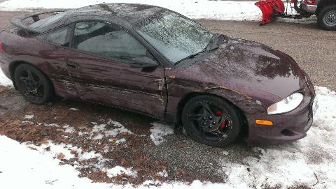

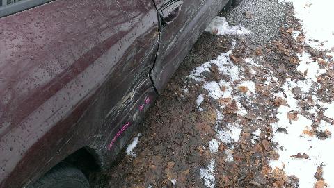

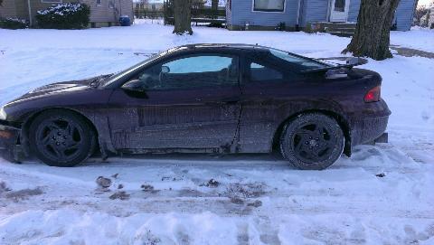

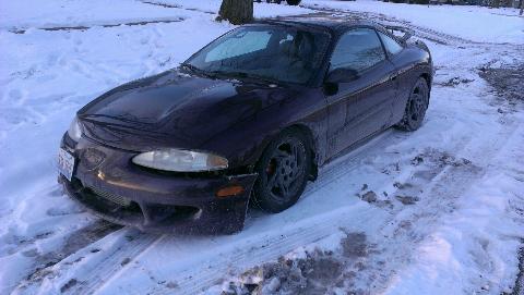

This is how the car was when i bought it.

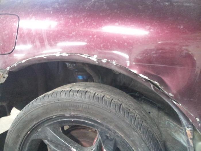

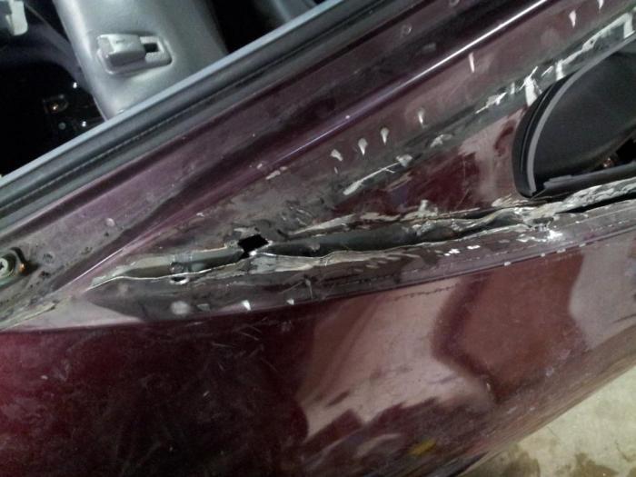

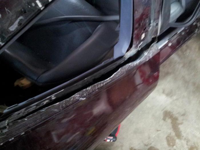

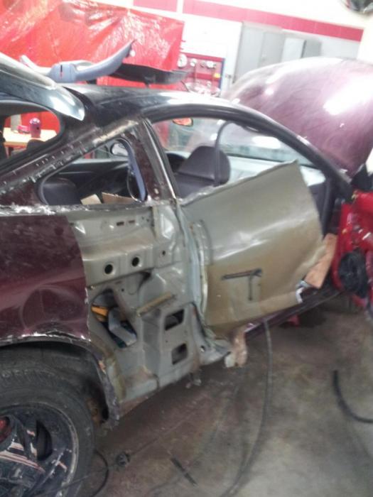

After I got the car home, the project began on removing the door and fender to replace them.

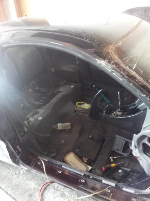

Also, taking out the interior to completely clean it out and remove the Mexican funk from the previous owner (we found a little bag of crushed red pepper even).

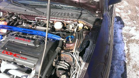

Finally the hood came off to address the rust in the strut tower.
Door and fender are removed off the car and the seats are out for cleaning

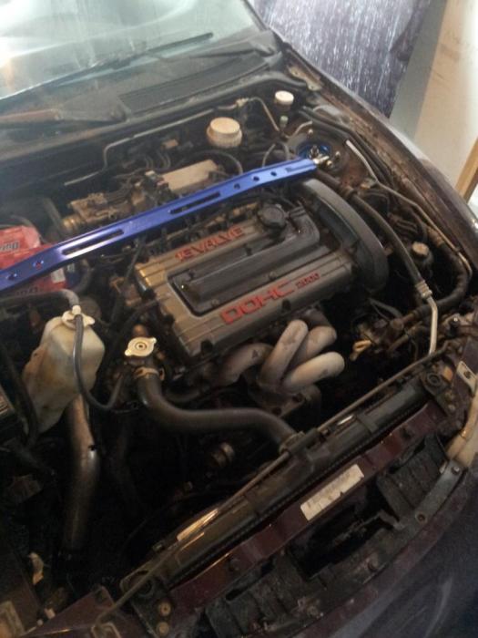

Engine Shot with the hood off!

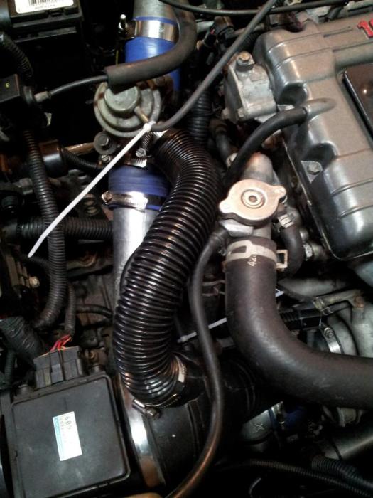

The previous owner installed a larger intake pipe that wasn't recirculating.
And to make the car a more functional daily driver, I went ahead and picked up the factory intake so I could reciruclate the 1G BOV.
I would like to thank DSMlover2011 for selling me an OEM intake pipe.
After i got the intake pipe came the task of running a pipe from the BOV to the intake.
After searching for a little bit i came across this thread
http://www.dsmtuners.com/forums/art...er/442537-hd-spa-hose-recirculation-tube.html
It turned out really good and looks very clean and it doesn't look out of place at all.

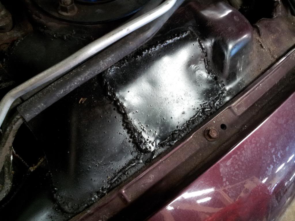

I would fix that strut tower ASAP. That is a structural part of the front end of our cars. Cut out the rusted metal and weld in 16 gauge sheet metal.
That's actually the first thing we did. :D We got the car back to his place. and stripped it down almost instantly. Since he was with me when I did mine, he was familiar with the whole process and wanted to weld his own. So I brought over my 16GA. sheet metal that I had left from when I did mine, and he went to town on his while I cleaned the interior of his car.

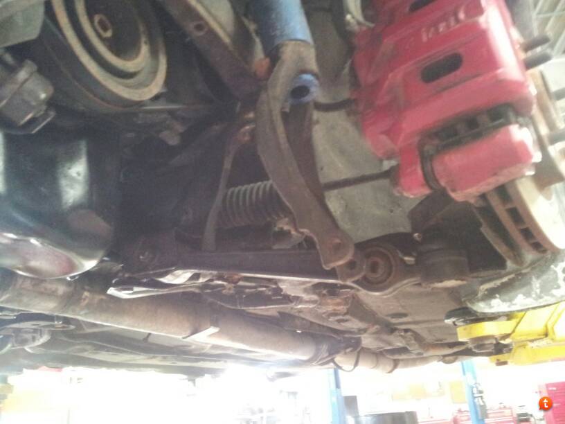

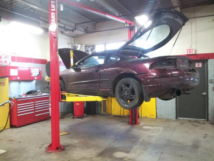

I got my car onto the lift and check the suspension parts.
The front right needs a wheel bearing and a drive shaft. :banghead:
Also when under the car I noticed the oil pressure sensor is leaking oil (I think that's what its called)
Car on the lift

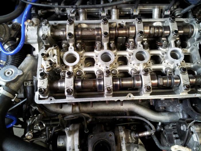

I removed the valve cover to look at the condition of the cams.
They look very clean and have barely any wear.

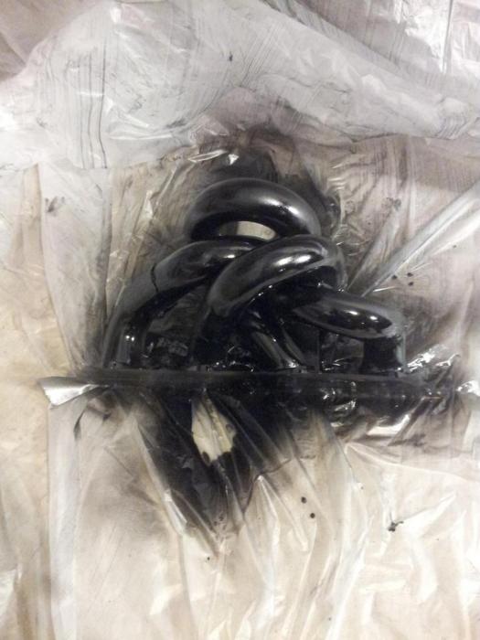

I removed the exhaust manifold and media blasted it in the media cabinet we have at the shop.
After they were all clean and the old chipping paint was off.
I brought the exhaust manifold home and painted them with high temperature gloss black paint.
The exhaust manifold that came with the car is a pace setter.
After doing some research the are cheap eBay headers.
At least they look cool :thumb:
Exhaust manifold while painting
When I got the car home the of the first things me and my buddy did was welded the left strut tower.
Before
After

Had to finished cutting out the seized bolts on the control arm to replace the half shaft. Also the other side needed a half shaft too.
Passenger side
Driver side

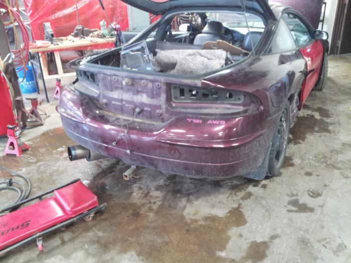

Update

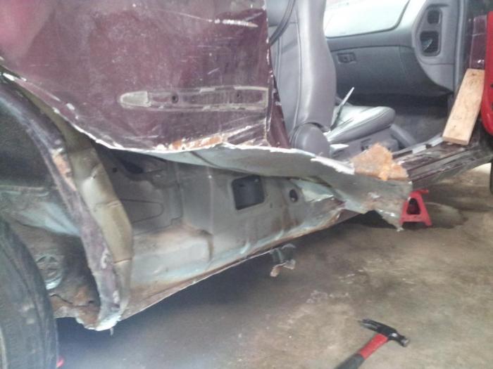

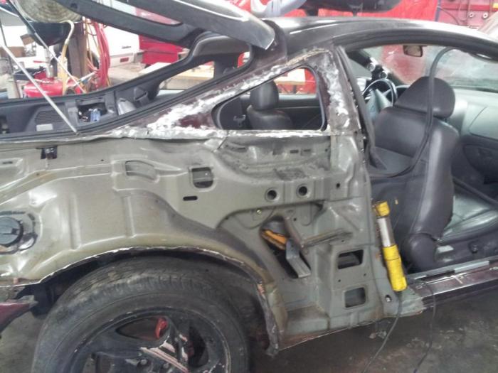

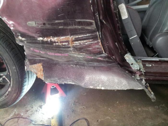

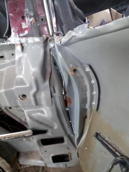

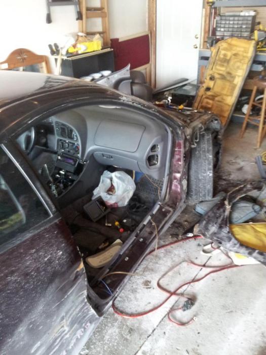

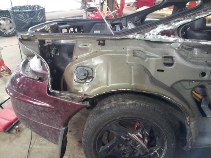

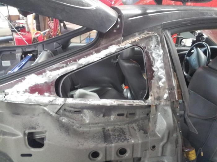

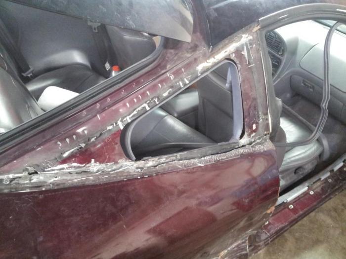

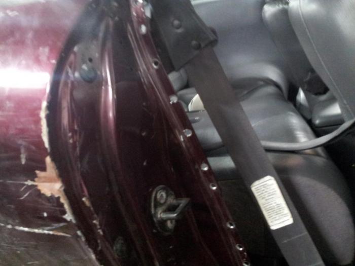

After getting a new door and a new fender. Came the big PITA quarter panel that was pushed in from being side swiped. I did a bunch of research and found out the panel was spot welded onto the car. I knew that the damage was to bad too bondo and was too expensive to have a shop do it. So I got to work removing it myself.
First thing I did Was remove the rear bumper to get at the back of the panel.

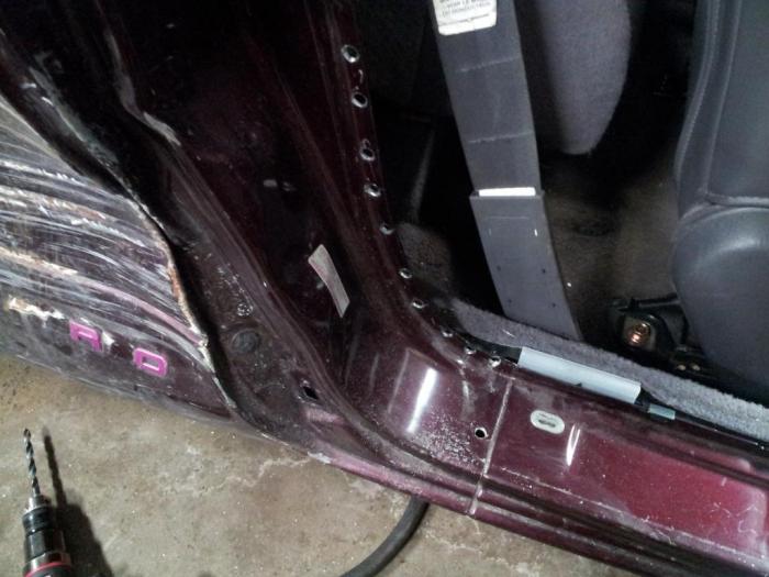

After that I started drilling out the spot welds that held the panel inside of the car. This went pretty fast it was thin metal too drill into.

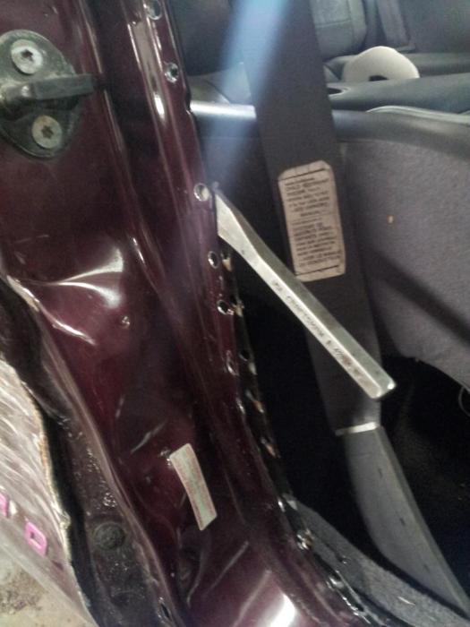

After the spot welds were drilled out I started hand chiseling up the seam to separate the panel from the car.

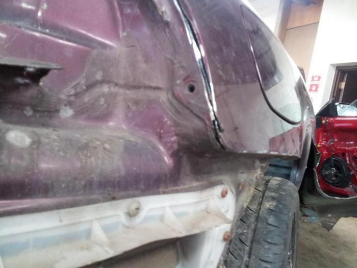

Then I had to remove the quarter panel window. I started by taking the weather striping off and then tried prying the window off from the car and it ended up shattering :banghead::banghead:
After I cleaned up the window, I started slowly hand chiseling the metal away from the car.
After the inside of the panel was separated and the window part separated. I went to the back and took a grinder with a cut wheel and started cutting around the panel. I was cutting farther away from where the panel sits to give the new panel more room and not to cut to much away. Also cutting under the panel where it meets under the car.
After those cuts were made. I made one last cut right in the middle of the panel to help pull in off. After all that it was time to start pulling and chiseling.
After the panel was removed.
It was a lot of hard work but I'm glad I went this route then paying a shop to do it. Also I have the new panel and will be making an update soon on me installing it. So Stay Tuned! :D

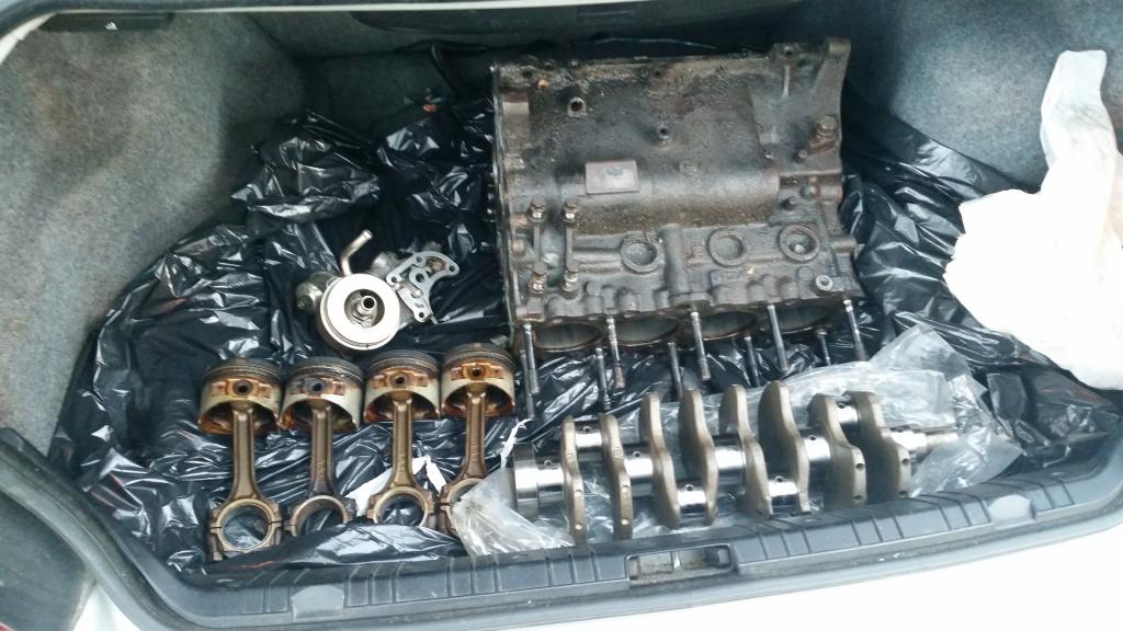

Hello everyone its been a while sense I last made an update and a lot of things have happened. First off I did get the new panel and put it on the car. I used body panel adhesive and welding in other places. After I got the panel on the car I started to drive it. After about a month of daily driving I was going to get the car painted. Before the car got painted i was cursing at a local car spot and my car spun a rod bearing. I instantly knew what happen because i was with my buddy 2 weeks before when he spun his bearing. I pulled the car of the side of the road and shut it down right away. At first i was so pissed. I wanted nothing to do with the car after everything i had done to it. After getting it home i made the decision to part out the car and try to get some money back from it. After a couple of days of hating the car i realized that this is a hobby that i love and that i should not give up on this car and see it to the end. After looking onto craigslist for a while. I found someone selling a 6 bolt block with a brand new crankshaft that was just polished. It also came with pistons and rods. It was a very good deal so i snatched it up right away.

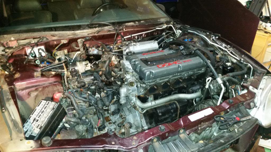

Where i am right now.. i have the old motor out and am getting the last few parts i need to get the 6 bolt together. I'm going to have a machine shop put the engine together as long as it doesn't cost to much. I want to take my time and do this right and do the easy stuff while the motor is out.
Starting to pull the motor
This is the 6 bolt block I got. Also came with ARP Head studs
Took me a month between school but i got it out!
While the motor was out i got to painting the engine bay.
I got some goodies! I'm still going to shoot for my 400whp goal.
