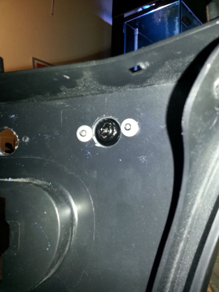

6. Now you need to remove the bumper material around the stock mounting holes. Use what works best for you, but a dremel with the mutli-purpose cutting bit was convenient for me. This would also be the time to remove the guide "pins" on the bumper itself that are normally used to line the bumper up with the fender. You won't need them any more with this kit. (You'll notice in the photos, I didn't cut them off until I actually mounted the bumper to the car.)
7. Now we're going to attach the s-spring to the brackets. For each hole, you will have: 2 long rivets, 1 s-spring, and 2 washers. Cones facing up, use the longest rivets supplied in the kit. Feed them through a rivet washer (this keeps the rivet from pulling through the spring) before putting them through the top of the spring.
8. Fasten rivets with a rivet gun. This is what it will look like when attached properly.

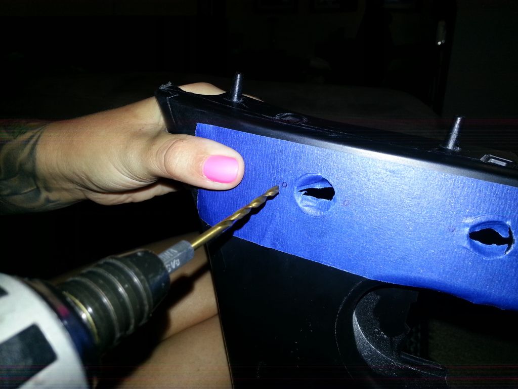

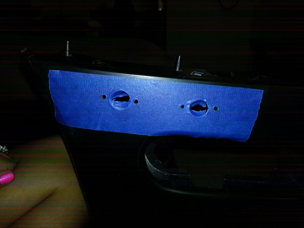

9. Place a piece of blue tape over the top of the Dzus holes in the face of the bumper cover. Cut a slit through the holes.
10. Push the Dzus fastener through the slit in the tape and mark the holes for the rivets. After marking the holes, measure them to the top of the bumper to make sure they're all of equal distance.
11. Using the 1/8" bit, drill through each hole.

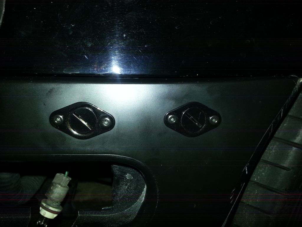

12. Remove the blue tape. Attach the Dzus fasteners to the front side of the bumper cover, and the rivet washers on the back side. The rivet will also go through the back side.

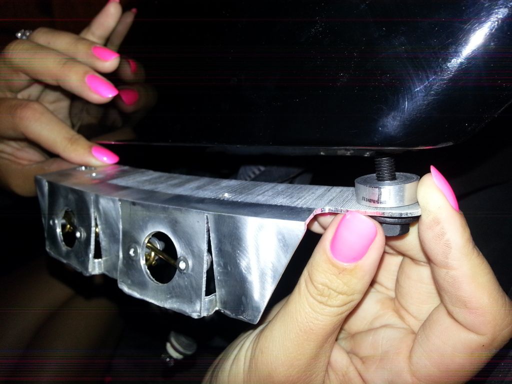

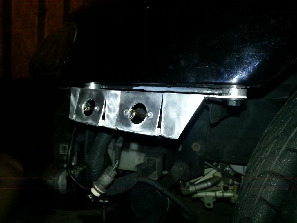

13. After all the Dsuz fasteners are attached to the bumper, now its time to attach the bracket to the fender. The aluminum washers will go between the fender and the bracket.
img_20130707_165928_zpsda2f0f12-jpg.251513
img_20130707_170214_zpsfb954300-jpg.251514
14. Slide on the bumper cover. You may have to adjust the angle and location of the bracket slightly so the bumper cover will line up with the fender and slide in and out freely. Rotate the Dzus fasteners so they line up with the retaining s-spring and twist to tighten. You're done!
