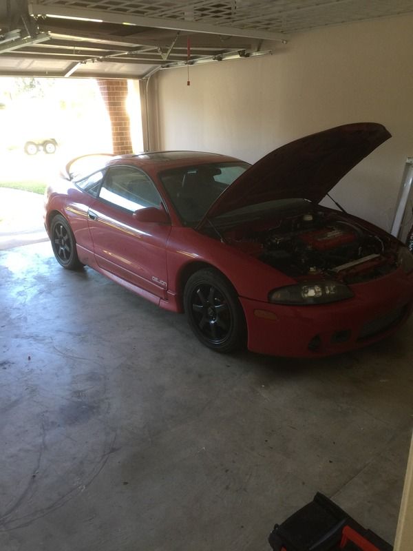

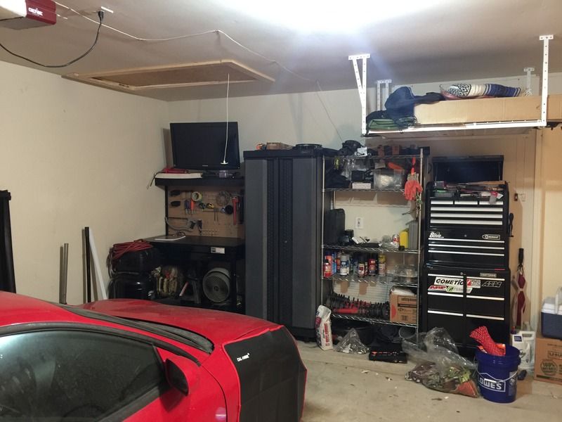

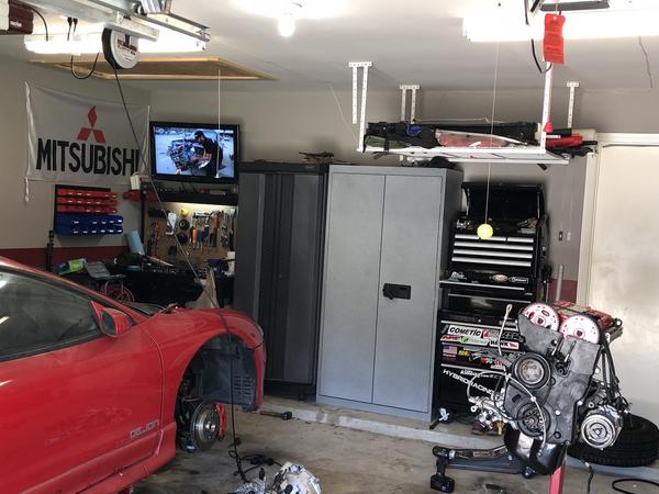

I finally have a garage! Its a tiny two car, but its so much better than laying on dirt or plywood!
So I started putting all my stuff away. Put the TV up. The reason for this is simple. When I arrived we somehow had an extra TV than when we left. Not really sure where it came from, maybe the previous owners left it and we didn't notice. Anyway. My plan is for more of the steel cabinets from Lowes but damn they are pricey. I will eventually get one small one to put all my car cleaning supplies and one large one for where the wire shelving unit is. But moving is expensive and that will have to wait. I also keep a huge pile of parts squirrelled away in the attic above. My next goal is to reinstall the overhead lighting this garage used to have in it and they took down and stored up above. I also want to paint the floors up but I haven't had time.

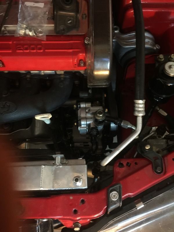

Also with my engine bay so clean, I finally figured out that the powersteering pump is leaking. And by leaking what I really mean is pooring out all over the place. Probably what has really been eating up my alternators. You can also kinda see the tucked lines here in this picture and I have more later on. So I rebuilt the powersteering pump. Really easy actually, easier than I thought. Good guide online that isn't strictly for the 7bolt but between it and the FSM I got er done. Painted the pump up with high tem engine paint while I was there.

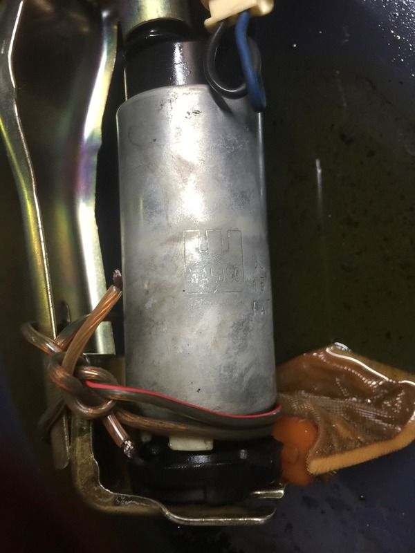

Decided to finally get around to replacing my fuel pump with a 255. And found a 255 already in there. So I just replaced that dirty sock.

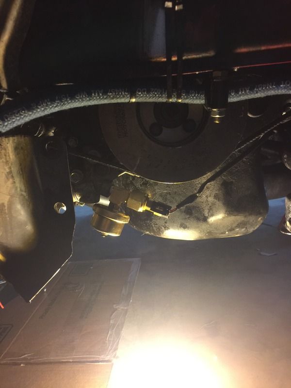

Wired up the AEM Oil Press Gauge. I kept the stock gauge as well, although I am probably getting rid of it when I install my Evo 3 Oil Filter Housing. This really isn't that hard if anybody wants to do it. You can also see my tucked power steering lines. Not really liking holding them down using zip ties, but its holding alright right now. I used a wire clip bolted to the oil pan bolt on the corner to ensure that the pressure sensor wire doesn't hit my axle or hit the belts.

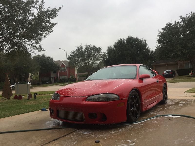

Gave her a bath for the first time in probably six months at least. Looks good clean, but the paint is roached. That's next on the list of what I am saving for actually, a decent paint job. Maybe during the summer. We will see.

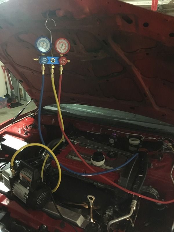

Started working on the A/C that I am determined to keep. Try number one. Failed. Didn't hold pressure. Vacuumed fine but would bleed 20PSI in thirty minutes. Not good at all. Have since gotten A/C working though.

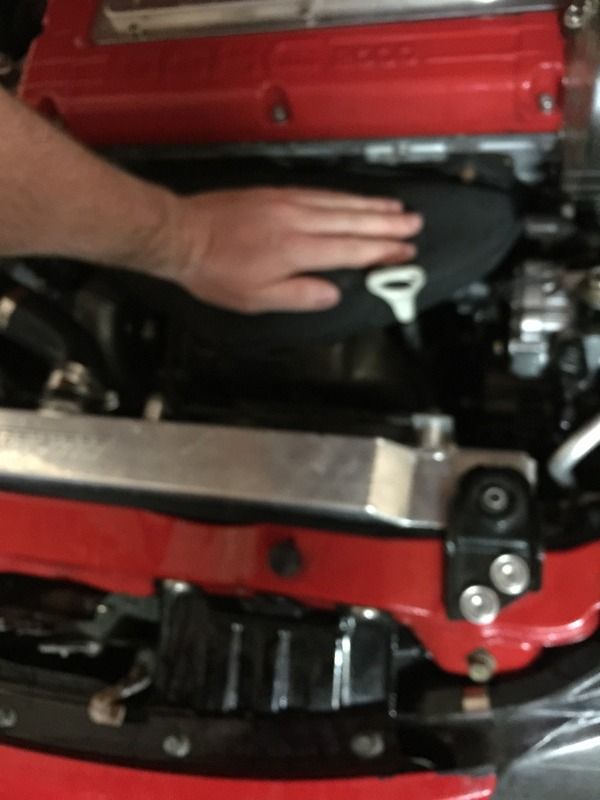

Turbo Blanket works really well. I really recommend these. Got it from here: https://turbo-performance-products.myshopify.com/products/dsm-fp-manifold-blanket

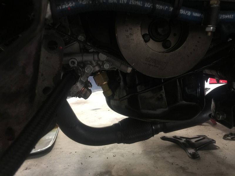

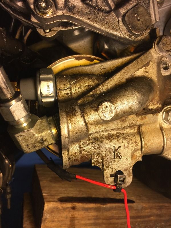

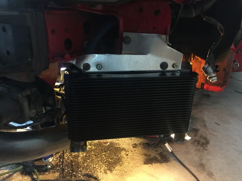

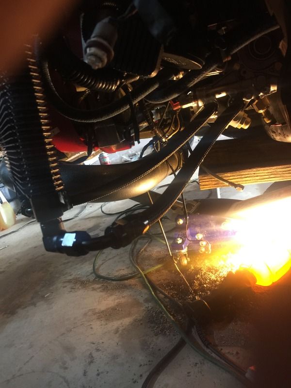

So I took this opportunity to switch to the EVO3 housing with external oil cooler. Here is how I set up my external oil cooler. Its not pretty but it is mounted pretty solid.
You can kinda see a gold knob hanging off the oil filter housing. Yeah that should have a crush washer on it ... but it didn't. So that was an oil leak.

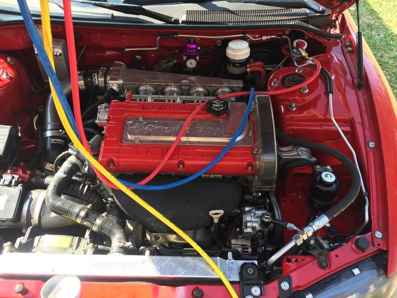

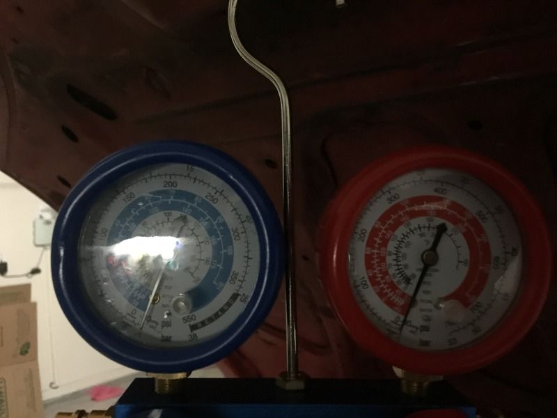

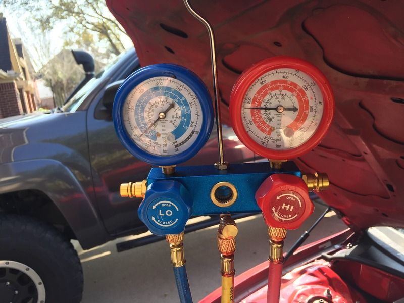

A/C has been a real b*tch. So with this Magnus IM it sits much lower in the bay and much closer to the A/C compressor. The hotside hose comes off the compressor and jams straight up into the back side of the compressor. I blew through two of these that blew in the exact same spot. So I said forget that noise and had my own custom made. I had it made a bit to long, but it works for now. Here it is getting made. I had them make it at an Oil and Gas hose supply company and it turned out pretty nice for $60
Holding that good good pressure. 40 on the low pressure side. 160 on the high side while running.

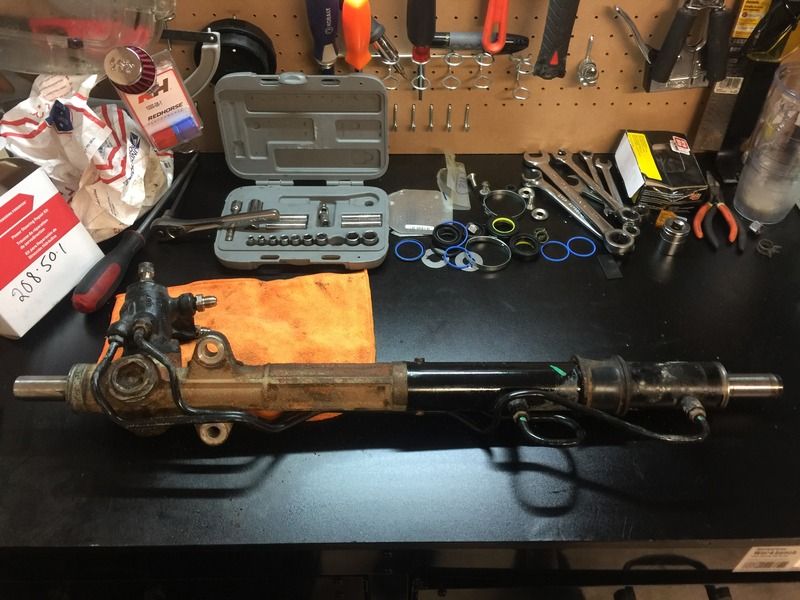

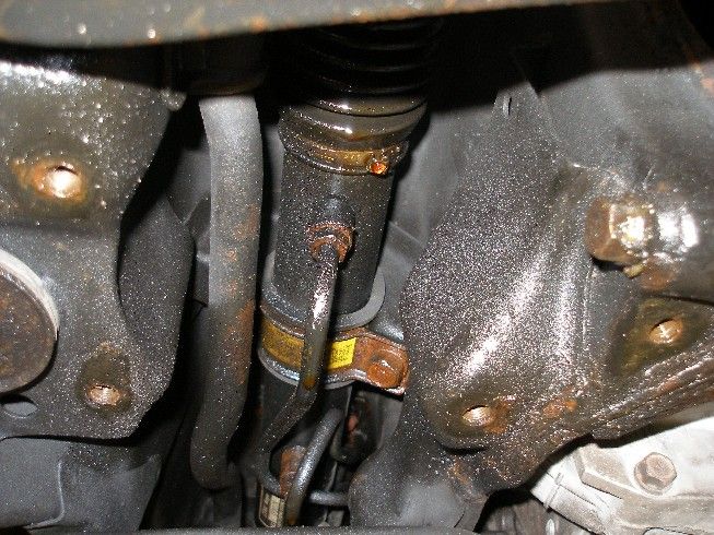

I guess that when I fixed my power steering pump suddenly it was working way better and at the correct psi so it blew out my power steering rack. And I don't mean like a little leak. I went from nothing to all the fluid in one day of spirited driving. So that' getting rebuilt.
And its still leaking at these nuts. Probably going to have to end up getting them just welded in place. Not really wanting to do that but I'm out of idea's. Replaced the orings and just can't get them tight anymore.

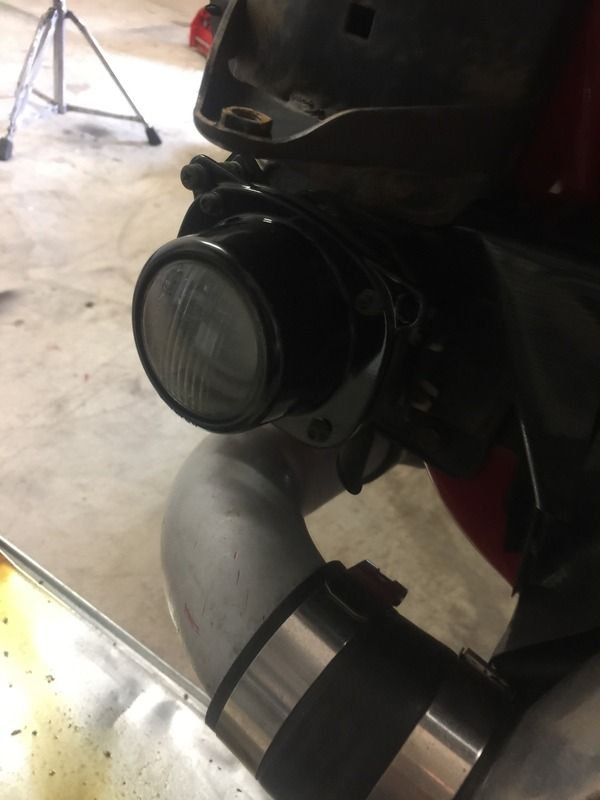

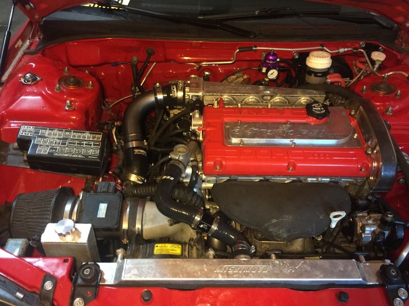

Put in new lights and really cleaned up the fog lights. One thing that really pissed me off was I forgot to get that one IC pipe powder coated. You can't really see it anywhere but it gets on my nerves.
Cleaned the crap up around here. Put on new crush washers all over the place. Liquid high pressure teflon tape on everything to do with the oil lines and fittings on the oil filter housing.

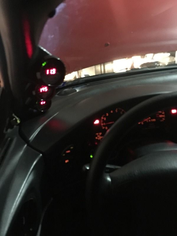

Moved gauges to the pillar. I hate having them here just because they are so obvious, but it was just impractical to have them where the radio was since I plan on putting a double din in soon anyway. Plus the are way better in my line of sight.
Painted the brake calipers front and rear. Rust wasn't really my color so I was happy to get them red. Used the G2 Brake Caliper paint system that some other guys on here recommend. If you use this stuff you better wear gloves, because it doesn't come off at all. Then your bosses think you murdered somebody or beat somebody up. Really weird looks.

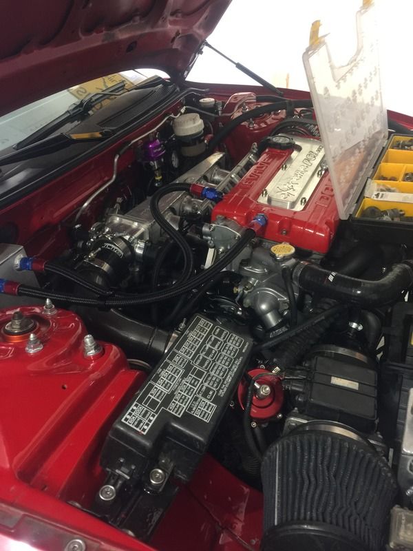

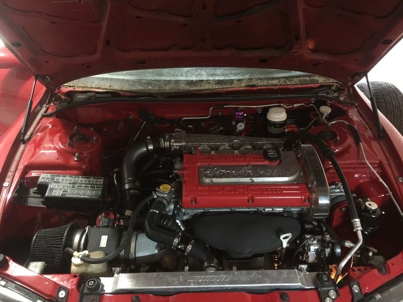

Bay shot. Anybody willing to trade their red / black top FPR for a purple I would be ecstatic.
Went to the Dragon and drove around. Car handles well and has gobs of power. Still working out some tuning, occasionally would knock on and off which was frustrating. If you look close you can see that this was the run where my oil decided to not want to be in the car. Right at the end of the run going around a corner the dummy light came on. Pressure was down to the 20s . Had to trailer back to Houston.

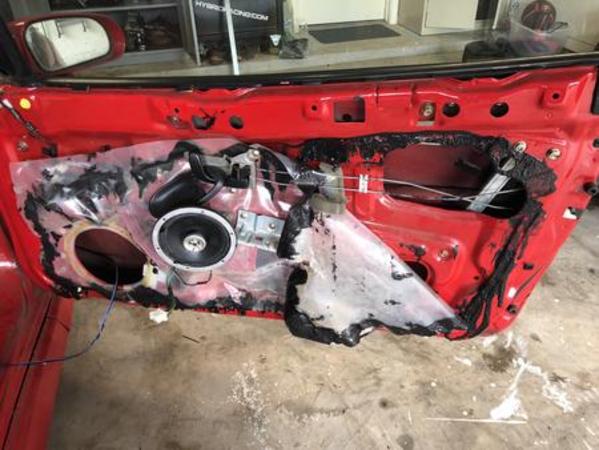

So about six months ago after one summer in the Houston heat the tar on the doors started leaking down. Pretty badly. I needed to get that off. So I collected my "tools"
This was the most effective stuff I could find. This black tar gets absolutely everywhere. It has to be the worst stuff I've ever tried to removed off of anything.
Then down to this. It appears there is still some left up by the handle but I can't for the life of me get any of that off unless I use a wire wheel. Also I added some "sound deadening". After looking around I just decided to try a product called "Frost King" Its actually made to put on ducting but its been proven to lower outside noise by at least 10 dB. Seems to work well enough for me. Easy to put on. Any way lighter than that stock rubber crap on the floors.

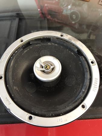

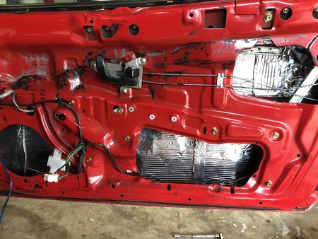

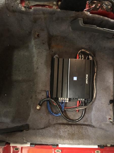

I wonder why my sound has been god awful and really not working in the front speakers. Previous owner said he put in a "banging memphis audio system" months before I bought it. Yeah ... my ass you did.
I also decided to go ahead and "upgrade my sound system". I sold one of my vehicles that had a decent one in it so I just pulled it from that one and put it in this car. Speakers are Kickers, Amp is Alpine, and Head Unit is a Double Din Pioneer that has now been in four different cars that I have owned. To make the back speakers work I had to buy 1.5" spacers and I still had to "massage" (beat with a big f*&king hammer) the upper wheel wells to make them fit. All wiring to the speakers has been re-run and is running solely off that amp. This did finally get rid of my stereo whine which had gotten very bad. Also I need some new carpet. These pictures make it look as bad as it actually is and that is embarrassing.

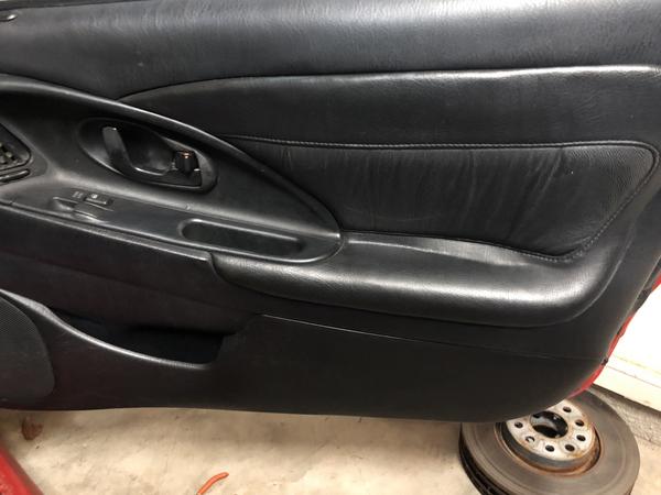

I have never seen these specific leather door inserts on any DSM. I'm not sure if they were custom made / came off another car / or what. But I do like them. They are very cushy. I have since replaced the broken trim piece around the door handle. I also took the time while I was fixing all of this wiring to add a bolt to the door handle rod to take slack out so the doors actually opened for once easily. The passenger had gotten so bad it wouldn't open at all with the outside handle.

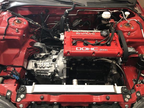

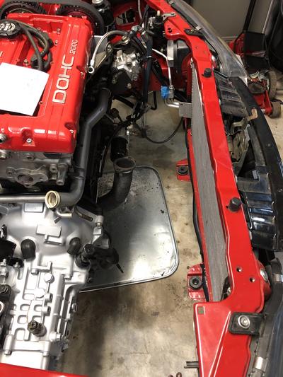

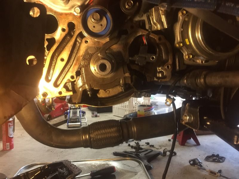

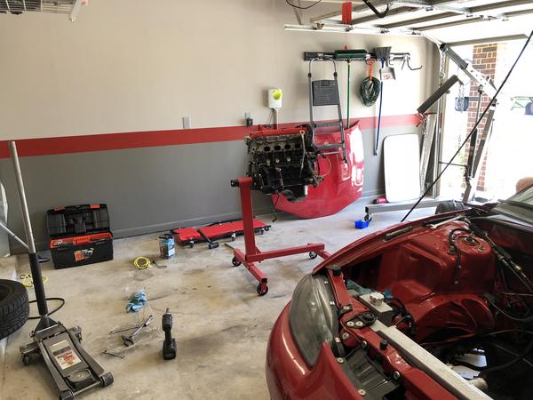

So thanks to build threads like @bettfootball and @NB4G63T , I have decided to redo the engine bay in my car again. The rear main seal is leaking and I'm still having a small leak around the timing side. The timing side is really starting to frustrate me because I have done everything by the book. Anyway the goal is to have basically a full wire tuck and all the parts repainted and freshened up. I will combine from both of these threads to try and create my own. I am keeping A/C and P/S so I will still have the upper lines for right now until I can figure out a way to get rid of those as well. Probably going to take awhile but I already have pulled the engine fixed a bunnnnch and put it back in.

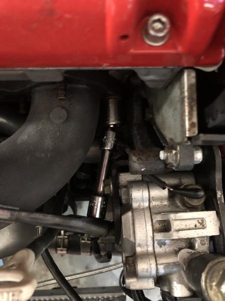

I have to say this is the best tool I've ever bought. Wobble extension. It has changed all my tool owning car working friends lives.

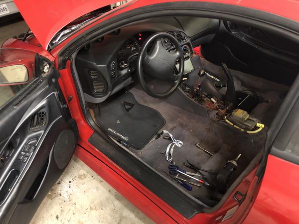

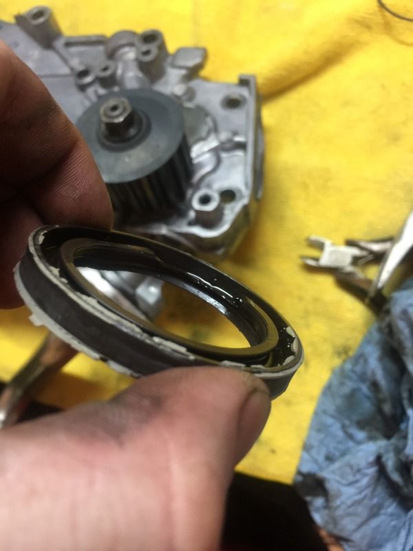

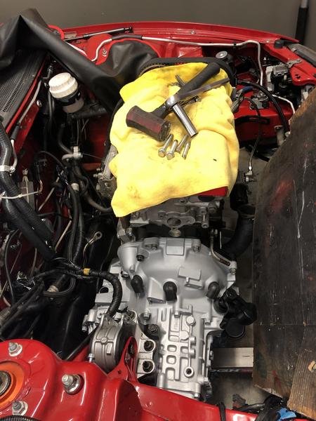

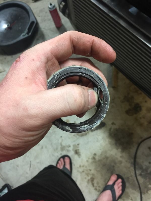

So I started all of this off by just thinking "hey i need to replace the rear main seal that won't be so bad" to "well it will take me three hours to pull the trans why not just take it all out" and in about 4hours this happened:
You see that A/C compressor? Yeah thats 100% garbage. Locked up in 5k miles. Bearing completely fused to the shaft. Its really impressive. I wish I had a bigger TV.

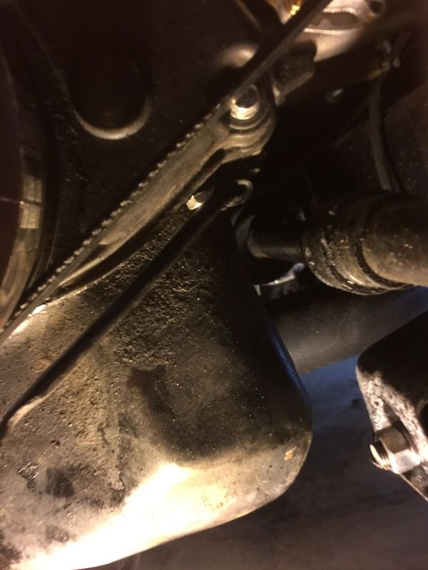

So I'm leaking oil from this side and I just flat can't figure it out. Valve cover gasket is knew and has mitsubond around the corners of the cam gaskets as per recommended. Seals are brand new. There is no oil residue below the these seals. When I removed the motor mount though it had oil behind it. Same with the tensioner. I did go ahead and replace the oil pump seal and rtv the outer edge in place. I also put rtv on the timing belt tensioner for the first time ever per recommendations. Also here you can see my "new" OEM A/C compressor. This was taking off of a perfectly working 98 car with less than 100k miles. I have hopes for it. If it goes out I'll just have it rebuilt before buying chinese junk again. I had to do some major cleaning to get it that clean it was coated. I also painted the metal plates the timing cover attaches to and the motor mount that we will never see. Trying to be more detail oriented.

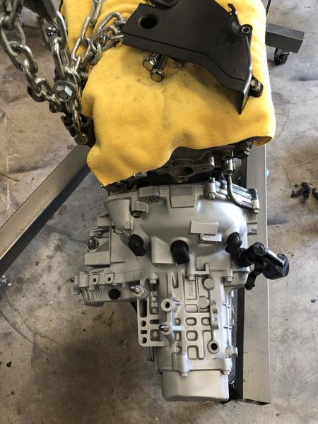

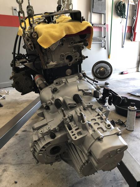

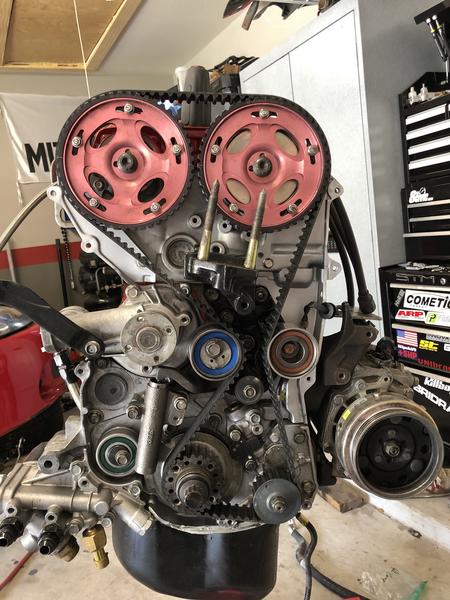

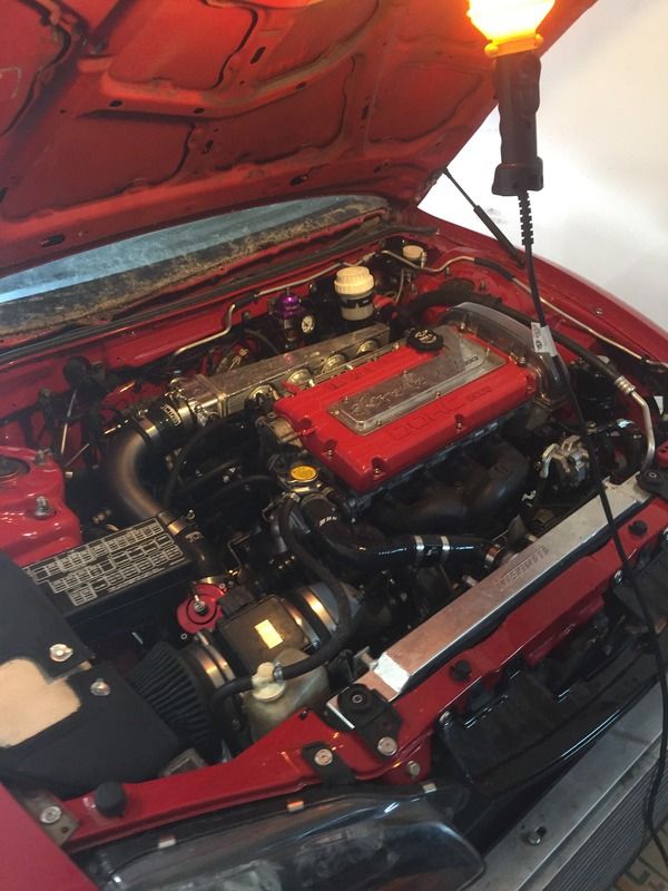

Trans cleaned back up. This was possibly the worst cleanup job I have ever done. This trans has been white, blue, and then silver without any layer before being stripped off. I used a wire wheel on a grinder and then had to go down to smaller and smaller wheels on the drill. Eventually had to use a small flat blade for the small areas. Did the best I could but still a couple spots I just couldn't get off without sand blasting. O well this will do until I can send it off to TRE for a complete rebuild. During the cleanup job the grinder slipped and caught my shin. So that sucked. Many cuss words were said. I used Alumi Blast and you only need one can if anybody else does this. That is plenty for four full coats. Went ahead and painted the linkage (both the one here and the one that bolts on) in High Temp Black Engine Enamel.
And back in the car we go. I wanted to start the wire tuck before this, but then I realized that I need the engine in the car to actually see how long to make the wires. You see all that noise around the firewall? Yeah that is ALLLLLLL about to get cleaned way up.

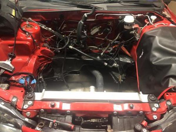

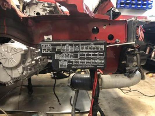

I have been trying to finish things up here. My main goal was to tuck my wiring harness. Similar to how others are starting to install it, I decided to install the main fuse box in the inner fender. I also decided to upgrade all the power lines. I now have a 4ga power wire from the alt to the fuse box and heavy gauge wires from the fuse box to the junction box (and then back to the battery).
Unlike most, I want my creature comforts. Mainly A/C. So this harness still has:
Headlights
Foglights
Fans
AC Press Switch
Alt
P/S (will be removed soon)
Oil Dummy Light

Mounted up where I want it. My brackets are slightly crude but will get trimmed up. Note that you can buy stock aluminum at lowes, but it doesn't bend it shatters in your hand and then you hit yourself in the face. Ask me how I know. Also that grey pipe is the death of me. When I took the pipes in to get PC'd I forget it. You can't see it but I'll be damned if it doesn't annoy me.

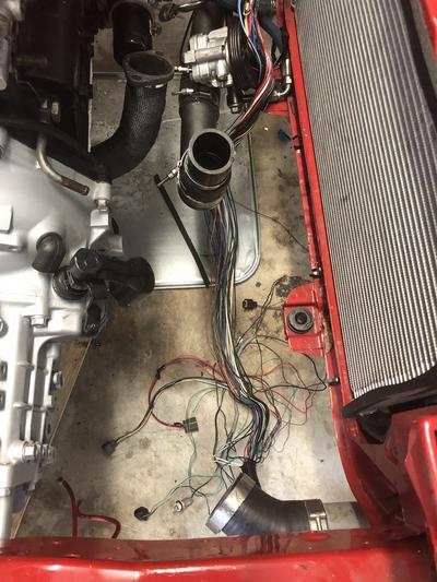

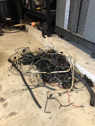

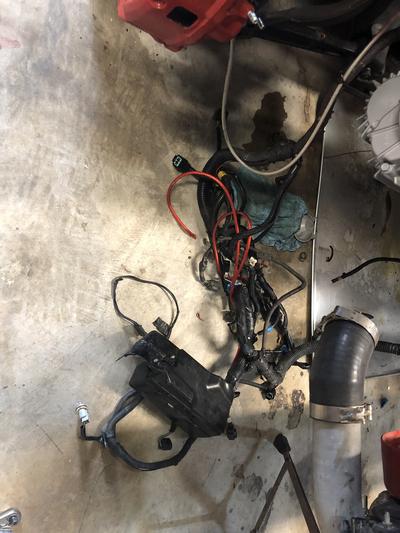

Well lets get started. Laying everything out and ripping loom off.
This is what I was left over with after I cleaned this harness up. Side note: whoever designed this harness is an idiot. There are wires running everywhere. Grounds on the passenger side go to the drivers side and vice versa. It makes no sense. I now have all grounds run to two primary spots. Since nothing is timing based (like digital circuits) the length of the ground doesn't need to be equal length, nor is much consequence. Needless to say, I was able to eliminate a good chunk of grounding wire just by choosing better ground points. Cutting the grounding splices will also make the entire harness just so much easier to work with (untangling, running straight, etc...).
Mostly finished. I chose to just use normal plastic wire loam on the bigger parts that you can't see for this harness. Really because its cheaper and I have boxes sitting around. Most ends that you can see are finished in Mil-Spec with wire shrink ends.

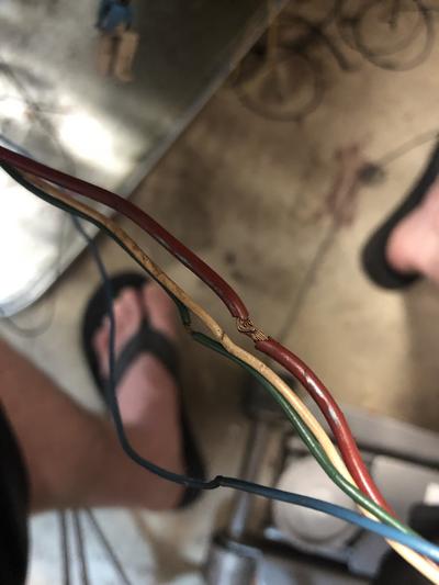

I can't imagine why I was having issues with the charging system. Seriously though these harness are getting old and brittle anywhere they are exposed to higher heat. This is going to become an all to common occurrence soon.
