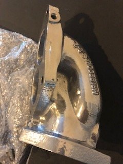

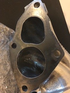

Over the winter I pulled the radiator, turbo and O2 housing. I sent the O2 housing out to get ported and ceramic coated by Boosted Performance:

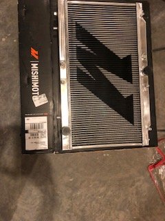

The stock radiator was in decent shape but I upgraded to a Mishimoto unit:

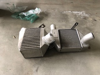

I also managed to acquire a Hahn SMIC:

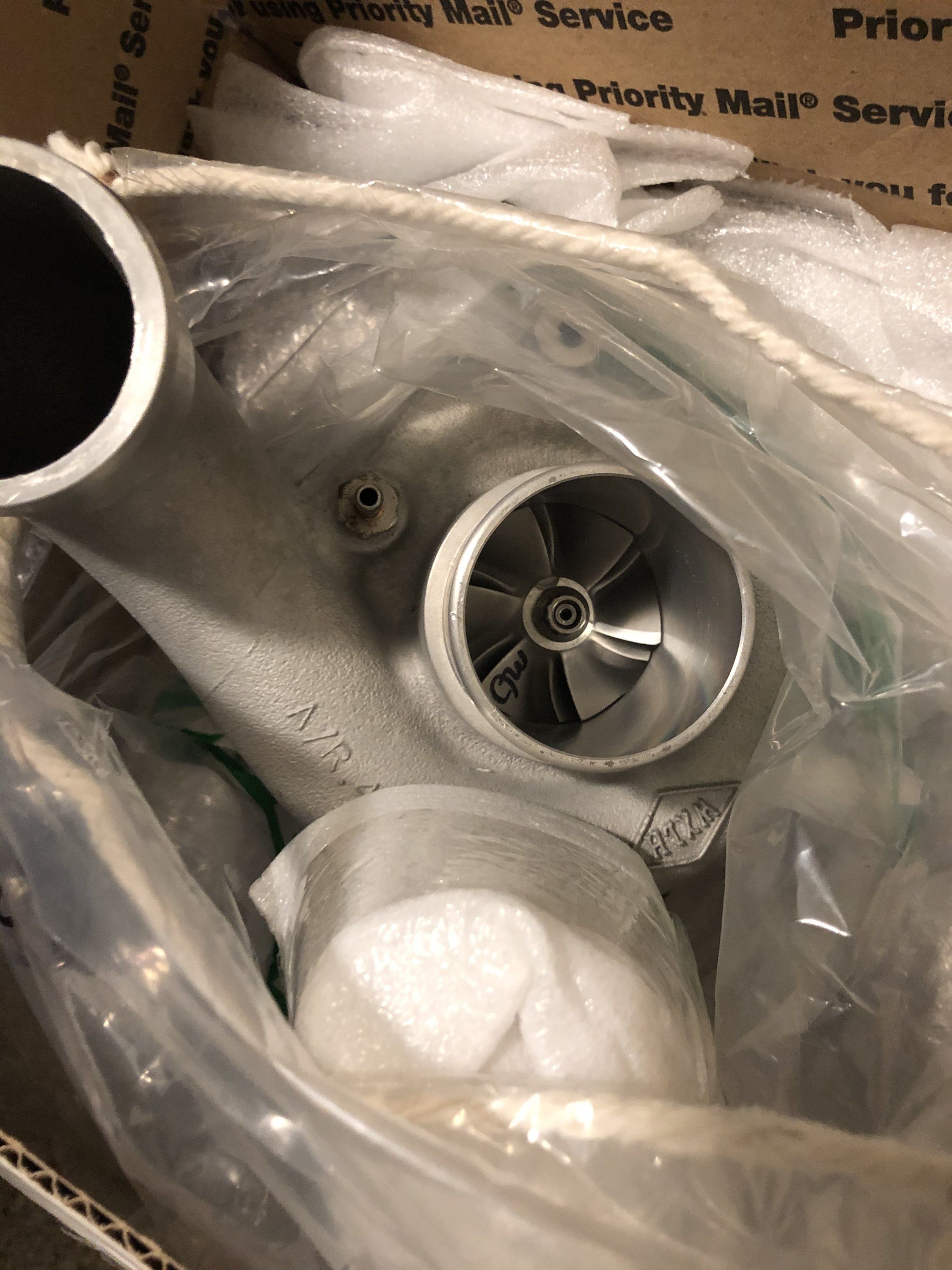

This is overkill for a stock T25 turbo but I had the itch to turn wrenches through the winter and spring. With the exception of the radiator, I've kept all stock parts!

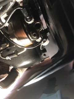

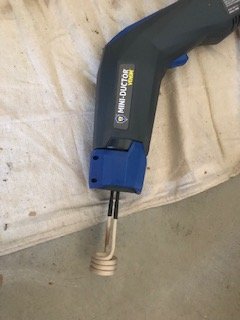

While putting everything back together, I found the stock oil feed line to be a hug PITA. It snapped while trying to line up so I picked up a flexible feed line with 0.075" restrictor. The only thing that proved to be a bigger pain than the oil feed line was the connection into the OFH. I tried a ton of PB Blaster but that thing was not moving. I used an induction coil for about 12 seconds and the connection came right out:

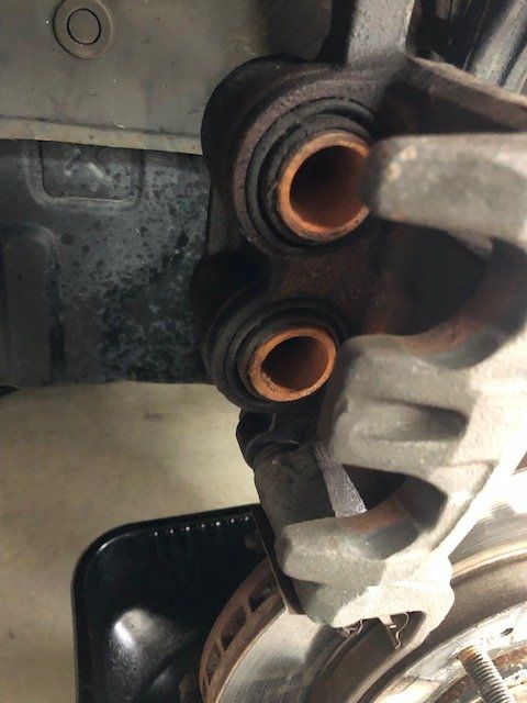

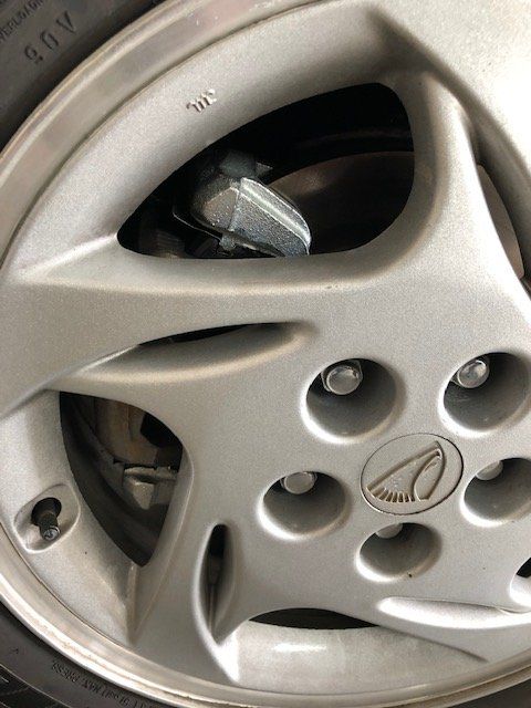

My brakes always felt a little squishy and I originally had purchased new rotors and pads but my calipers were looking pretty crappy:

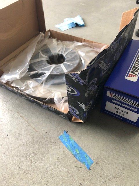

I considered rebuilding them but I didn't have access to compressed air so I just purchased remanufactured calipers all around. With new calipers in hand, I paired them up with centric blank rotors and porterfield R4-S pads:
While doing the brakes, it was a perfect time to do the Outlander upgrade:

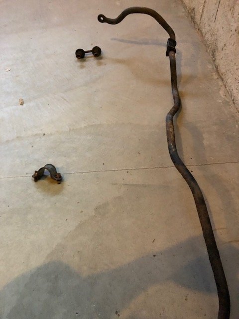

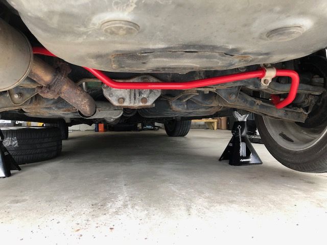

My stock rear sway bar and end links have seen better days:
I keep all (or most I should say) stock parts so I'll clean up the RSB and have powdercoated and then store it with the other stock parts. I got in on the group buy for a new RM RSB:

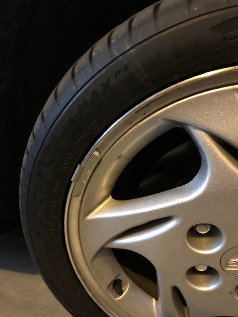

Minor update: the old tires got tossed in favor of General g-max rs
New tires, new brakes, and a thicker rear sway bar..might have to give the dsm a spin at autocrossing.

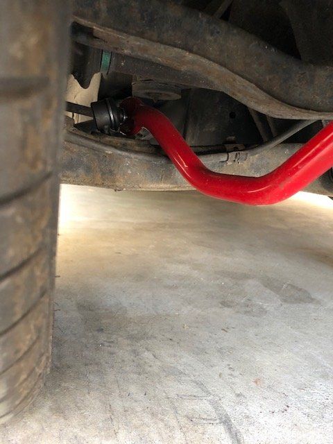

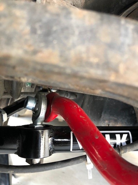

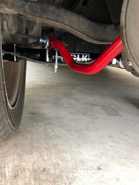

Ever since installing the RM rear sway bar, I've had issues with the bar physically hitting the rear lower control arms (with the car in motion). Not sure if anyone else had this issue and it's a little difficult to see via pics but this is what I had been dealing with for almost a year:
I got tired of hearing the bar hit the control arms while driving so I upgraded to Volk rear lca's:
Installation complete. Much better:
Much better but now that I think about it, I probably should have ordered the toe arms and done those at the same time. Lesson learned. Maybe.

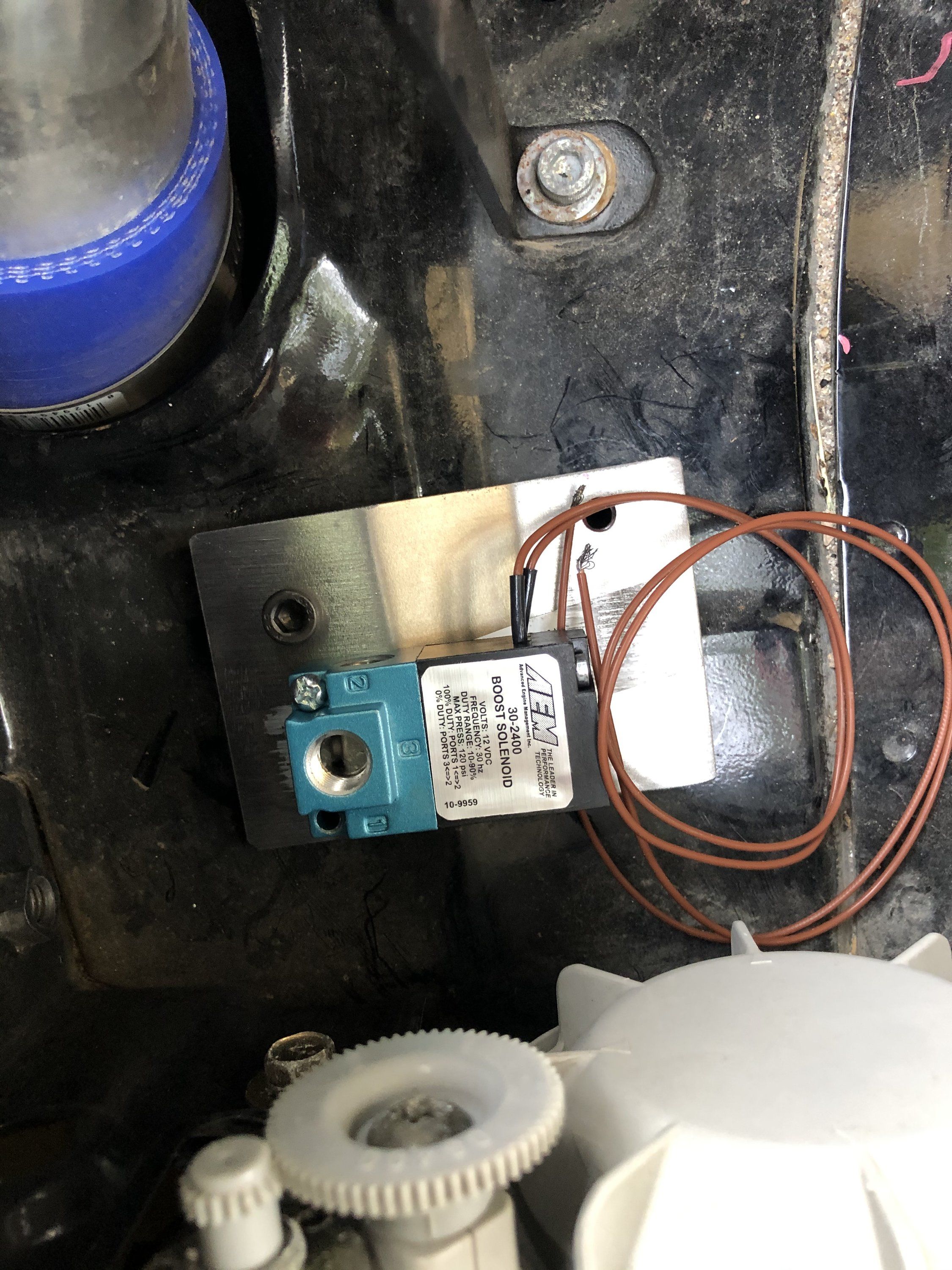

Not having an actual boost gauge always bothers me so I picked up an AEM Tru-boost. Fabricated a bracket and used existing bolt holes next to the intake to test fit the solenoid. I’ll probably flip the solenoid around but I’m happy with the location and mock up.

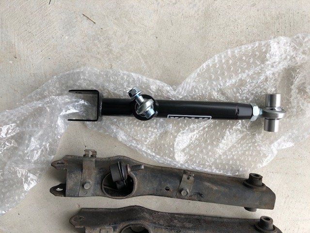

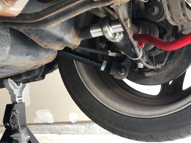

"Minor" Update 6/17/2020:
Volk trailing arms were installed a few weeks back. Checked the torque on the rear lca's and put a fresh coat of oil on both arms. I had to reuse the nuts on the knuckle side, as I could not locate new stock ones:
Driver side trailing arm behind the lower control arm:

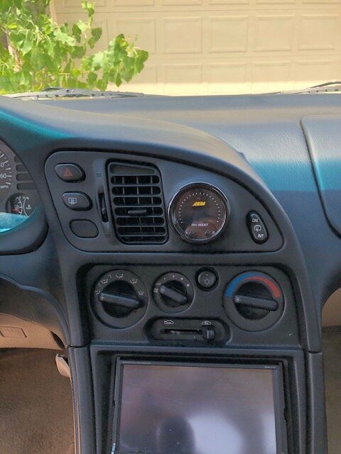

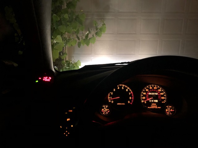

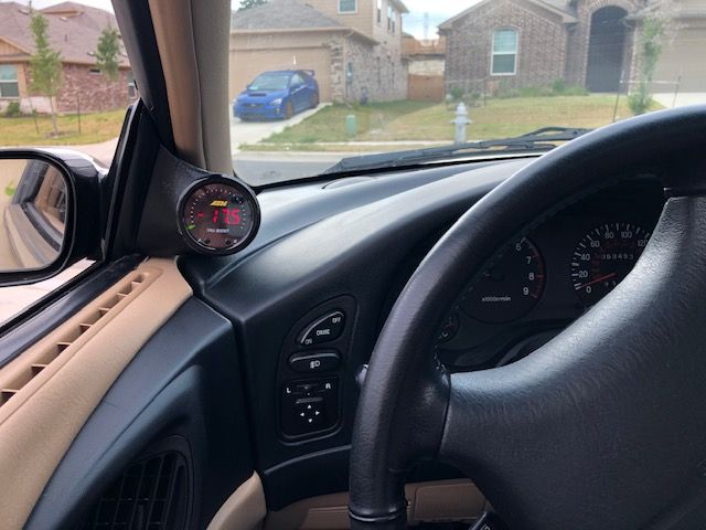

I really wanted a boost gauge that would actually indicate boost and tonight was the trail run for the AEM Tru Boost X gauge/boost controller:
The tiny T25 is peaking right where it should--at about 12.5 psi. I really like the gauge pod from @Kai Hefner but I think I will eventually use it for a different gauge. Running wires (2 sets of electrical wires and a vacuum hose) for the gauge and the boost controller does not allow for a clean install through the weather stripping. Most likely I'll get a pod for one of the center vents and reserve the door pod for a future Wideband. Still a very impressive 3D produced part, so maybe he'll make more custom parts!

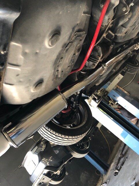

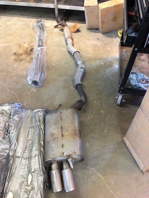

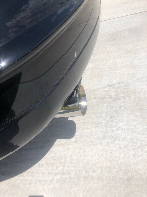

This morning I was able to get the car on a lift for a stock exhaust replacement:
Out with the old, in with the new...
First impressions are mixed...I do like the deeper bass from the Thermal and it's a beautiful looking exhaust. But it's too loud IMO. Maybe I'm approaching "get off my lawn" stage at the ripe old age of 40 but I will most likely have a shop weld in a resonator when I add a catted downpipe. I'll gladly settle for a bit of restriction to attain decibel reduction.
I also moved the boost gauge to the center vent area. With the gauge and BCS wires, it was too much to try and fit through the weather stripping on the side mirror pod. I'll save that one for a different gauge.
