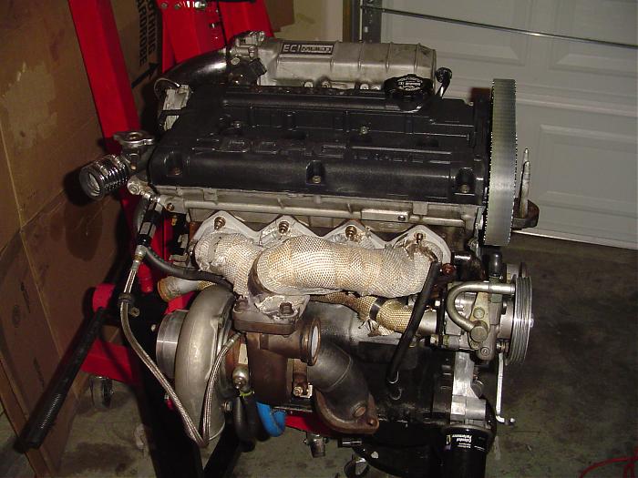

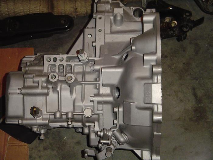

Also during this time I was rebuilding the motor from the blue Talon as a (hopefully never needed) spare. I decided to mate the fresh motor to the old rally transmission. I cut the roll cage in 4 pieces and reinstalled it into the black shell. The DMS suspension, rally computer, intercom, seats, belts, anything salvageable went into the new car. Stripped down to its shell, the old red rally car got winched on to the trailer and left for the crusher. :cry:
