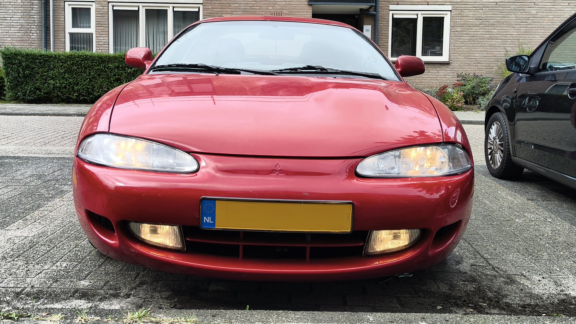

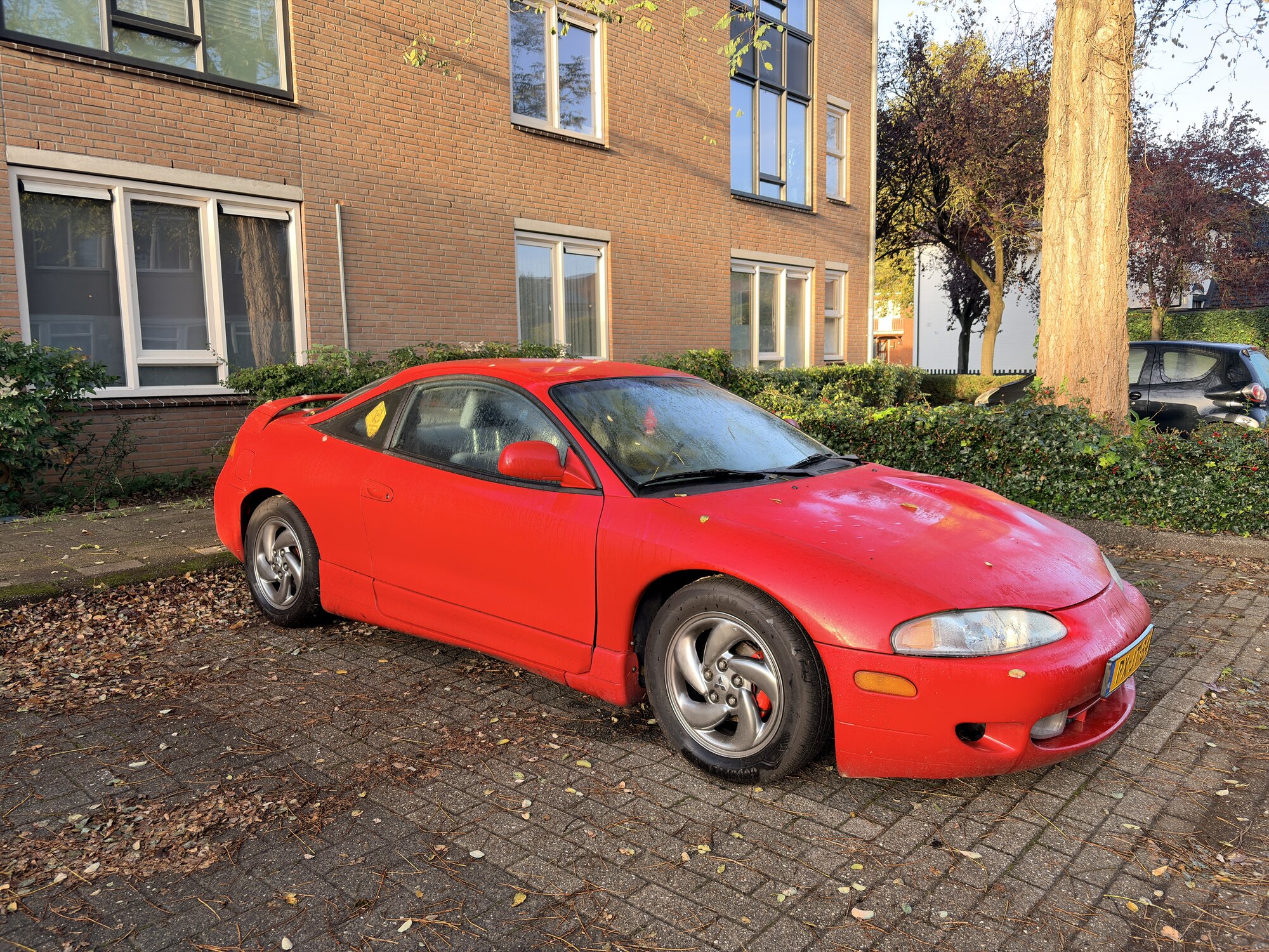

Street Build My first - very imperfect - car
A gorgeous european Mitsubishi GS, with a 4g63 NT under the hood.

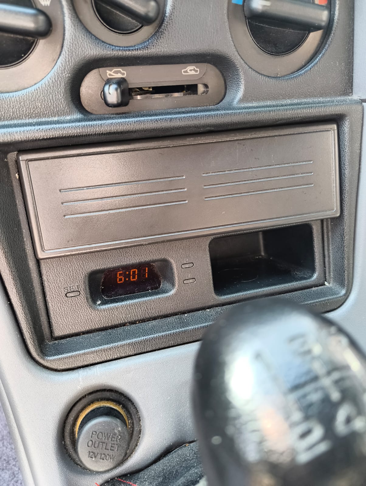

4. The little clock under the radio seems to be unplugged, or at least, it doesn't work. Fixed in #3!

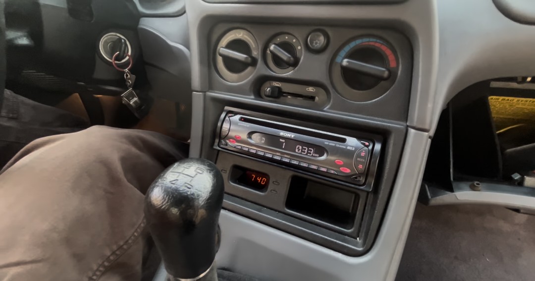

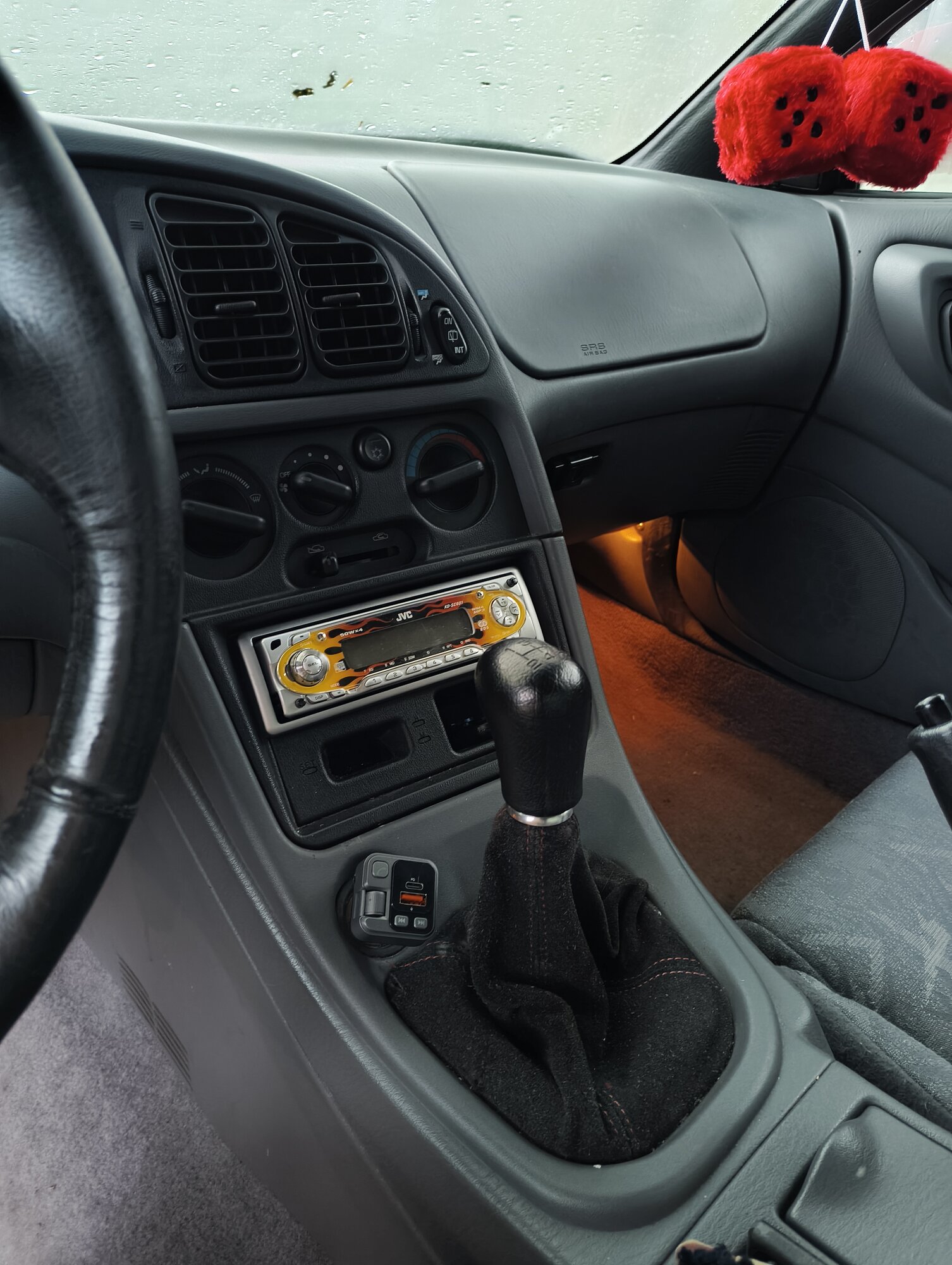

Putting in a radio

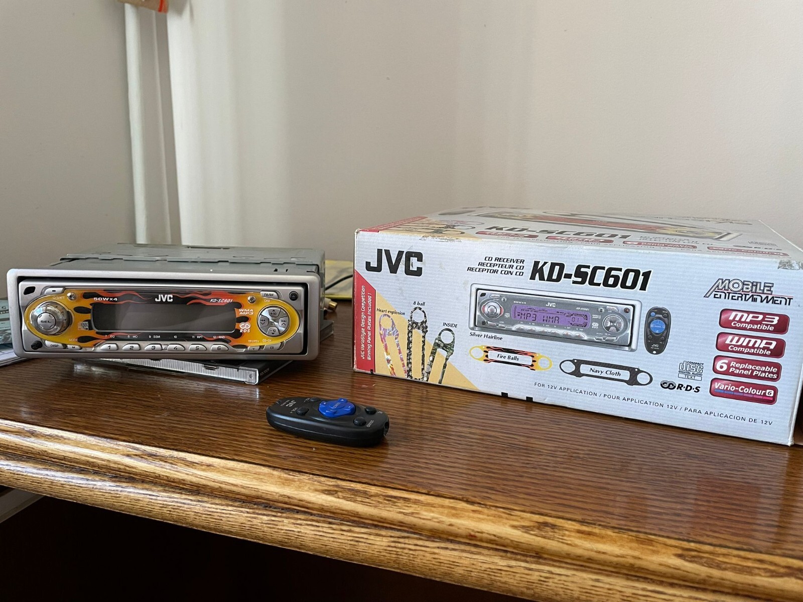

So as promised, one of the first things I needed to do was put in a radio, because I couldn't stand not listening to tunes when driving this beauty.
I got an old radio/cd player off of marketplace for €10 and then spent another €20 on the cables I needed to plug it in :ohdamn:, but it works! Or well, halfway. Sadly this revealed four more issues with the car:
1. Only the door and front speakers work, no sound from the rear
2. Power antenna will not raise
3. I have a mystery cable behind my radio that might be related to not having sound from the rear speakers / it connects to the seat ejectors
4. In trying to get my seat more comfortable, I figured out none of the adjustment options work. I guess I'll have to take the whole chair out to see what's wrong with it.
This weekend me and my buddy will work on fixing the ABS, SRS, and speakers. The first two using some kind of obscure trick I learnt from German forums, which taught me you can short the first pin on the OBD sensor, and like Christmas the dash lights spell out the error codes in morse. I'm looking forward to it!
Big day of doing a whole bunch of stuff / I found out why there is no sound from the rear speakers...
Today me and a buddy took to doing a whole bunch of stuff to see if we could put her in a little bit of a better condition, and to see if we could diag some of the issues. We ripped the airbags out, but they seem to be just fine, so probably the ECU has to be reset / replaced, but at least that sounds like an easy fix.

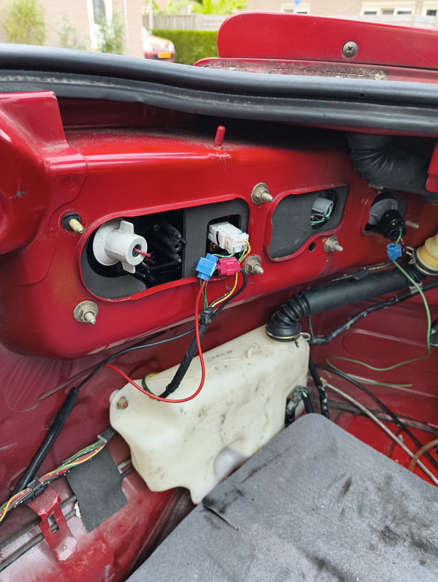

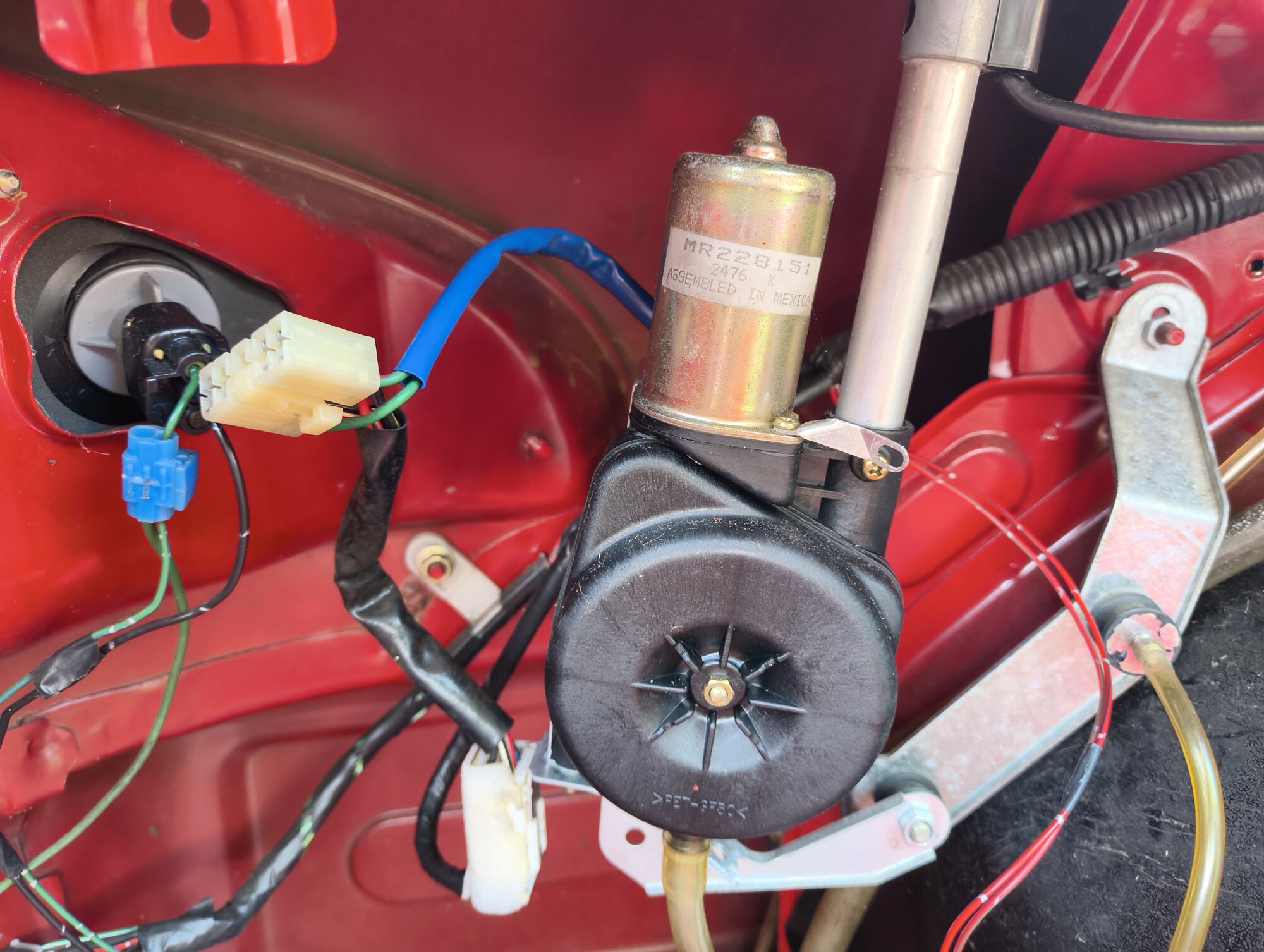

The power antenna doesn't work, and the trunk is filled with more loose wires than connected ones, so I will have to take a deep hard look at where they should be going. For example, it looks like my antenna should be plugged in to something, but I could not find any logical place to do so, so it's just floating around right now.
We didn't get around to checking the ABS codes, (if it is even possible), so that will have to come later.
We also ripped out the driver's side seat so we could take a look at fixing the seat adjustment knobs, but they seem rusted to shit, and we only could get them to move with a ton of force. Another thing that will have to be finished later.

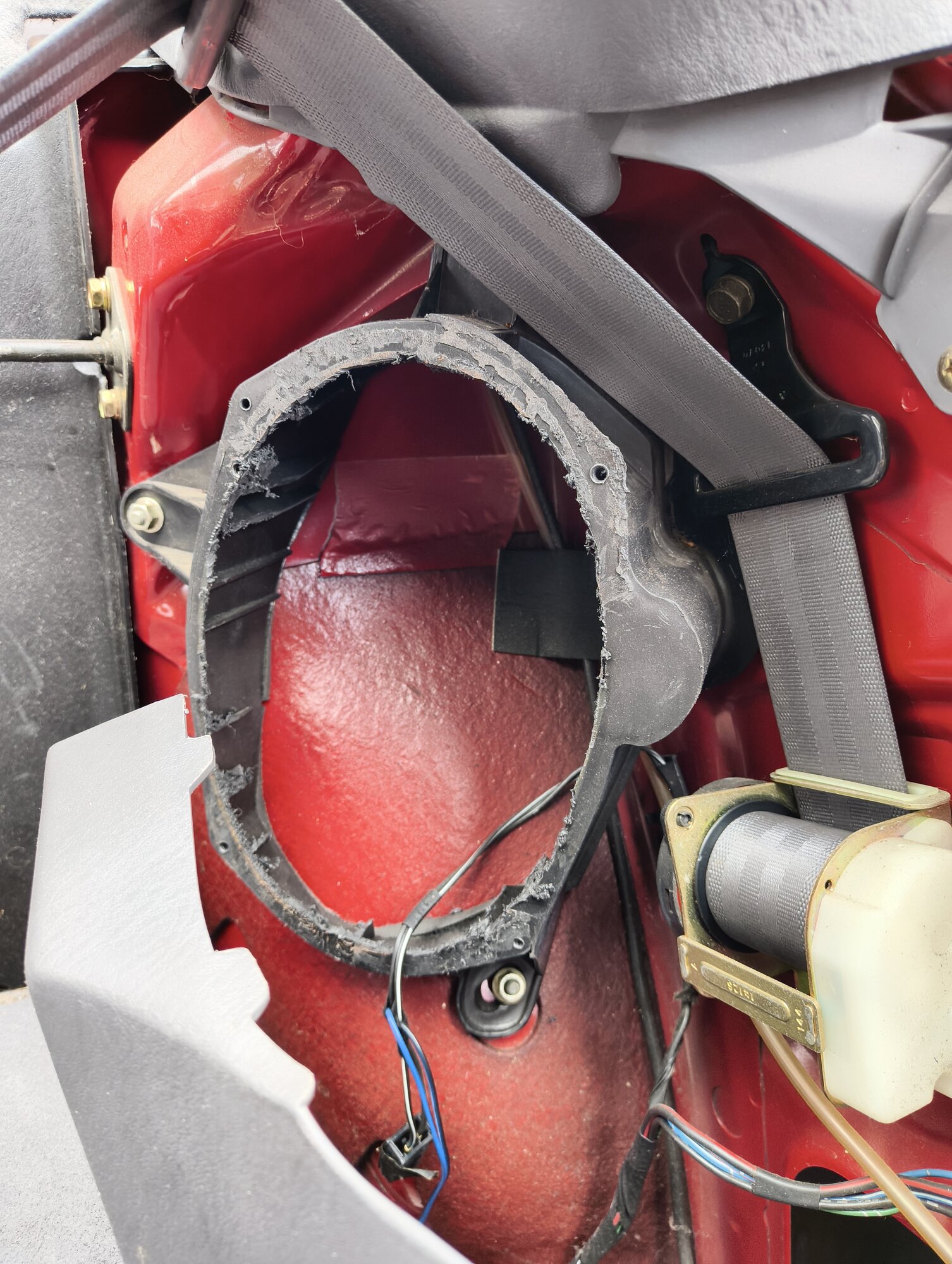

Now - for the rear speakers, apparently, the reason as to why I didn't have any sound, is because I DON'T HAVE REAR SPEAKERS. I guess the last owner took them out because they were really nice, or something? Either way, that it luckily too an easy fix, just gotta replace them. Feel free to recommend some nice ones that don't break the bank!

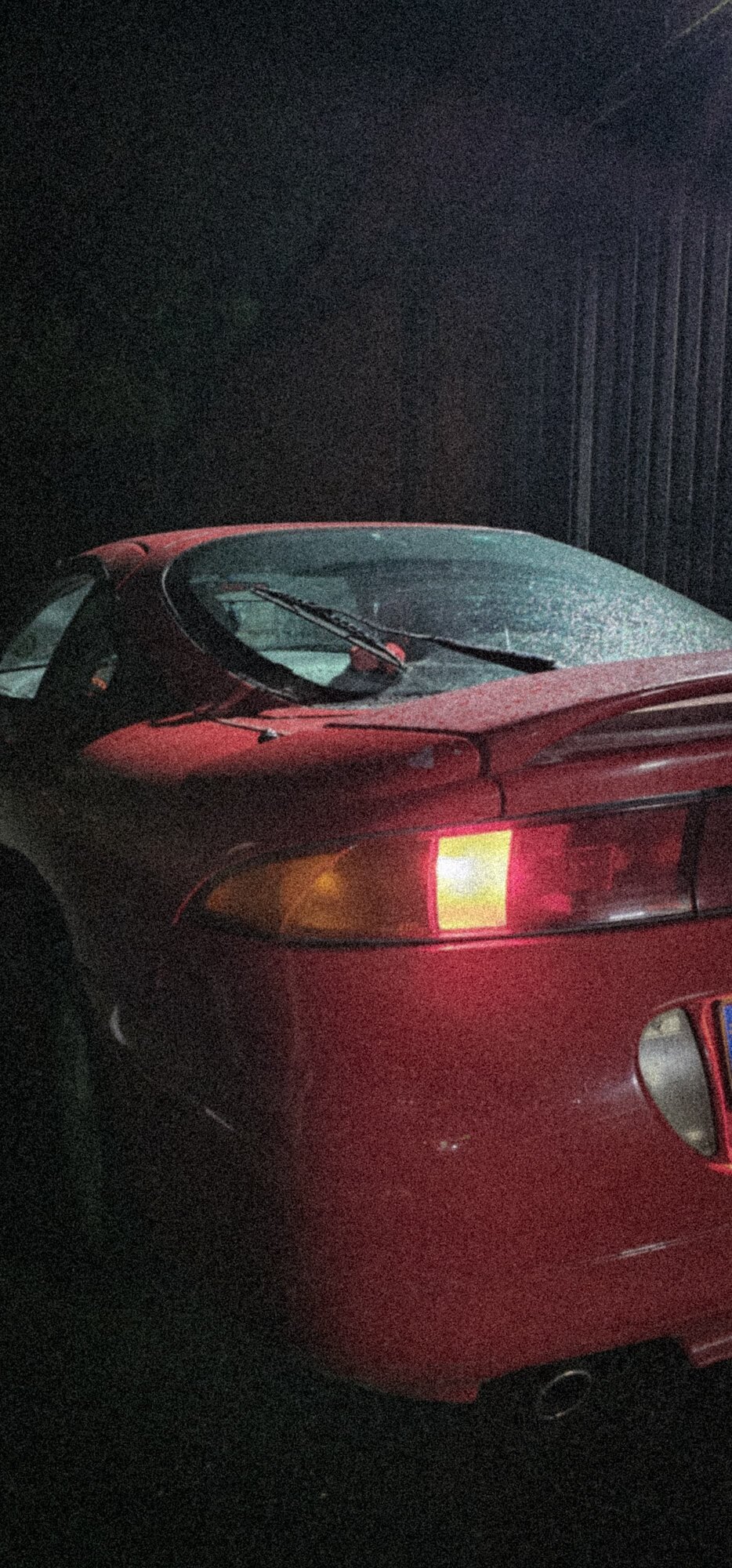

As for actual progress: We replaced the dead battery (ourselves, real mechanic shit), and topped off the windshield wiper fluid. Realistically, we needed this day to get a feel for what is wrong with the car, so I'm still more than satisfied with our progress. It'll be more than a couple months before I can really drive her a lot, anyways!

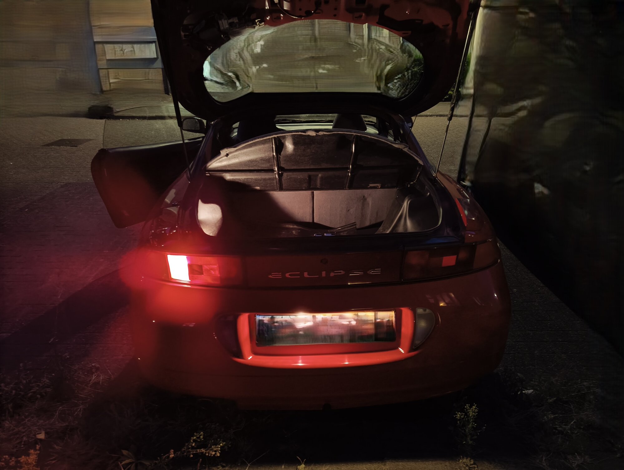

Oh and finally, from looking around in the trunk as to why the power antenna isn't working, I accidentally knocked a cable a bit loose making my brake lights not work too well no more. whoops.
Just a tiny little update: I have rear speakers now! I'm making a list of parts that I still need, and I found a dealer that will actually be able to read my ABS / SRS codes and hopefully clear them, so we're making good progress! I also met a community of people with DSM's in my country, and they've been real nice and helpful. Someone says they might have a rear spoiler for me that isn't f***ed up, and otherwise, I'll spray mine along with the replacement rear trunk that I have, and she will look a whole lot better. Also been eyeing about 30 different rims, now I just have to select a set.

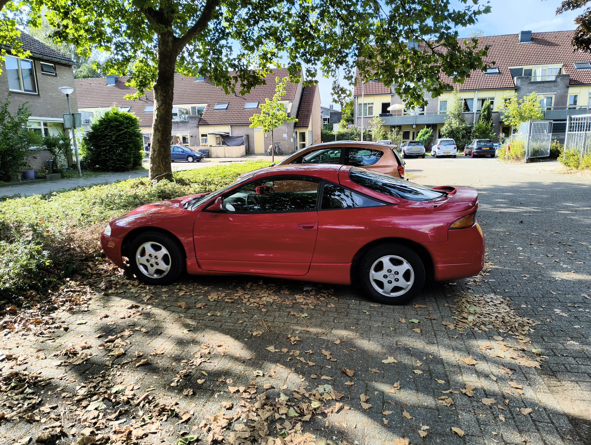

A very productive weekend
Last weekend was great, I went to the dealership to reset my SRS codes, and lo and behold, no more light! I'm glad that I can now somewhat more safely go 200kph on the Autobahn. Dealer also said that the ABS 'stuurapparaat' was broken, which is dutch for either pump or ECU... The dealer said I need a new pump, anyways. I found some for roughly 70 EUR, so I will order a new one and try to put it in myself.
I also picked up my new spoiler, the guy who gave it to me is cool and owns two dsm's of his own. We drove around a bit, took some pictures that are much better, than what I had, and then cleaned up the headlights so that they actually show something now.

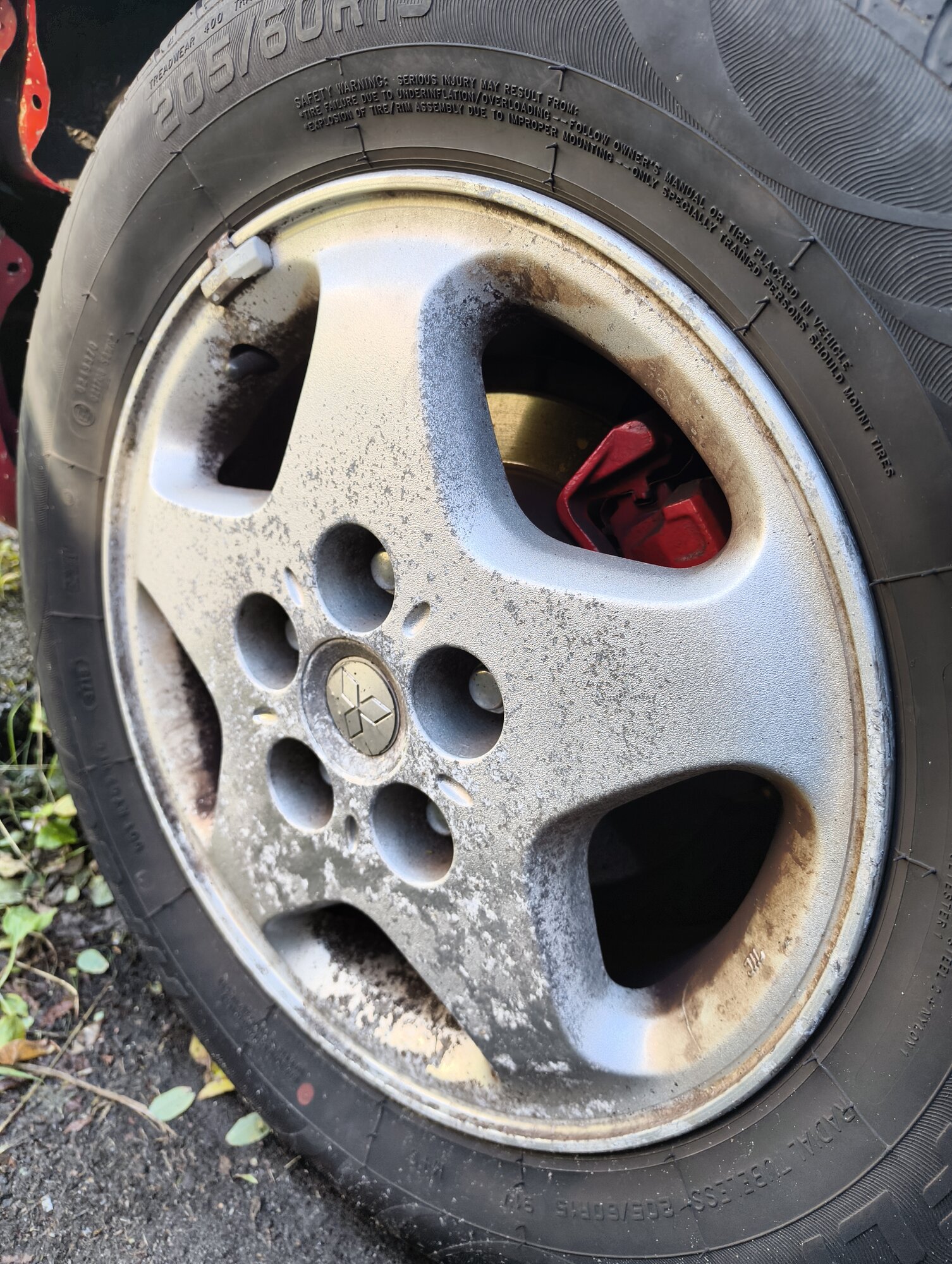

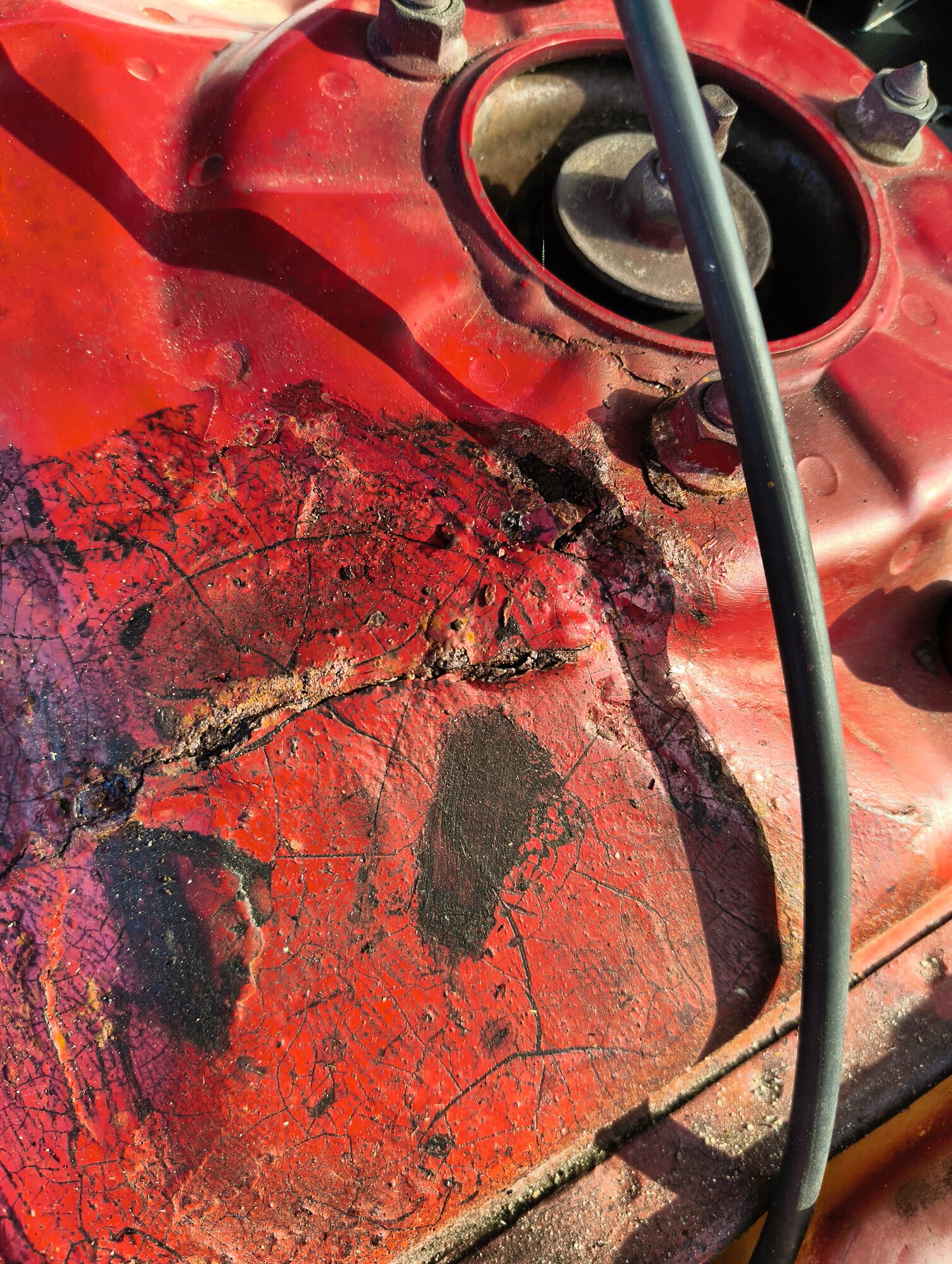

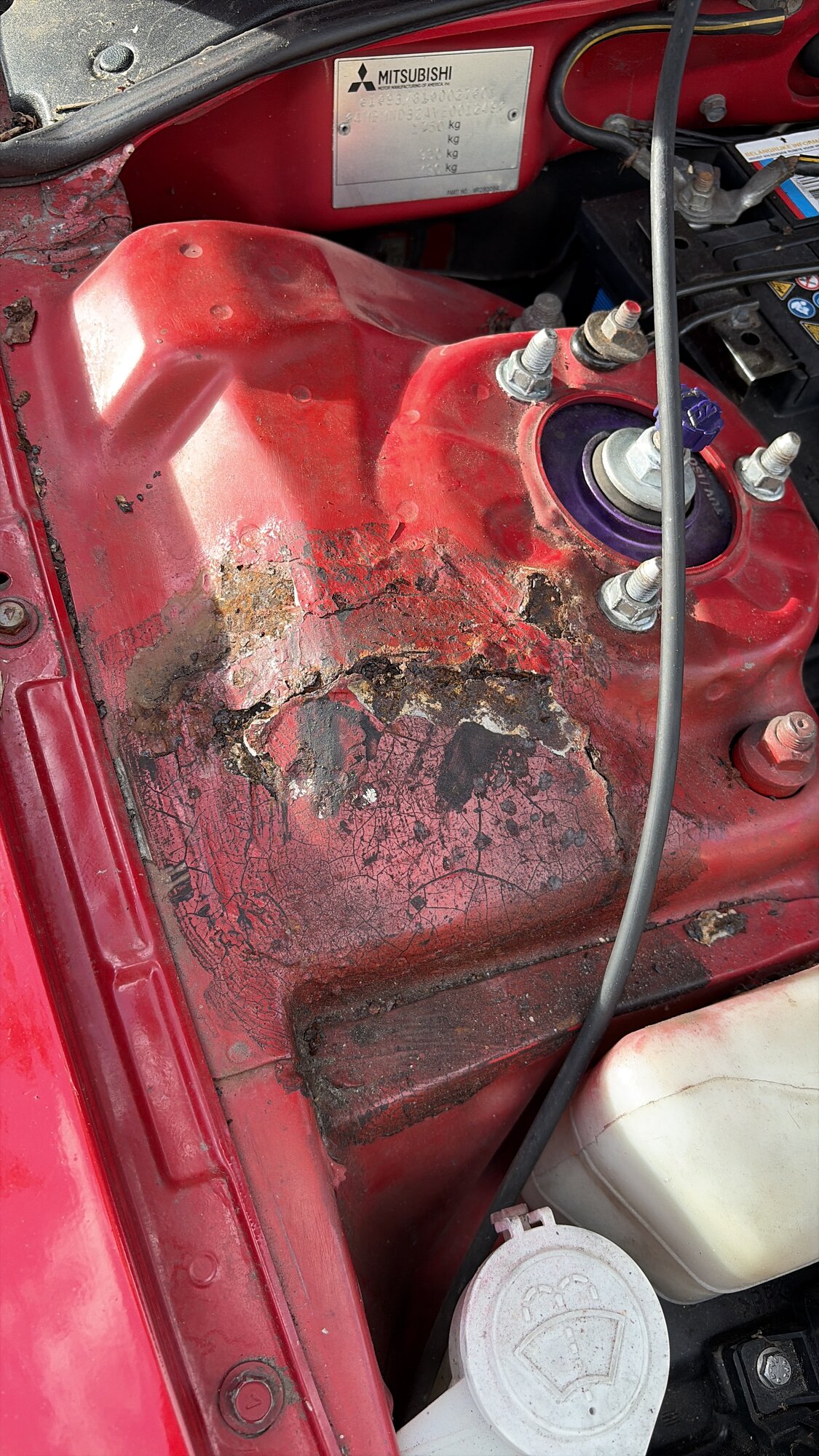

Now on to the bad news - I have strut tower rust, I've had it for a while, but it didn't look godawful so I was blissfully ignoring it. It still feels very solid and the previous owner obviously did something to repair it, but it still needs work. I'm taking it to a body shop this friday to a get a quote and to see if they can fix it. I'm not expecting it to be cheap, but that's OK. I have about a 8K budget for the whole car, and we barely went over 4K so far, so I just have to make sure that it's done very well, and then I'll be a very happy DSM owner.
Oh, and I was also thinking of changing my rims, but they have kind of grown on me. I'm going to see if I can replace the center cap with a Mitsu logo that is actually red, and try my damned best to restore the wheels to a better condition.

you can check on (its IN or ON the correct tense? im from argentina) rockauto or maybe in amayama, they ship worldwide, you can find oem and alternative parts.
about the wheels you can sand them and then paint them with a removable spray paint, and take your time to find the best fit for you, no hurry.
the strut tower is the first thing you should repair (as you said) and it may use most part of your budget.
Local repairman quoted me 2.5K for the strut tower + wheel well repairs, so not too bad actually. Either way, I'm content. Beginning of October it will go through testing, so let's see if the government thinks it's safe to drive on the road (spoiler alert, it is). Also got a new rear wiper fluid tank, fog lights, and all the parts needed to get my power antenna working again! I know most people really don't care about that kind of stuff, but I love all the tiny features on cars like this.

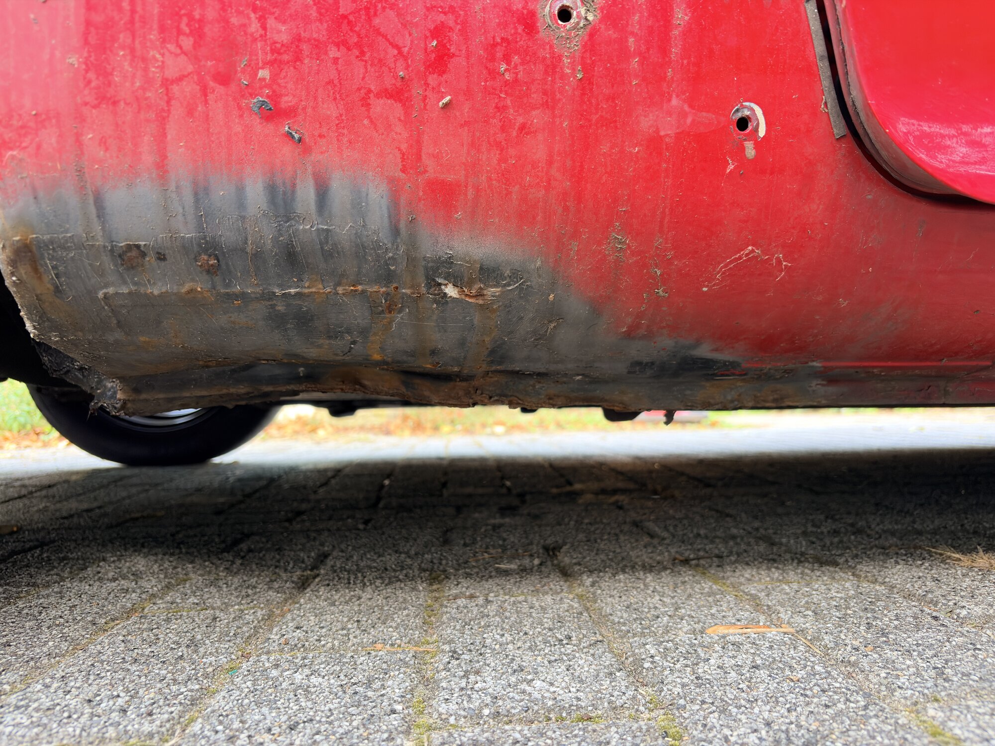

f***ing MOT
Got the MOT check today, it passed, but not after paying ±700 EUR for rust repairs, etc. Definitely not the cheapest car I could've bought, but that's life. Got a new power antenna relay too, and will install that along with the spoiler this weekend or coming monday.

- Installed the working power antenna

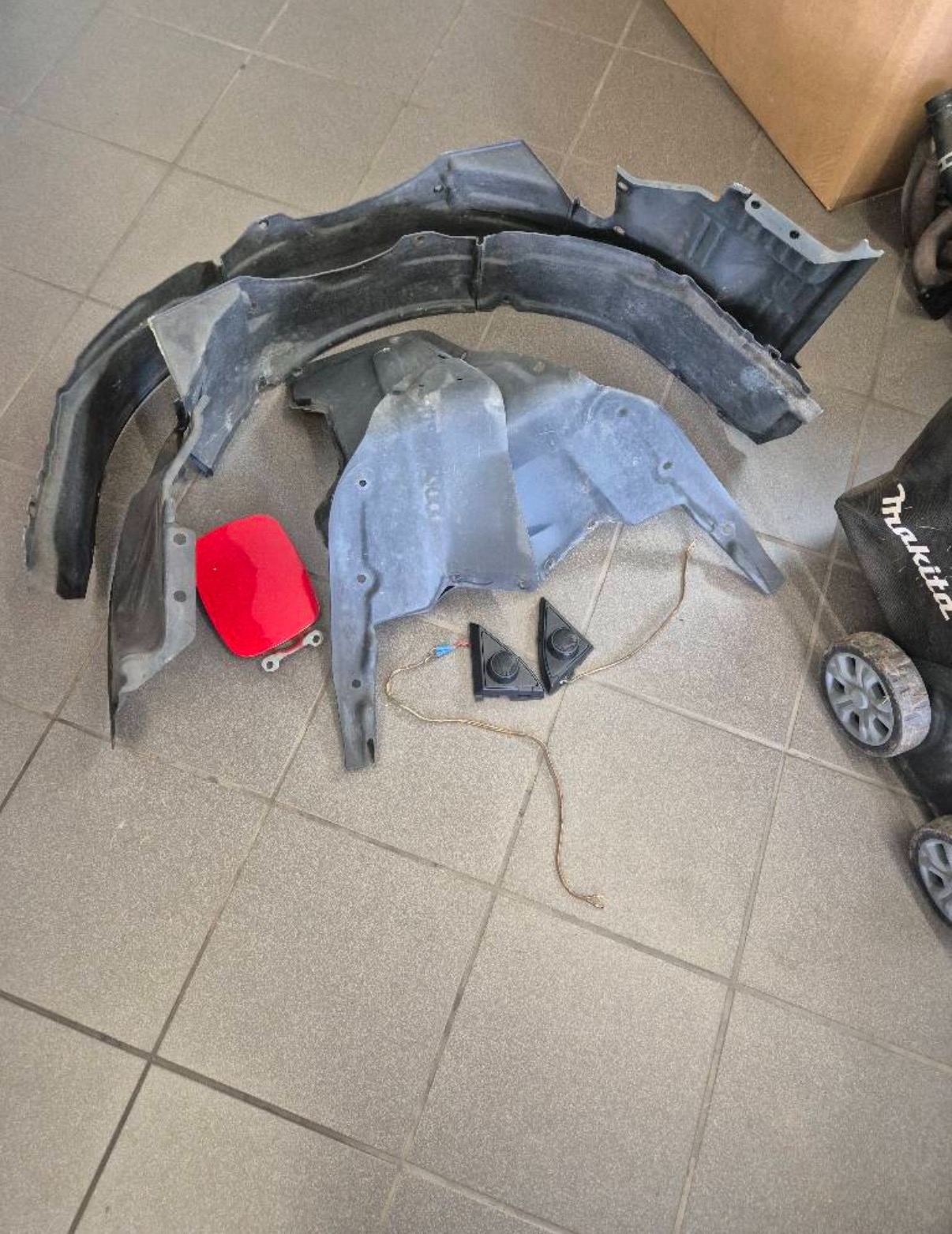

It's been a long while I have posted here, but I have done a bunch of work on the car - and a bunch more has broken. I came back from a holiday to find that I can't shift into gear anymore - one of the clutch cylinders has gone and there is 0 fluid, so at least I know why it didn't work. In the mean time, I bought a bunch of stuff:

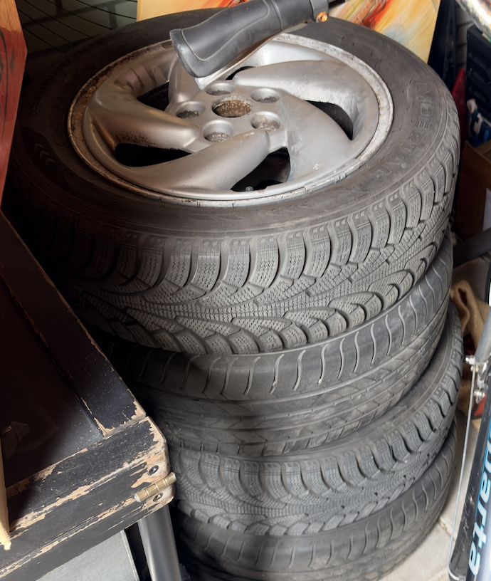

Original GS-T rims! I always loved seeing these rims but never thought I'd be able to buy any as the only ones available online go for ridiculous prices, and DSM parts are very scarce here. Once I clean them up I'll put some new tires on there and swap them out.

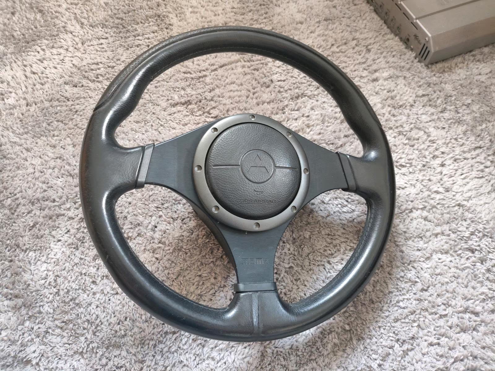

Evo steering wheel with bracket and airbag adapter;
A new non-dented gas cap, wheel liners, and some funky speakers for the inside of the mirrors that I want to use for an electronics project later;
