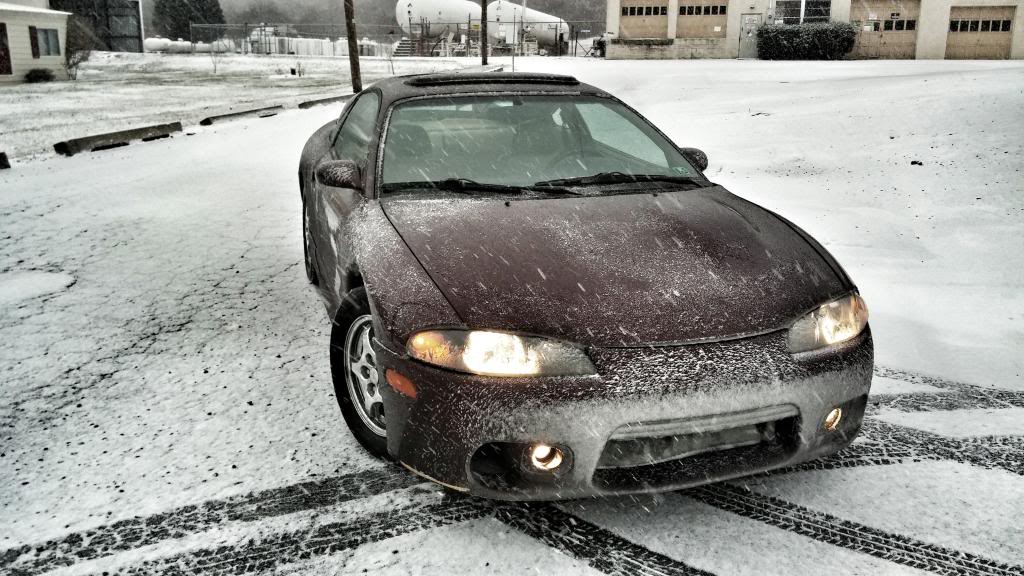

Well, I decided I should start a journal on my current dsm, a 98 barcelona red pearl metallic gst.

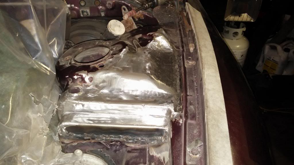

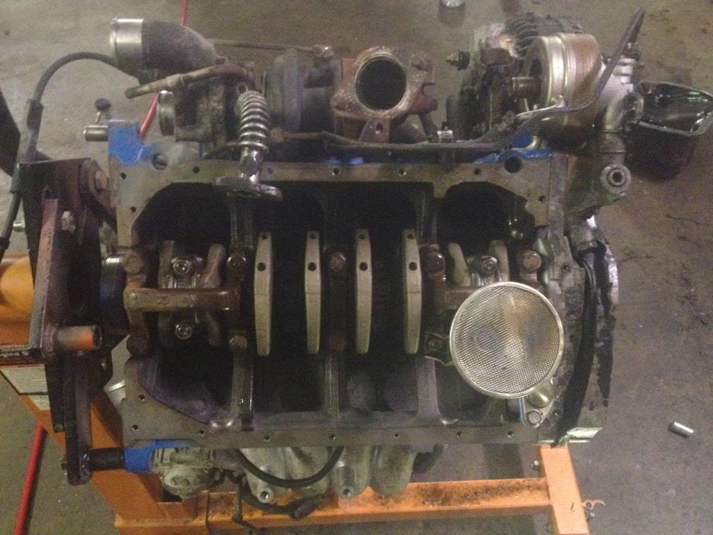

Brief history: I purchased the car with a friend of mine for $400 total, back in october. I laid out $250 and he gave me 200. We got the car so cheap because it had a locked up motor and very bad strut tower rot. I had a newly rebuilt 6 bolt block with n/a pistons that I was going to swap in and flip the car quick.

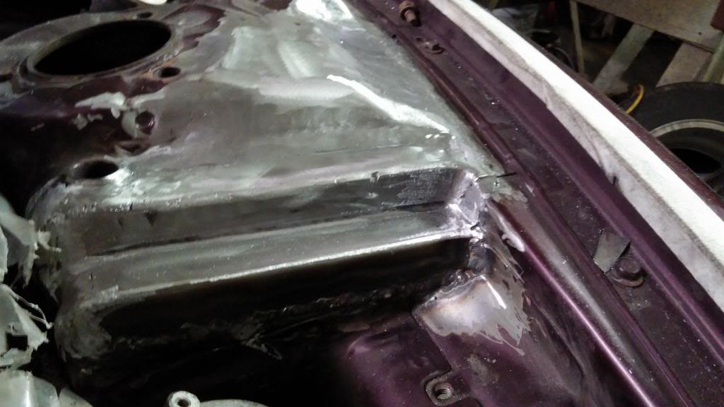

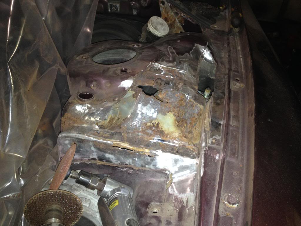

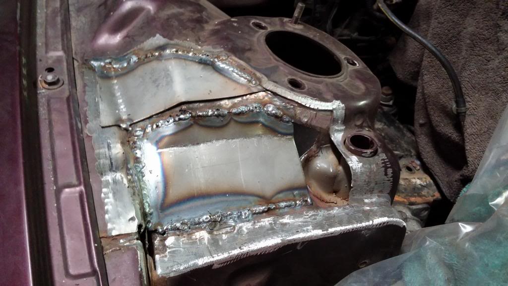

I got to work assembling the 6 bolt, my friend paid for the gaskets since I was supplying the motor. I got the motor put together, swapped it in the car and made sure it ran good. My father in law wound up fixing the strut tower rot, being my friend dipped on his promise to do it. he used 16 gauge steel and did an outstanding job rebuilding the towers. I wound up driving the car for a couple weeks making sure everything was good with the car before i put it up for sale. I had a change of heart and decided to keep the car, and gave my friend a holset turbo to repay his part of the deal.

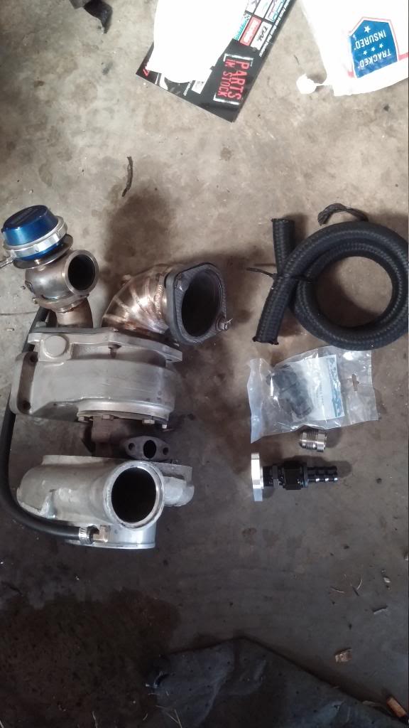

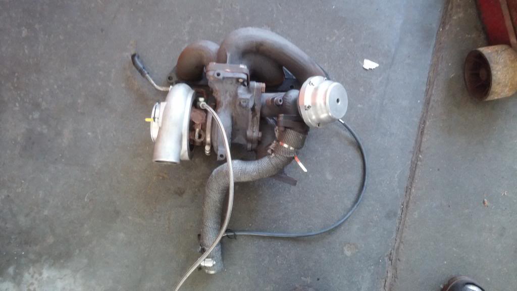

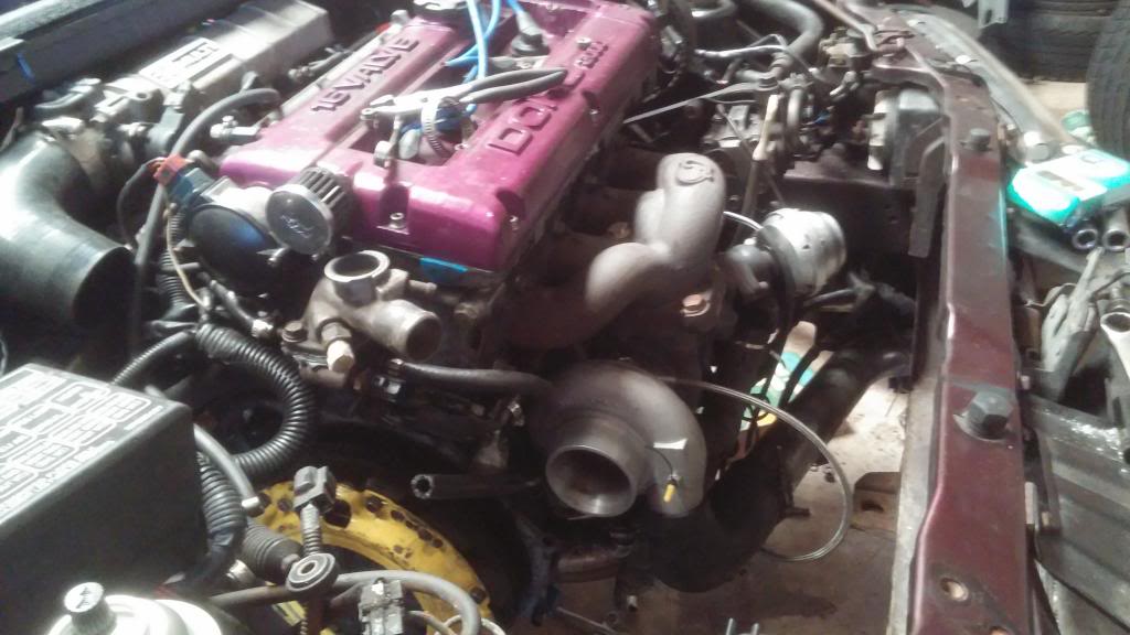

Fast foward to the last couple of months, I bought a 20g turbo, fp manifold, tial 38mm wastegate, punishment o2 housing, 1600cc injectors, black leather front and rear seats, and dw300 fuel pump. I installed all of it plus my stm tank to rail kit, stm fuel pump rewire kit, and fuelab afpr. I bought the 20g because i got it for a steal and knew i can flip it for more if I didnt like it. I drove the car a couple days and decided I wanted a holset setup. I sold my whole 20g setup and bought a holset hx35w w/ bolt on housing, new punishment 3" o2, turbosmart 40mm wastegate, and evo3 manifold.

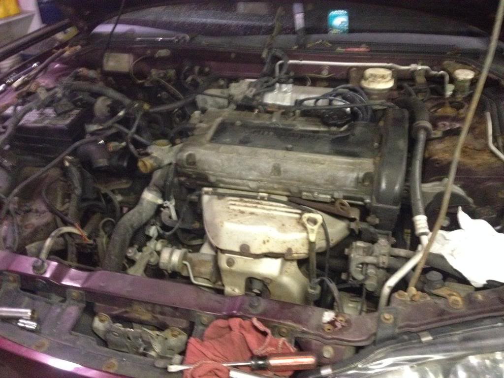

Right now the car is down for the holset swap, I am also doing a fusebox relocation to the passenger airbag location, and possibly doing an awd swap.

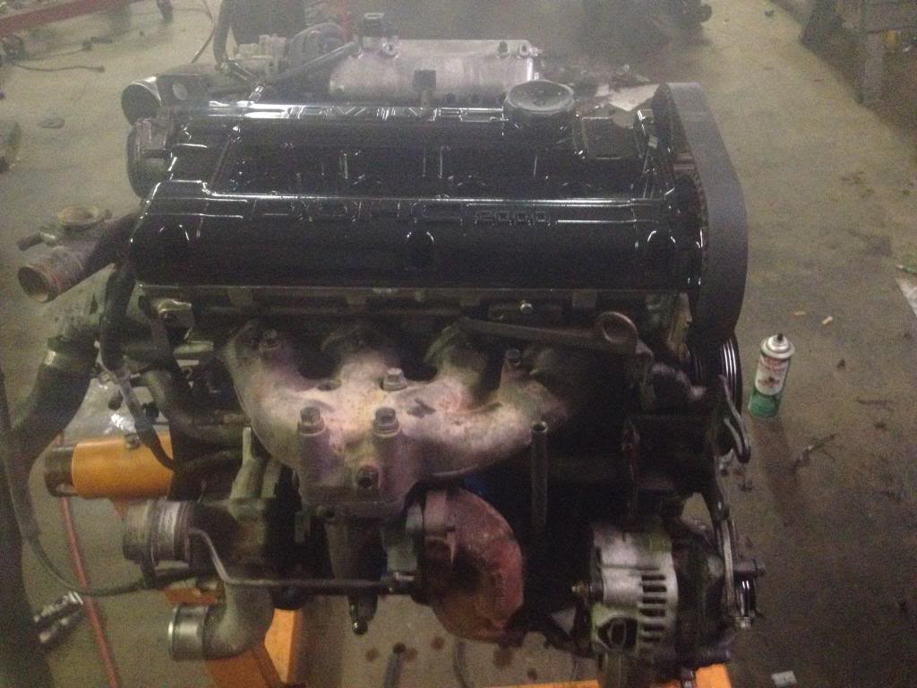

As it sits now, plus holset stuff:
20140426_222012_zpszeiou6kg.jpg20140427_141224_zpsfbwcjntc.jpg20140504_143940_zpszcv213s2.jpg20140430_165830_zpsvbntu1kn.jpg20140507_162352_zpsmcqadzur.jpg

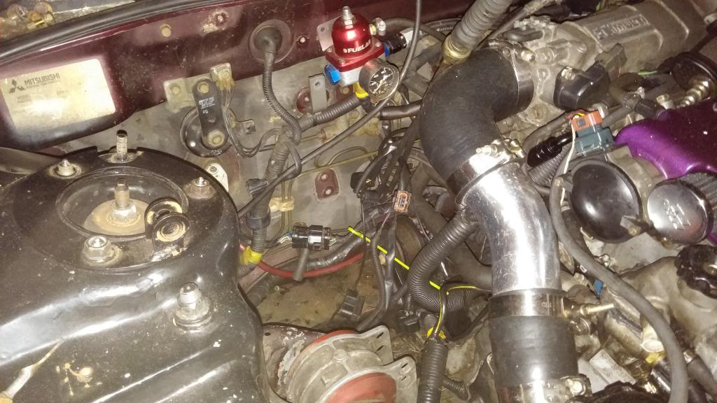

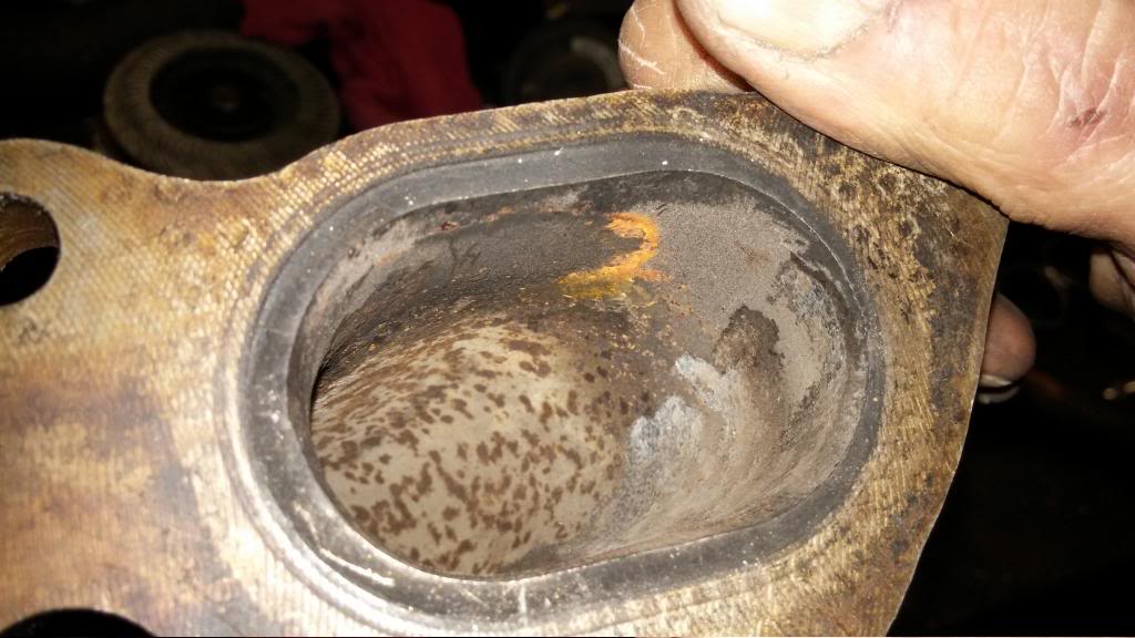

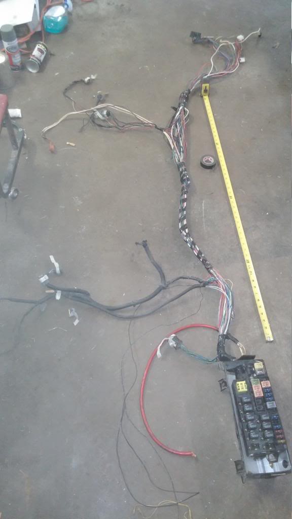

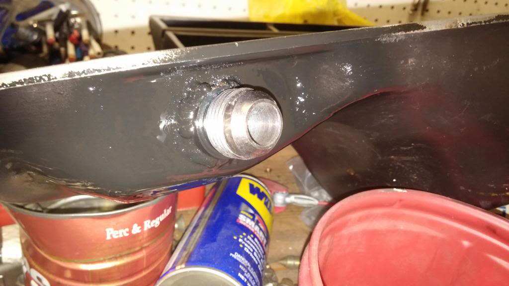

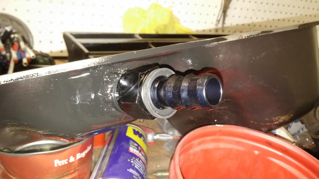

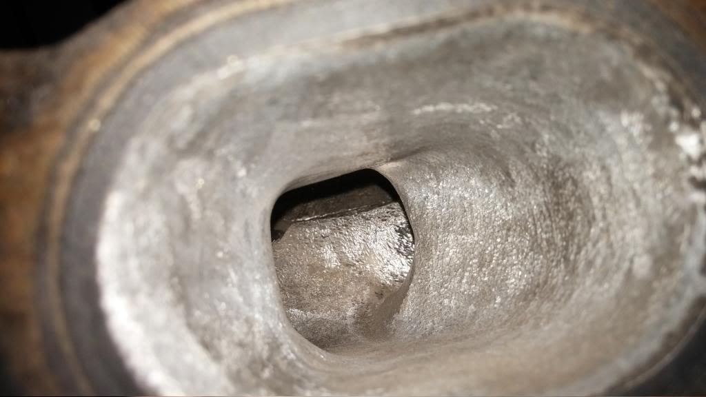

Finished wiring the fuse box on thursday. Last night did some porting on the evo3 manifold and welded my -12an bung to my non turbo oil pan. Things are starting to come along now. Going to blast the manifold and remove all the casting flash and paint it once porting is done.
Going to clean this up a bit more, pulled factory harness in the car as far as it can go and ran the wiring across the subframe instead of on top of the transmission.
I have to put the plug in the fender hole and ziptie the wiring to the frame rail
nevermind the crappy weld. For some reason it wasnt welding good on the outside of the pan so it was welded on the inside with no issues at all.
Stock unported runner
Ported exhaust exit and number 4 & 3 runners.

Nice patch work on the strut towers, I would have taken that deal in a heart beat, I love bringing cars back from the grave.
Keep it up, looks like another car saved
Thanks ejanes. It was a deal i couldnt resist.
Yamahaulin yes it still has the n/a pistons. Running it like that til it blows. Im running e85 so knock is near non existant. I like the extra bump in compression as well.
Yeah the comp will help the e-85 make some nice power. Gonna suck when those pistons let go though, hopefully wont cause to much carnage.
