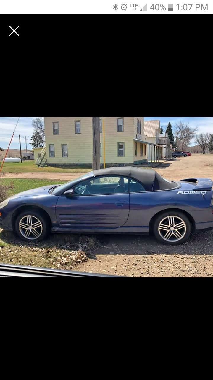

Not exactly sure what how to turbo my dsm I was told it's a lot of fabriction what you guys thinkThis is the Build Thread for Mitsubishi eclipse. Reply below.
This site focuses on the 1st and 2nd gen eclipse (90-99). Your car shares some architecture but not much. It is mitsubishi powered. Adding a turbo is more than just the turbo itself. It's a combination of the turbo and all associated accessories, piping etc., a fuel system that can supply enough fuel under boost, the computer system designed to deal with a turbocharged car and lastly the motor itself will differ in compression ratio, piston design and likely some machining clearances. It isn't as simple as "add a turbo". Yes that has been done but there are large limitations to adding a turbo to an otherwise stock car. Yes it's a lot of fabrication. I am of the opinion of going after other mods to increase the fun factor of the car. Depends on the use of the car.Not exactly sure what how to turbo my dsm I was told it's a lot of fabriction what you guys think
