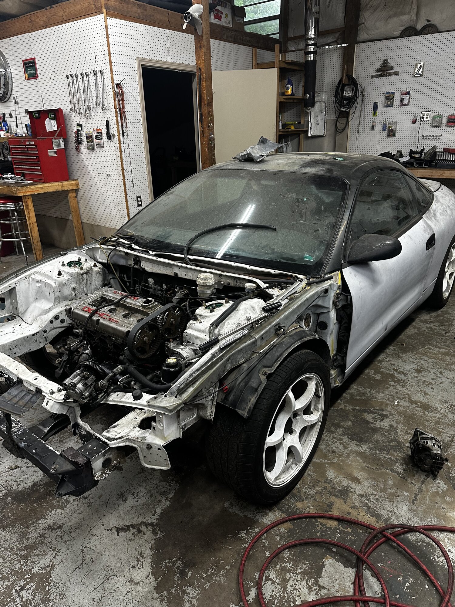

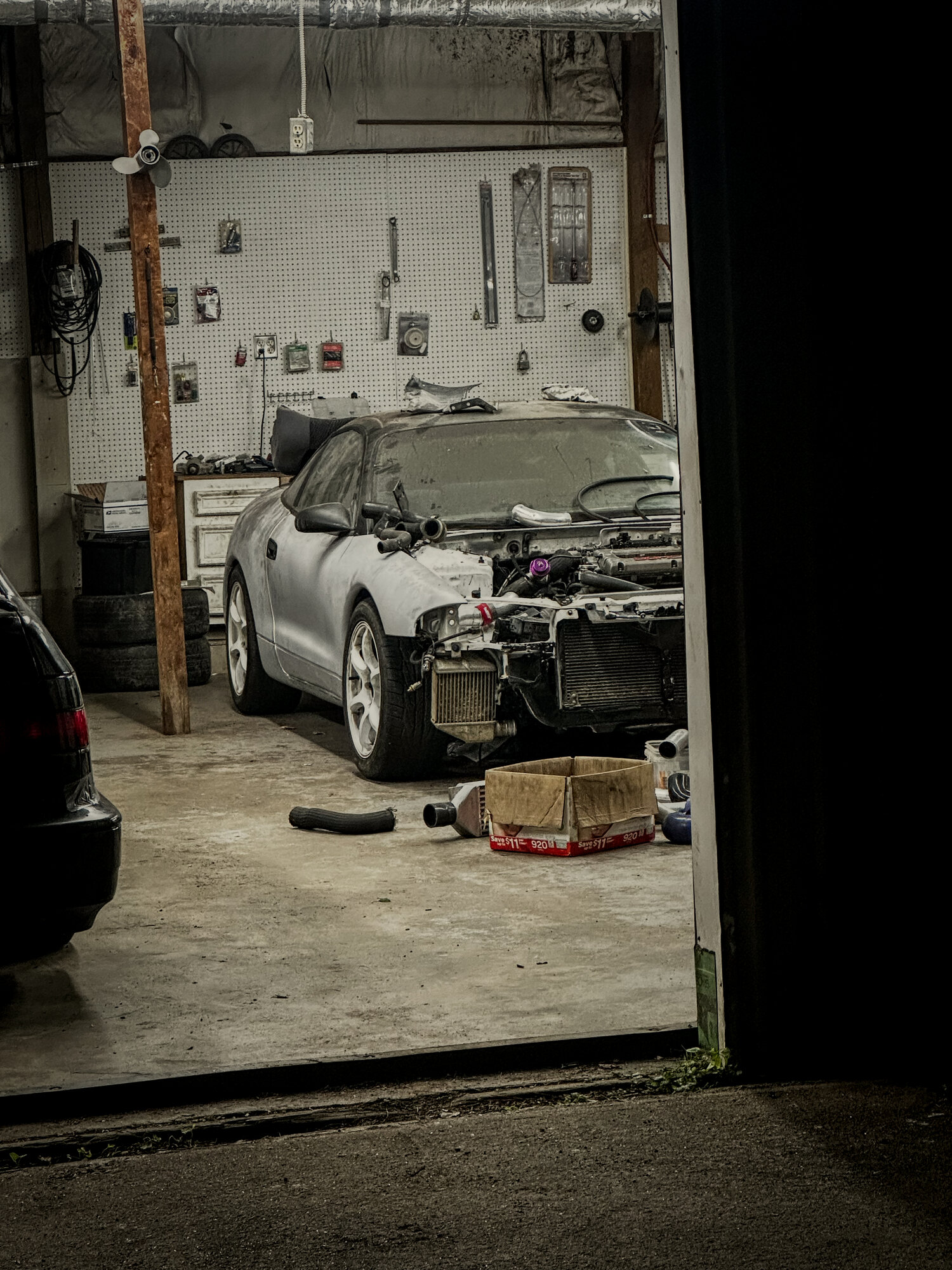

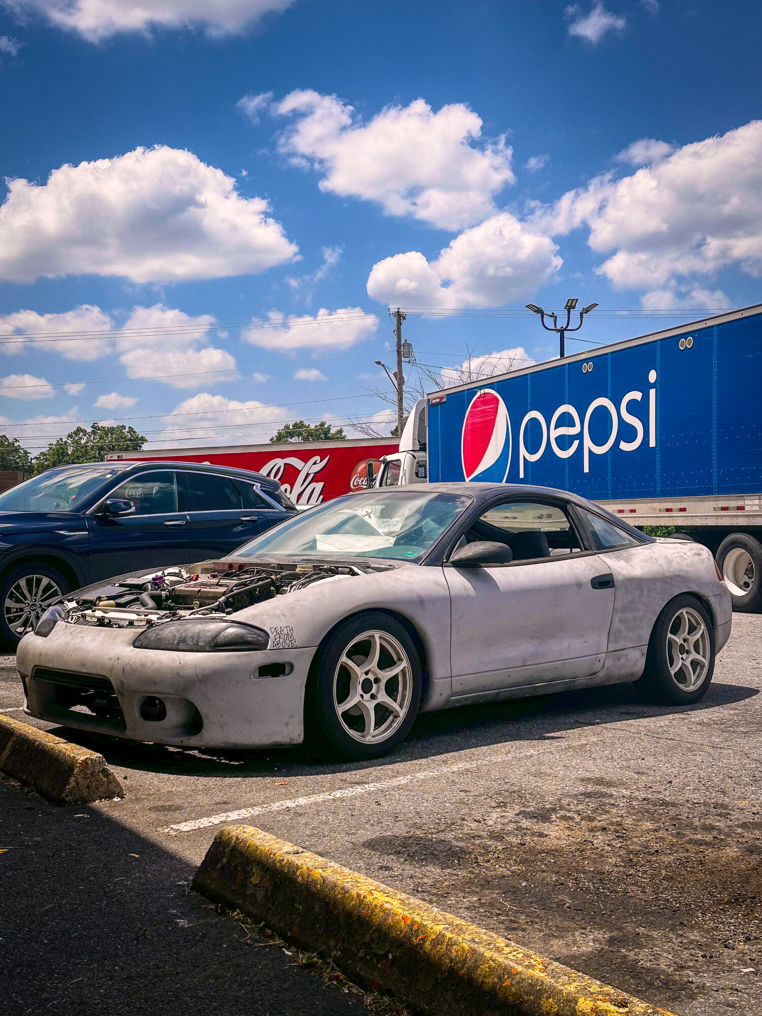

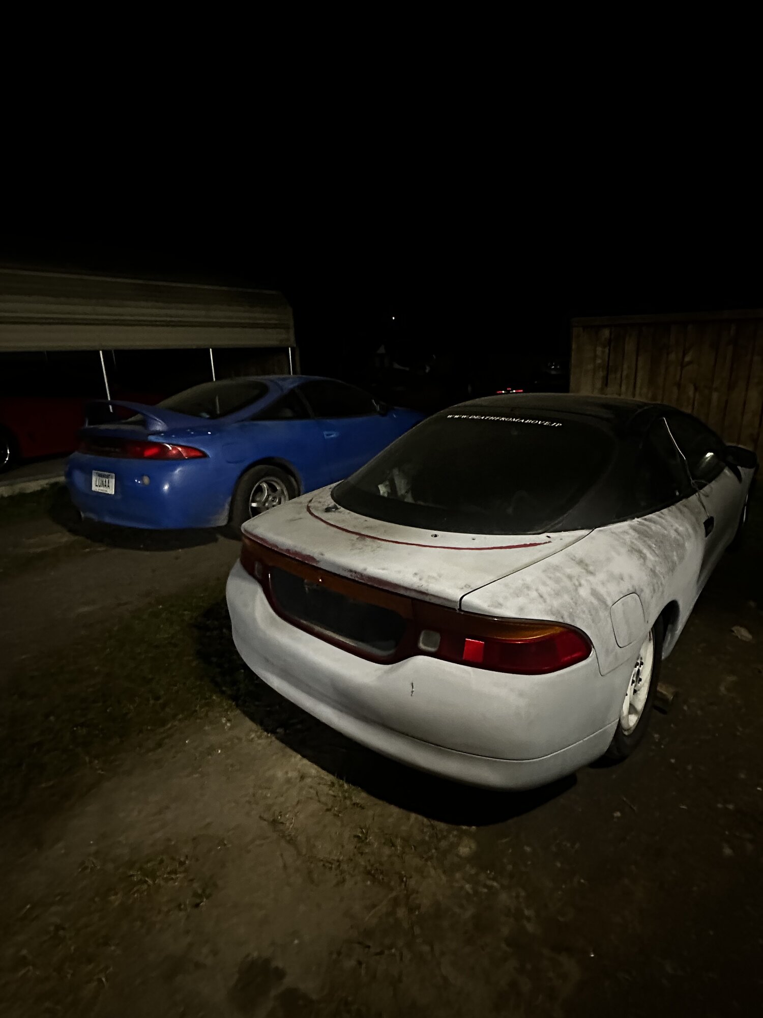

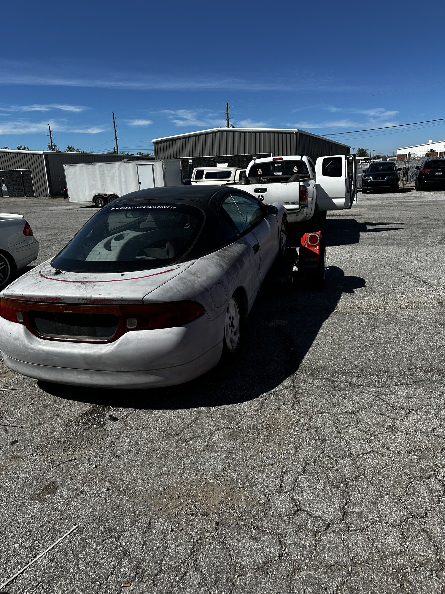

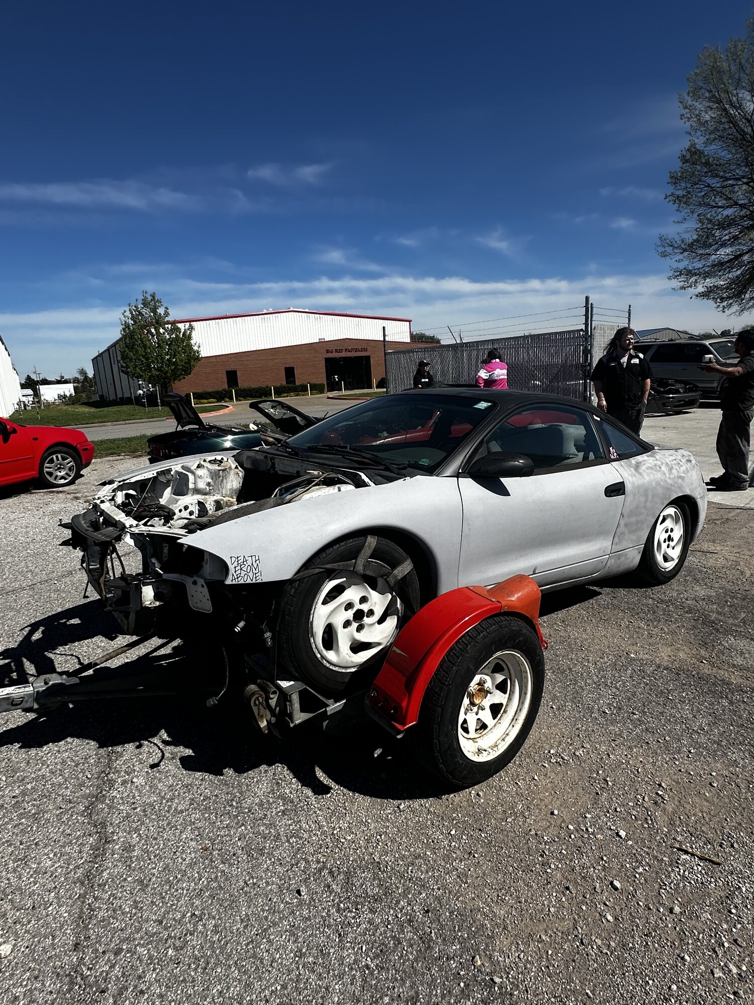

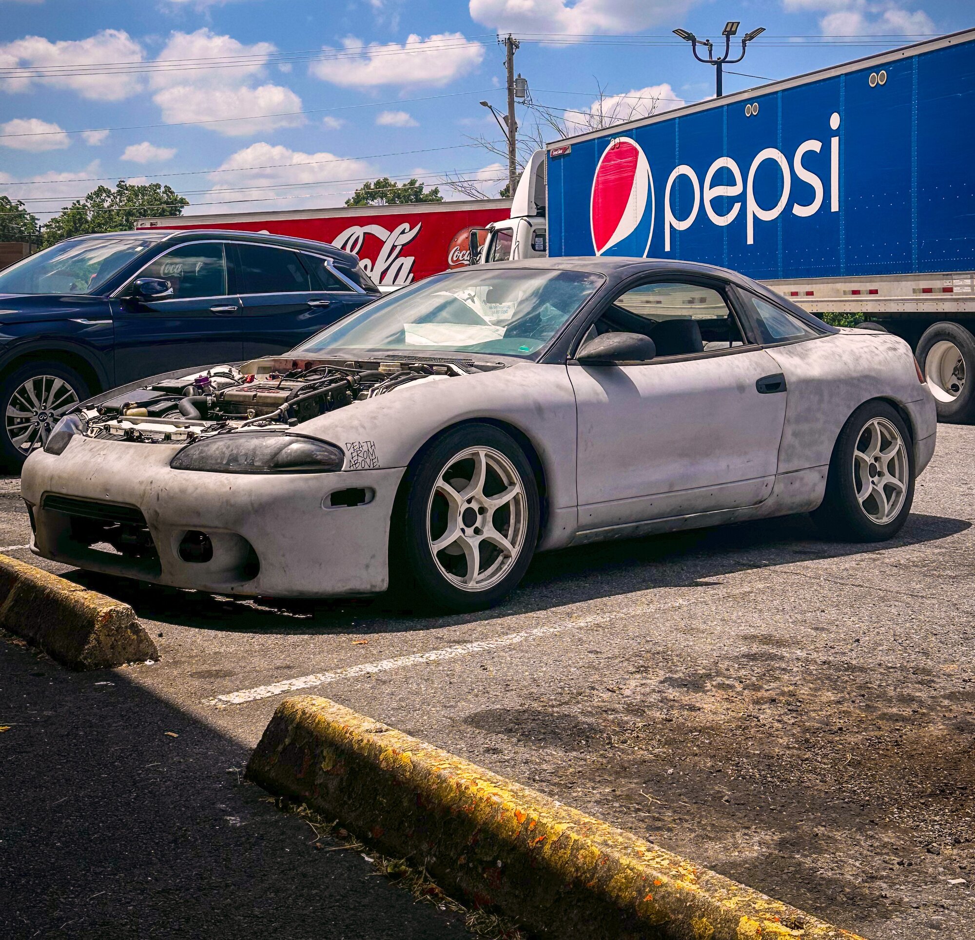

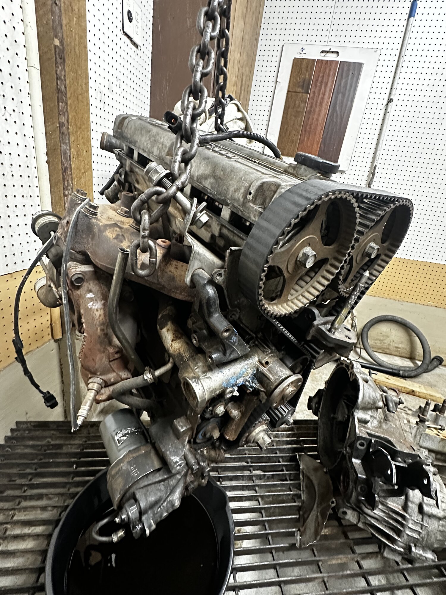

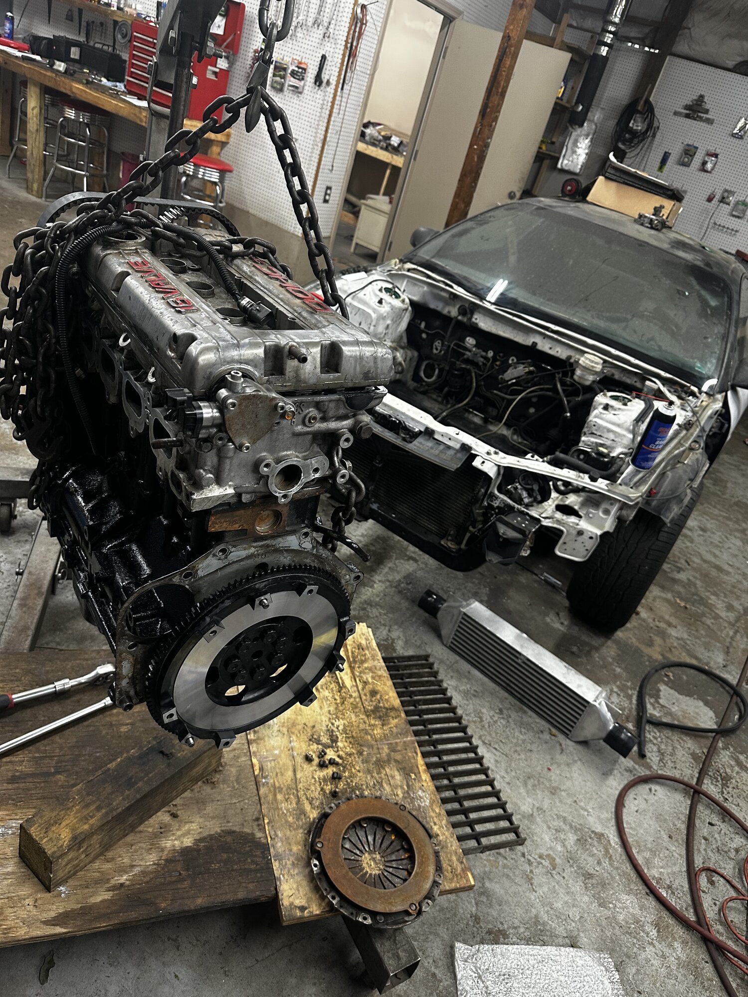

1995 Eagle Talon Tsi FWD, 2gb Eclipse facelift. Road to 300hp

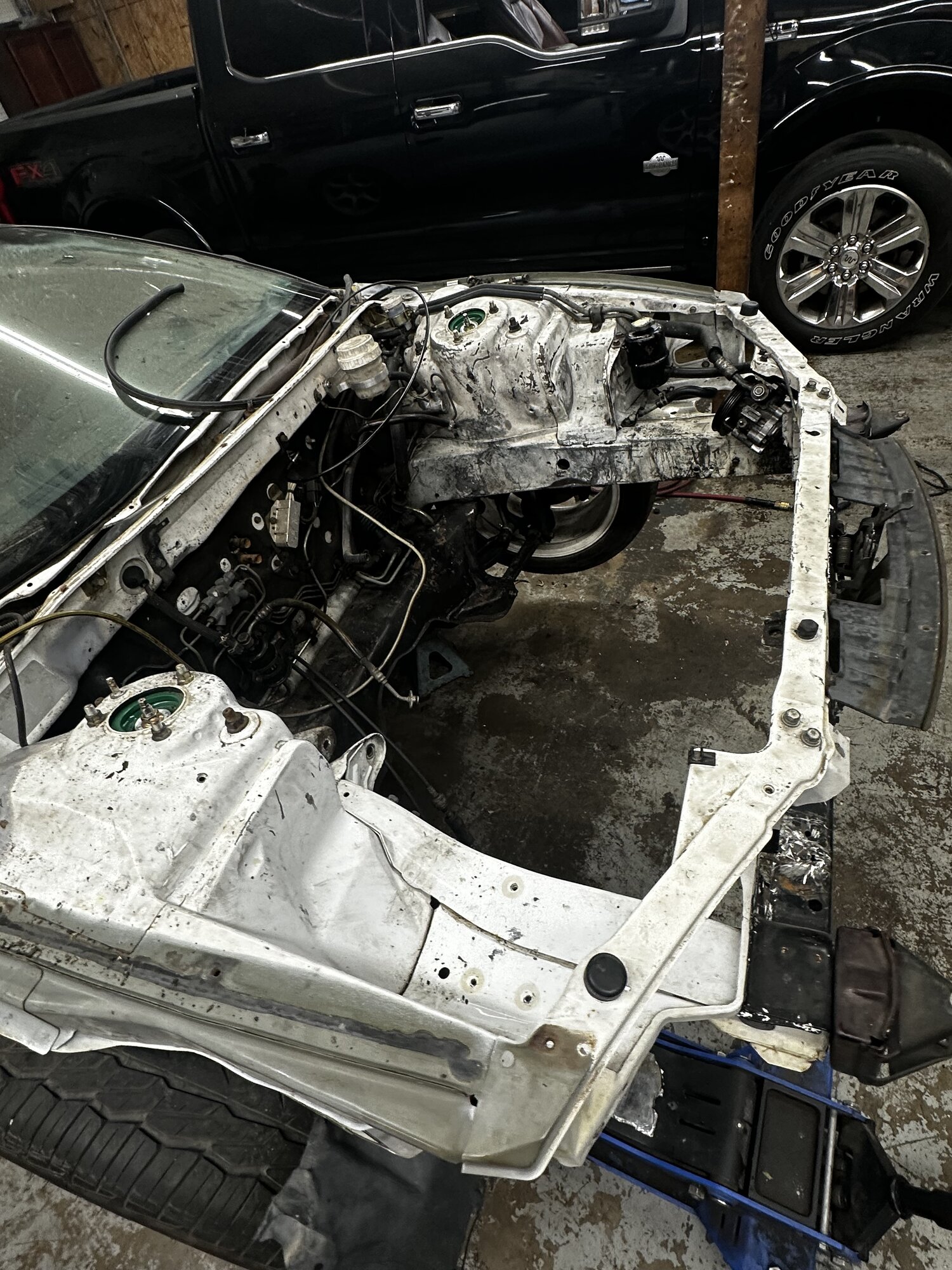

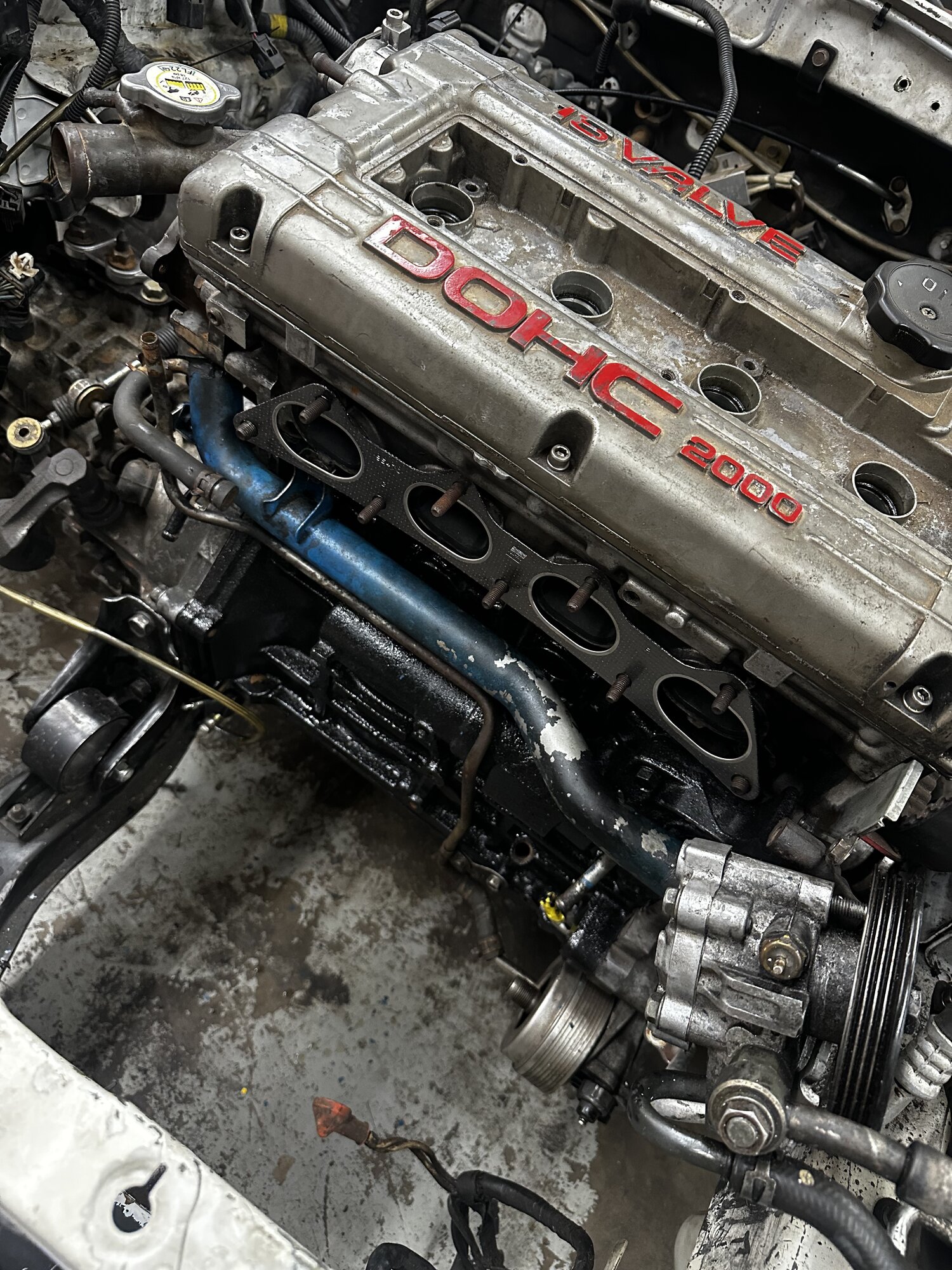

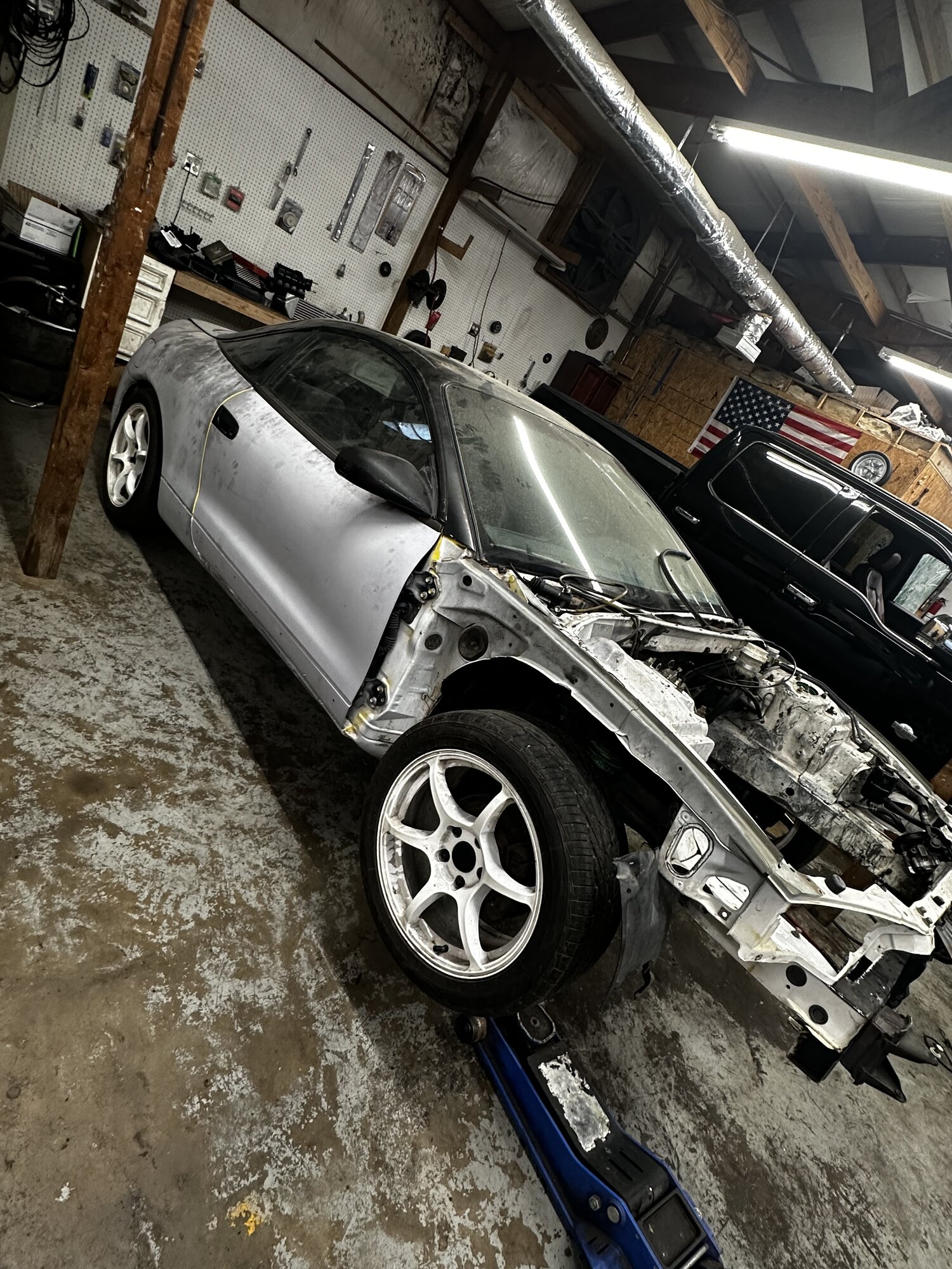

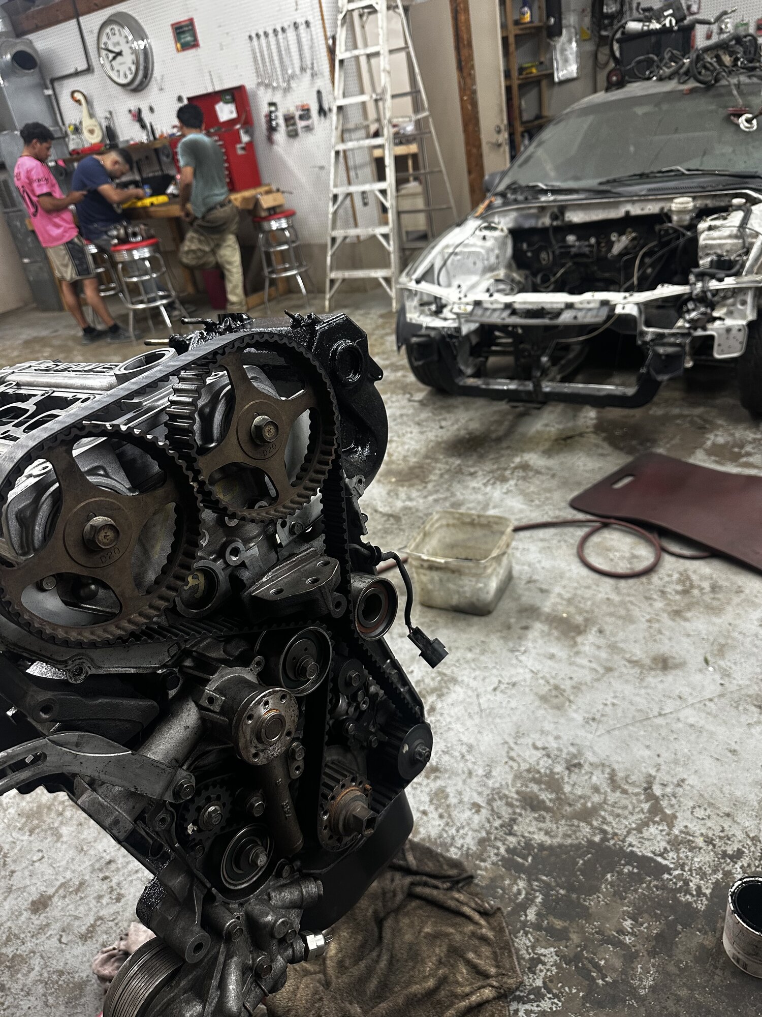

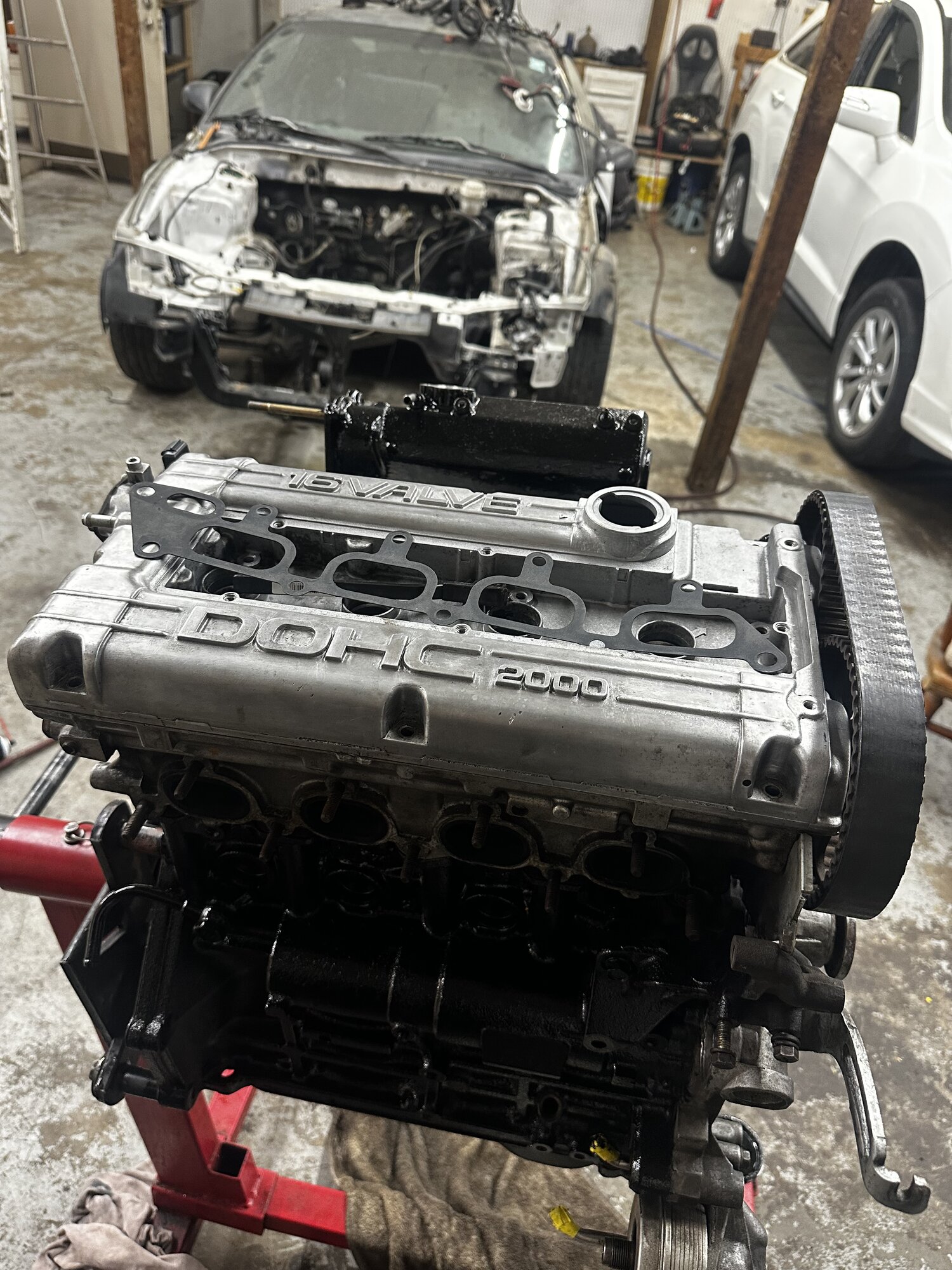

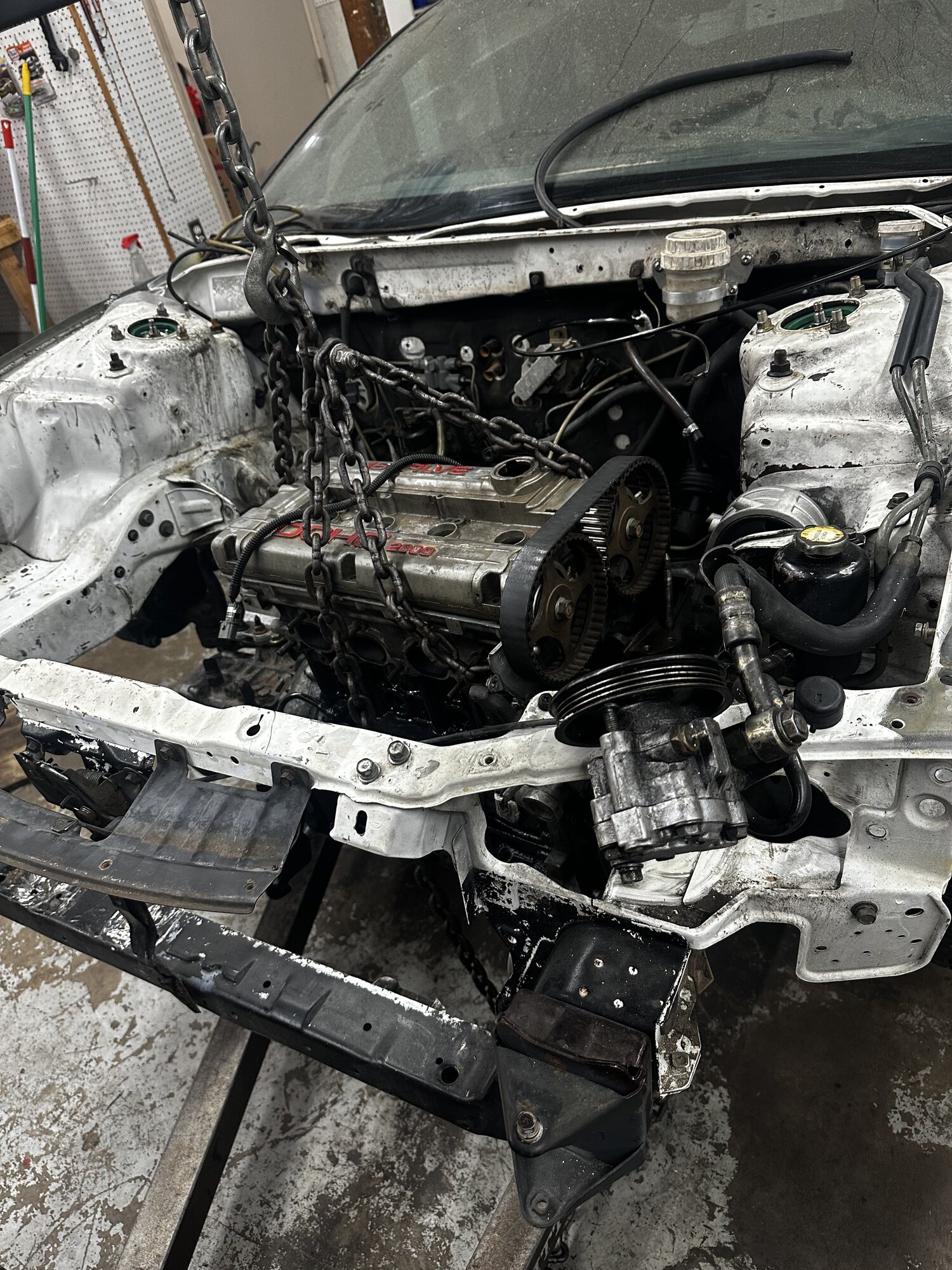

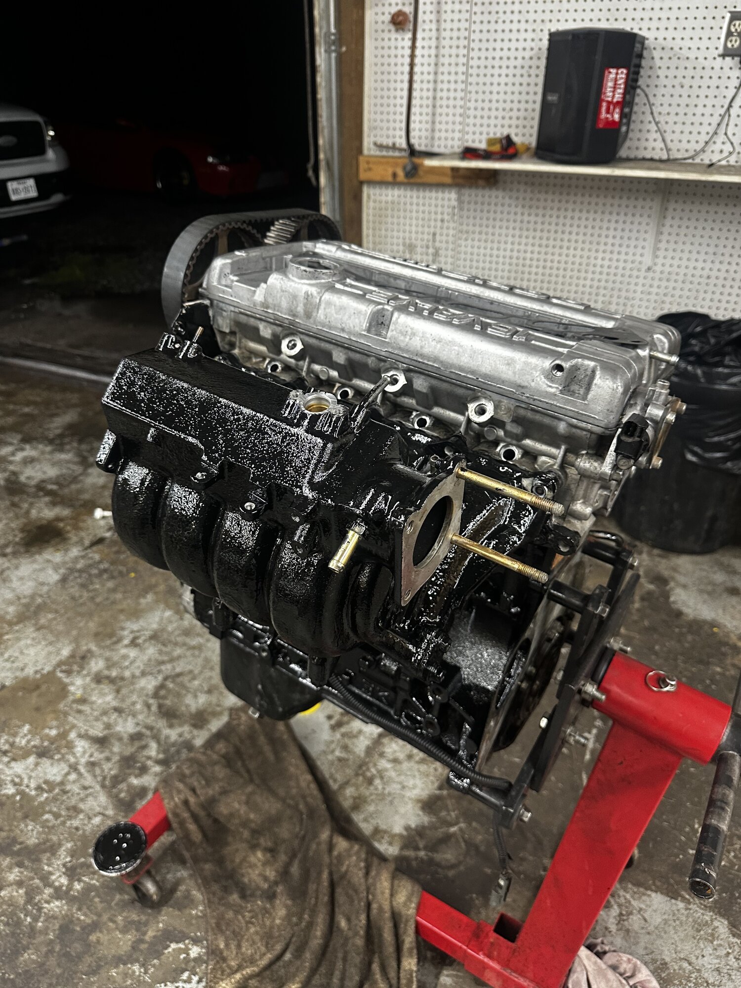

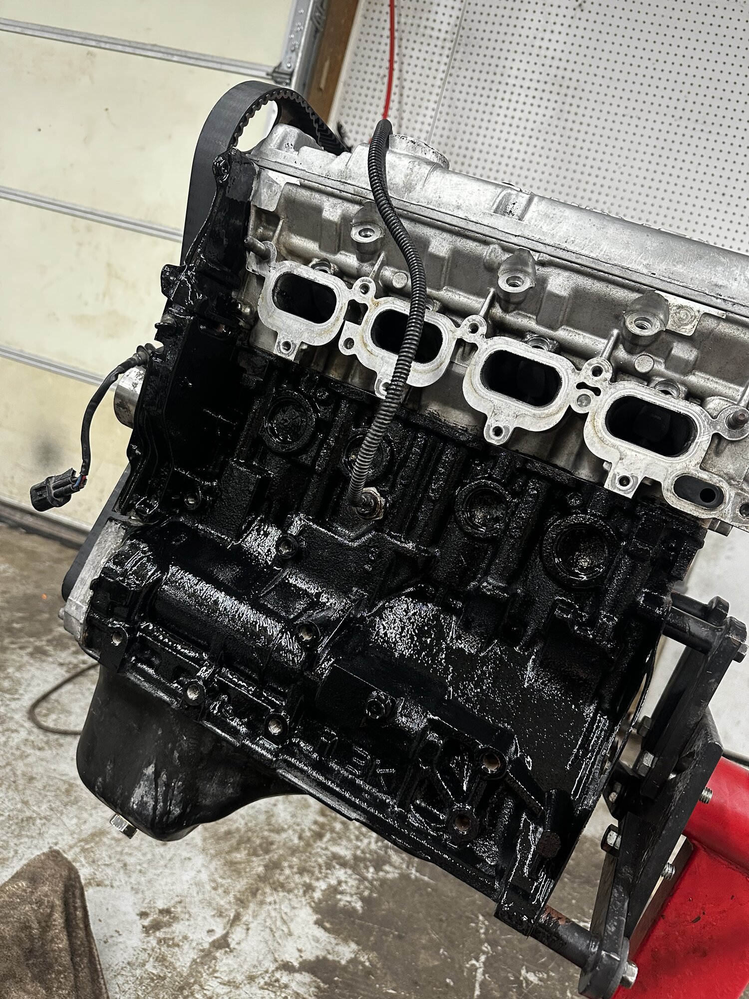

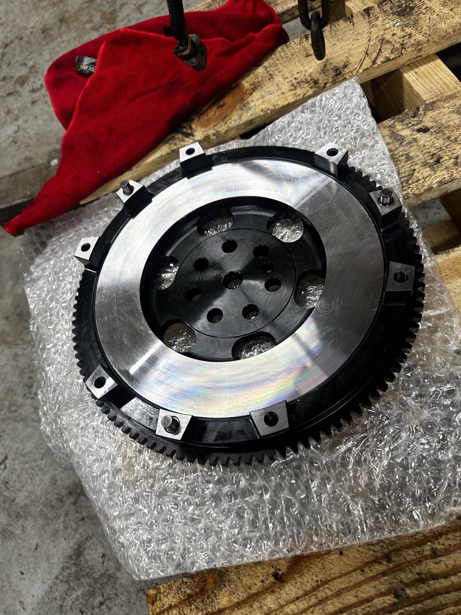

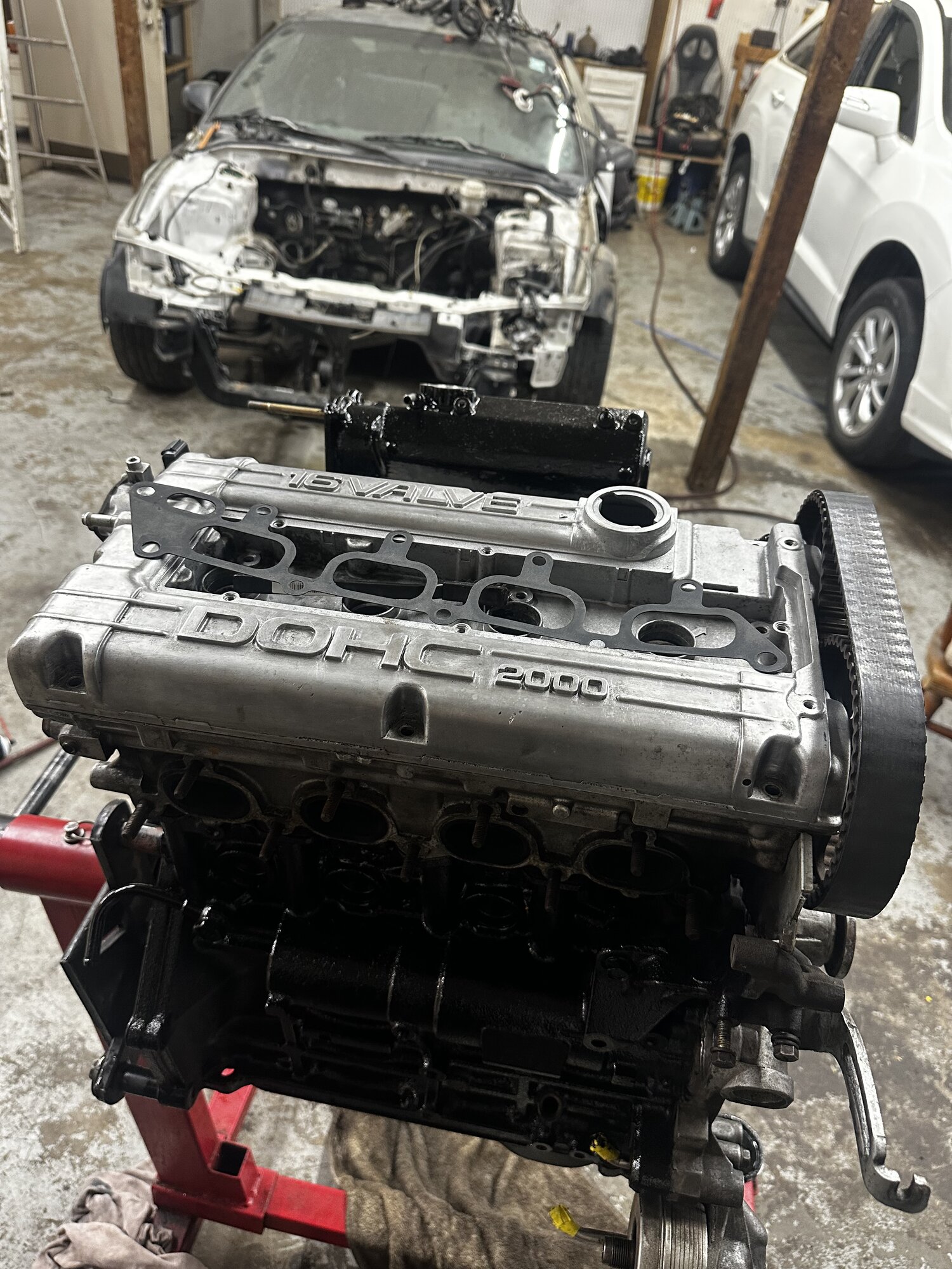

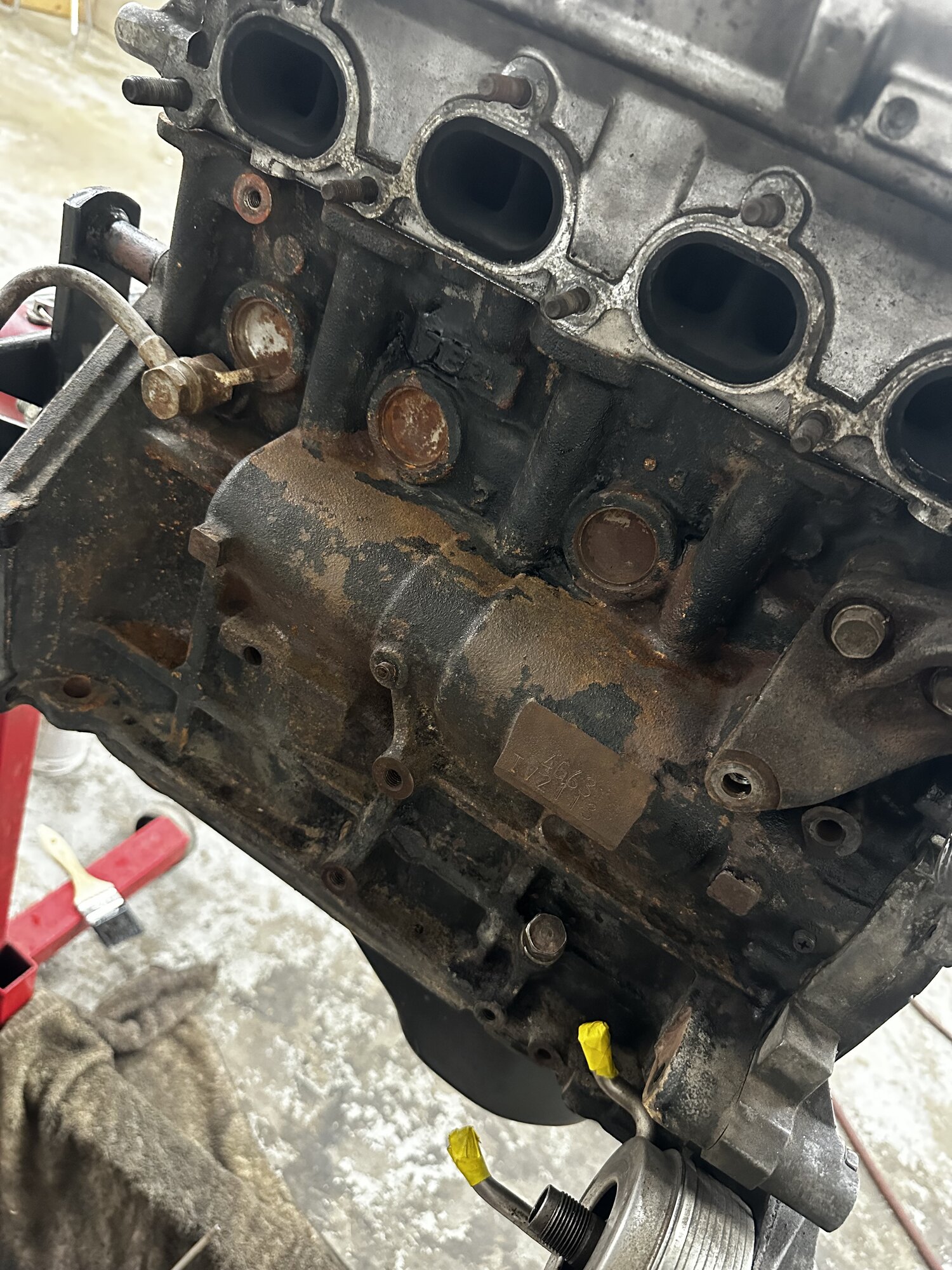

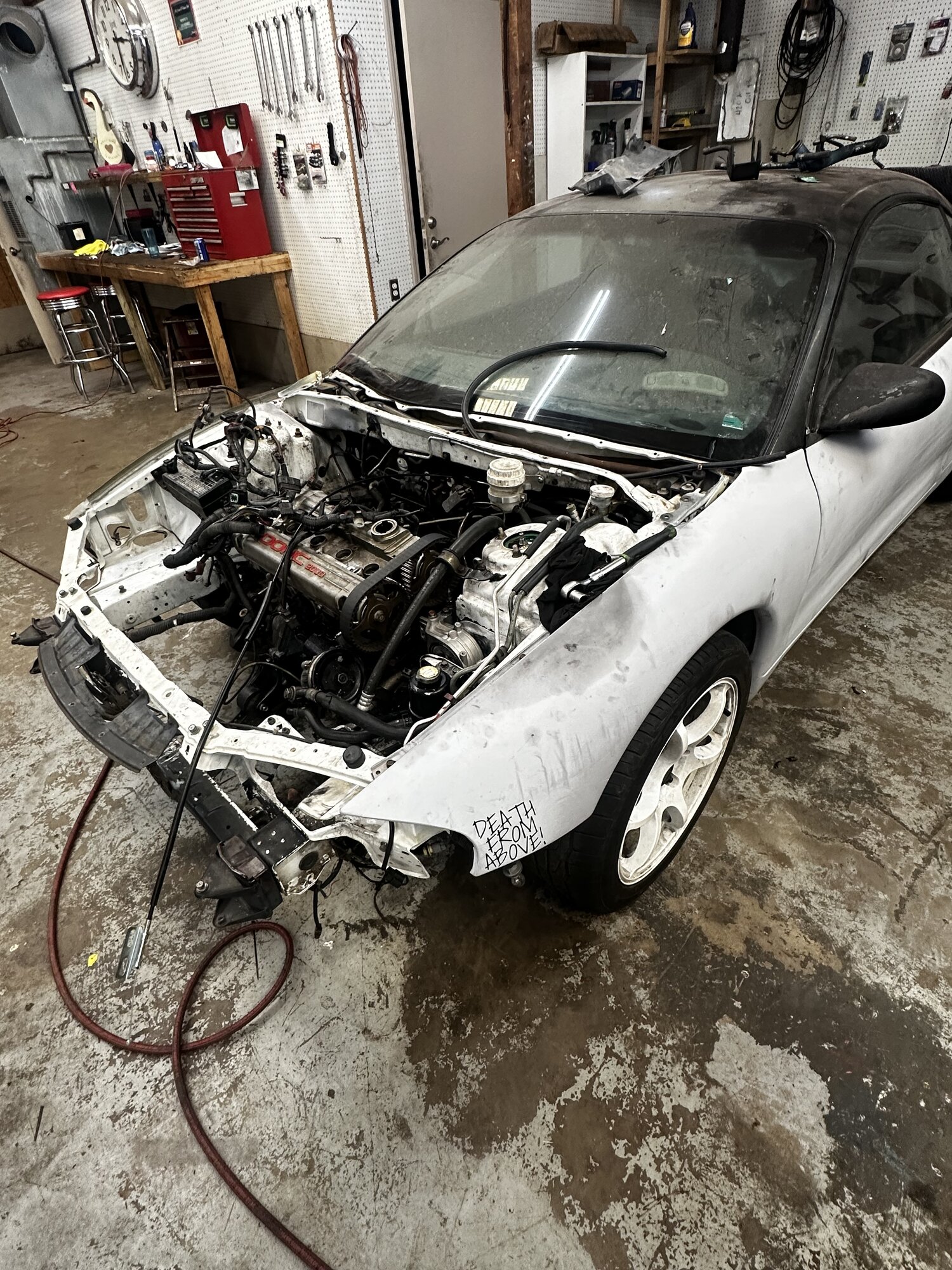

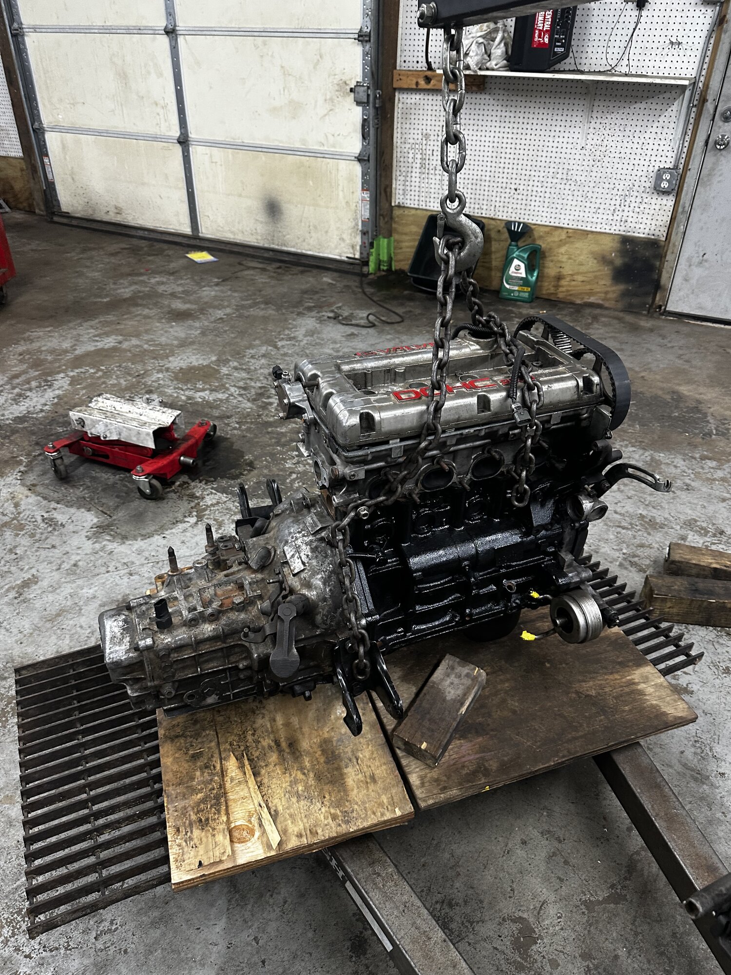

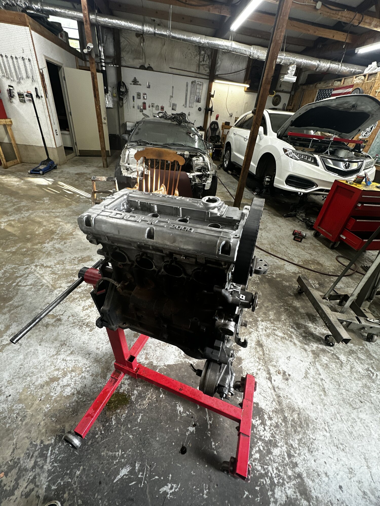

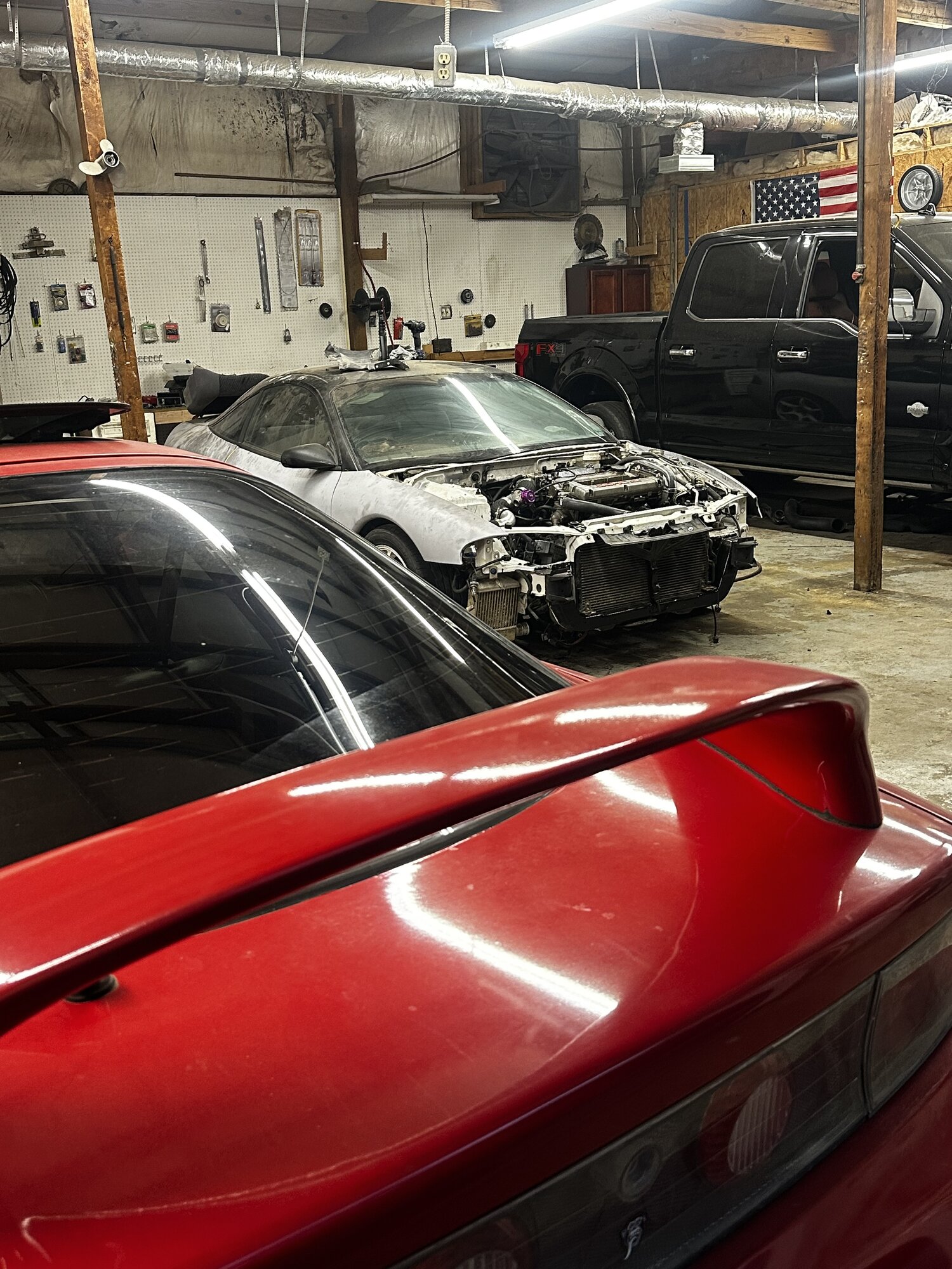

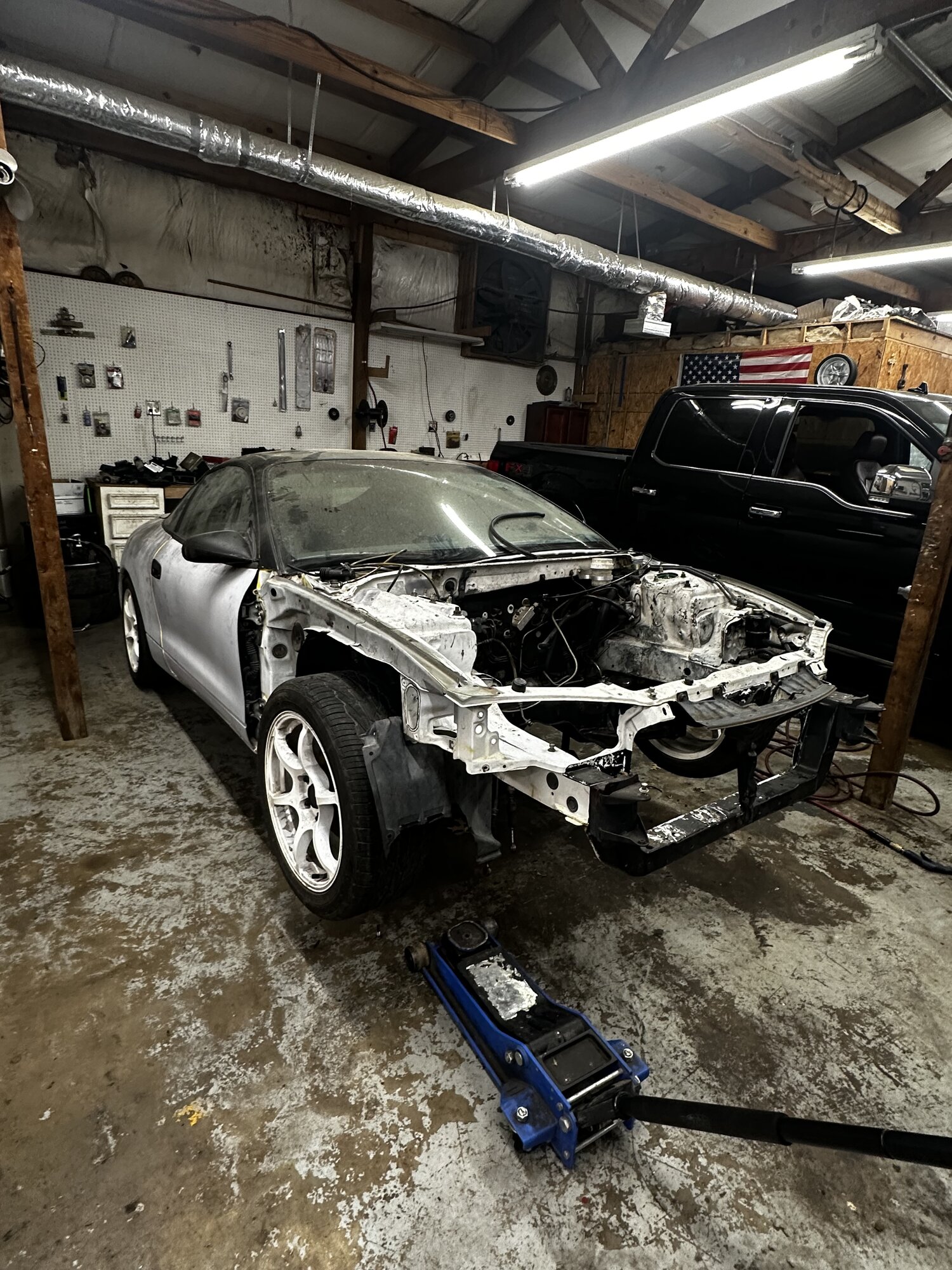

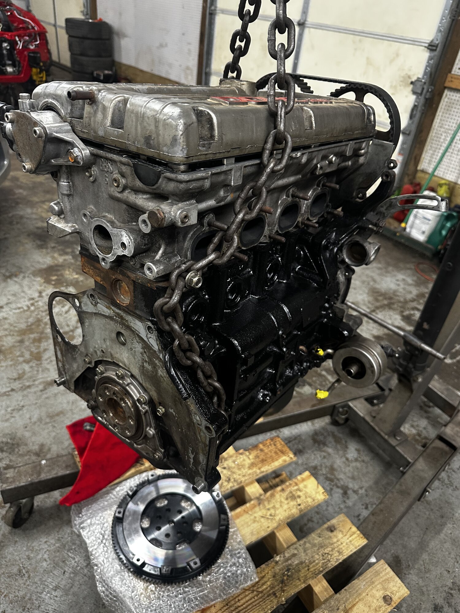

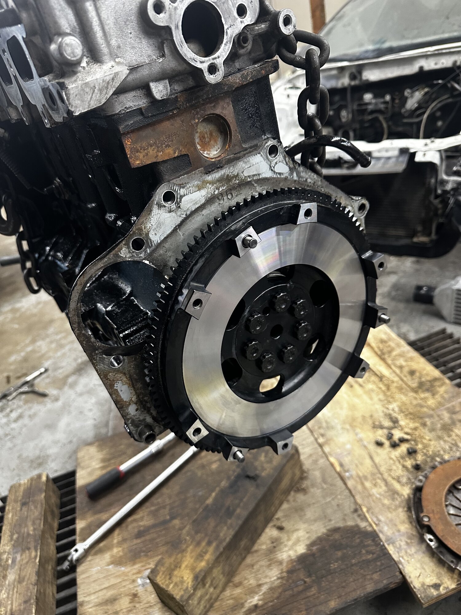

04/21/26 Engine prep. Engine from 1997 GSX, rebuilt 4000 miles ago. Trans 5 speed manual with 82,000 miles on it. OEM clutch with a lightweight Competition Clutch flywheel.

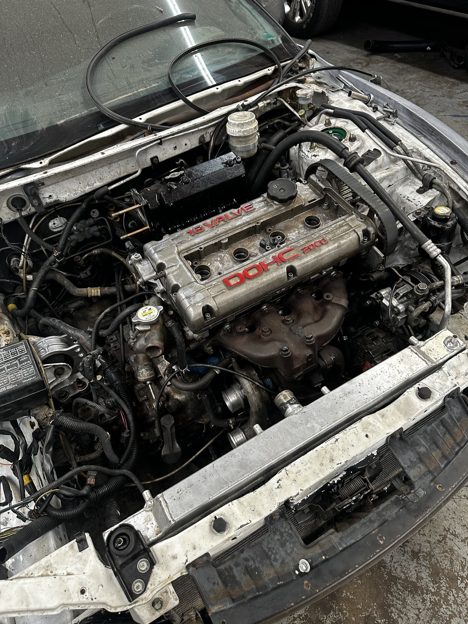

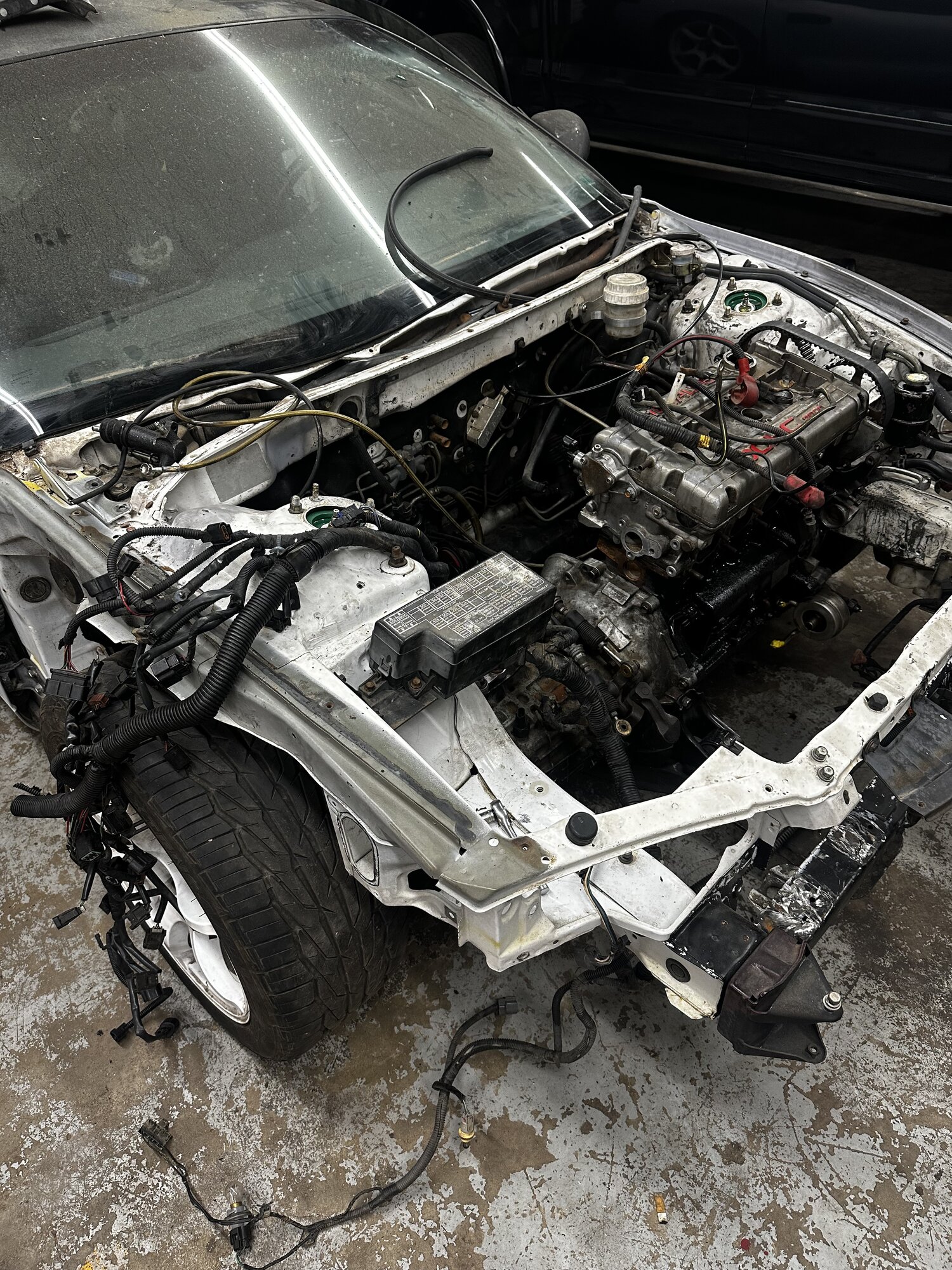

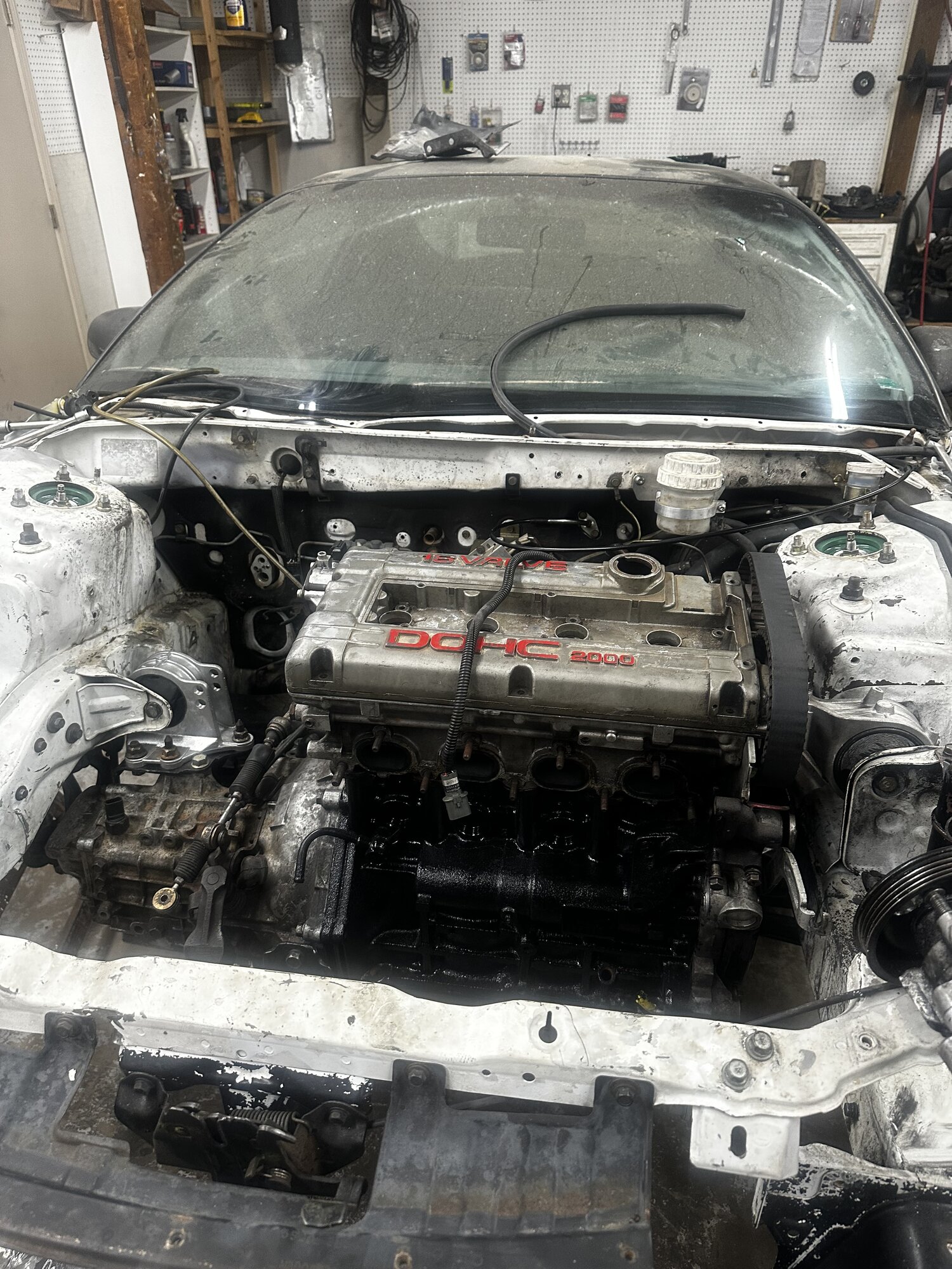

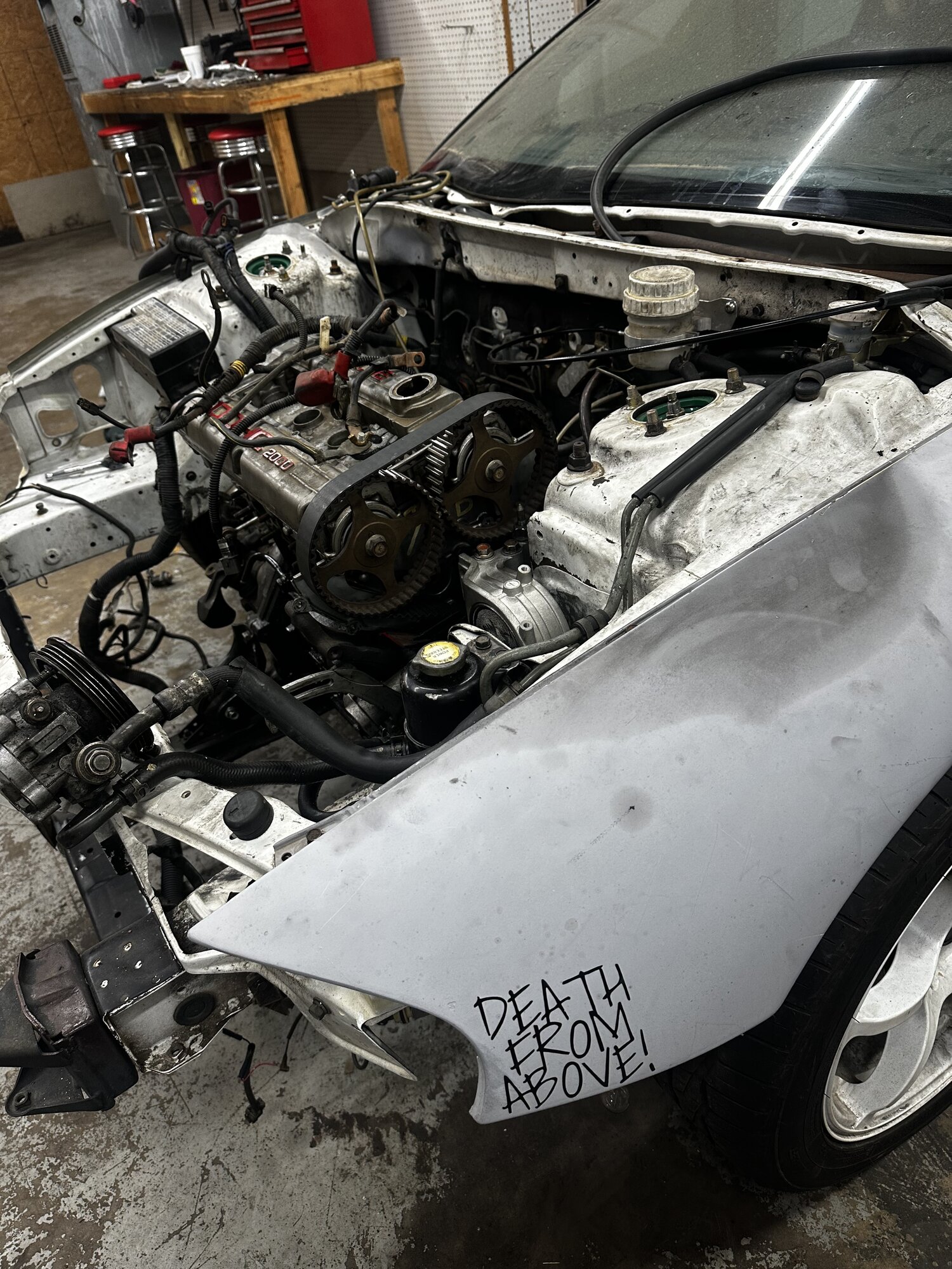

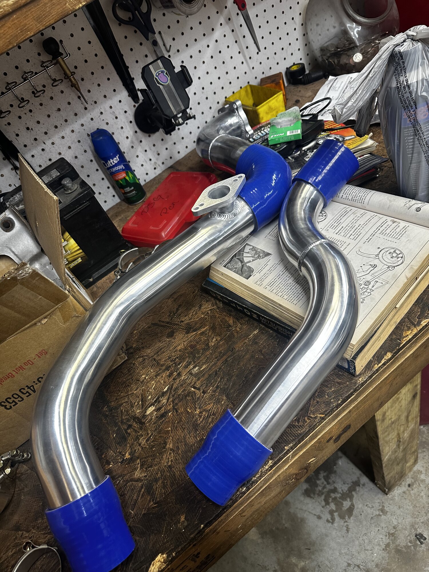

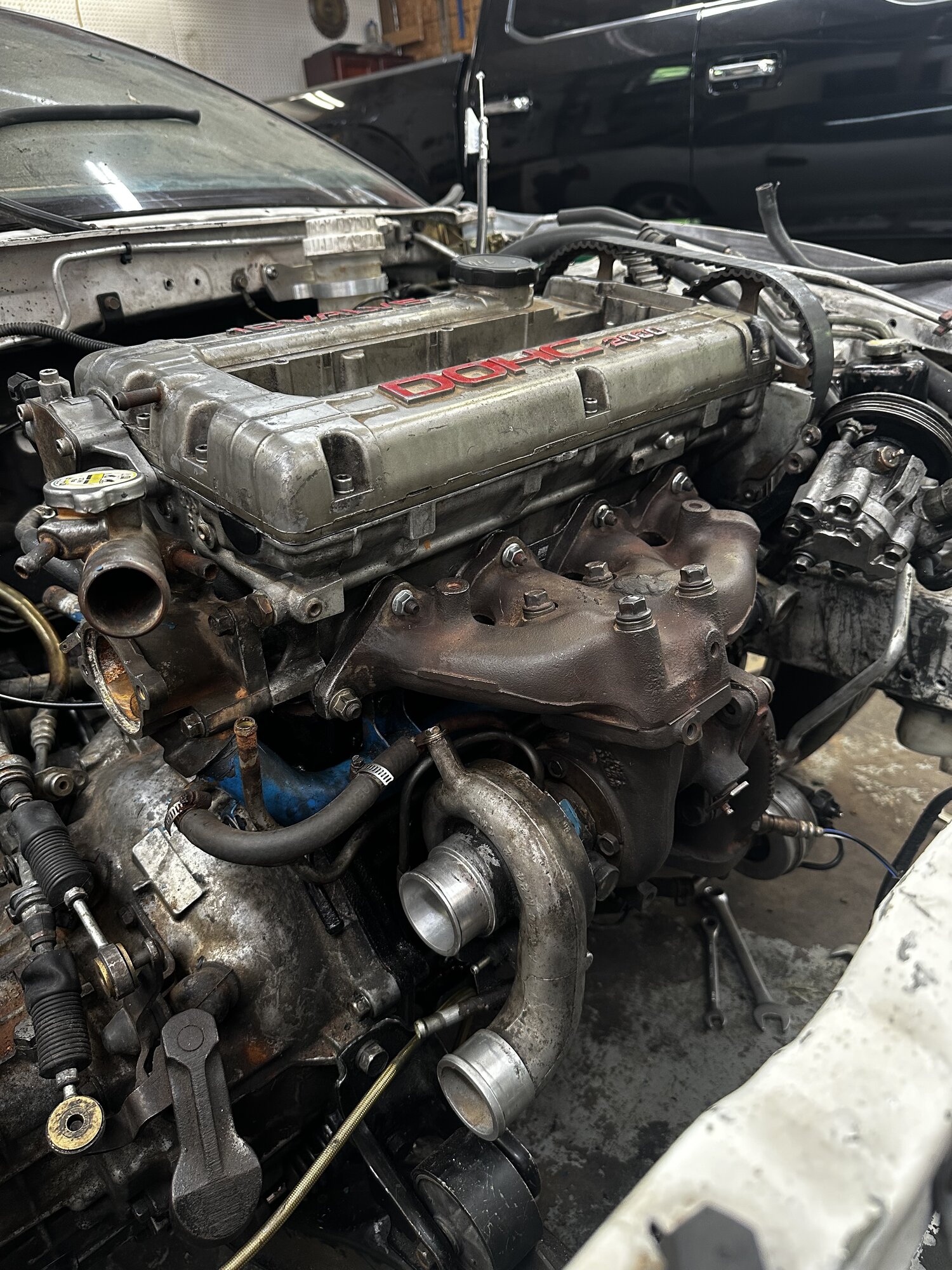

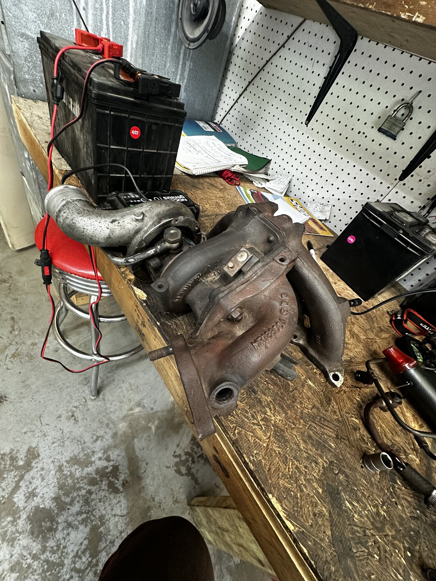

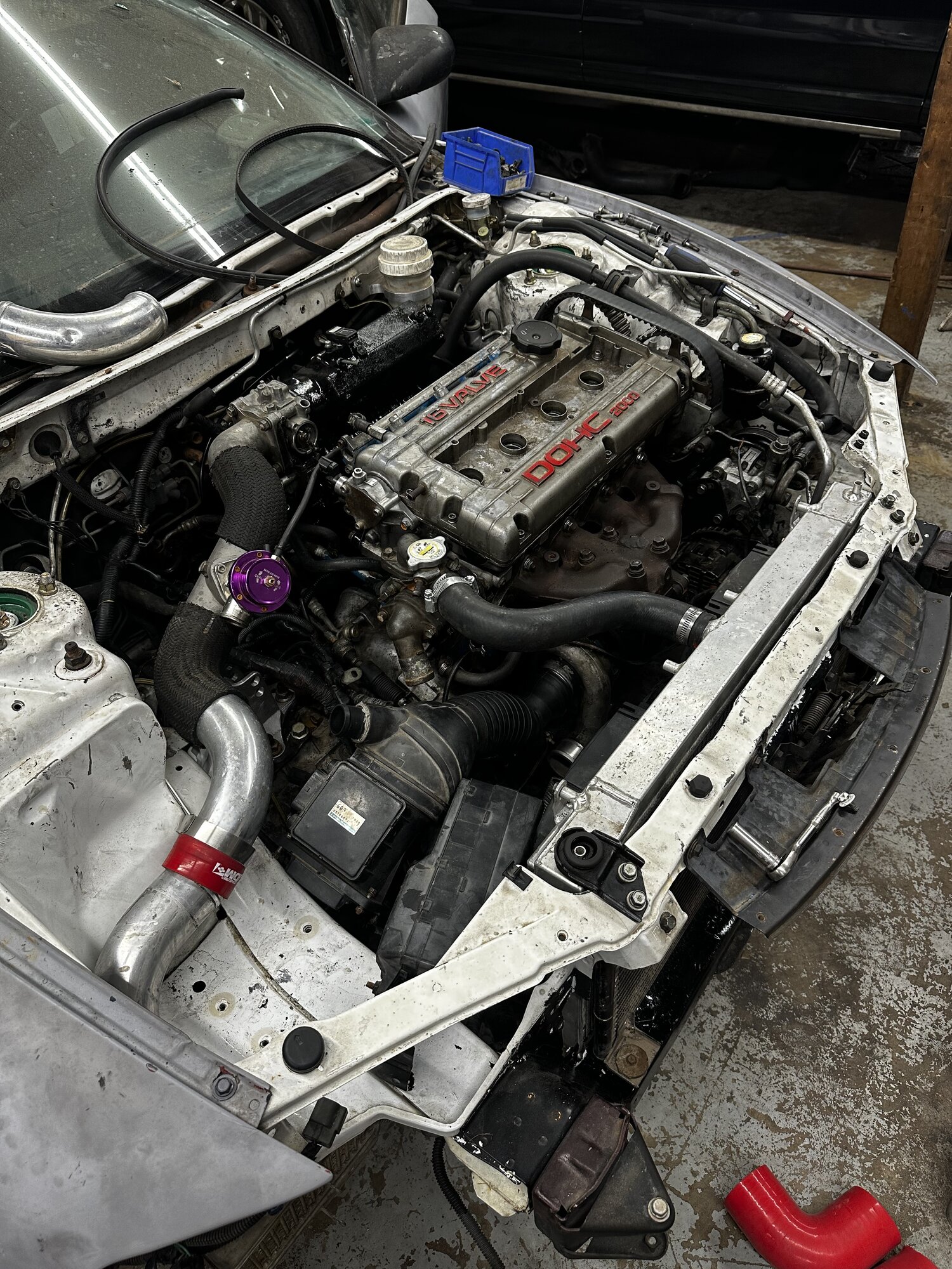

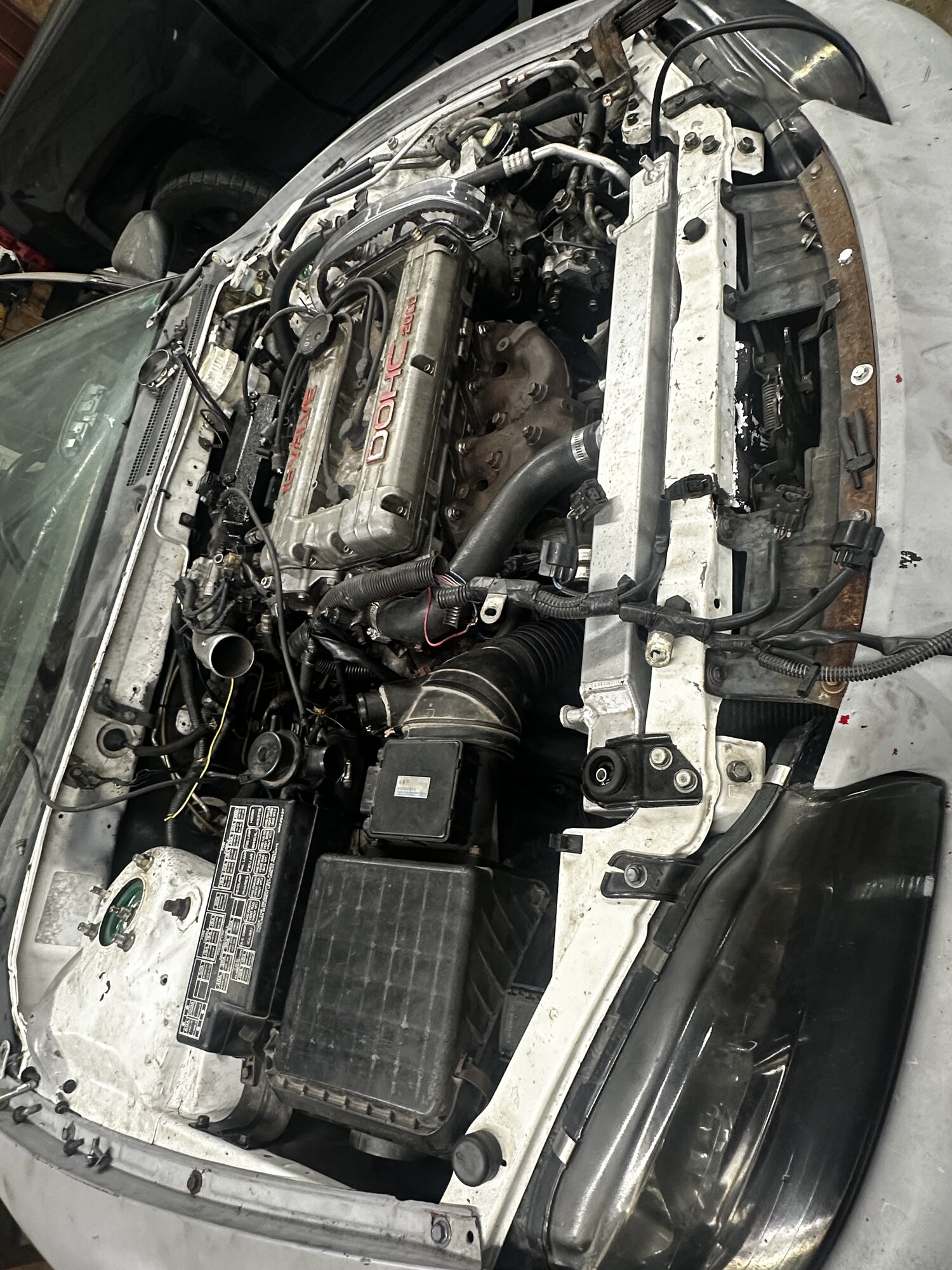

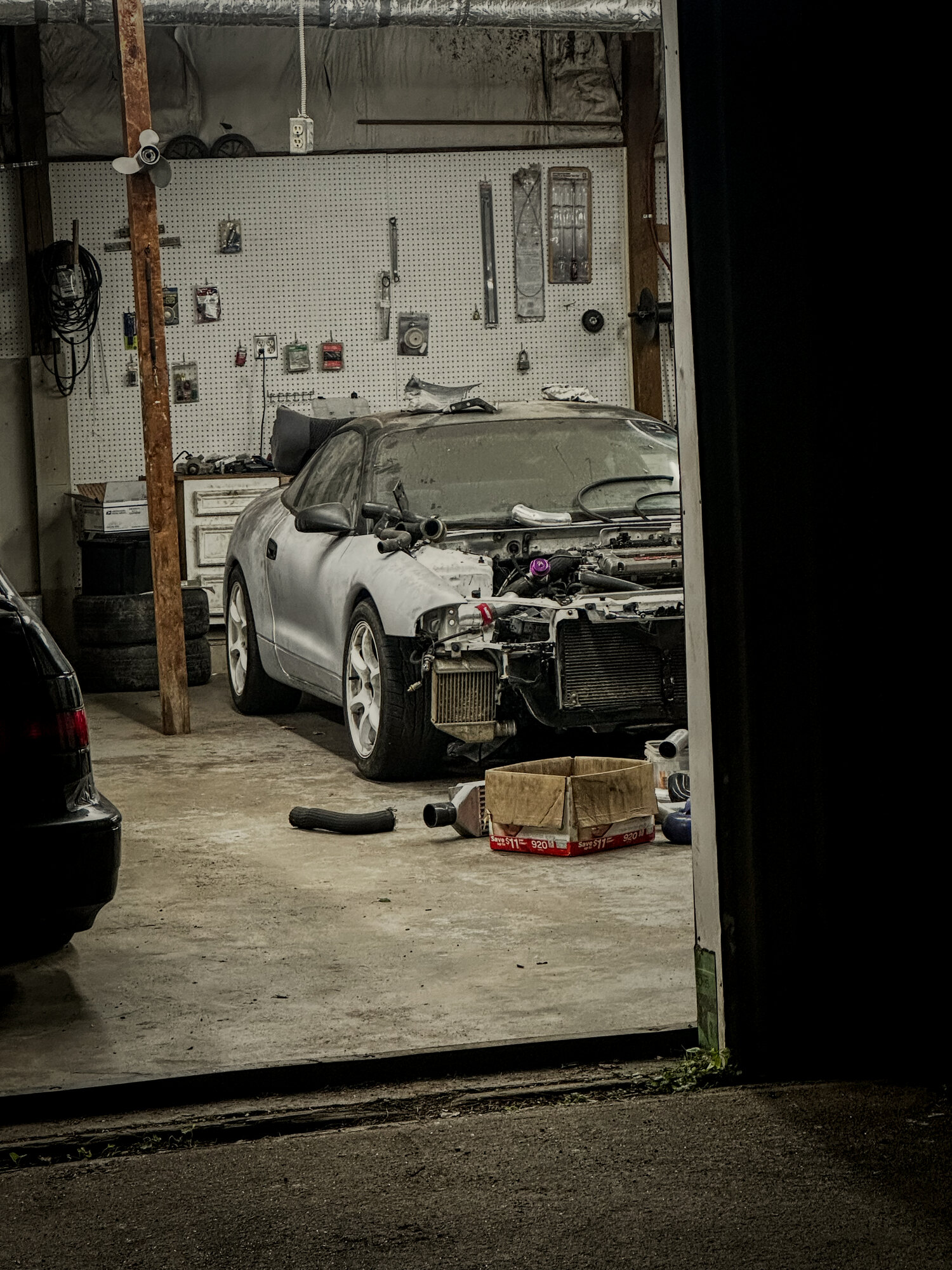

05/24/26 Engine and trans in, mixture of a 98 manual engine harness and a 99 auto chassis harness. Clear cam timing cover did not survive because I was dumb and ran it without the middle timing cover piece. Trying out some Intercooler piping routes, eventually found a stock one to use for the moment. Stock T25 turbo.

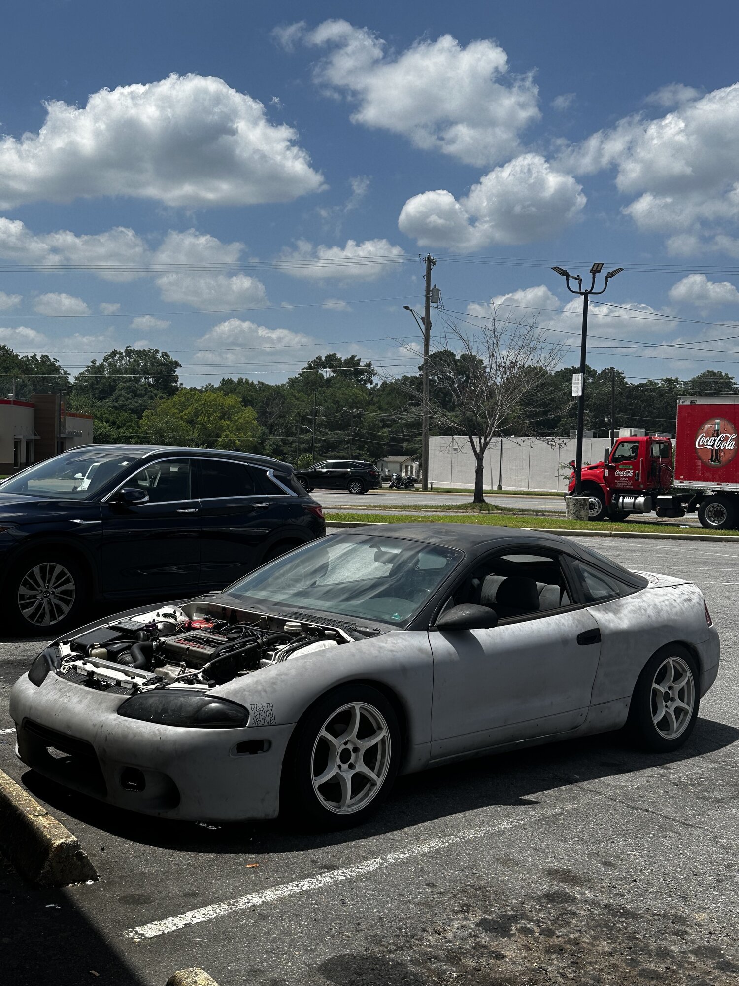

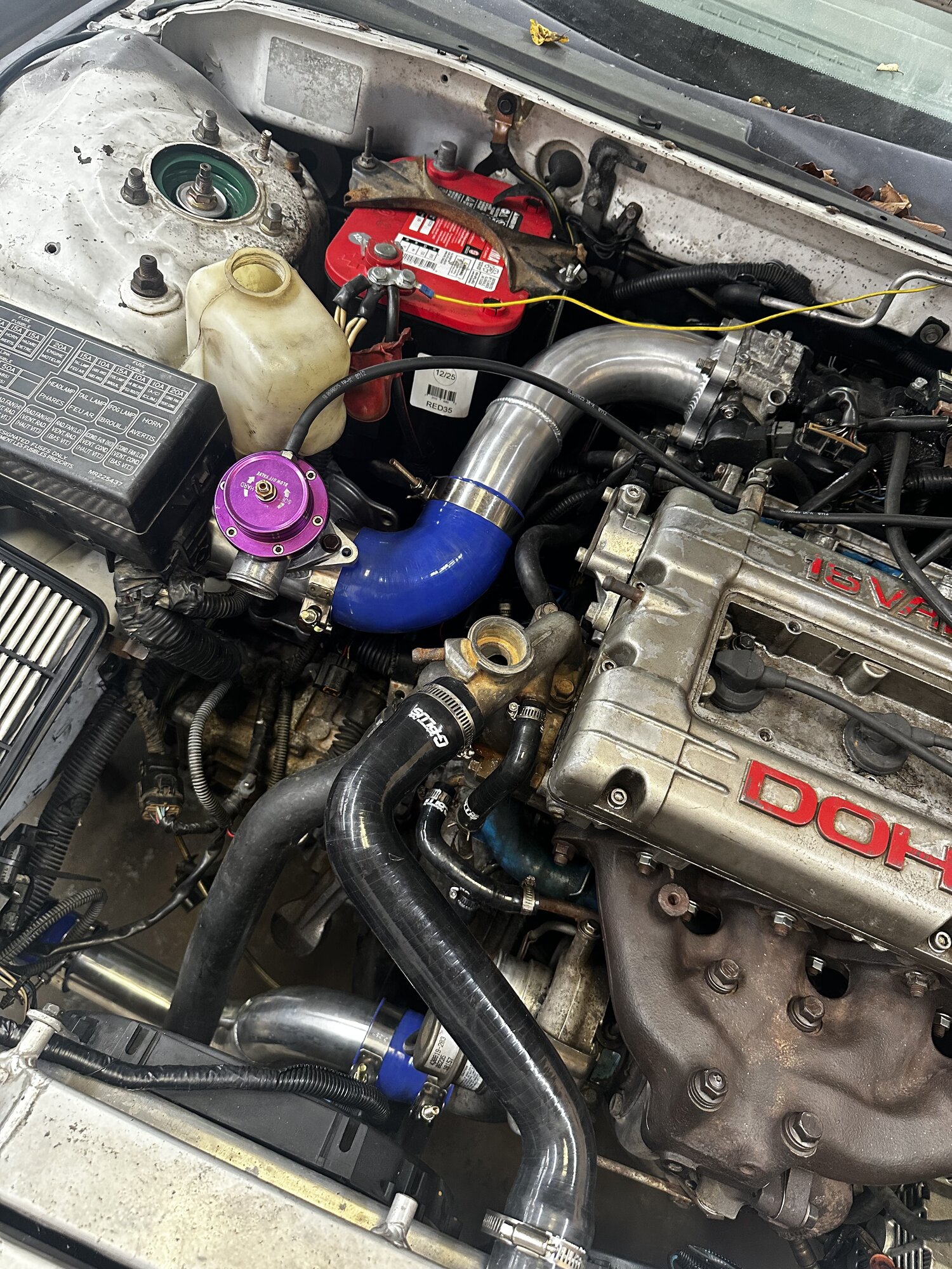

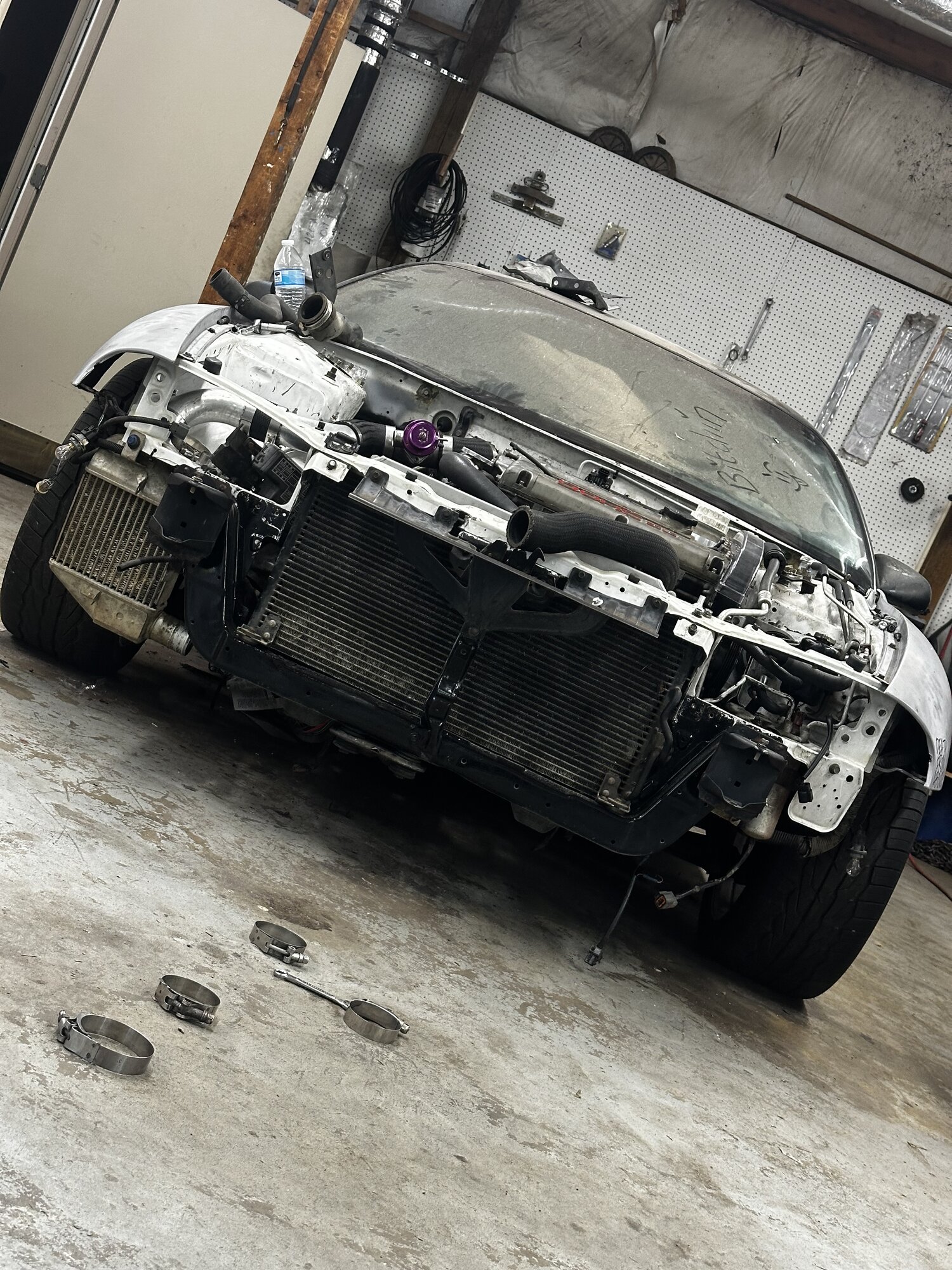

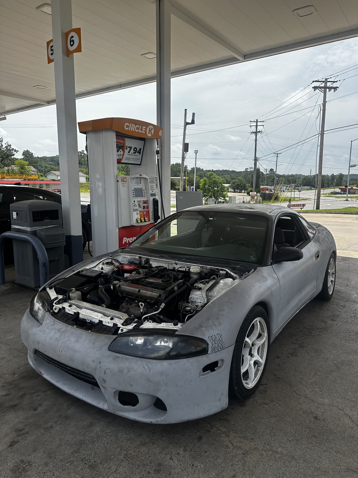

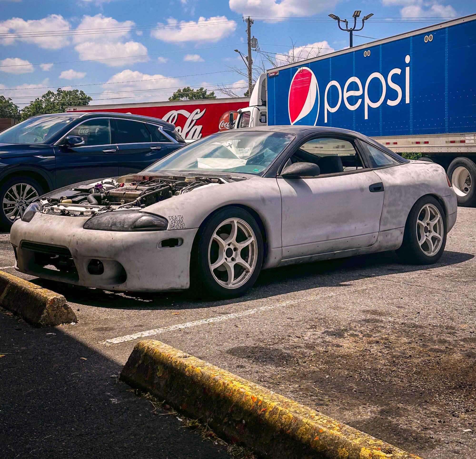

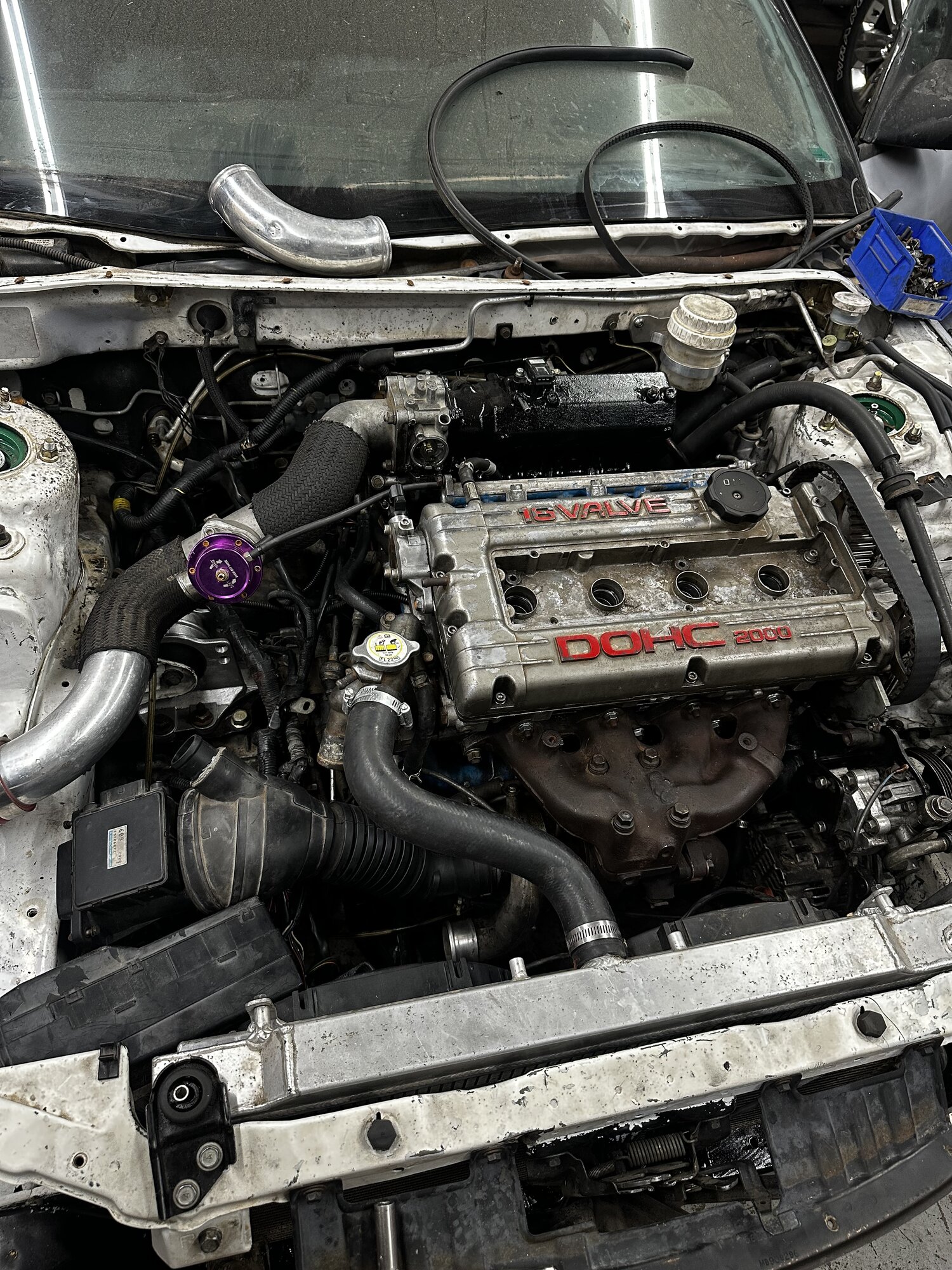

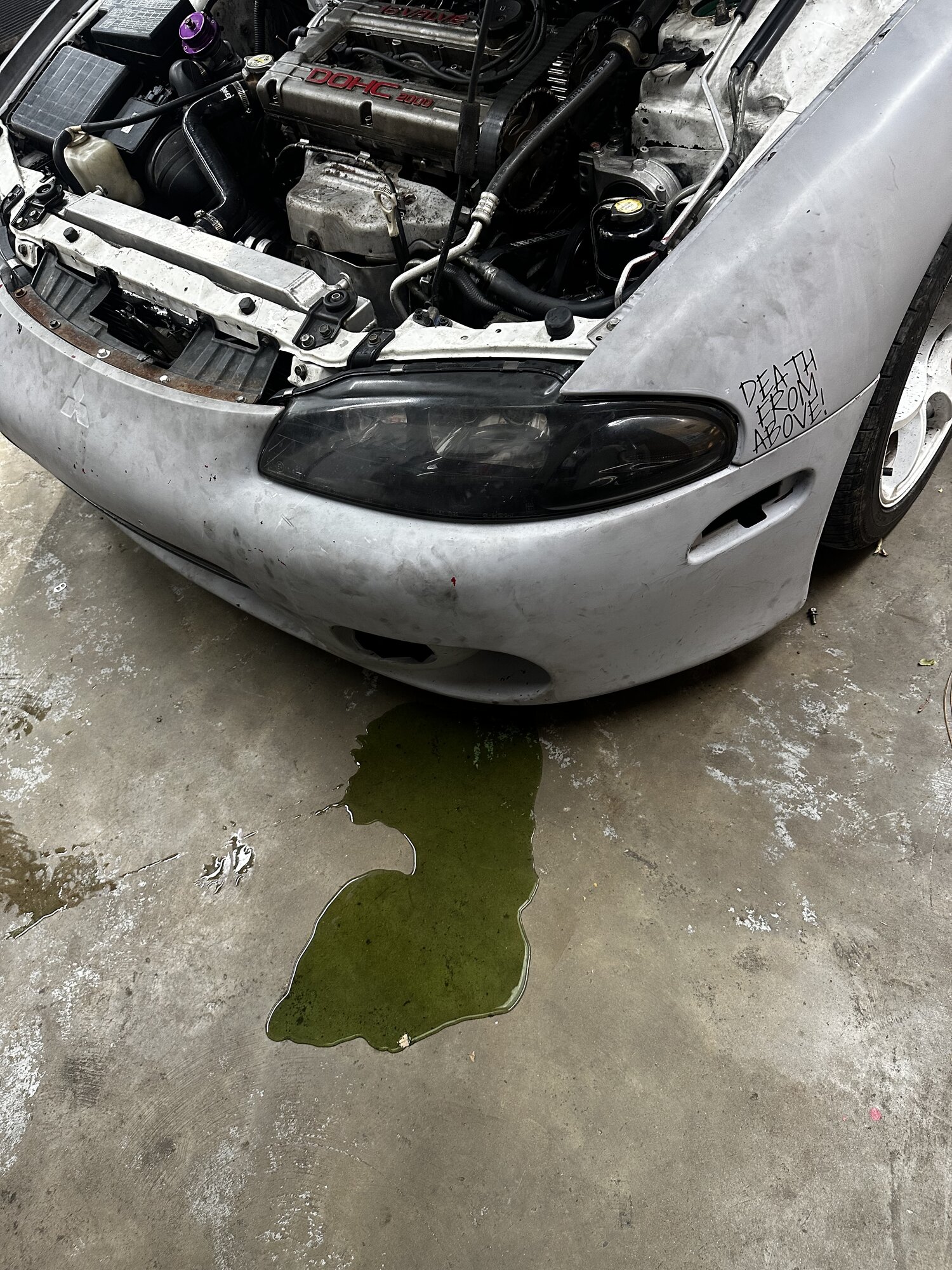

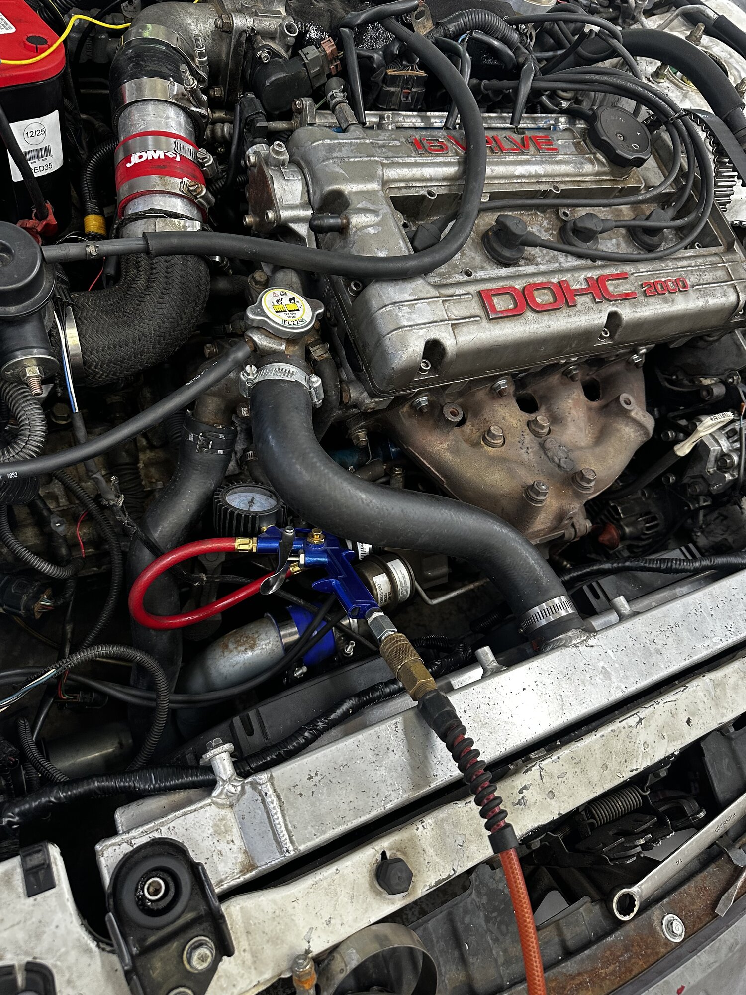

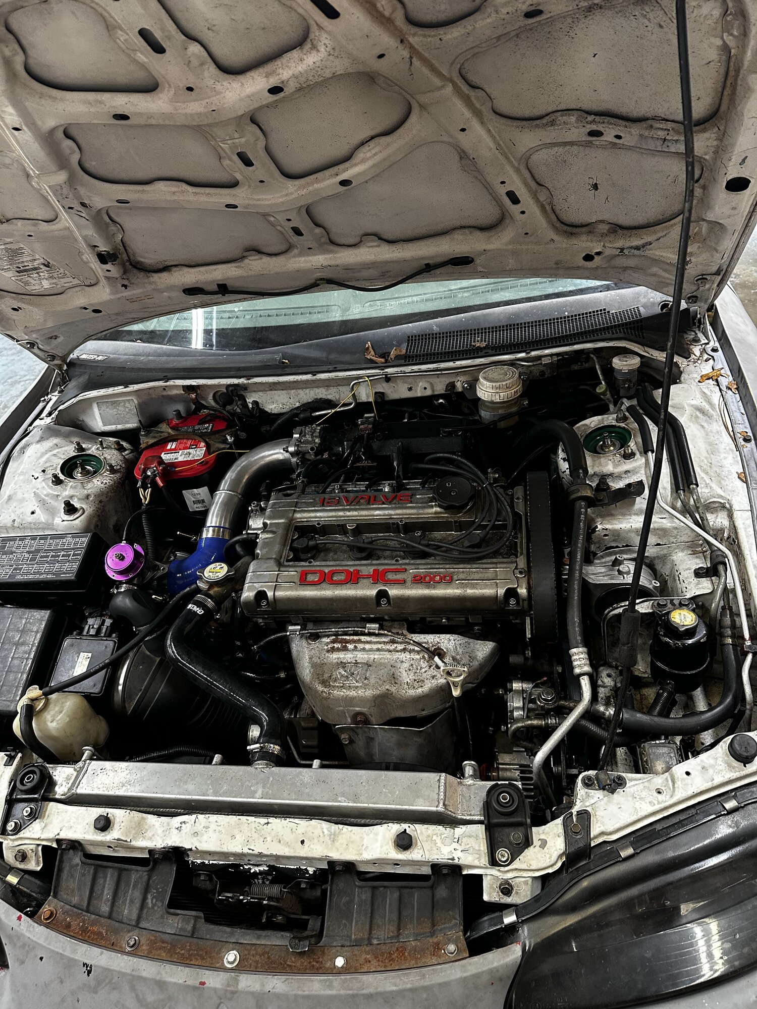

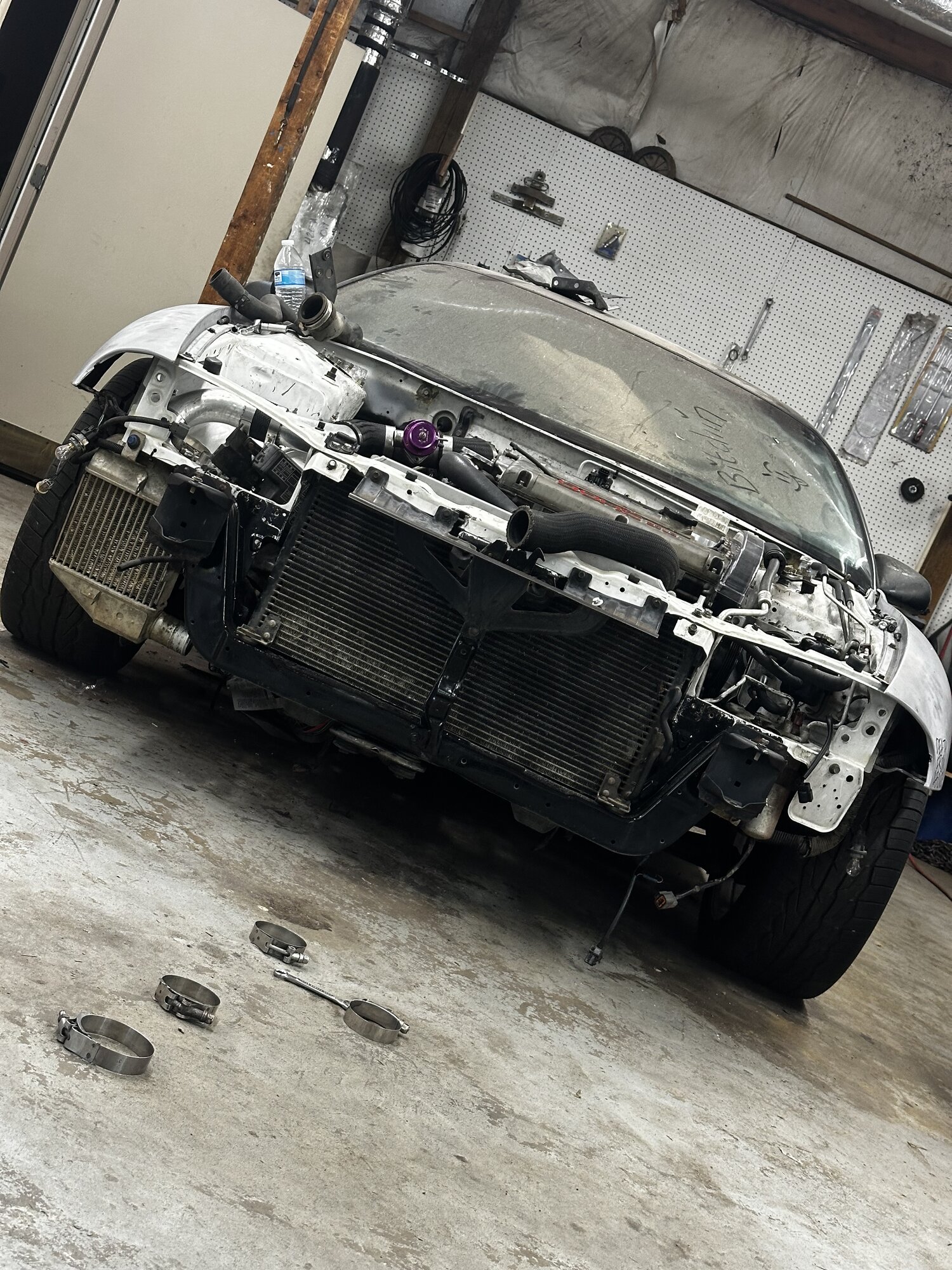

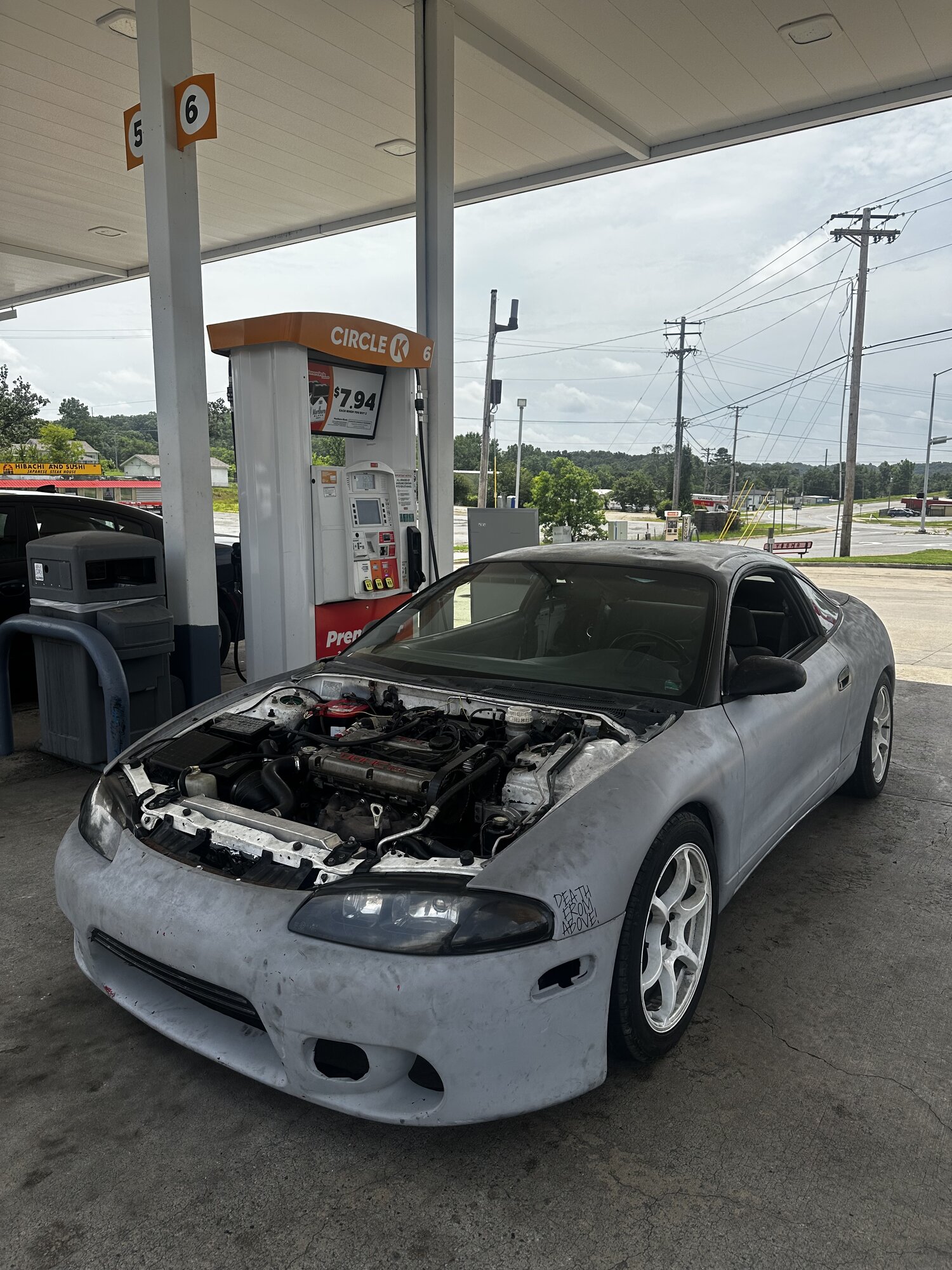

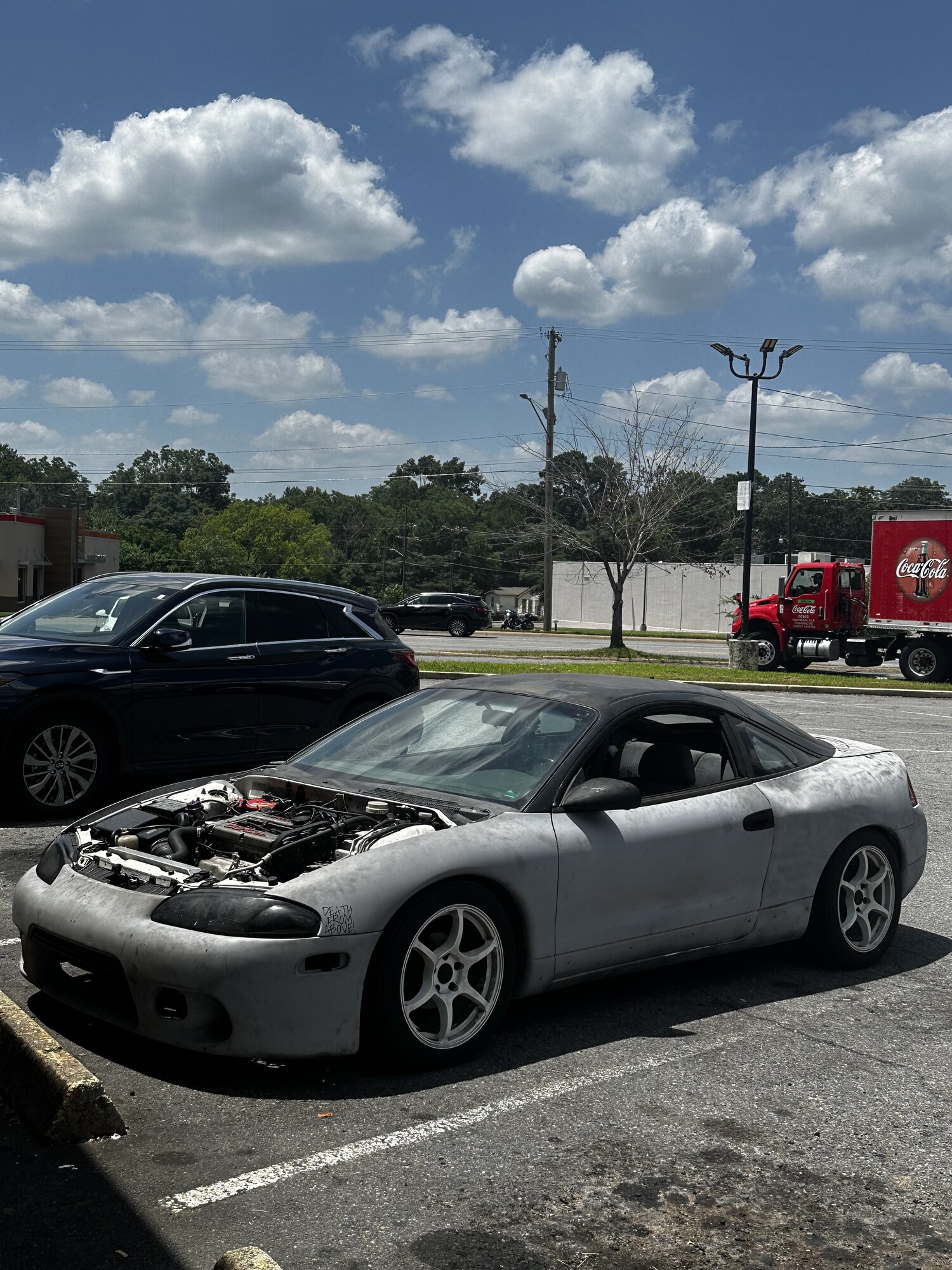

06/14/26 Shes alive! Engine sounds healthy (no surprise came out a running GSX) Chasing down boost leaks, stock BOV was leaking majorly of course. Swapped out with a knockoff Greddy type s. Transmission feel and sounds very good and healthy. Now its time to clean up the wiring, find all the leaks, and start breaking her in.
