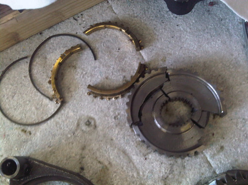

Going back to May 6th, I had a camera crew come out and film me for an online project. Anyway, after a day of filming at home, they followed us to Rocky Mountain Raceway. First run was a bust, can’t exactly explain why. Second run I got all setup with in car cameras. Launch sucked, again – unsure what happened – slamming gears didn’t go well, then fourth went in and stuck. Limped down the return lane and pulled over. I was finally able to get the car out of gear, but knew the damage was already done.
This is what we found the next day.
Originally only the 5th gear synco was busted, but the gear ended up being demolished to get it off. Well, that sucked, but was an easy fix.

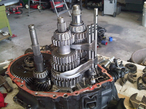

PS. The inside of a dogbox is pretty amazing.
Got the new syncro put in and took her around the block. 1st, 2nd, 3rd . . . and stuck. After a bit of coaxing, got it back into 2nd and BAM! Screeching halt, car dies. Tried to crank it once and then gave up. Luckily, I was only a few hundred feet from my driveway so we grabbed the truck a towed it back.

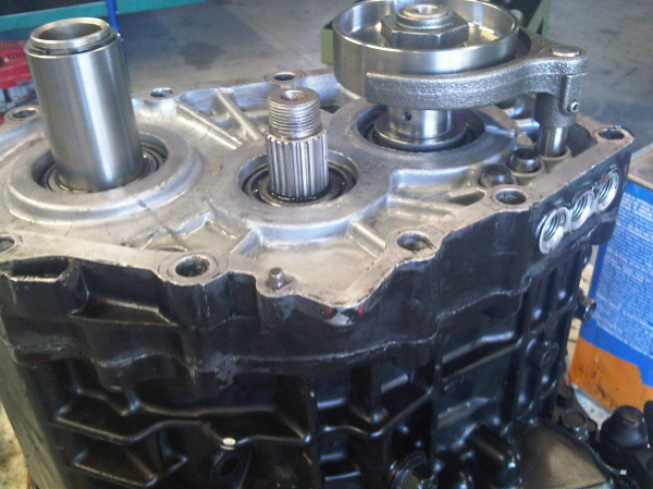

All this gave us time to install a 5th gear delete.
