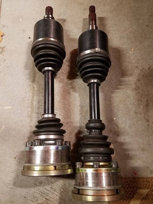

Rear axles shouldn't be a problem anymore as I bought these from Adam StJohn after the event was over.

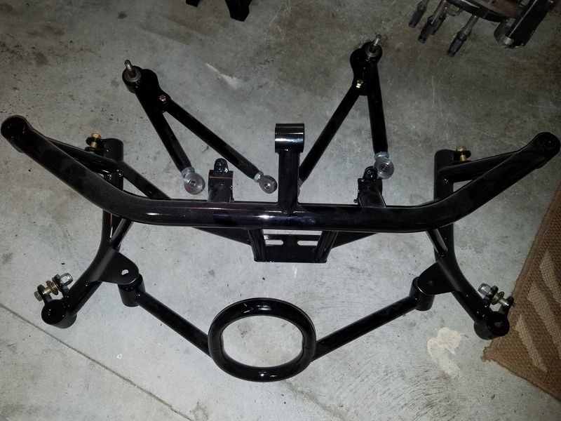

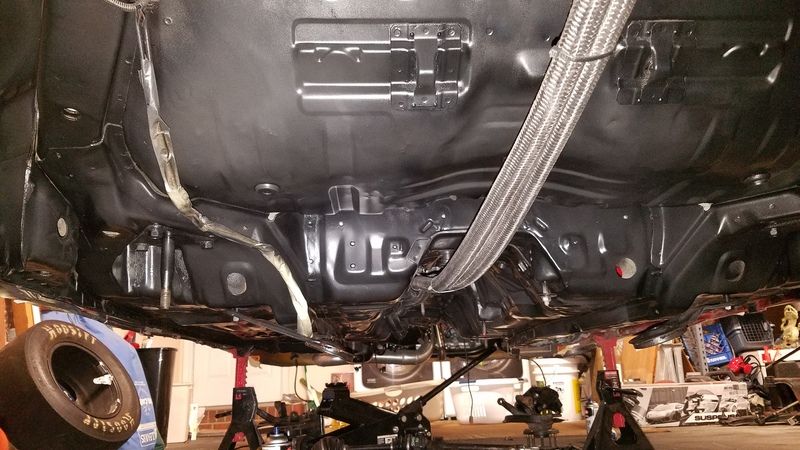

Well since plan "diet" has started, I was able to source a tubular k member from don and Justin Barnes. Construction is very nice and will shed around 40 lbs in the front. It has a built in driveshaft safety loop and a clamp to go around the tail shaft of your t case.

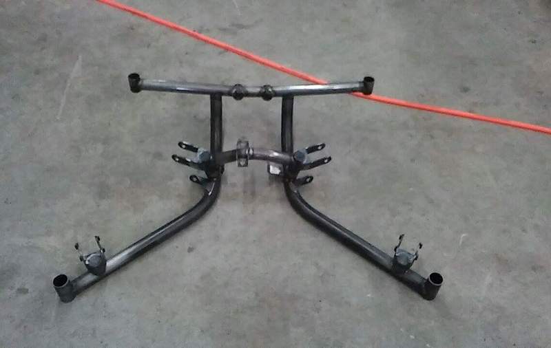

Well the diet is still commencing so I had a tubular rear subframe built for the 4 bolt. It's getting powder coated at the moment.

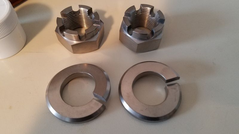

Second is a set of titanium axle nuts.

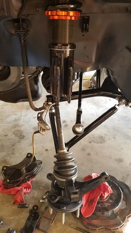

Now that I have the tubular k member and the rear sub frame I can install the k sport drag kit

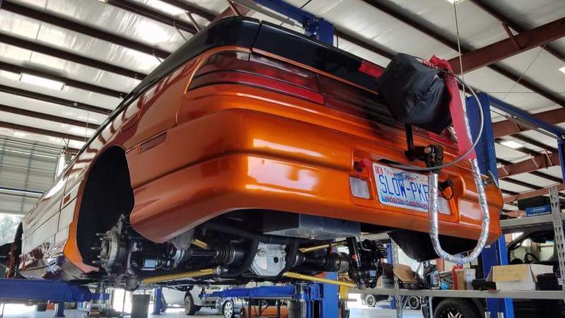

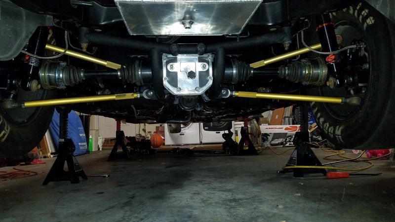

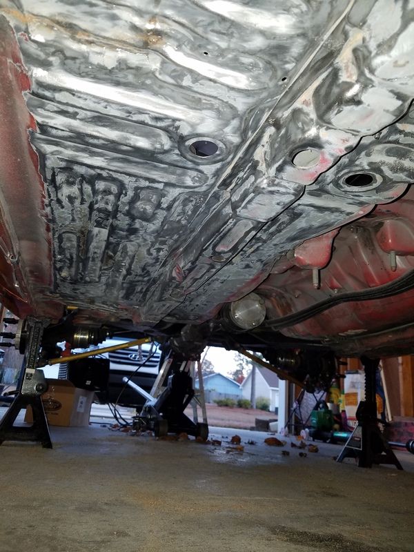

I got the rear installed yesterday with help from my pops. Installation went smooth except for sourcing some new bolts that were needed for the upper control arms. A big thanks to Bruce Williams @ Carolina Dyno for making this tubular rear for me.

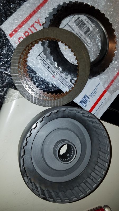

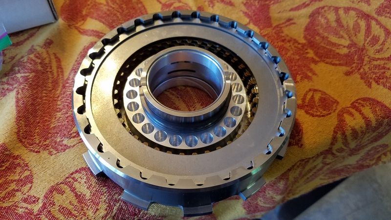

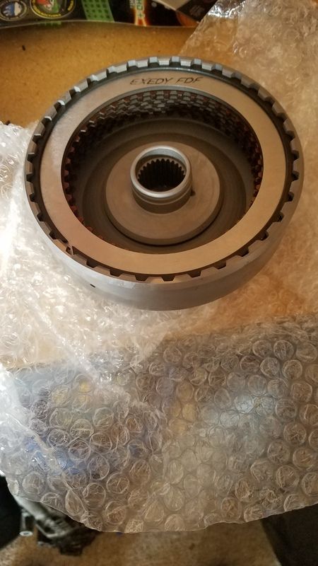

While the rest of the household was sleeping @ 530 I decided to work on the transmission. Took the JB Designs front clutch apart and let the frictions soak in transmission fluid while I disassembled the transmission. I was right at the point of putting it back together when my arm was twisted and ordered the Kiggly billet basket. It should arrive this week and I will get it matched up with the JB Designs part. I'm glad that Jeff and Kevin are making parts for this transmission that are allowing guys to push these cars harder and harder.
JB Designs basket

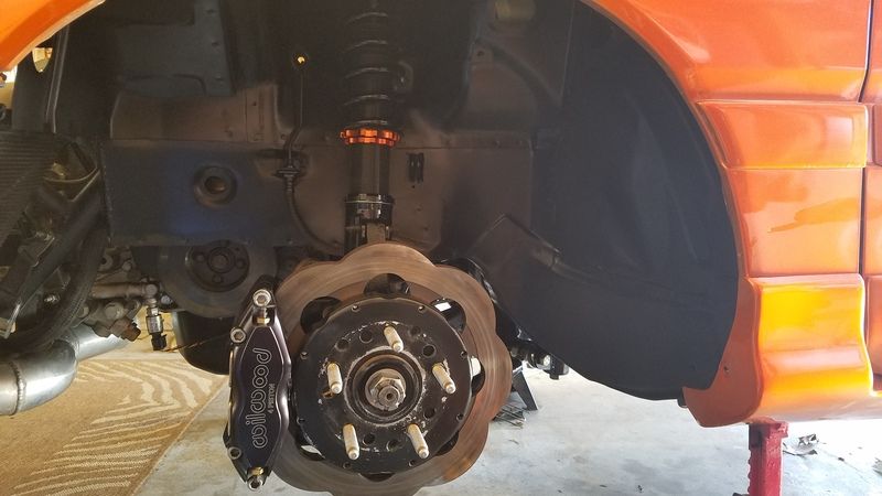

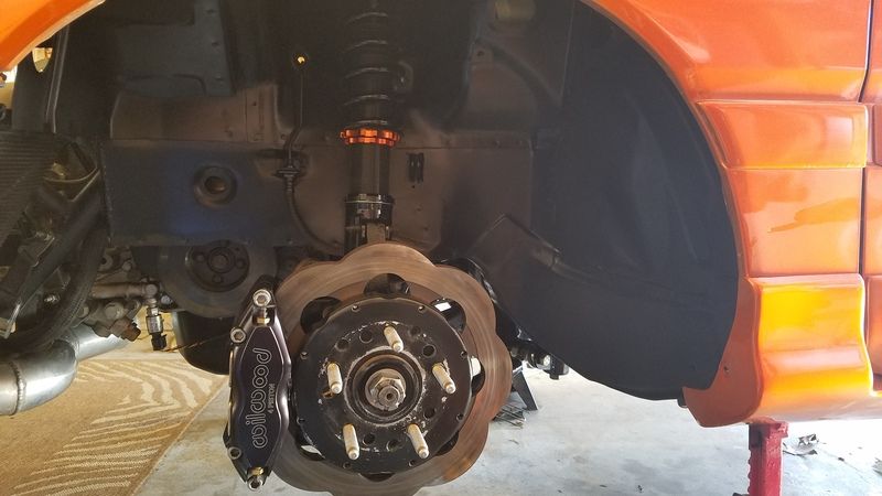

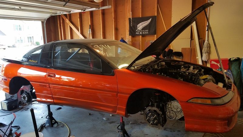

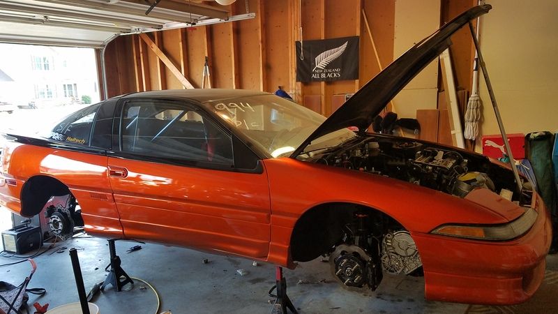

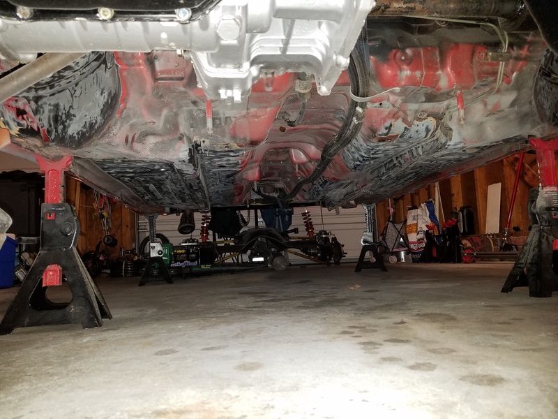

Well I got the trans put together and installed over the weekend. After the trans I got the front subframe installed with the help of my pops and Brandon (team fury).
Finishing up a few odds and ends and the car will finally be on the ground for the next round.
