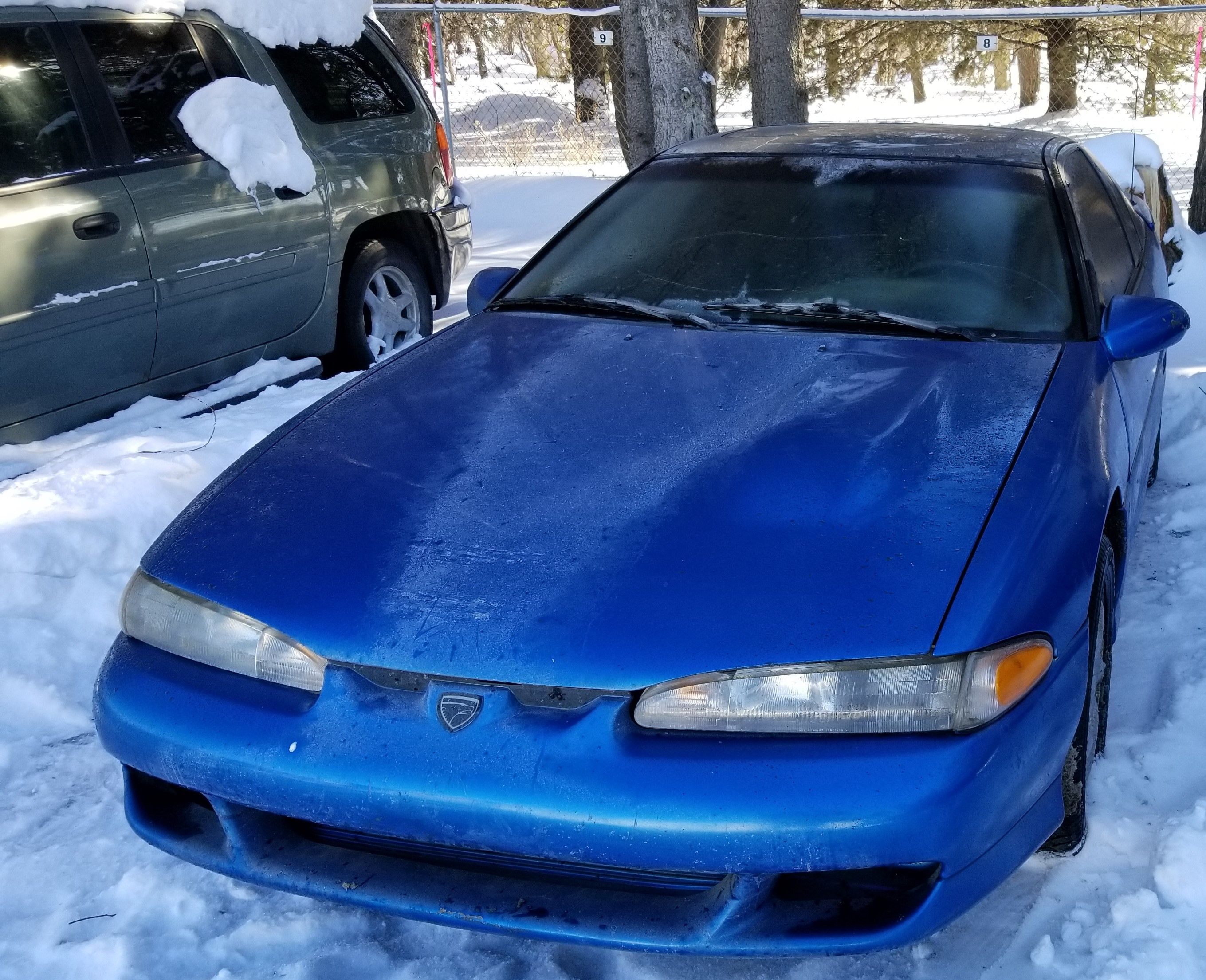

I found this car a couple months ago. Starting to do the work on it now.
Hello to All
So I'm not sure if you would call this a "barn" find, but to me it was a good find.
posted was an add for a 91 Talon Tsi. Went and looked, liked it, it would turn but no starting. Guy told me parked for 10 years. Fired it up about 6 years ago. I have plans for it, being the body is really good. Didn't start didn't bother me.
Bought it, brought it home, tried to turn it a couple times, no go. So next day went and got some plugs, put them in, no go. Pulled plug and tested spark, had lots. pulled the banjo bolt off the fuel filter, no fuel, ahh makes sense.
next day, pulled fuel pump, seized solid. Pulled fuel sending unit, rusty. Looked in tank, scaled rust.
So decided since it is still winter here, lets pull the tank, get it cleaned and treated. they quoted me 3 weeks to a month. no issues here. so since the tank went in i have bought and fixed:
Fuel pump- got a 133 lph pump. cleaned up the fuel pump holder. Installed new wires,
Cleanup up Fuel sending unit- When I pulled it it didn't work. Cleaned it all up, got it working again. yay
Pulled ECU. Wanted to send it in for a EEROM. no go, they don't have any boards.
Took interior our to see what has been done with the car in the past. Cleaned up what I didn't like. Old wires from Stereo install, etc. Painted some parts etc.
So tank came back to me last week, will try to install this week. the biggest thing to me right now is to hear it run. I gave myself a budget to get it running. it is approaching it. If it starts up, I'm good. if it doesn't, might re-think it. I think once it has fuel, it should go. being it was stored for that long, I think it was closer to 15 years, What greblins am i going to find....... write more later.
